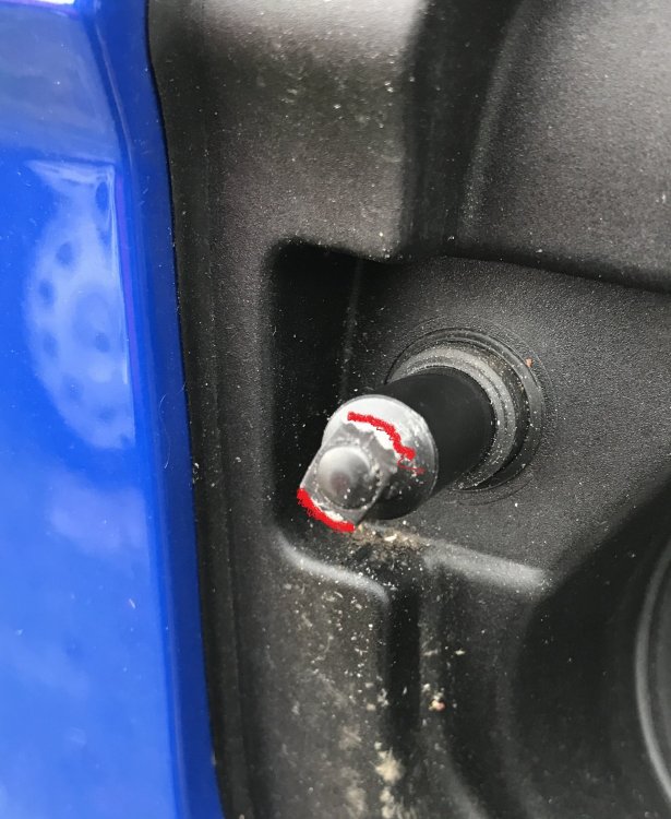

The plastic lug / latch needs a trim with a sharp blade.........
Can you elaborate, please?
I trimmed the edges marked in red......it cured my 'reluctant to open'  problem and also, if it sticks again, a little bit of gentle levering now pops the flap without doing any damage.......
Thank you Berisford!
