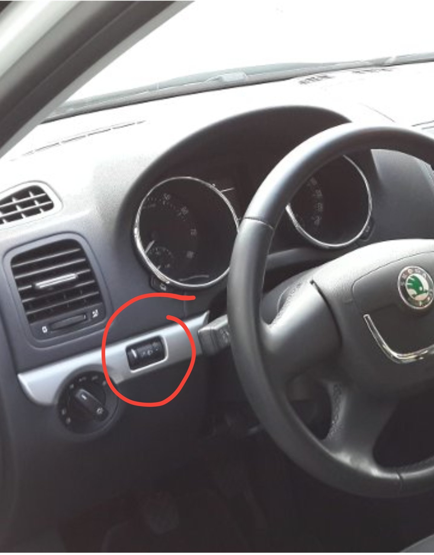

Do you guys have a dash dimmer switch? Our poverty spec just has the headlight raise/lower wheel not the dash light dimmer but judging from this picture it looks like the dash/headlight dual controls are standard spec on some trims?
If so, my next question would be has anyone retrofitted the dual control switch ? Is the wiring already there for it?

Your profile says that you have a Superb and not a Yeti - but no matter as I can either move the post or you can alter your profile - just let me know.
Anyway, I would guess that it there's no dimmer fitted on the dash then that function should be in the infotainment menu.
The Yeti belongs to my partner👍
It's a pre-FL 1.2 S and doesn't have the Maxidot display. I can't see anywhere on the head unit to manually adjust the dimmer either... it just seems to be set to 'fairly bright'
I'm guessing it's because it's a base spec model.
I'd be surprised if the wiring was already there but it's easy enough to check. Remove the switch and count the wires, if it's about 3 then it's missing, if there are about 6, it's present :)
Base spec did not have the dimmer control.
Logic prevails, Langers. Cheers 👌
