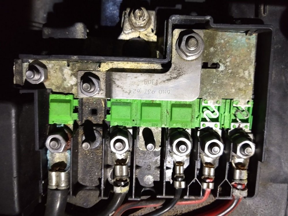

I am working through the PAS threads (my PAS has stopped working. Light on, heavy steering. New battery - no joy. Topped up PAS fluid - no joy).  I've found a blown fuse in the battery terminal fuses (the PAS one) but can't find anyone in the UK who can supply a new one!
Has anyone got any suggestions where I can get a new fuse quickly or make a repair please?
Is it the dingy looking fuse on the far right of the picture you are referring too? (It looks like it's gone).

Has it blown or has it corroded through ?? does it look "burnt"......???

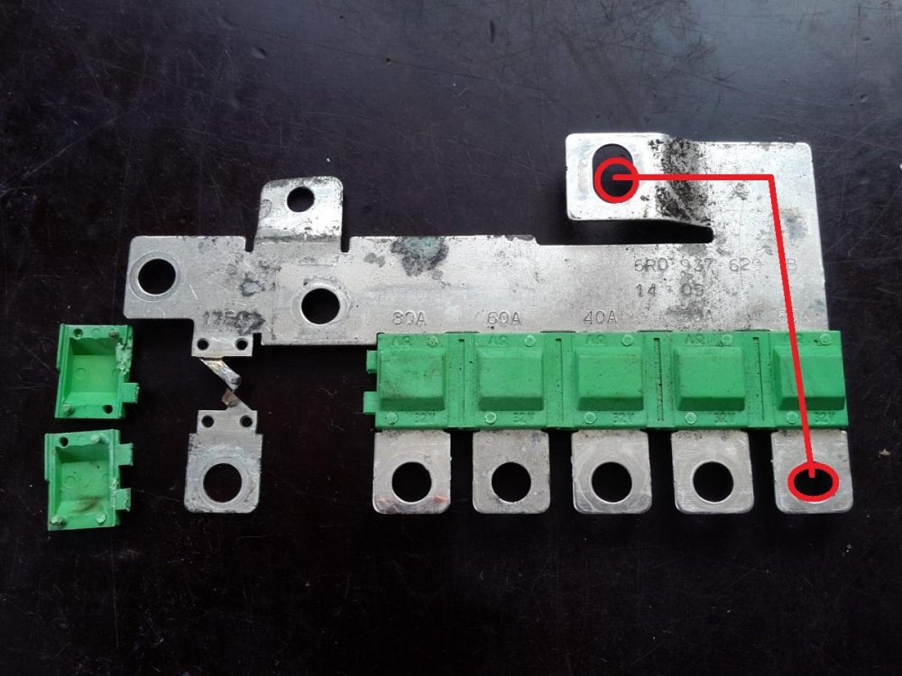

EDIT - Another post mrgf found shows an image.....
What you "could" do as a TEMP fix ONLY is make a small jump lead using 50 AMP wire and connect between the link as in image below.....this will allow the system to work. "IF" you do this, A) you need to ensure all is working ok ie the light goes out as that "may" just be a fault as there is no power because the link is broken, AND check the wire is not getting hot ie your power steering unit is not siezed / working properly, if all is then good, then purchase / replace the linked part / assembly.
IF THE WIRE GETS HOT, YOU HAVE A PROBLEM AND IT NEEDS FIXING PROPERLY TO PREVENT THE RISK OF FIRE !!!!

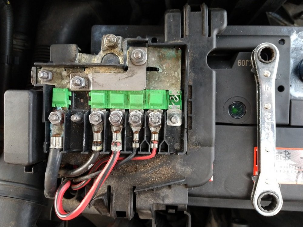

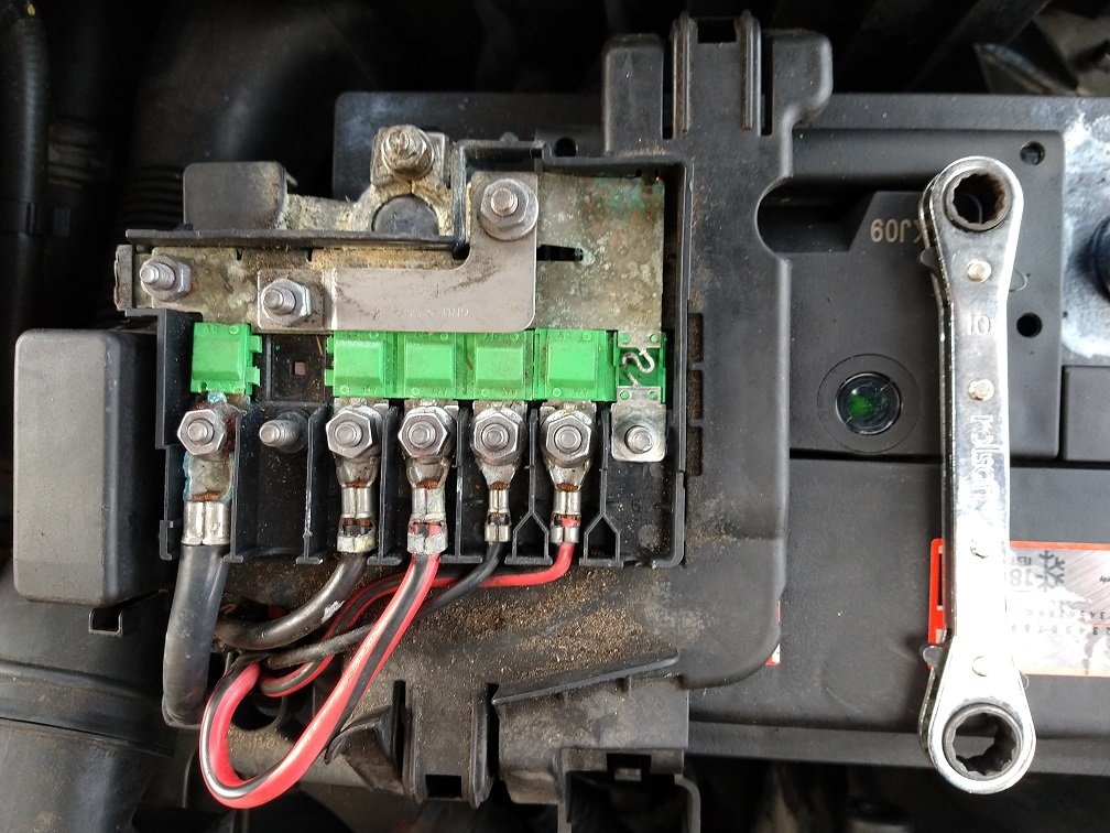

Moe the wire 3 studs left onto the unused fuse?   Can't make out the values on this screen, but if it's close/similar.
May be worth checking the run of that red/black wire for any damage/shorts to chassis, before anything else.
Looking now on a bigger screen, it seems that spare fuse is a 60A and the normal PAS one a 50, but the wire looks plenty chunky enough to be sufficiently protected by a 60, so I don't see any problem with just moving the wire once you've checked for cable damage. It does look like your fuse has burnt out rather than cracked though, so needs investigation into why; cable damage shorting to metal or water ingress into the main power connector at the PAS module would be joint top of my list of suspects.

Good morning everyone, and thank you all very much for your kind replies.  (I tried buying a replacement from Skoda-Parts but their site went down yesterday)
Moving the wire to test was a genius suggestion! Unfortunately, I think the blown fuse was probably a red herring, caused when installing the new battery - carelessly!  The PAS light is still on...
So, we have:
Battery fuses OK
A new battery (although the little green light is off now?).        (12.59v switched off, 14.32v-14.49v at 3k revs, AC on etc. Trickles slowly back from 12.88v when switched off.  It looks to my untrained eye that the Alternator is functioning?)
Pump fluid topped up (it wasn't that low).

Yeah, looks like you went from a 50amp to a 60amp so if the fuse WAS blown, stay there temporarily but if it was actually ok, slip it back as its only ten amps but its still 20% higher a rating!
The little "Trick" urban panzer suggested was similar to what I was thinking but I would then slip it through an in-line fuse of the correct rating, to be sure.
Sounds like the pump has given up the ghost, though. Usually, when topping up from a low/empty level, you need to work full lock from left to right, a few times to get air out the system, etc but as you mentioned driving for a bit, I guess you did that anyway, unless the shops were just one or two streets away.
