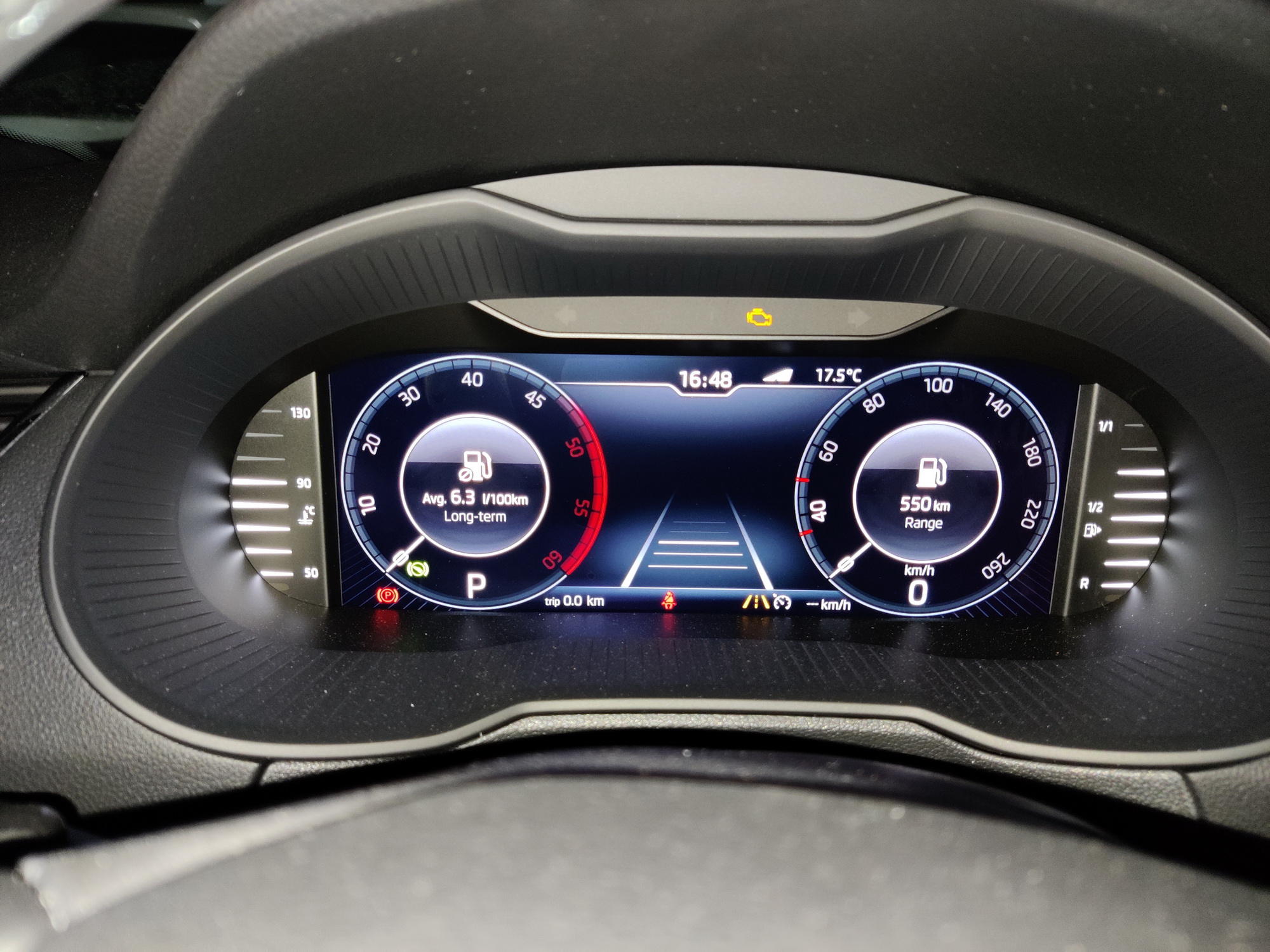

Ok, so I was being a bit blind, as to the trip odometer reset. I also think that the user interface leaves something to be desired. I found the "odometer reset" (which, upon selecting, more properly is described as the TRIP odometer reset) under "Instrument cluster settings", which to me doesn't make much sense because it's not really a "setting" (despite the command name being "reset"; to me, a "setting" about the "instrument cluster" would be a configuration change. Anyway, there it is).

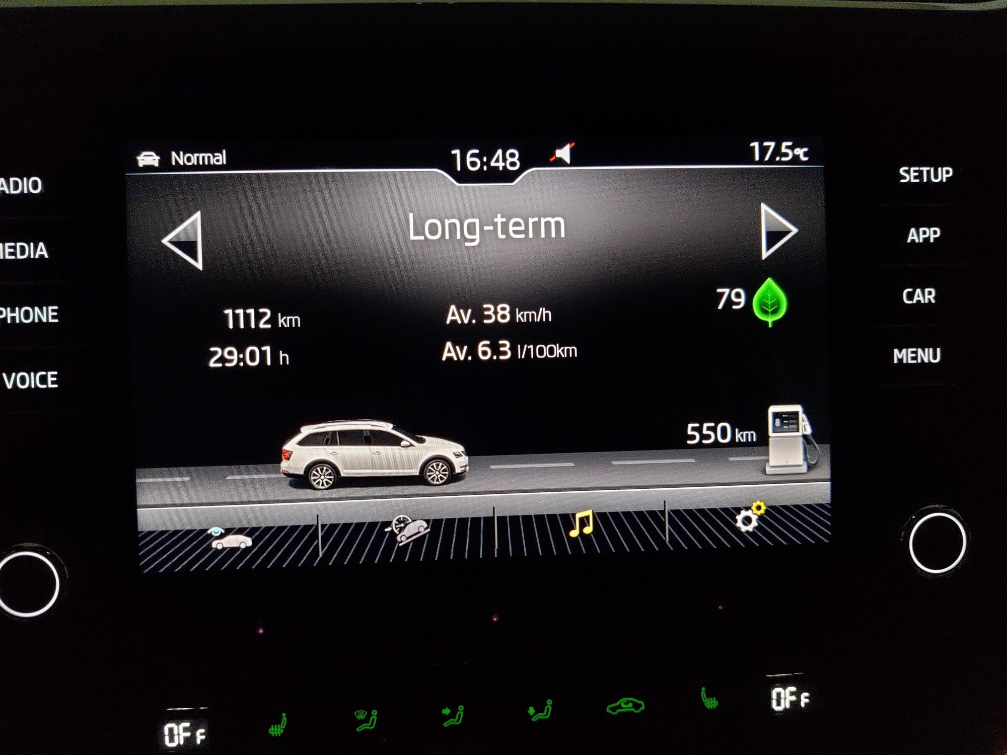

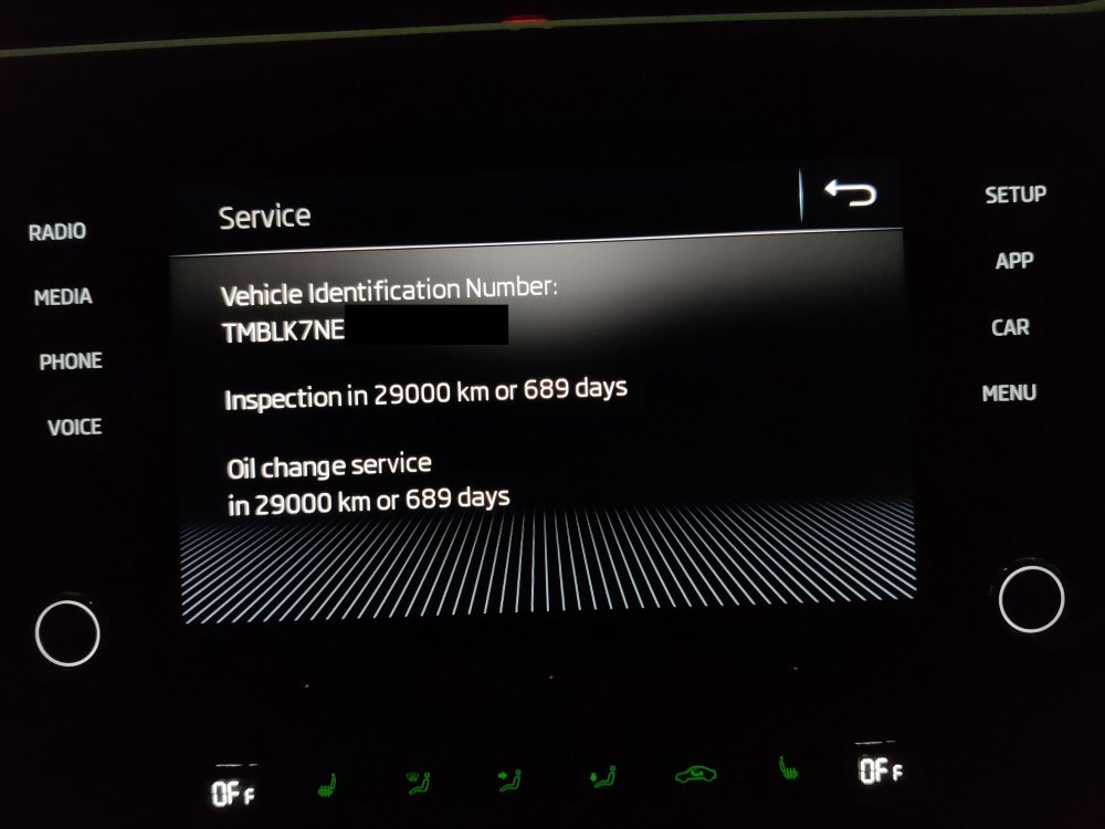

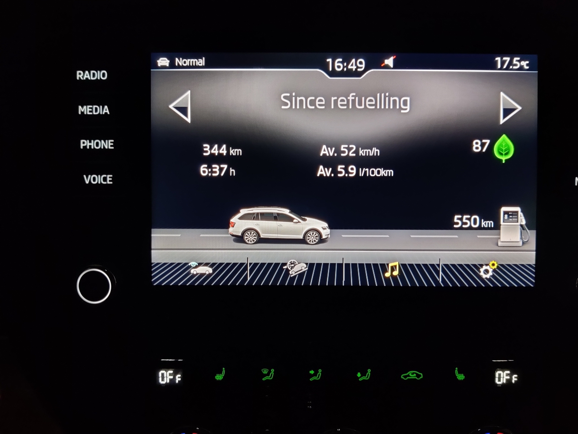

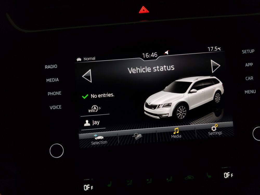

As for Adblue remaining range, I'm still stymied. Here are some screenshots.
And, thanks again.
-Jay
Oh thats nice. A Scout with a Virtual Dashboard. I want one for my Scout!
However - you are looking for the AdBlue settings in the wrong place. It isn't on the centre consule or MIB2 interface - the settings are on the Virtual Dashboard.
Using the righthand button on the steering wheel marked with two squares inside each other, you will enter into the various system menus for the car. Select - Vehicle Information. Now using the scroll wheel - scroll around until you find the AdBlue information.

Thanks @varaderoguy, you've been great. The Zoom won't be needed - with your last piece of advice, I finally found it.
