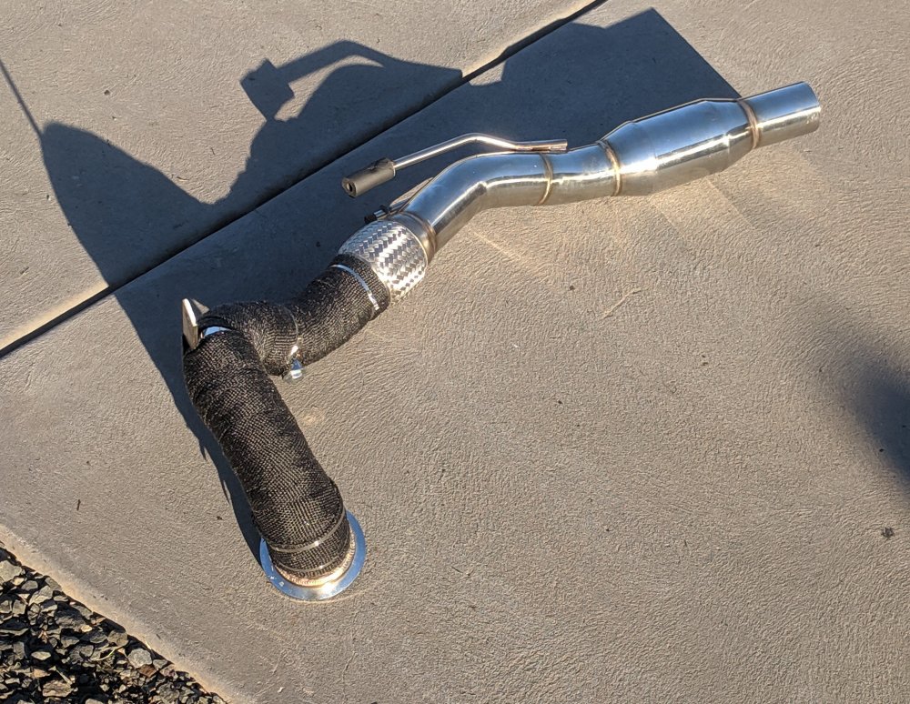

Don't laugh, but I bought my downpipe "second hand" (never installed) for 300AUD or about 150 pounds. I don't even know what brand it is, but I think it's a Taiwanese ali express special. It's got a 200cell cat, the welds look perfect, O2 sensor bung is in the right spot, fitment was perfect and it's lasted me 40000km on a pops and bangs map. I was fully expecting to have to replace it a few months down the track but so far it's been faultless. Now on Stage 3 and it's still working fine. This might be the unpopular opinion but sometimes the name brand stuff is not worth it, at the end of the day it's just a stainless steel pipe (unless you have really harsh winters... cheap stainless will corrode)
