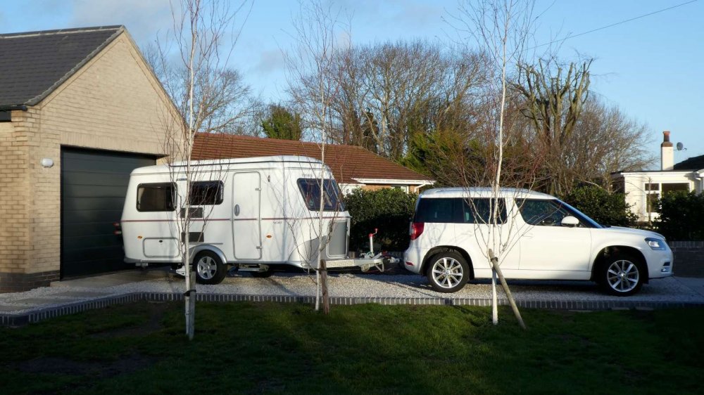

I towed an Eriba Troll and later a Bailey 380/2, I had the 2x 2L 110ps.
Anyway, it towed fast and smooth no problem. I owned two Yeti.

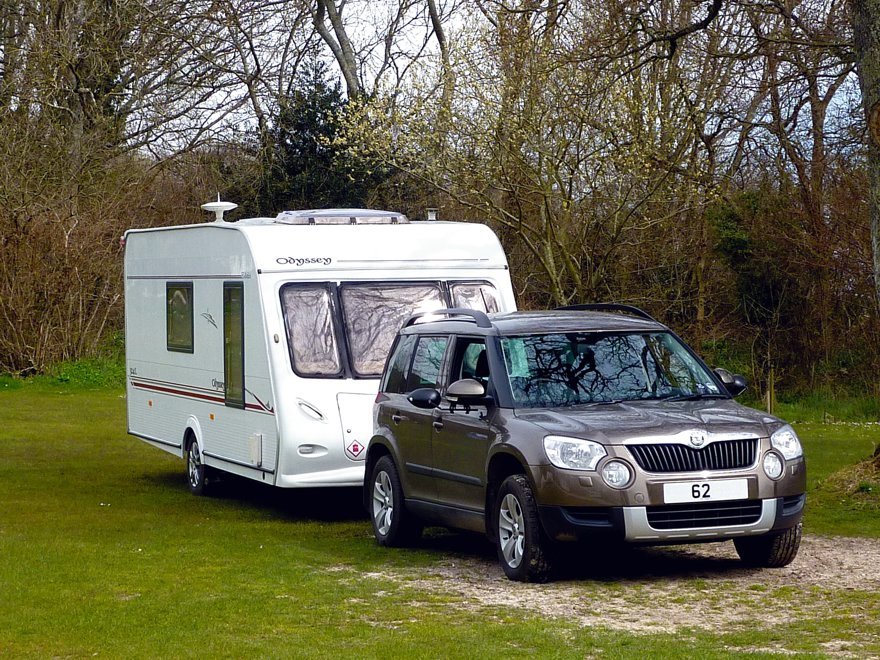

Thanks, owners seem to like them as tow cars for caravans.

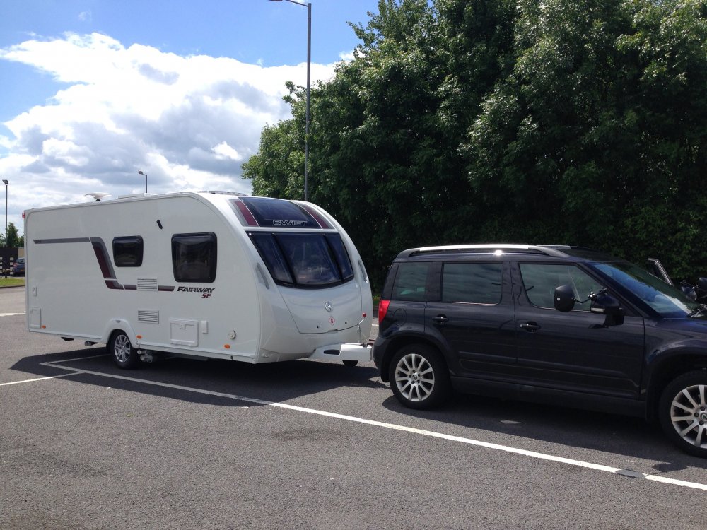

My caravan is a Swift Challenger with MTPLM 1451kg. Its close to a 100% match with the Yeti as a tow car. But with the weight of driver, passengers and loading heavy items on the car it should be ok.
