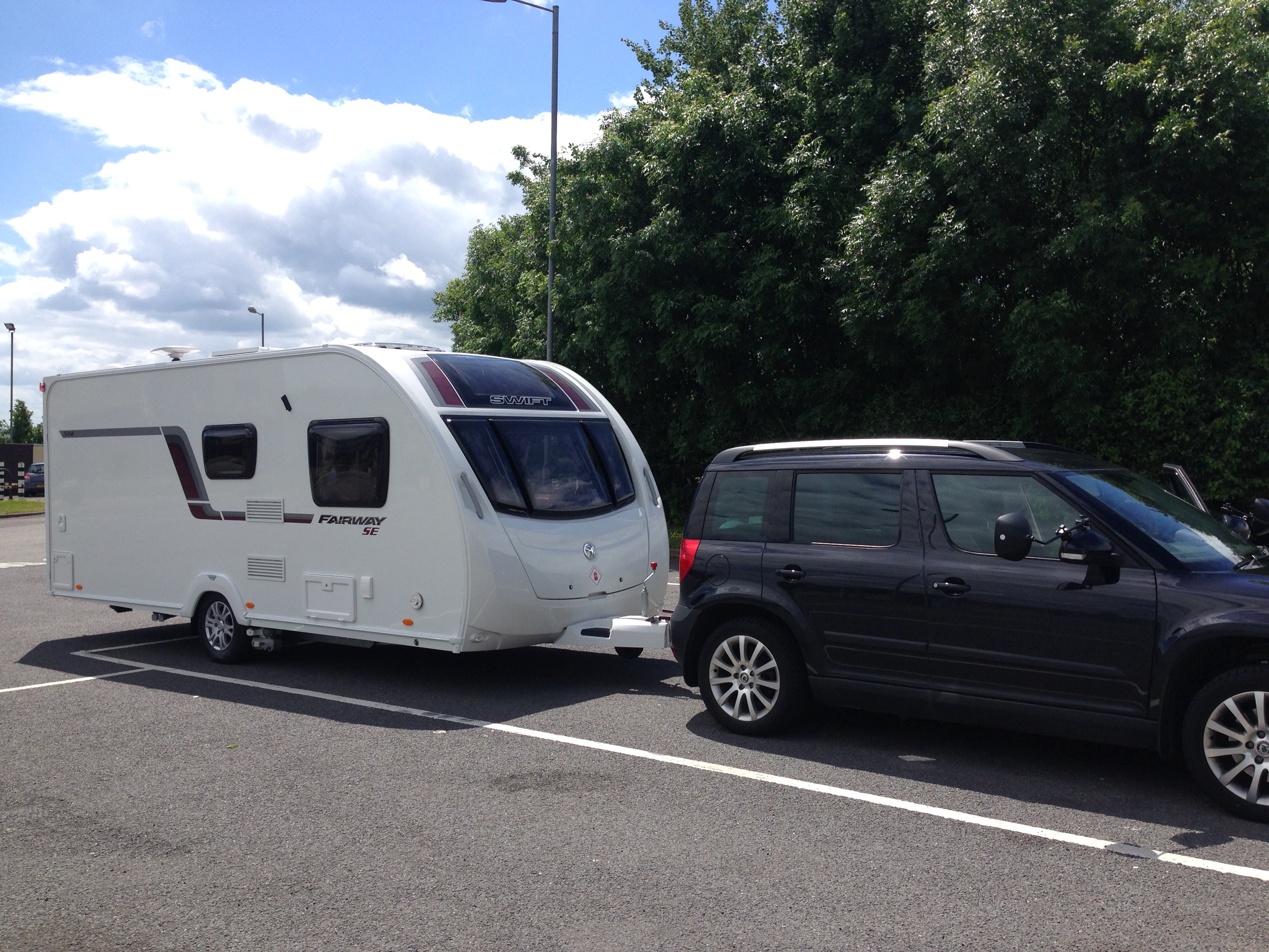

I towed a Swift Fairway,  MTLPM 1500kgs for 3 years with Yeti Elegance 2L 170 Bhp 4x4 with no problems at all.

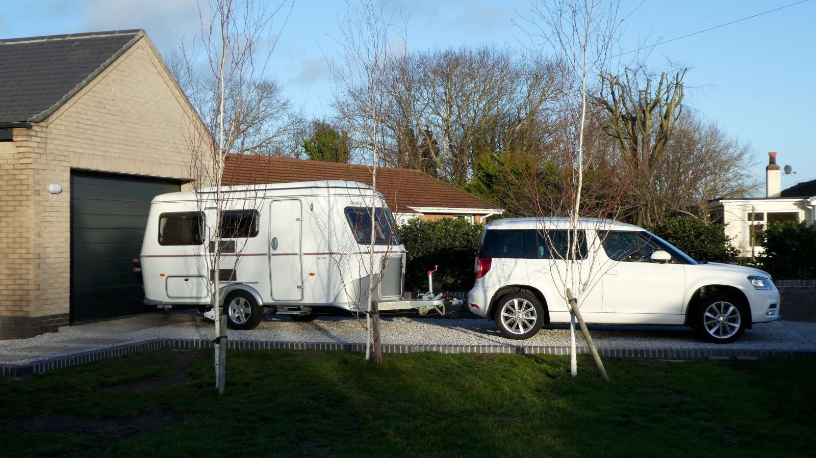

I towed a 1200kg Eriba for 5 years with 110bhp 2wd diesel. The car was very stable and with the rear seats out lots of room. It would also return up to 40mpg and I was very pleaed with it.
I've now moved on to a 1.5 petrol Audi A3 which to my surprise tows better with 150bhp and same torque as the diesel, and has a bigger boot.
Hindsight is a wonderful thing and I would say avoid the lower powered 110bhp diesel. At the time I thought it was fine, but now I realise how much better the extra horsepower is. Ideally a 150bhp 4wd would do the job a treat.
