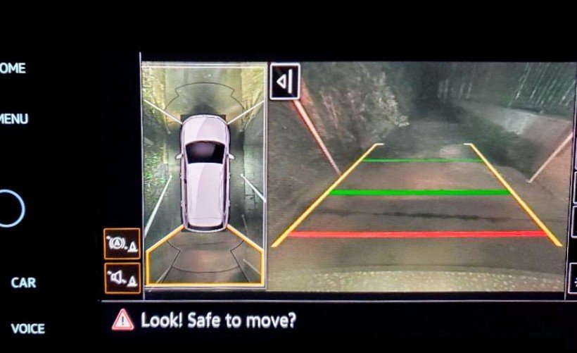

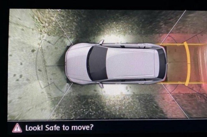

At night when it is dark, do the side camera's mounted under the door mirror not work properly i.e. they need the area they're filming to be illuminated for anything useful to show on the infotainment screen?
In pitch black situations, the side cameras are pretty dark and show little detail unlike the rear camera. I’ve opened my door a few times to get the mirror lights to turn on. OP is trying to get the mirror lights to always turn on when the lights are in manoeuvre mode (turns fogs/corner lights on etc).

when activated, it looks like this on a Golf.....
