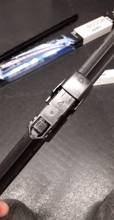

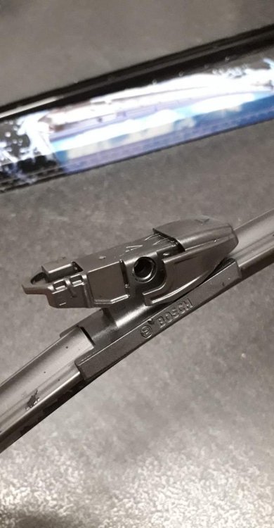

I’ve got some replacement Bosch wiper blades for our 2019 Karoq. According to the website/reg, they should fit but none of the four supplied fitting adapters seems to fit. Am I doing something wrong/daft?..
Any advice appreciated, thanks!
I believe adaptor number 4 is the correct one.
I thought the Bosch A864S Aerotwin Wiperblade set comes with the fittings attached?
Certainly the ones I bought from Amazon last week did.
Edited by Berisford

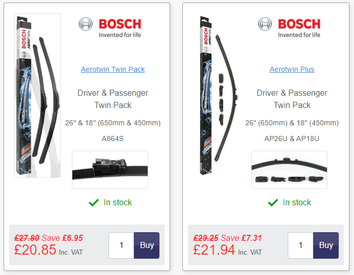

Thank you! I ordered the AP26U and AP18U as recommended - there is a #4 fitting. I will try that tomorrow. I also have an Audi TT and this is also the fitting for that.
I can confirm the #4 fitting is the correct one. Didn’t look remotely similar to the one that was on the OEM blade but definitely works. Now have super smooth Bosch wipers 👍

Definitely adaptor number 4...

Yes, it seems that Bosch have finally got around to creating a dedicated twin pack without the need for adapters...
All this talk of wipers and adapters prompted me to get off my backside this afternoon and do something about the front + rear replacement Bosches that had been delivered before Christmas. They were A331H (rear) and A864S twin-pack for the front. They were all direct replacements for the rubbish supplied with the Karoq - there was no need for fitting any sort of adapter. I got mine here (if the link works).....

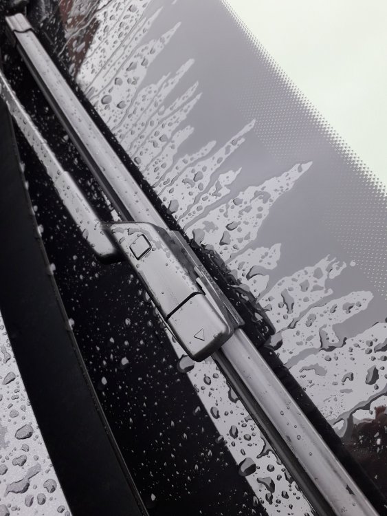

Fitting was a doddle - especially when I had re-checked the manual to get the wipers into the 'service' position (P289/290 in my manual). The spring on the wiper arm is surprisingly strong so I would wholeheartedly support an earlier suggestion of putting some padding (e.g. a folded towel) on the screen in case the spring thwacks back and buries itself in the glass.
It hasn't been possible to test the wipers in real rain yet but, a few squirts from the washer, and the wipers were sooooooo quiet. A vast improvement! 😊

The Bosch twin pack A864S that doesn't require any adaptors is available from Amazon for £17.35.
The rear is A331H @ £5.94
