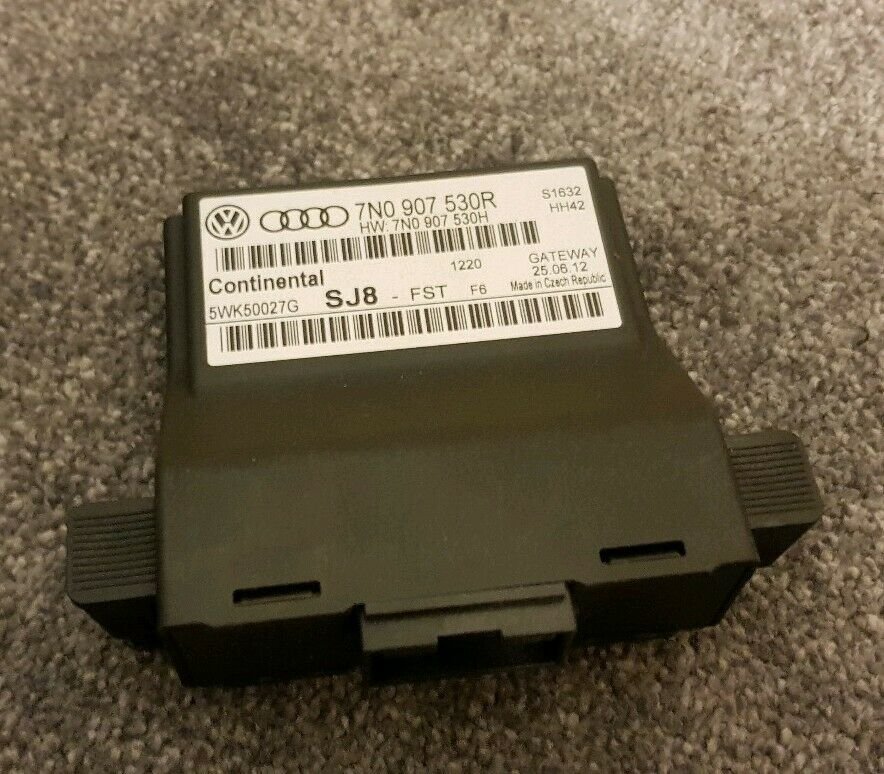

To the OP. Your problem is almost certainly the radio keeping the Canbus active, you will need to fit and code a canbus gateway controller with a later revision number, its well documented.

so it looks like I either need to get a newer gateway controller or put the standard radio back in?
how do I know where to start with getting a new controller?
Will the head unit maker not supply patches or am I barking up the wrong tree?
is this what I need?
Barking up the wrong tree, we eliminated the radio earlier when you confirmed that you'd reversed the wires.
I think your problem lies in the loom or the drivers window motor.
The CAN gateway won't be at fault.
