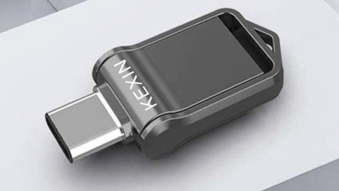

I entirely agree that it is a big shame to lose the SD card slot, but probably there were reliability problems and it simply became easier for VW/Skoda to simplify things down to just one connector and USB is the most flexible.
Here is a nice little device that is quite tiny but couples a USB-C connector with a USB-A for connecting it to computers which don't have USB-C for loading music onto it.
£18.99 for 64GB at present (cheaper I am sure in the future and there will be more devices like this on the market).

You have to be very careful with big capacity drives like that. I've found 64gb ones don't work in the car. 32 seems to be the max. Something to do with the way the data is stored and logged or something very technical above my pay grade!

I'm using a 256GB SD card for my music with no problems - the key is to make sure the card is formatted FAT32 which Windows won't do for large SD cards (in their "wisdom" M$ have decided to make 32GB the maximum they will format to FAT32) , so I use a downloaded app which will format up to 8TB as FAT32...

Quite right. MS as always a law unto themselves. There is no real technical limitation that they limit FAT32 to 32GB except probably to encourage people to move over to NTFS (which is also supported by the head unit). It may also be that the operating system code is old and venerable (like a lot of Windows) and they don't want to risk meddling with it!
The major consideration is the sector size, which for small volumes up to approx 2TB is 0.5kB - that is even the smallest file will occupy 512 bytes as a minimum space on disk. FAT32 can go up to approx 16TB, using a 4kB sector size, but whether that is supported is unclear as the manual doesn't specify a maximum size for volumes.
