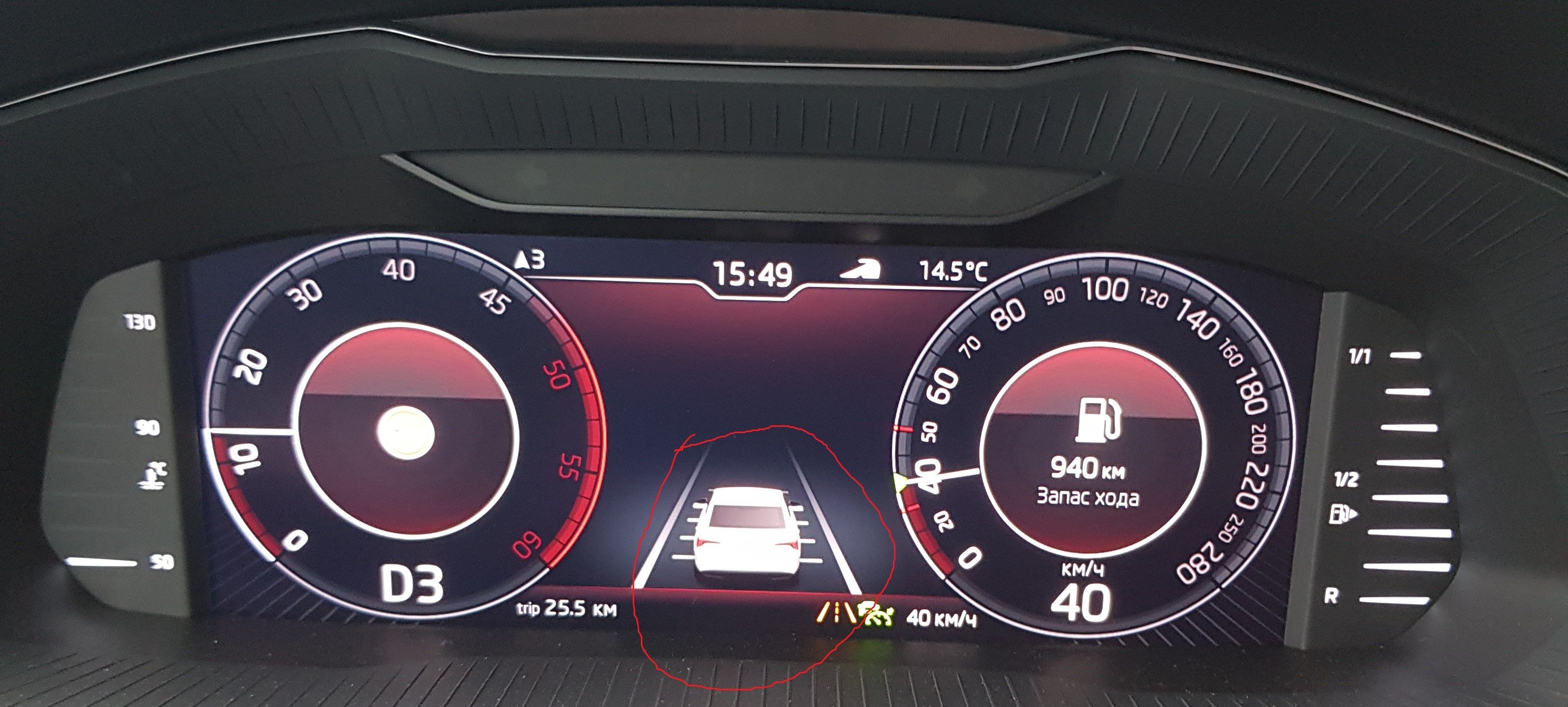

Sasha do you know what need to be changed to make icon of the car makes move in ACC display? In mine case it all time on the lowest position but ACC itself works fine. THX
I don’t have ACC on my car so I couldn’t say unfortunately.
