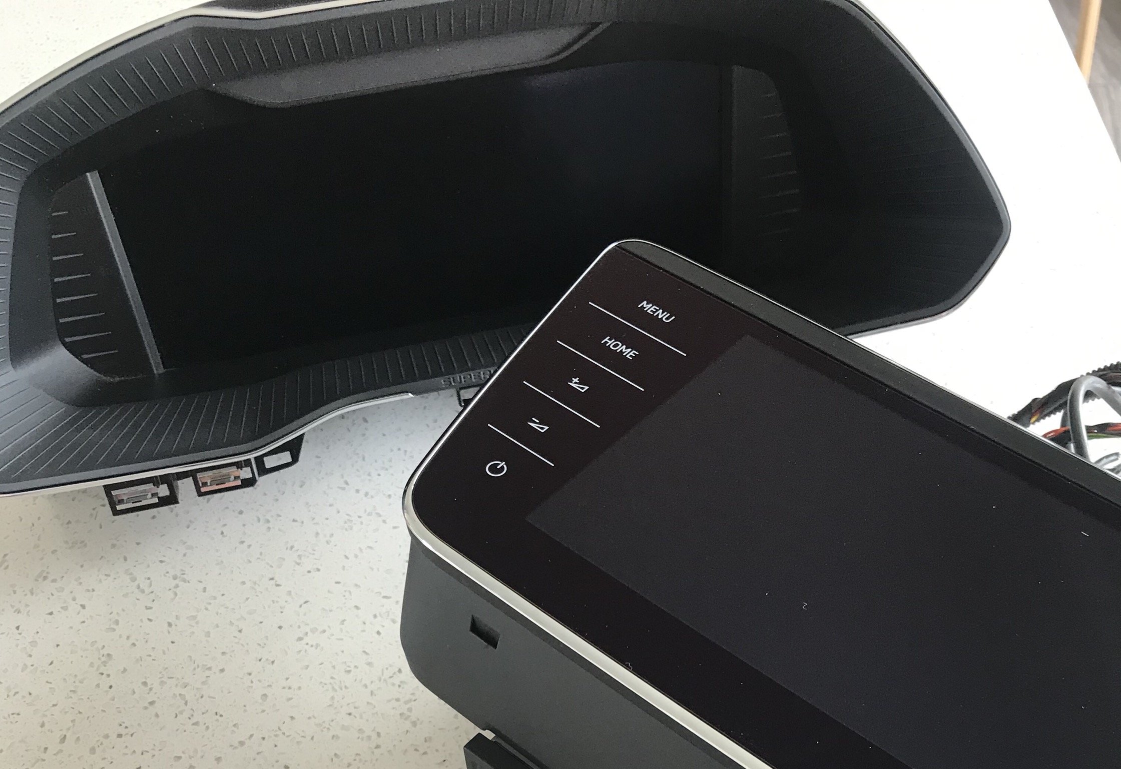

so this came today.

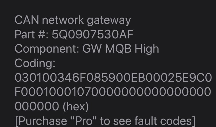

I’m still confused about the gateway is something I need to complete retrofit? How do I check if I have the correct gateway.
Do a vcds scan, it will show wat CAN Gateway u have.
It's Address 19.
I'm sure urs will b High version like mine.

So it’s appears my CAN gateway is 5Q0.
Is it sufficient?

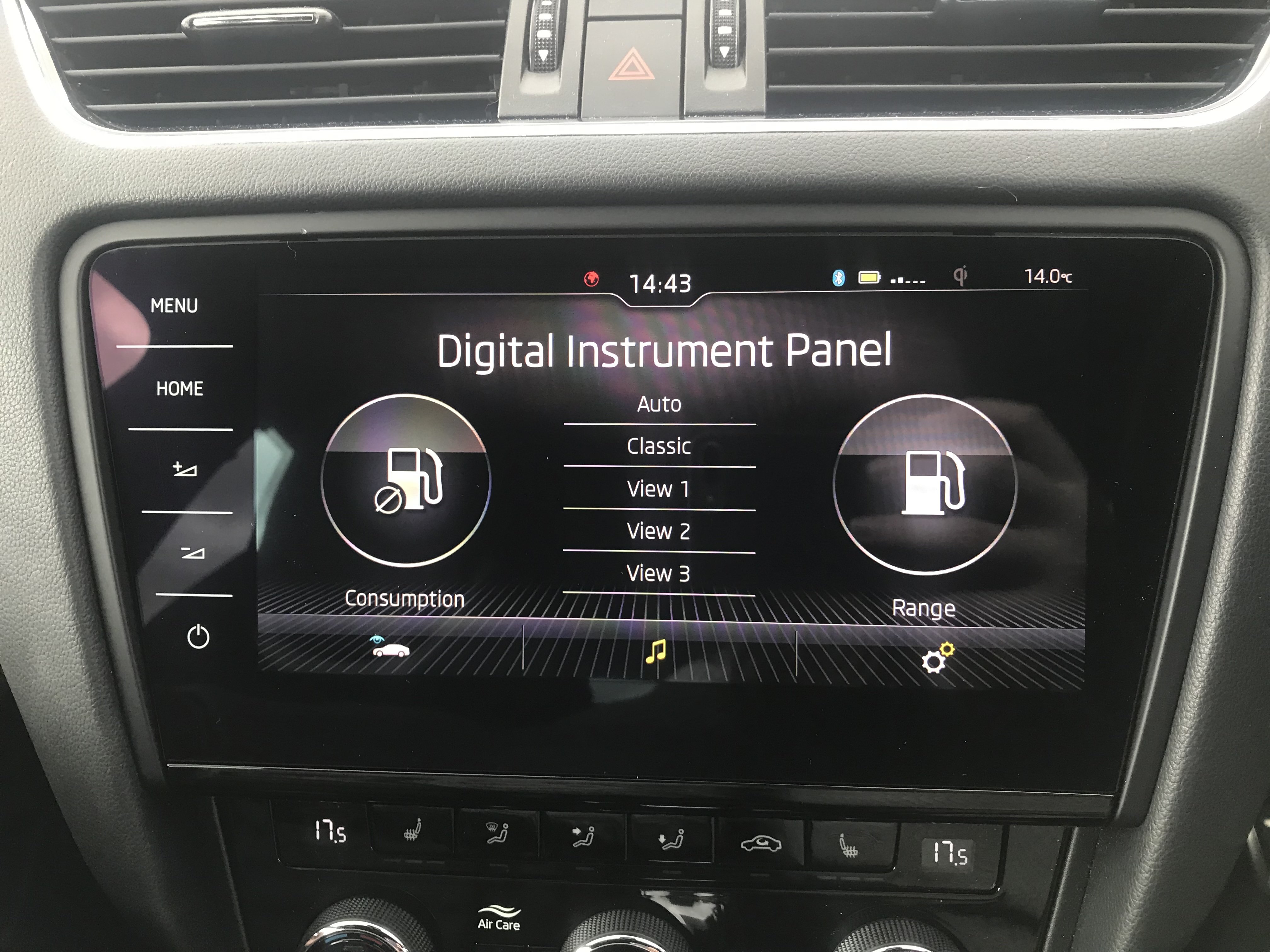

@SashaGrace is it possible to change the view without 3Q0 or do I just get to only use the standard view?
You can change the view but you won’t be able to get this tab to change the dial info.
Thank you. How do I change the view without the dedicated menu or button.
You press the OK button on the steering wheel, the right side scroll wheel. You can fit the steering wheel buttons with the VIEW button if needed.

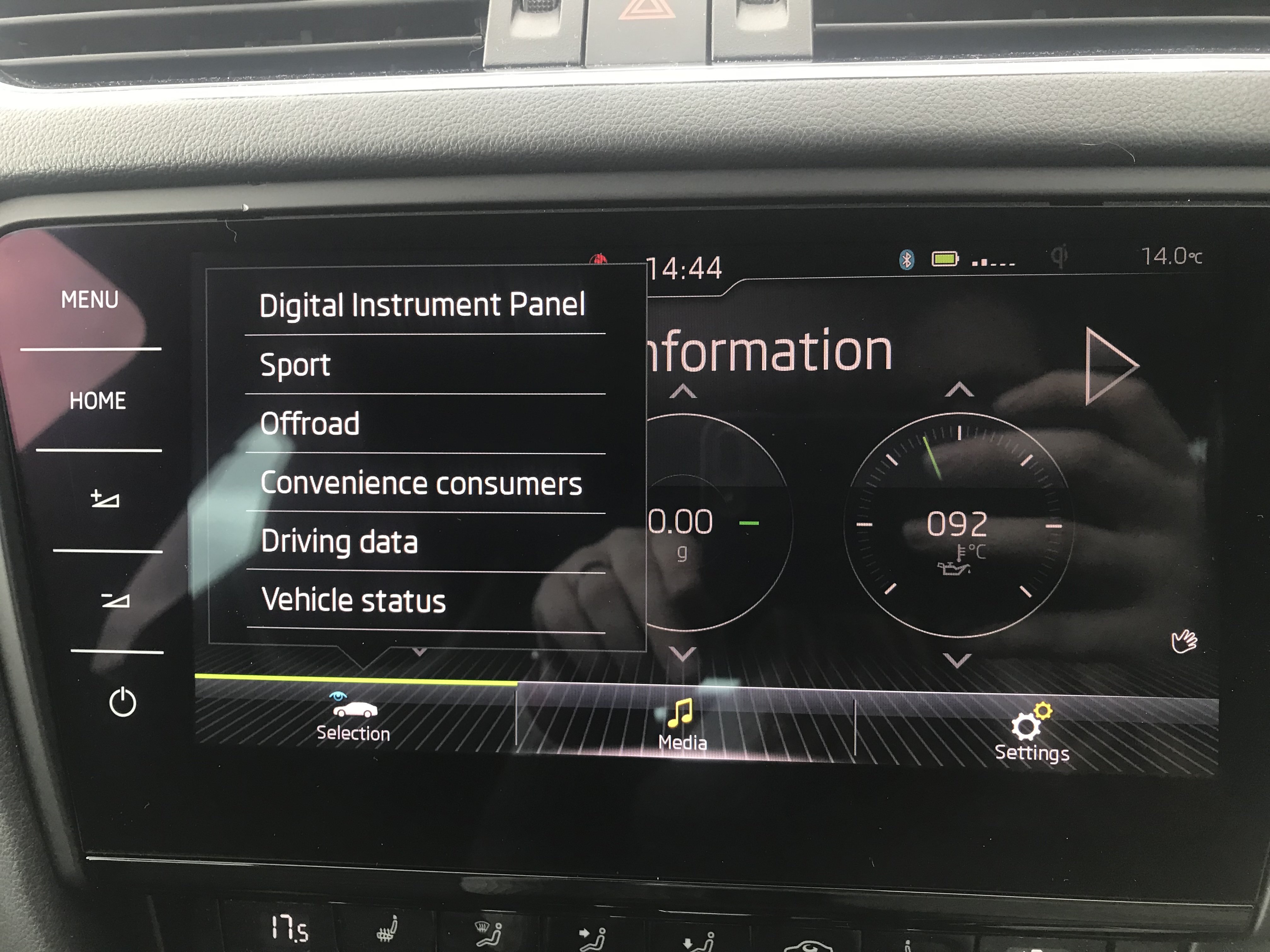

Hey guys, looking for some help, please.
I have recently retrofitted a VC to my Superb 2018, brand new one, coded by a guy with access to ODIS, succeeded to get the map view on the new VC, but I'm missing some things:
- the VC menu doesn't appear in the CAR/SELECTION menu
- the single speedo/rev meter option in the VC - is this the sport mode?
Can anybody help me with coding this? I have some previous experience with VCDS.

Hi let's try to activate this 2 items in 5f, then restart columbus. in my case it helps to get VC configuration in columbus
