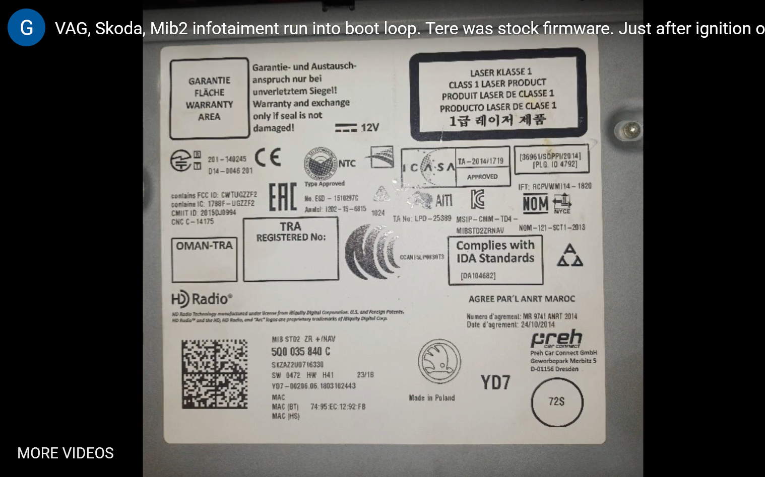

I've never pulled one apart like this before, I am still wondering what was reason yours was pulled apart.  So I can only assume you was trying to do something?
Believe me or not but nothing. No reason to lie. I was on a way to home and stopped for a lunch. An 1h later returned to car turned on ignition connect phone to start navi but it didn't boot correctly anymore.
In my opinion it can be connected somehow with mobile phone or something installed in the phone. Recently i installed waze navi instead of google maps i had used before.
There are some similar topics in the internet
https://support.google.com/androidauto/thread/18210685/skoda-head-unit-is-crashing-often-with-new-android-auto-while-music-playback?hl=en
https://www.vwvortex.com/threads/mib-ii-stuck-in-boot-loop.7478545/

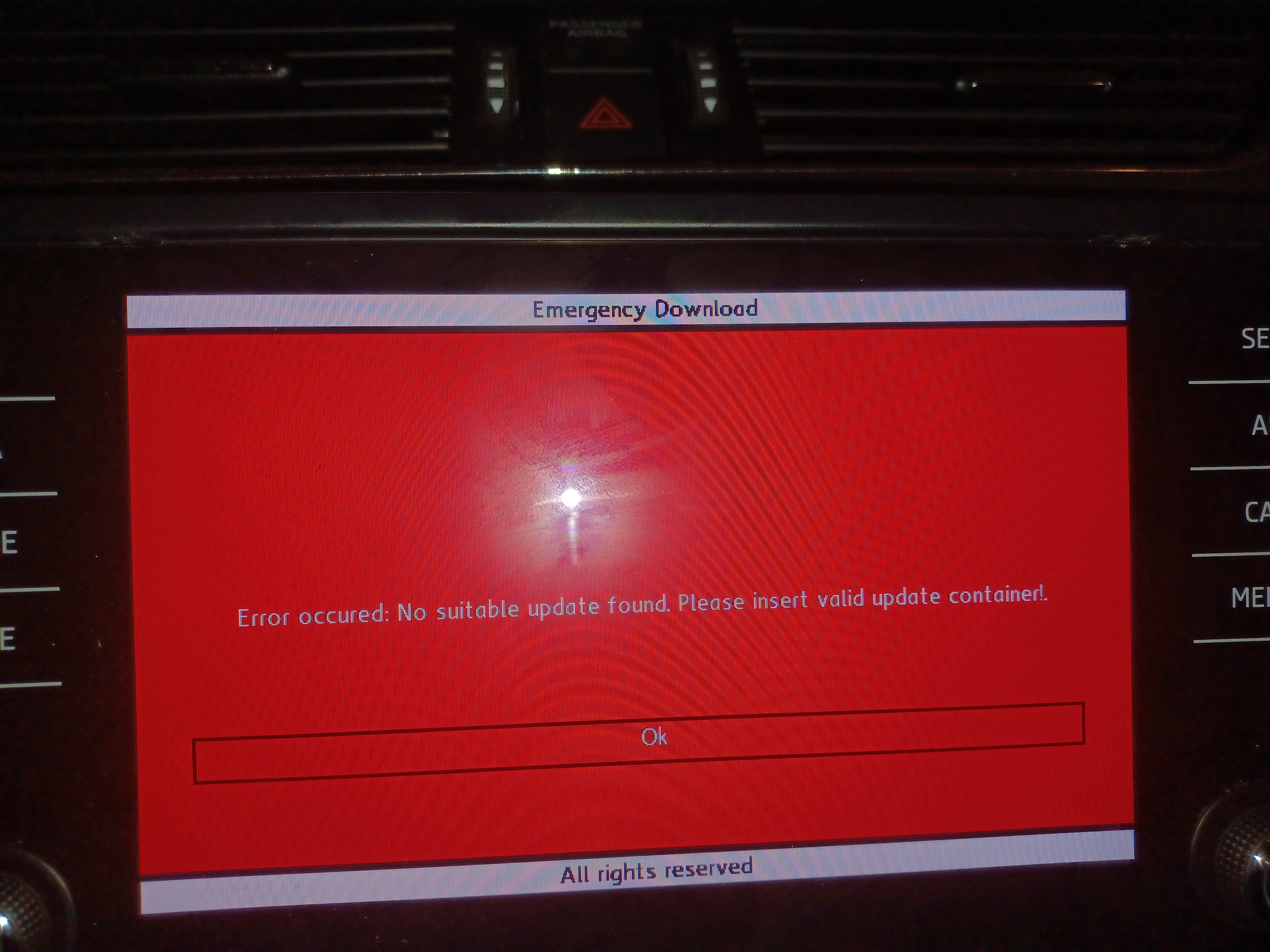

Hi @varooom
I tried emergency update with the file you have sent to me unpacked to sd card but unfortunately it didn't helped
Do yo maybe have different firmware for this unit ? Maybe i could try with stock one ?
Thanks,
12 minutes ago, sykora said:
Hi @varooom
Thanks,
Firmware is stock, just 0480 version, you might have been running 0472 version as seen in last few seconds of your video.
But the firmware 0472 or 0480 both contain emergency recovery.
Was the files unpacked to root folder of SD Card?

SOP4
Yes, files unpacked to root directory, sd card formatted with Fat 32. Tried tow different sd cards 32 and 64 Gb but no success

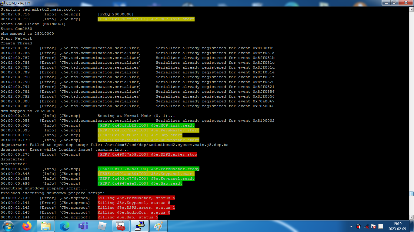

Below once again how the unit got crashed
The message was
dspstarter: Faild to open dsp image file: /net/imx6/tsd/dsp/tsd.mibstd2.system.main.j5.dsp.bs
dspstarter: Error while loading image! terminating...
And logs from update below. After screenshot

00:01:18.281     [Info] [cmsg.m30]      hwc: tsd.carcom.hwcontrol: AntennaDAB/Sirius.setState(): antenna switched on
00:01:18.282     [Info] [cmsg.m30]      hwc: tsd.carcom.hwcontrol: AntennaDAB/Sirius.setState(): antenna switched off
00:01:18.283     [Info] [cmsg.m30]      hwc: tsd.carcom.hwcontrol: AntennaDAB/Sirius.setState(): antenna switched on
00:01:18.283     [Info] [cmsg.m30]      hwc: tsd.carcom.hwcontrol: AntennaDAB/Sirius.setState(): antenna switched off
00:01:18.284     [Info] [cmsg.m30]      hwc: tsd.carcom.hwcontrol: AntennaGPS.setState(): antenna switched on
00:01:18.284     [Info] [cmsg.m30]      hwc: tsd.carcom.hwcontrol: AntennaGPS.setState(): antenna switched off
00:01:18.411     [Info] [mcproot]       Current UTC is: 1.1.1970 at: 00:01:18  utpime is: 0 days 00:00:18
00:01:19.281     [Info] [cmsg.m30]      hwc: tsd.carcom.hwcontrol: AntennaDAB/Sirius.setState(): antenna switched on
00:01:19.282     [Info] [cmsg.m30]      hwc: tsd.carcom.hwcontrol: AntennaDAB/Sirius.setState(): antenna switched off
00:01:19.283     [Info] [cmsg.m30]      hwc: tsd.carcom.hwcontrol: AntennaDAB/Sirius.setState(): antenna switched on
00:01:19.283     [Info] [cmsg.m30]      hwc: tsd.carcom.hwcontrol: AntennaDAB/Sirius.setState(): antenna switched off
00:01:19.284     [Info] [cmsg.m30]      hwc: tsd.carcom.hwcontrol: AntennaGPS.setState(): antenna switched on
00:01:19.284     [Info] [cmsg.m30]      hwc: tsd.carcom.hwcontrol: AntennaGPS.setState(): antenna switched off
00:01:19.286     [Info] [cmsg.m30]      persist: MotorState: normal, voltage (p1), temperature (p2), speed (p3) p1: 85 p2: 10 p3: 0
00:01:19.488     [Info] [cmsg.m30]      watchdog: Watchdog State: Running/Active/GActive:  p1: 21a p2: 21a p3: fff
00:01:19.489     [Info] [cmsg.m30]      watchdog: Watchdog State2: System/ReceiverProbs:  p1: 44020 p2: 0 p3: 0
00:01:20.281     [Info] [cmsg.m30]      hwc: tsd.carcom.hwcontrol: AntennaDAB/Sirius.setState(): antenna switched on
00:01:20.282     [Info] [cmsg.m30]      hwc: tsd.carcom.hwcontrol: AntennaDAB/Sirius.setState(): antenna switched off
00:01:20.283     [Info] [cmsg.m30]      hwc: tsd.carcom.hwcontrol: AntennaDAB/Sirius.setState(): antenna switched on
00:01:20.283     [Info] [cmsg.m30]      hwc: tsd.carcom.hwcontrol: AntennaDAB/Sirius.setState(): antenna switched off
00:01:20.284     [Info] [cmsg.m30]      hwc: tsd.carcom.hwcontrol: AntennaGPS.setState(): antenna switched on
00:01:20.284     [Info] [cmsg.m30]      hwc: tsd.carcom.hwcontrol: AntennaGPS.setState(): antenna switched off
00:01:21.229     [Warn] [mcproot]       Invalid i.MX watchdog response: 1659028 (expected 16839)
00:01:21.281     [Info] [cmsg.m30]      hwc: tsd.carcom.hwcontrol: AntennaDAB/Sirius.setState(): antenna switched on
00:01:21.281     [Info] [cmsg.m30]      hwc: tsd.carcom.hwcontrol: AntennaDAB/Sirius.setState(): antenna switched off
00:01:21.283     [Info] [cmsg.m30]      hwc: tsd.carcom.hwcontrol: AntennaDAB/Sirius.setState(): antenna switched on
00:01:21.283     [Info] [cmsg.m30]      hwc: tsd.carcom.hwcontrol: AntennaDAB/Sirius.setState(): antenna switched off
00:01:21.284     [Info] [cmsg.m30]      hwc: tsd.carcom.hwcontrol: AntennaGPS.setState(): antenna switched on
00:01:21.284     [Info] [cmsg.m30]      hwc: tsd.carcom.hwcontrol: AntennaGPS.setState(): antenna switched off
00:01:22.281     [Info] [cmsg.m30]      hwc: tsd.carcom.hwcontrol: AntennaDAB/Sirius.setState(): antenna switched on
00:01:22.282     [Info] [cmsg.m30]      hwc: tsd.carcom.hwcontrol: AntennaDAB/Sirius.setState(): antenna switched off
00:01:22.283     [Info] [cmsg.m30]      hwc: tsd.carcom.hwcontrol: AntennaDAB/Sirius.setState(): antenna switched on
00:01:22.283     [Info] [cmsg.m30]      hwc: tsd.carcom.hwcontrol: AntennaDAB/Sirius.setState(): antenna switched off
00:01:22.284     [Info] [cmsg.m30]      hwc: tsd.carcom.hwcontrol: AntennaGPS.setState(): antenna switched on
00:01:22.284     [Info] [cmsg.m30]      hwc: tsd.carcom.hwcontrol: AntennaGPS.setState(): antenna switched off
00:01:23.281     [Info] [cmsg.m30]      hwc: tsd.carcom.hwcontrol: AntennaDAB/Sirius.setState(): antenna switched on
00:01:23.282     [Info] [cmsg.m30]      hwc: tsd.carcom.hwcontrol: AntennaDAB/Sirius.setState(): antenna switched off
00:01:23.283     [Info] [cmsg.m30]      hwc: tsd.carcom.hwcontrol: AntennaDAB/Sirius.setState(): antenna switched on
00:01:23.283     [Info] [cmsg.m30]      hwc: tsd.carcom.hwcontrol: AntennaDAB/Sirius.setState(): antenna switched off
00:01:23.284     [Info] [cmsg.m30]      hwc: tsd.carcom.hwcontrol: AntennaGPS.setState(): antenna switched on
00:01:23.284     [Info] [cmsg.m30]      hwc: tsd.carcom.hwcontrol: AntennaGPS.setState(): antenna switched off
00:01:23.411     [Info] [mcproot]       Current UTC is: 1.1.1970 at: 00:01:23  utpime is: 0 days 00:00:23
Can you show screenshot of SD Card files and folders.
From what I can see you are doing it correctly, quadlock out, USB communication thing plugged in, and RX is connected to TX to enable two way Comms.
Then you short out the two pads on motherboard and push in quadlock, and in the terminal screen you select 2 for emergency recovery.  Then remove quadlock.
With SD Card in slot one only, you then insert quadlock and see the red EM screen, that then fails with above screenshot?
I have only one SD slot so no way to make mistake.

I was also beginning to think it's a hardware fault also seeing as you was able to get recovery emergency mode started.
First of all thank you for your support
Secondly I would be grateful if you could still answer few questions
1.  Is there anything else i can check with this hardware or I should look for new unit. I'm lack of further ideas what else can I do with current one
2. Is there anything interesting in logs that suggests the hardware is dead from point of view ? I see some errors but I don't know how serious they are.
3. If I bought another second had unit (new one will be quite expensive i guess) is it a big challenge to adopt it to the car and restore all functionalities of broken one ? I mean privately without passing it do dealer to do it.
BTW: The car is still quite fresh in my opinion (2018 and currently millage around 83kkm) and infotainment is one of the last think that I would expect to break. But.. strange things happens.

I will answer the best I can, I don't deal with the hardware side, just provide firmware updates.
1. As far as I can tell, you have done everything possible to load files from emergency recovery.
2. The fact that it cannot perform recovery, tells me it's a big fault with HW.
3. Dealer price is insane, even with 50% "goodwill" contribution (if lucky!). 2nd hand parts, will have CP, Component Protection, which has to be lifted to code into your car.  If the part is stolen, then it will be refused and you might loose the money.  Best choice is a breaker yard if you take removal keys to find the same 04xx firmware that was on yours.  Then you still might have issues coding at a main dealer, outright refusal.  An independent garage could be more forthcoming if they have ODIS online connection.

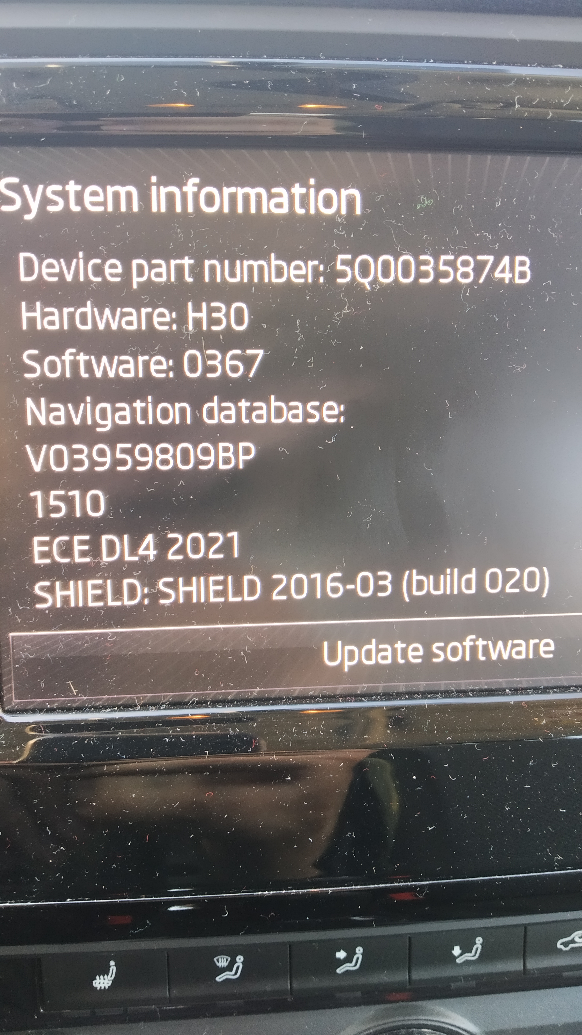

Hello! I have  a H30 MIB2 with MST2_EU_SK_ZR_P0367T. !
Can i please have the update
MST2_EU_SK_ZR_P0369T ?
