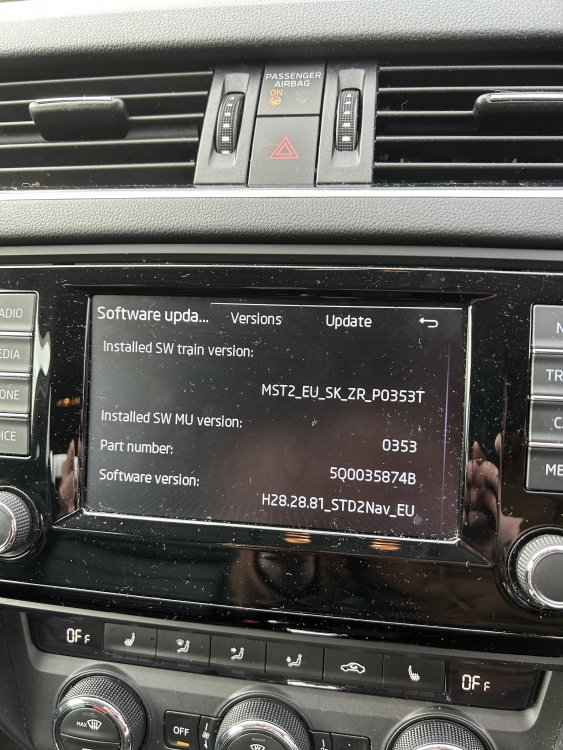

1 hour ago, Andrei1997 said:
Hi,
please someone can help me with an update file?
Also if anyone knows, on my unit carplay doesn’t work anymore with the last IOS…
Thank you a lot
There is update to 0369 version, not sure it will cure your problem.
You may also loose the FEC codes if they have been hacked into the system, won't know until you try update.

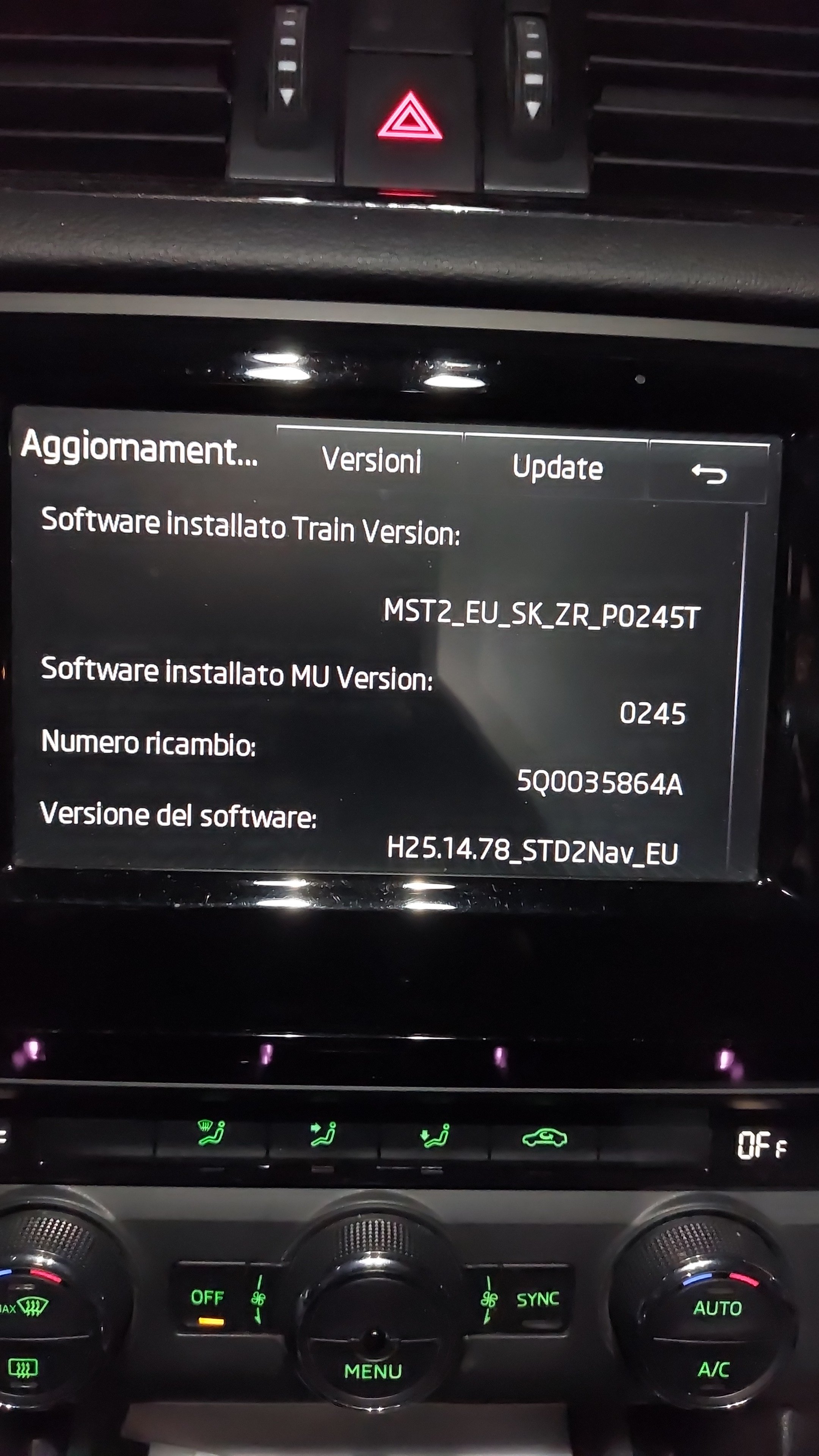

Hello,
I have a Skoda Yeti with a Amundsen it only have Mirrorlink and i hope to get Android Auto with a Firmware update.
Valid SWAP FEC codes are already installed.
Software Train is MST2EU_SK_PQ_P0245T
Part 5L0035680C Hardware H22
is it possible to update to 253T? or what is the latest possible Version?
can you provide me a download link?
4 minutes ago, OlsenOil said:
Hello,
Sent link, but don't expect miracles
I finaly did it,
update to 0253T was succesfull.
And Today I changed with OBD11
Module : 5F. (Information Control Unit)
Adaptation
Vehicle Configuration
Google_GAL=active
Apple_DIO = active
Now
MirrorLink
AQndroidAuto
AppleCarPlay
are availiable from SmartlinkMenu
Thanks Varoom
I finaly did it,
Adaptation
Google_GAL=active
Apple_DIO = active
Now
MirrorLink
AQndroidAuto
AppleCarPlay
Thanks Varoom
Nice work, and write up for others

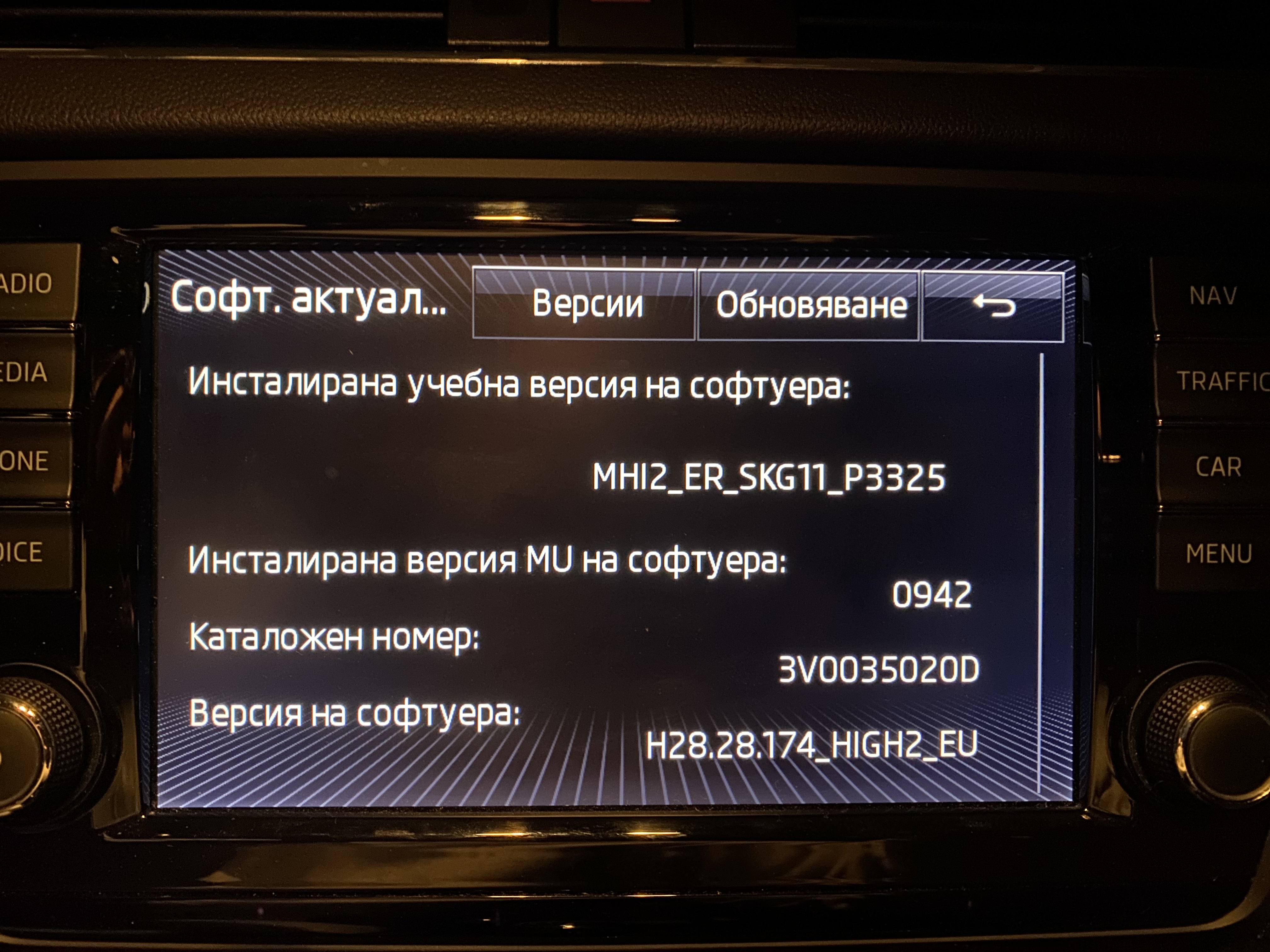

Hello,
can I get the update file for my MIB2 unit? Car is Octavia 2017 MK3 5E RS 4x4.
And also is there any kind of information what exactly its improved version after version? Should I update it only if I find some bugs/issues?
42 minutes ago, Nice_to_Mitio said:
Hello,
You can update to this
release = "MHI2_ER_SKG11_K3343"
MUVersion = "1433"
There are no release notes.
That's a bigger debate, there maybe fixes you won't see, but then after the whole system is more responsive, or if using bluetooth it's more stable.
Let me know if you wish to try update.
