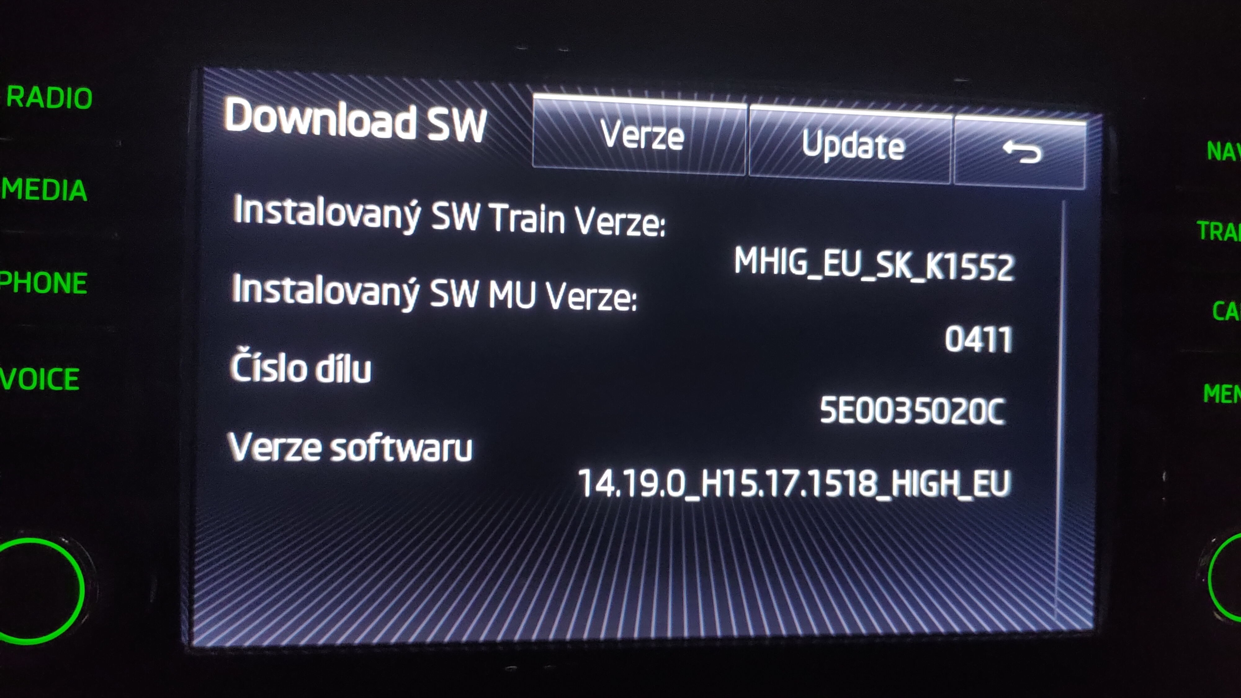

Hi @pab567Thank you for response
    3, I see
    5. Let's say main requirements is to stay with current screen. I would like to avoid replacing it. Are there any other OE numbers that will work with this screen ?
    7. No idea how much dealer will wish for this adaptation. But anyway do you have any step by step tutorials how to adopt such device to the car ?
Ad. 5. Bolero 5Q0035840x / 5Q0035842x / 565035840 / 565035842, Amundsen 5Q0035864x / 5Q0035874x / 565035864 / 565035874, Columbus MIB2 3V0035020x, 3V0035021x, 3V0035043x, 3V0035044x (x - any letter, for Bolero and Amundsen B or C).
Ad. 7. For official way you need VAS interface, ODIS and online account in SKODA systems.
@pab567
5. Thank you for the this list
7. I know that dealer can do this. But I'm rather asking if you know any step by step tutorials how to do this in unofficial way  ?
8. Are you able to activate such device maybe you are not so far away from me in Poland 😉

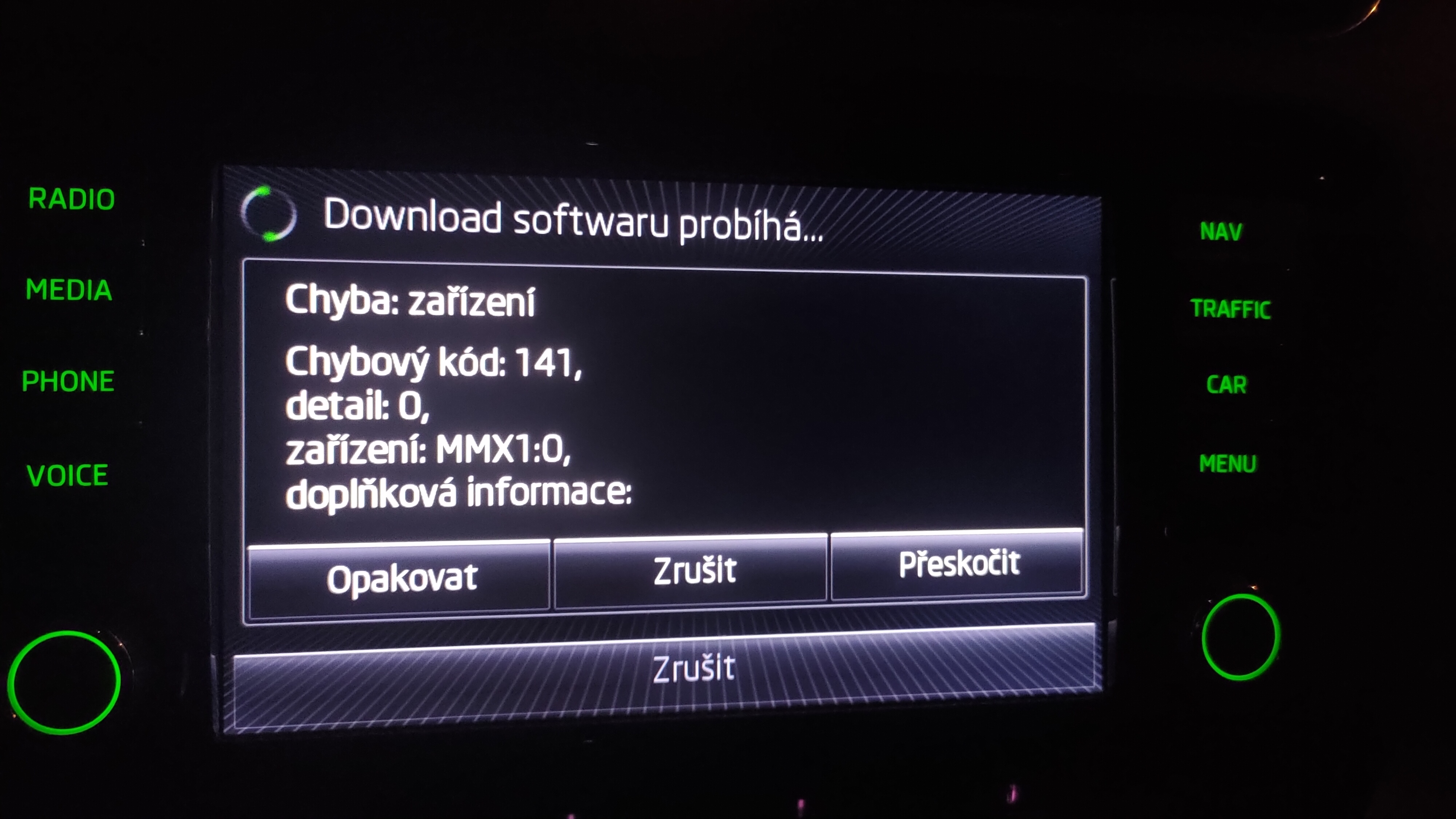

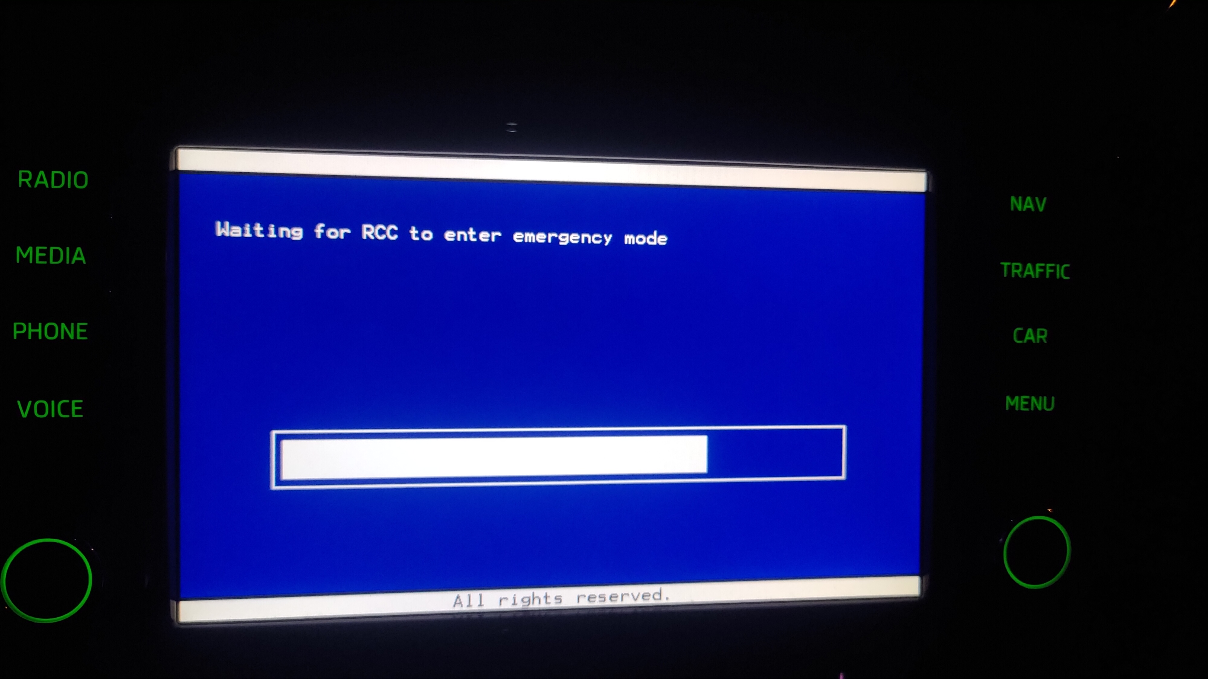

Hi friends...Im currently updating my infotainment in my car...and it showed me this warning...error: device...error code: detail: 0...device:MMX1:0...detail information

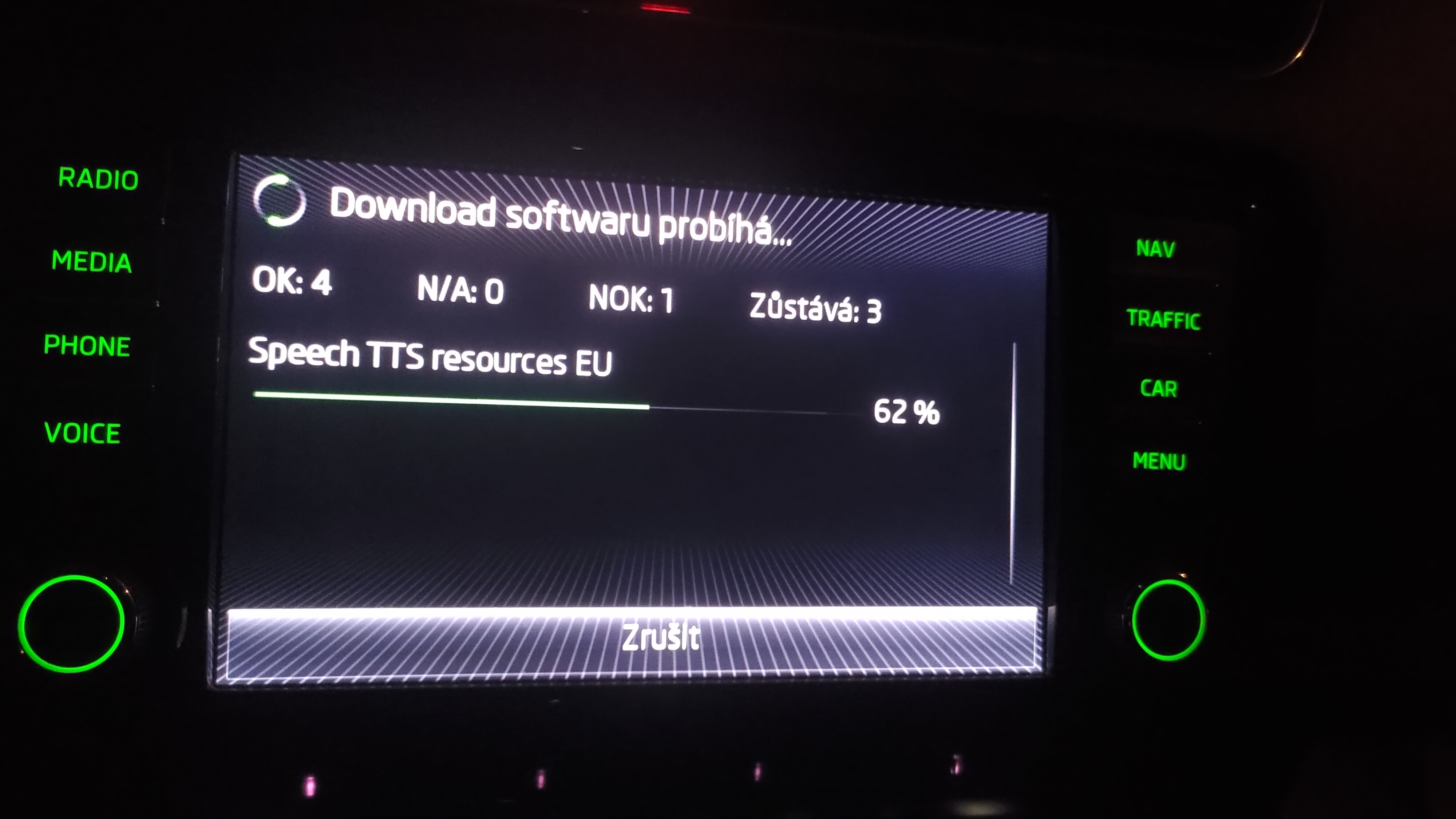

I choose repeat...but without succes...so I tried skip...and it is continuing next...but there is NOK:1 🤔😬. What I should do next with it? Please advice friends.
Now this😱😱😱. Help me please. I did all by instructions.
@pab567 This is a hardware fault question by looks of it?  Or they need to try different media perhaps.

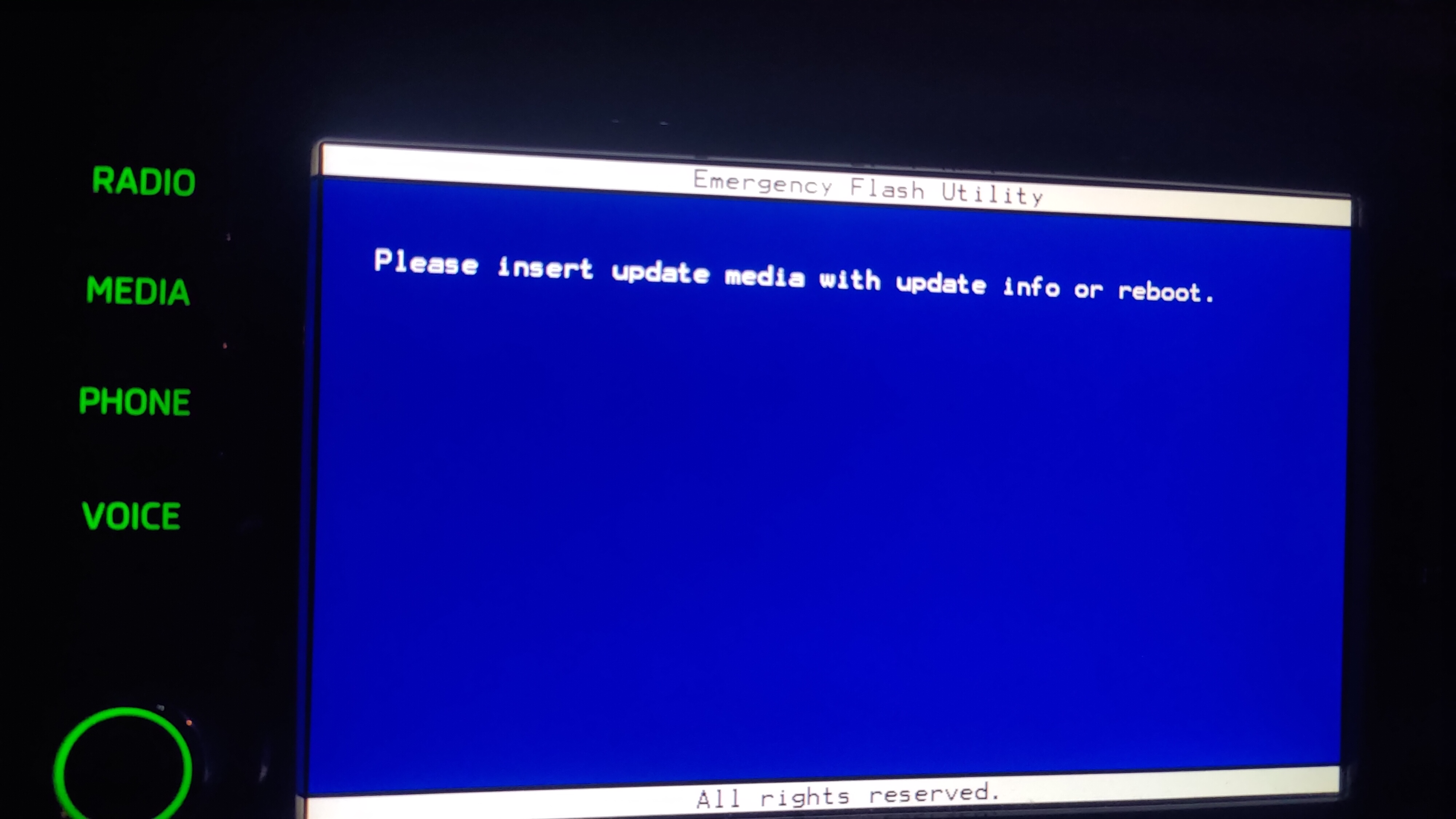

now what next😟
8 minutes ago, Maisner said:
now what next😟
You need to check the media for any bad sectors, or use another media if you have a spare.  Then try to put the data on there again from the download.
Yes I have original Skoda SD 8gb card I try to format it to FAT 32 and then copy there all files from this SD Kingston 32gb card.
Don't copy from Kingston, as you may just copy corruption, did you keep original file I sent?
Yes I have it at home in laptop...I can turn off engine on my car and lock it...or rather no?
It's already "crashed" to emergency mode, so yes engine off and head inside

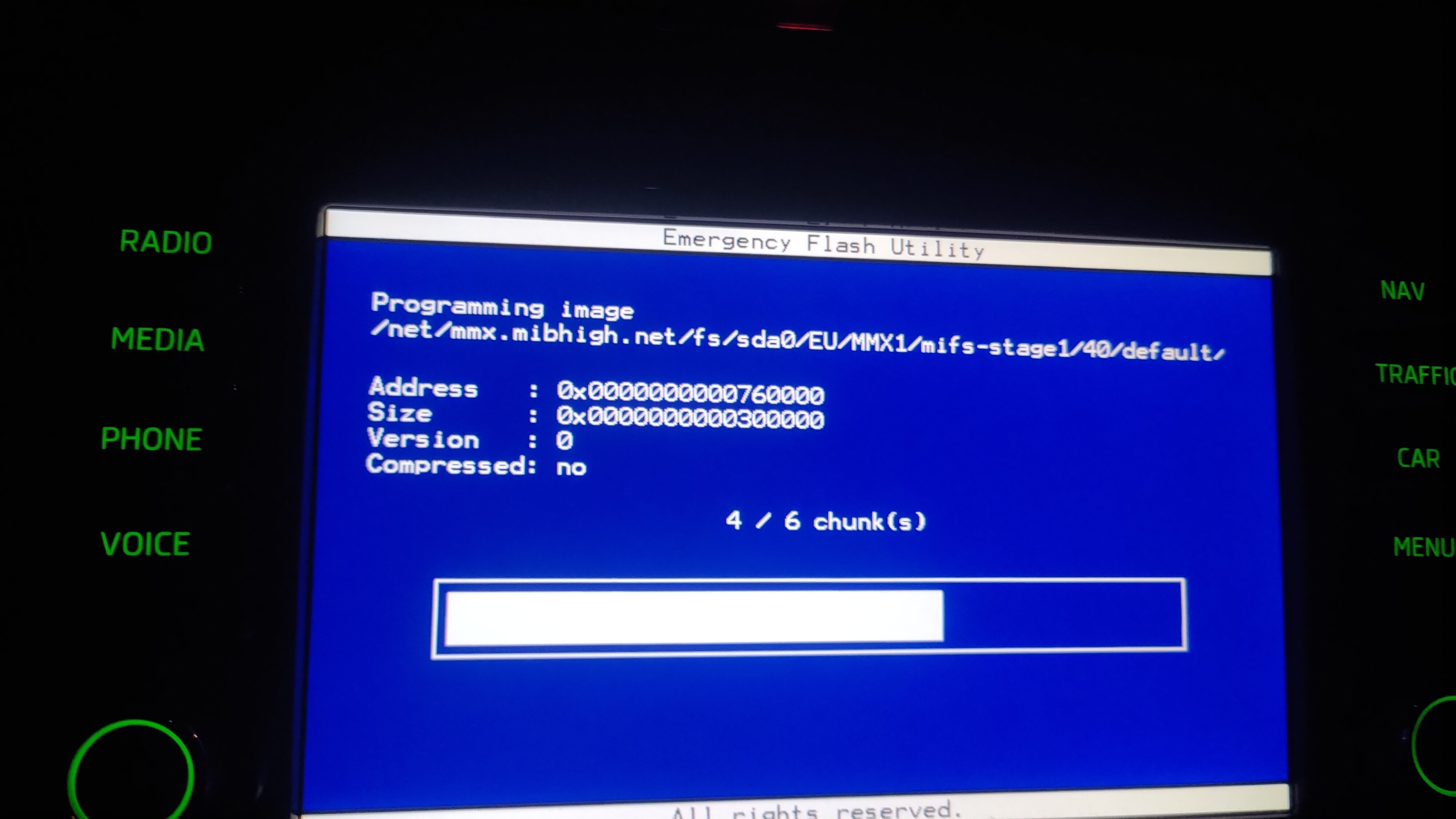

Now all is looking like in right😃. Thanks for some advices my friend👍...problem was mine probably with SD card or extracted files from your zip file in my laptop. All junks of MMX1 on sd0 were completely processed sucessfully😏.
Wow, we can breath oxygen once more!
Glad it got it working in the end for you 🤝
