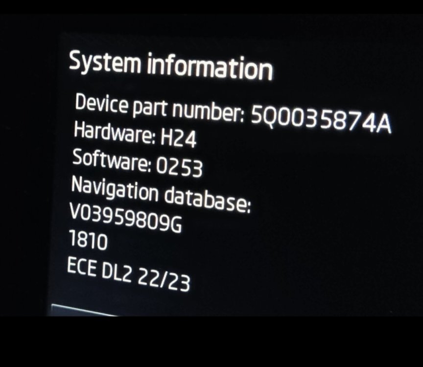

Hi I have tried many different cables and have connectivity issues with Android Auto although Apple Carplay is working good.
Could anyone tell me if there is any FW updates for my unit please?
You have latest firmware at 0253
Maps could be updated to 2010 (from your indicated 1810)

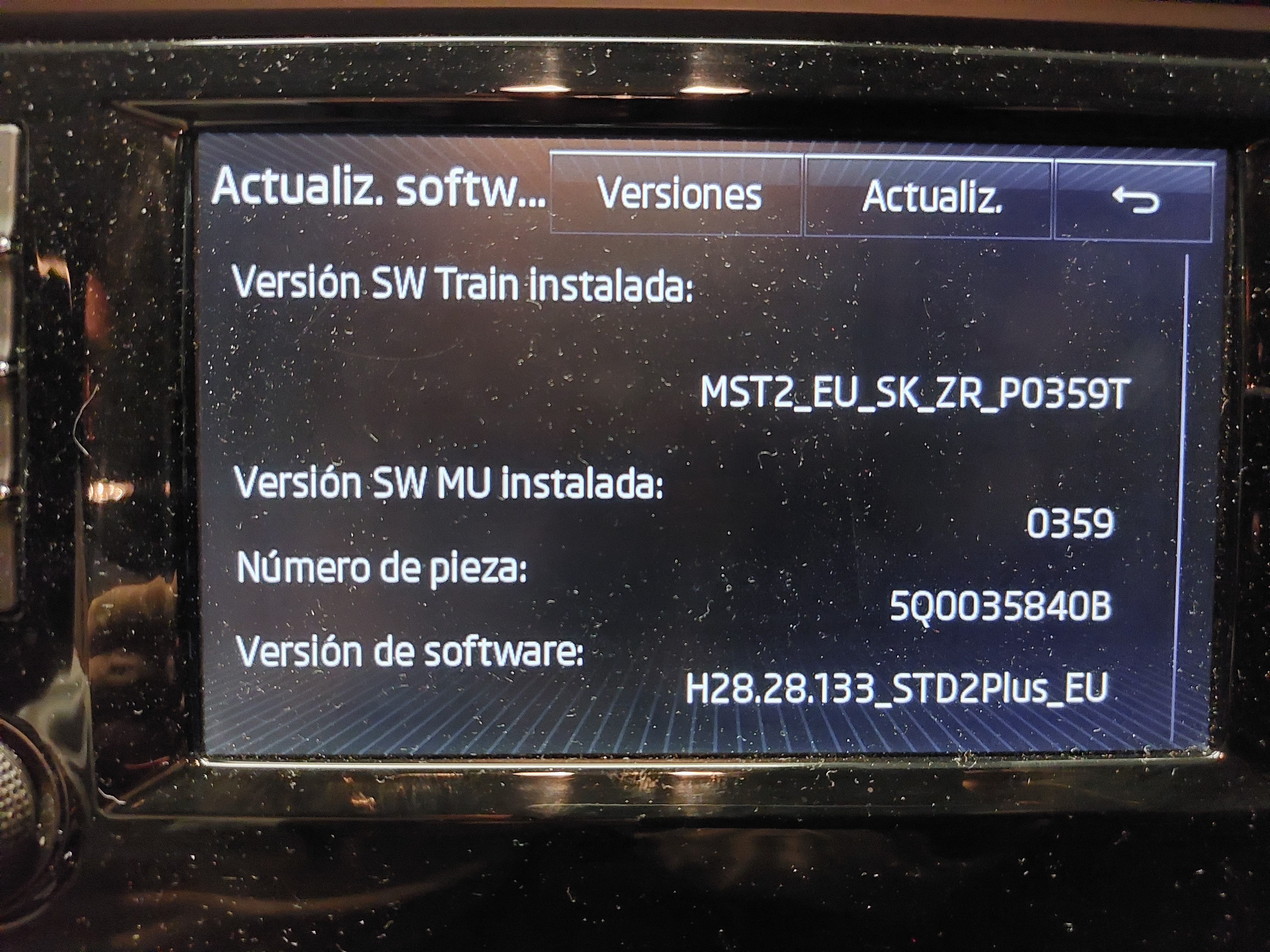

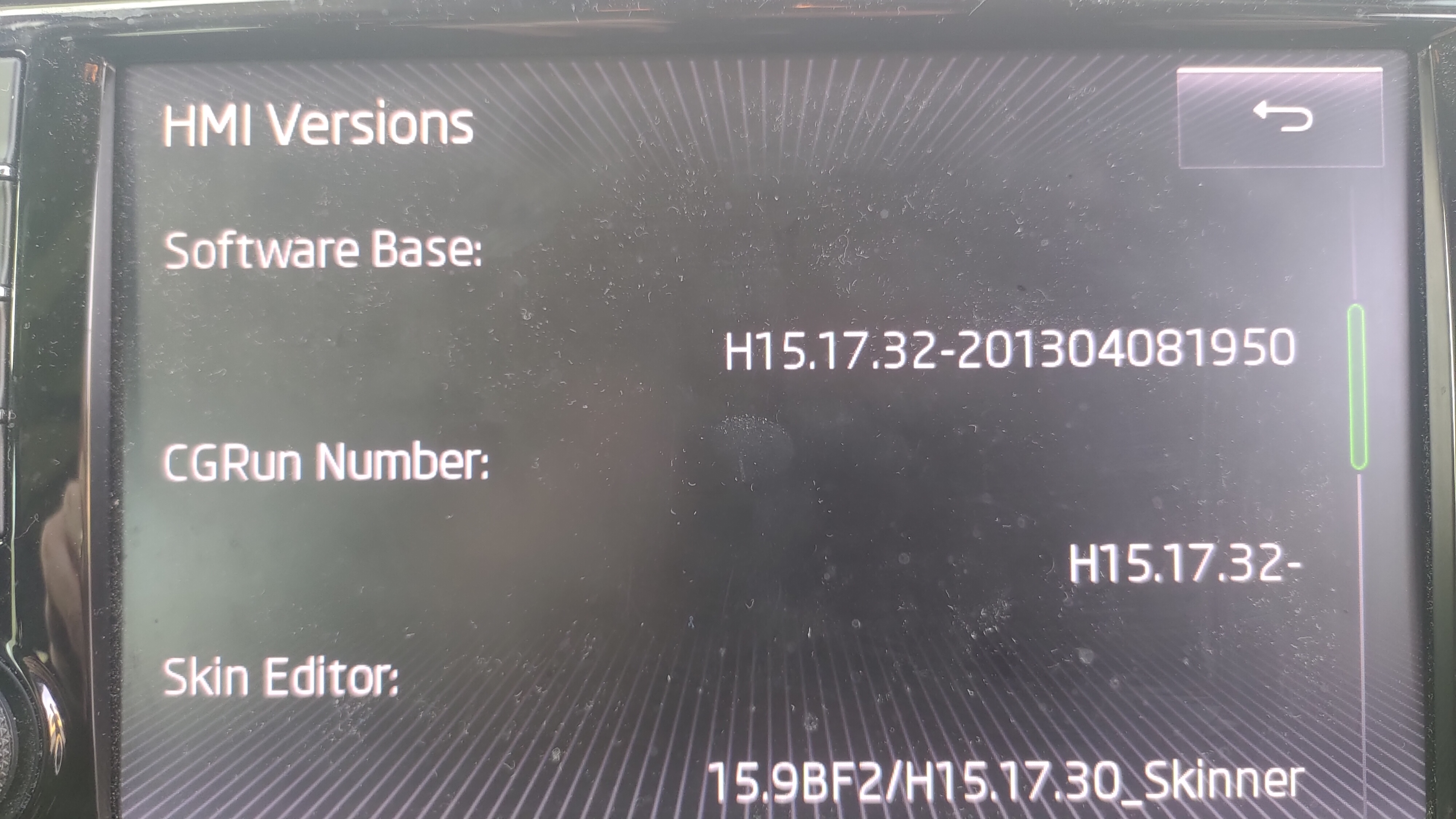

Hi! I'm new in the forum and I didn't found where to post about bolero update.
Where I can found the firmwares to Bolero and there are any post about what it change with the firmware.
Thanks to Varoom I get this picture of my unit.
Thanks
Thanks
/cdn-cgi/mirage/ca74ccc0c958c90dcfb1f2893c53ba68e43e63c06f0ba81c9f9acb2c1959ac8e/1280/https://www.briskoda.net/forums/uploads/monthly_2023_02/20230207_232755.thumb.jpg.407cb8a990704aaf99d37ec8827b96e7.jpg
I know a guy who can supply firmware 😁

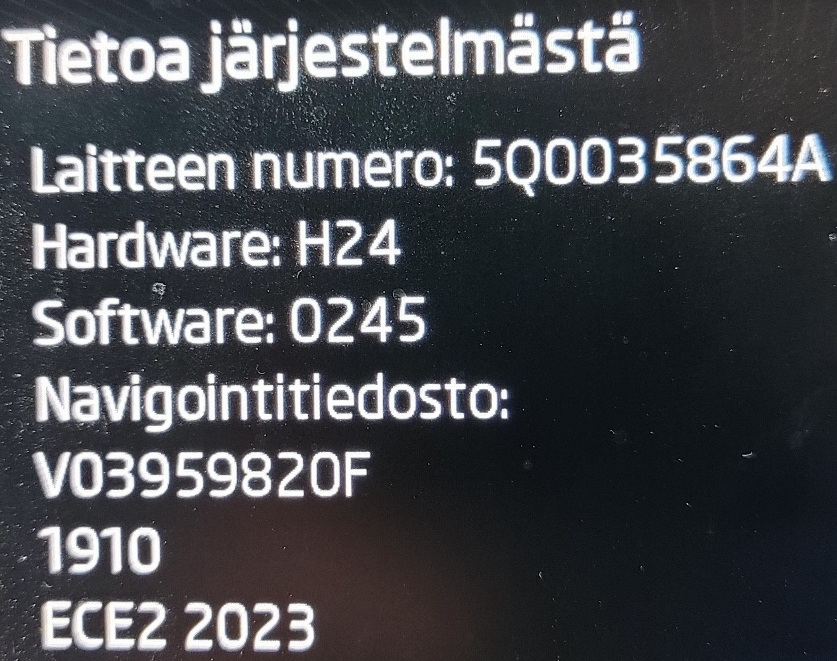

Hi, this is my first post on this forum.
I need new firmware for my Skoda Superb III Amudsen system.
Would you mind sending me the latest firmware release? Much appreciated

Hello, yes I can send you a new firmware to 0253 version
Also you can grab new maps from this post here...
You have "1910" and is available "2010" version

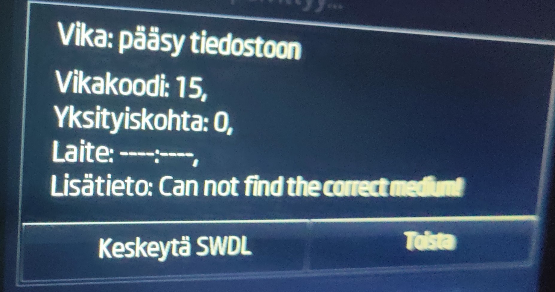

Now I have problem with installing the firmware. It starts, but after starting again there is error message which says, Error: cannot access file, Faultcode 15, Cannot find the correct medium.
Files are on USB stick which is FAT32 format.
Any advices?

I have same firmware in my car, I had to use SD Card, not USB to update firmware.

Does it has to be on official Skoda SD card or can I use any I do have?
Any card will work, brand not important

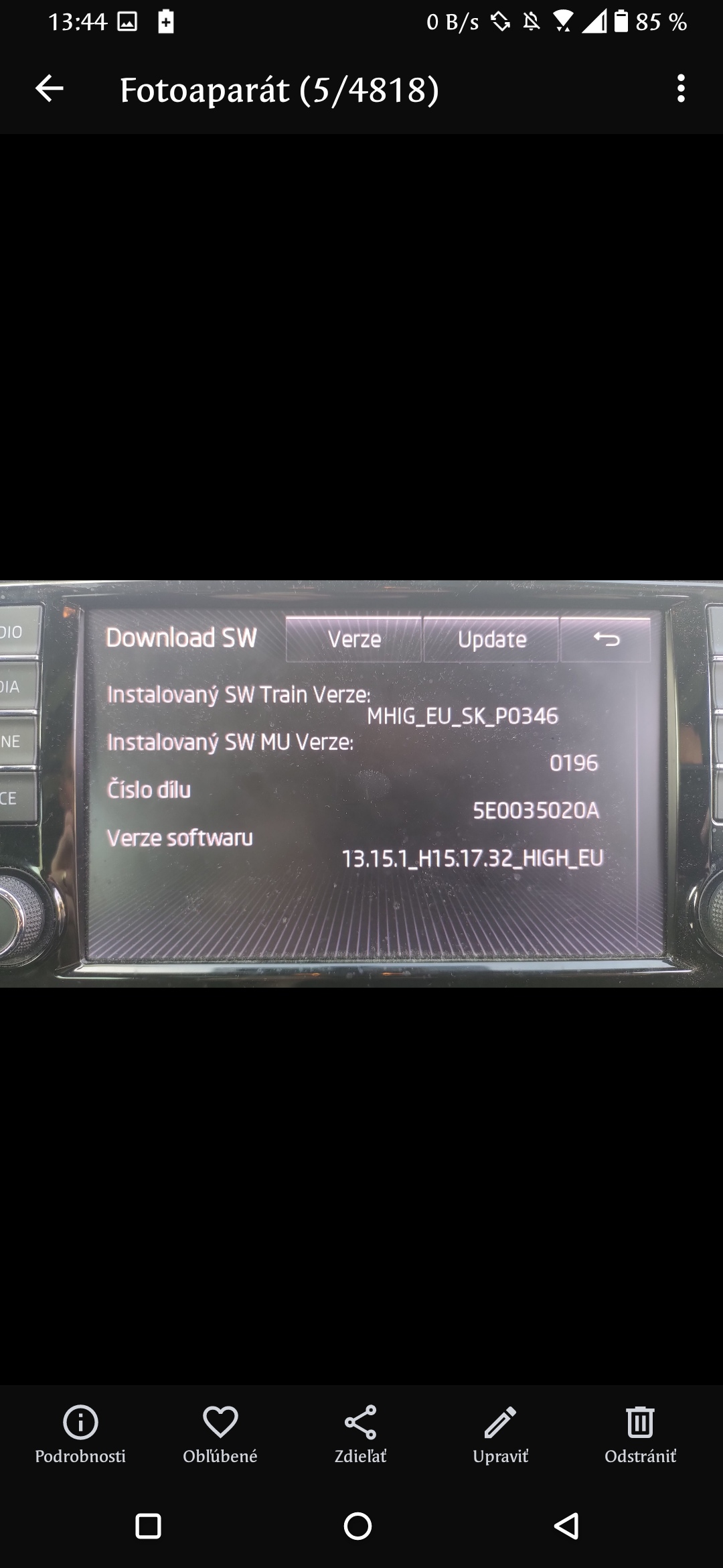

Good day friends. I would like to have a new version of my infotainment in my car Skoda Octavia III 1.6 tdi 77kw Greentec 11/2013. Thanks for help and sending the newest firmware to me🤝.
I shall send this via Private Message
MHIG_EU_SK_K1552
MU Version 0411

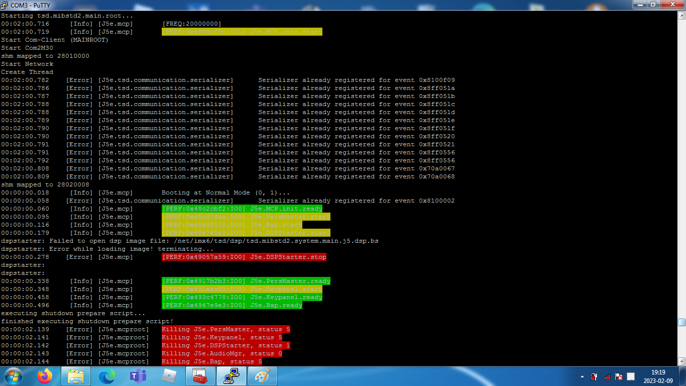

Hi  guys
I have a problem with my infotainment as it has run into some kind of boot loop. It's happened without any reason. Just after normal ignition on and connect Android Auto device with USB cable.
There was stock firmware no updates before etc. So obviously i don't have any firmware backup to restore. Maybe flashing the device with fresh firmware could help to repair it but i don't have any. I cannot also provide you what was installed before.
https://www.youtube.com/watch?v=9g83QmeuCJw
You are welcome with any advice how to proceed with this issue.
Thank you,

Do you think that those firmware you have sent will be possible to install in emergency mode ?
My device currently does not boot at all as you may have seen on video.

Not sure what you have done yet, but in theory it has a recovery process.  It happens when the SD Card is corrupted, it ends in red emergency screen.
Till now I've just manage to connect to the device with terminal. I haven't done anything more yet as shown on video i pasted. The device is now in kind of boot loop. Keeps restarts. It crashed suddenly during normal usage. Just ignition on and connect Android Auto phone with USB cable. And it crashed
Error log on the terminal shows:
Unable to open dsp image file: /net/imx6/tsd/dsp/tsd.mibstd2.system.main.j5.dsp.bs
Full procedure of emergency recovery is described on this video. Do you think it will work with files you have sent to me ?
One again thanks for help
