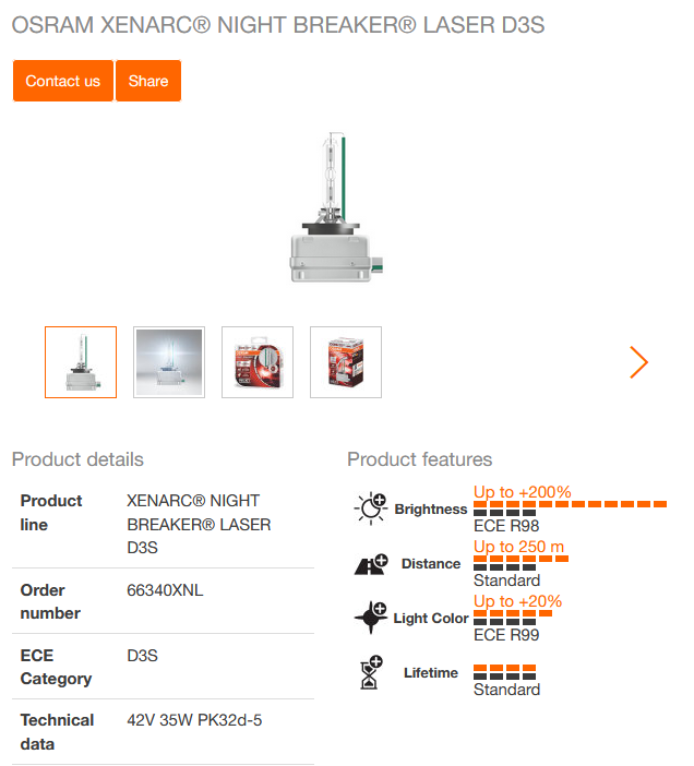

I will be replacing my HID D3S Bulbs with Osram Night Breaker Laser over the coming months.
I have seen a few reviews online and they appear to be the best all-rounder.
Thanks for the link to "How to replace" as that has come in handy already.
I actually had a quick look and mine appear to be Philips Bulbs that are the original fitment bulbs.
I have nothing wrong with mine and the aim is spot on, but as the car is nearing its 3yr service in May, I just thought I would get this done as I am looking to keep the car long-term...
