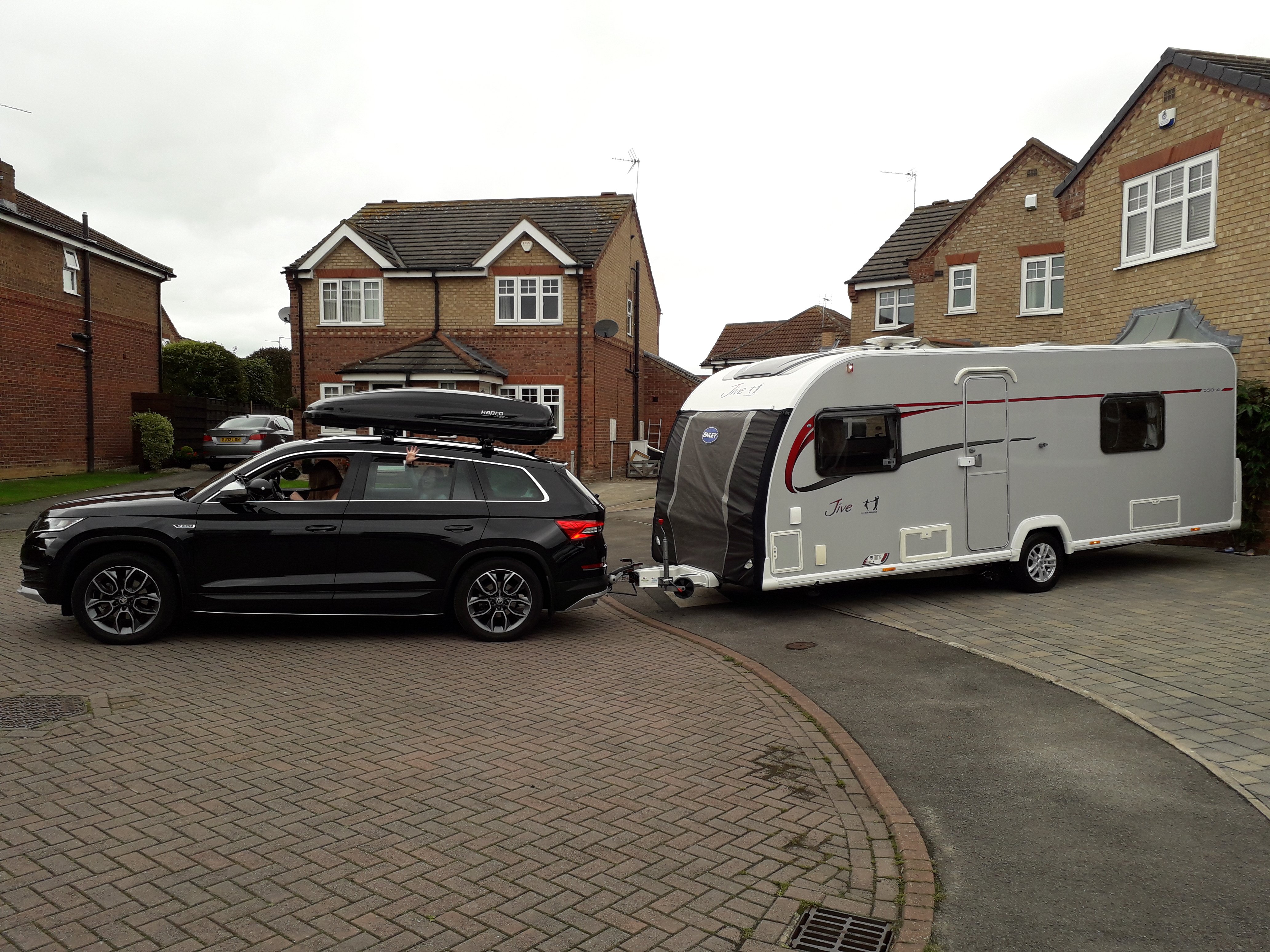

Towing a caravan/ Spring assisters
I ve got quite a heavy German Built caravan that my Superb Wagon 2.0 CRD 170  Pulls really well,  However the loading on the rear springs produces an Angle ( V ) Which looks quite bad and occasionally bottoms out the Caravan jockey wheel over speed humps e.t.c.
The rear springs aren't bottomed out and theres no wheel rub , it just looks a bit off when towing.

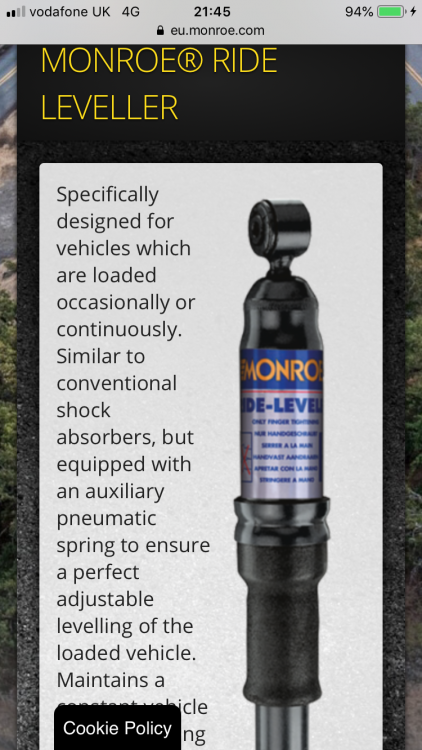

6C32D974-F739-4B43-8A1C-08654BED2565.thumb.png.819c1713c407d5afe711a969388a2140.pngI fitted these to my old Volvo years ago, brill bit of kit. Back end used to sag and catch like yours and looked awful, used to say to wife one day am gonna get stopped due to to looking well over loaded. but luckily fella up road had a Volvo with a caravan and it was him that put me on to them.
can get a compressor to go with them but that was very expensive so just used the one I had for blowing car tyres up with the valve in the boot area.

I installed these on my Dad's Volvo Estate 740 way back when - sorted a saggy bottom out especially when towing his caravan.  Don't think they are available except a few for "legacy" cars
