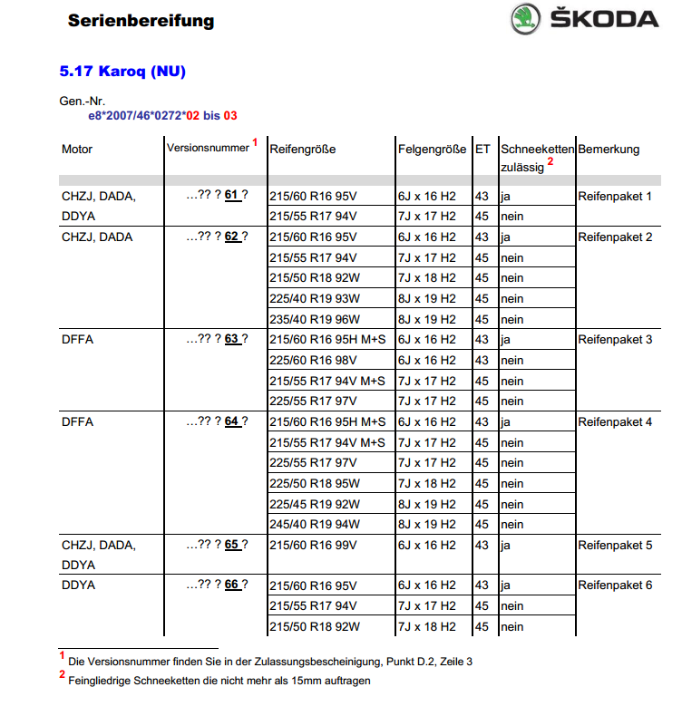

Without wishing to hijack the OP's thread but having an ongoing decision as to what to do with mine, I've seem this table before and it's really useful.... or it would be if I knew which Motor type the 190 TDI DSG was...! Any help appreciated!

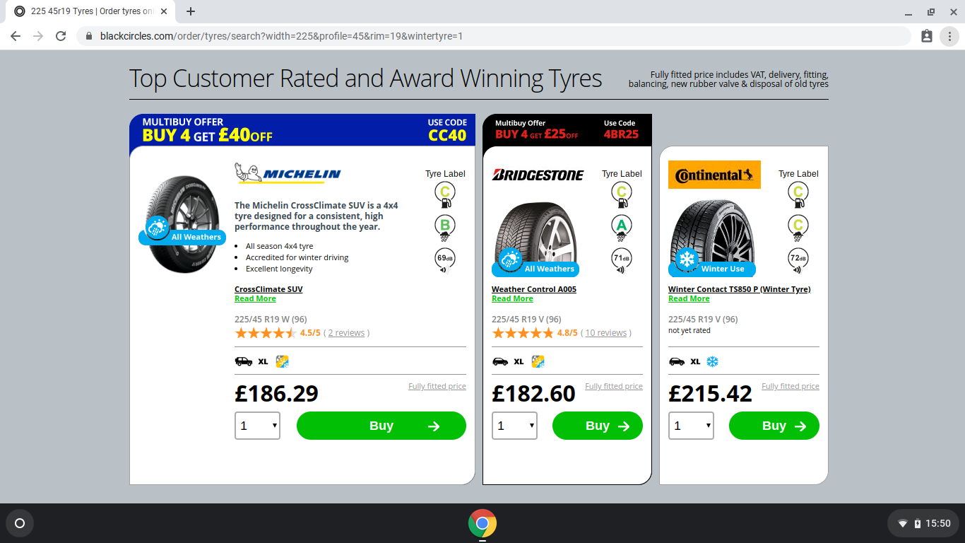

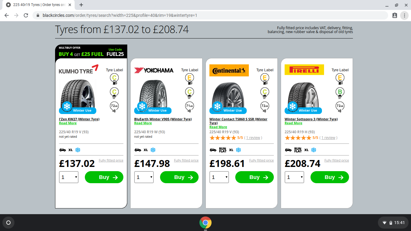

The Winter tyres available in 225/40 R 19 are perfectly good ones and really the profile means very little. 40% of 225mm is fine as a sidewall height unless going rock crawling.
On my continental Karoq 2019 the engine code is found on a label low down on the central 'B' right doorpost.
More tables for all Skoda models in the PDF that you can downoad from this site:
https://www.skoda-auto.de/service/serienbereifung

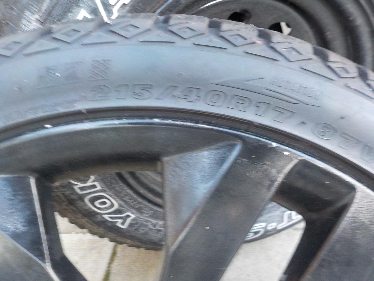

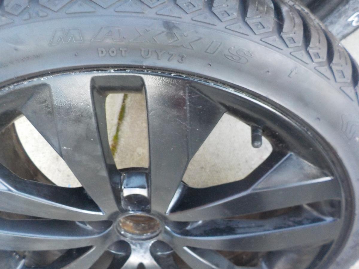

Hi Karock, this wasn’t/isn’t a sales pitch, but from the advice to date here and elsewhere it does seem I might be better to move the spare Annapurnas and tyres on and put the proceeds towards a set of winters for the Karoq. I’m currently looking at tyre size options.
I’ll be removing the winter wheels and tyres next Monday when I’ll photograph them. Basically there’s a set of 4 unmarked Annapurnas which I had powder coated last winter (they were polished/lacquered - which is not a lastingly durable finish and a set of Vredestein Wintrac Pro ( in the correct weight rating) which have at least 7mm of tread.
Let me have an email and I’ll send you pics early next week?
Where do you get your information from re: their effectiveness? or the profile means very little? Winter tyres on that size of wheel will not work to the same level as one with a 50 profile tyre. Winter tyres work due to their softer compound...  not a great combination on such low profile tyres.
The 225/40/19 winter tyres are about as popular as a fart in a spacesuit. How many All season tyres can you find in that size?

Just in the likes of Tyre Leader there will be a dozen Winter tyres showing in 225/40 R 19.
Only 7 All Season tyres right enough.
Anyone fitting them are not going to find them in that size if that is what they needed as being less effective as the 225/45 R 19.
