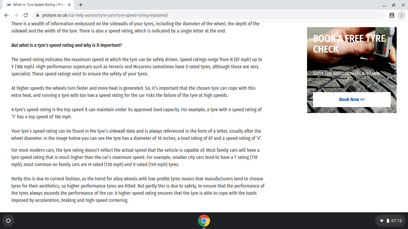

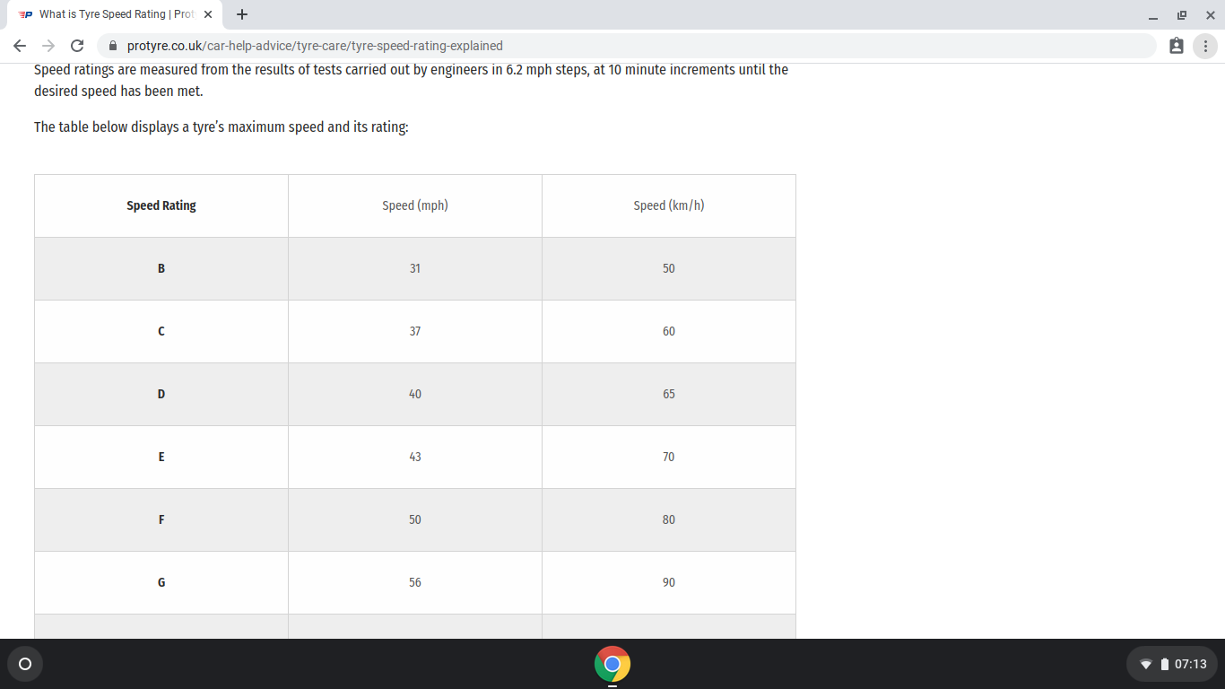

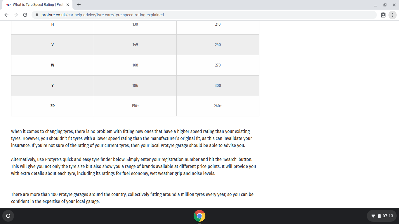

@Carlston   Some of your advice is dangerous.  It needs taken not with a pinch of salt but lots of thought over where you get your information.
Assumption can be the cause of the mother of all F**k-ups.
Speed and load rating and manufacturers guidelines are not just based on top / max speeds but on cornering forces.
