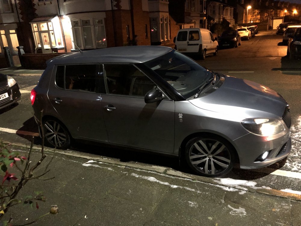

Hello everyone, am new here and wanted to know if there is anyone in the wirral area who can do vagcom mods on my fabia mk2 vrs, am after the kph digits speed turning to mph and maybe a few other bits tweaking ! Any ideas for mods would be appreciated.... thanks all !!
