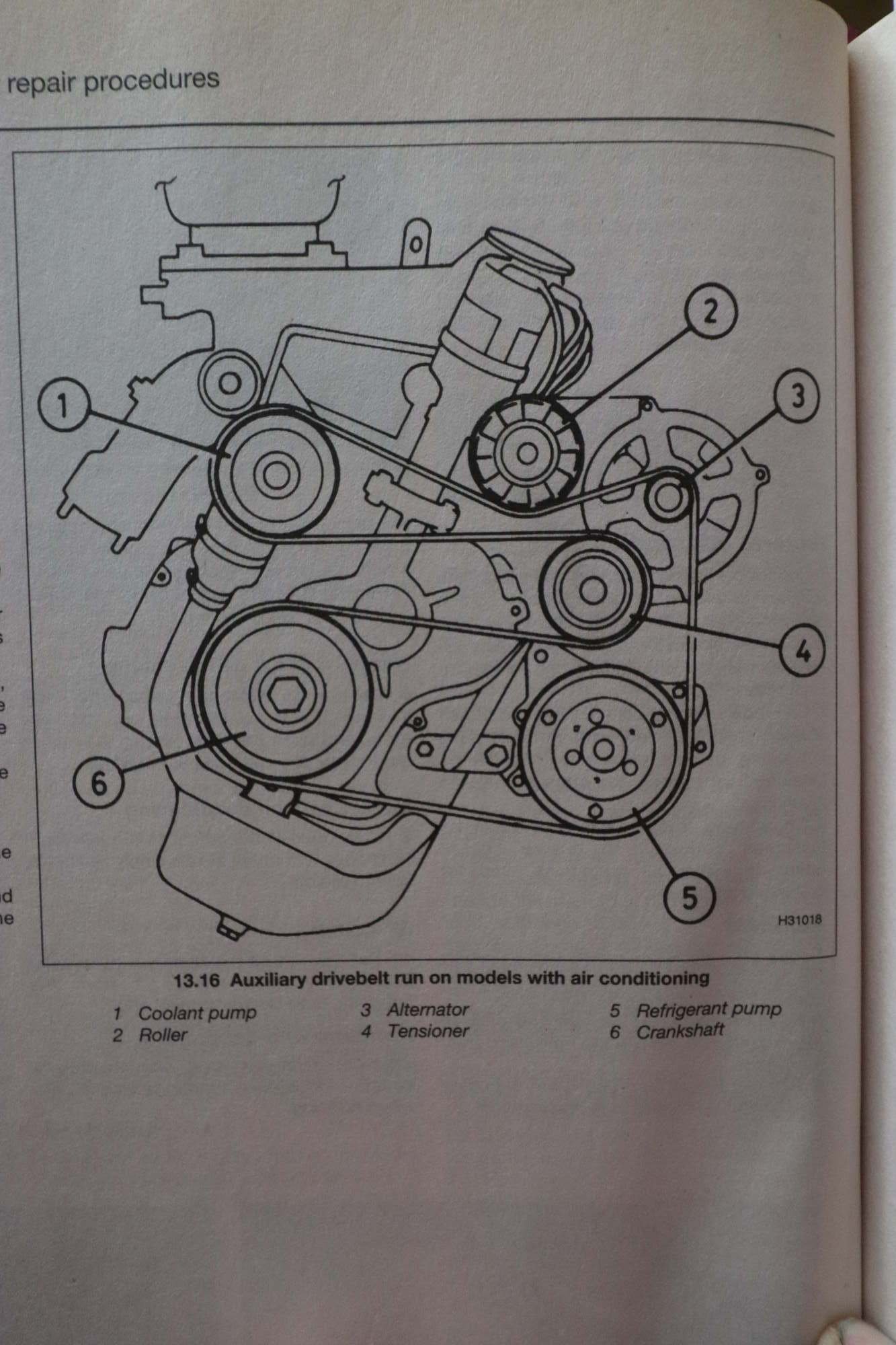

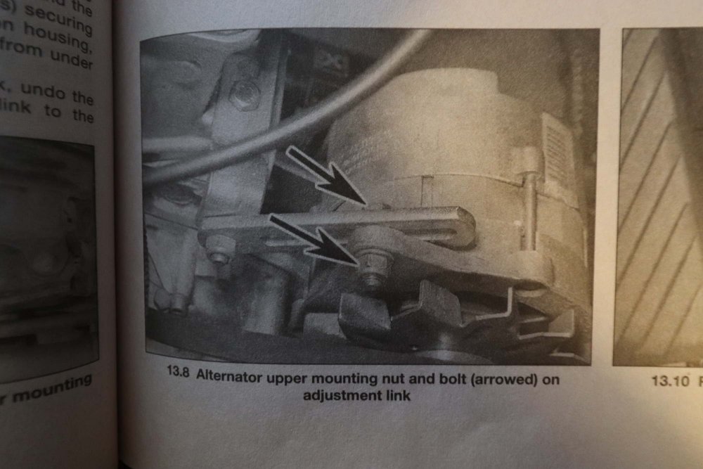

the alternator cannt be moved like on this picture img 3699a jpeg
but the drivebelt is not fitted like in the drawing in the next picture img 3698a
the drivebelt is over pulley 2, in my car
i see no way to release the tension on the drivebelt to remove the alternator
maybe i have to unbolt a pulley
but which pulley i can remove safely??
haynes gives no solution
Cut it off and you will soon see what was imparting the tension.
Normally its pulley 4 which is rotated by a spanner to release the tension, does your belt not run around that pulley?

read somewhere maybe release tension on pulley 4 with spanner

yeah pulley 4 is the variable one

the drivebelt scheme is as in the diagram above in my topic, except for pulley 2 over vs under
so ii go for using a spanner on pulley 4

i dont have that bracket in my car
uppermounting is a kinda clamp thru which the upperbolt goed
the lowerbolt is in a construction with powersteeringpump
but i go for a spanner on pulley 4

If it's a 1.6, pulley number 4 in the diagram is the tensioner. From dim and distant memory, I think you slip a long 16mm spanner behind the pulley to wind the tension off by pulling against the spring. You'll need a long spanner because that spring means business.

that nut from tensioner is located on the other end then the rest of the pulleys
direct under the sparkblock
