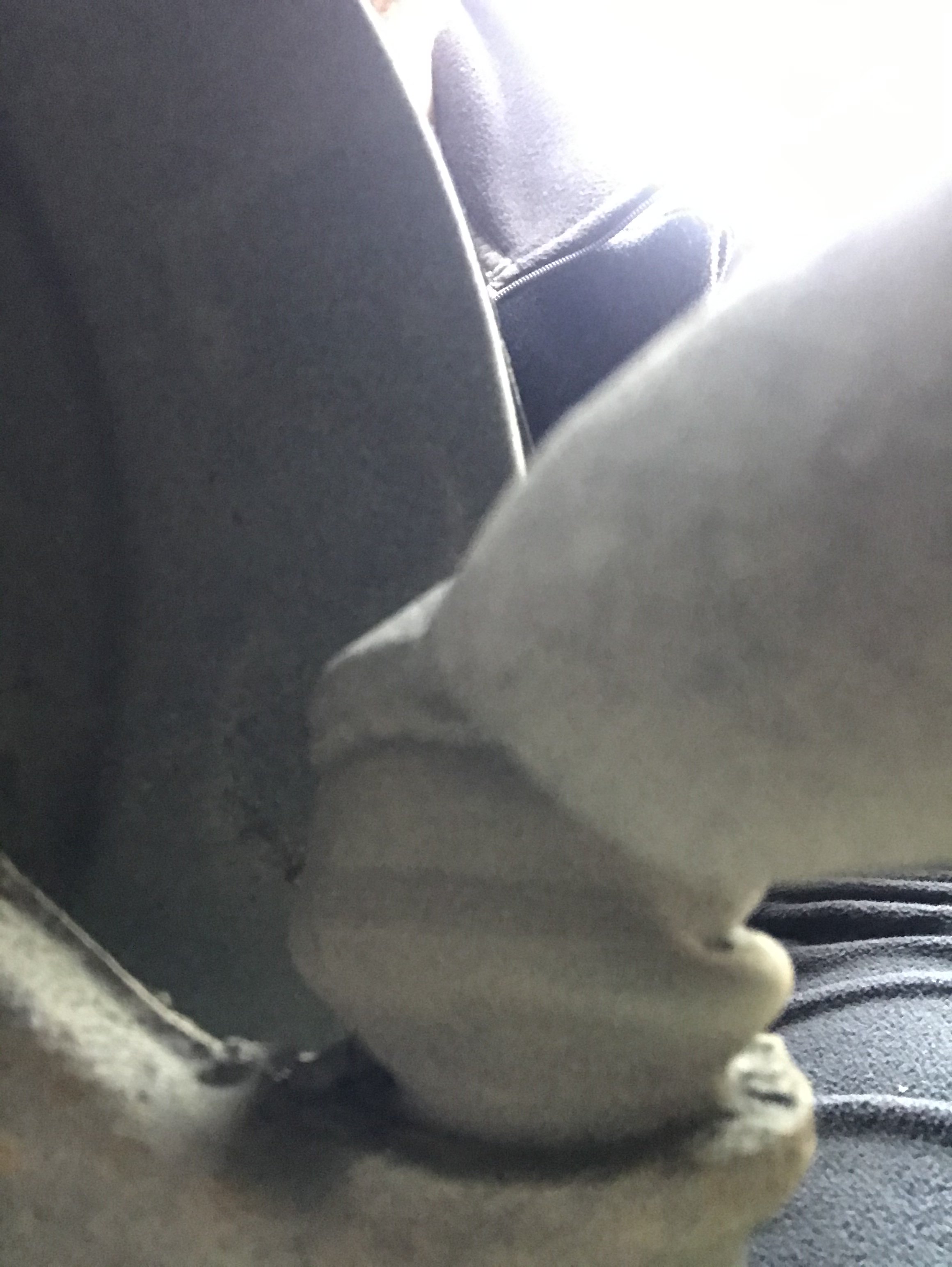

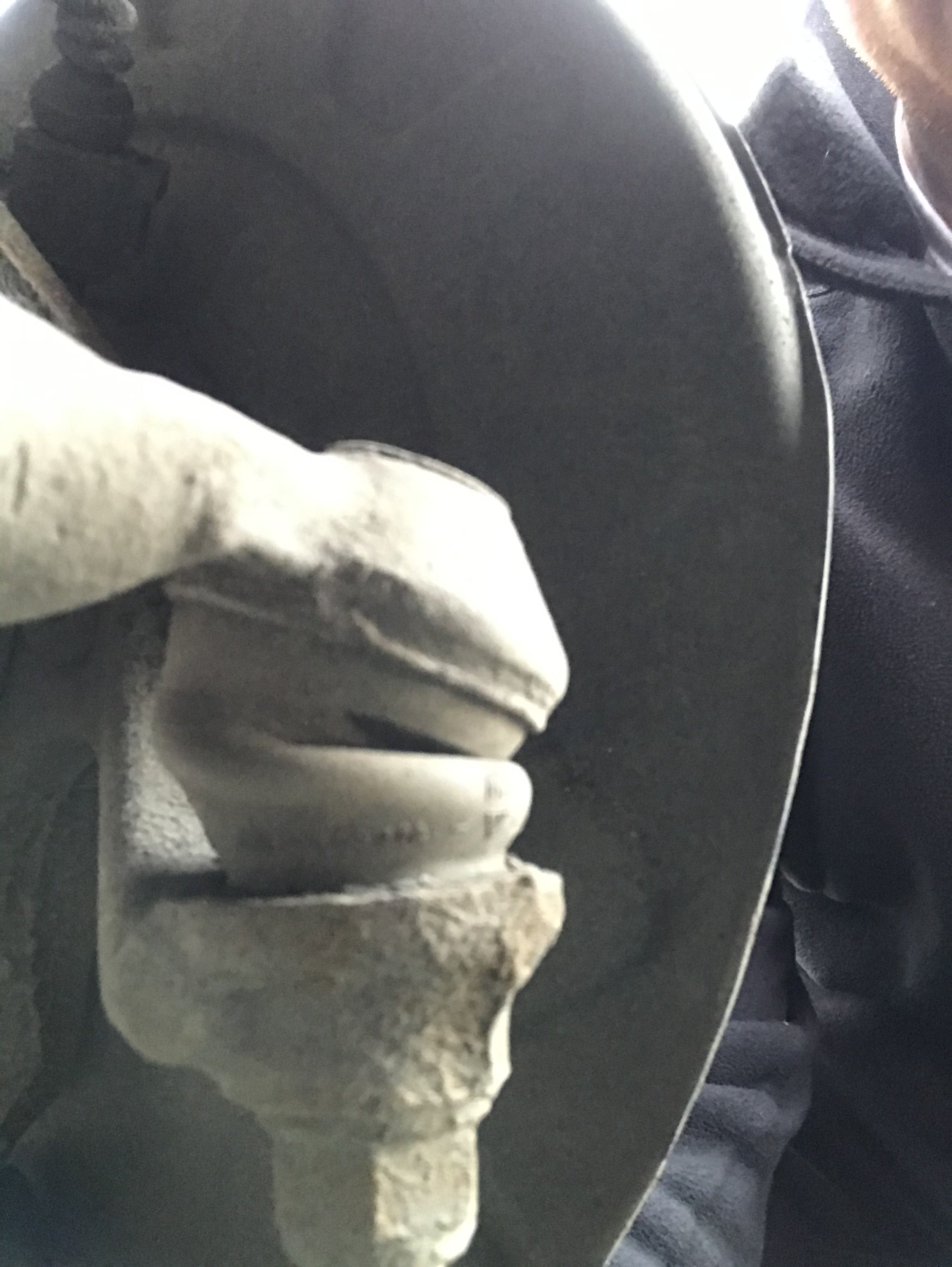

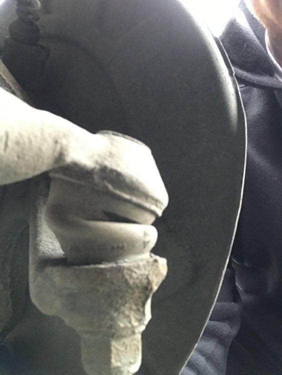

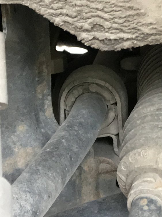

I’ve attached a picture of the anti roll bar bush and also the drop link bearing.
Both look fairly dry and the drop link bearing looks deformed?!
any thoughts on what you see?
I’ll have a look at the rear components later on too.
What I do to try and find a squeeky bush is spray it with silicone spray. If the noise quietens then you know it is that specific bush.
