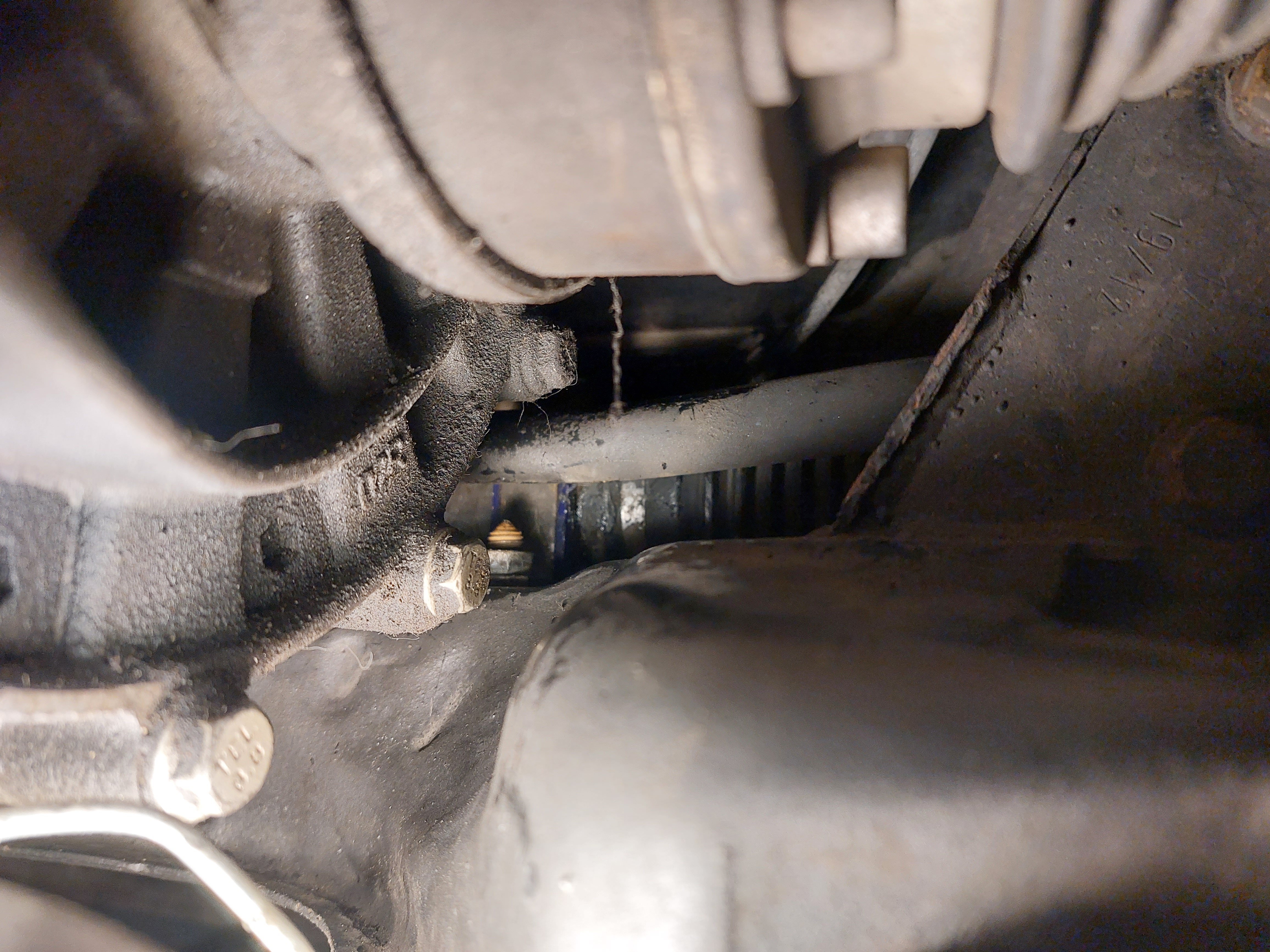

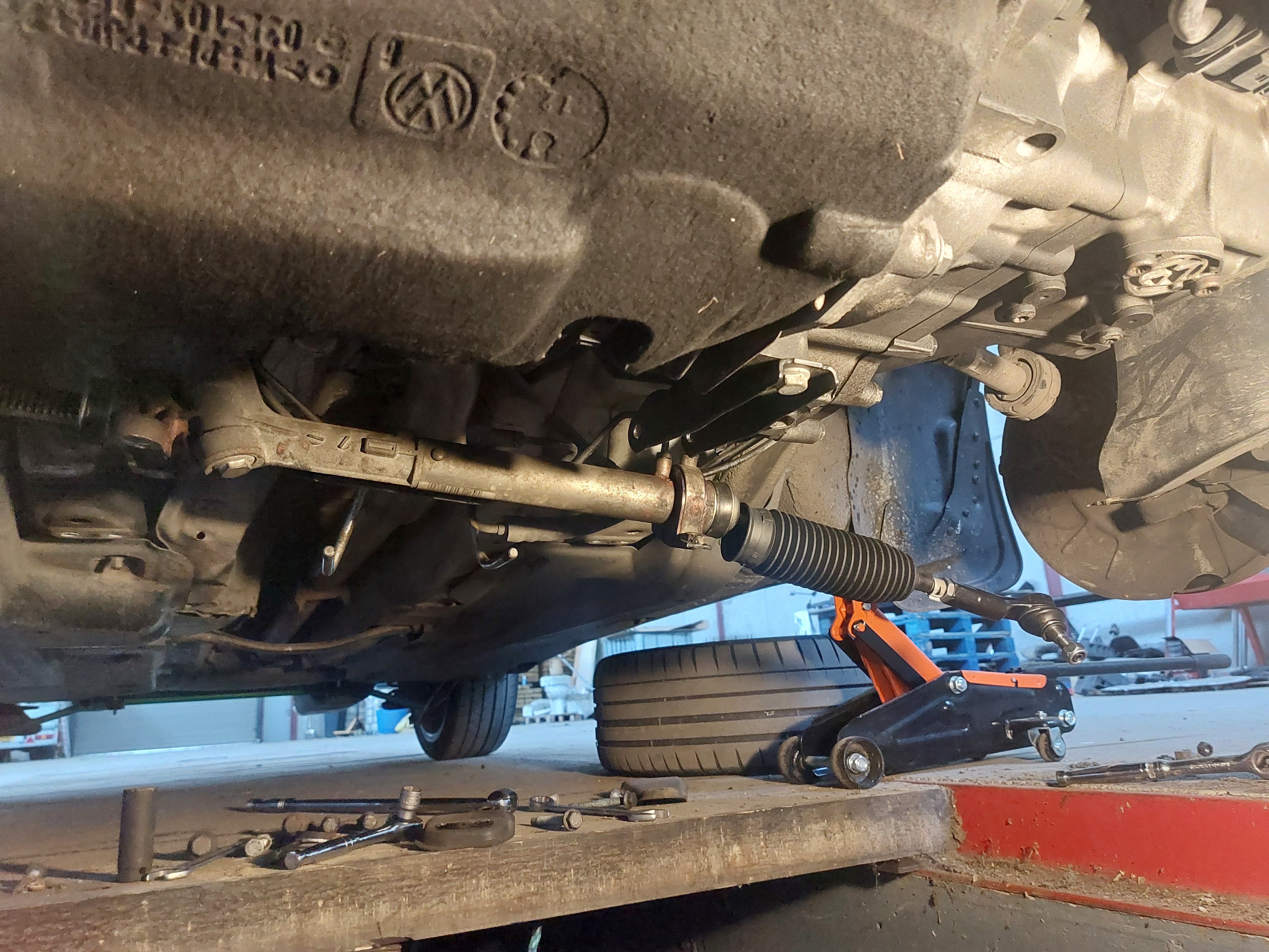

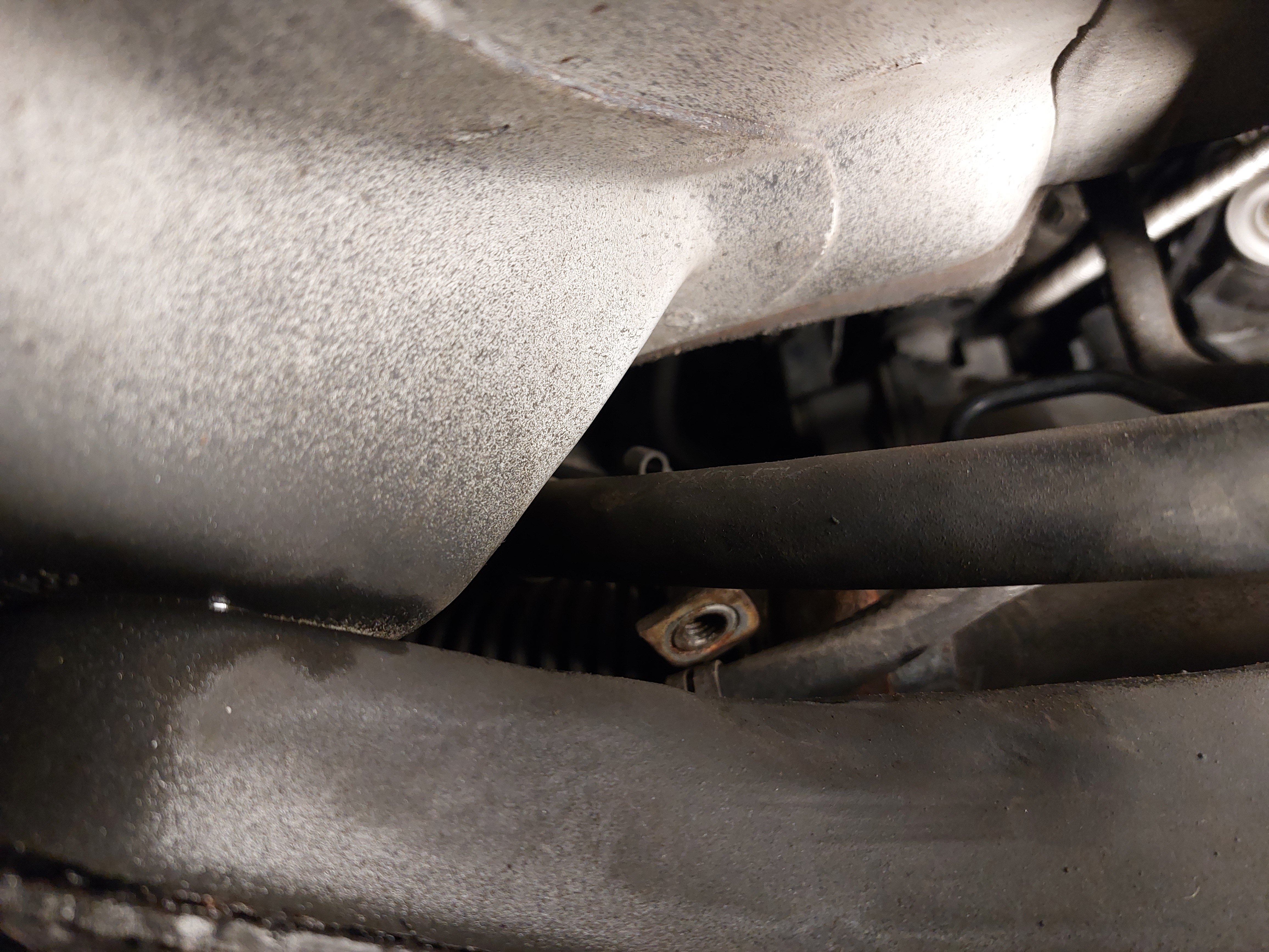

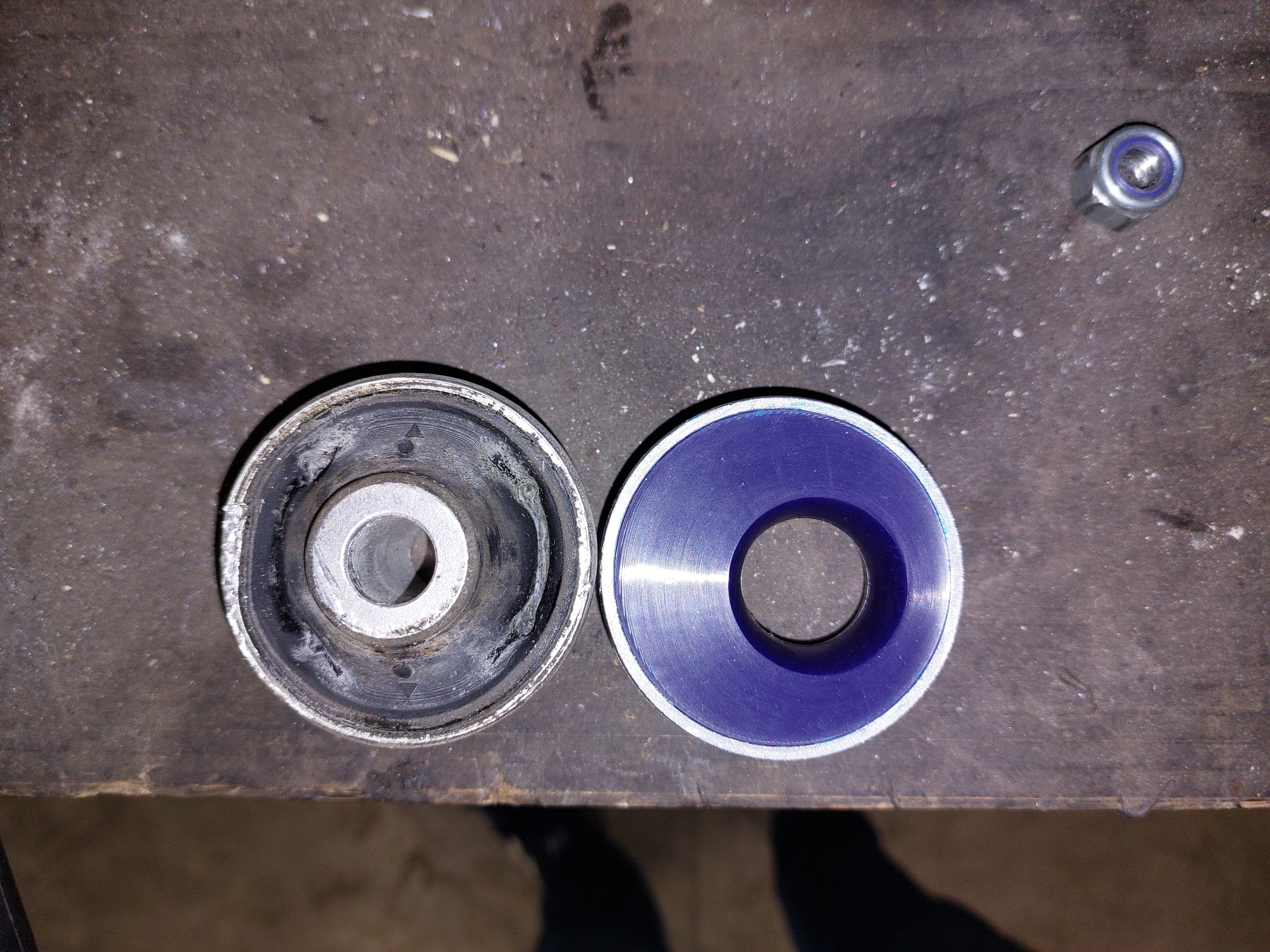

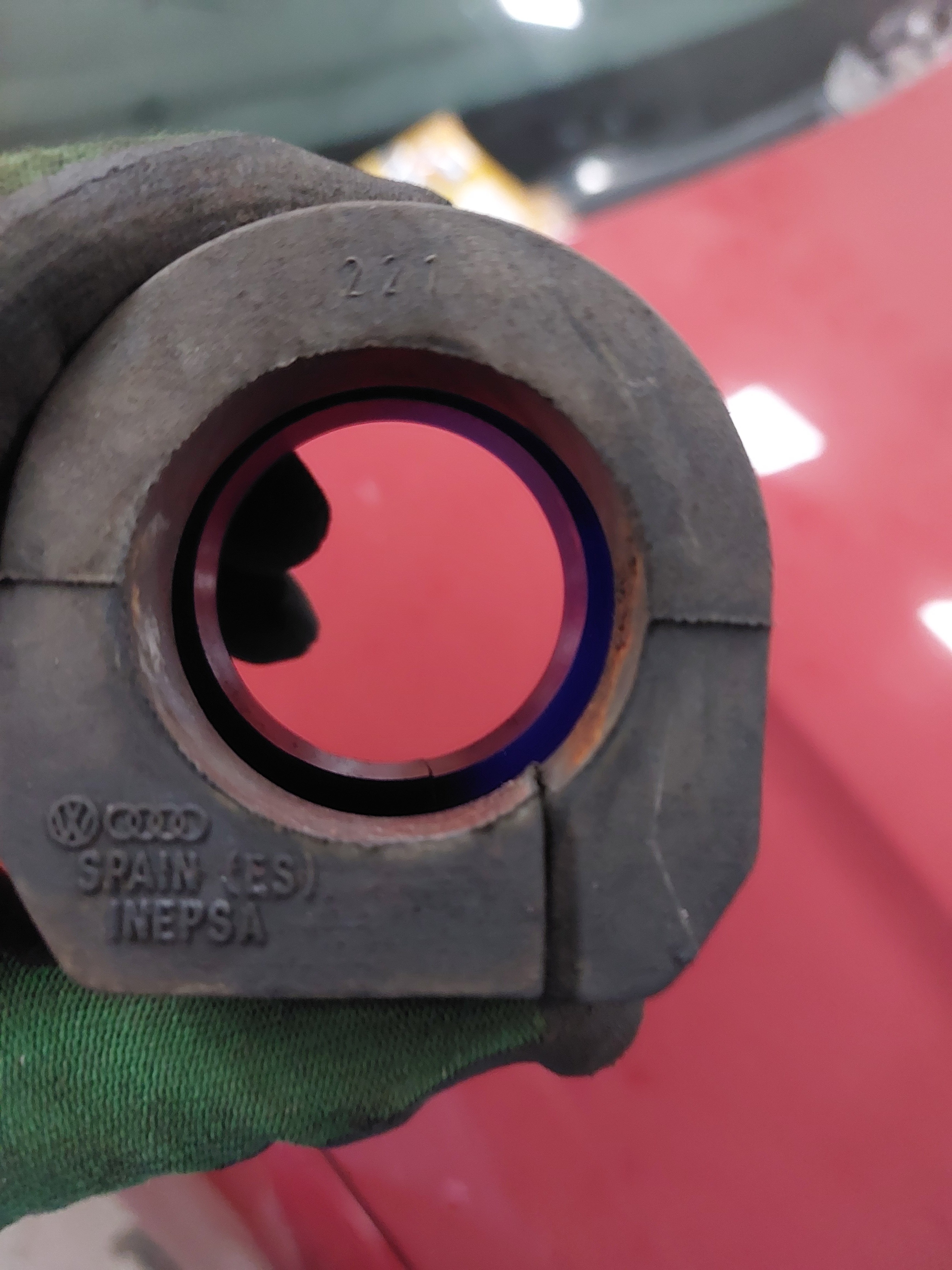

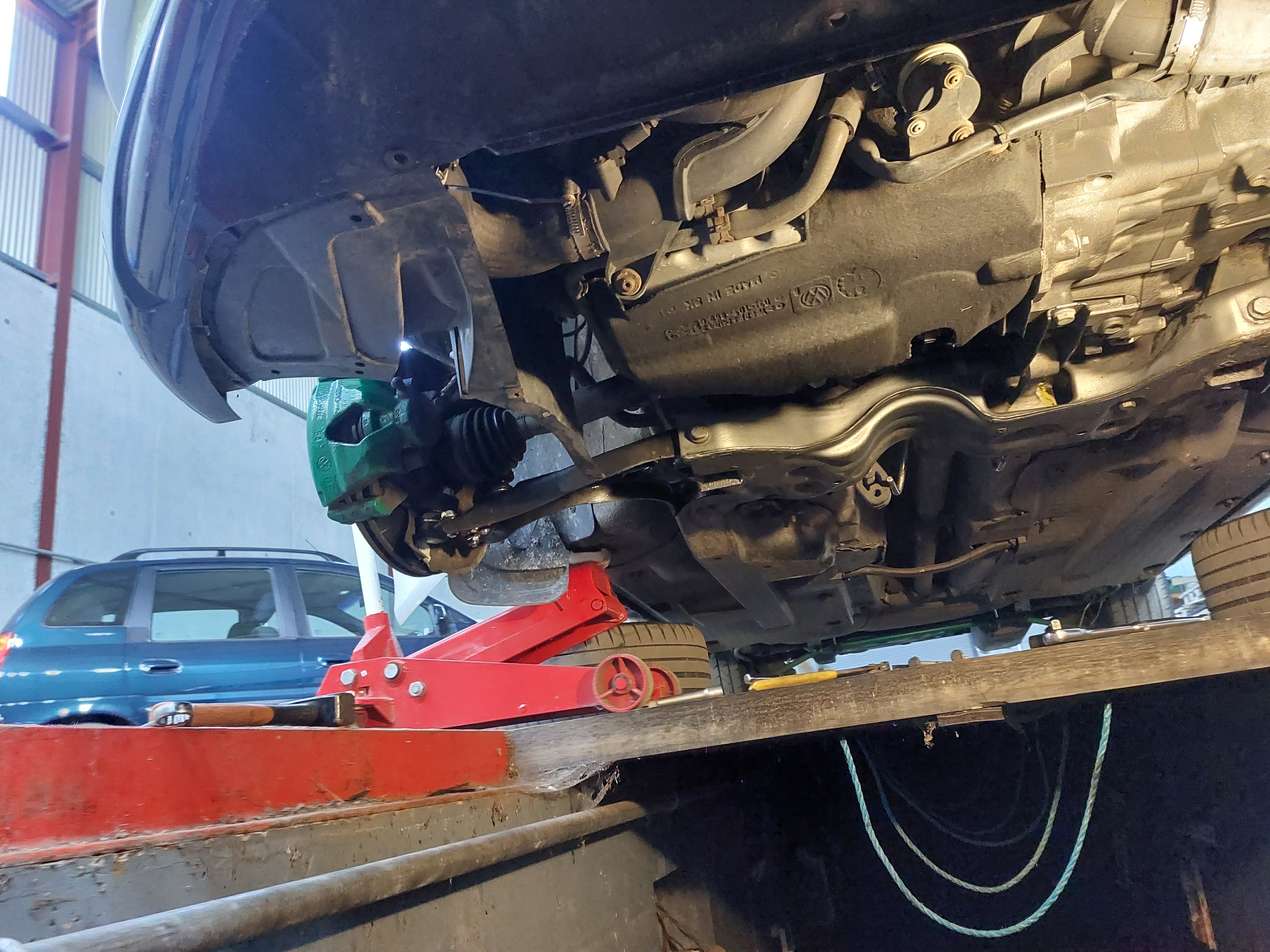

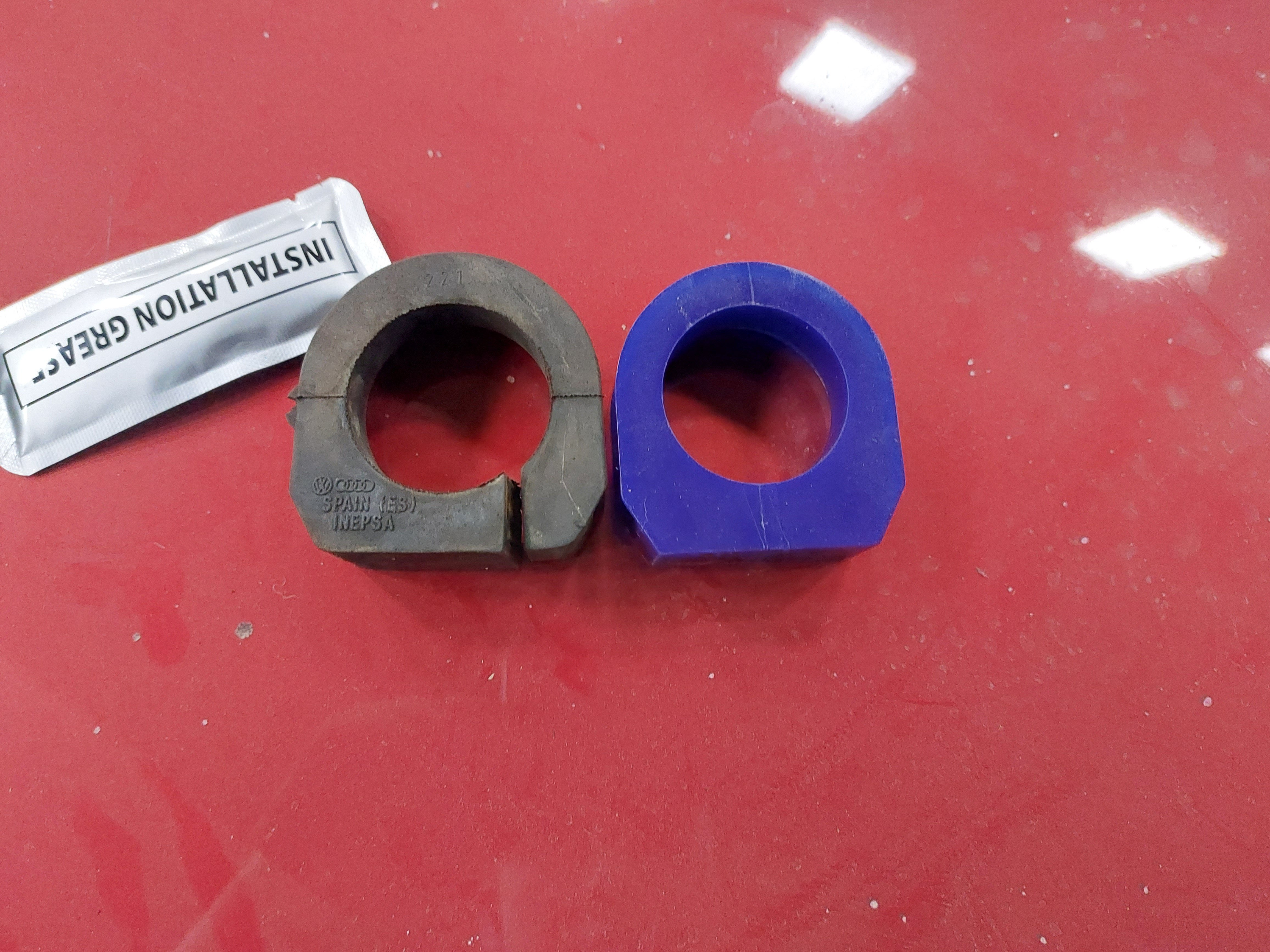

Had another steering rack bush got for this after I used the first one on the mk1.
Figured out how to swap it without dropping the subframe, bit of a faff but doable. Forgive the comically bad pictures, not great access.
Old vs New
As perfectly aligned as I could reasonably get, superpro ones a fair bit tighter.
In the car can just make out the purple colour of the new one.

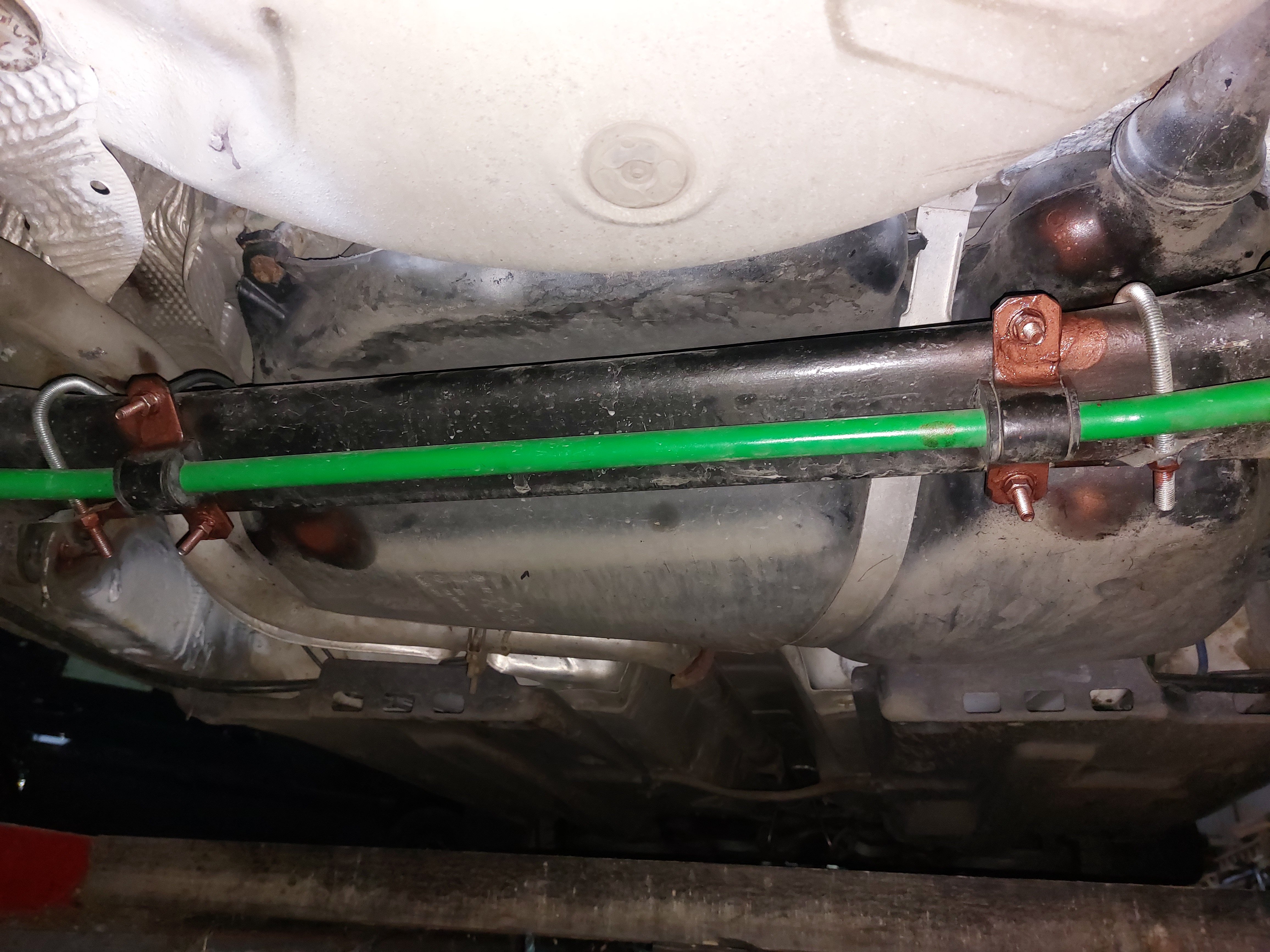

Managed to do this on the pit, still took just over an hour. If its possible to do on a "big engined" 1.6 diesel, I'd imagine its a piece of cake on the 1.2l petrol cars
When I had the tools out and was using the pit I did a bolt check front and back, considering I changed the drop link and rear springs end of last week.
Bit of Copper spray to stop bolts rusting

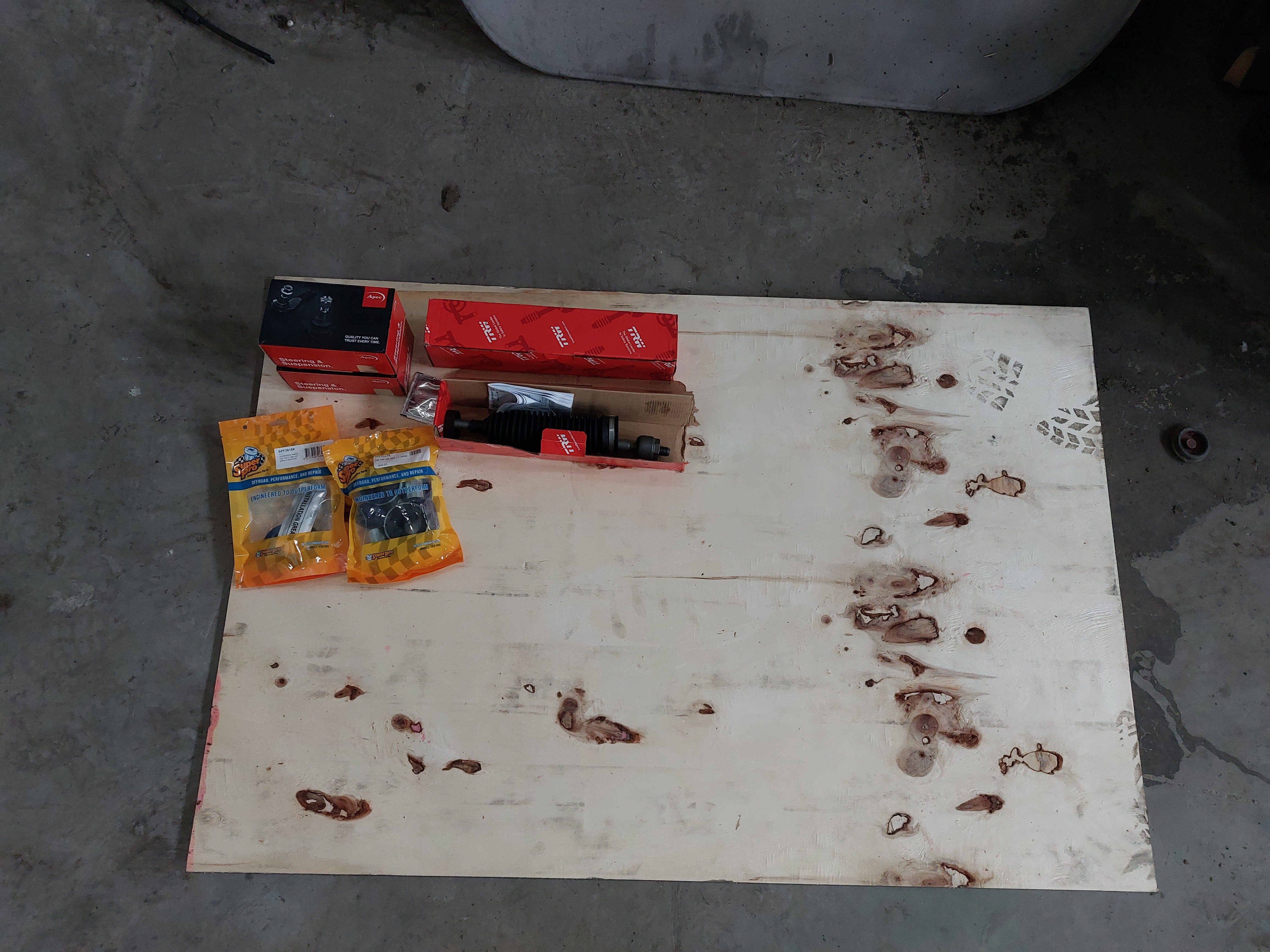

Got the parts for this sitting on a piece of wood.
It's due a service so I'll probably have the track rods done then, and the caster increase bushes I want to do myself.
I have another thing coming. Bought and all, probably the last thing bought for this car for a while it seems.
I have all of this stuff got already so it will be put on, but that's it for now.

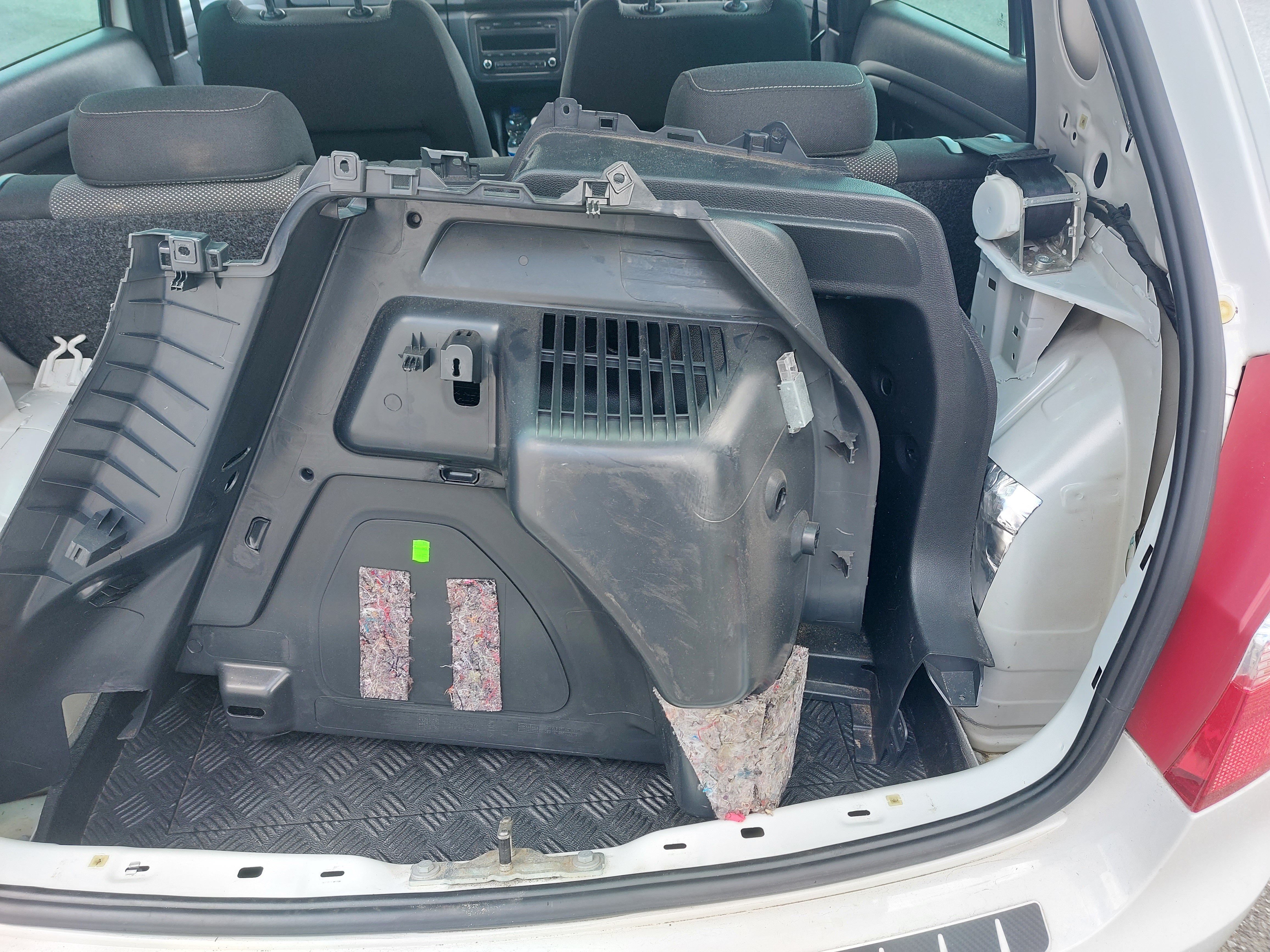

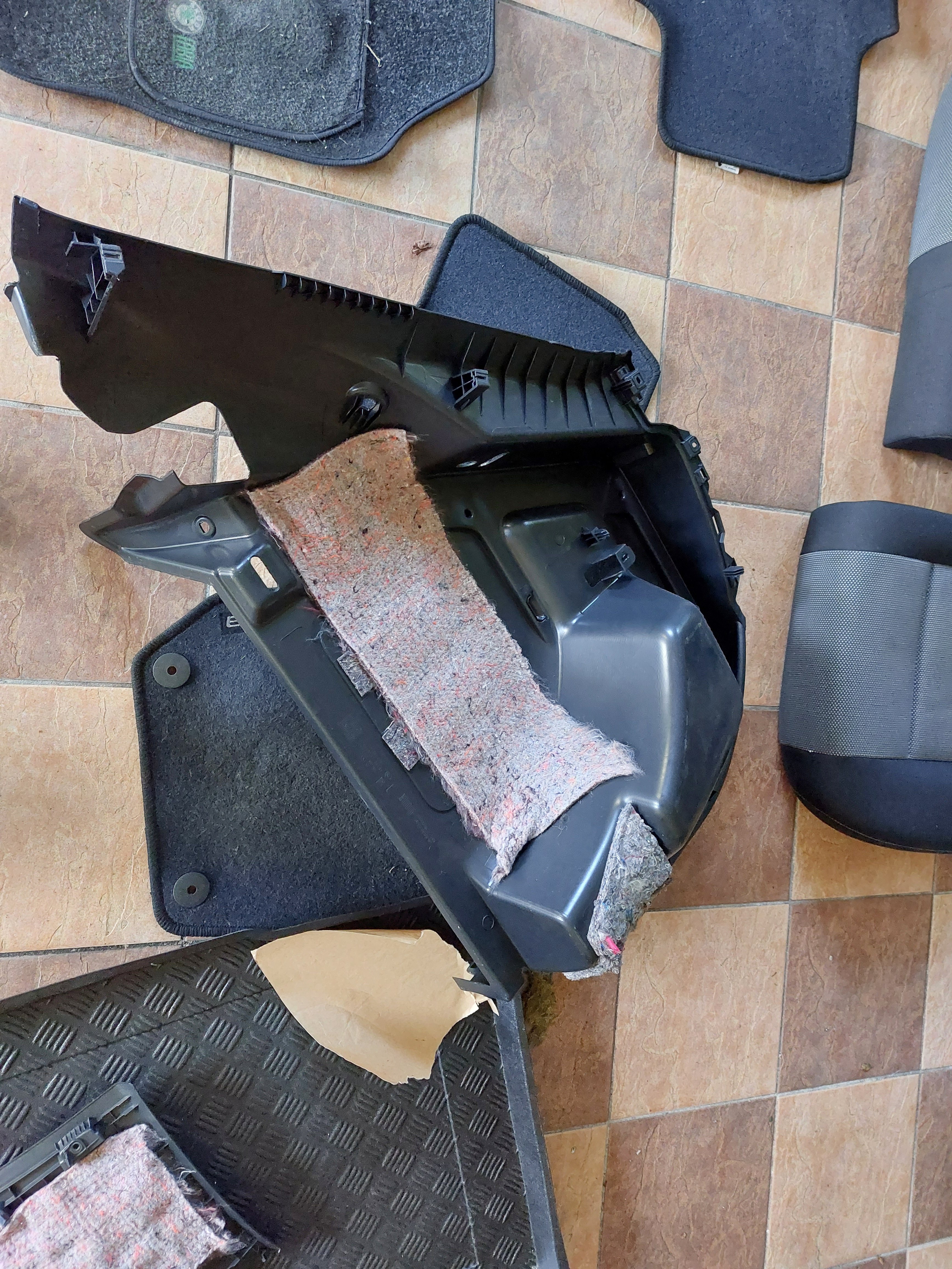

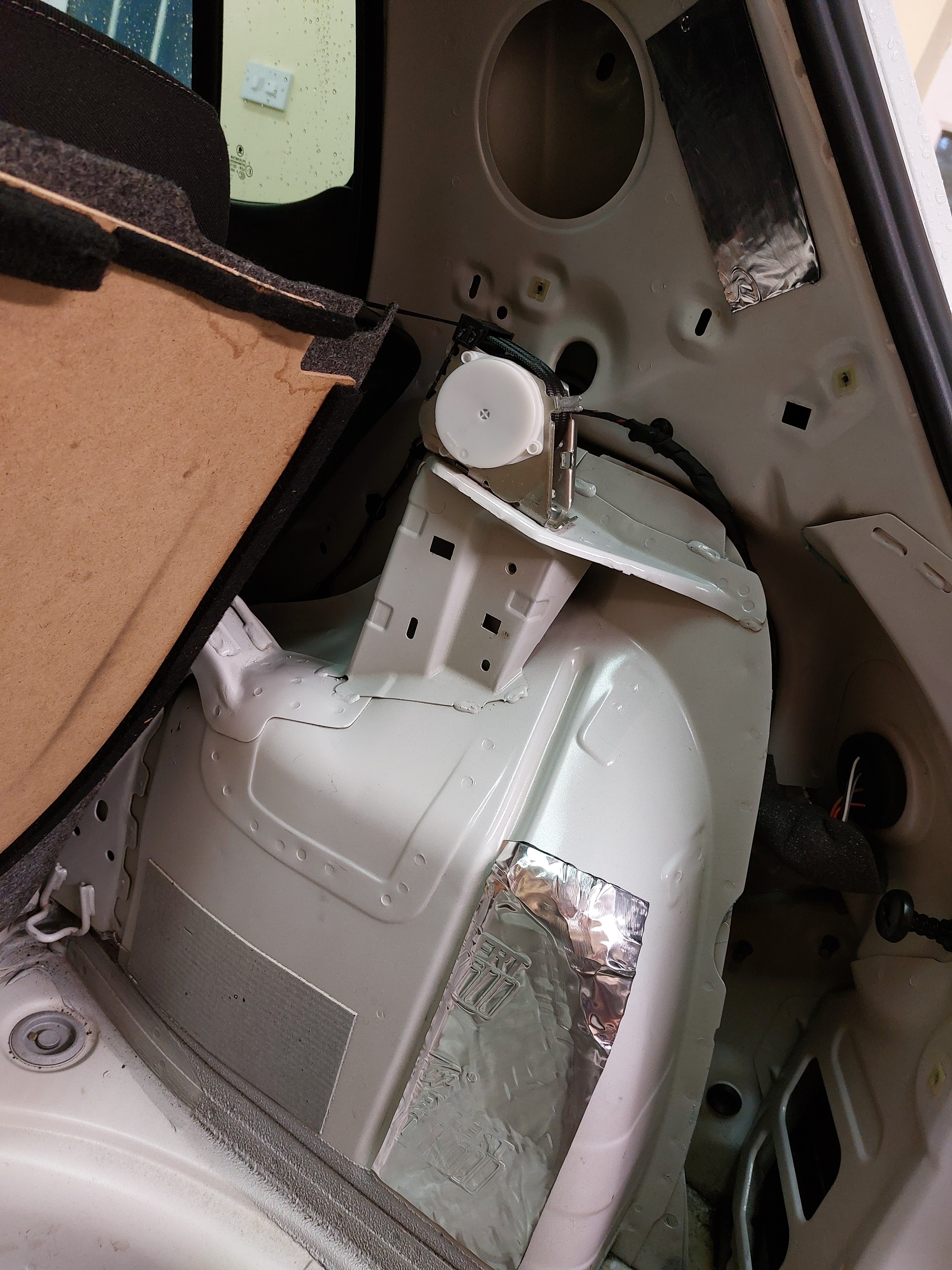

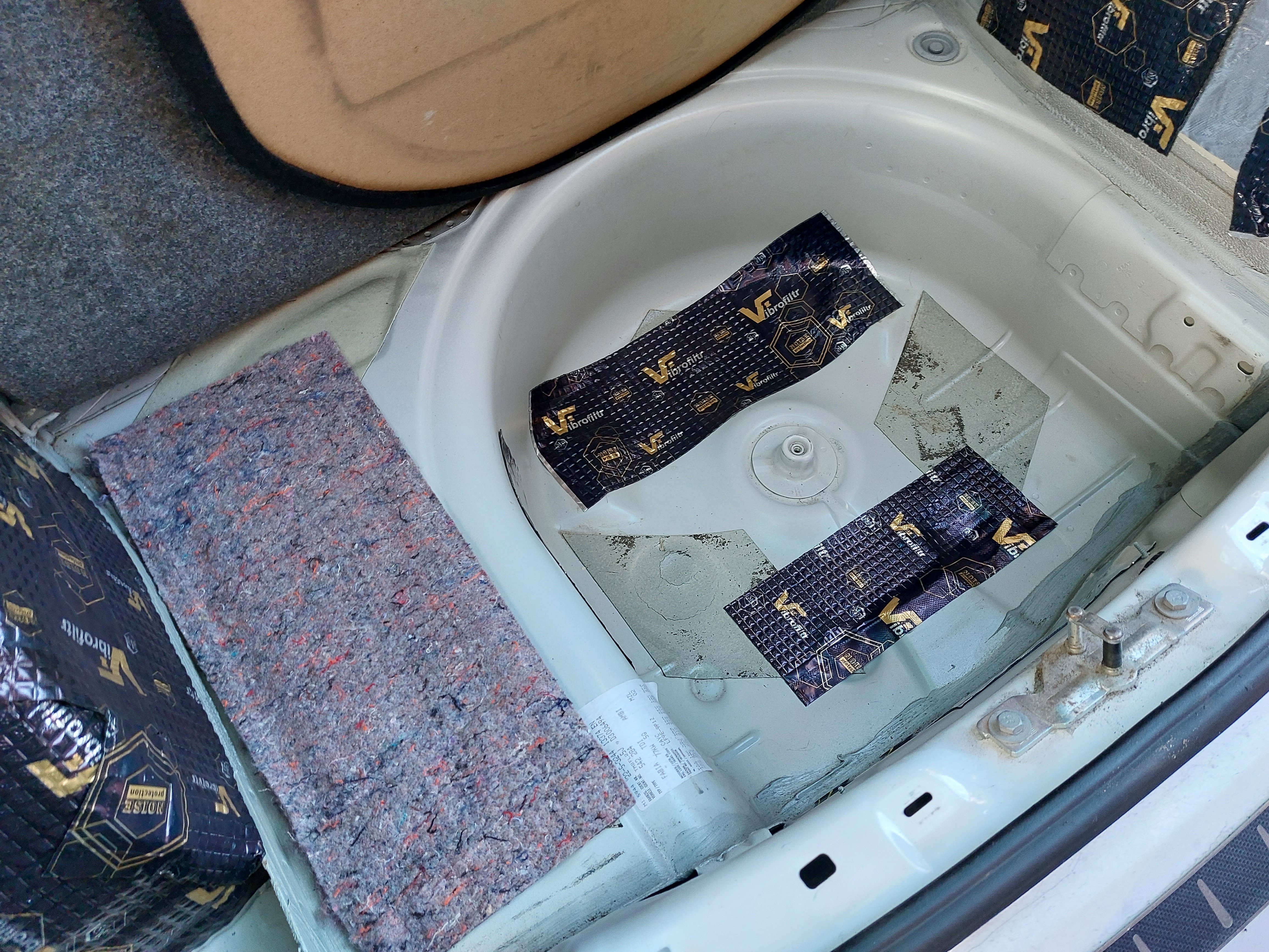

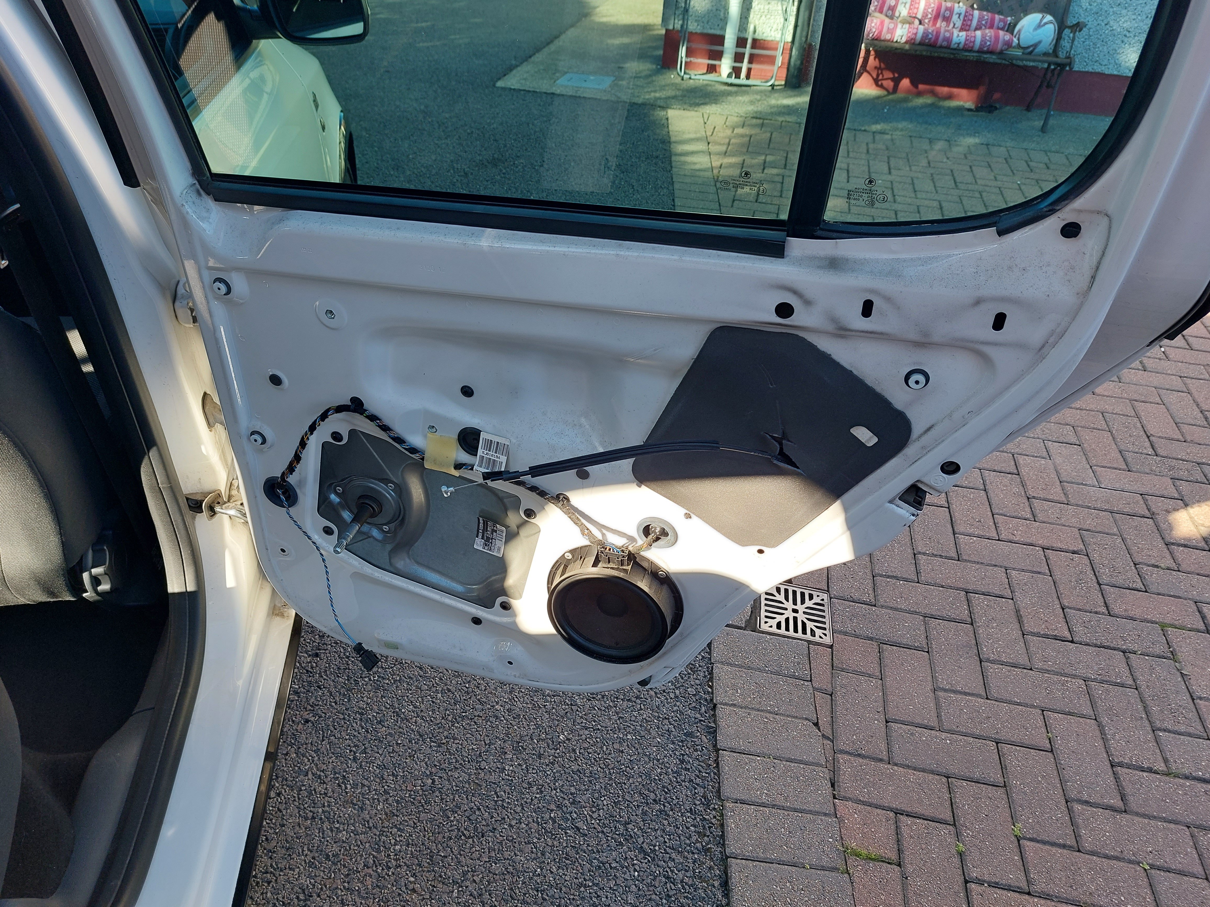

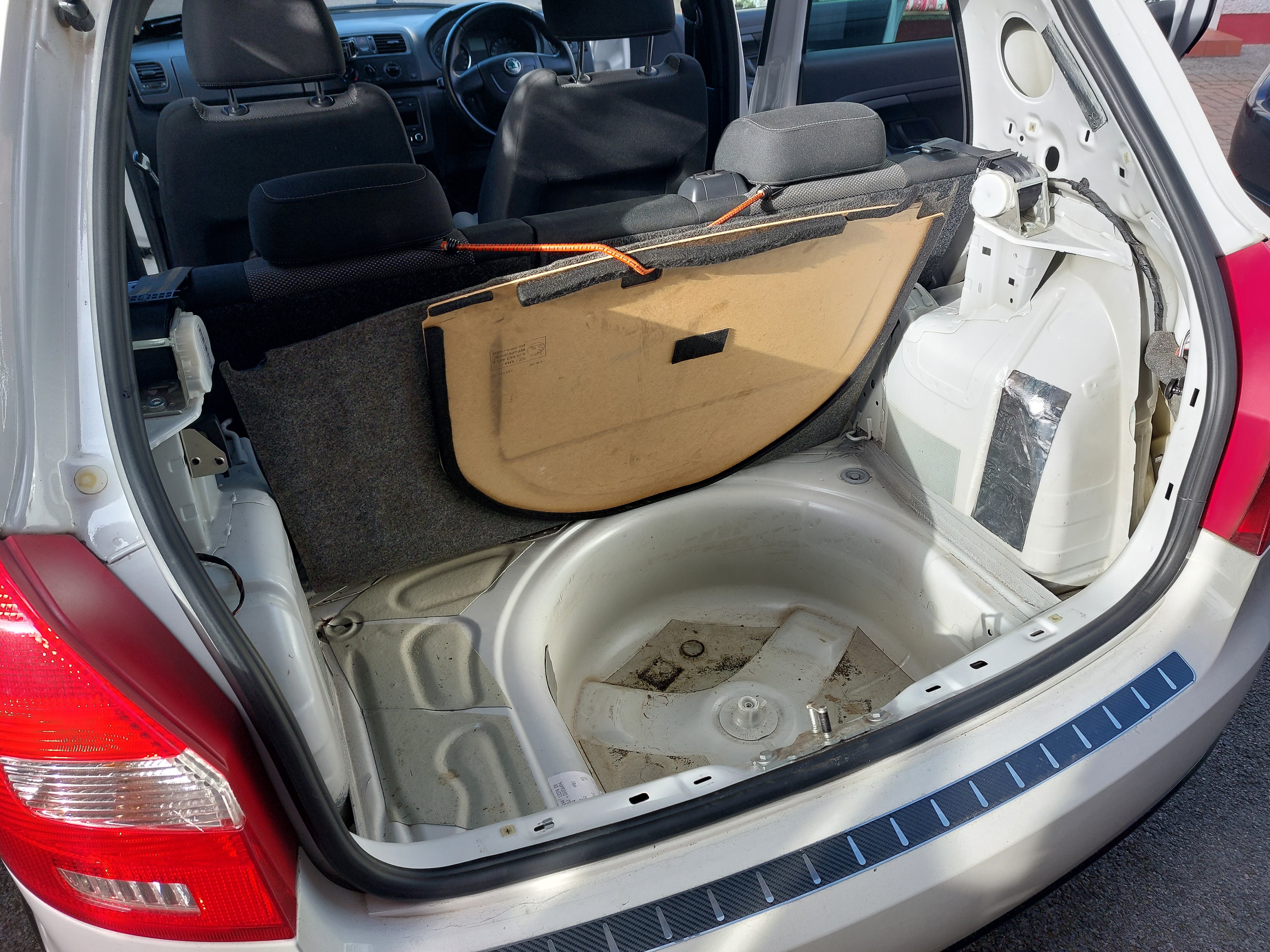

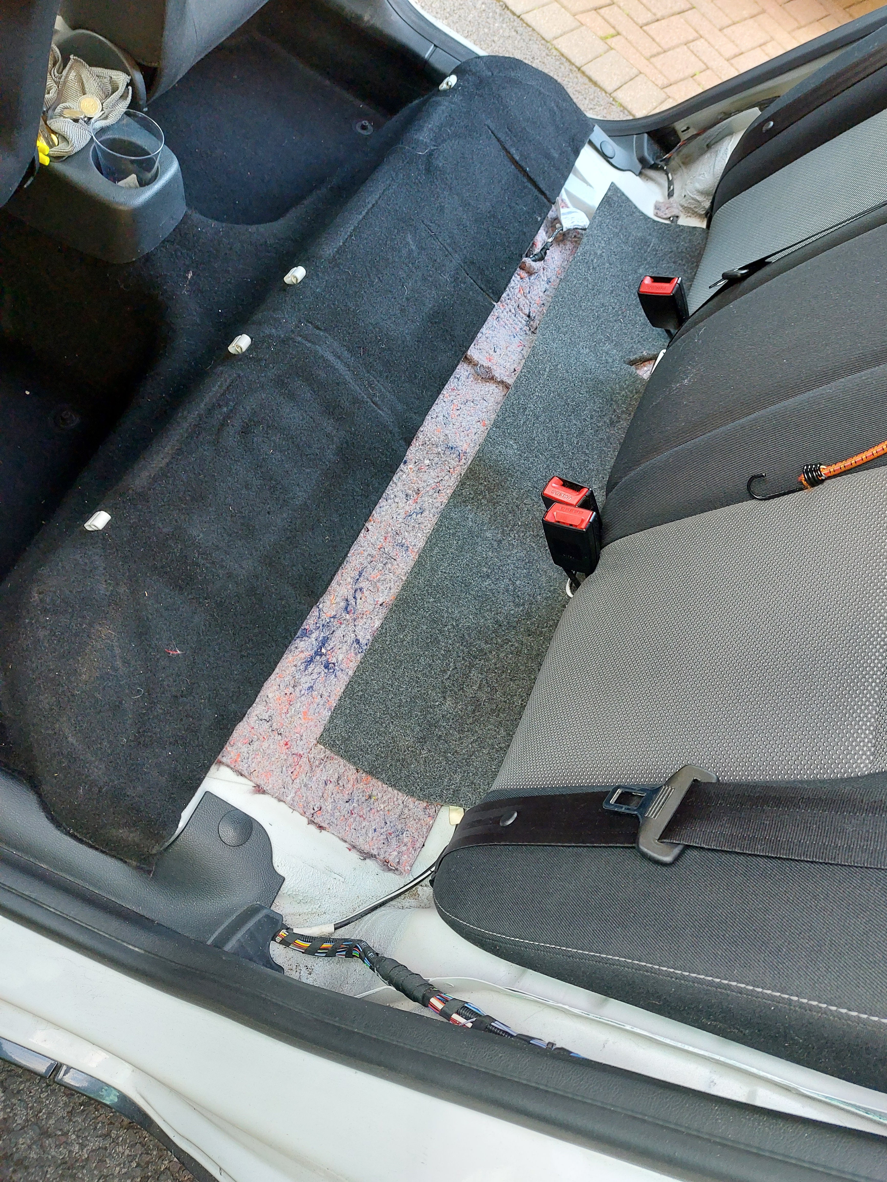

Got some sound deadening pads from halfords, only a little bit but they did work quite well. 15 euro for 2 little sheets though, not cheap.

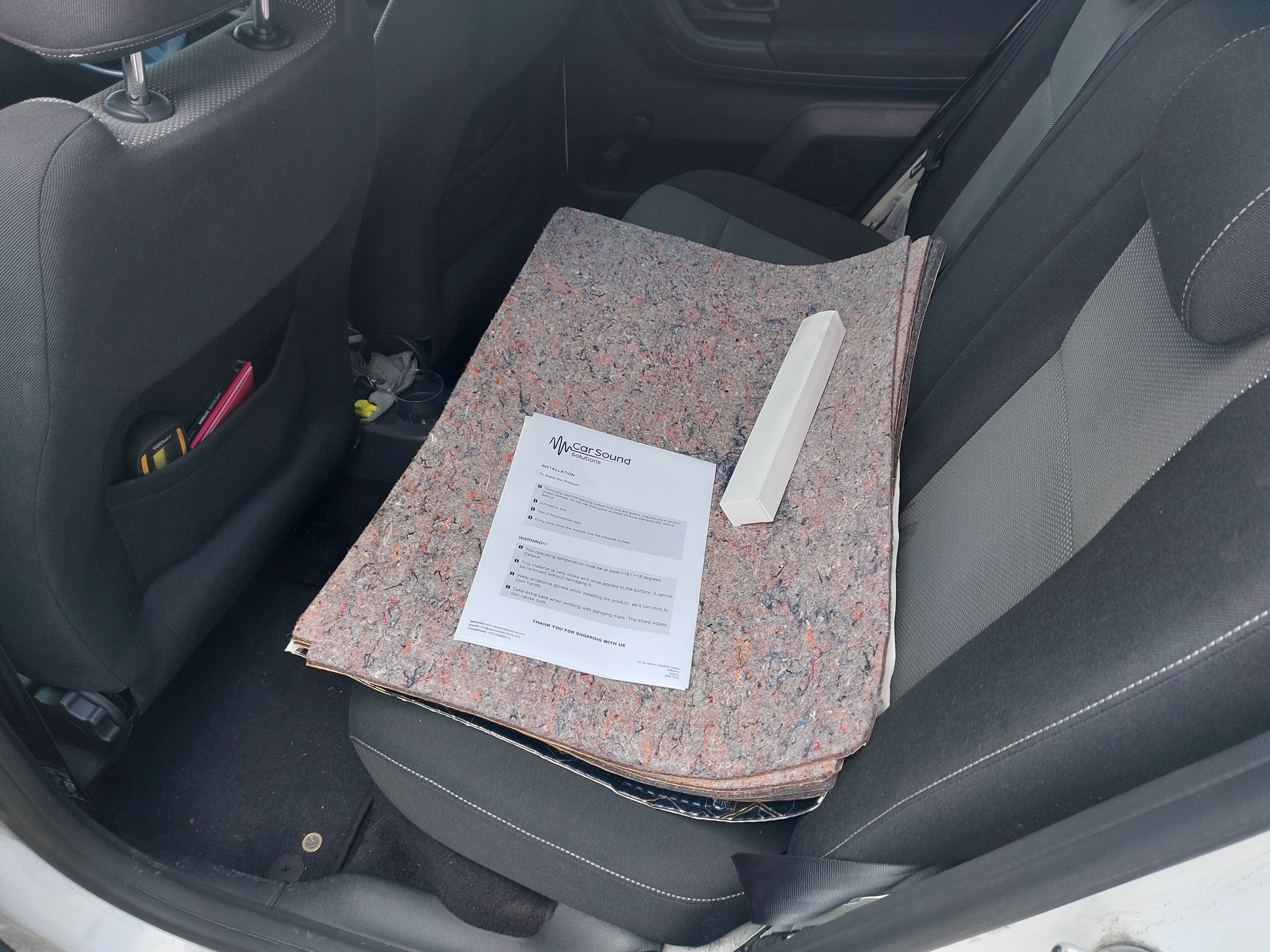

So, went down to kilkenny the other day to get two things, a lot of sound deadening and some spare boot trims.
Why spare trims?

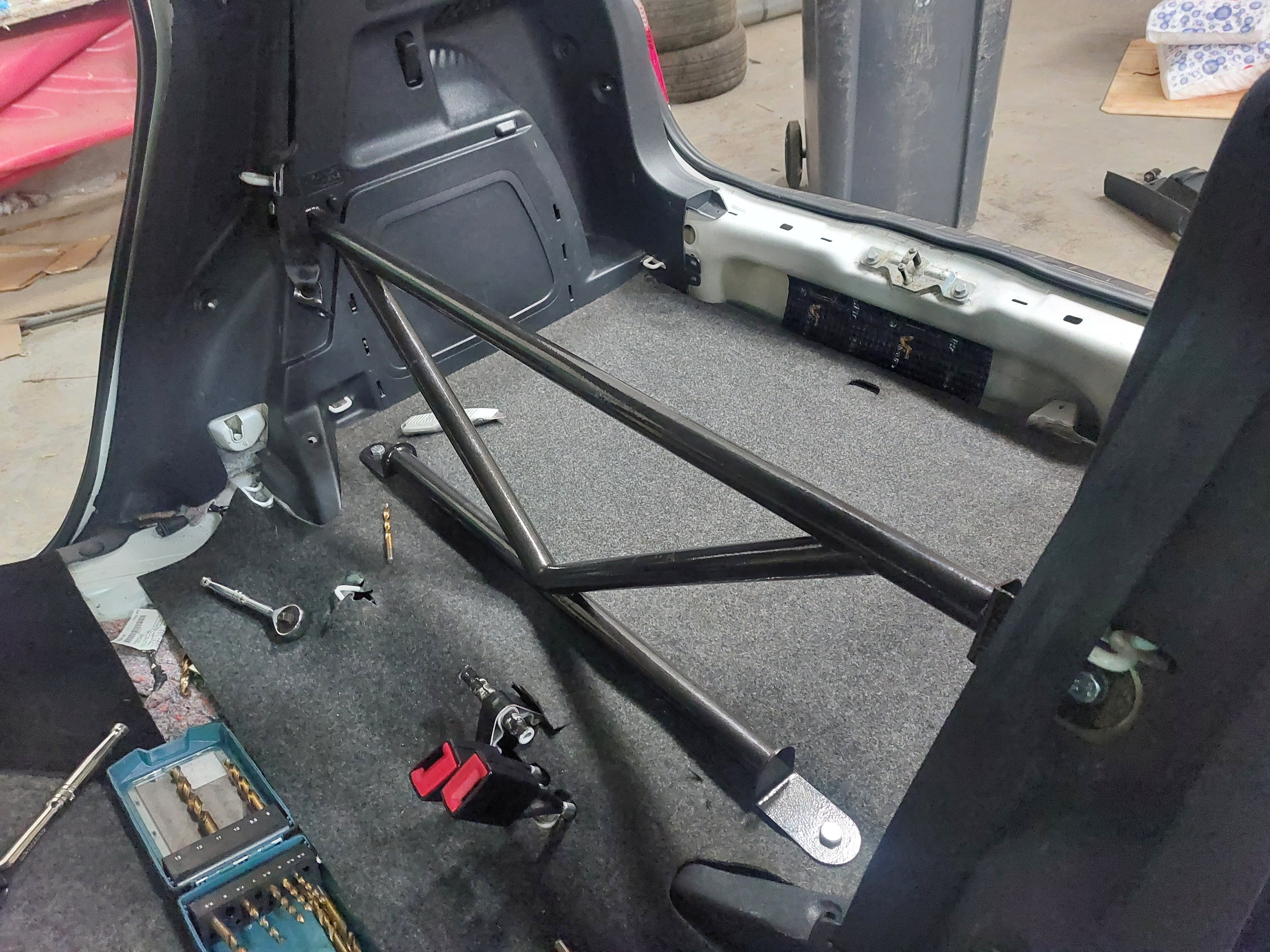

Well I'll be putting a brace in the boot again, this time though I don't want to run it stripped out like before. I want to keep the original trims in one piece hence buying another set.
Will either be the brace I had before or a k brace.
4 sheets of sound deadener ,4 sheets of felt and a roller tool came up to 60 euro. I've only used half it so far.
Wasn't going for full coverage, but most of the sheets went around the wheel Wells.
Put felt mat behind the plastic trims instead of the arches.
Back together, a bit tougher than before. Don't think you'd be able to use thicker stuff as the trim might not fit at all over it.
Looks no different than a standard car but it is much quieter.
Have enough to do the doors which I do want to do.

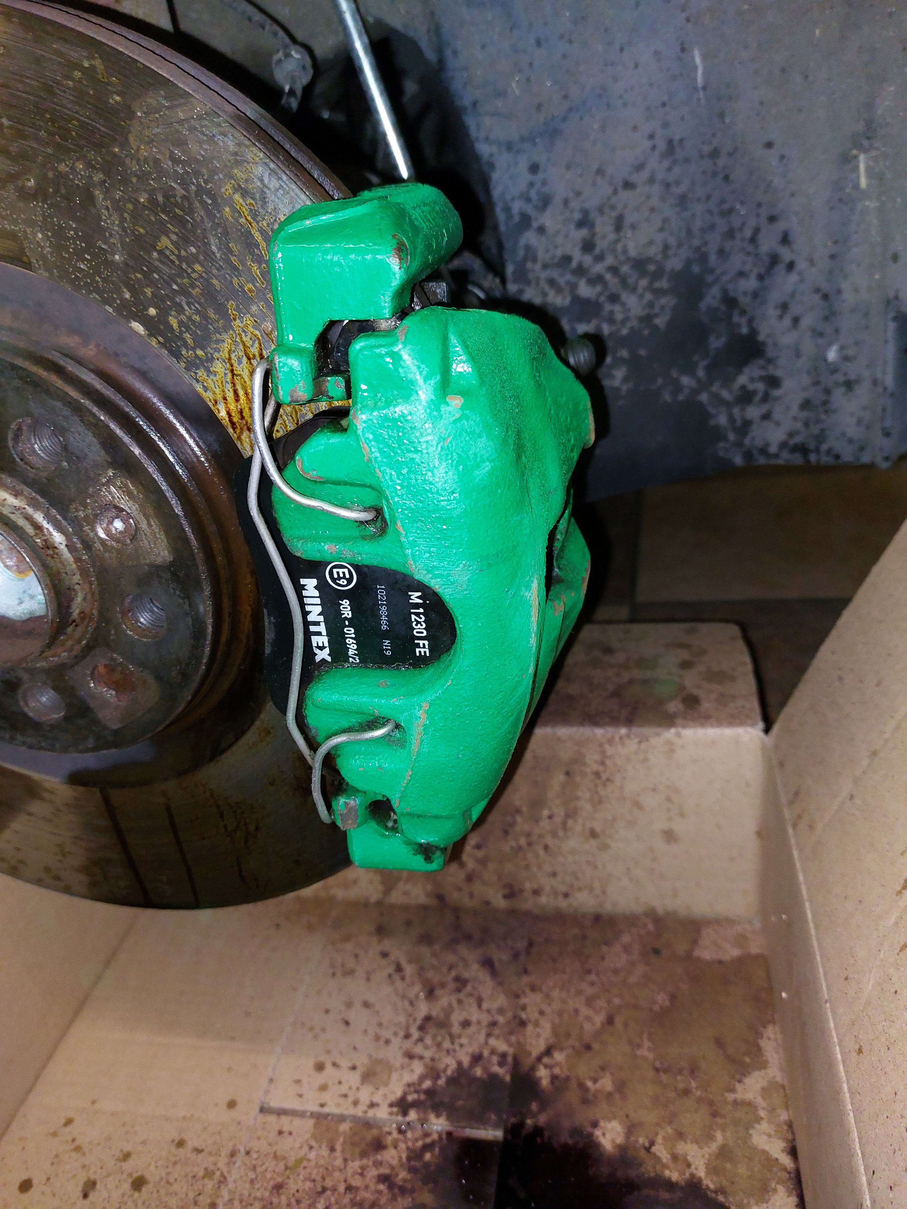

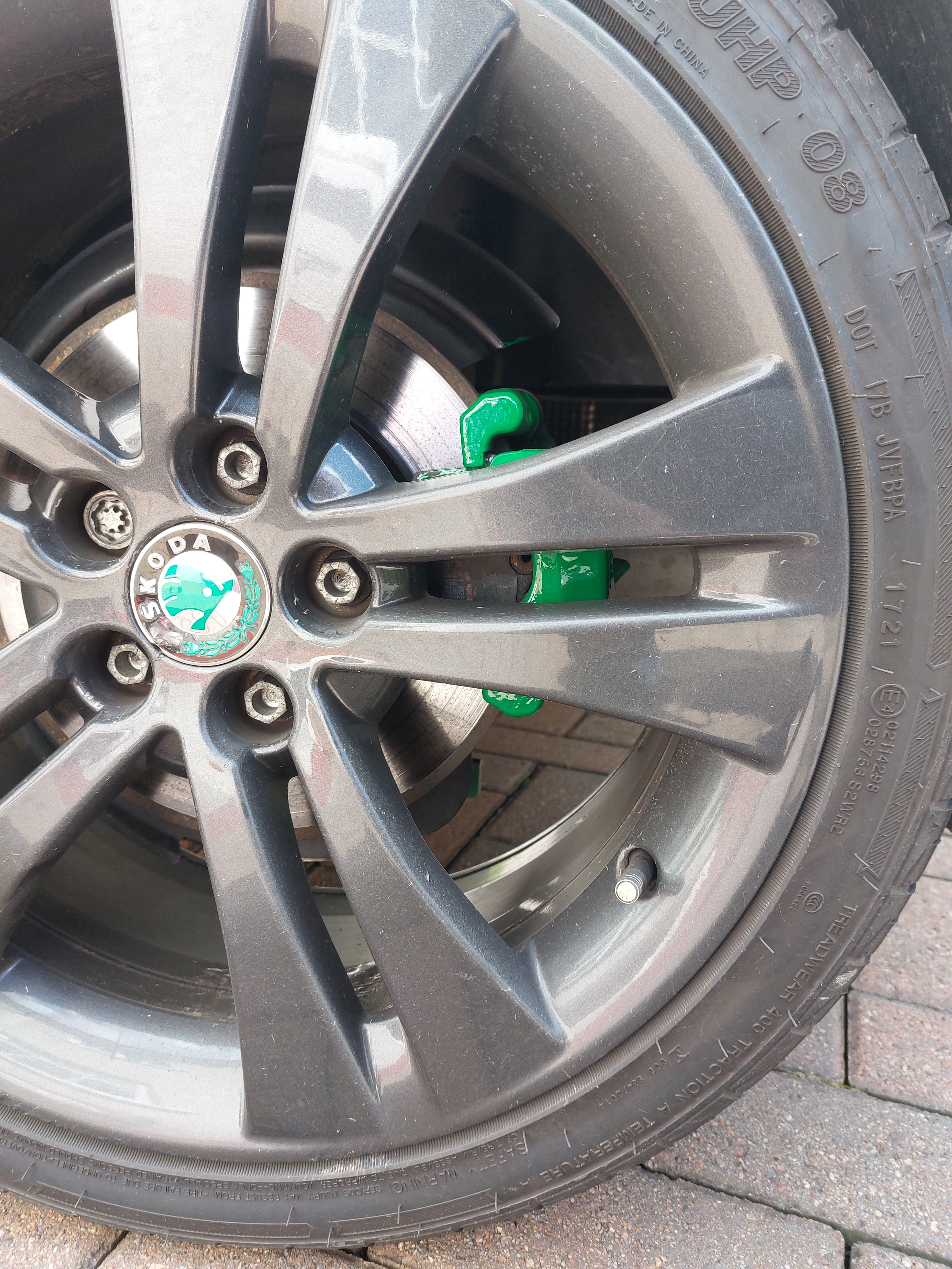

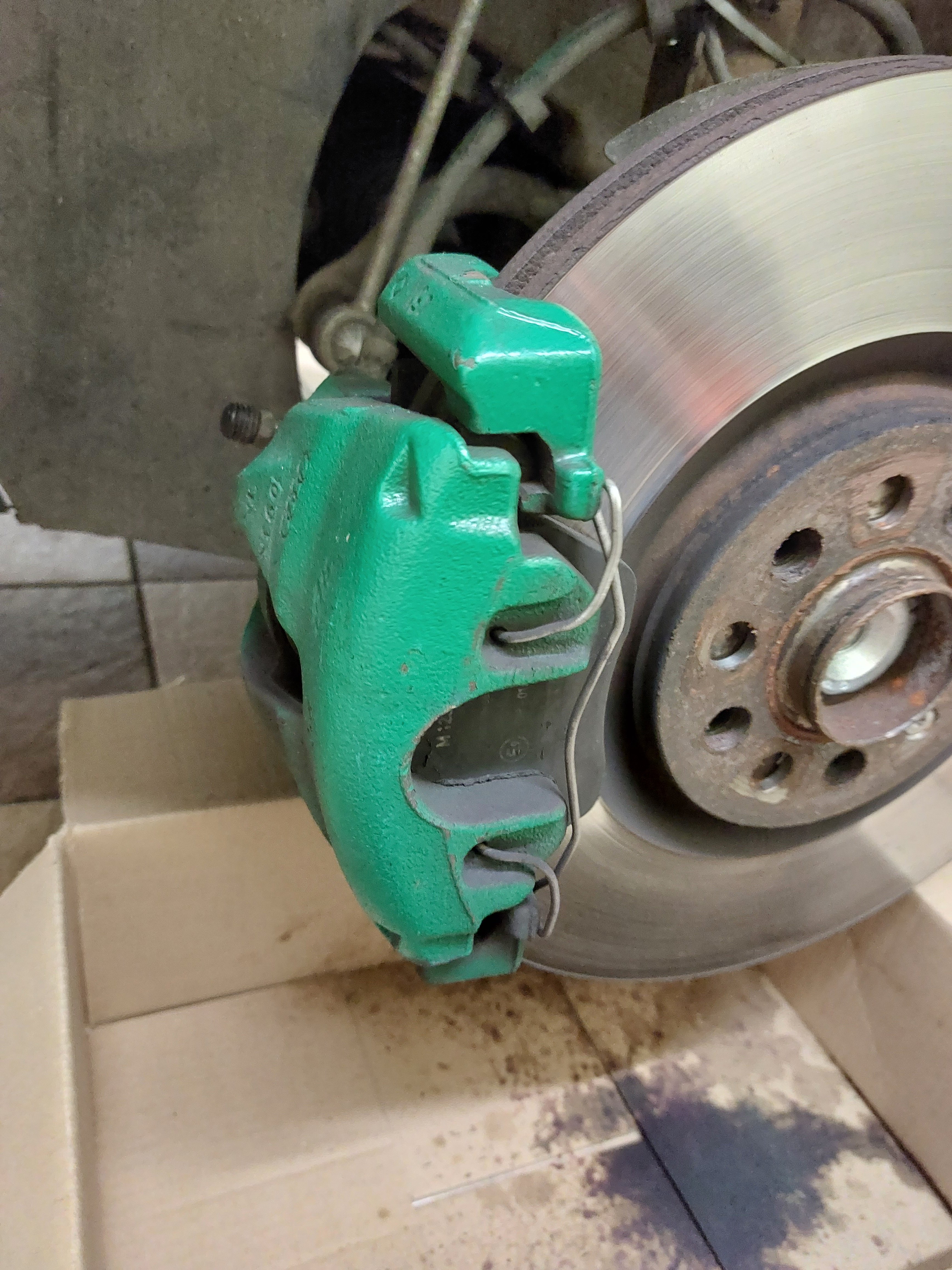

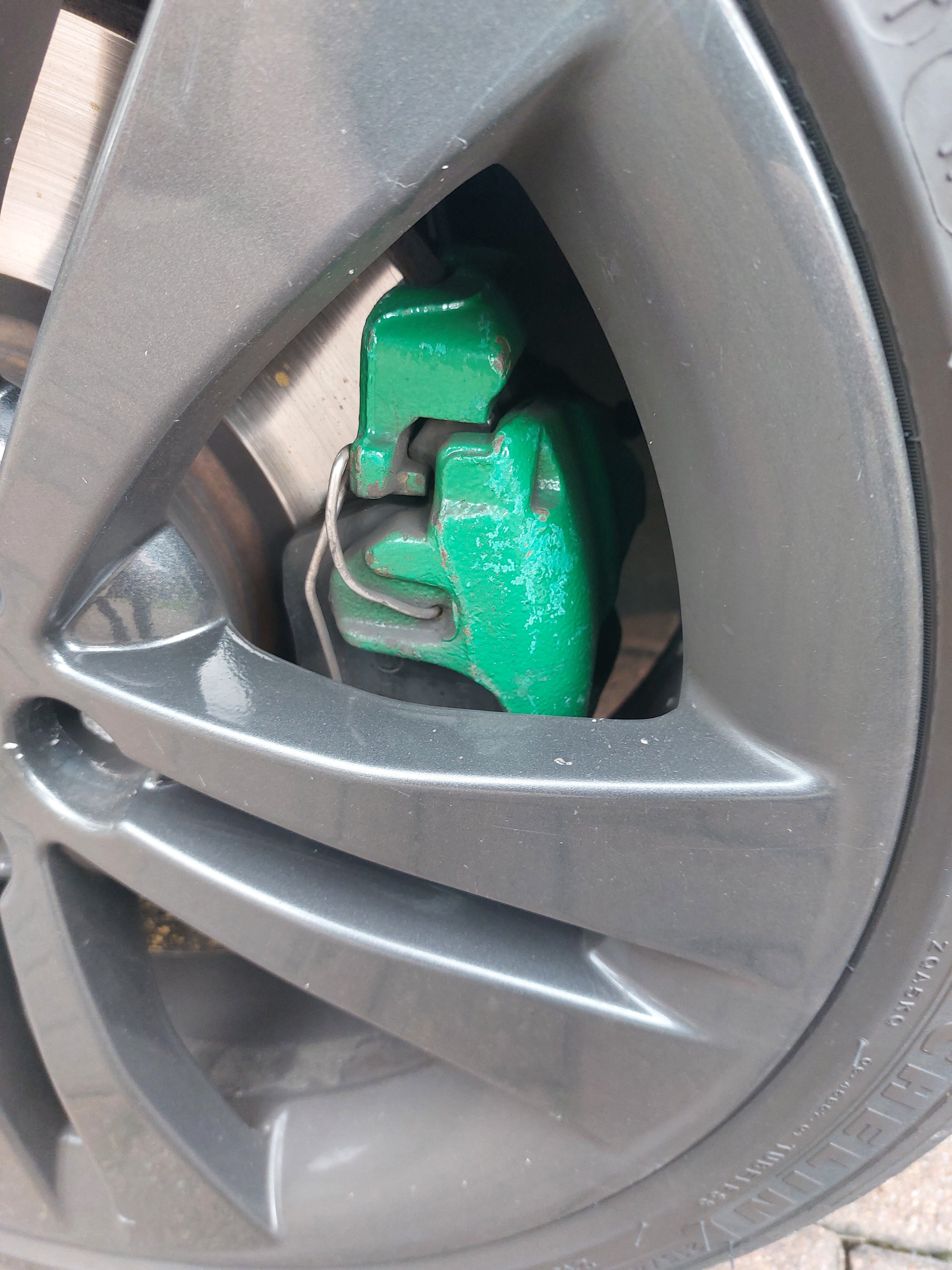

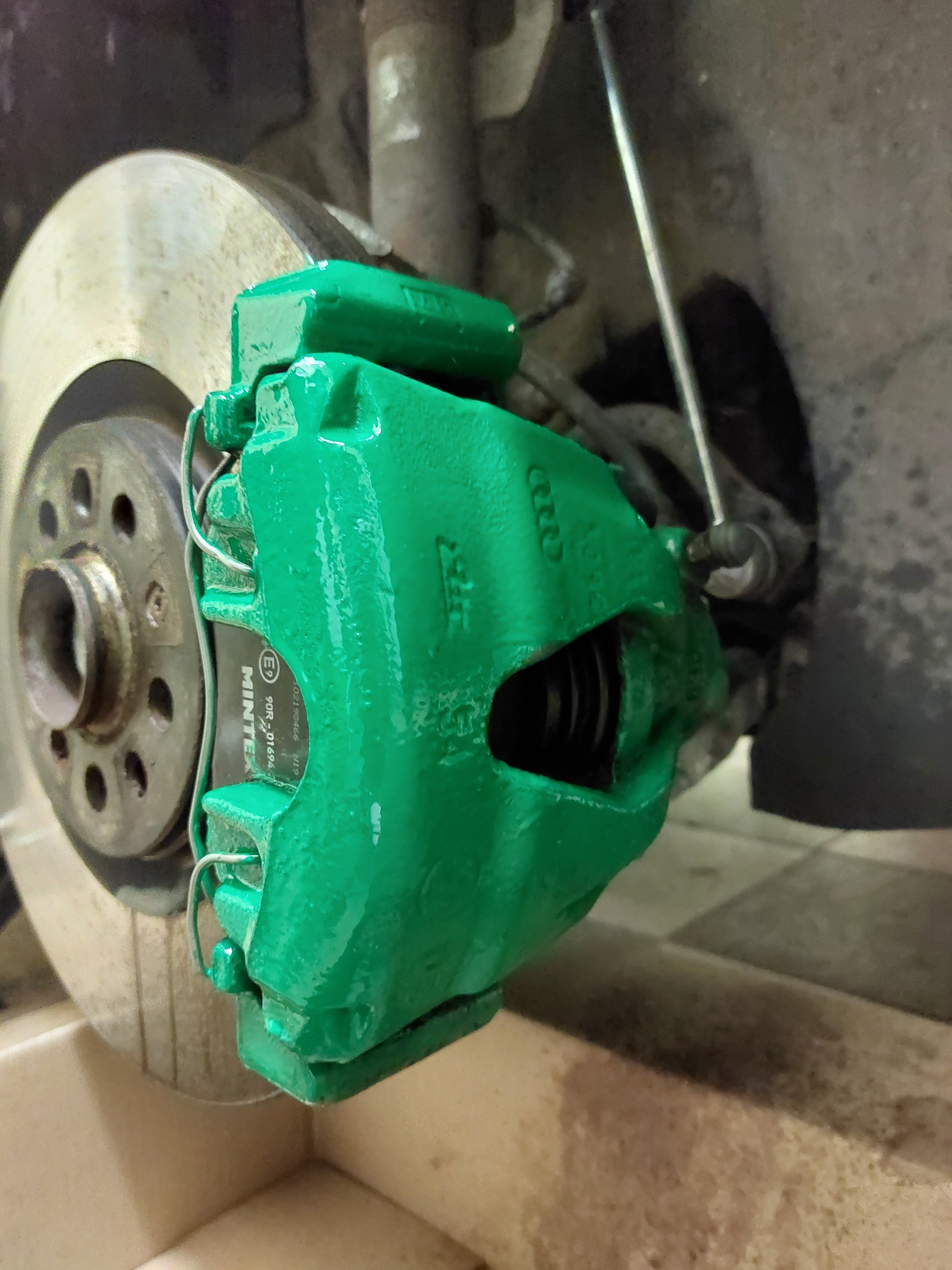

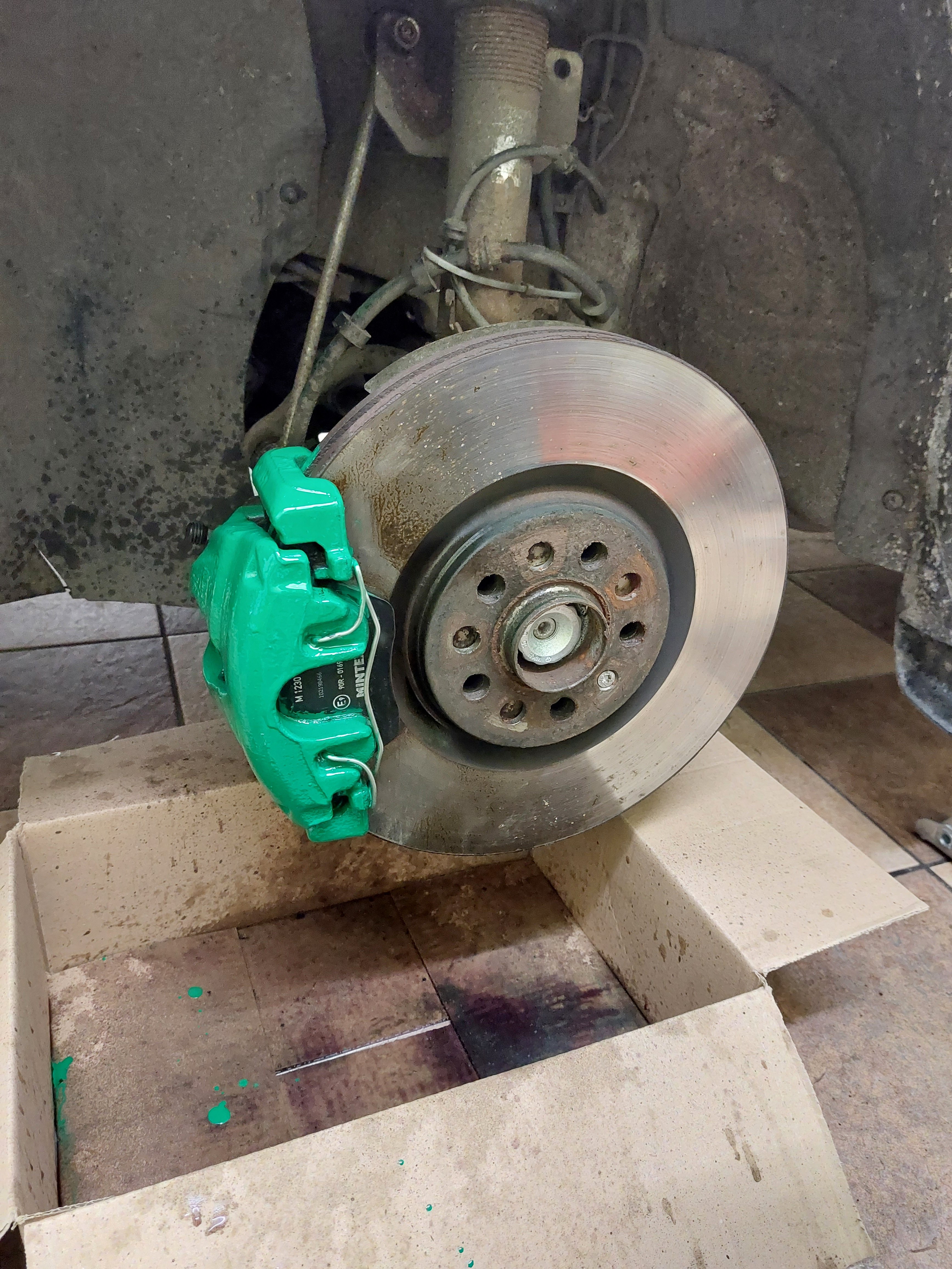

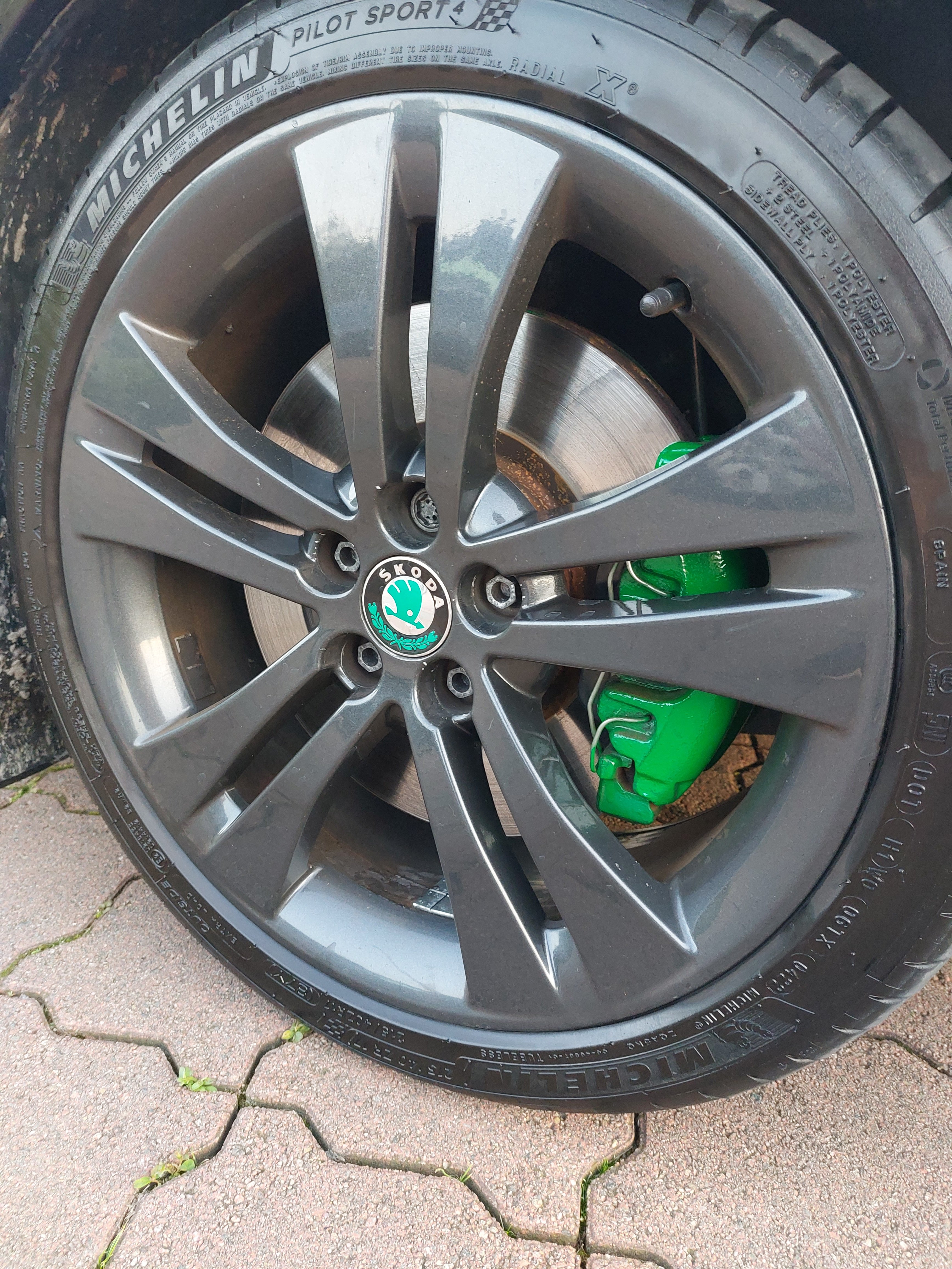

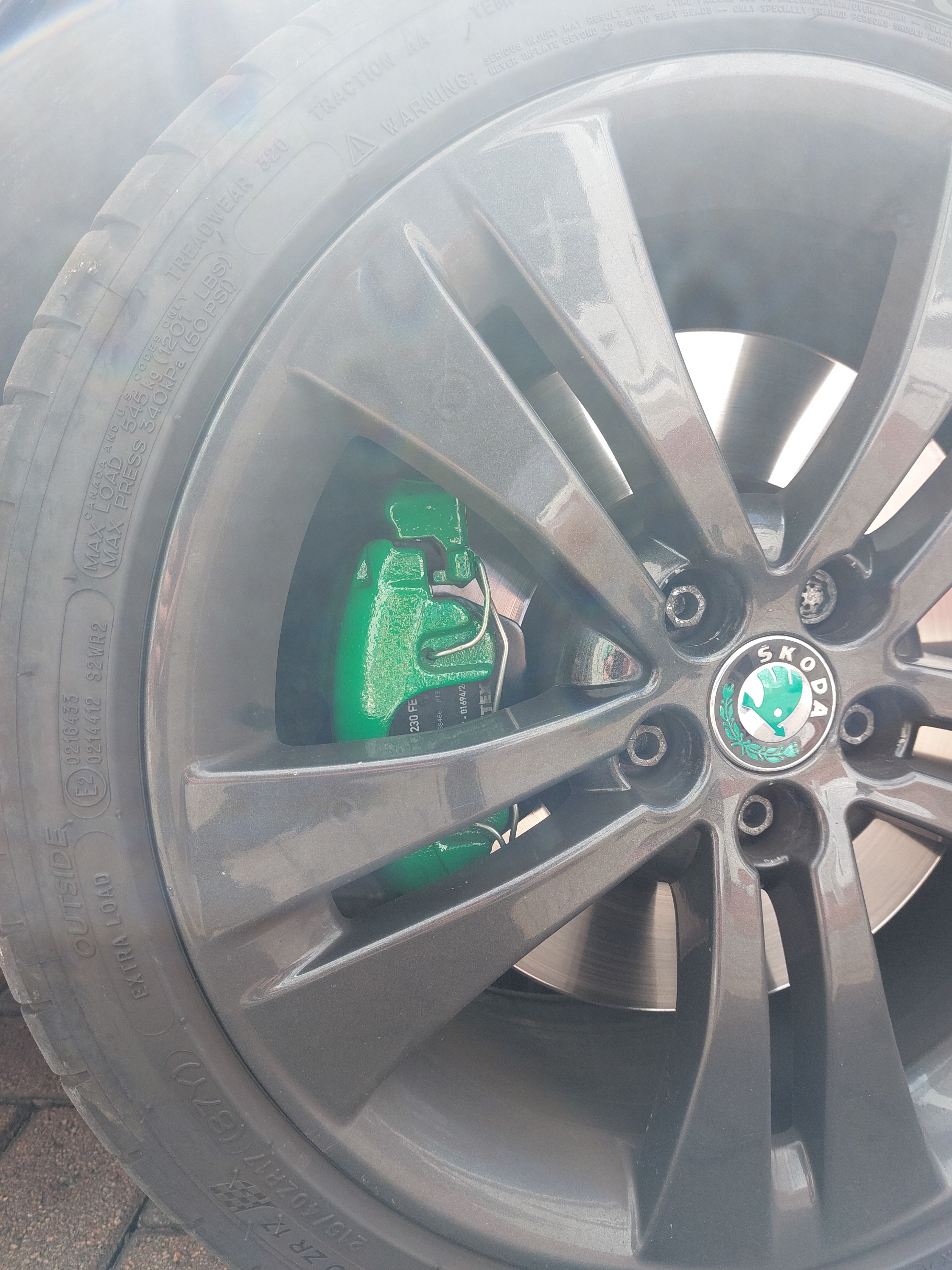

Got a pot of Pantone 348 mixed up to paint the calipers, fronts were looking shabby.
Deep clean and sanded
Then paint
Other side.
Did the rears again also, no pictures though.

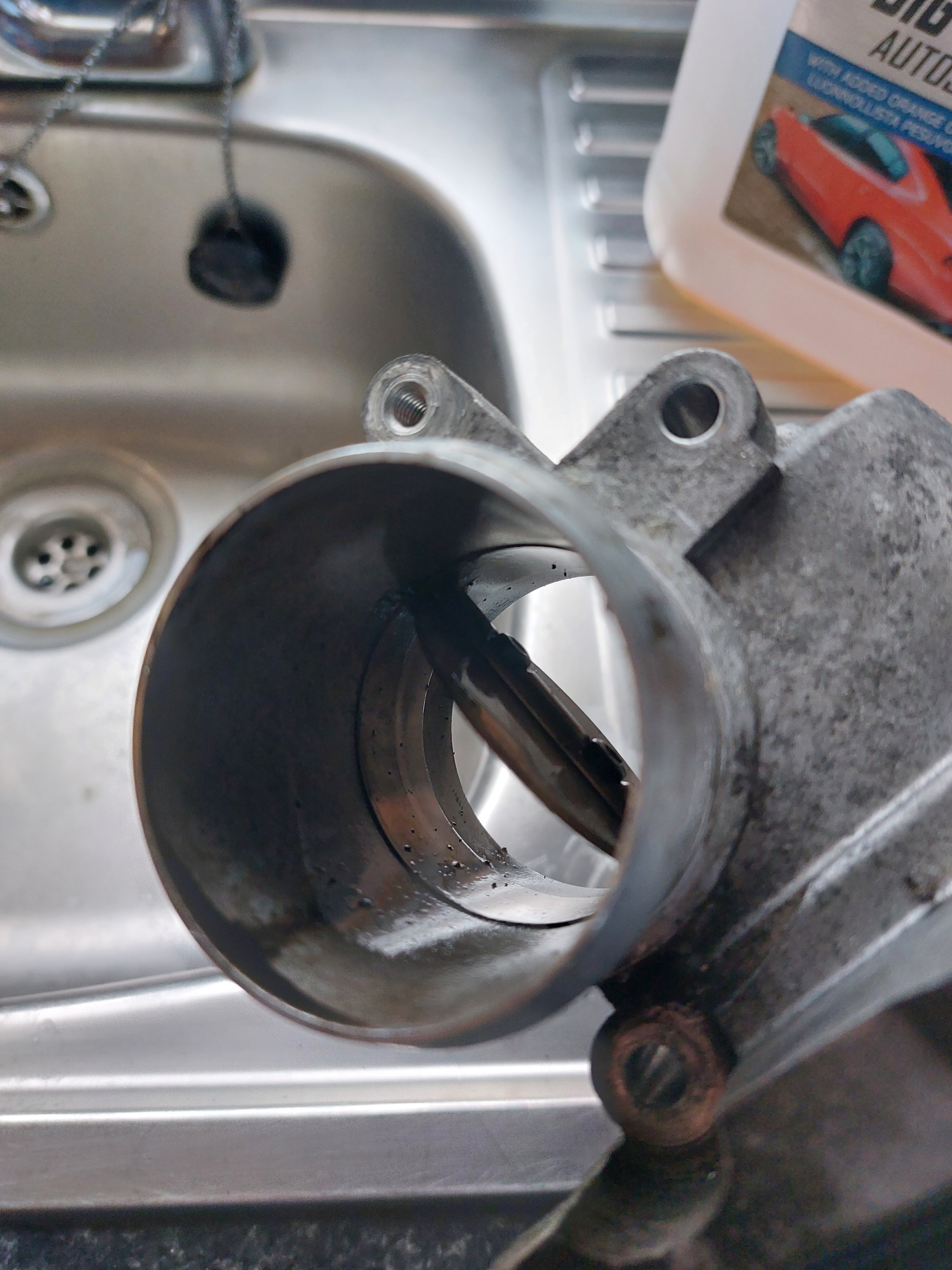

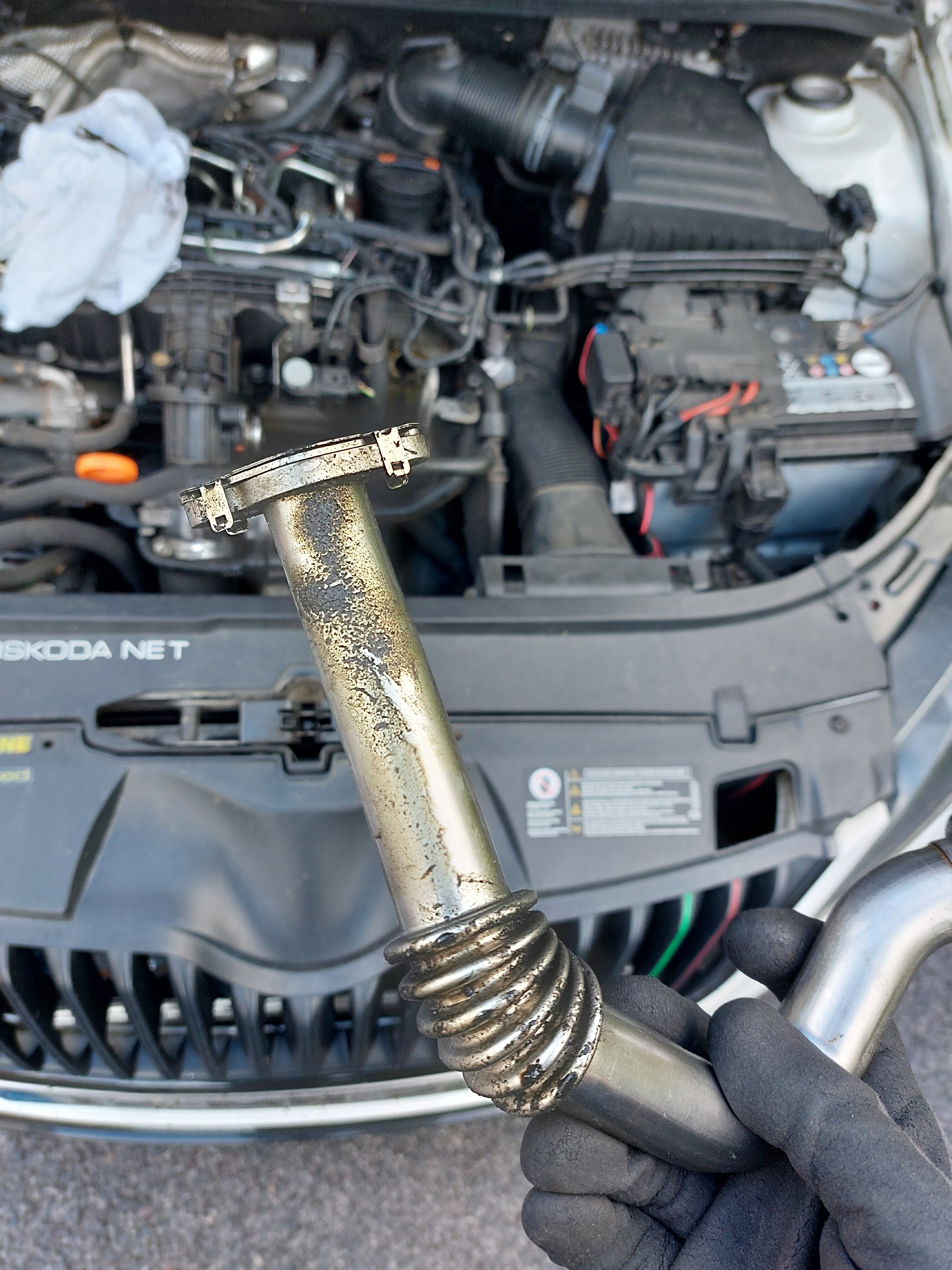

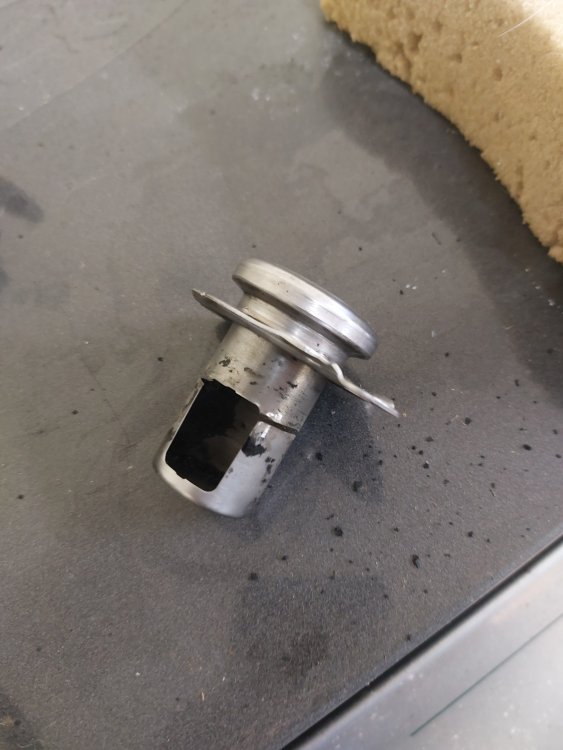

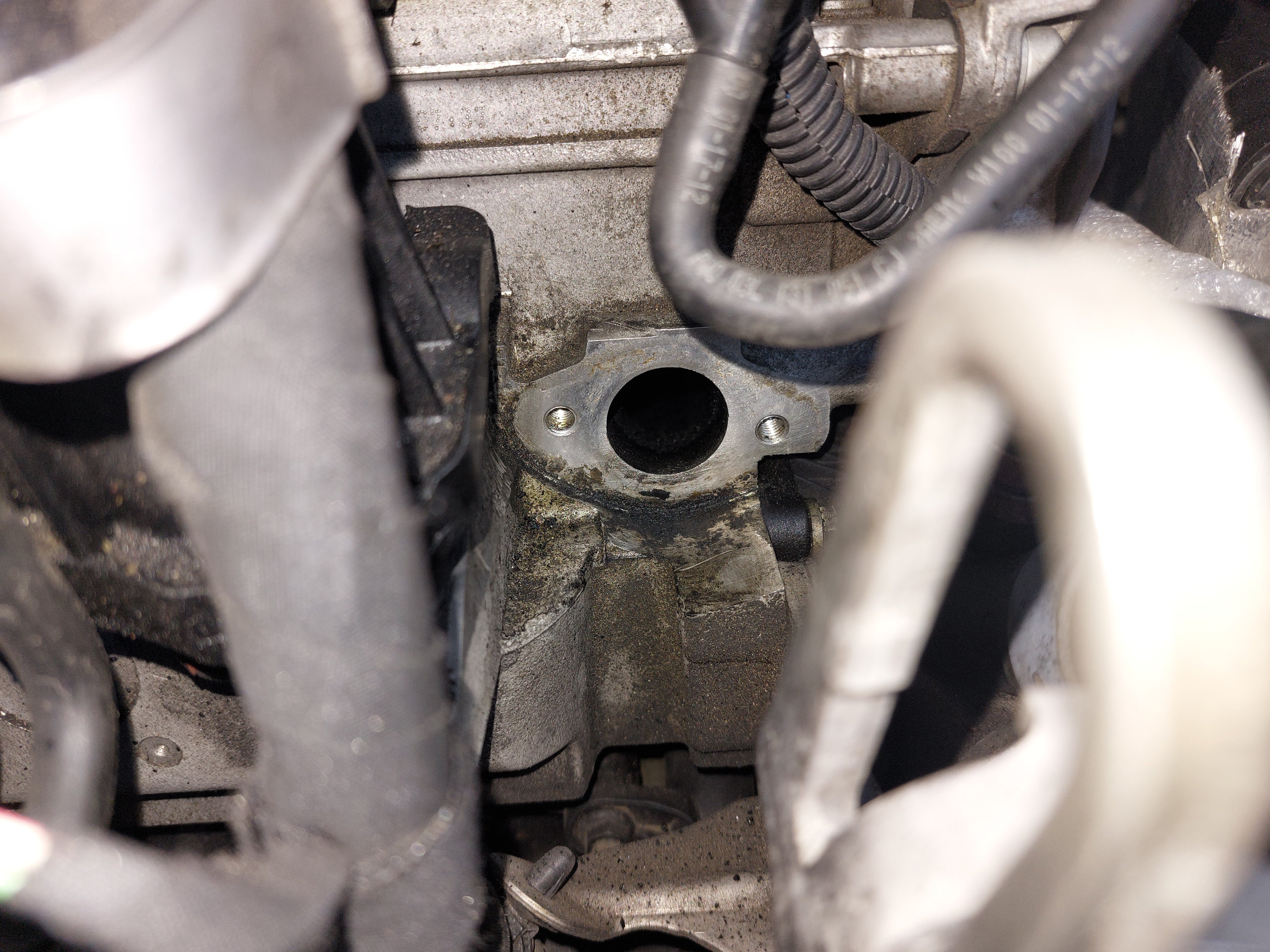

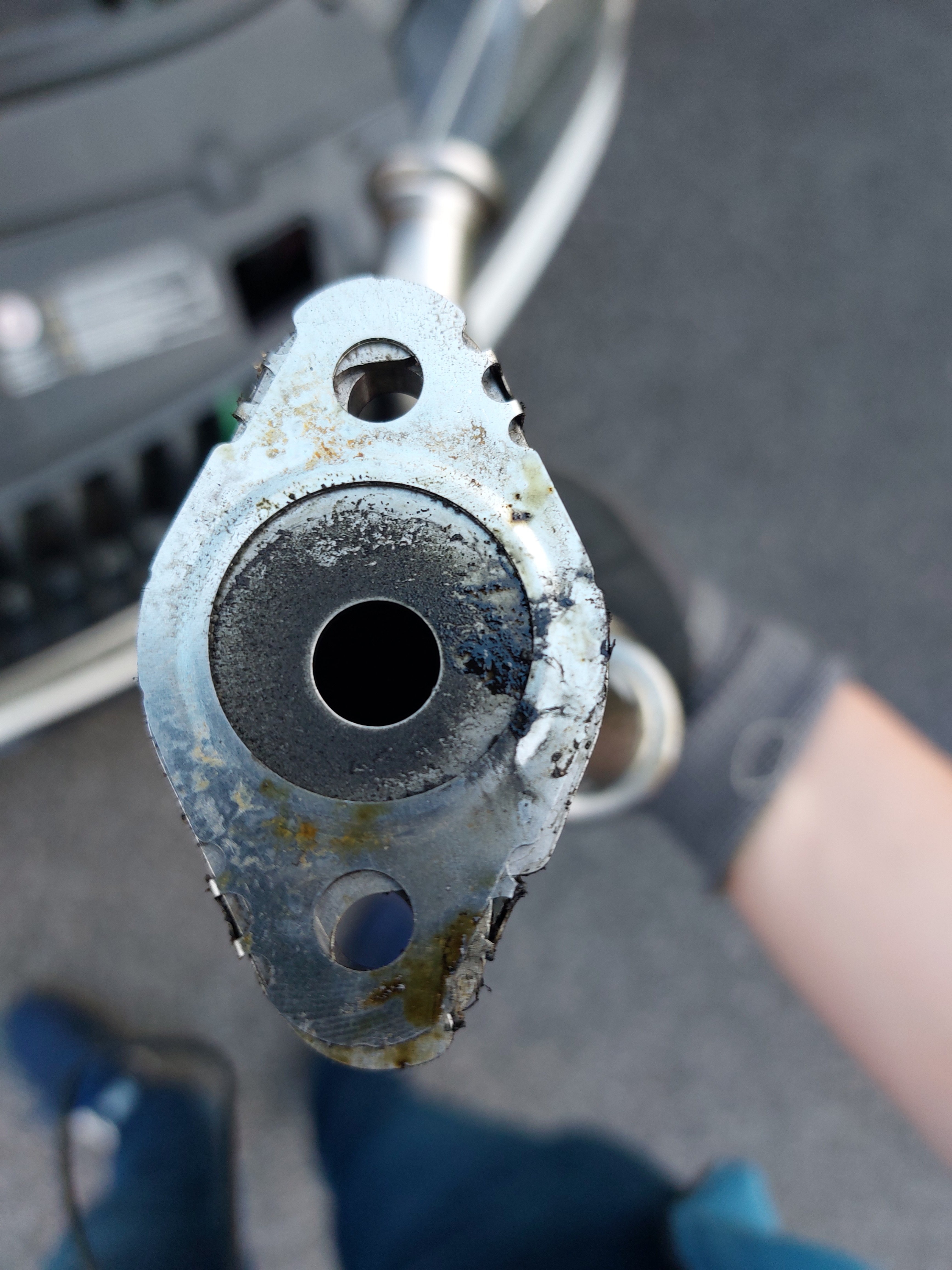

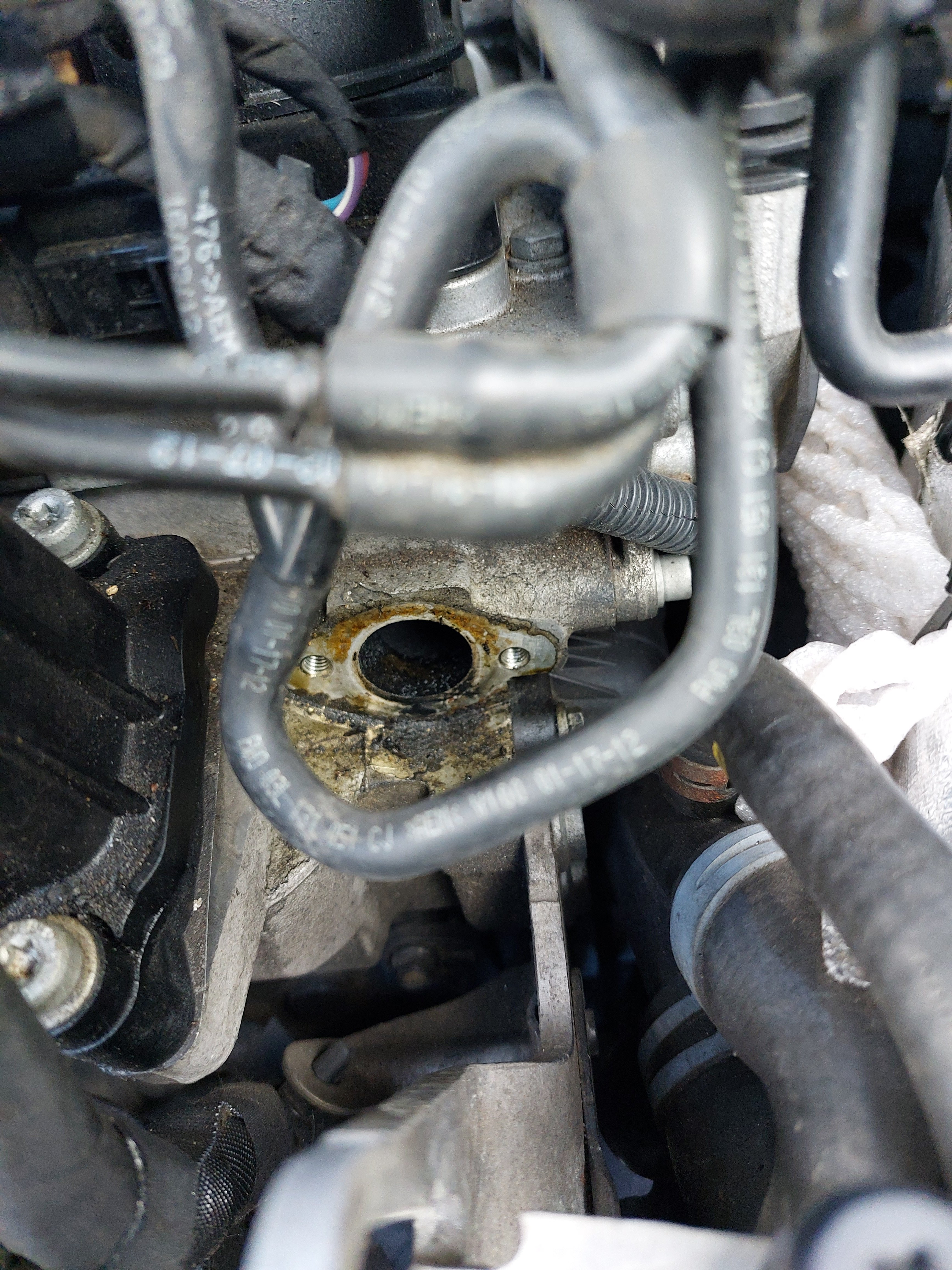

Took apart some of the EGR/Intake system for a clean. This was last off December of last year, and it's done plenty of miles since.
First thing I noticed was oil under this pipe, I think one or both gaskets are needing replacing.
Restrictor plate is doing its job

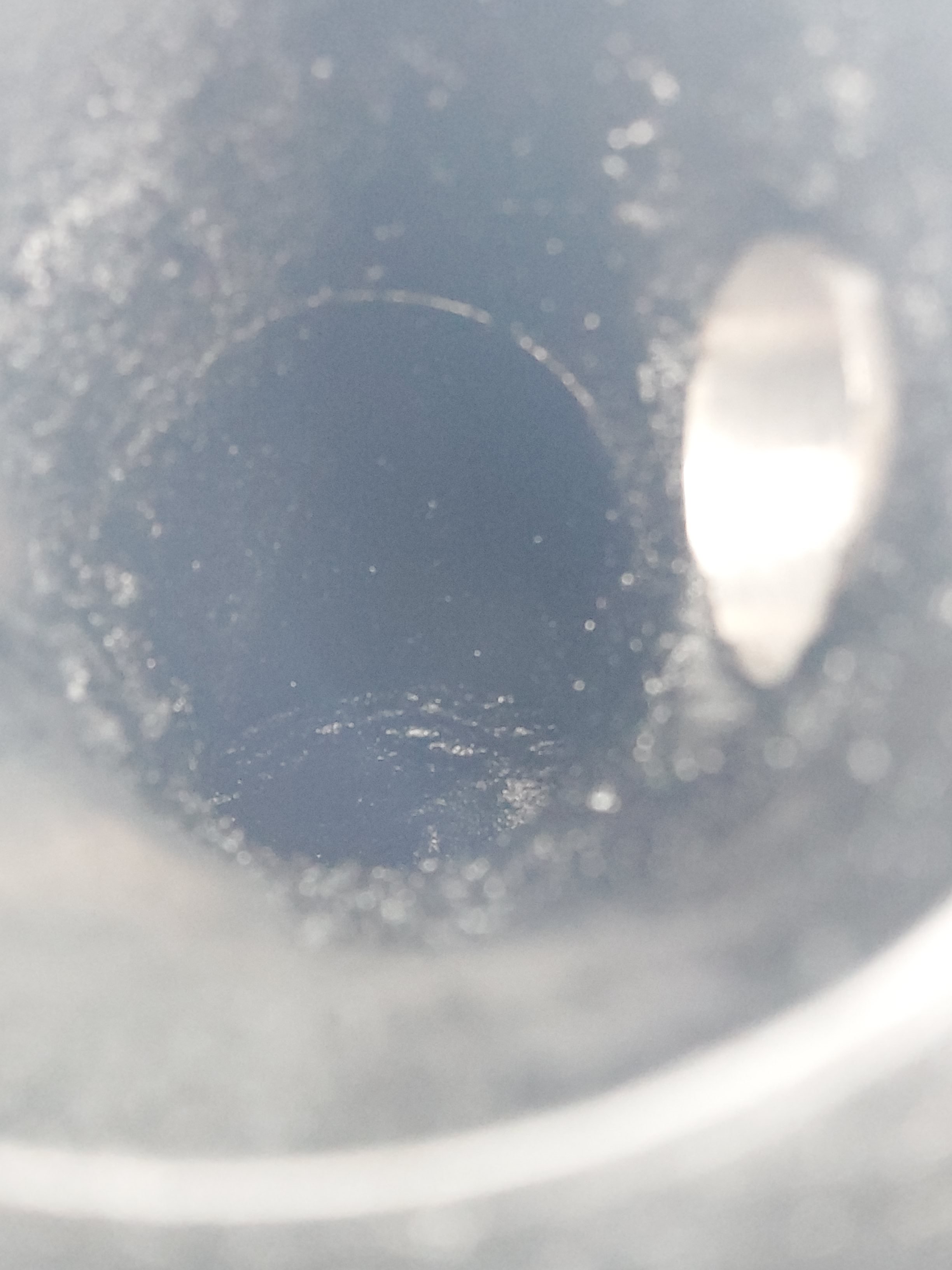

Rest of the system was very clean, mostly oil vapour instead of built up gunk like before.
Gave this a good clean before reassembling.

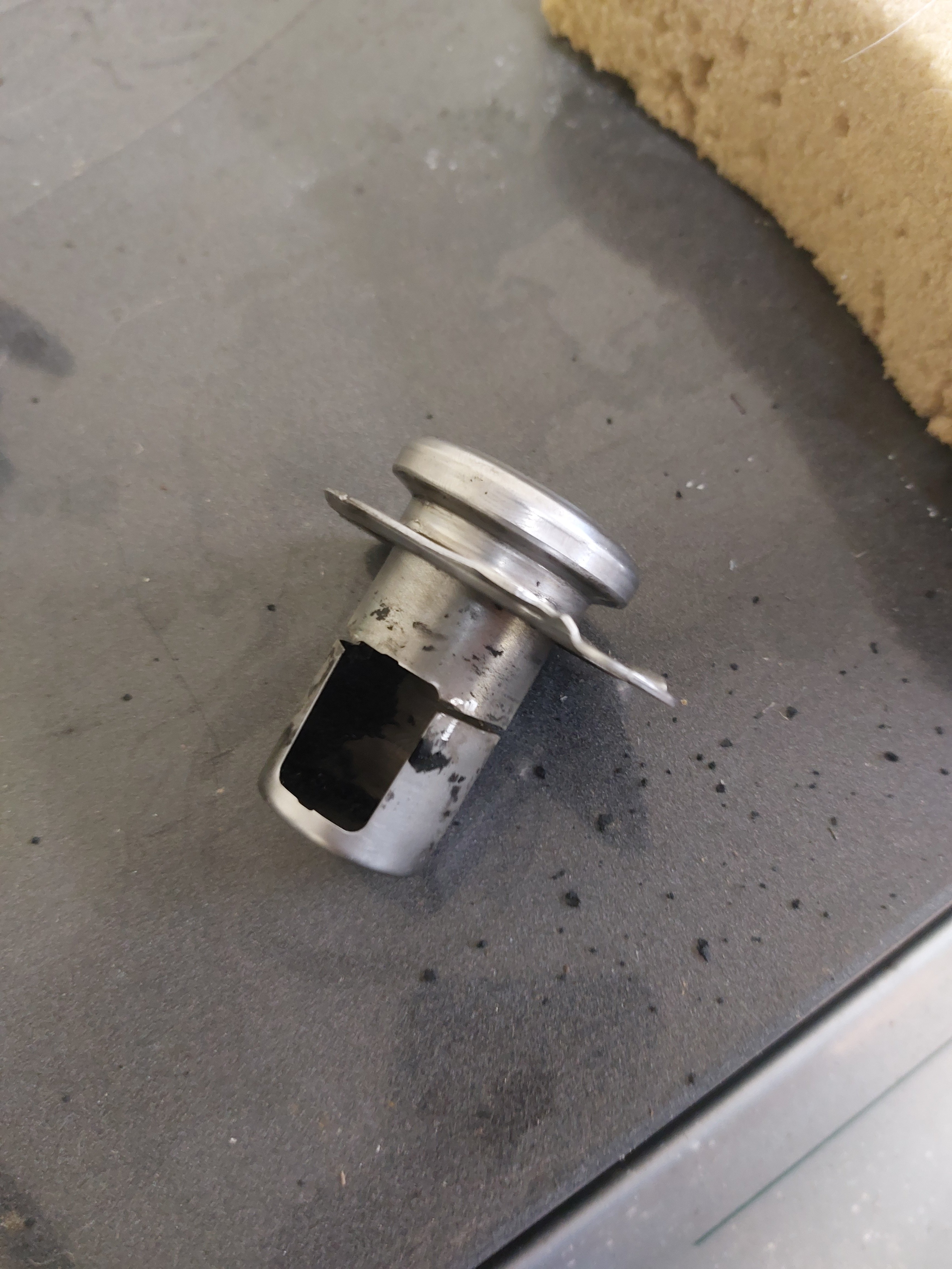

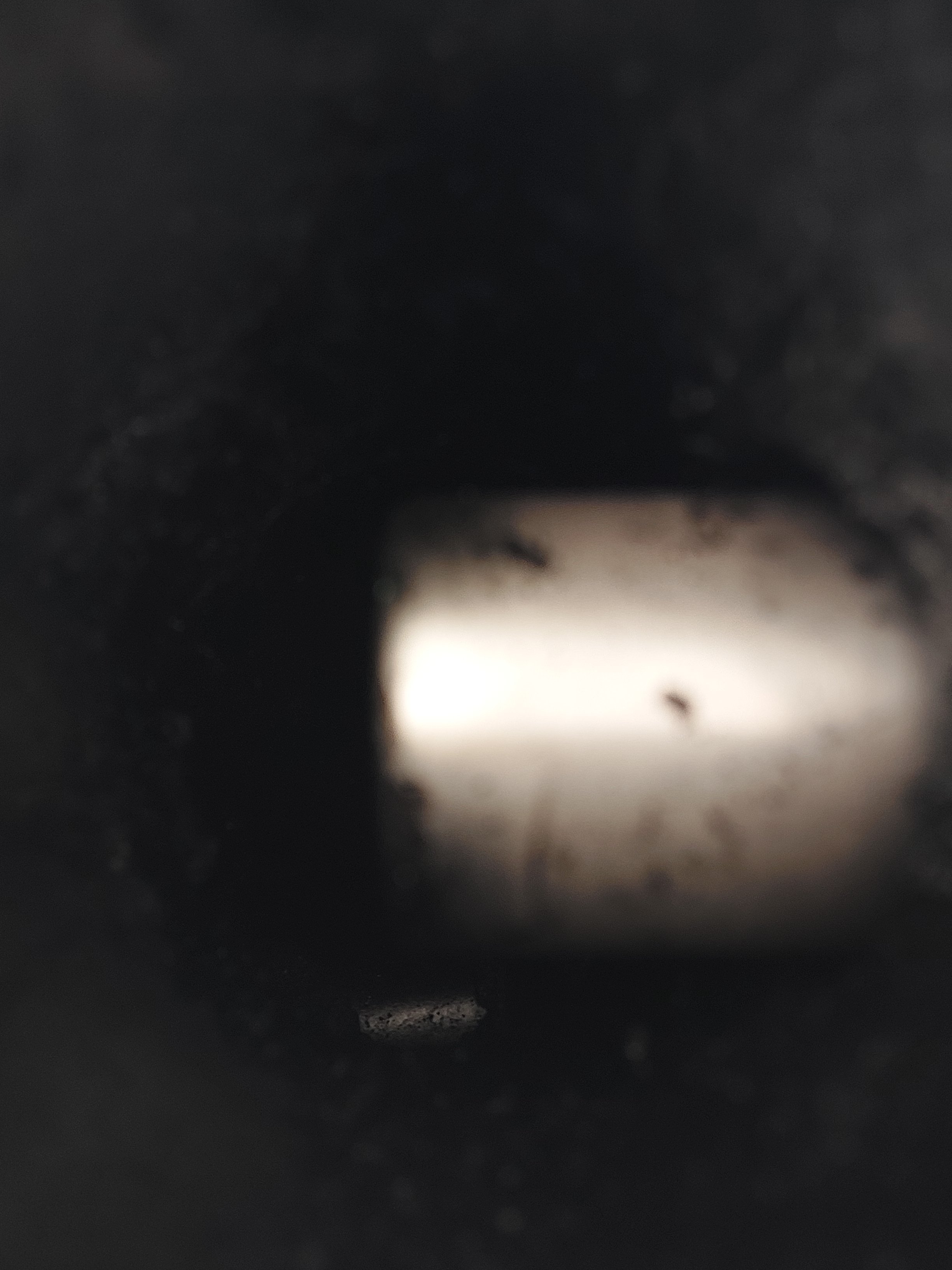

Anti shudder valve had basically no buildup, wiped off.

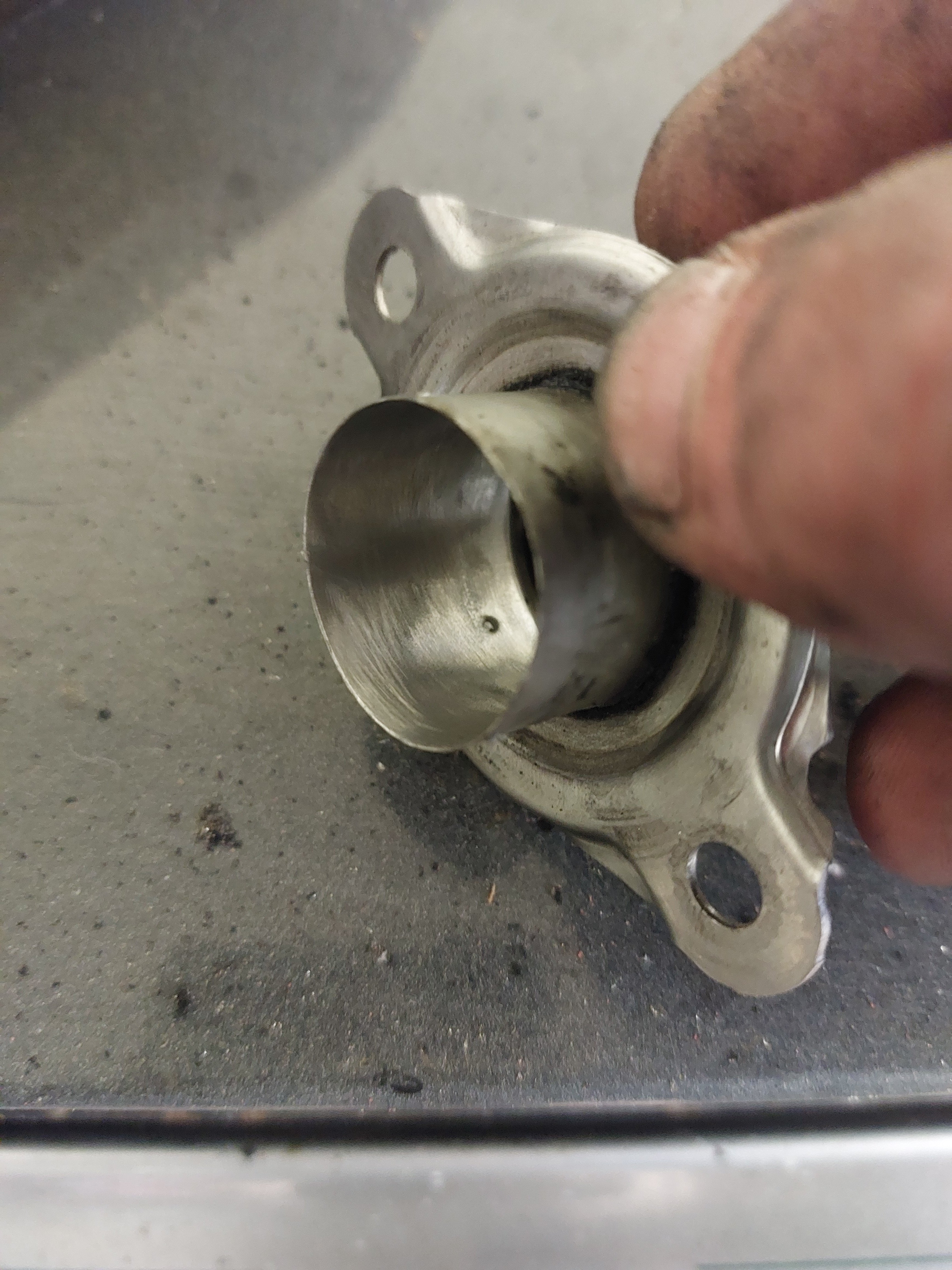

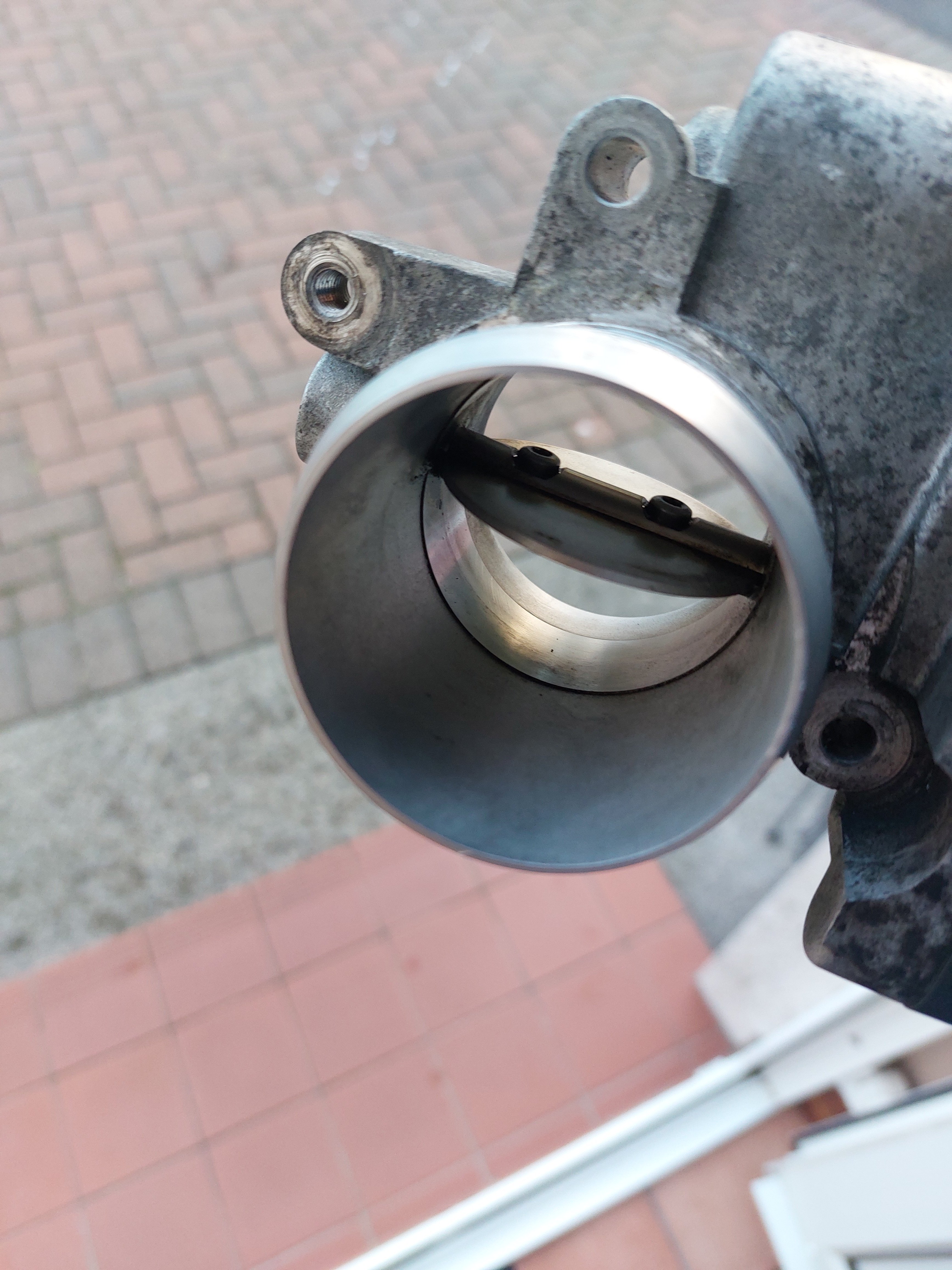

I did end up making a bit of a mod to the intake, never occurred to me how much the egr piece in the intake obstructs the air coming in.
So I decided to take it out and chop a lump off.
End Result:
While I highly doubt this'll make any noticeable impact, I hope it'll make the engine breath a bit easier
Do want to clean the intake manifold properly if I get the chance.

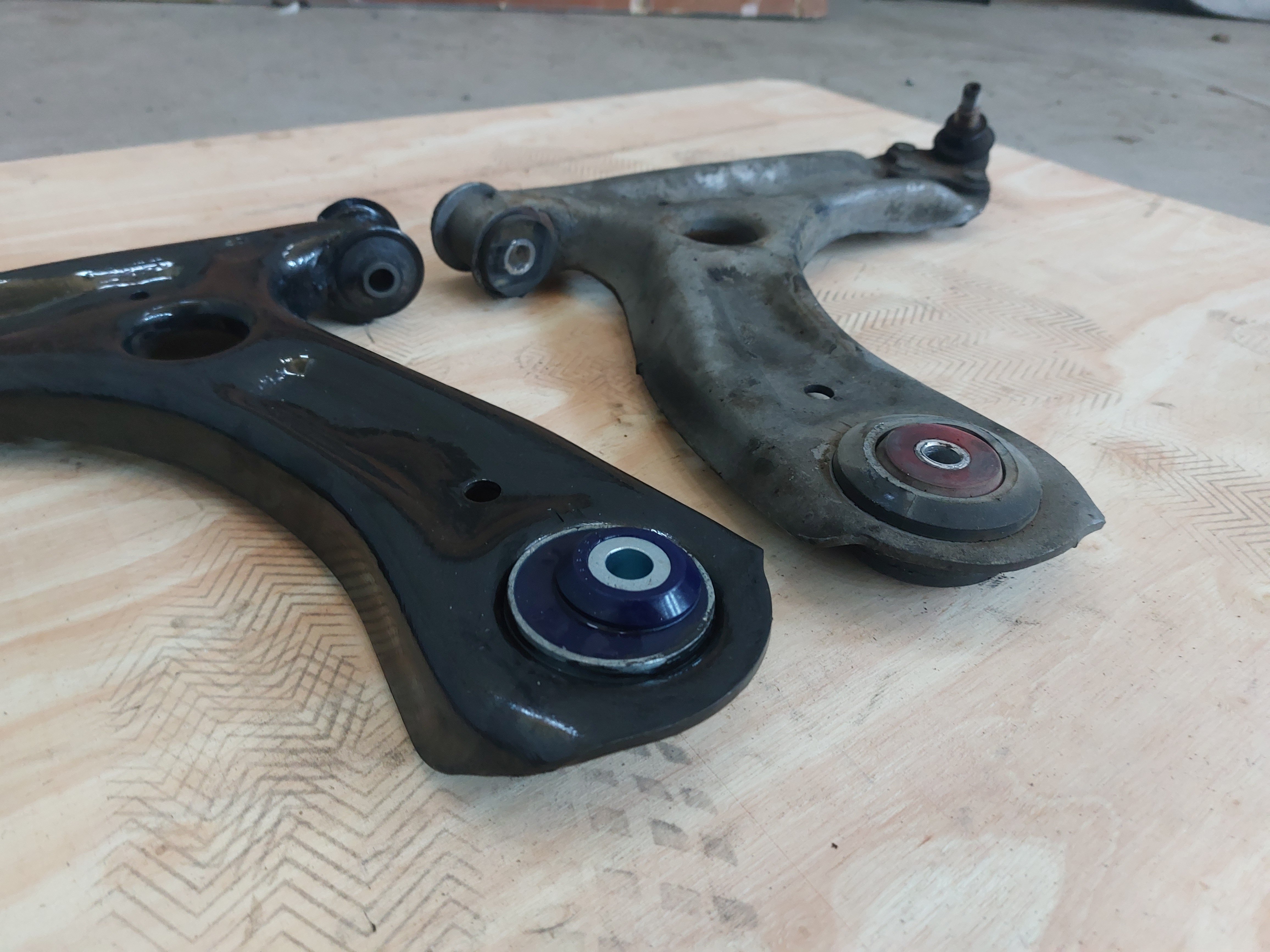

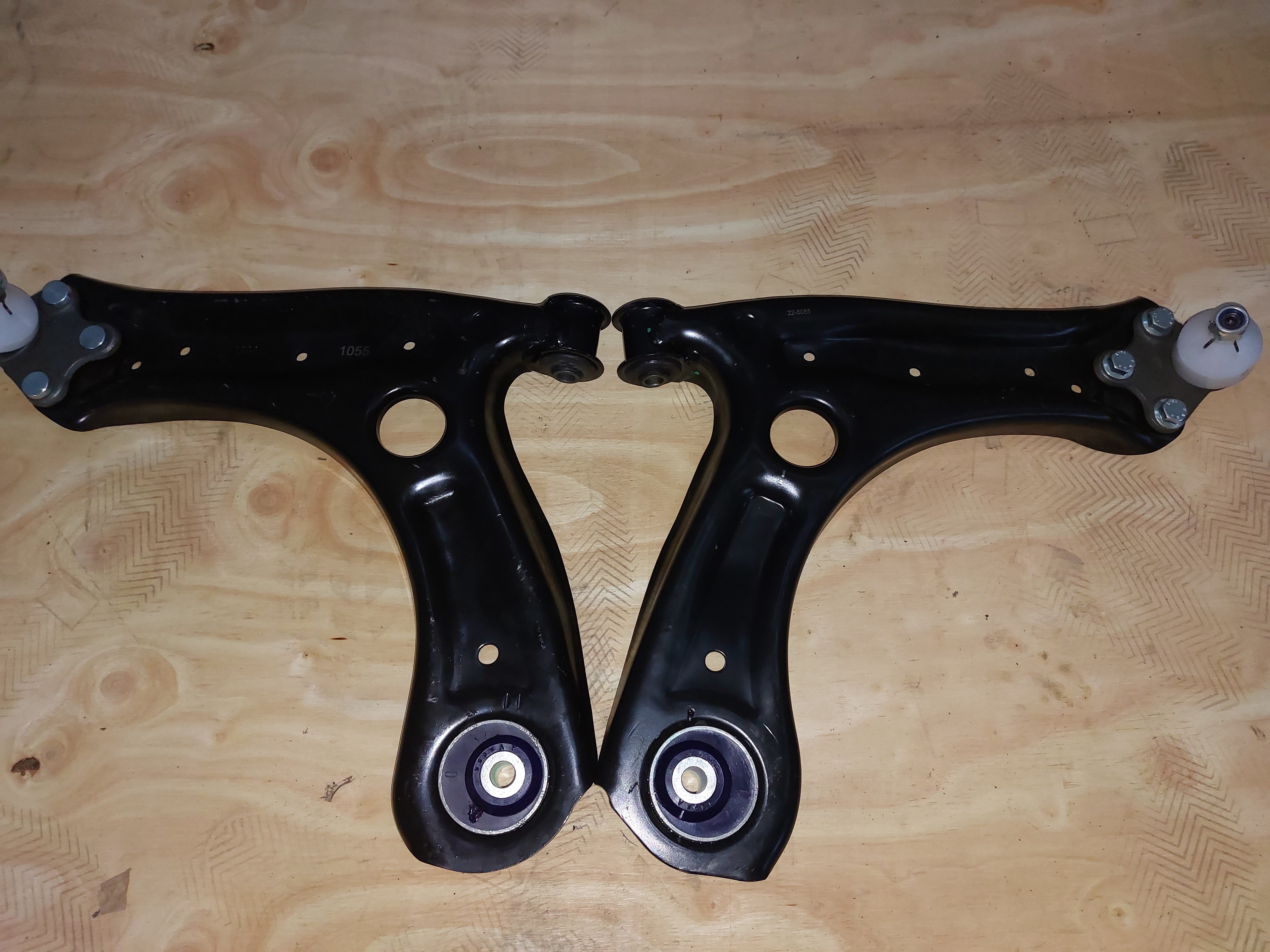

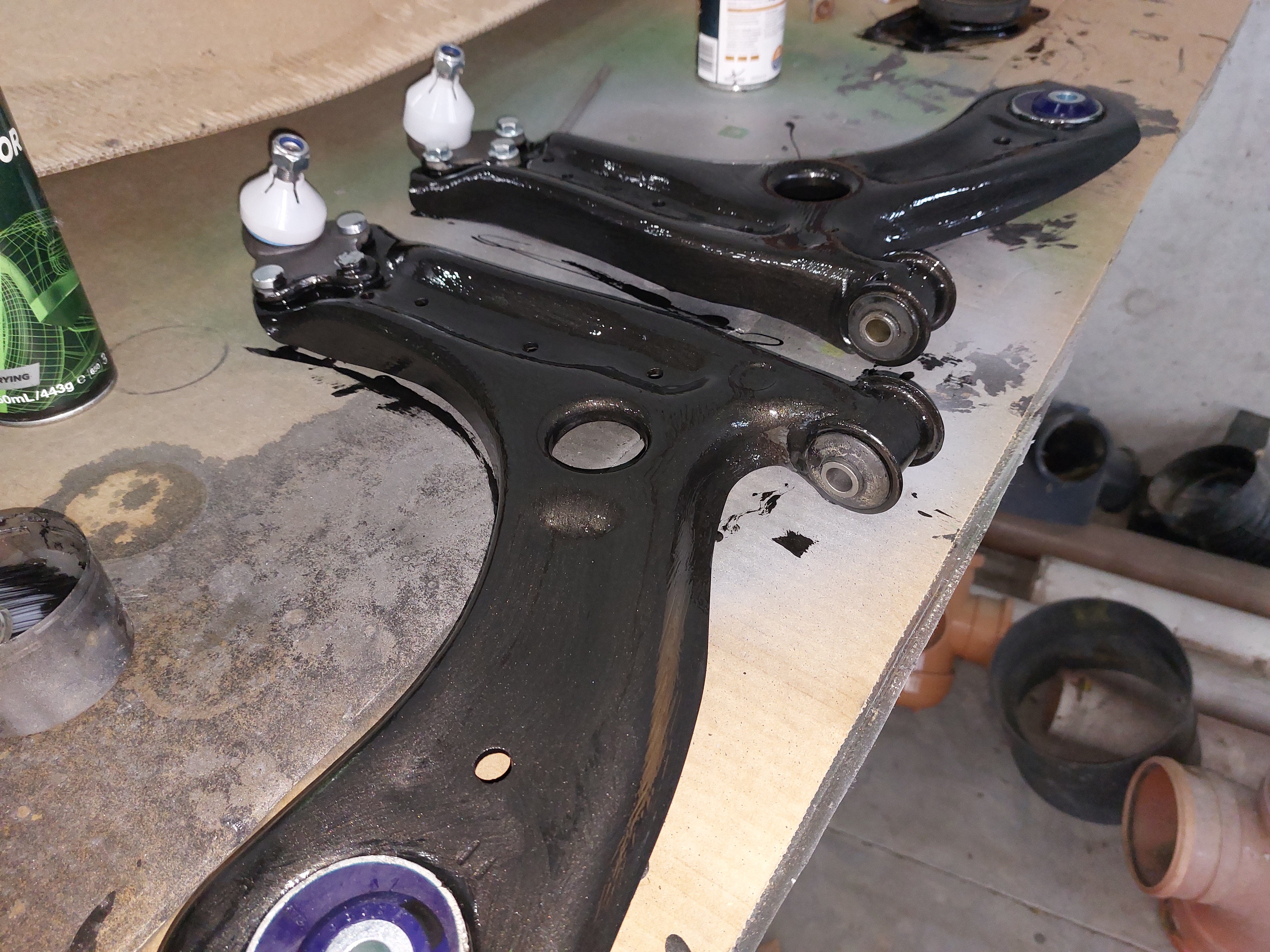

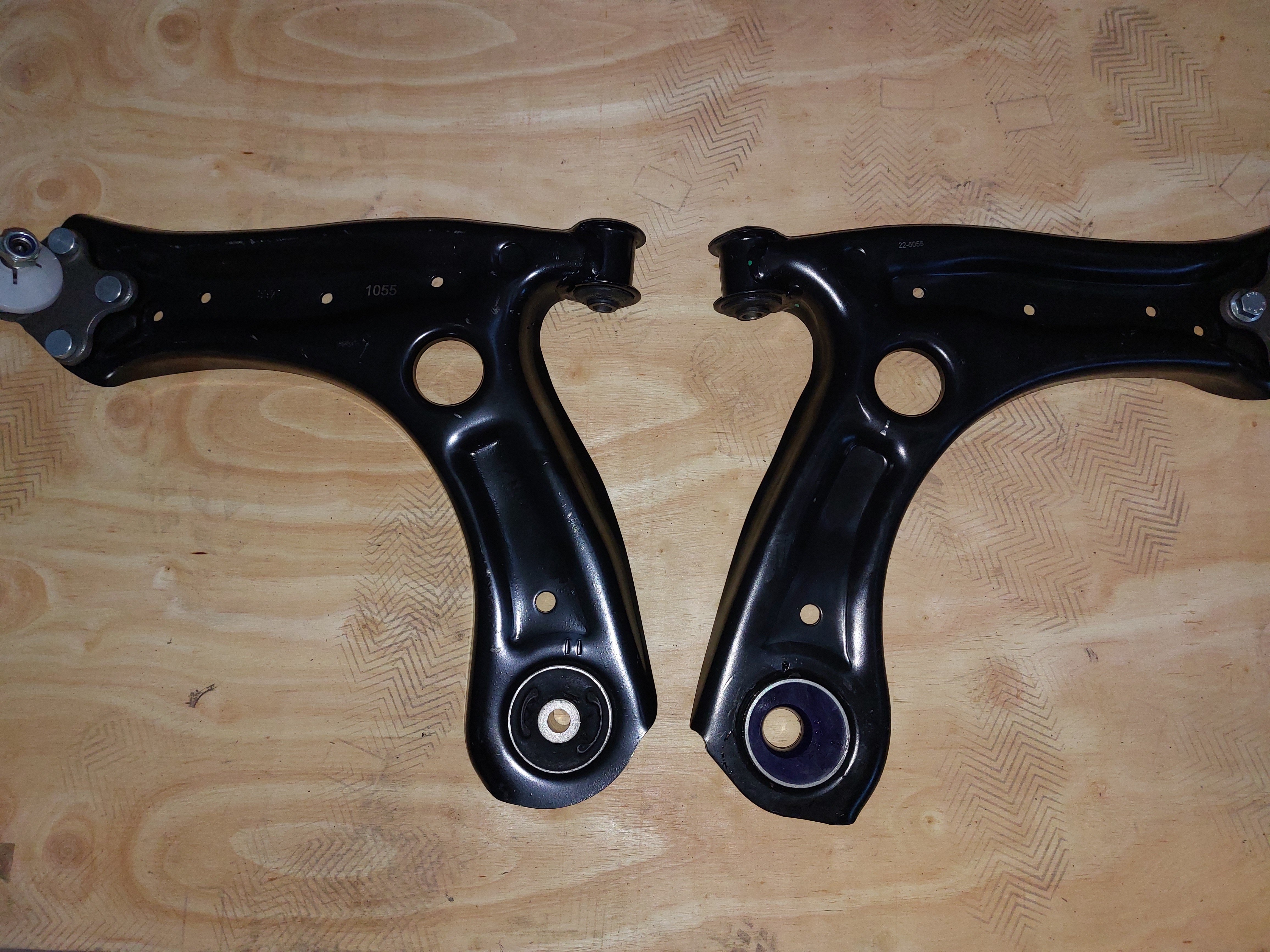

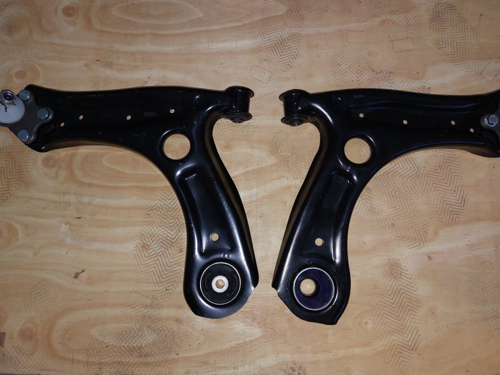

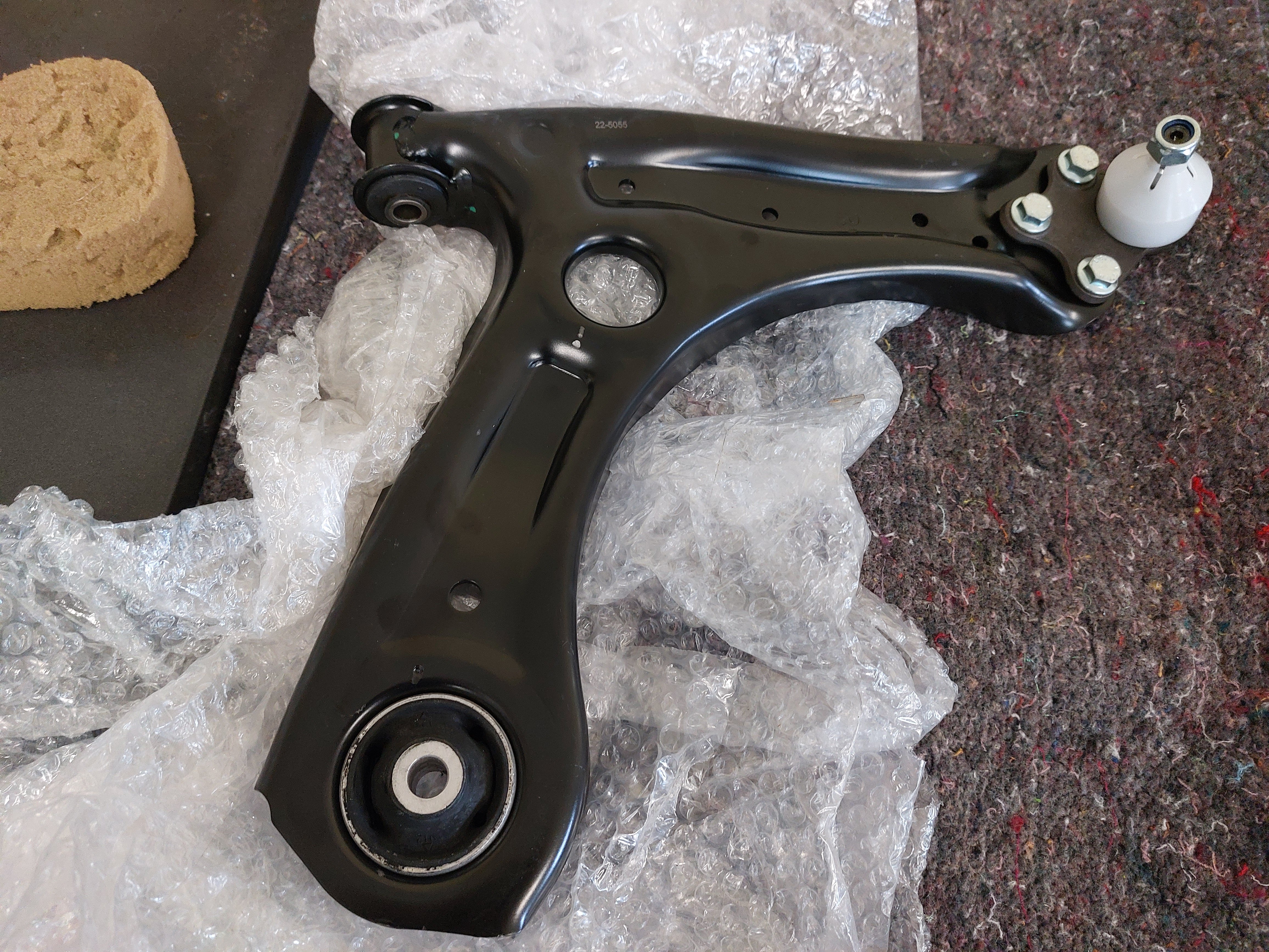

I was a bit worried about those superpro bushes, didn't want to gamble on taking the car apart only to find they needed to be pressed into my old bushes.
So I bought new Wishbones.
Approx £25 each, including bushes and ball joints.
Used a vice to press the old bushes out, and the superpro ones in.
These bushes being offset need to be clocked so the hole is near the inside of the car.
Fully assembled.
Painted them hammered black, ready to go into the car next day.
Choosing to keep the front wishbone rubber, as its a solid bush it doesn't make a bit of difference if I keep it rubber or switch to Poly.

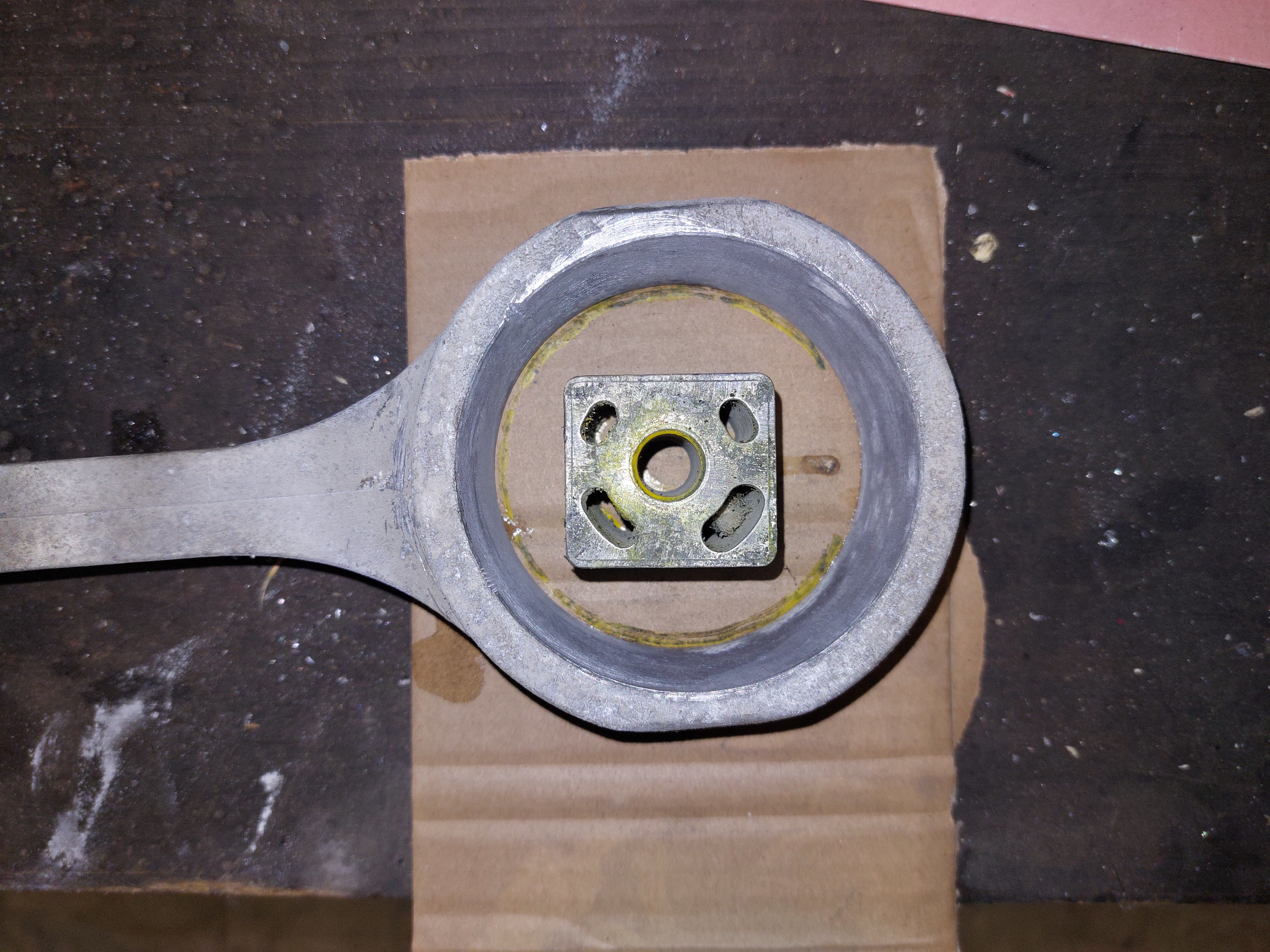

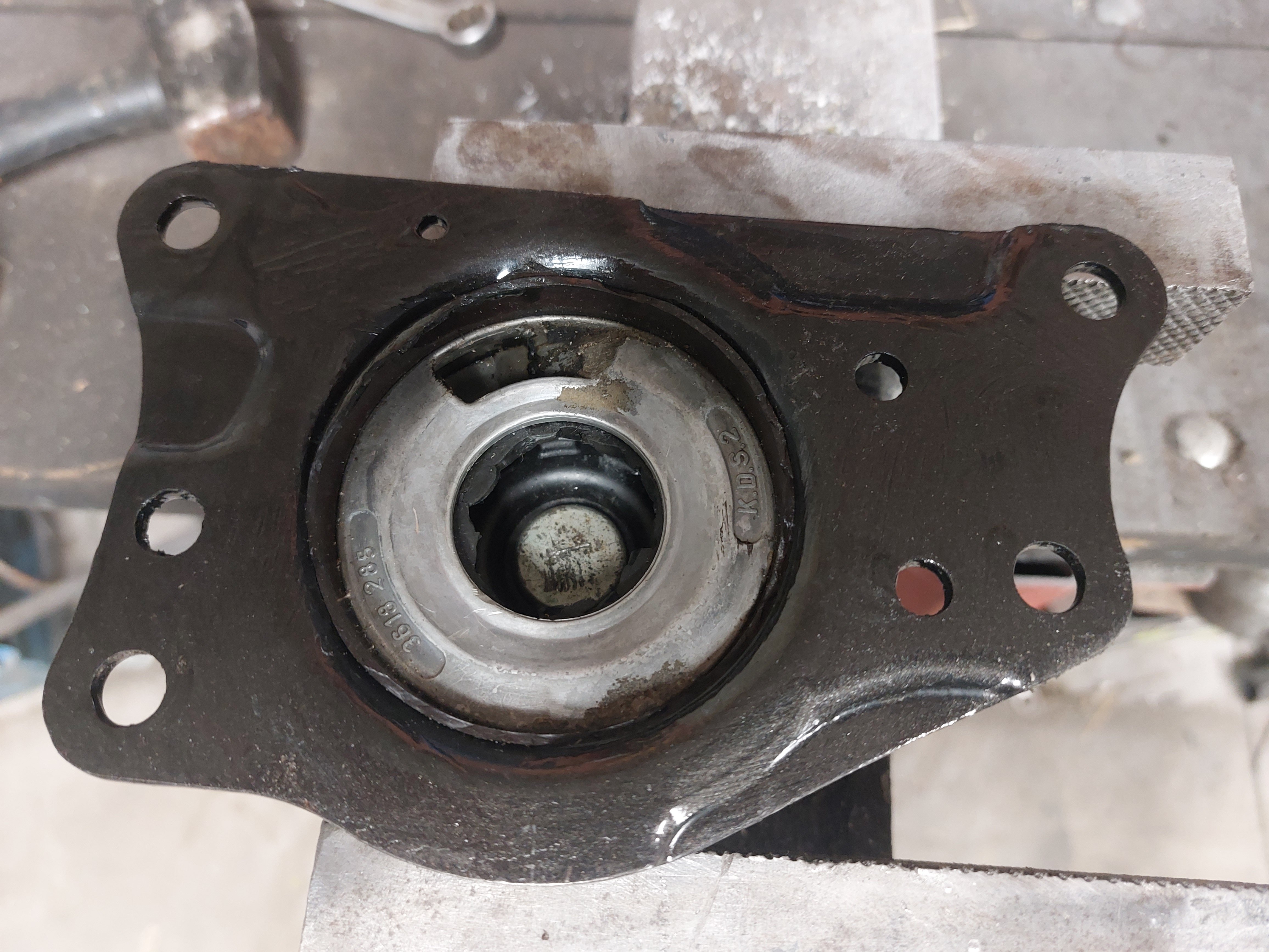

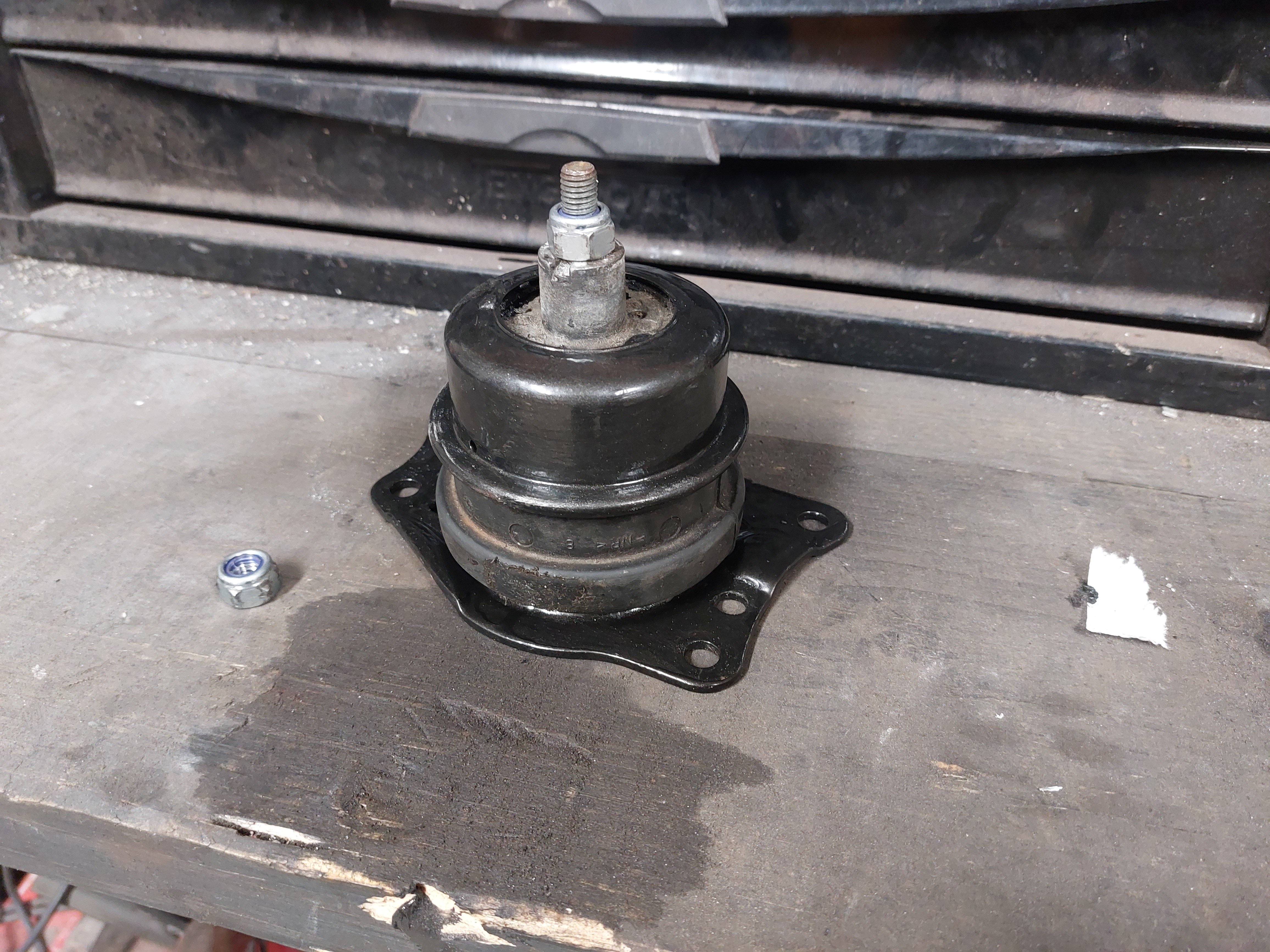

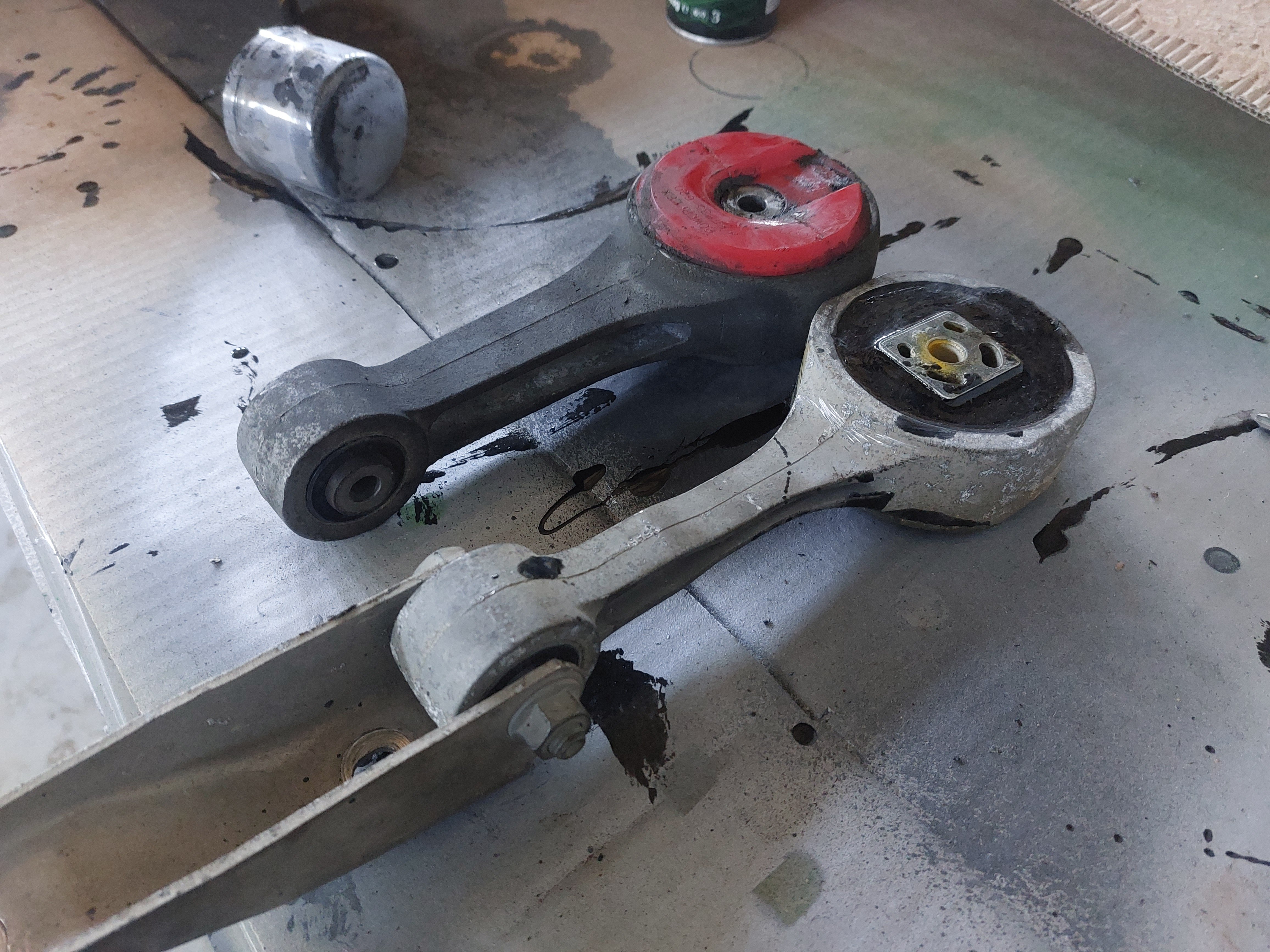

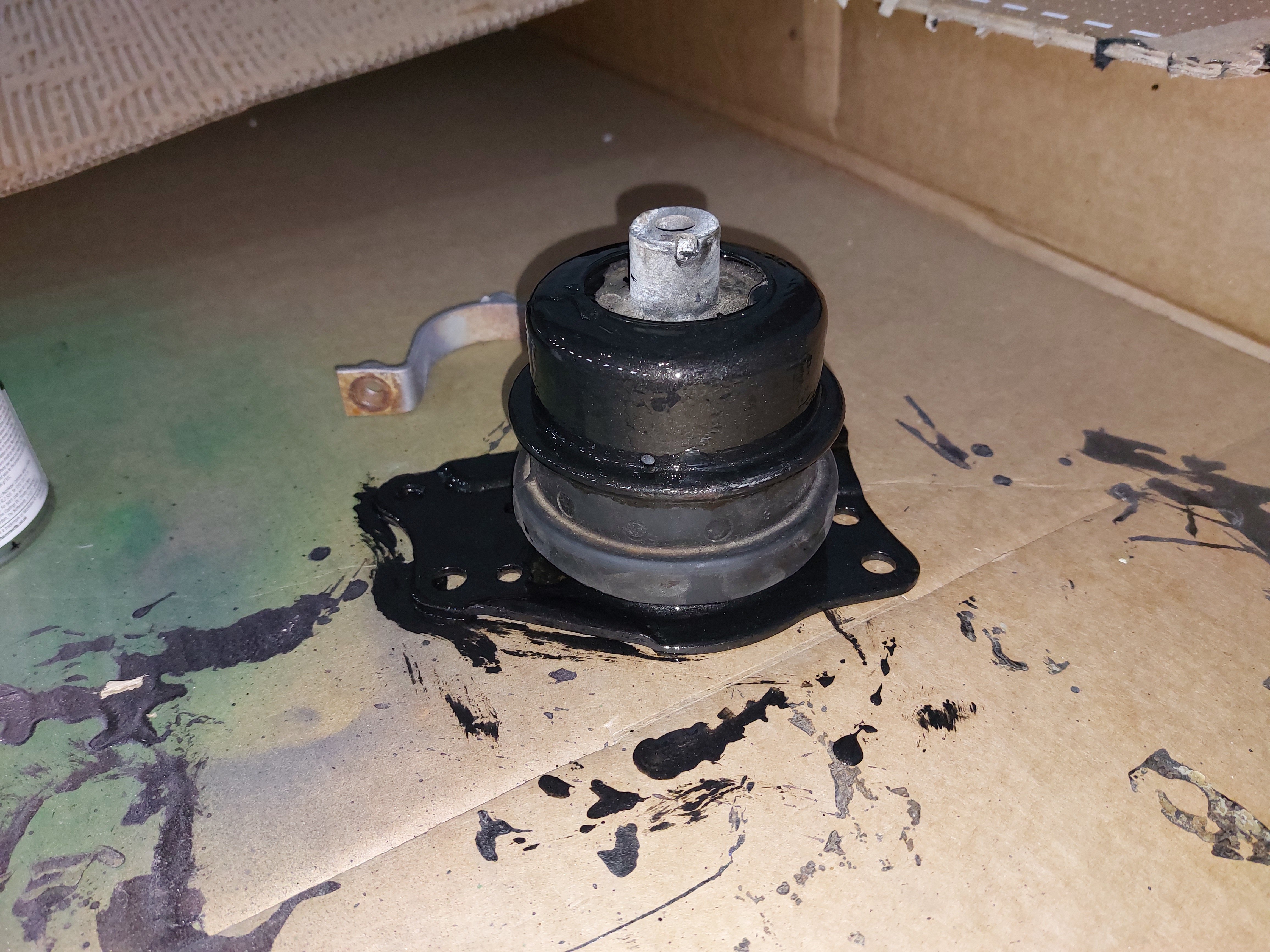

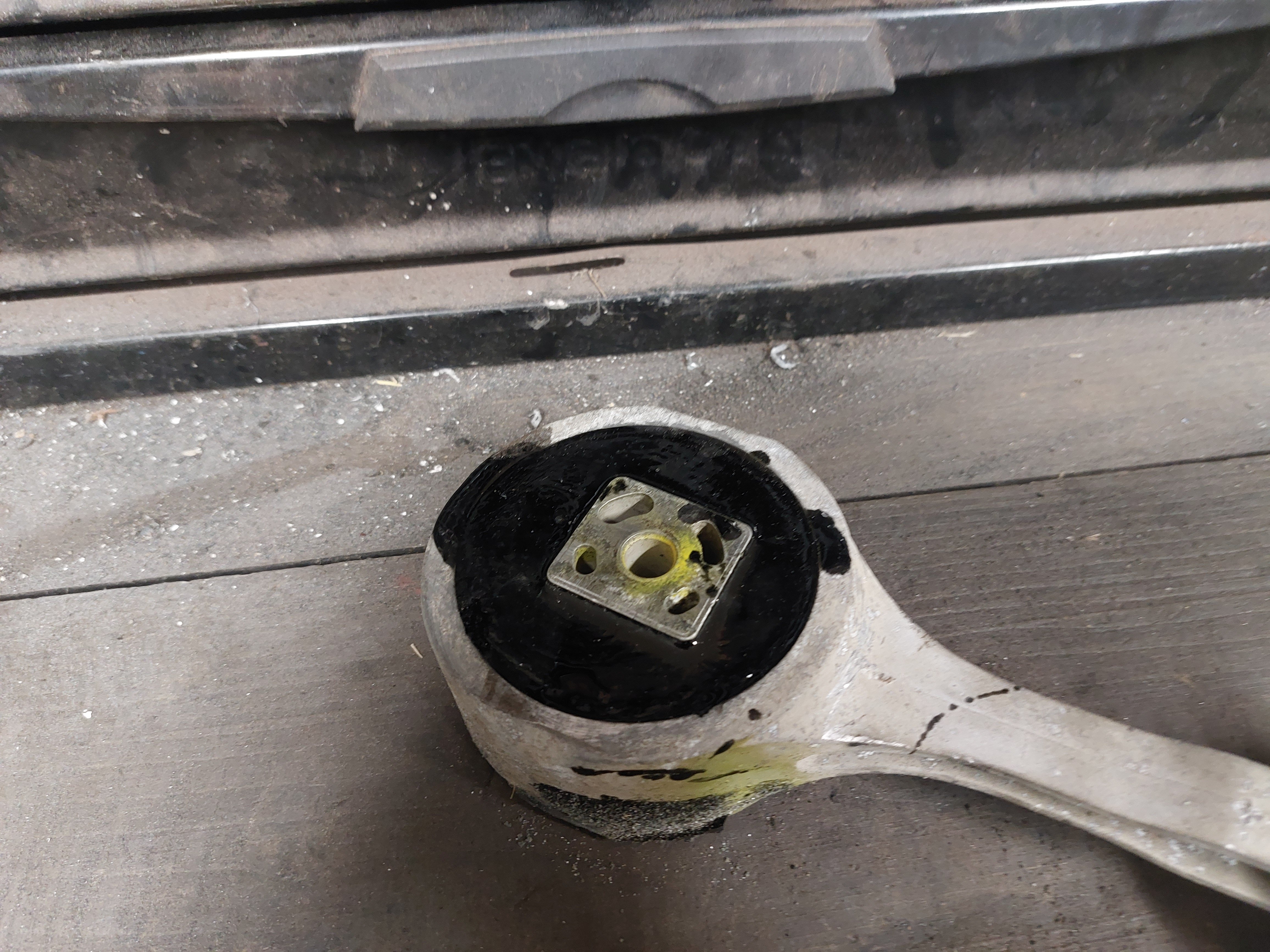

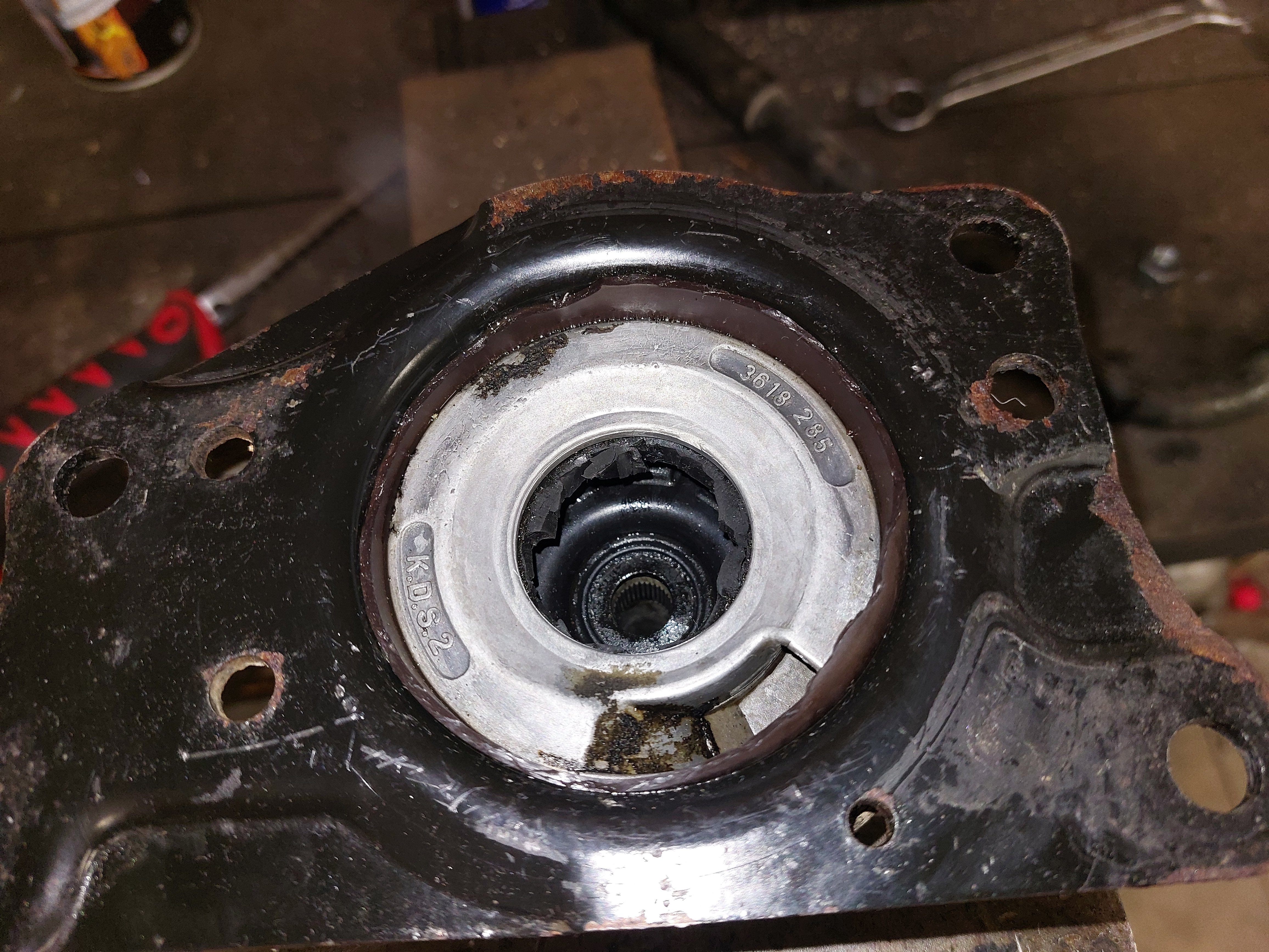

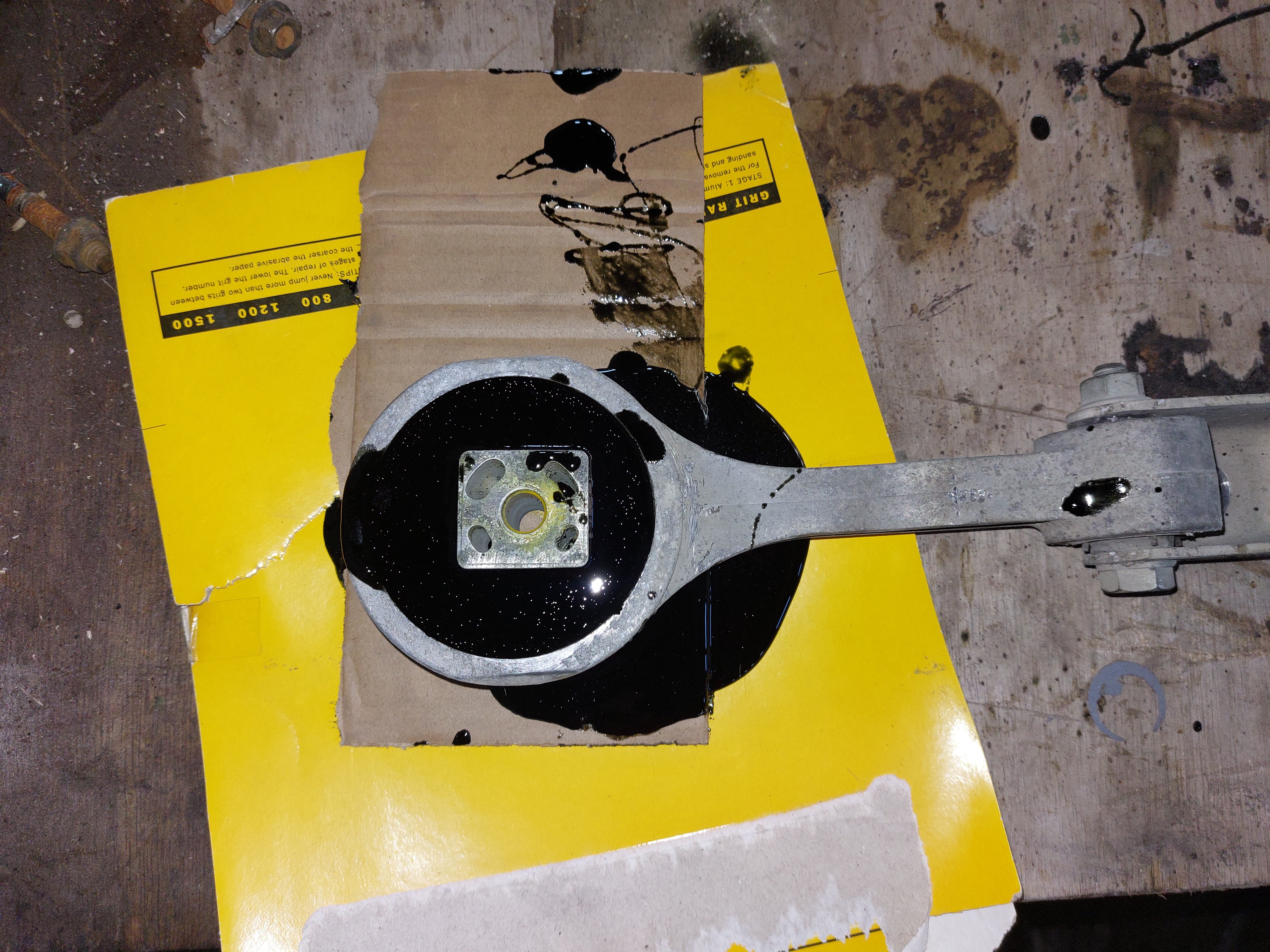

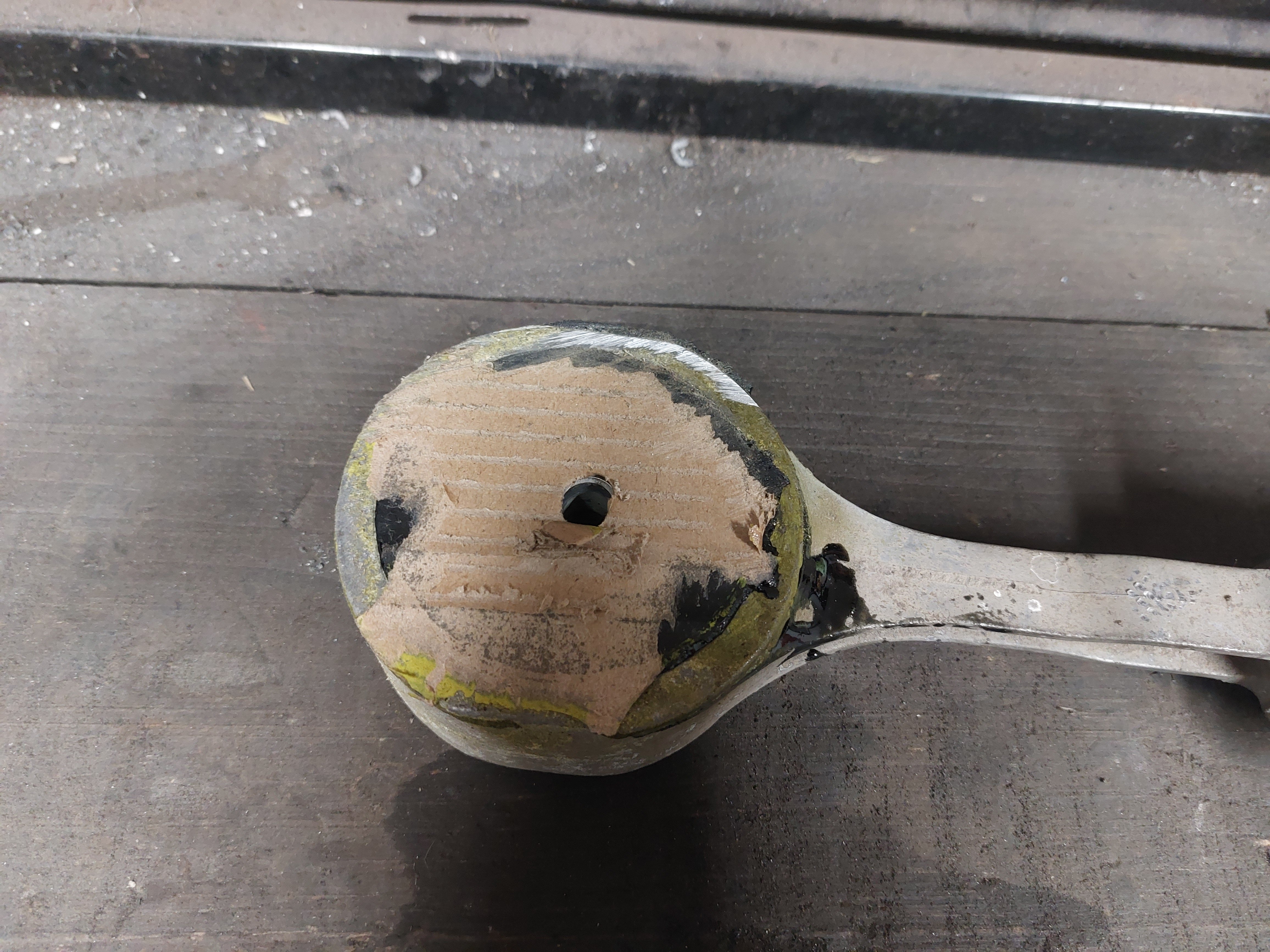

Also, Made a start on some new engine mounts. This time however I'm using proper polyurethane instead of tigerseal.

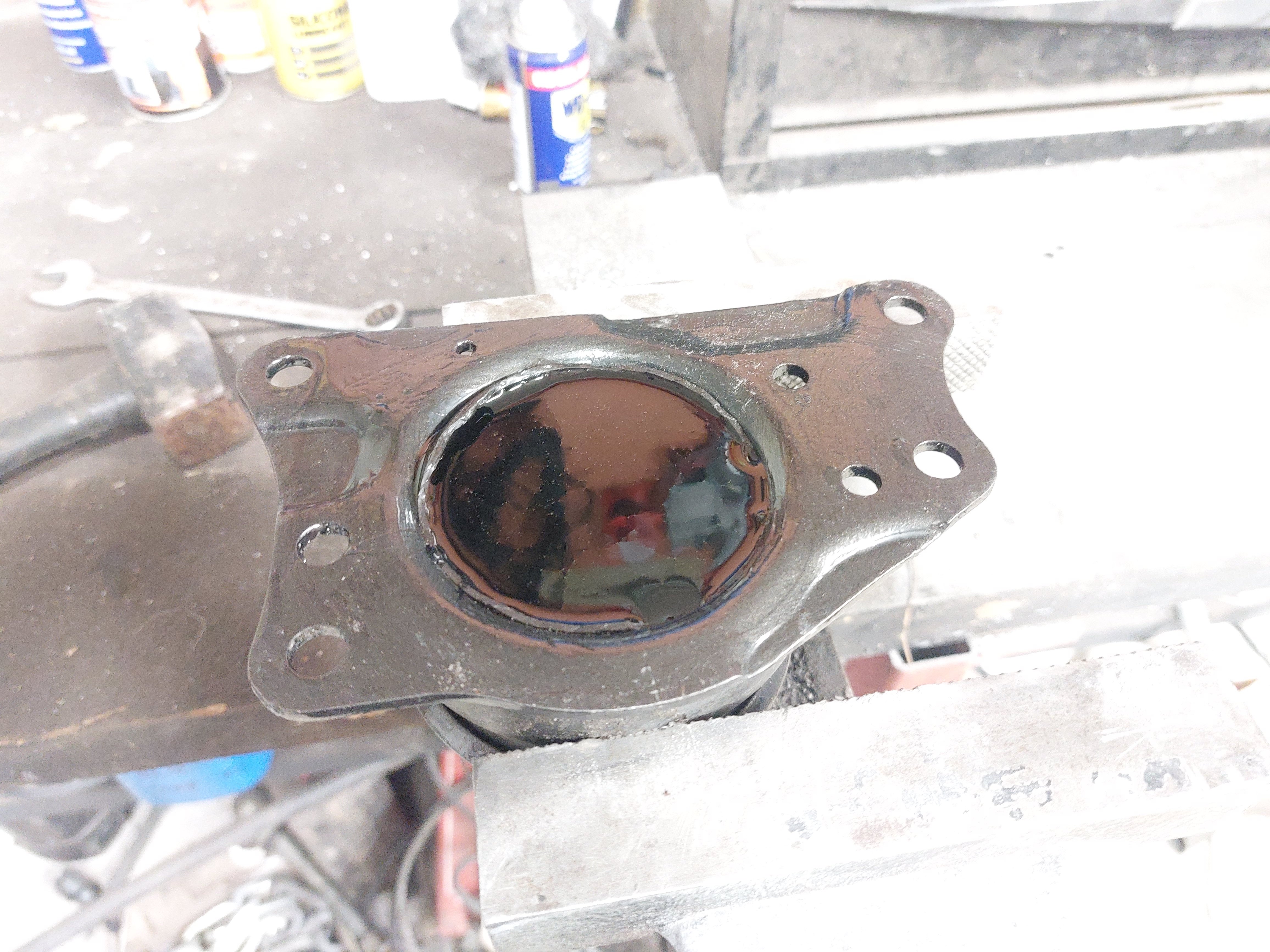

Gutted an old engine side Hydroil mount, gave it a deep clean and paint ready to be filled next day.
Also did a dogbone mount, came off the 1.2l petrol fabia I got the subframe for the mk1 from a while back.
Filled this with 70 shore hardness stuff, spilled quite a bit because I hadn't sealed it properly to the cardboard.
Debating whether or not to use 60 shore stuff on the hydroil mount.
This dogbone will go onto the Monte, I have a powerflex bush in it now, but it is a 65 shore one and I want one that's just a bit firmer.
Made a bit of a mess but otherwise went OK.

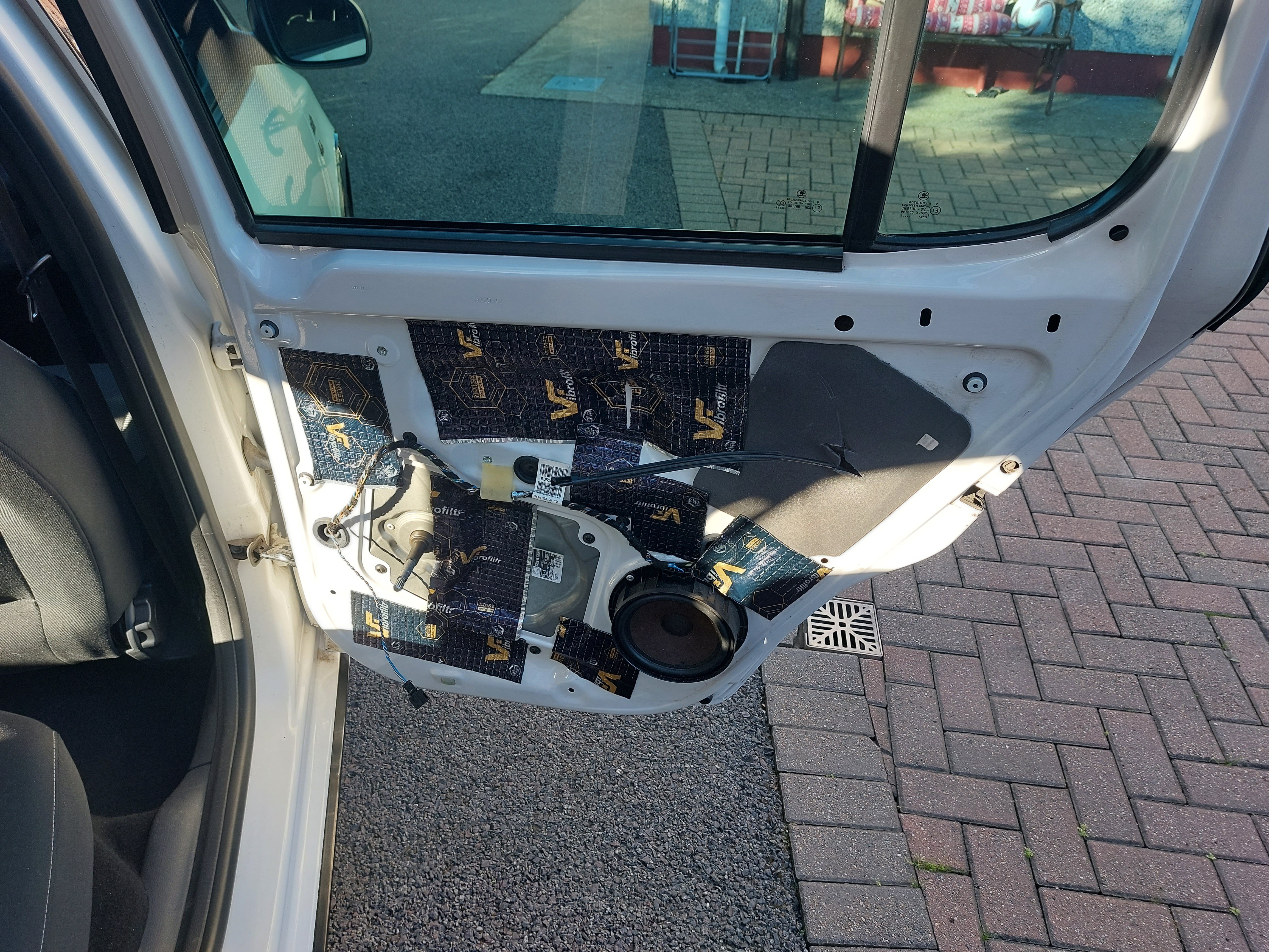

Rear doors done

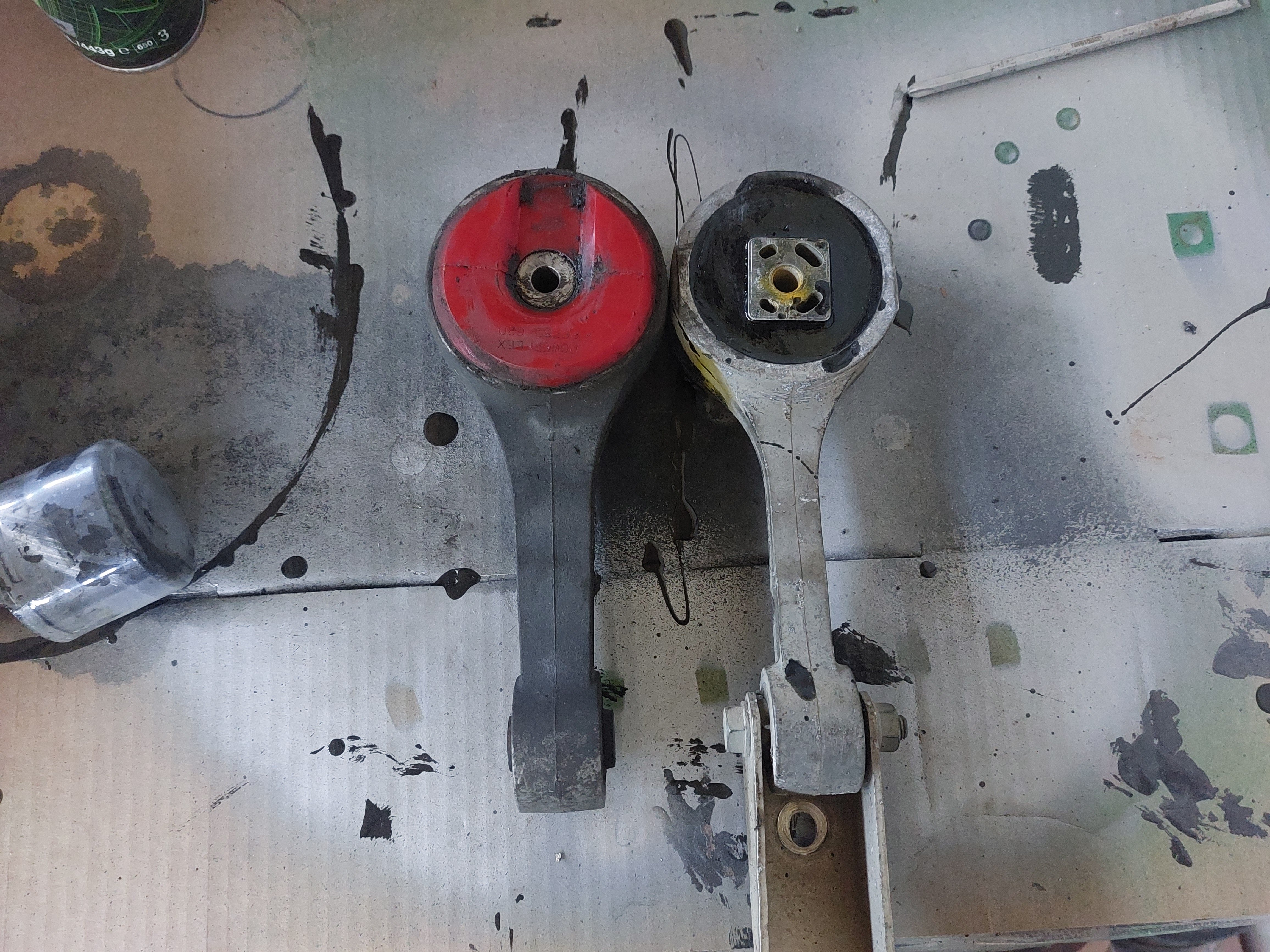

New dogbones done and installed
Not the prettiest but anyway.
Only realised swapping them out that a Mk1 dogbones different to the one originally on the mk2
In the car, it's very firm at idle
Powerflex is a 65 shore  hardness and mine is a 70.
Think it'll need reliefs drilled into it just to take the edge off it. Off idle it is superb however.
Filled the hydroil mount with 60 shore stuff.
Should be a good balance I think.
Dyed black even though it'll never be seen.

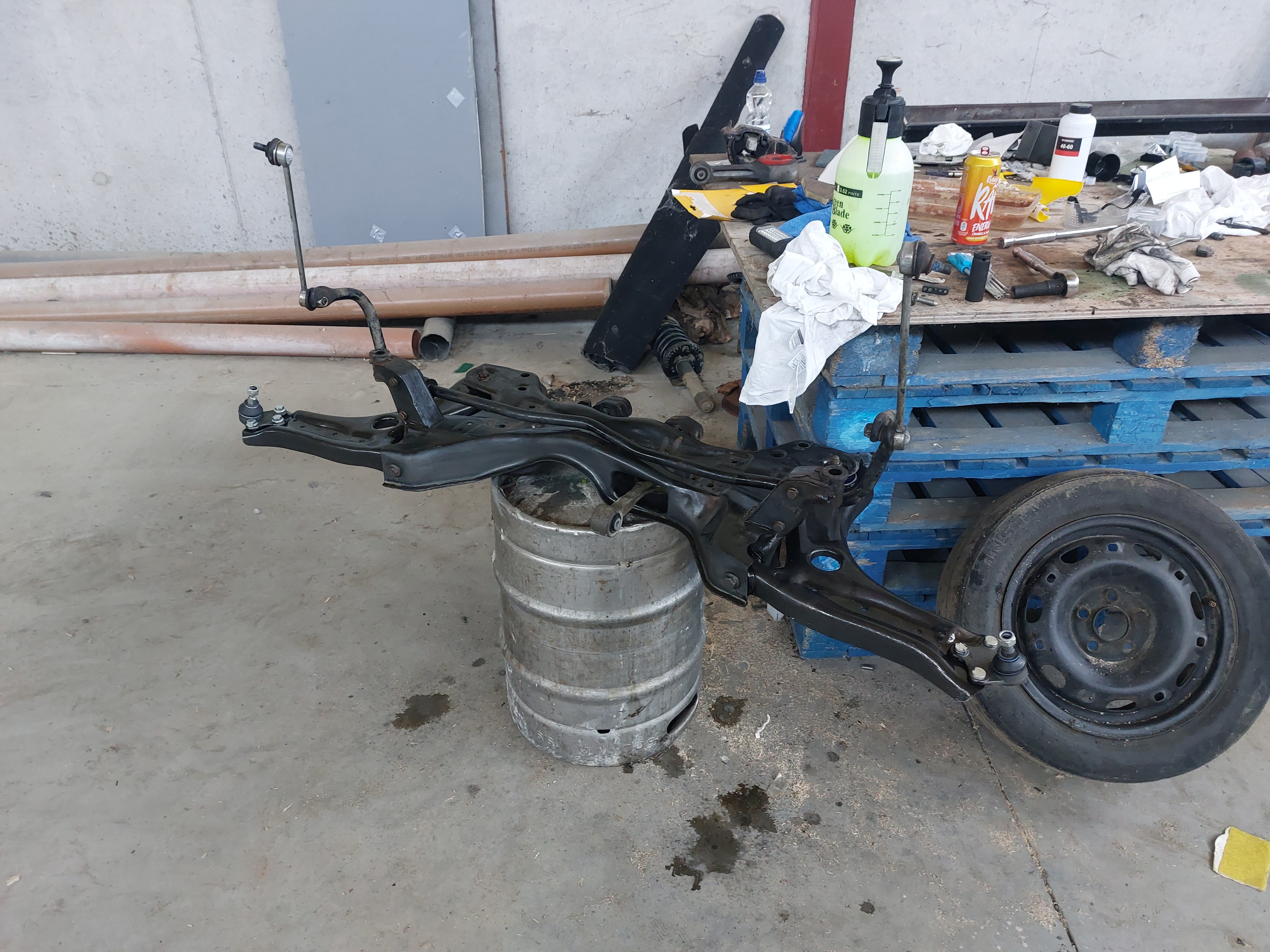

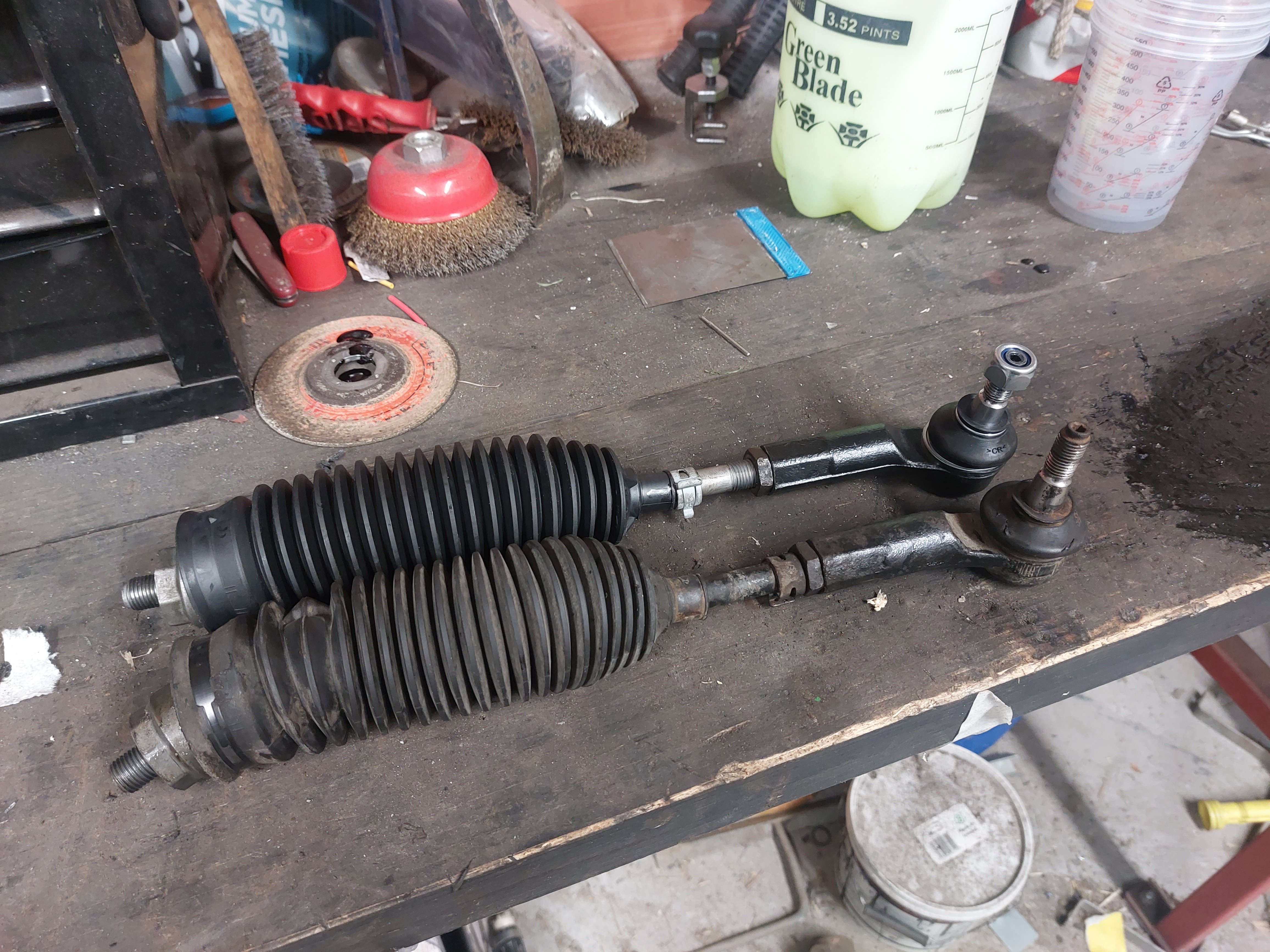

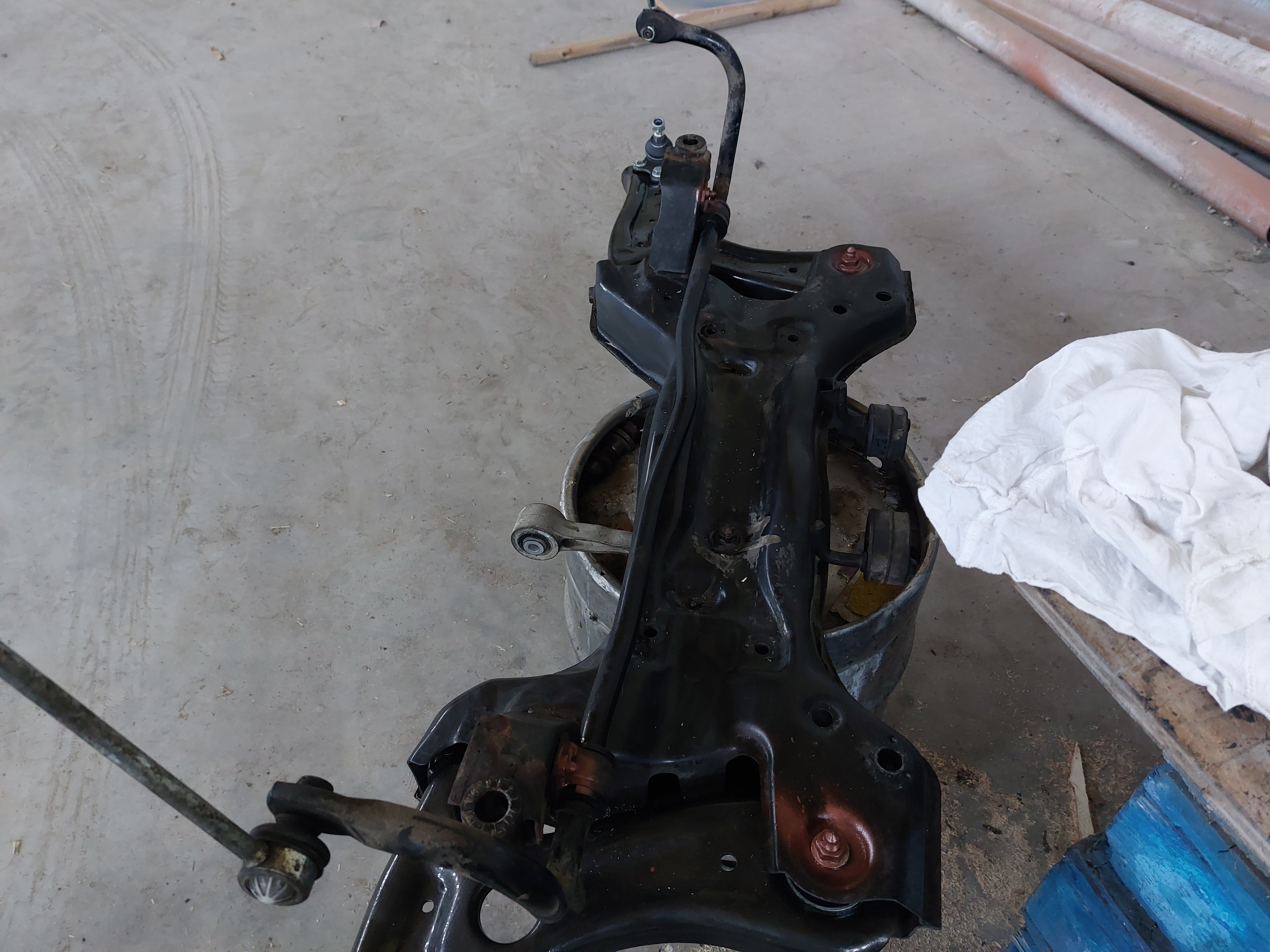

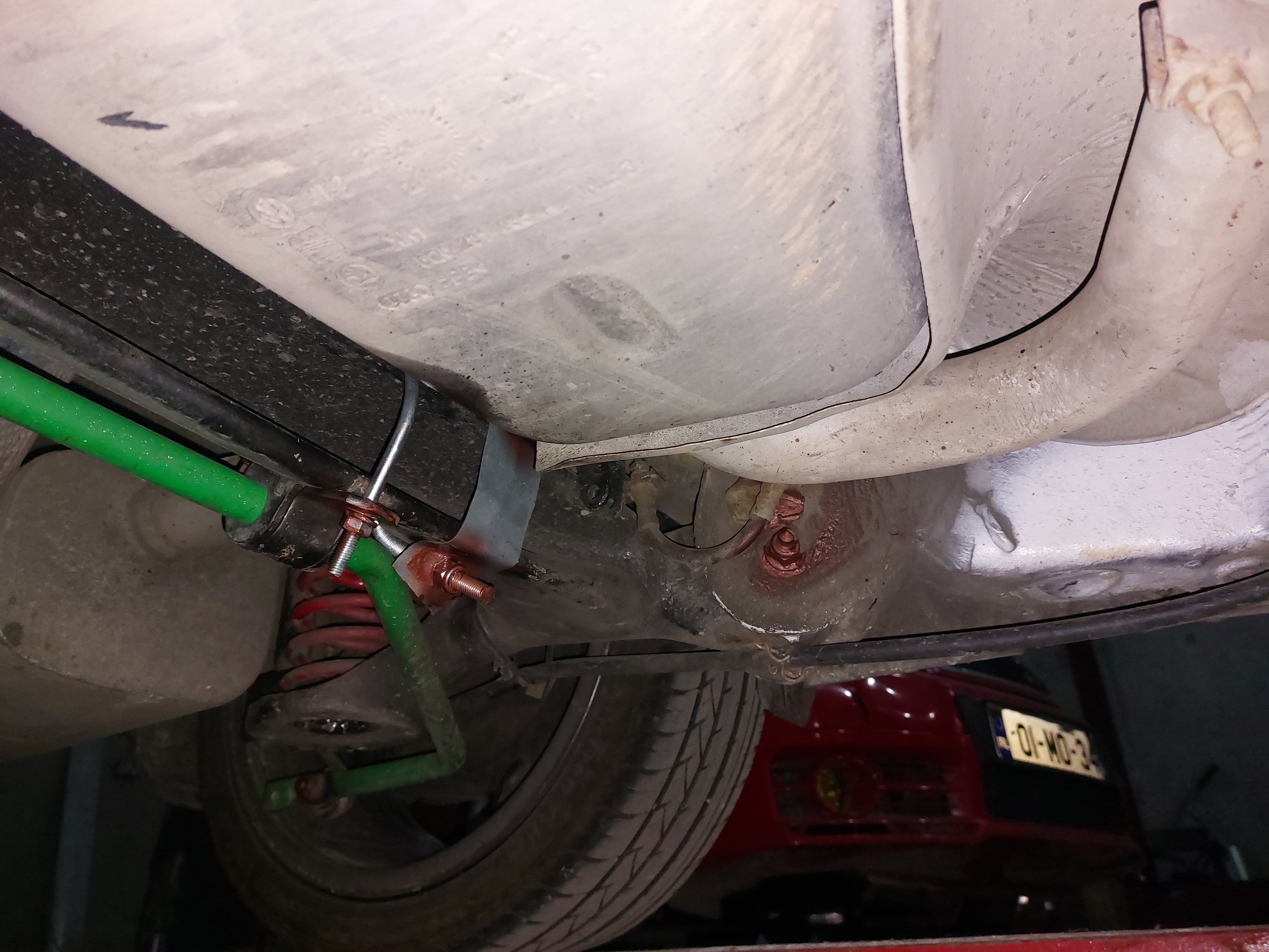

Dropped subframe to do track rods and caster increase bushes.
Needed to reuse a jam nut off an old track rod, one of the new ones went missing.

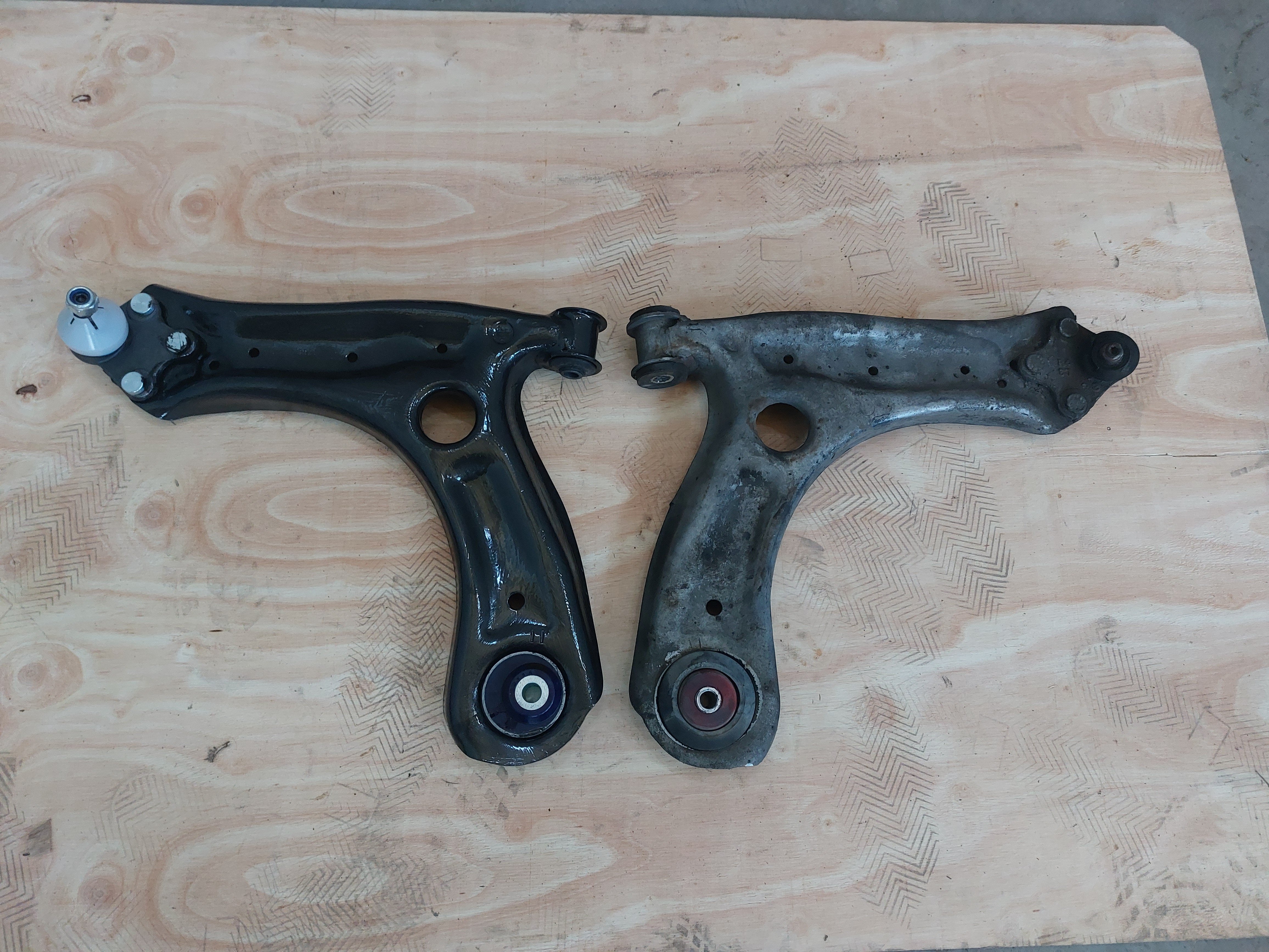

New vs Old wishbones
Built all on the bench, keg even
Regreased ARB Bushes and Steering rack bush when I had access.
Back together.
Did my best to keep the length of the track rods the same as the old ones, but with the castor bushes it didn't really matter.
Drives straight enough for now, will be aligned ASAP
Have a printout of the alignment before, so should be able to see just what difference these bushes have done to castor.
First impressions are good, but I think I should wait until its aligned proper to say for sure just what difference these have made.

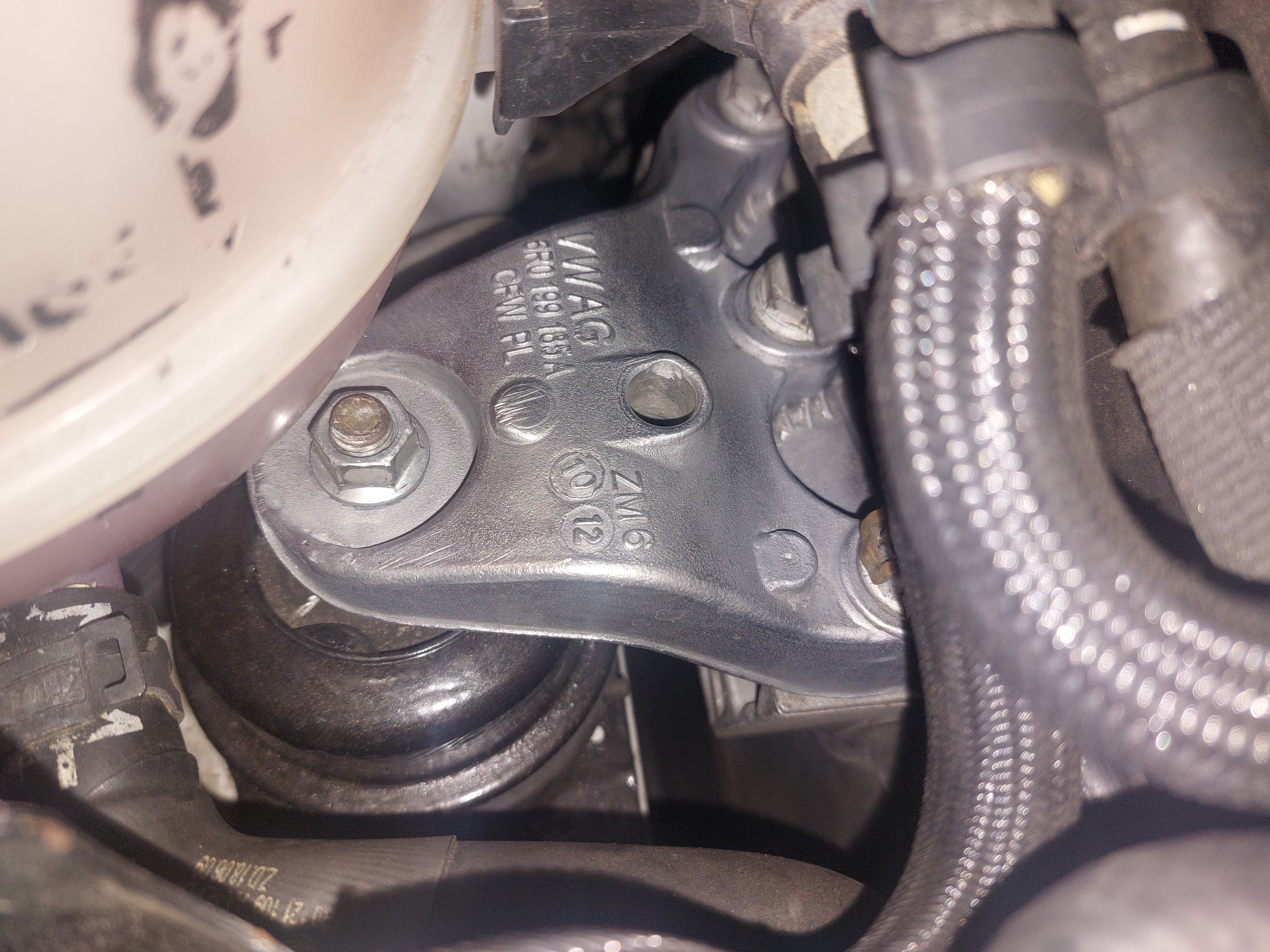

So done a few things since. Dogbone was too stiff at idle.
Removed it and drilled a few holes in the mount which has done the trick, no more vibrations than the powerflex but a bit nicer changing gears.

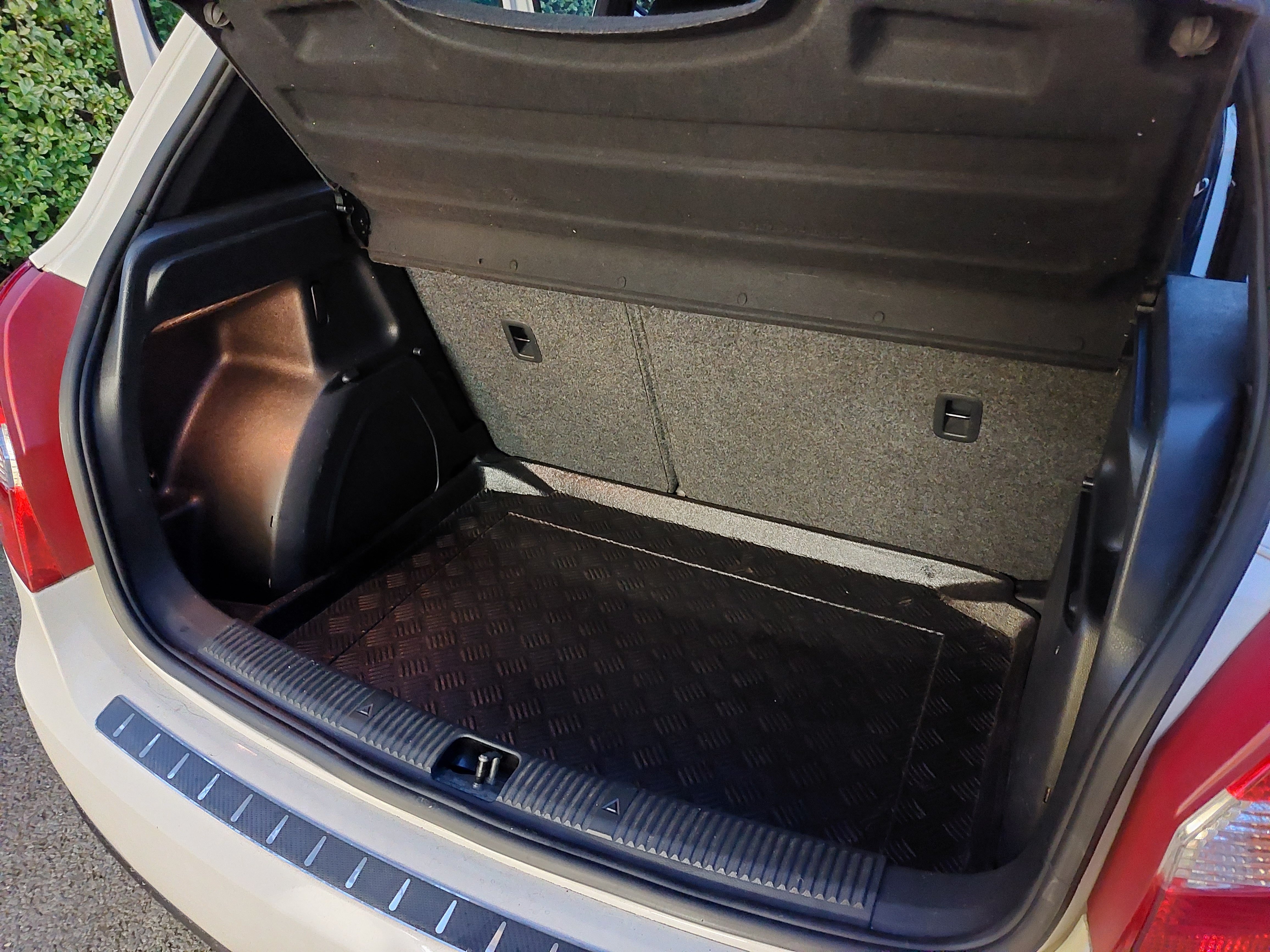

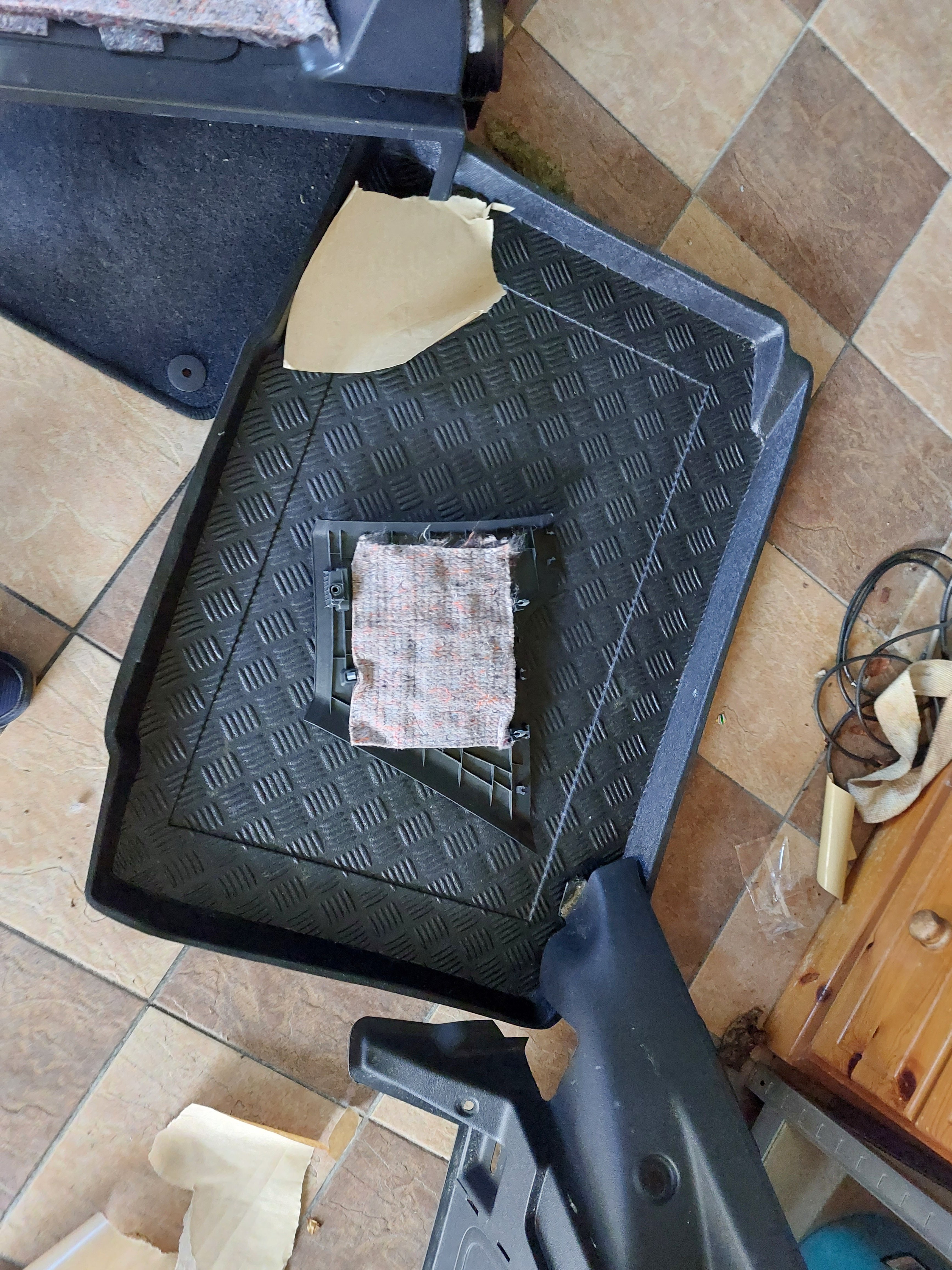

Did a decent job trimming the boot trim, these are the spares I bought, originals are kept safe and sound.
Would have preferred if it was tighter to the back seats but it's fine.
The way this fits is bolts going into rivnuts that need to be drilled into the car.
I think I'll replace the bolts with studs in the future, make it easier to refit in the future.

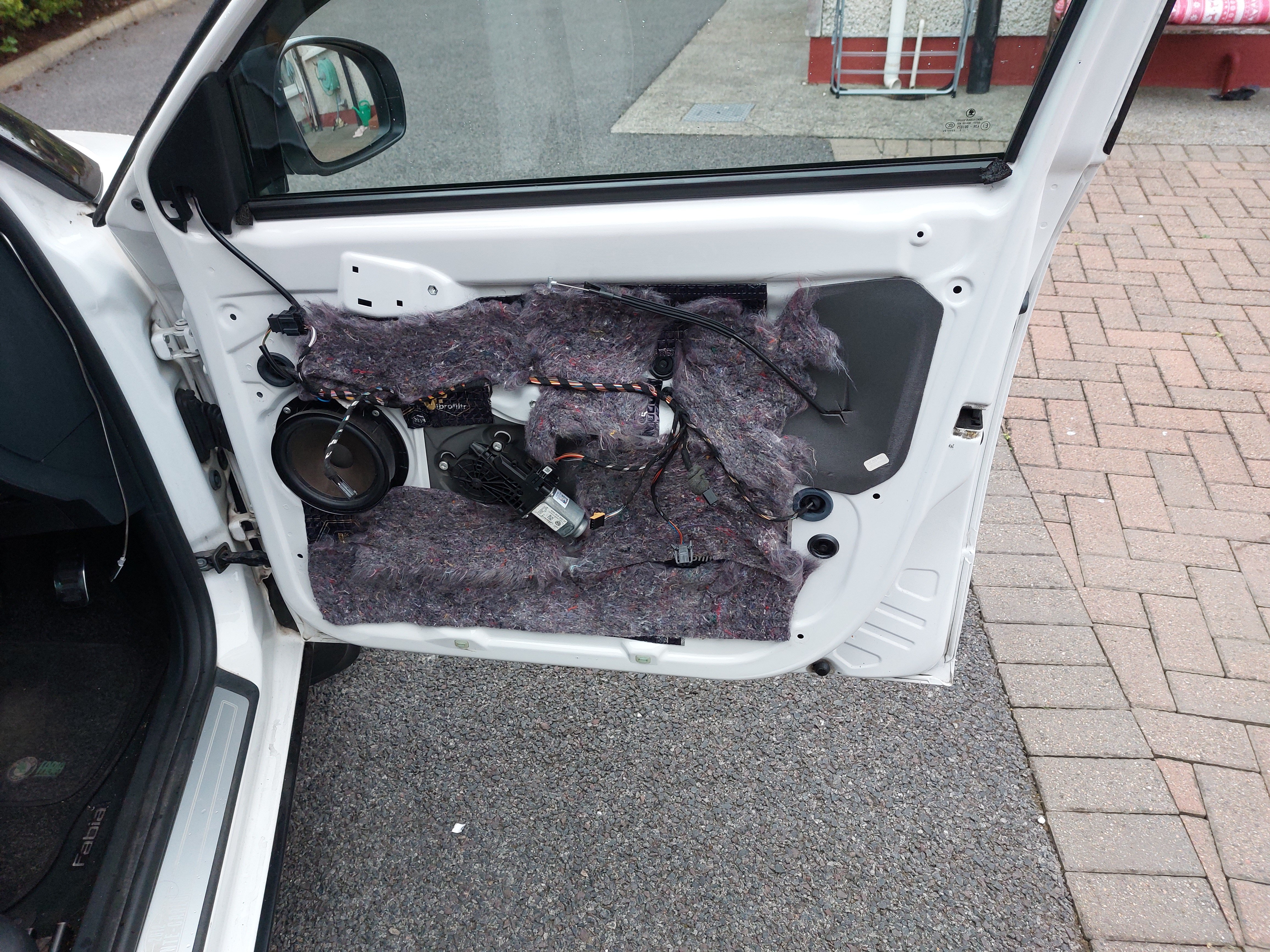

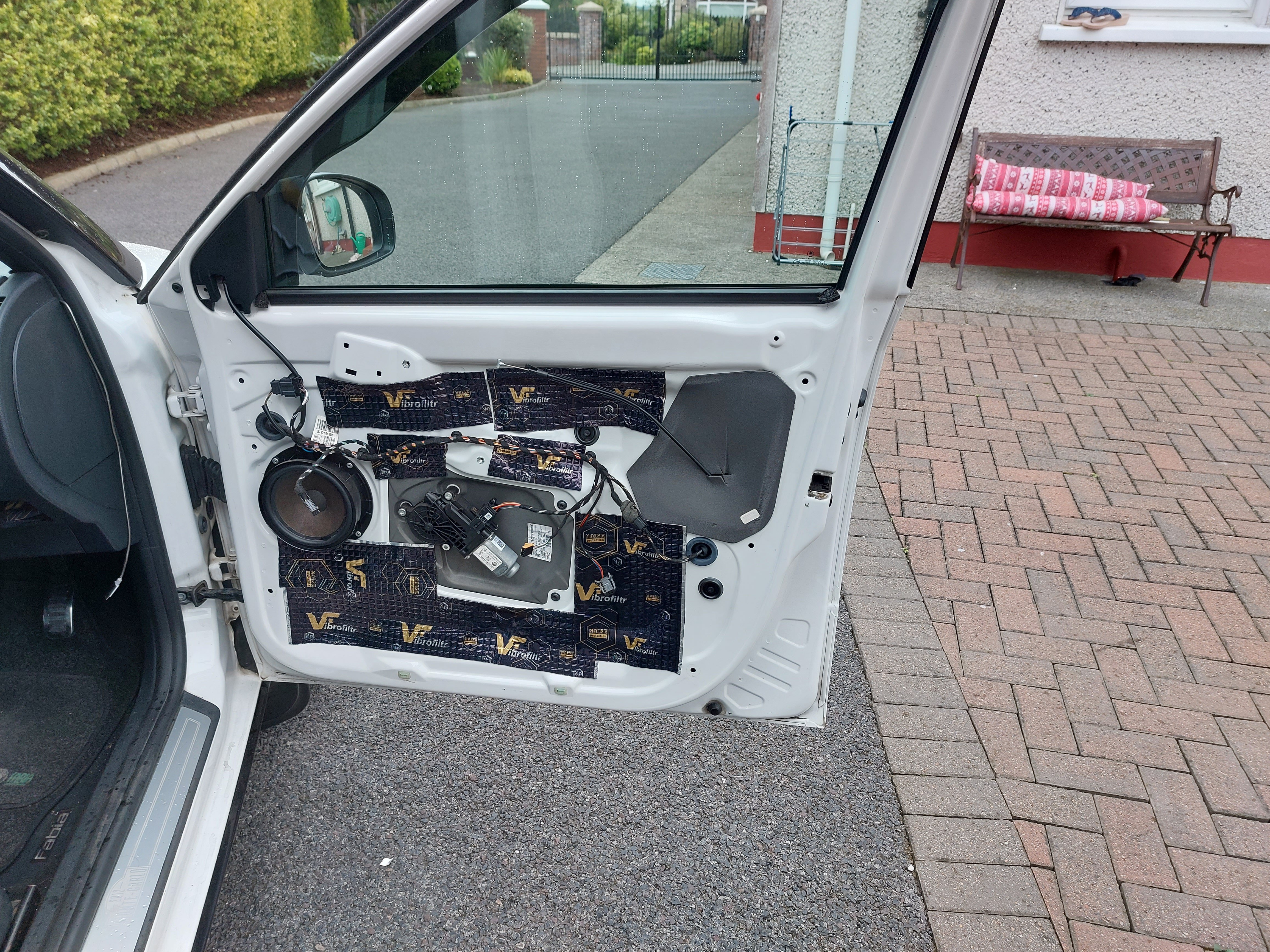

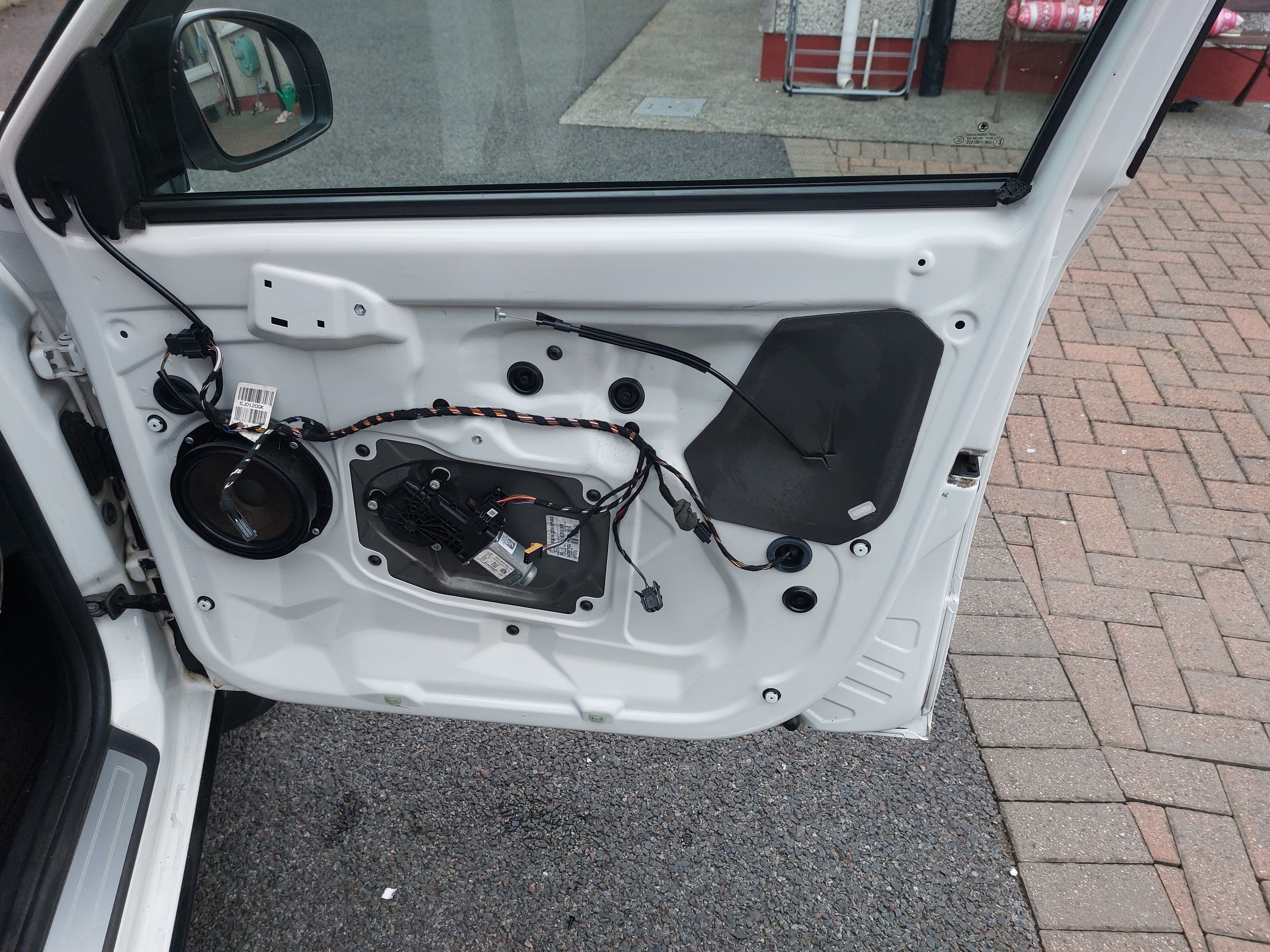

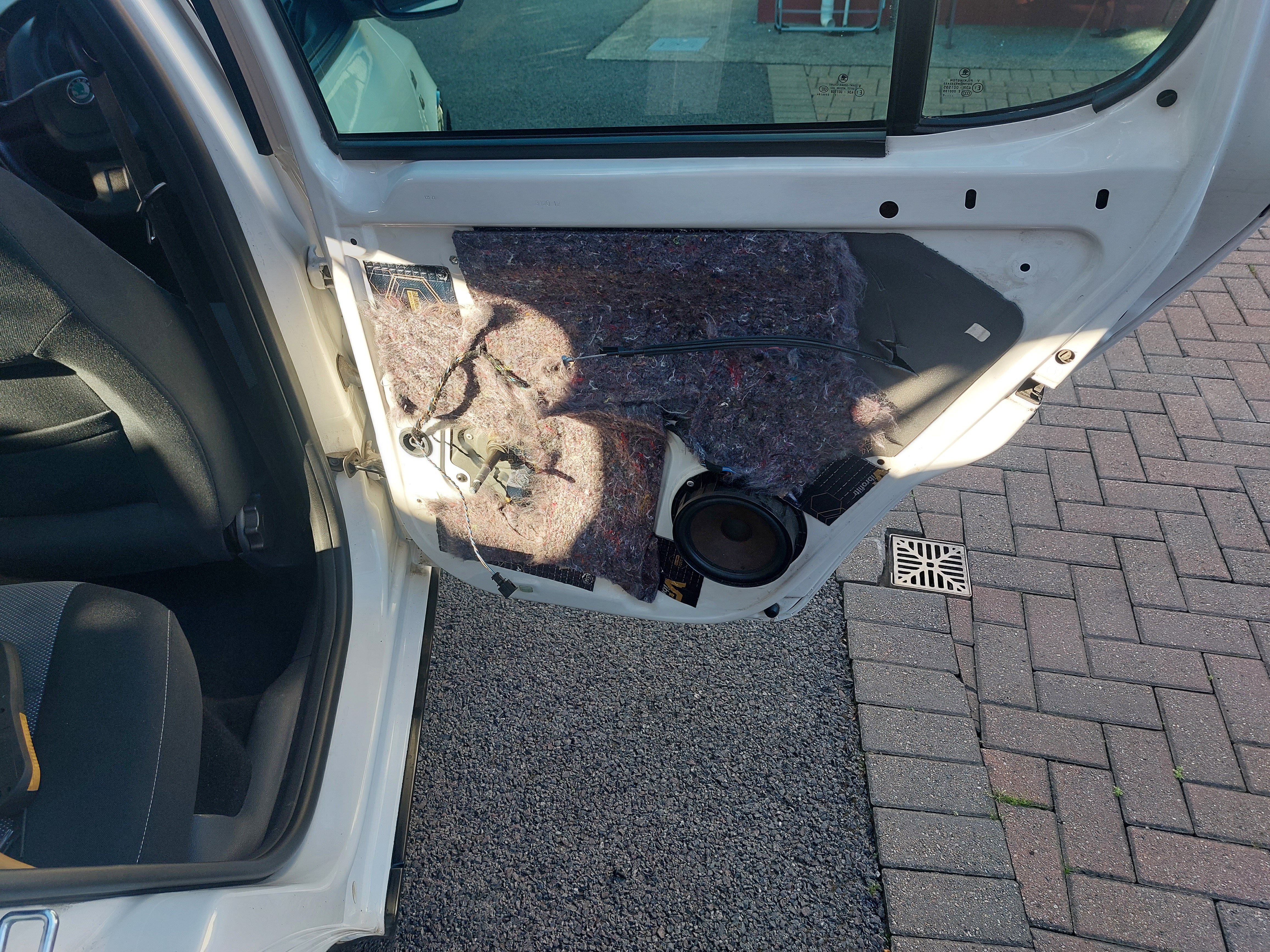

Front doors sound deadened

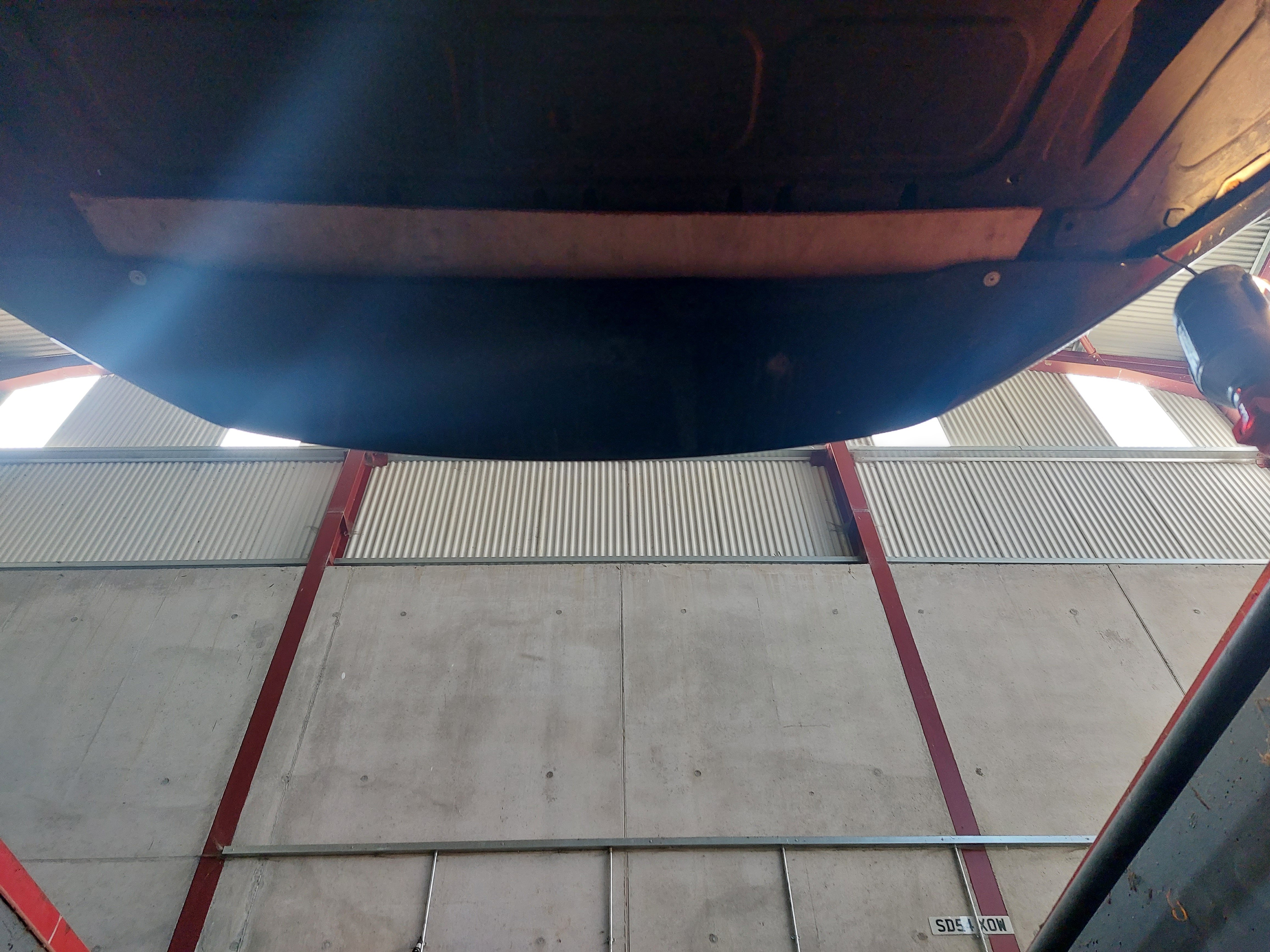

Managed to find a way to refit the undertray with a bit of wood.
I mean it works, will redo this to look a bit more proper, eventually.
Fitted the Filled Hydroil mount too.
60 shore is as stiff as it needs to be, its slightly firm at idle but perfectly liveable like this.
I’m thinking of increasing the sound deadening in my VRS soon. Has it been worth the hassle? Hopefully fix a few of the creaks whilst I’m at it!
It wasn't hard to do at all and It is worth it to do. There's very little sound deadening on these anyway so any bit helps.
Even the little bit I did made a difference.

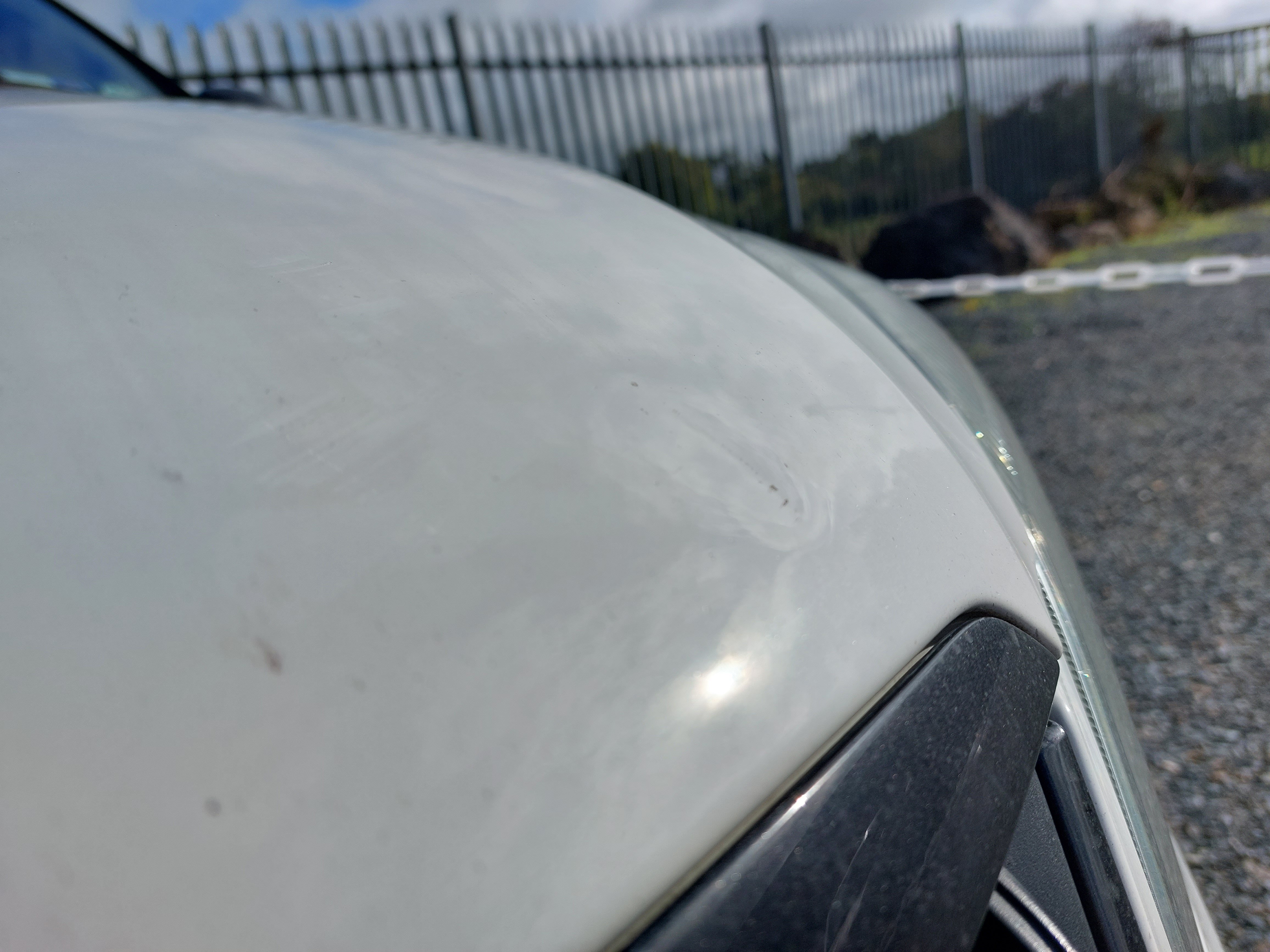

Have had a bit of bad luck since, gust of wind knocked a roadsign down onto the bonnet. Left a decent dent but no paint work needed seemingly.
Should be sorted next week hopefully.

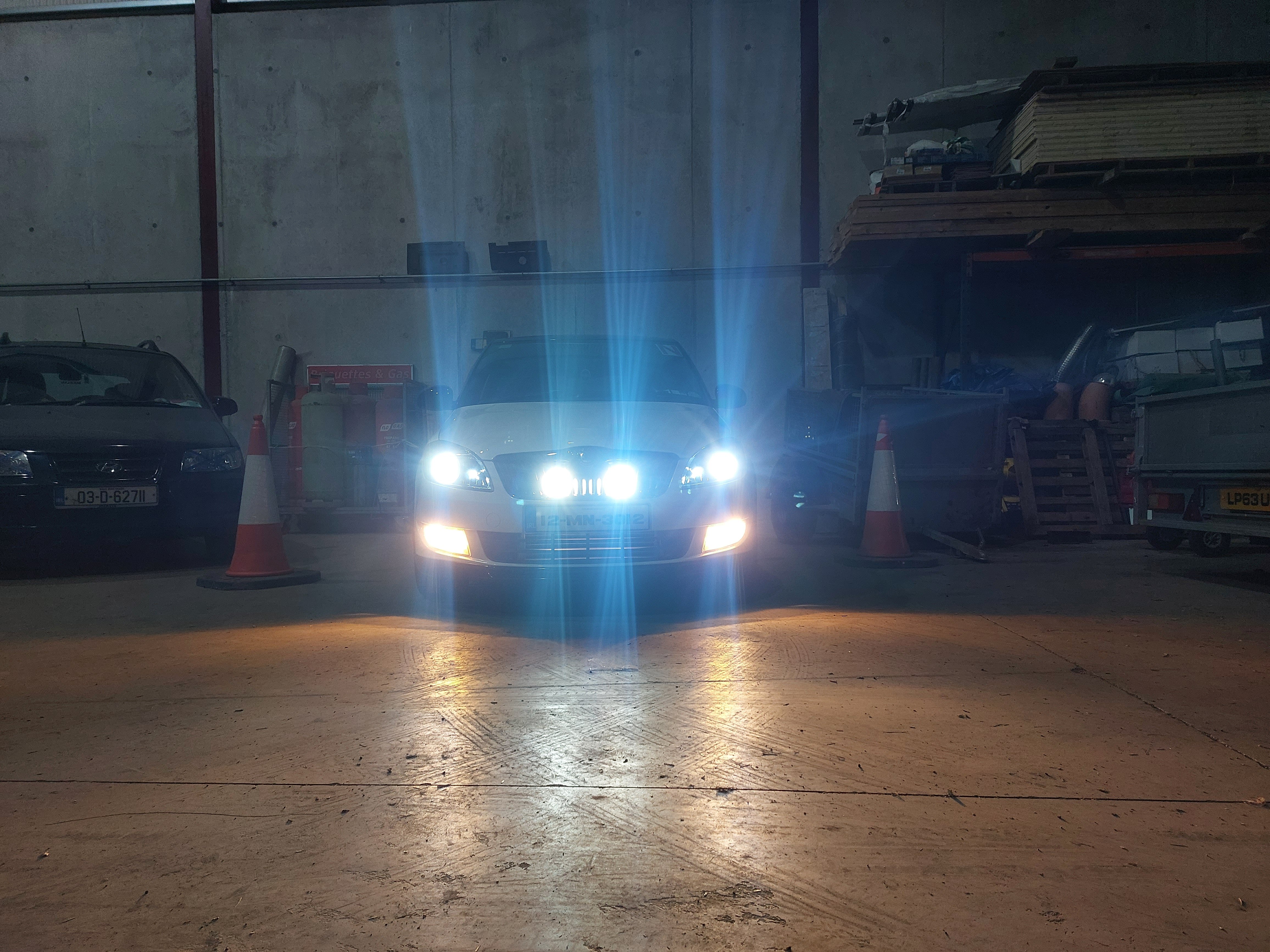

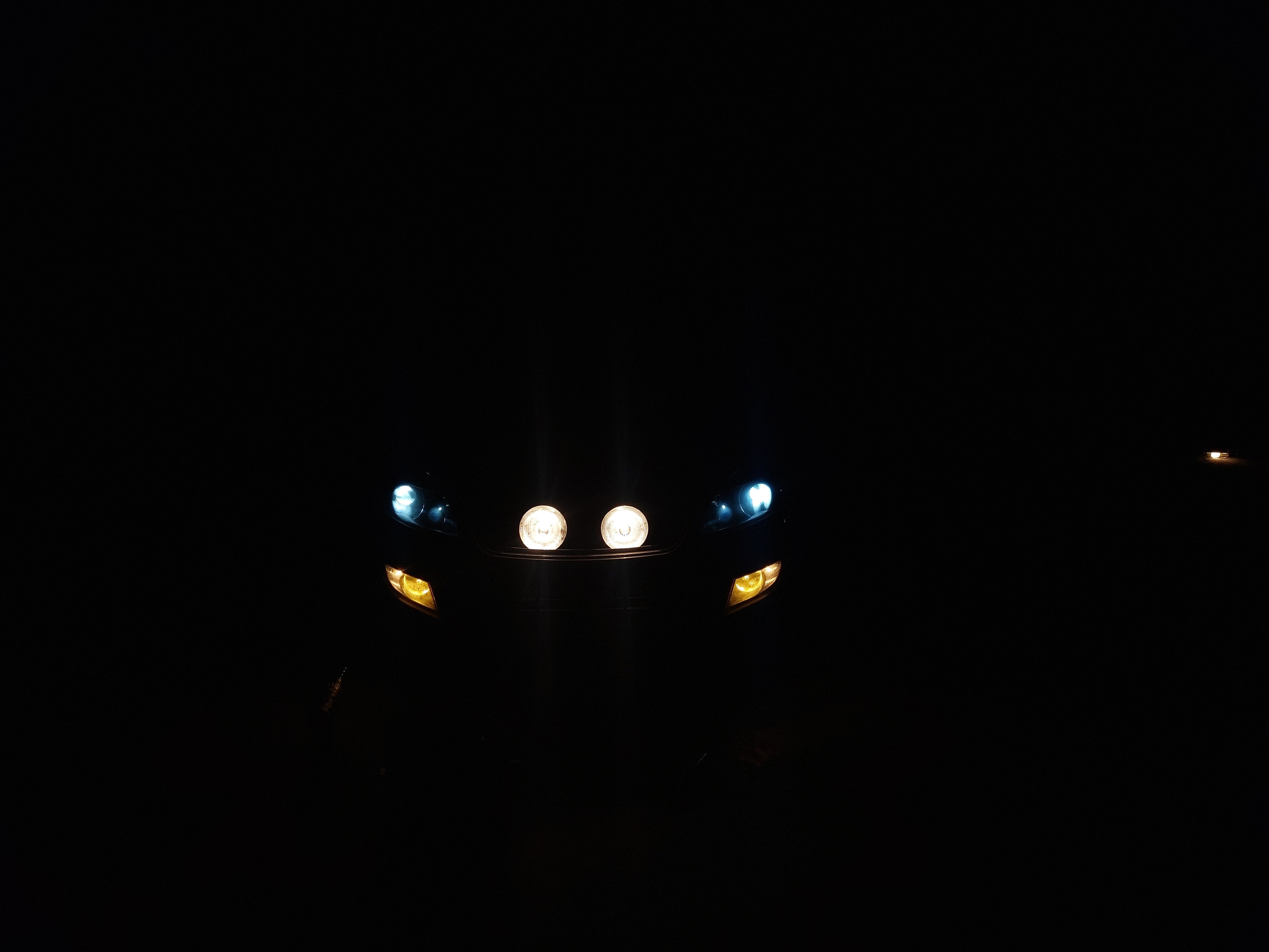

Lastly wired the DRLs to come on with the sidelights, finally.
Very easy to do, used my own wiring with a relay, signal from the sidelights and a wire from the relay to one of the drls. For some reason once you get power to one, it sends power to both DRLs.
Pic of what no lights looks like
And just the DRLs on their own.
These can still be switched on and off as skoda intended too.
Helps light up the sides of the roads and all it cost me was the price of a relay.
Should have done it years ago.

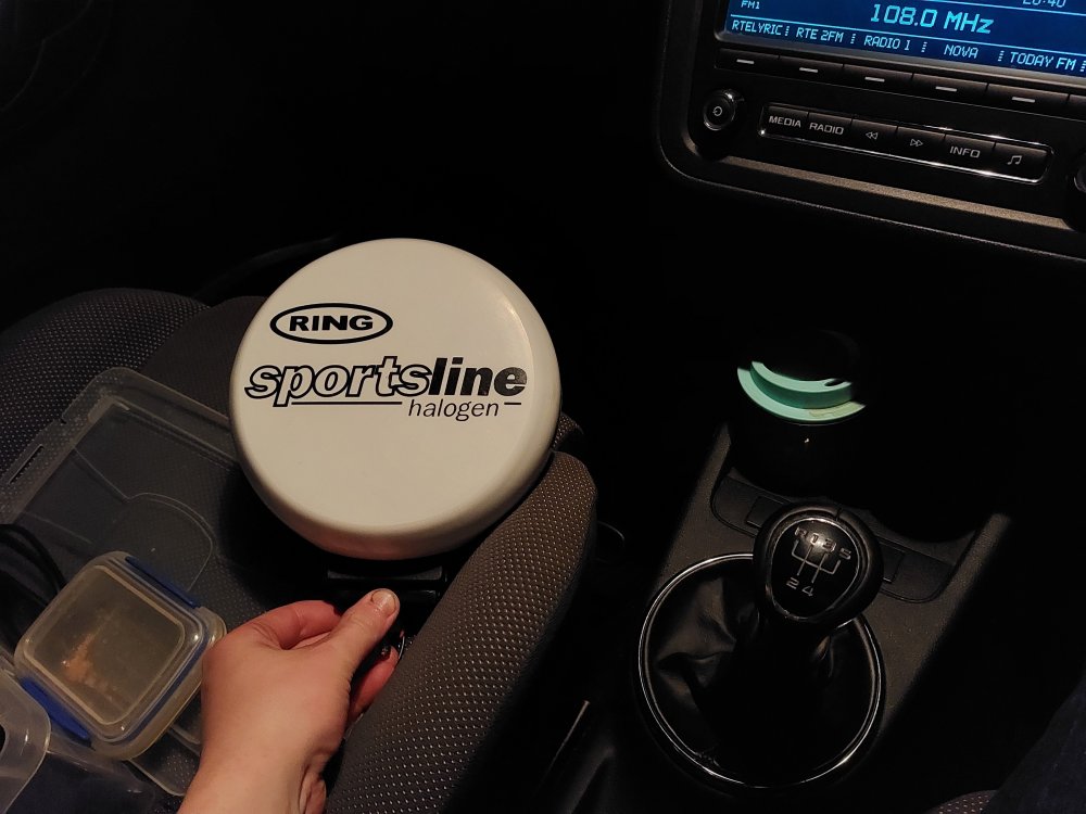

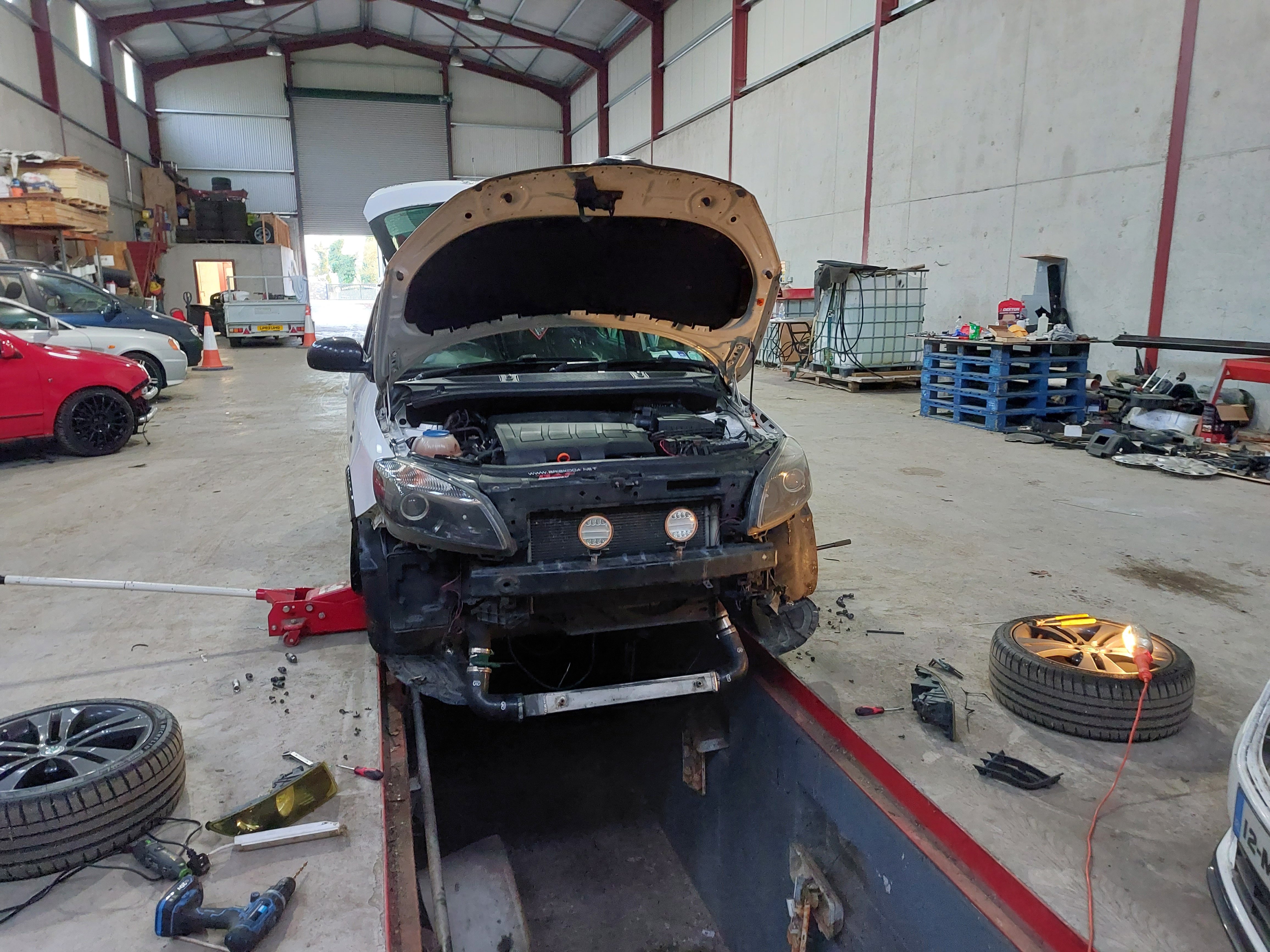

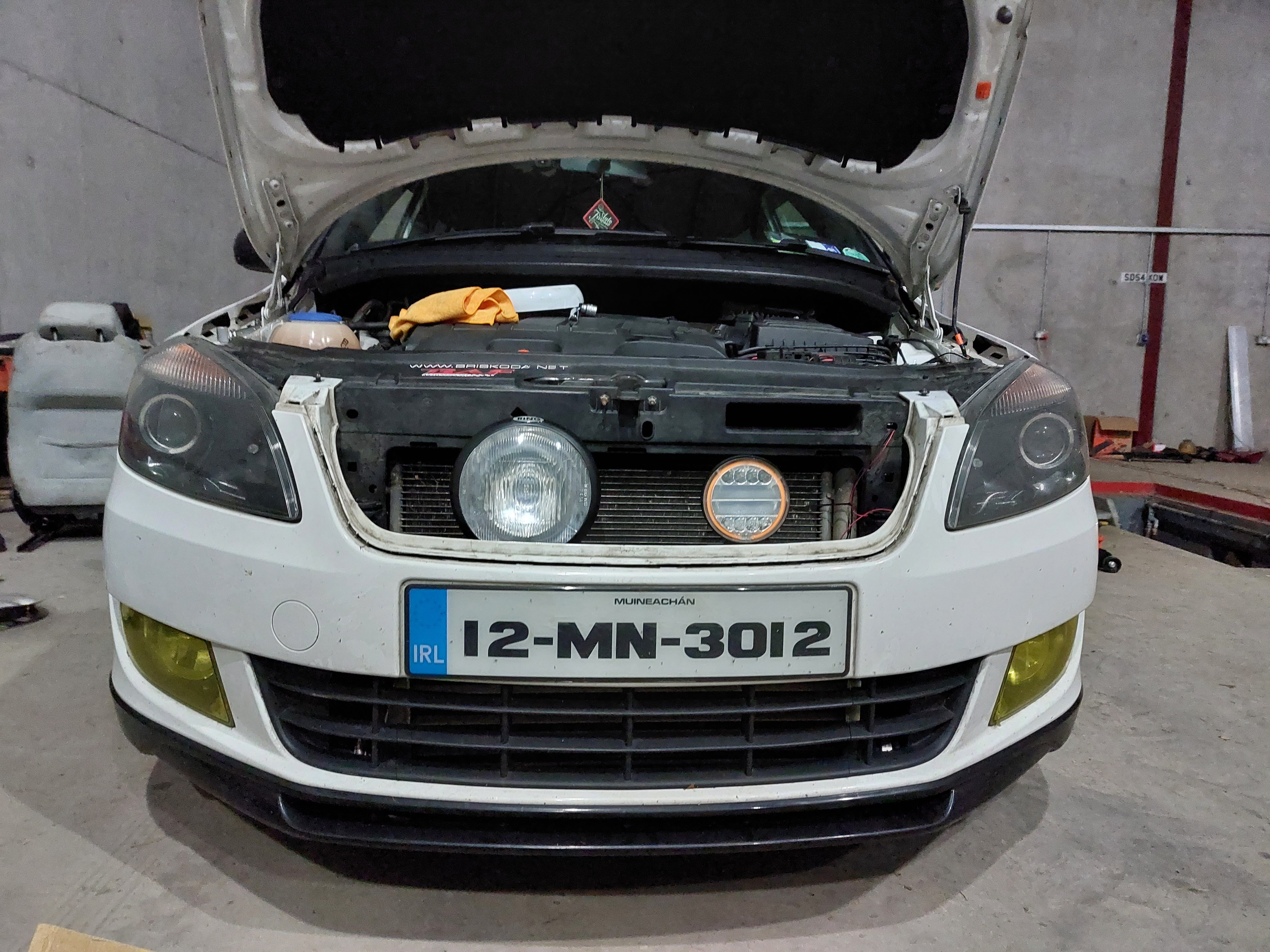

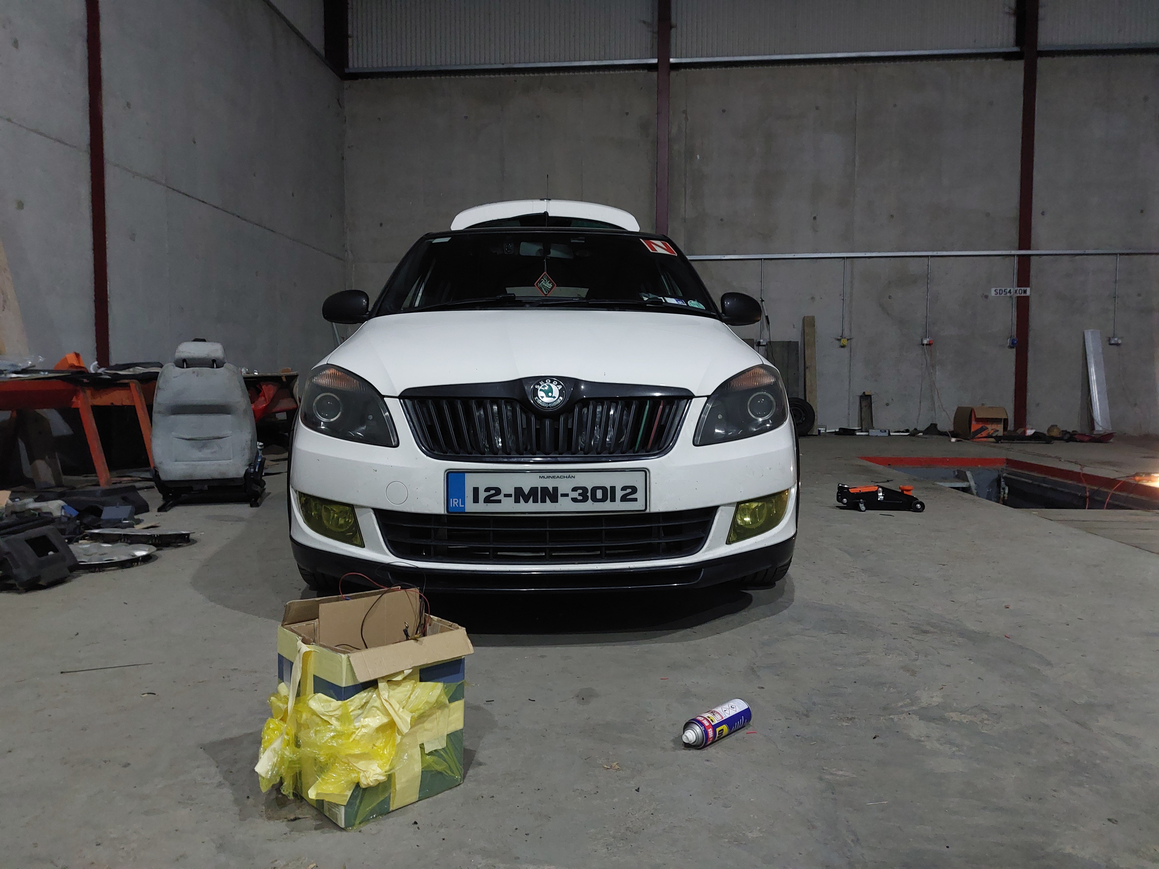

Did a job on the intercooler to make it sit tighter.

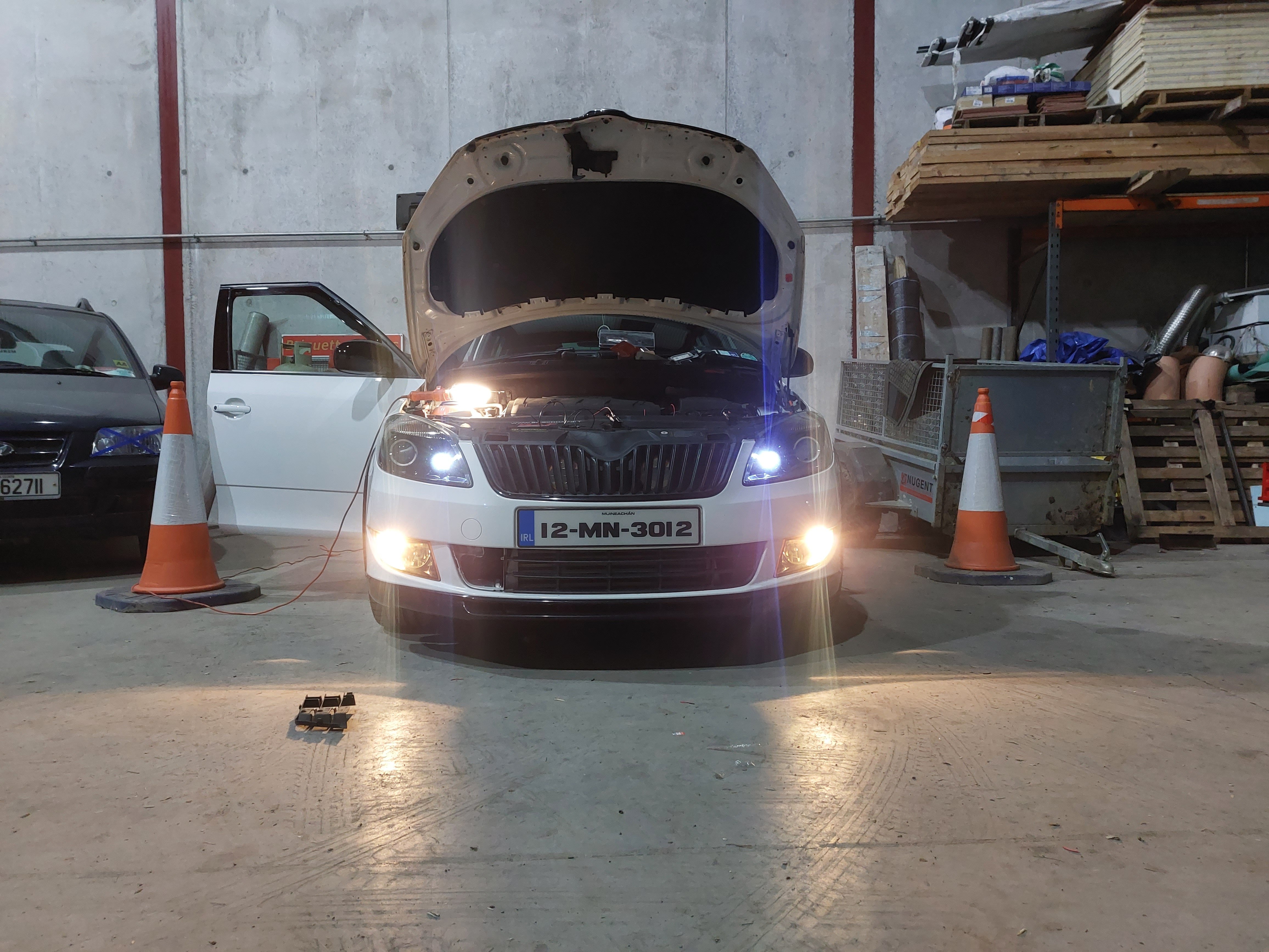

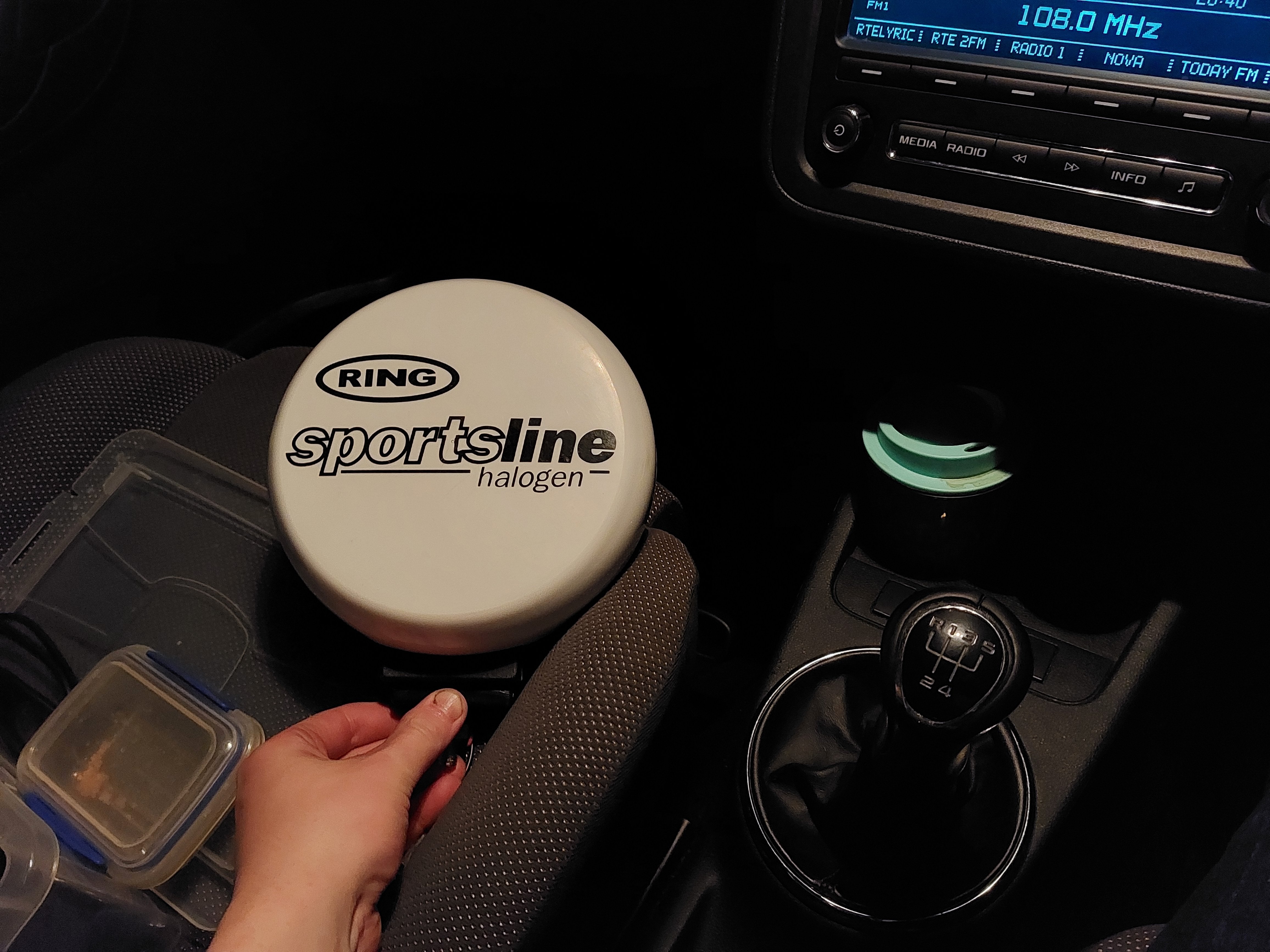

And changed the spot lamps hopefully for the last time.
7 inch halogen lamps this time
Very very tight fit. But they do fit.
Will be changing the main lights back to halogen soon. LED bulbs were not the silver bullet for improving lighting I was led to believe 20221105_191650.thumb.jpg.c39a9741b36eeef95ba9915b79dc756a.jpg
