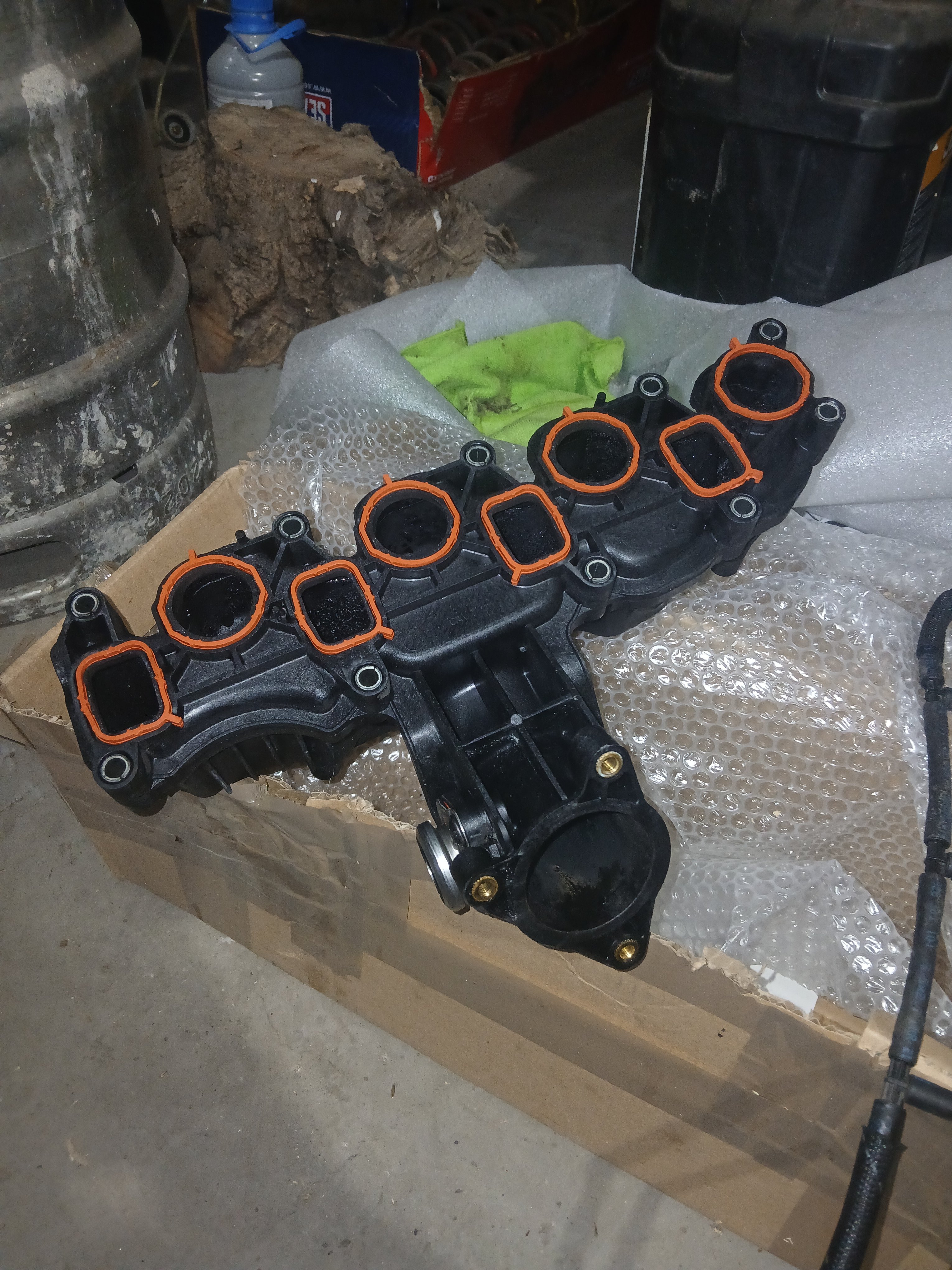

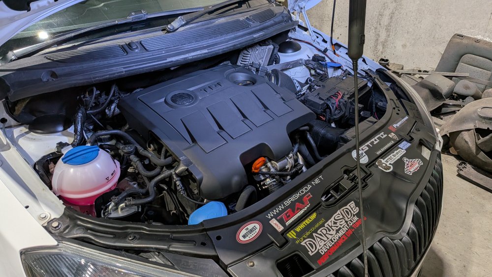

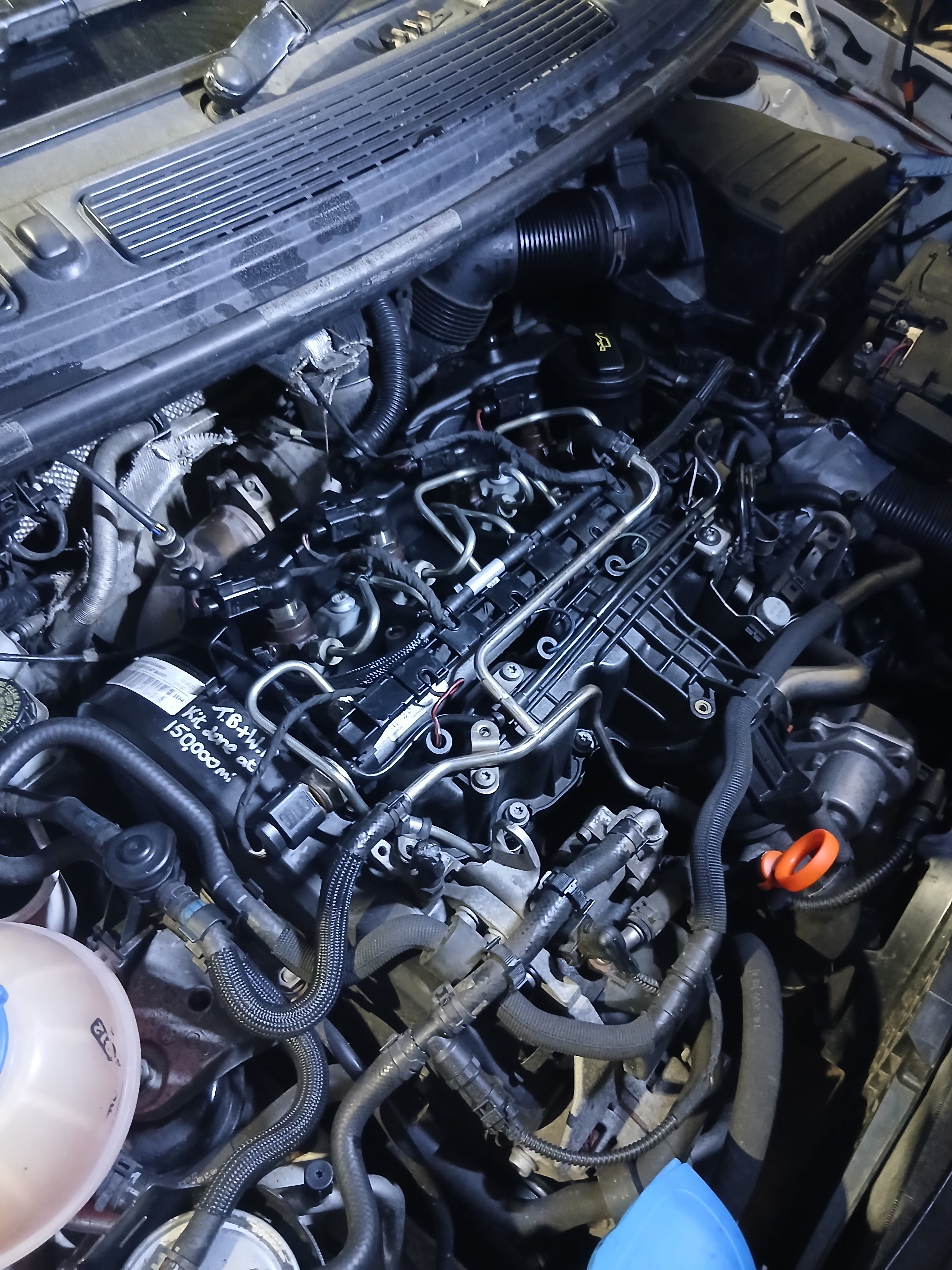

Got it all cleaned up, cleaned the intake manifold some too.

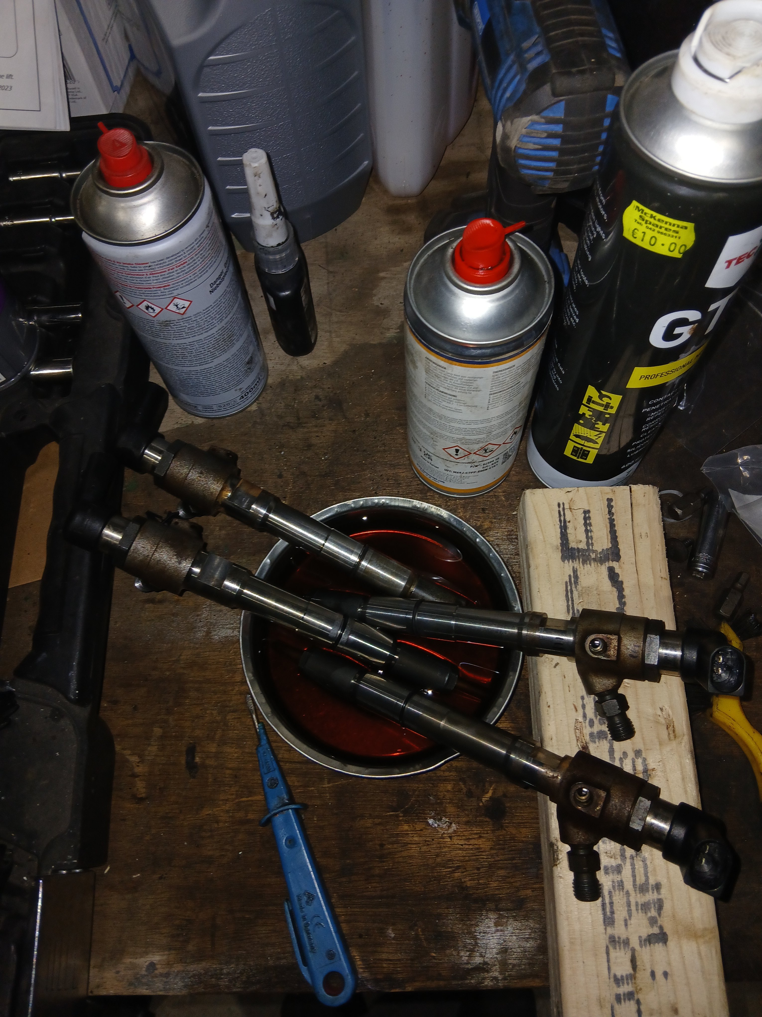

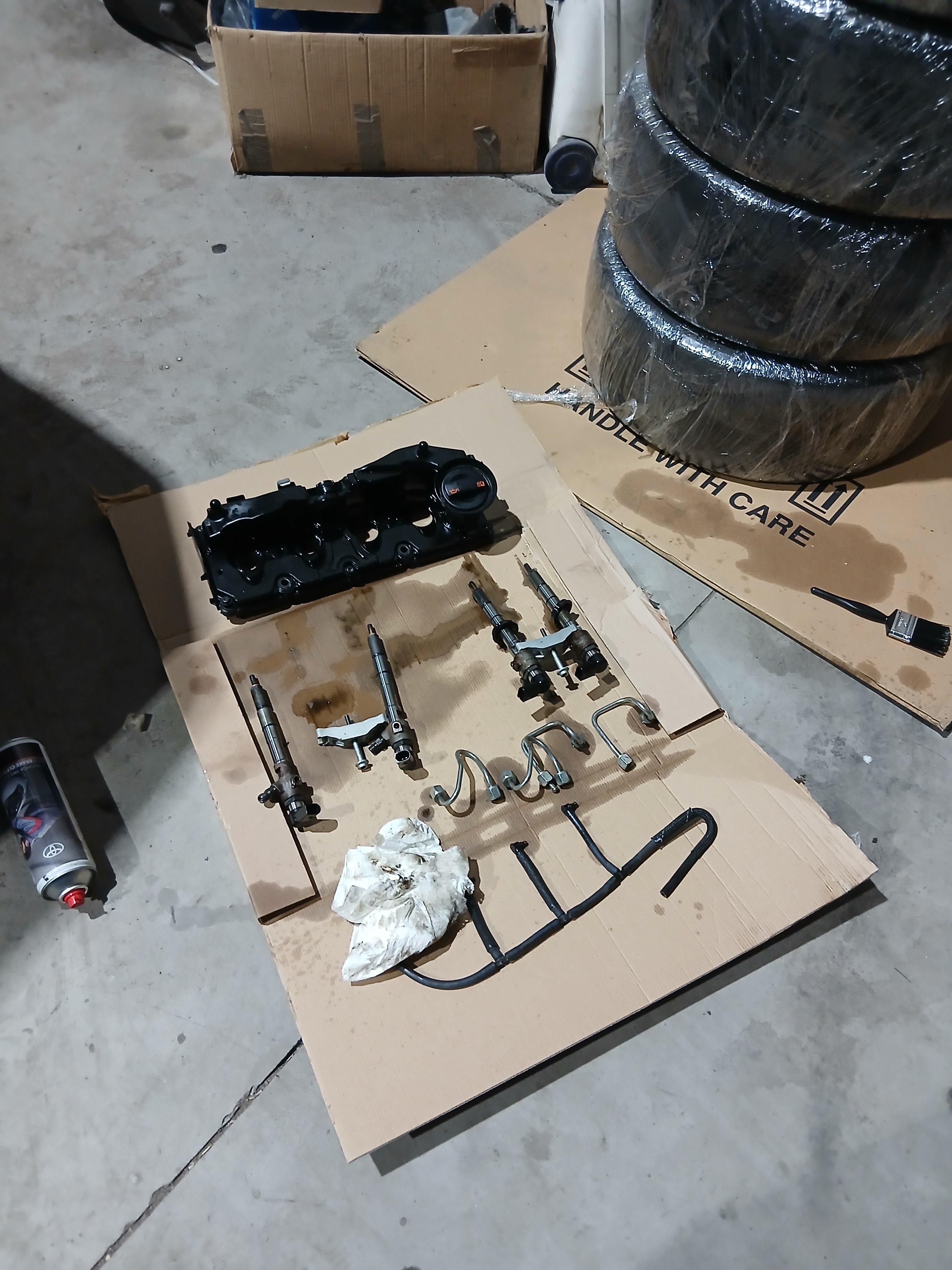

Cleaned the injector bodies up, and left the tips submerged in injector cleaner, i had some spare, figure it would do no harm.
Did see little bits in the bottom of the dish so it cleaned something out.

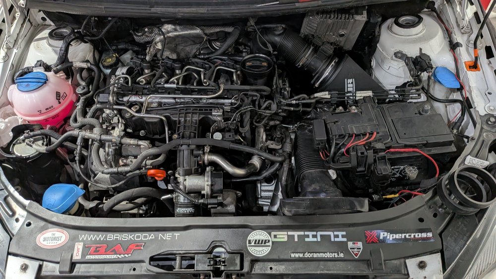

New seals, rocker cover gasket etc, all good, reused the original injectors, see how much longer they last.

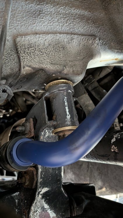

    Lot of progress done since: The axle has turned out very nice compared to what it was before, should keep looking fresh for a while yet.   I managed to find a set of 256mm rear br

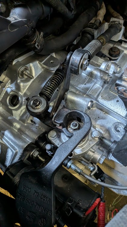

  • Very happy with the mounts. So much nicer changing gears and a lot less drama putting my foot down. Slightly more vibrations but not crazy especially this being a diesel.    Wanted

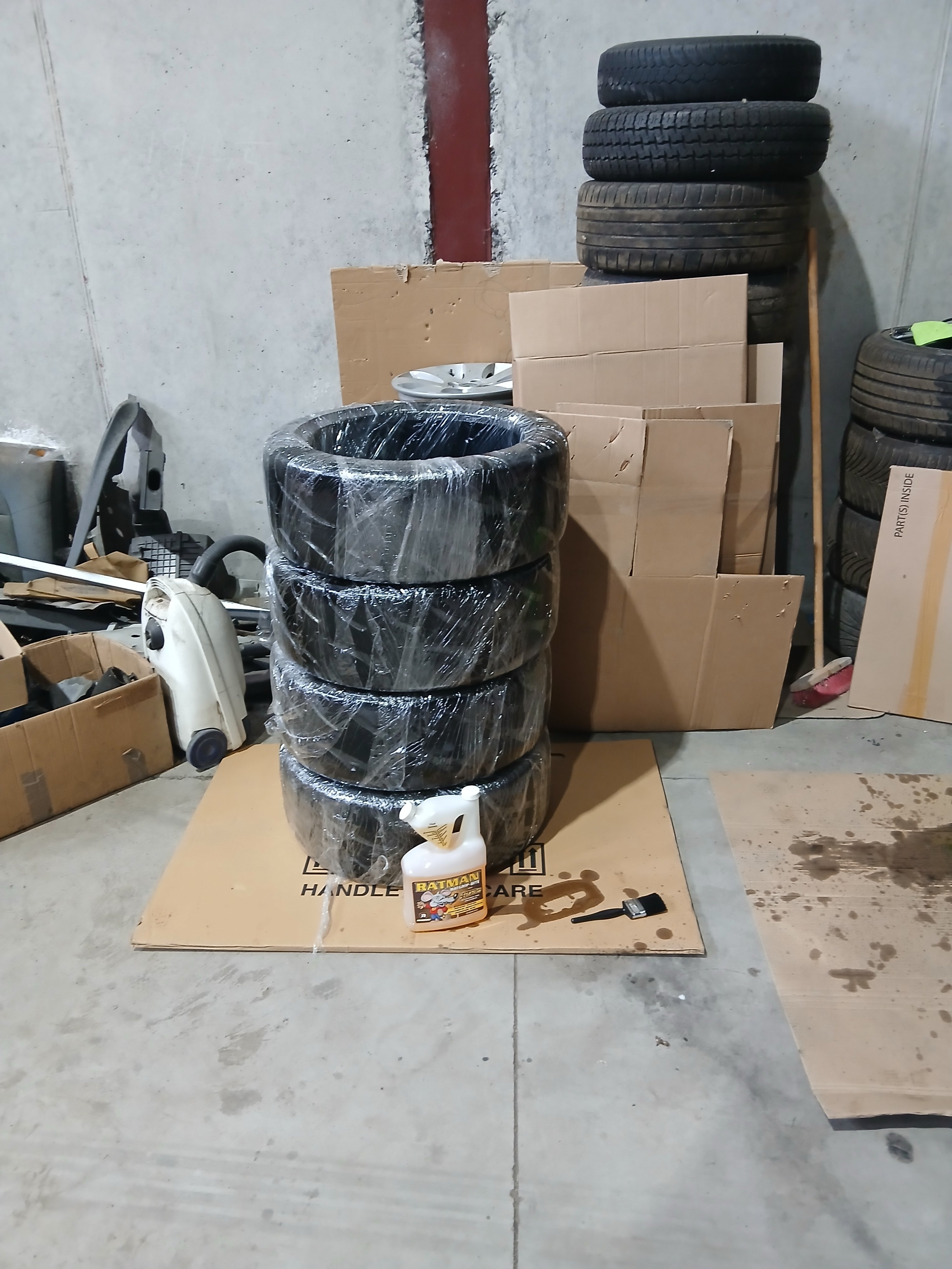

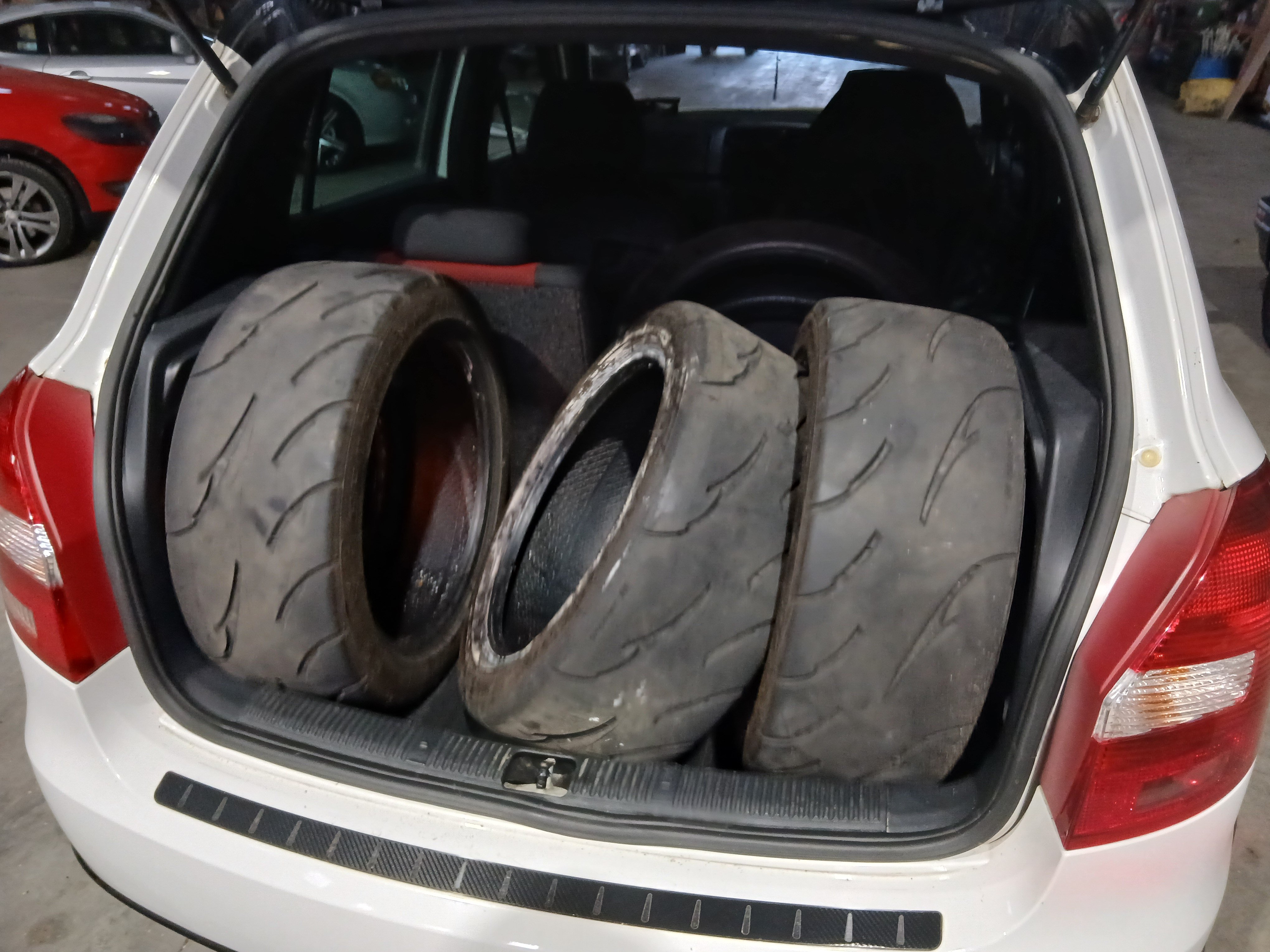

Got some nearly new ar-1s for this thing
Some tyre softener stuff too so coated and wrapped them up.

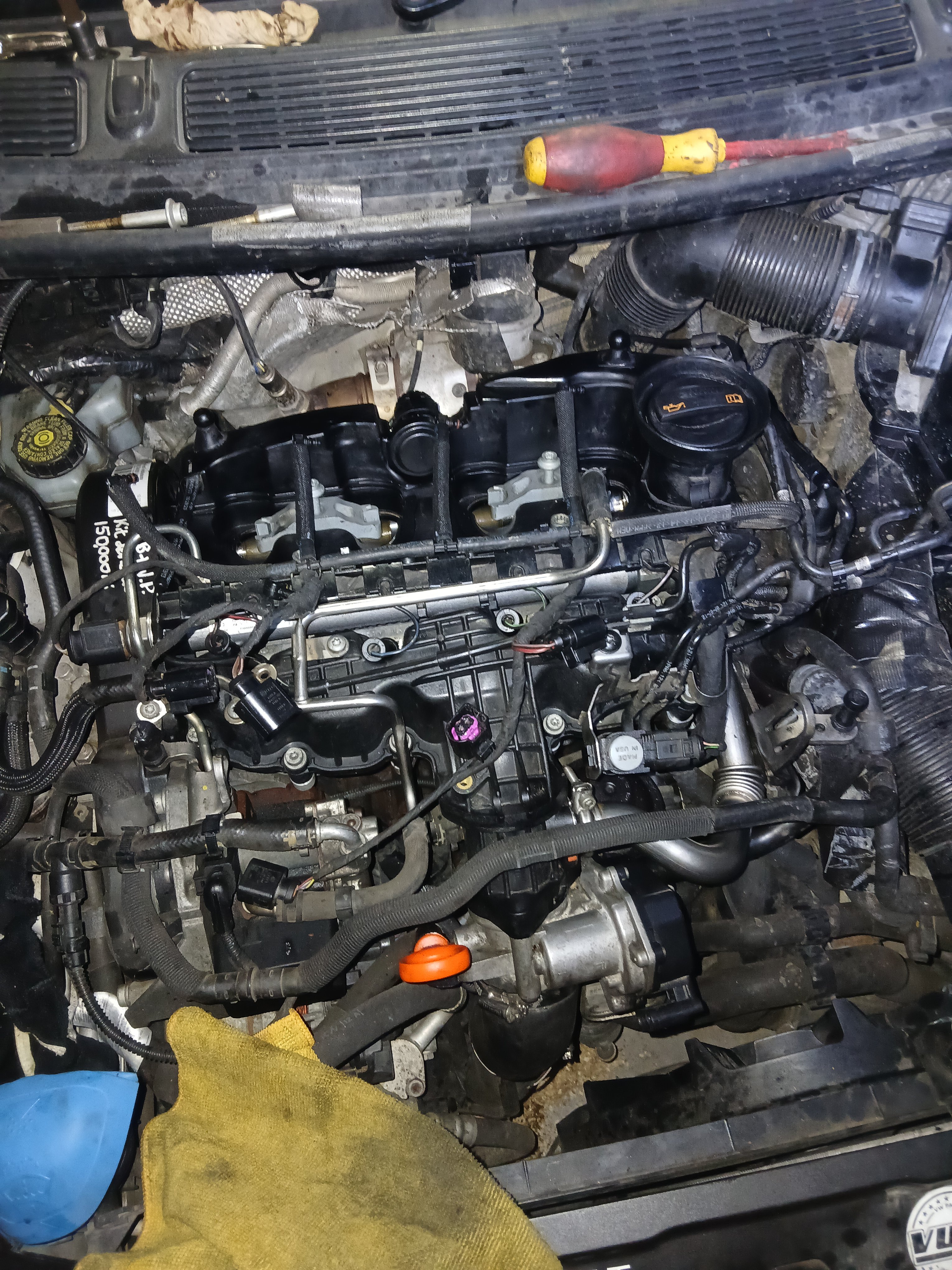

Then the car started leaking quite badly, rocker cover.
Have done a fair amount of driving since and it was fine, until it wasnt, probably something caused or disturbed.

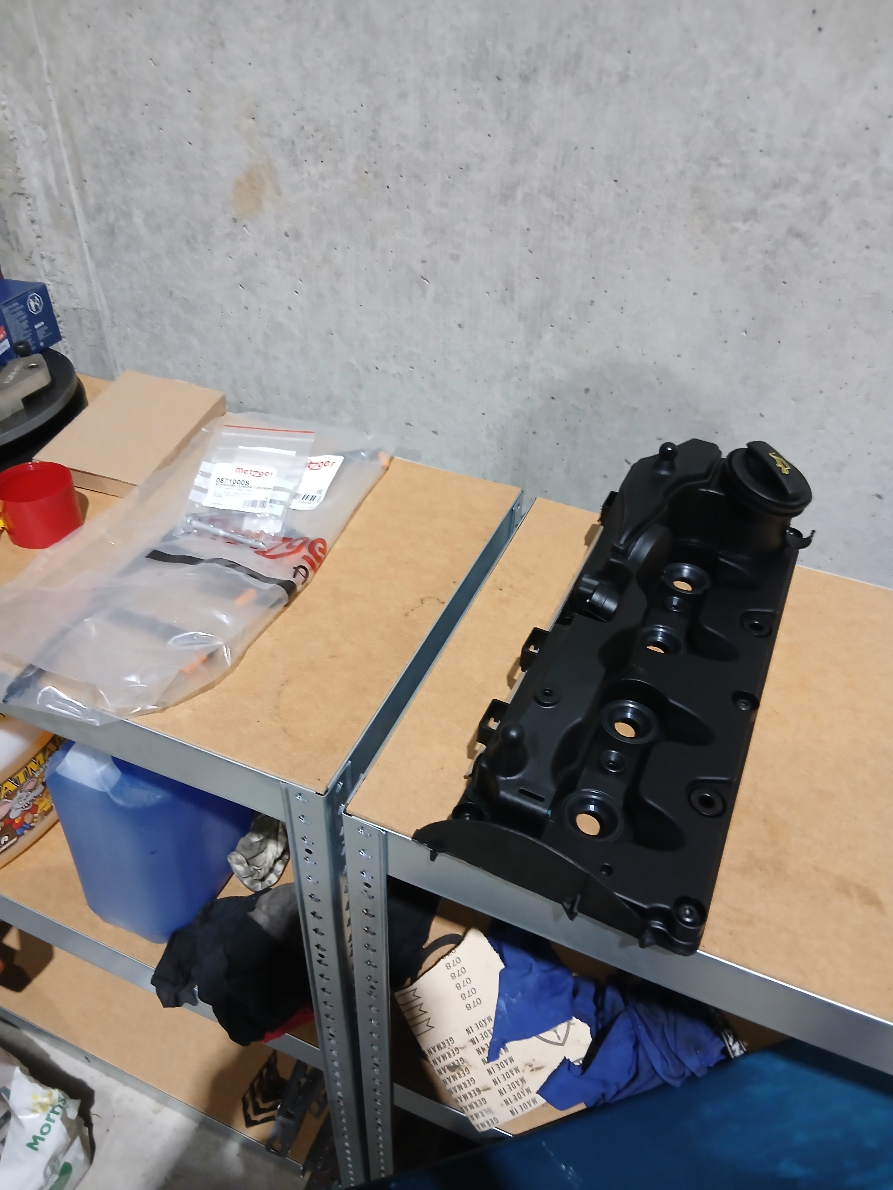

Bit the bullet and bought a new rocker cover, injector bolts and washers (again) and new leakoff pipes. Even with trade discount, it hurt.
Easy enough job since i'd done it before atleast.
Got it done in maybe 2hrs
All good and fine now.

Full 180k service. Seen a pipercross filter for cheap so got it (new). Know full well it will make no performance difference.
Full Oil/Air/Fuel/Pollen wipers etc. New n75 again and pedal pads as mine were slightly wore.
Replaced two rough looking coolant pipes also.
Small amount of fuzz on sump bung but nothing worrysome yet.

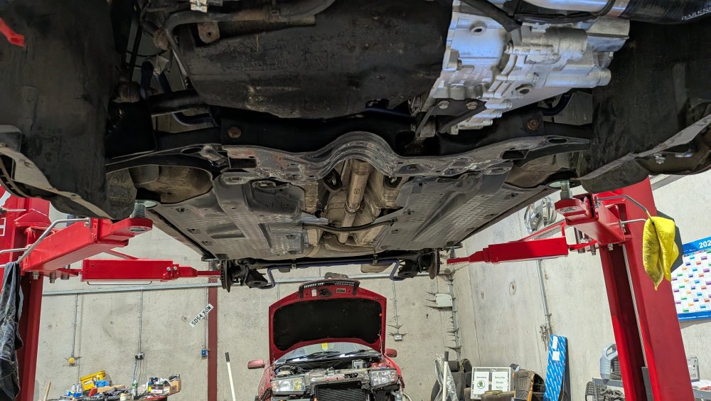

Full deep scrub underneath especially. 2 trips on the irish sea and salted welsh roads had me worried.
Have a video but too long so bullet points.

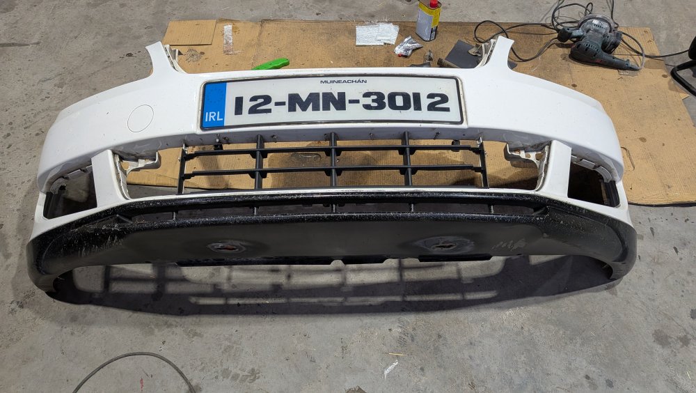

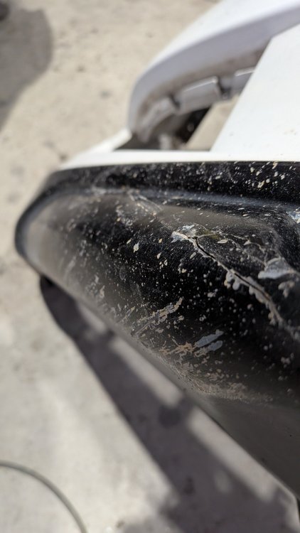

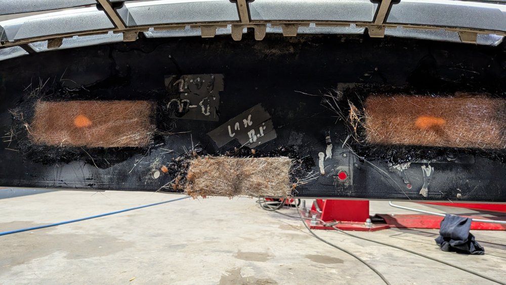

Rubbed the underneath raw, broke undertray. Floorpan covers damaged slightly, backbox/fuel tank all rubbed slightly
Undertray missing. Some of the mountings damaged.

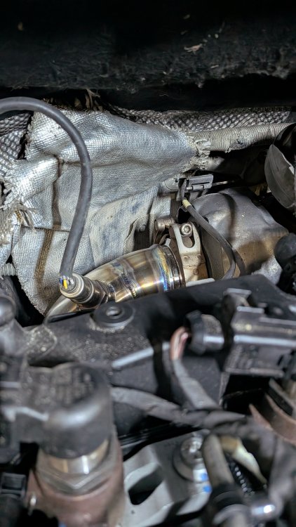

Exhaust mounts tweaked on downpipe.
Damaged the lip mostly areas id fixed earlier giving way.20251124_143503.jpg

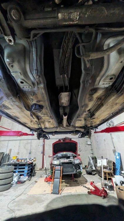

Floorpan covers i had spare from a parts car, my old ones will be fitted to the sdi eventually.
Sorted some rust underneath. Not too bad. Sprayed all white over it and used wax coating on top.
Sprayed the floorpan brace also.

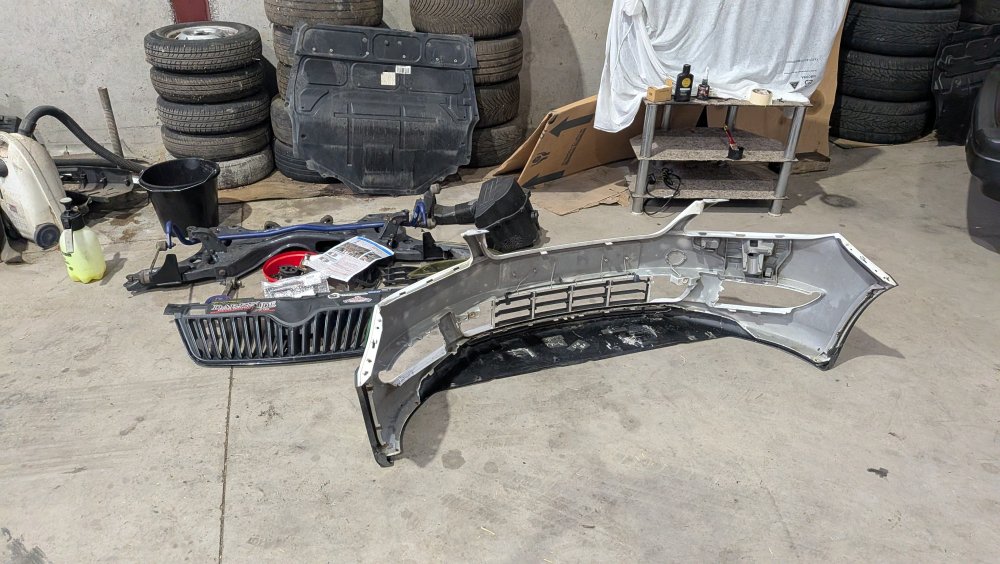

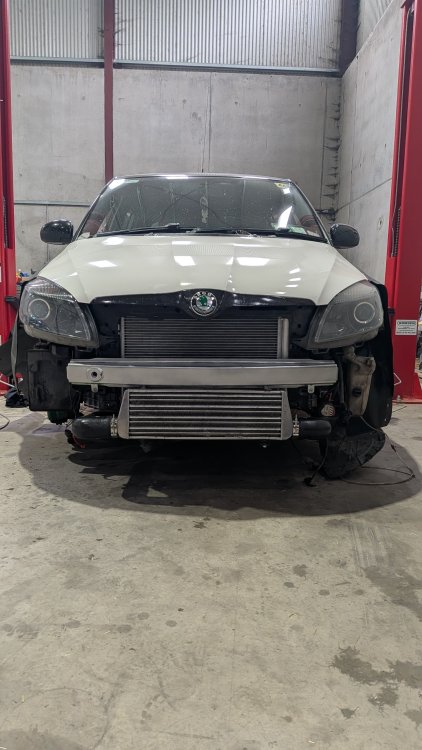

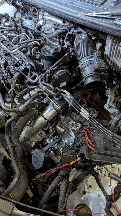

Lot of work going on
Engine and all out
Front off
Shed load of parts to go on

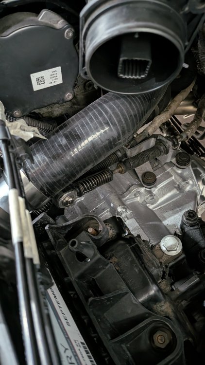

6 speed has been taken from the vrsdi

Took some bits down to powerwash, intercooler came up insanely well, bit of polish and itll be golden.
Subframe being stripped and repainted, again.
Be touching up some bits of rust etc, very slight but its all apart so its being done.
Turbo off. Box off.

New rad and condensor. Rad was weeping slightly and not had working ac in years, used compressor going on also.

Engine bay cleaned down, new coolant bottle on, darkside braided clutch line on.

Whiteline rear anti roll bar off, keeping it for the SDi.
H&R bar is non adjustable, but powder coating seems fantastic on it vs the whiteline, have to say the clamps for the bushes were a bit of a nightmare to install.

Swapped out the shifter for the one out of the SDi originally, as it was in better shape than the one in my car, in spite of being 11 years older than the car, and having more miles. no matter what I did to it, I could never get it to feel as tight as I wanted it to.
Shifters are different but bolt up the same, otherwise fit and work the same, figure I can get a new bush for the SDi shifter and be golden.
Had solid shifter bracket bushes and was able to work my solid cable end bushes on the 6 speed.
It works, and it feels fantastic.

Currently stuck waiting for hardpipes, standard boost pipe no longer fits because the 6 speed is that much bigger, no way of working it and I did try.
Also found a pinhole in my downpipe
Least it's not split fully at the welds.
Seeing if I can just get a replacement top piece vs welding it, again.

Nearly there. Hardpipe kit from darkside arrived, fiddly to get it to sit right around the box, but I think I'll have it sorted. Way it wanted to sit left me with the same problem of interfering with the shifter.
Got some bushes for the triangular up/down piece of the shifter, cleaned all down had to sand the pin that it pivots on the box as whatever grease was on it had hardened and bonded almost to the pin.
Hard to describe but cleaned up well, new bushes for it and the squarish slider piece on the end. Slight improvement again and much improved over the previous setup. I'll order a bush for the gear stick and do it later on, it's decent but could be better, sort of last piece of the puzzle.
The selector on the box with the weight will not come off so I'm "stuck" using it, not that I mind too much.
New top part of downpipe on too.
Spent some time touching up the undercoat I did end of last year. Wasn't bad but we had some ridiculous flooding start of the year and the plastic floor covers were filled with rocks and silt, was all off anyway and cleaned so. Touched up the wax coating, more schutz stuff around the exhaust tunnel (mostly for a bit of sound deadening and it was all out)
Shot any holes full of lanolin too to keep on top of everything.
Did some repairs to the lip, it'll get painted properly again at some point.
Patched up best I could. Apparently fiberglass ones are being made now so could see me just replacing it at some point.
Have repaired and repainted it before
But it does get hammered on quite a bit
Lovely road rash on it.

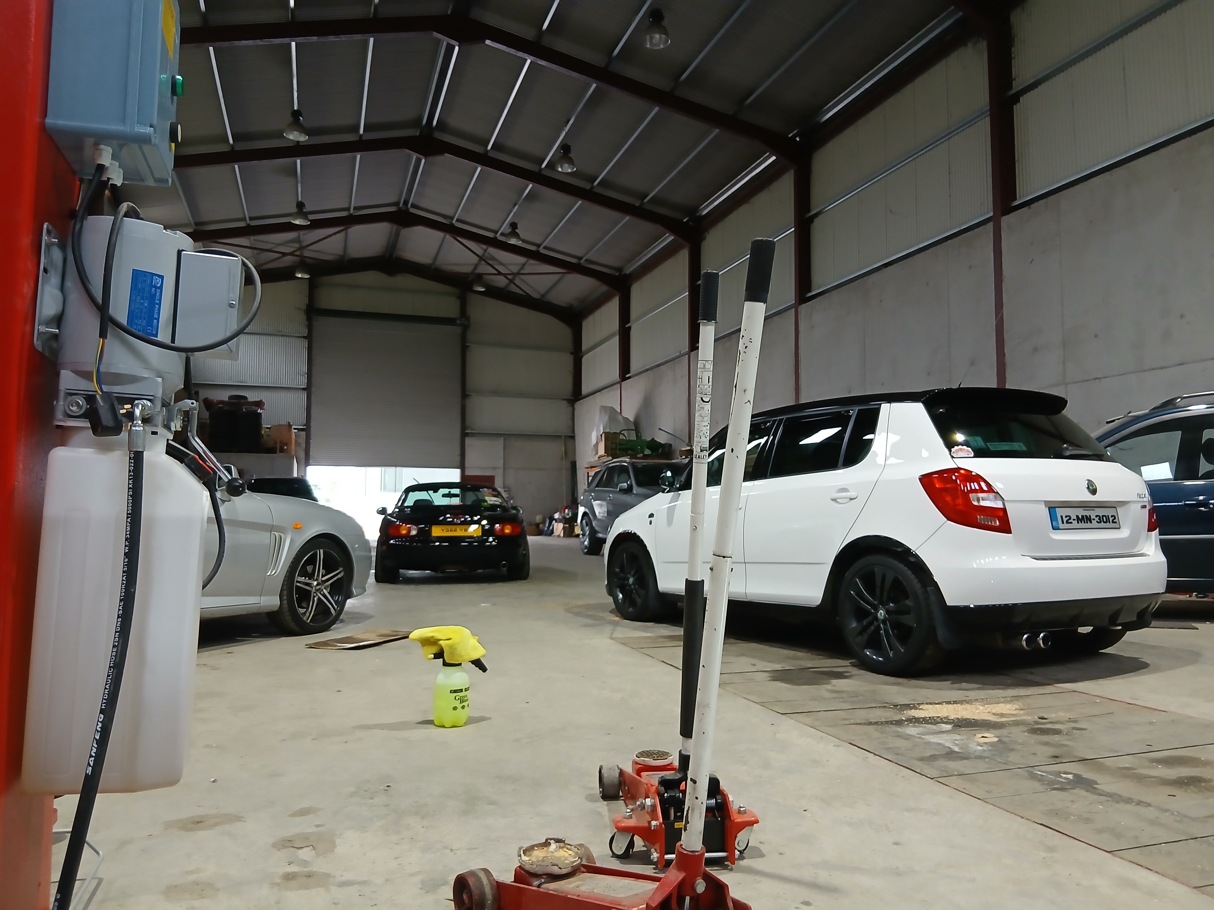

Is running and driving on the lift, changed the oil, new coolant etc. it is very close now.
Have videos I might link later.
No leaks or anything either thus far.

Very happy with the hardpipe kit, was struggling immensely but think I've got it figured out.PXL_20260606_161802274.jpg

Replacement hardpipe from darkside fits much better.
