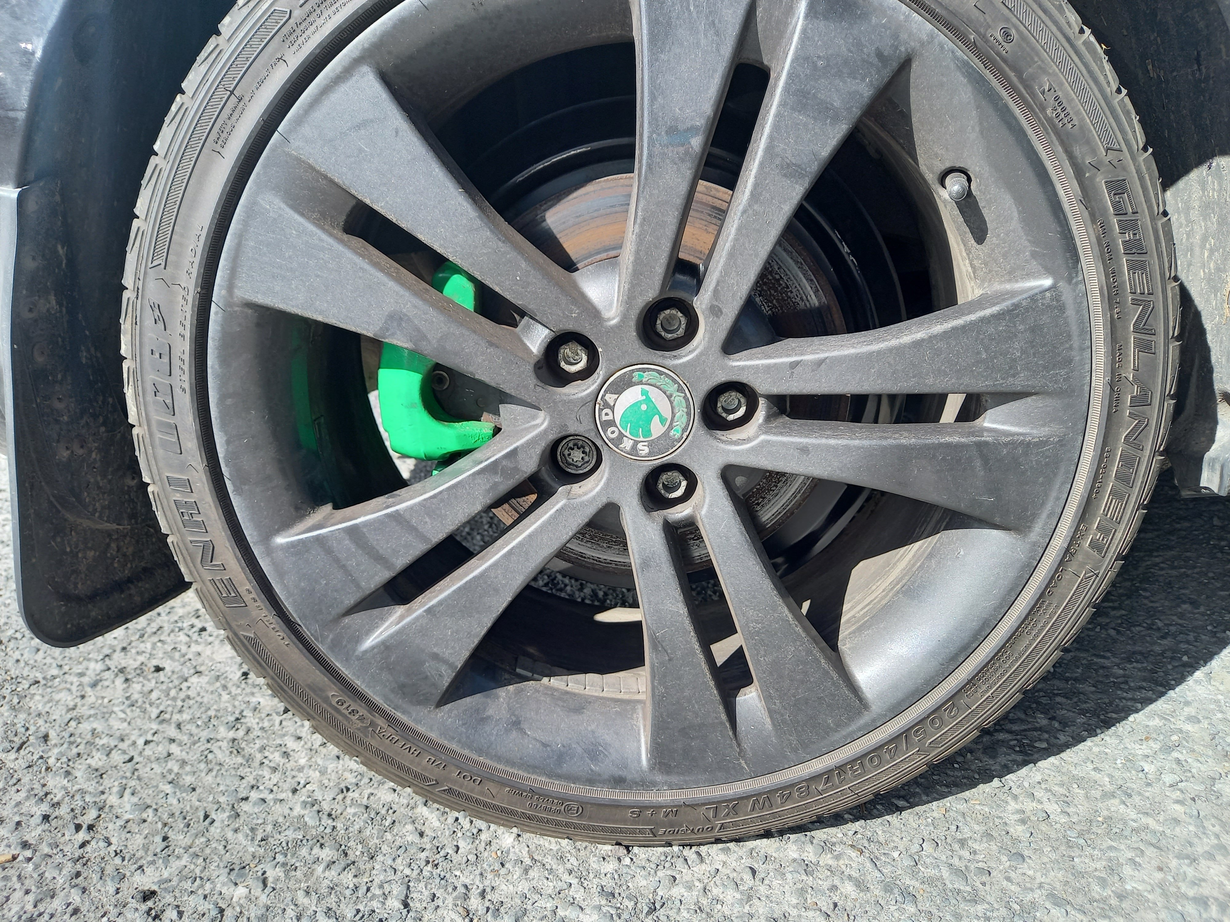

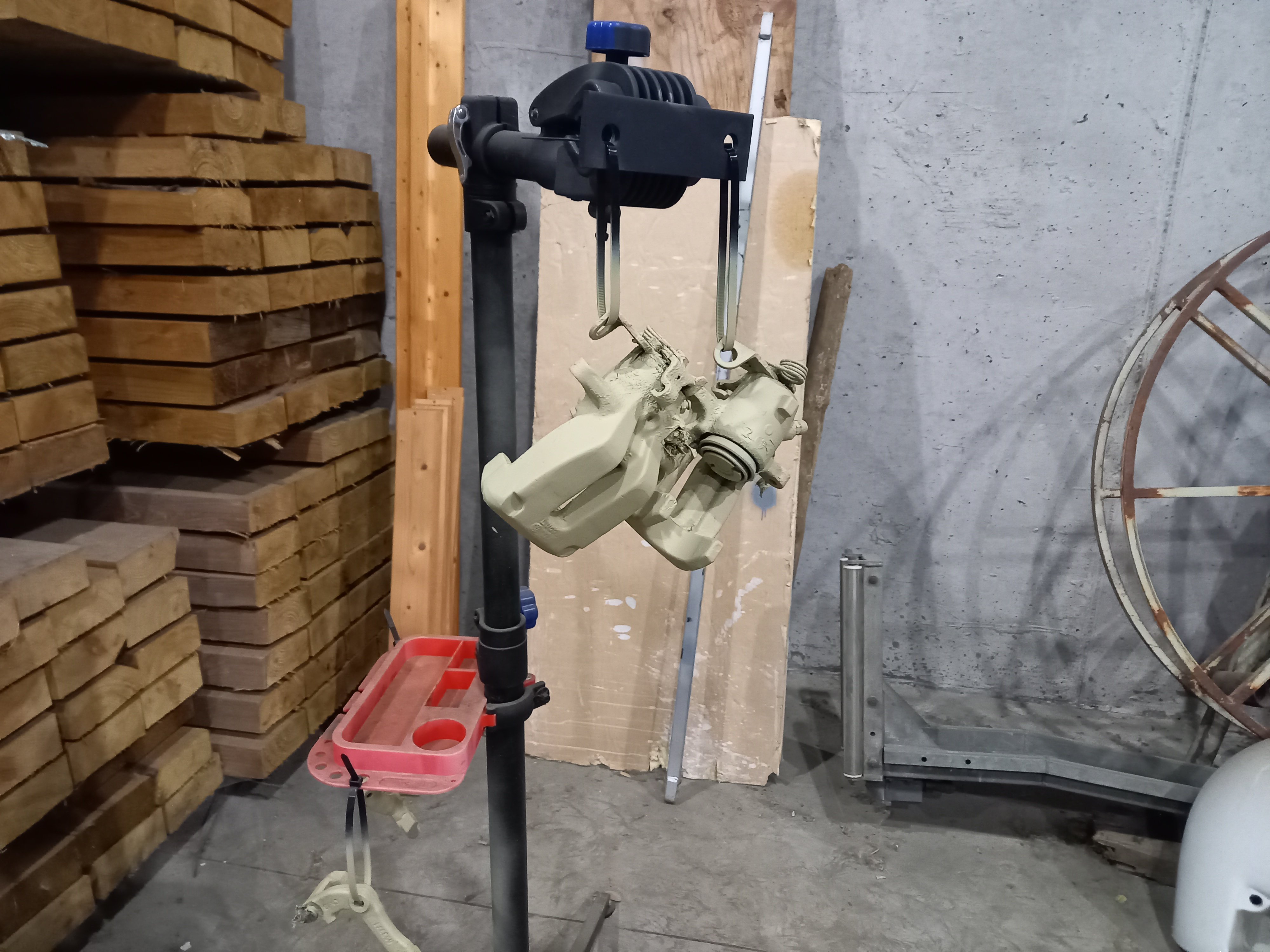

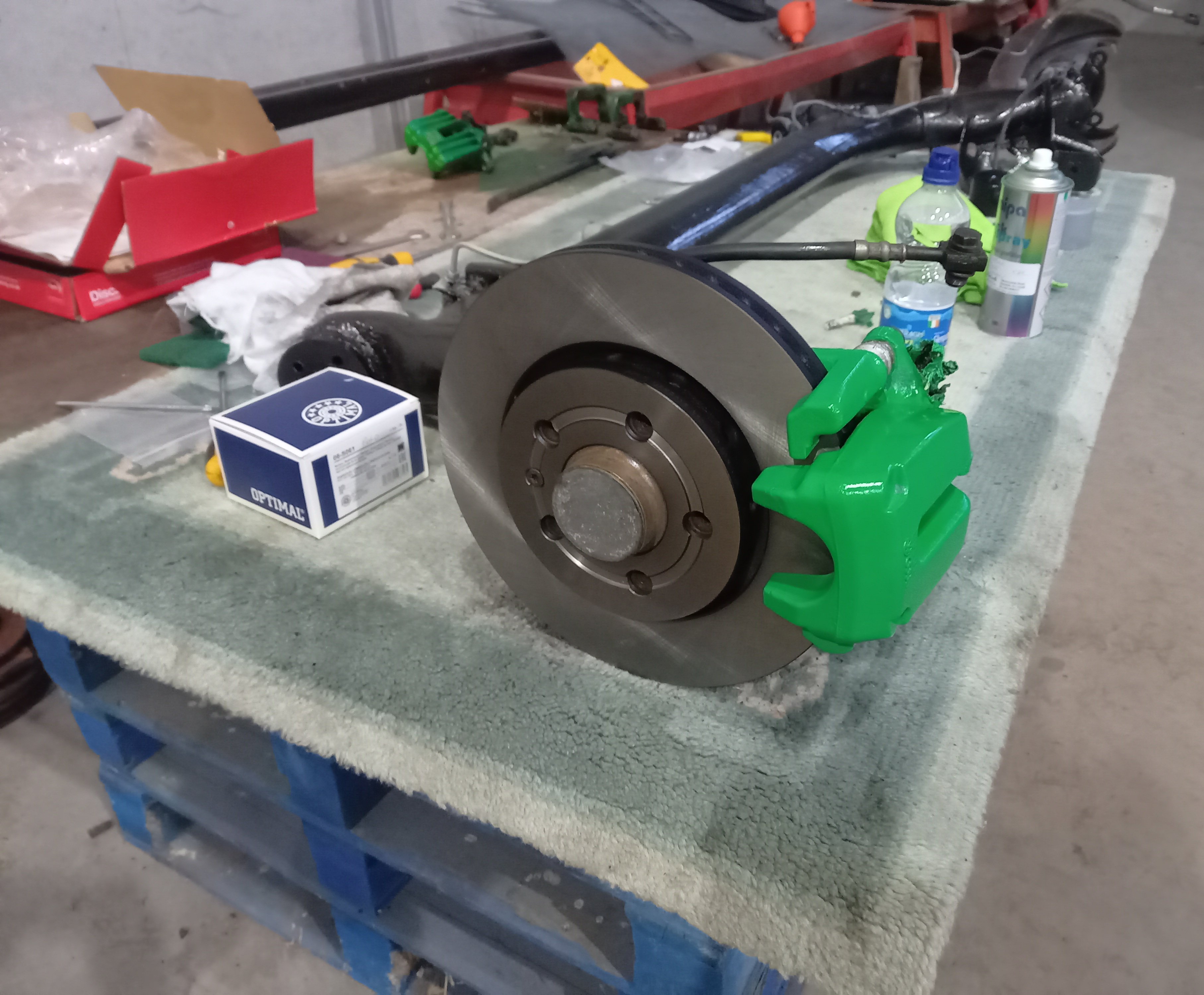

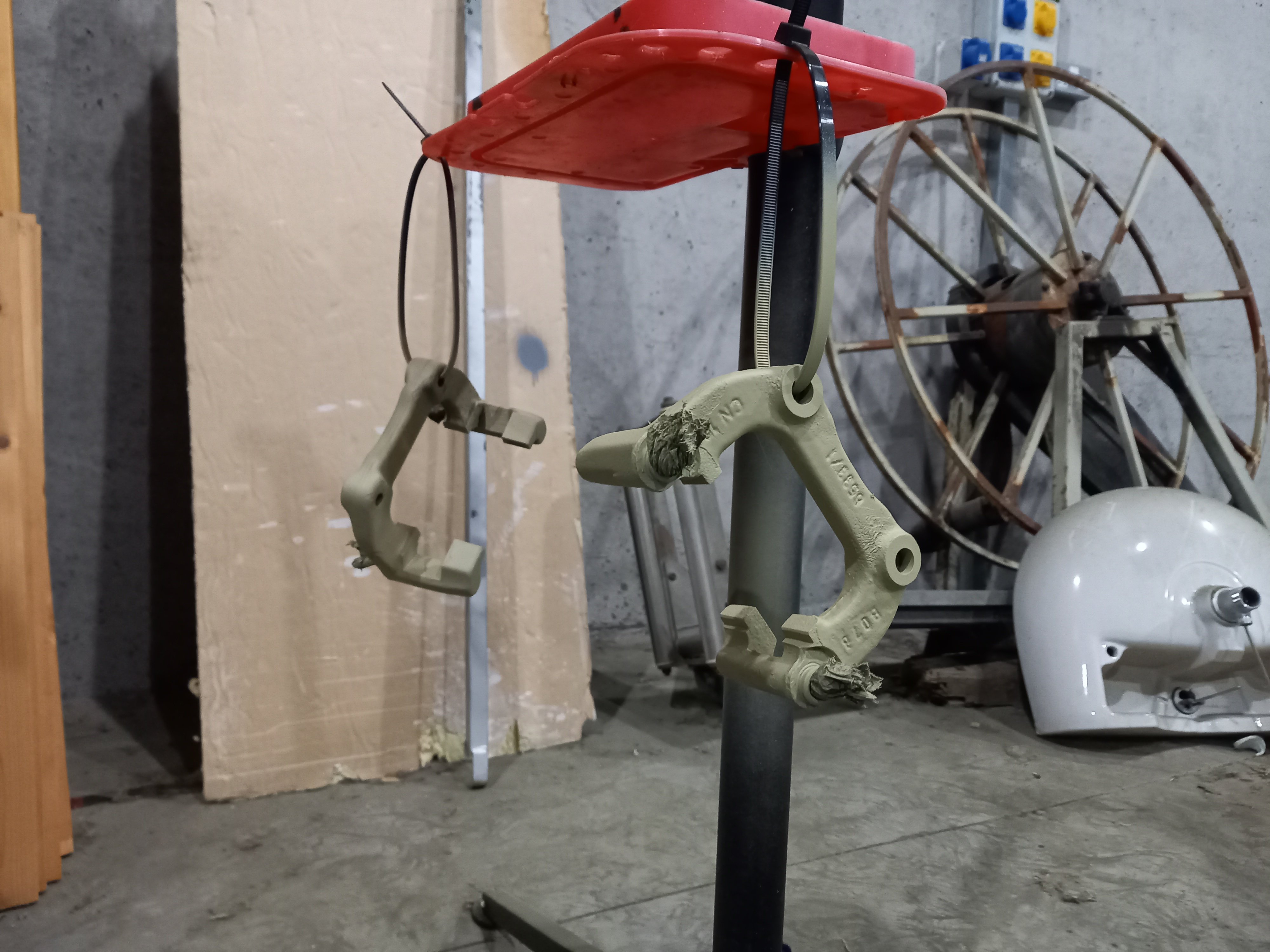

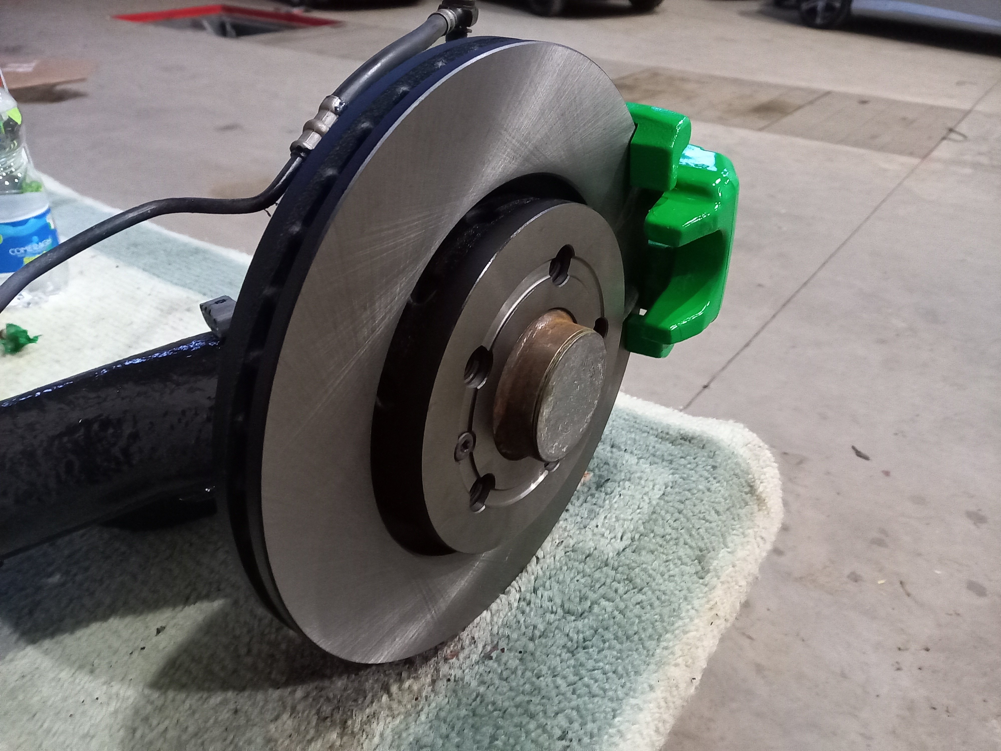

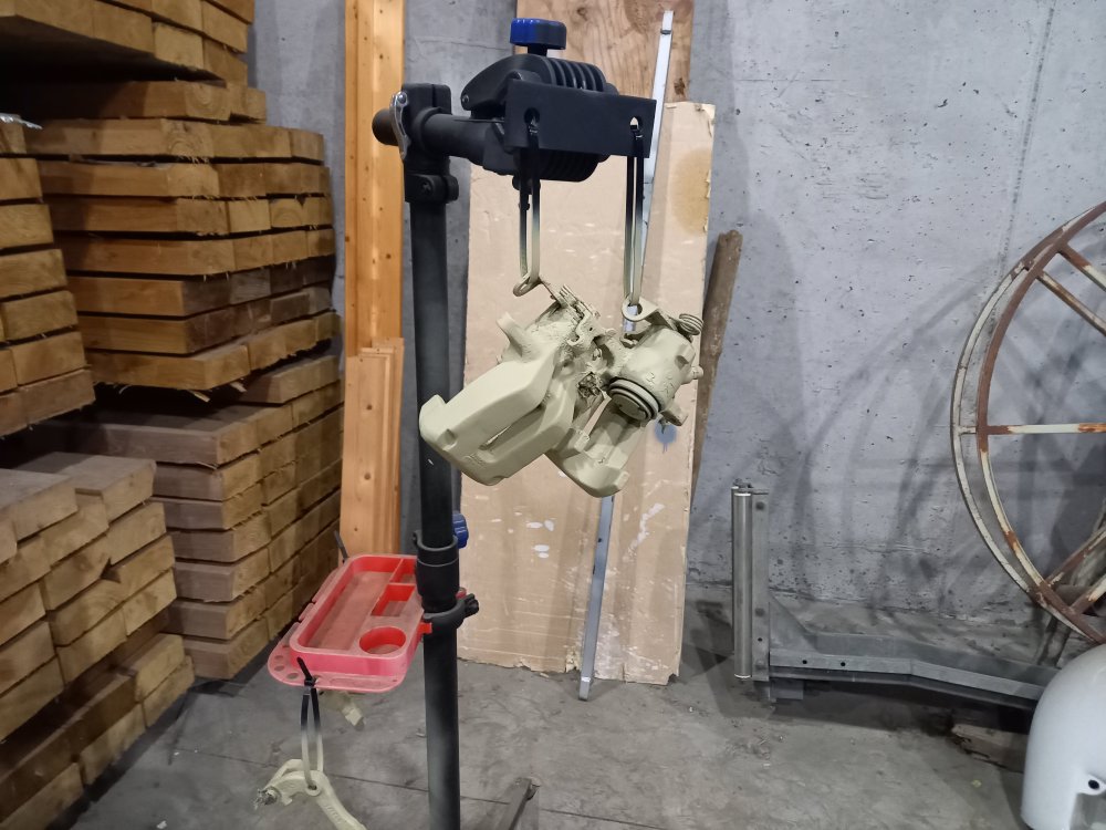

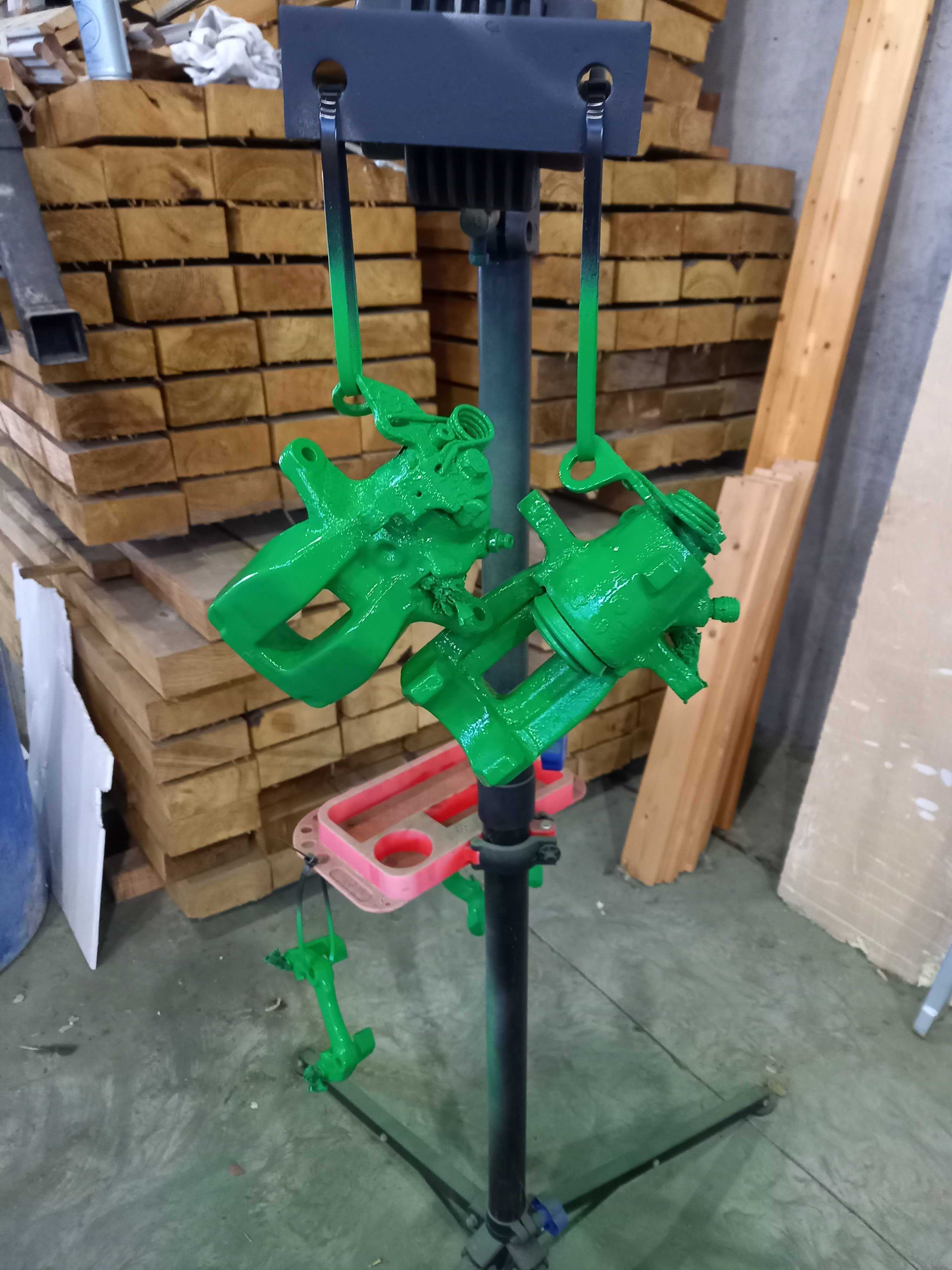

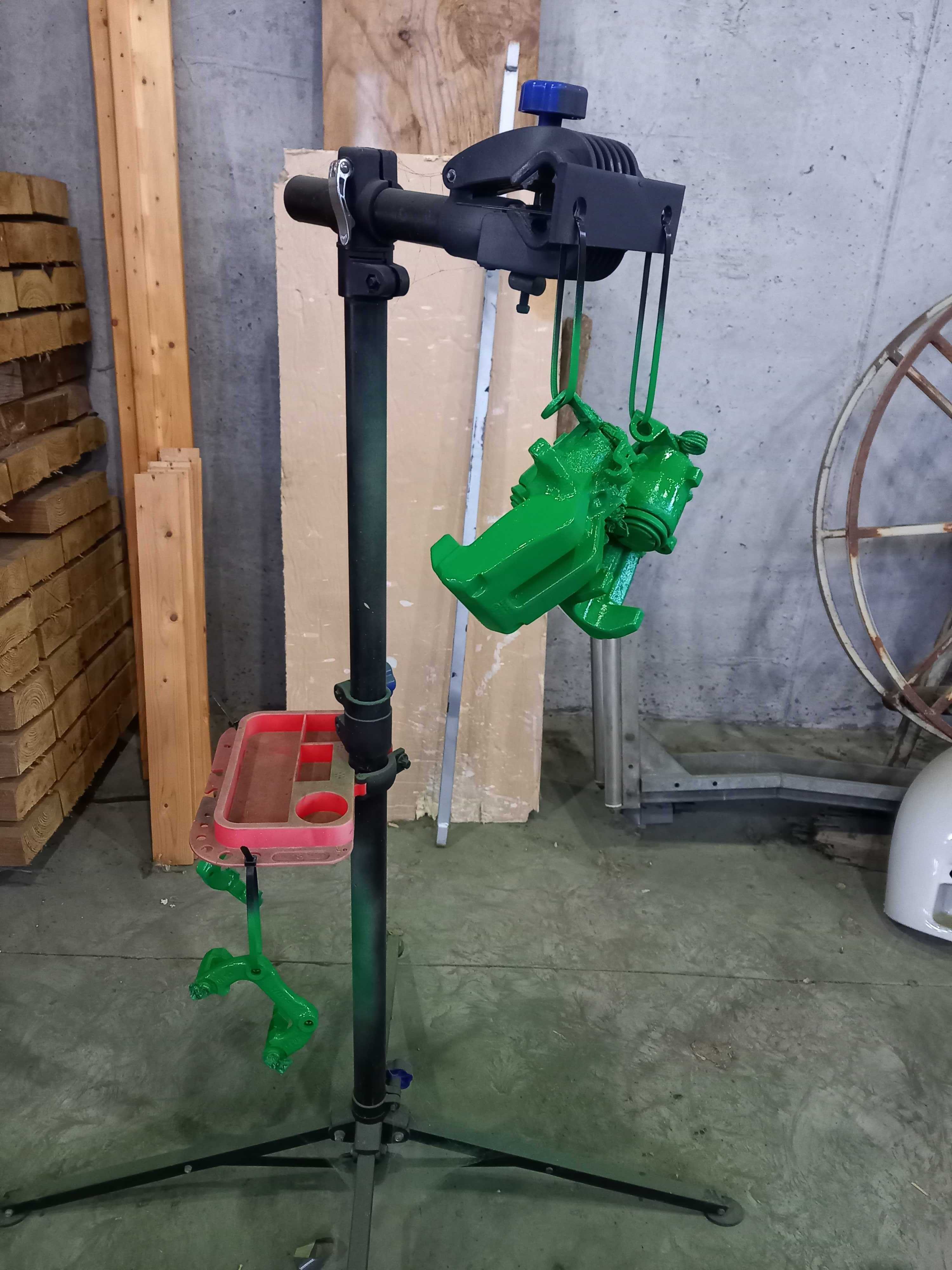

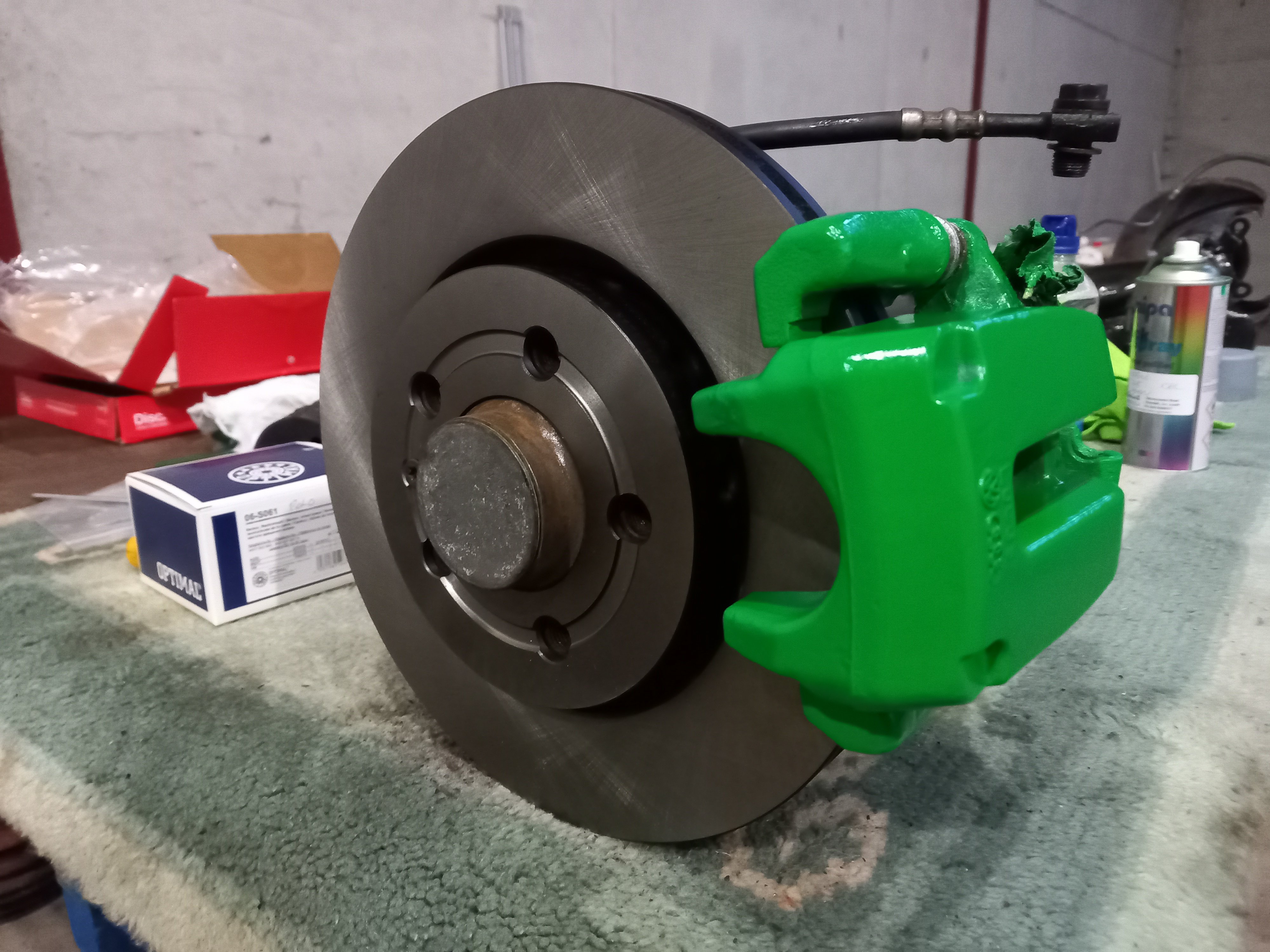

Calipers got high build primed:
20220330_202035.thumb.jpg.0a551c36495ef2522b9a4271aadf3e00.jpg20220330_202040.thumb.jpg.2b4c4ab8047a3766ec92c2a7b61e7220.jpg
Then sanded back and painted:
Got lazy and didnt bother masking off the piston and boot, doubt it'll make much odds.
Also got new discs and an abs sensor as one of them on the axle was damaged getting it off the car and the correct size heat shields ( not sure if they can be put on without needing to replace the wheel bearings.) Its basically ready to go into the car otherwise, end of next week is still when i'm aiming to have it done.

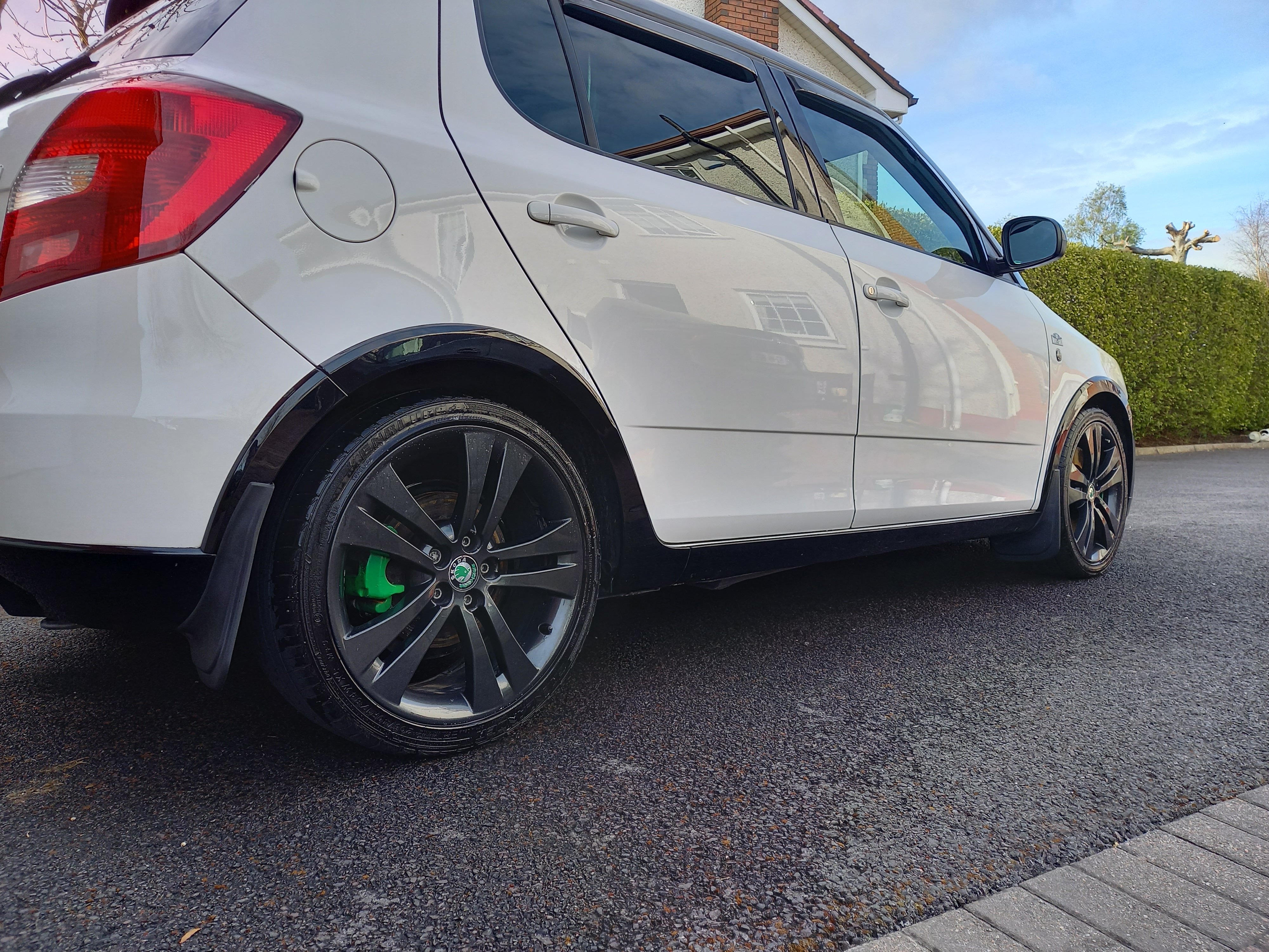

    Lot of progress done since: The axle has turned out very nice compared to what it was before, should keep looking fresh for a while yet.   I managed to find a set of 256mm rear br
  • Very happy with the mounts. So much nicer changing gears and a lot less drama putting my foot down. Slightly more vibrations but not crazy especially this being a diesel.    Wanted
Ooooh that is awfy clean looking. I'm aptly green with envy. :biggrin:
Axle is officially done. Mechanic had a lot of trouble fitting it, both the discs were rubbing on the carriers and the pads I had were too thick and the caliper would not go back far enough to take them. Very luckily I didn't get rid of the discs and pads I got with them, as they were the only ones that would work.

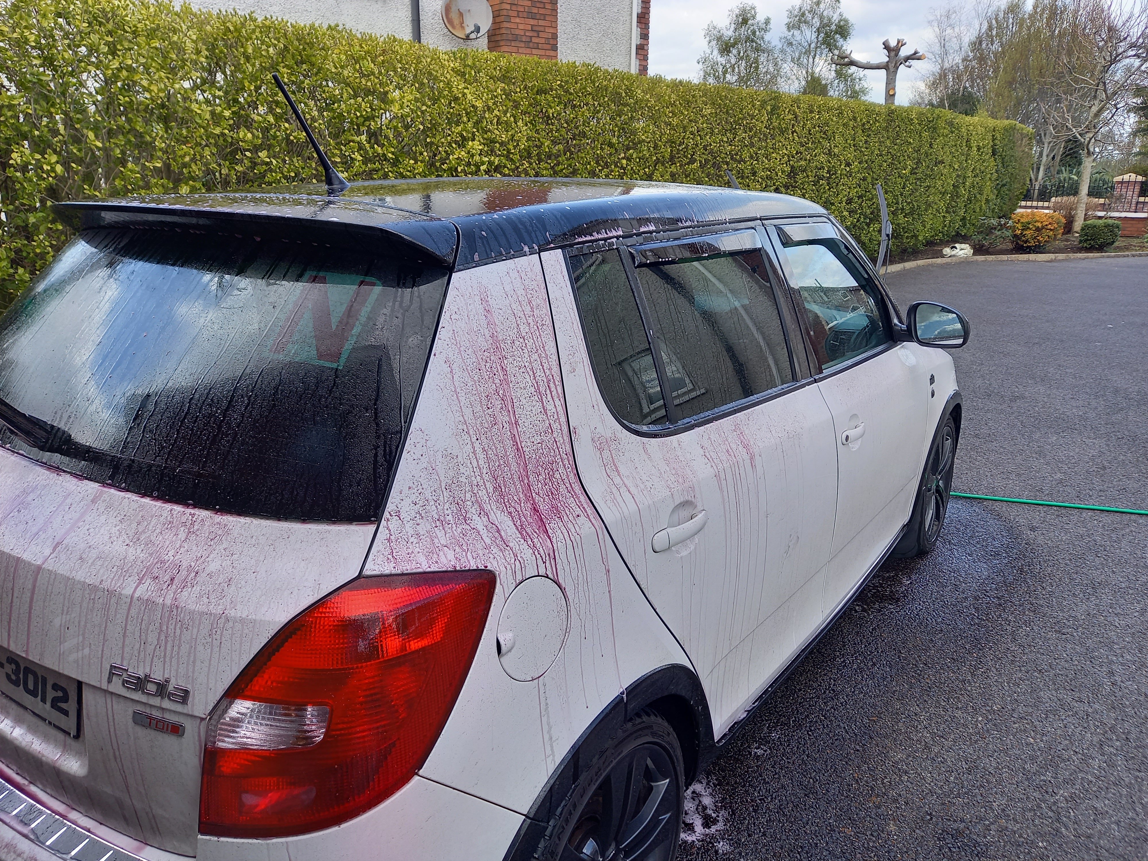

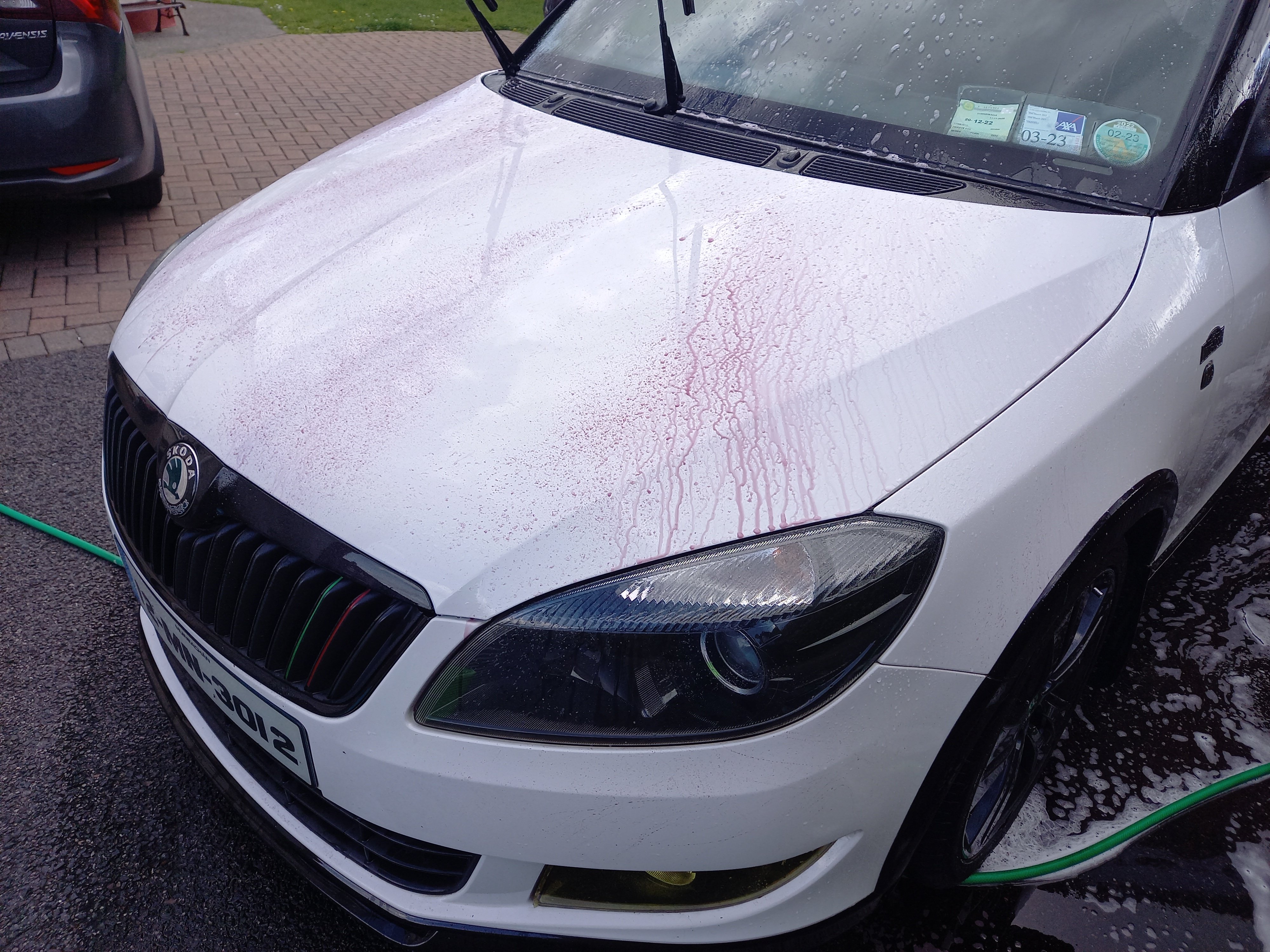

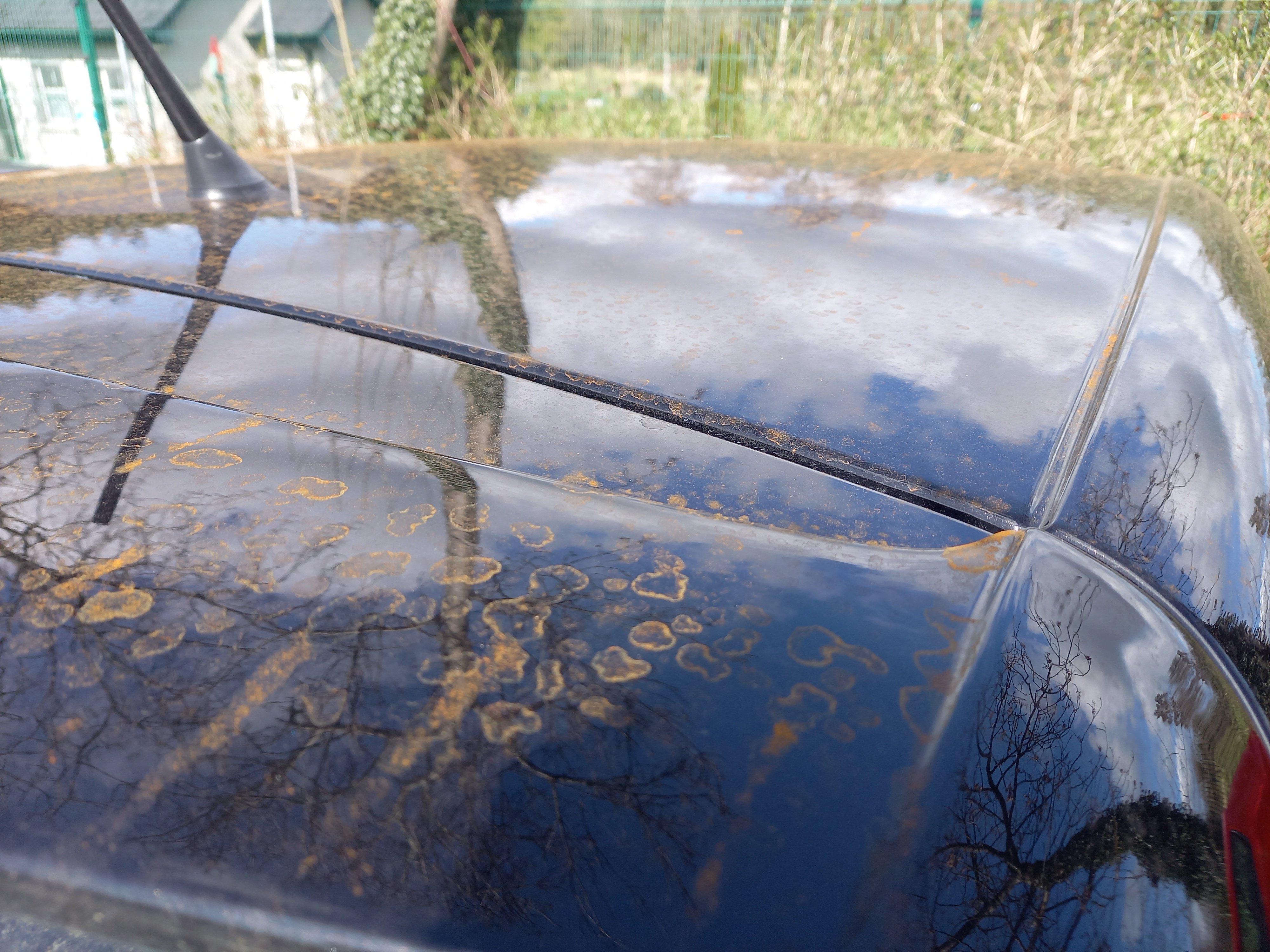

Got quite dirty so needed a deep wash when I got it home.
No clue how it got rust water over the top of it, certainly a new one for me.
Sprayed it down with iron remover to get as much of it off as I could before touching it.
Had to do 2 even 3 passes in some areas, and it seems to have etched into the roof slightly. It'll polish out easy but I'll do that another time.
Anyhow, some before and afters:
Currently I don't have my rarb on as its on the old axle which I still need to pick up. You'd know it was off, I think i'll sand it back down and paint it before it goes back on. I know its only cosmetic but its still shocking how quickly that rarb started to rust.

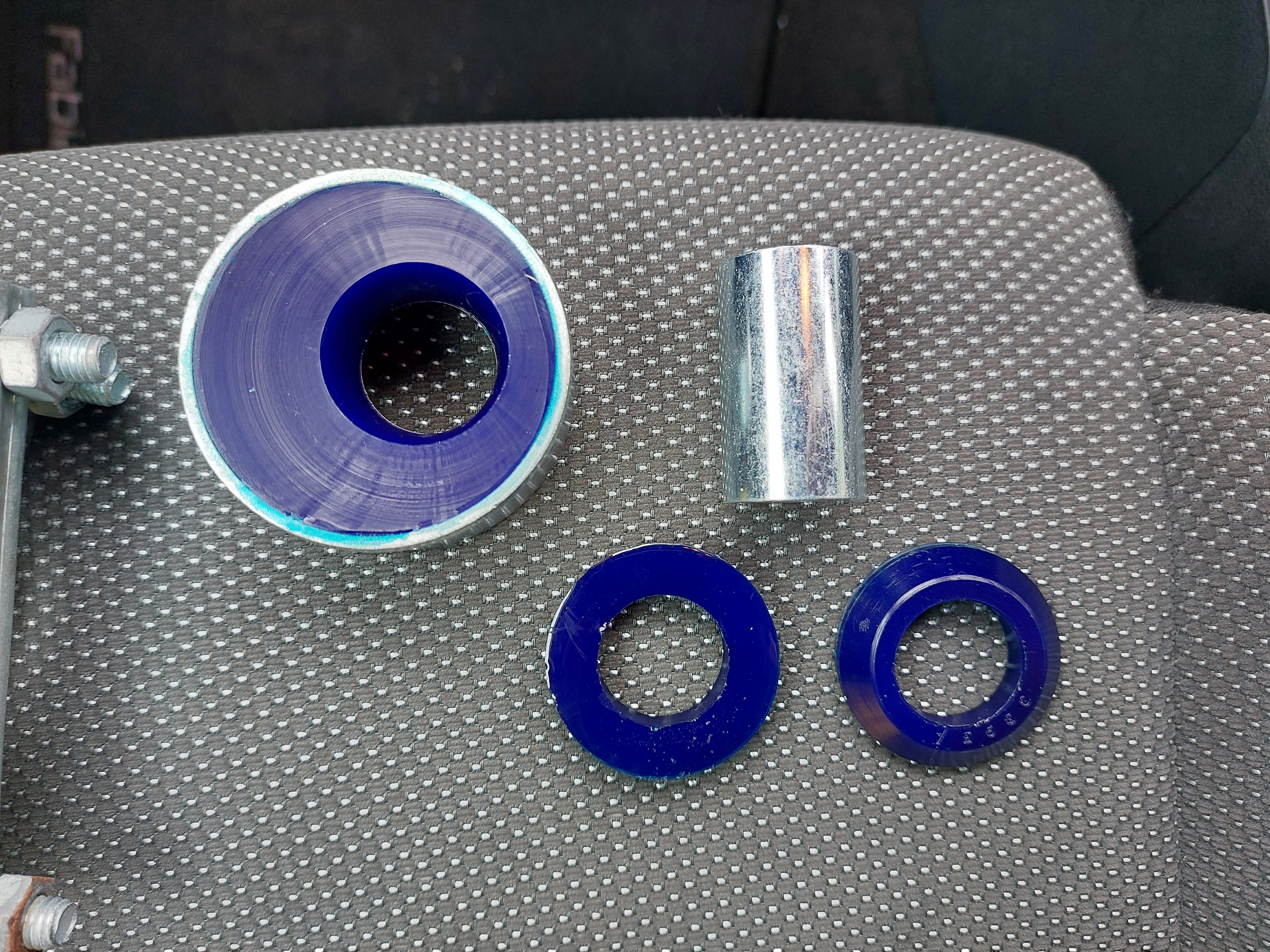

New polybushes are absolutely perfect so far. Car rides fine, no more harsh than it was before.
Haven't driven the car much so the rear discs havent had the chance to clean off 100%. What I can say so far is that the handbrake is fantastic compared to the drums. Brakes feel really good in general, imagine they'll be even nicer after they settle.

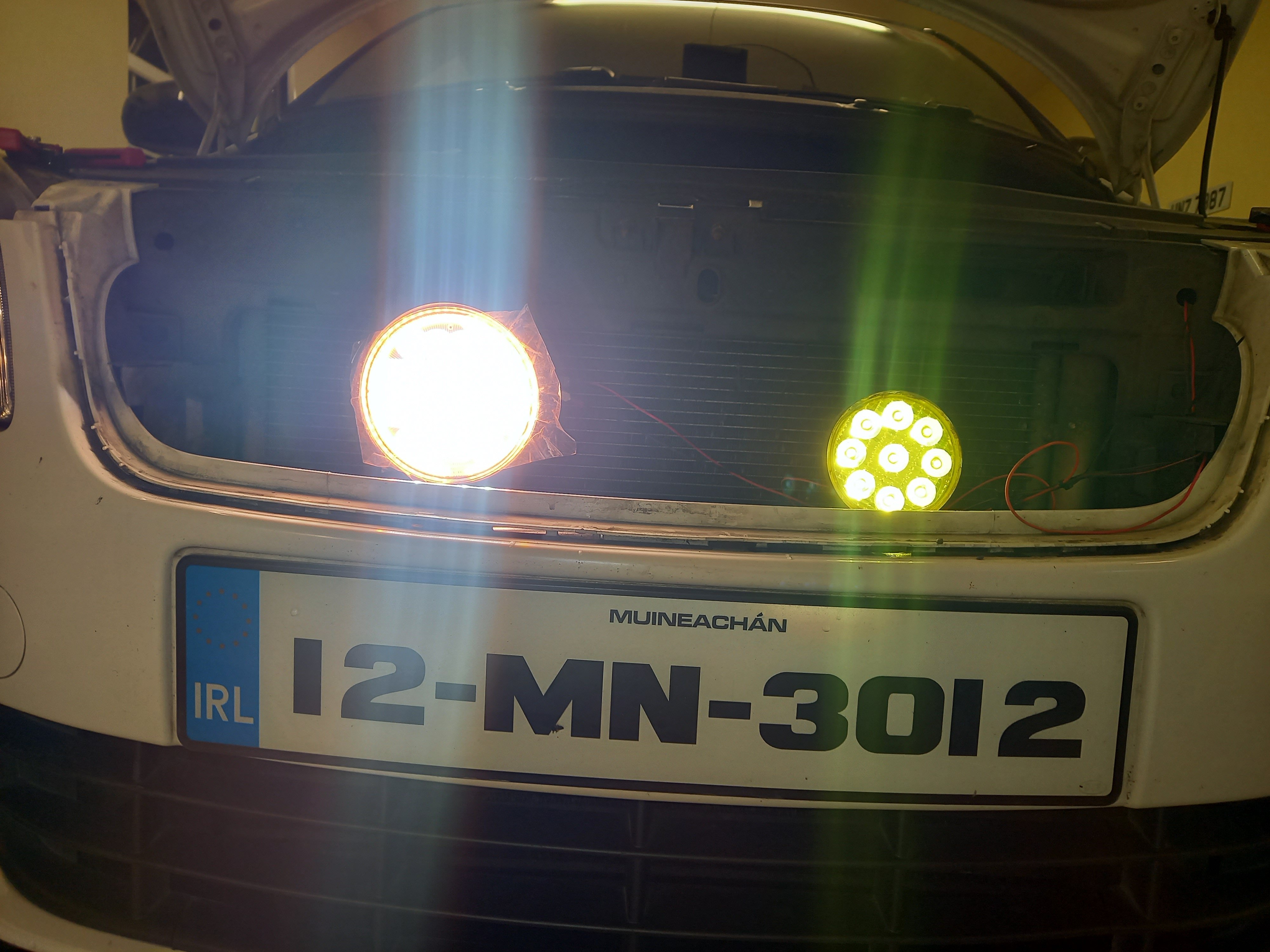

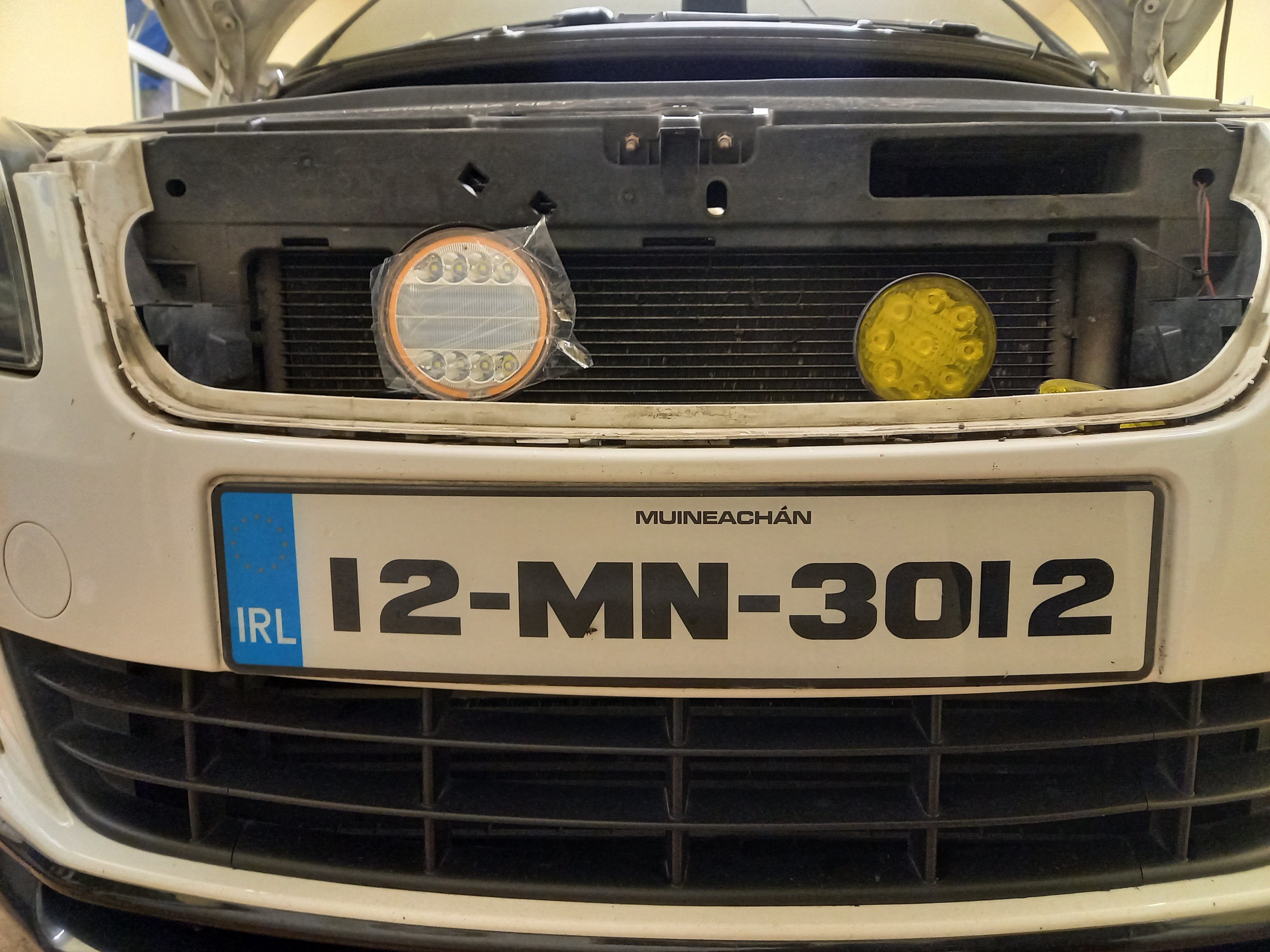

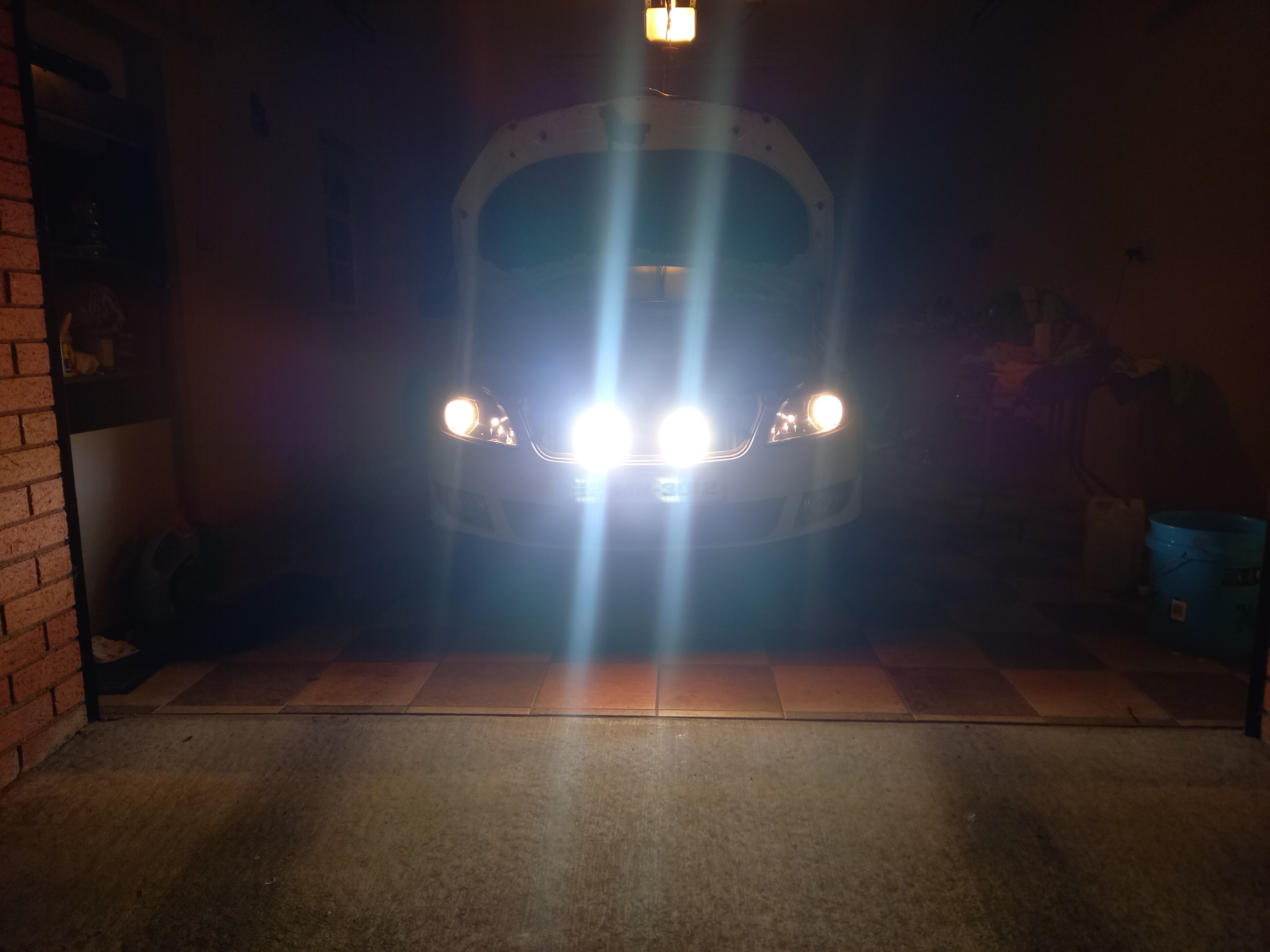

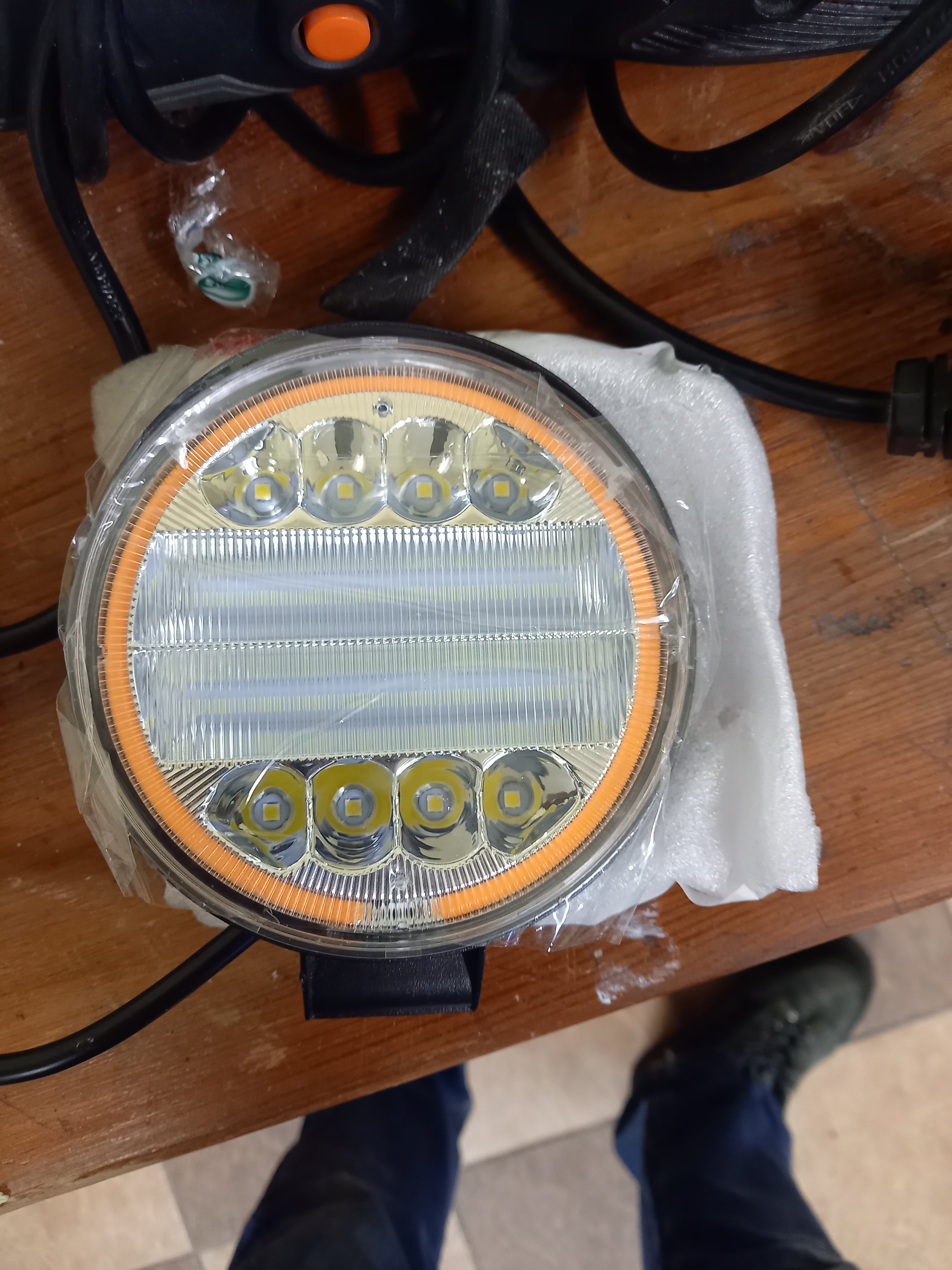

Got some larger spotlamps to replace the 3 inch ones I had before. These ones are 5 inch.20220419_200648.thumb.jpg.5c1d1a0851fa50bf1dade5ad0331414a.jpg
Much larger than the old ones naturally enough and it didn't take me long to wire them in.
Old ones were decent, but these ones are even better, far more light cast out, reaches more distance and spreads better.

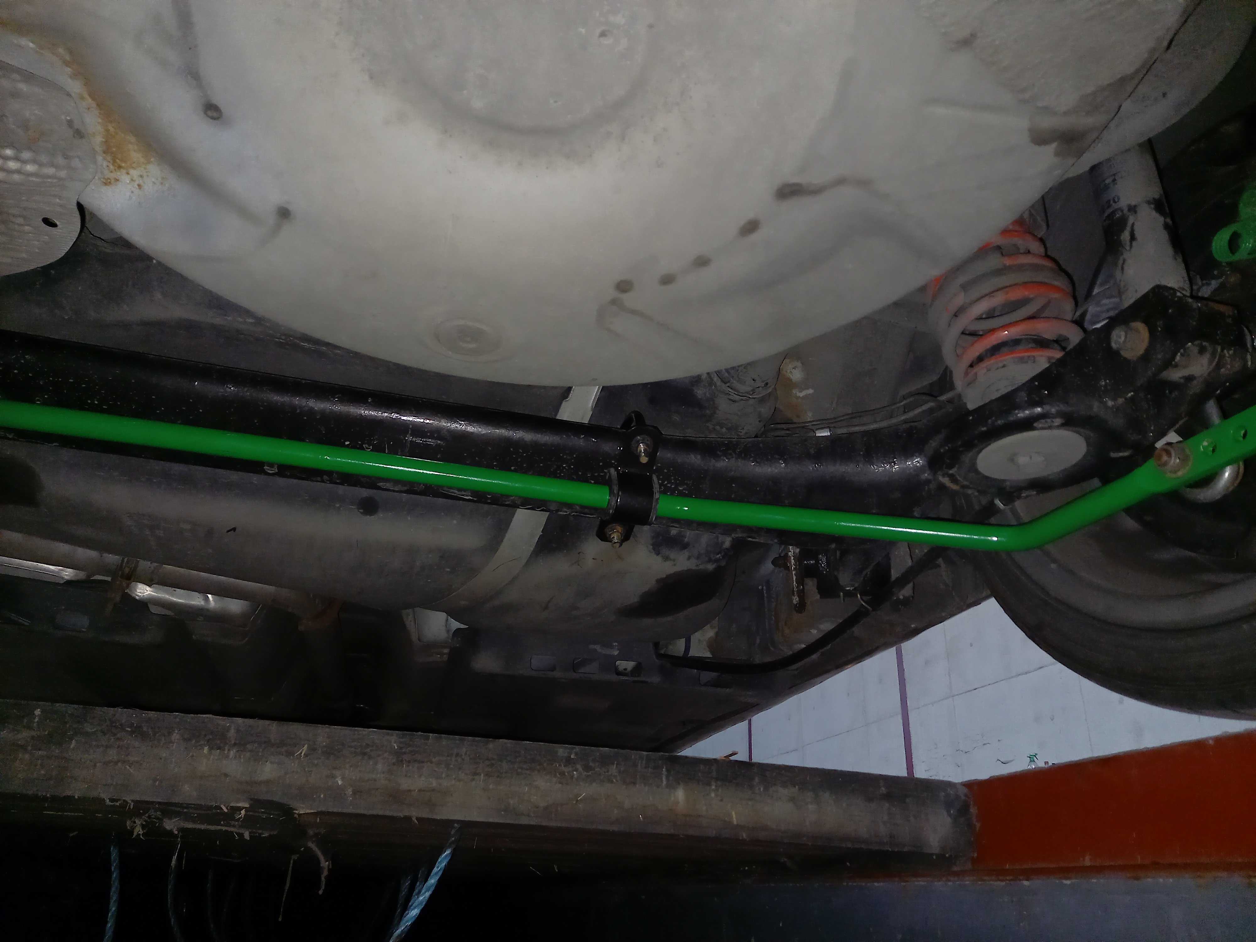

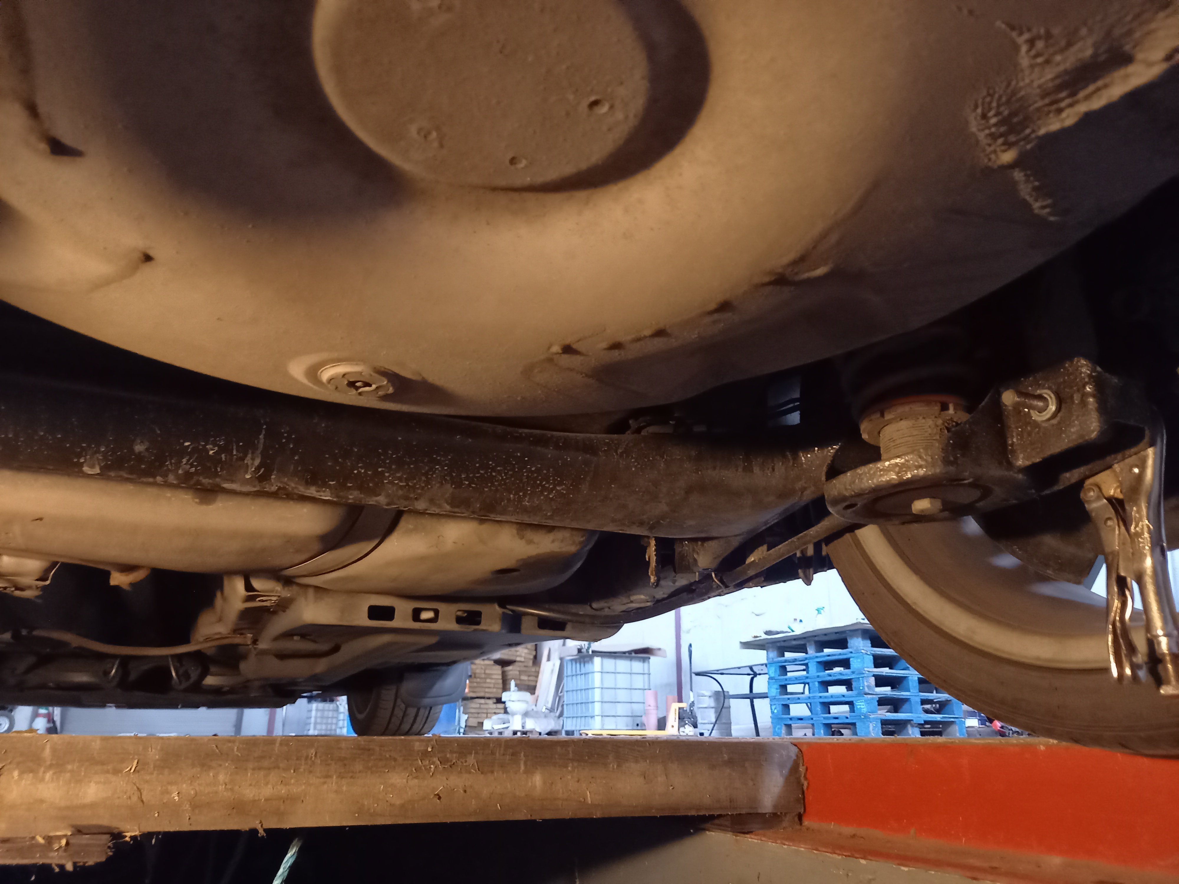

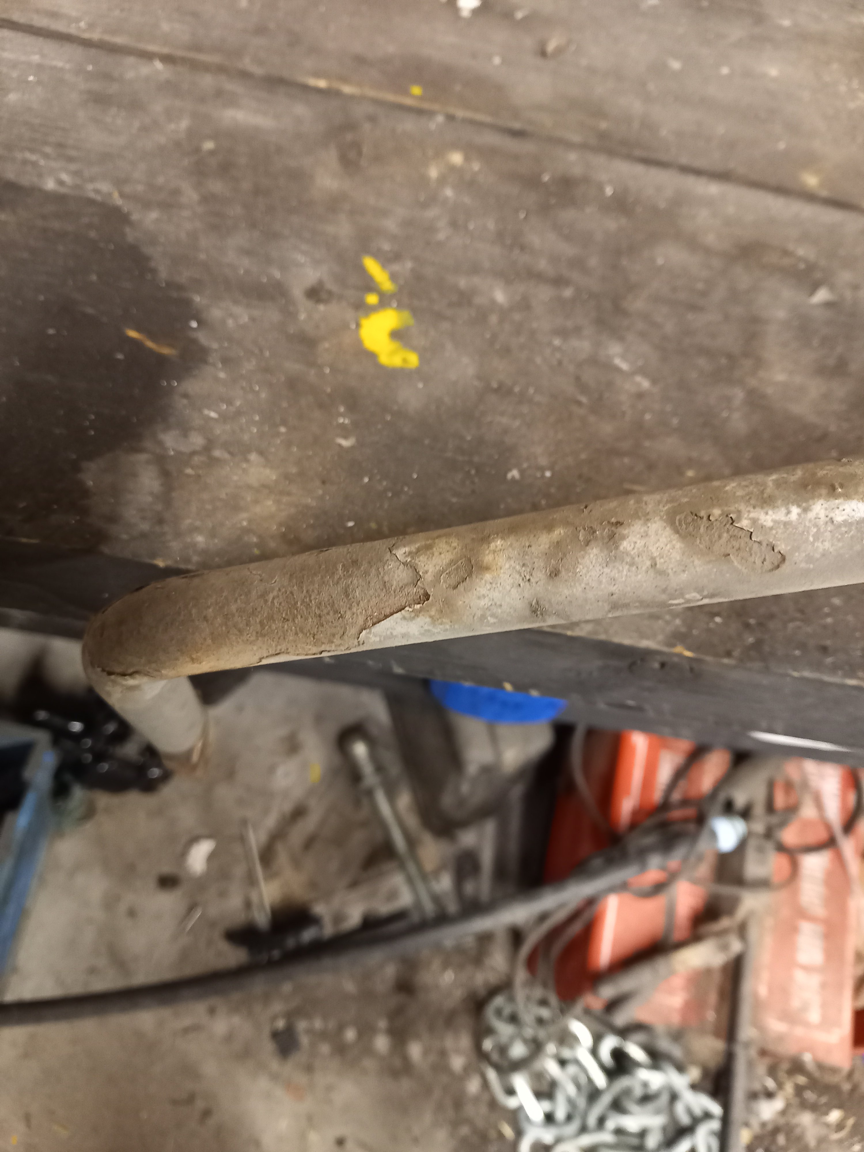

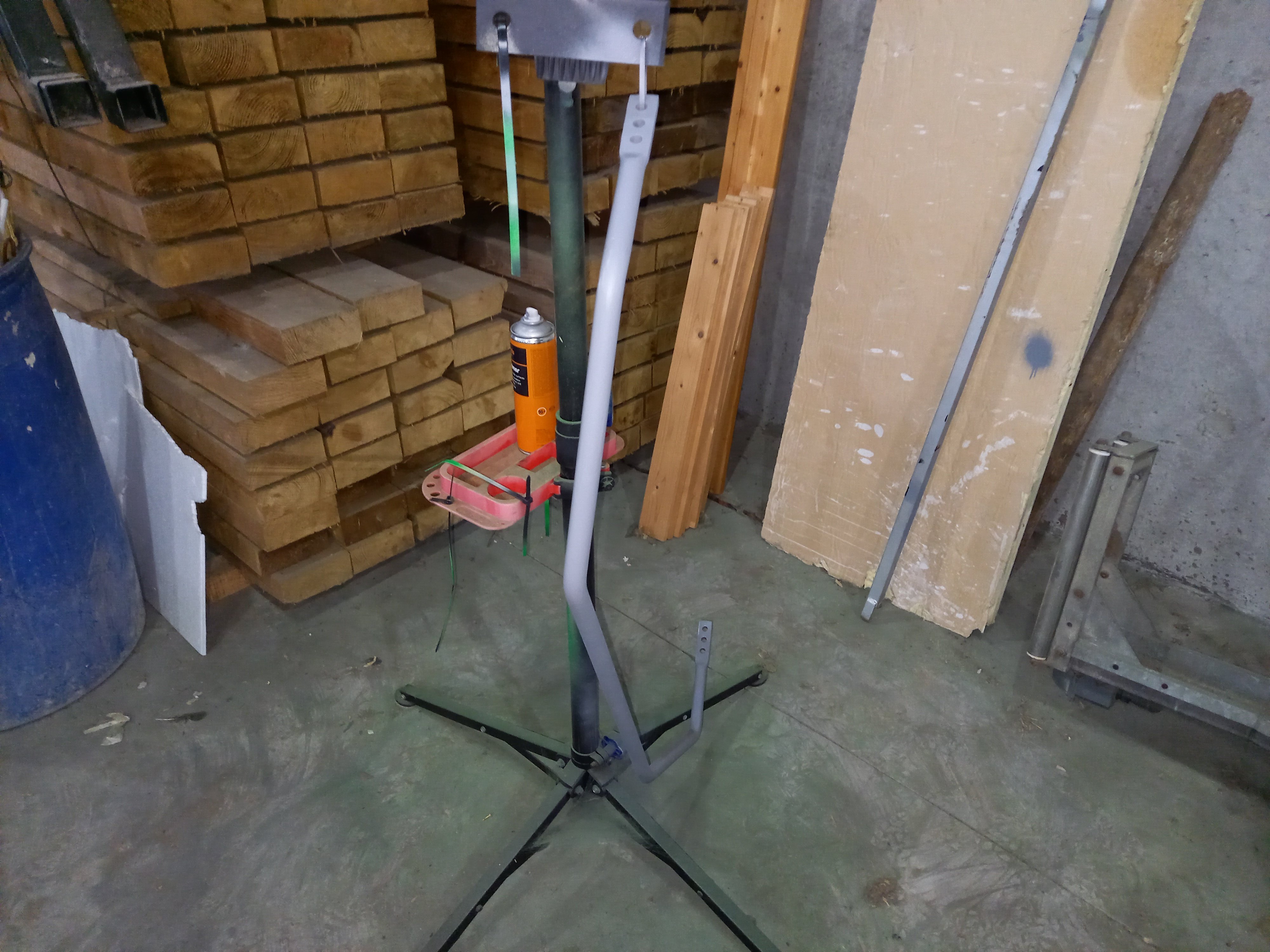

My RARB was on the old axle still so I wanted to paint it while it was off the car, got it sanded down, painted and ready to go and then as I said above, got too busy to go out and fit the thing until this evening.
Its purely cosmetic, but still very poor job on the powdercoat this came with (bought it brand new from whiteline)
Ground all back
Primed, then High Build primed.
Then was painted to match the calipers and finally fitted this evening.
Some rust on the shell, and marks on the axle from fitting that need looking to, but not enough time this evening.

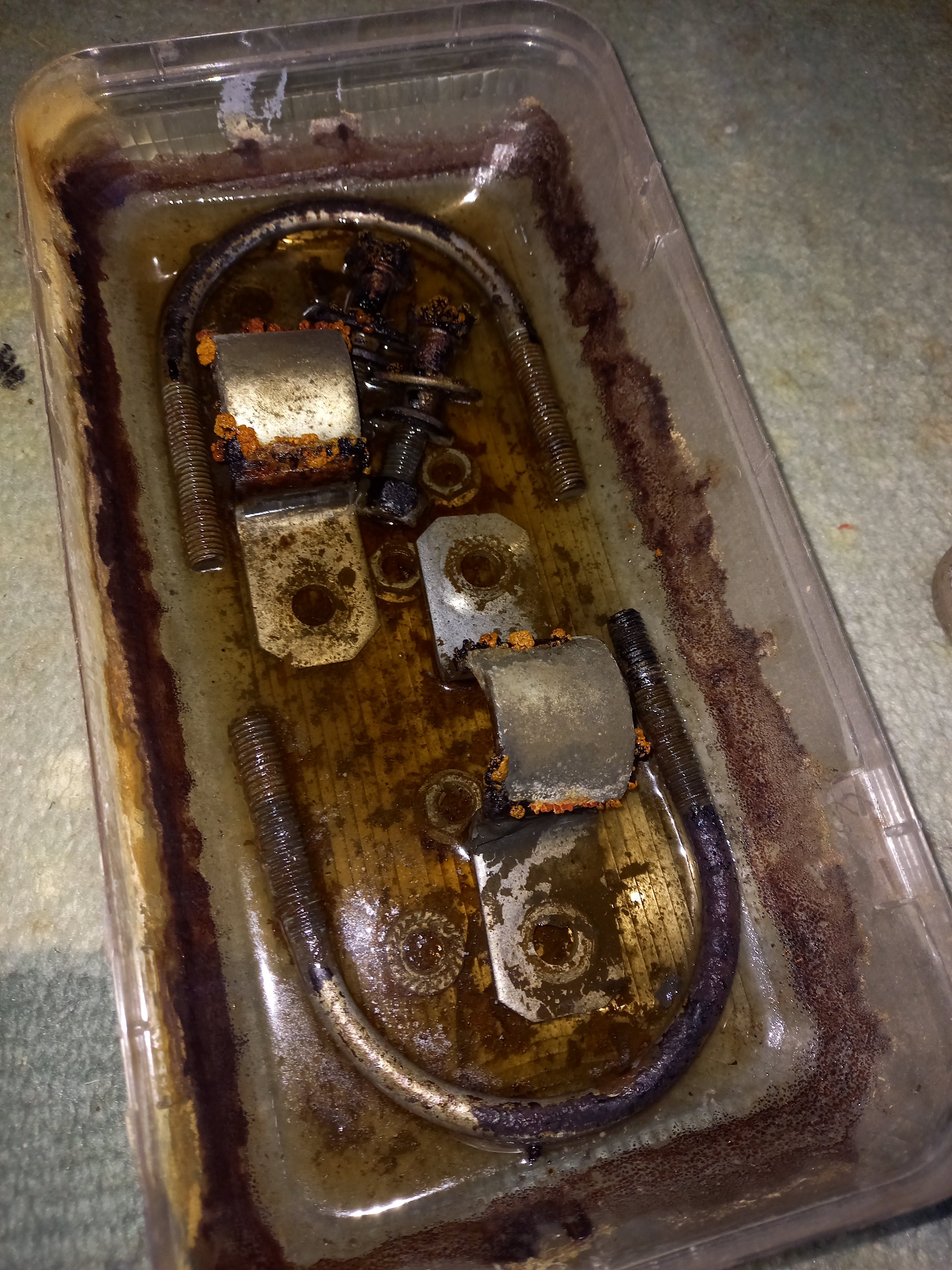

Worth noting that I soaked the hardware in a vinegar bath to knock off any rust on them. Which worked very well.
These got a coat of hammerite before going on the car.
I'm glad to have it back on the car, immediately noticed the difference

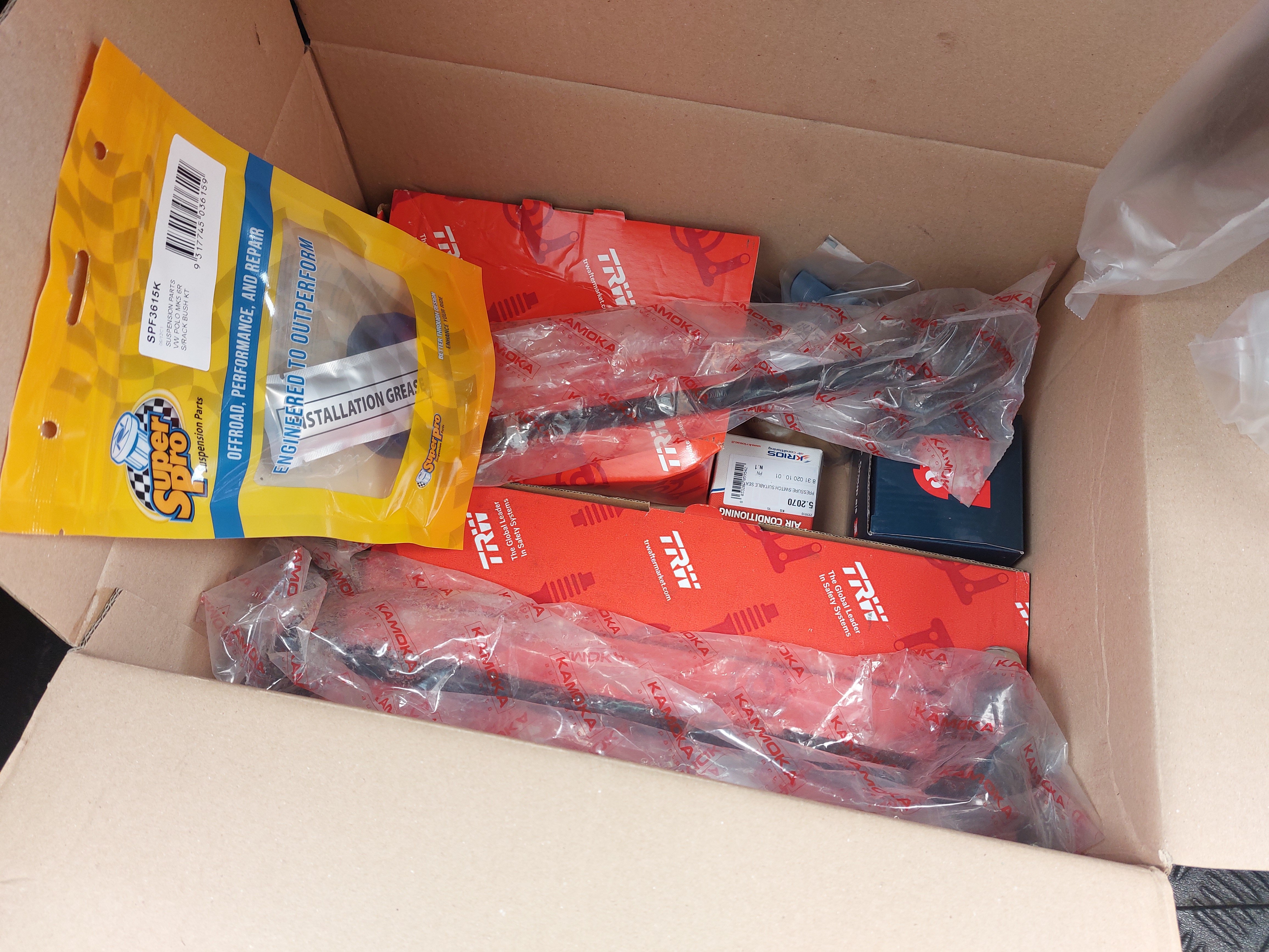

Ordered some stuff from creations motorsport for an upcoming project, and also ordered a short shifter while I was at it. Had ordered one before but shipping to Ireland post brexit meant it got returned to sender, and I got my money back.

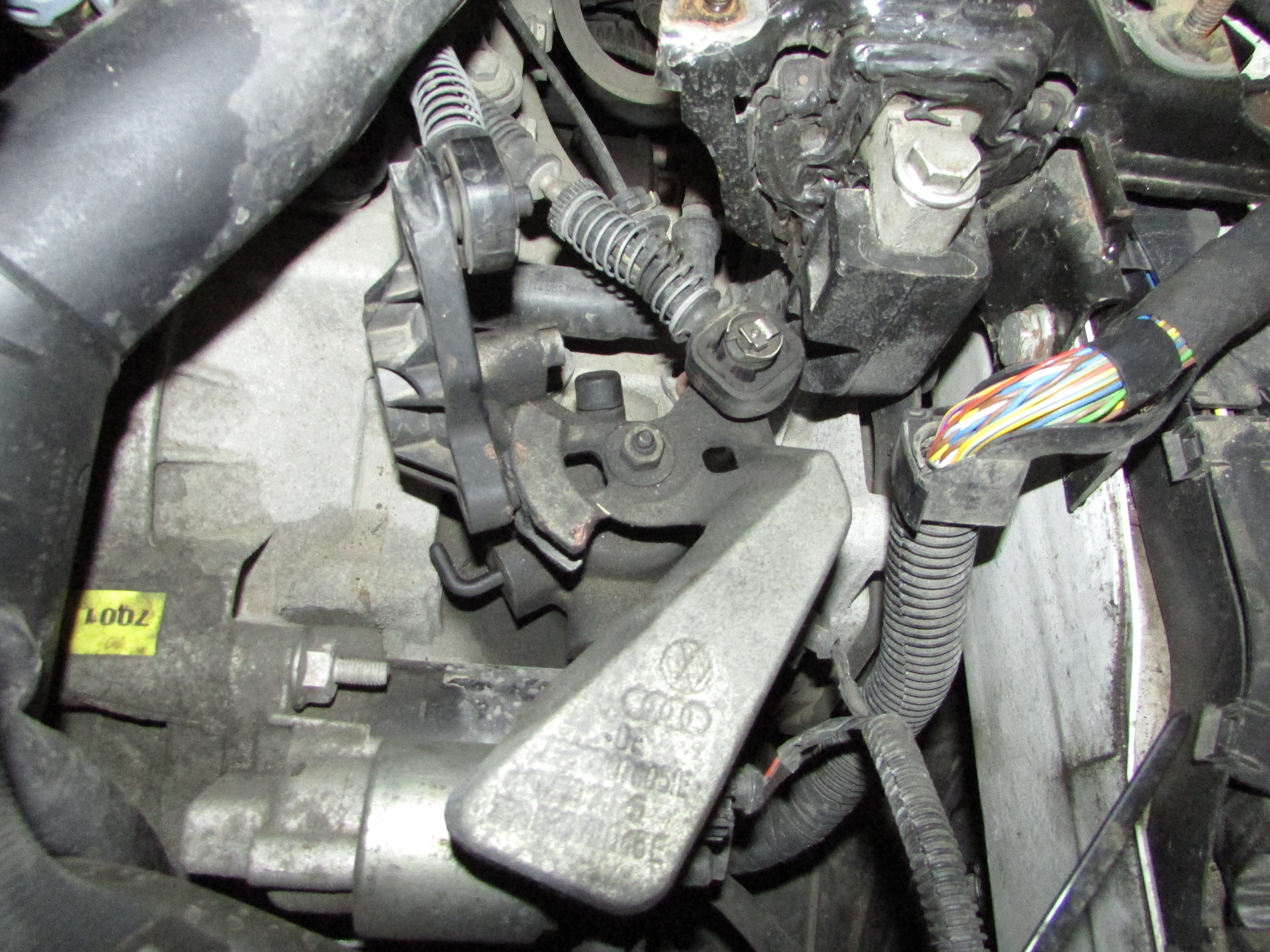

Pretty simple job to do and has done what it claimed and shortened the length between gears. Thought it was too short at first but after a few minutes it felt just right on the shortest setting.
Short shifter lacks the large weight so it feels a little more notchy than standard also.
Also filled the bushes with tigerseal to stiffen things up further.
It did make a difference but didn't help some side to side slop I was feeling beforehand, but I found where the slop was coming from when I was doing this.
Something to fix in the future but not really an issue now. It feels great in spite of this.

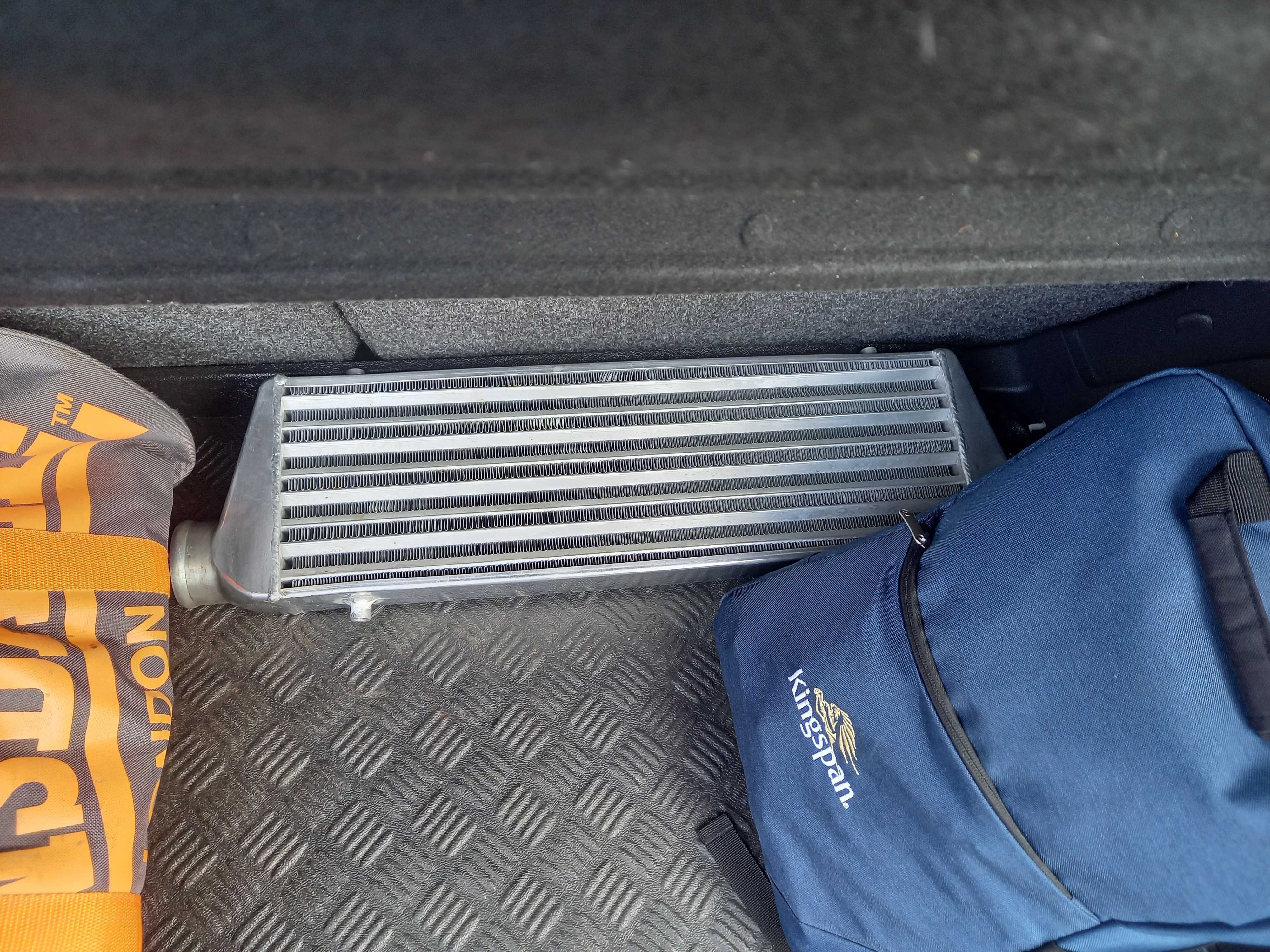

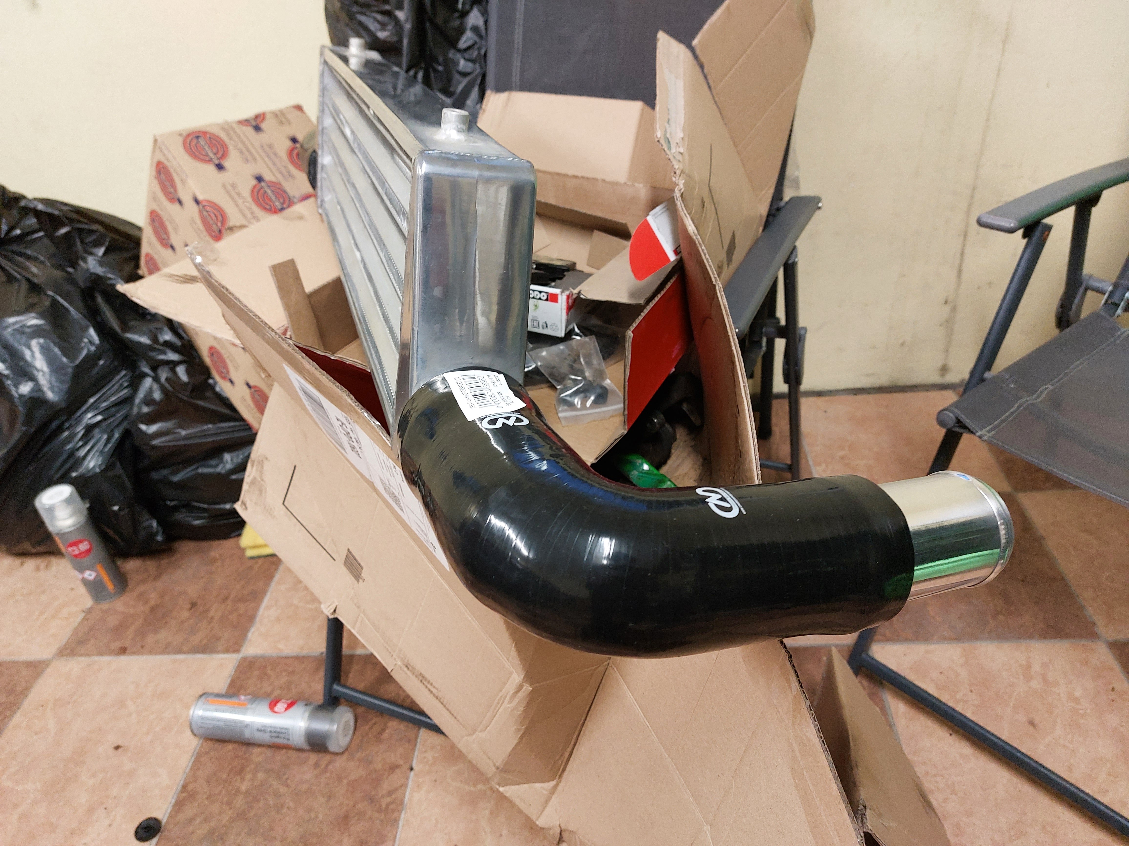

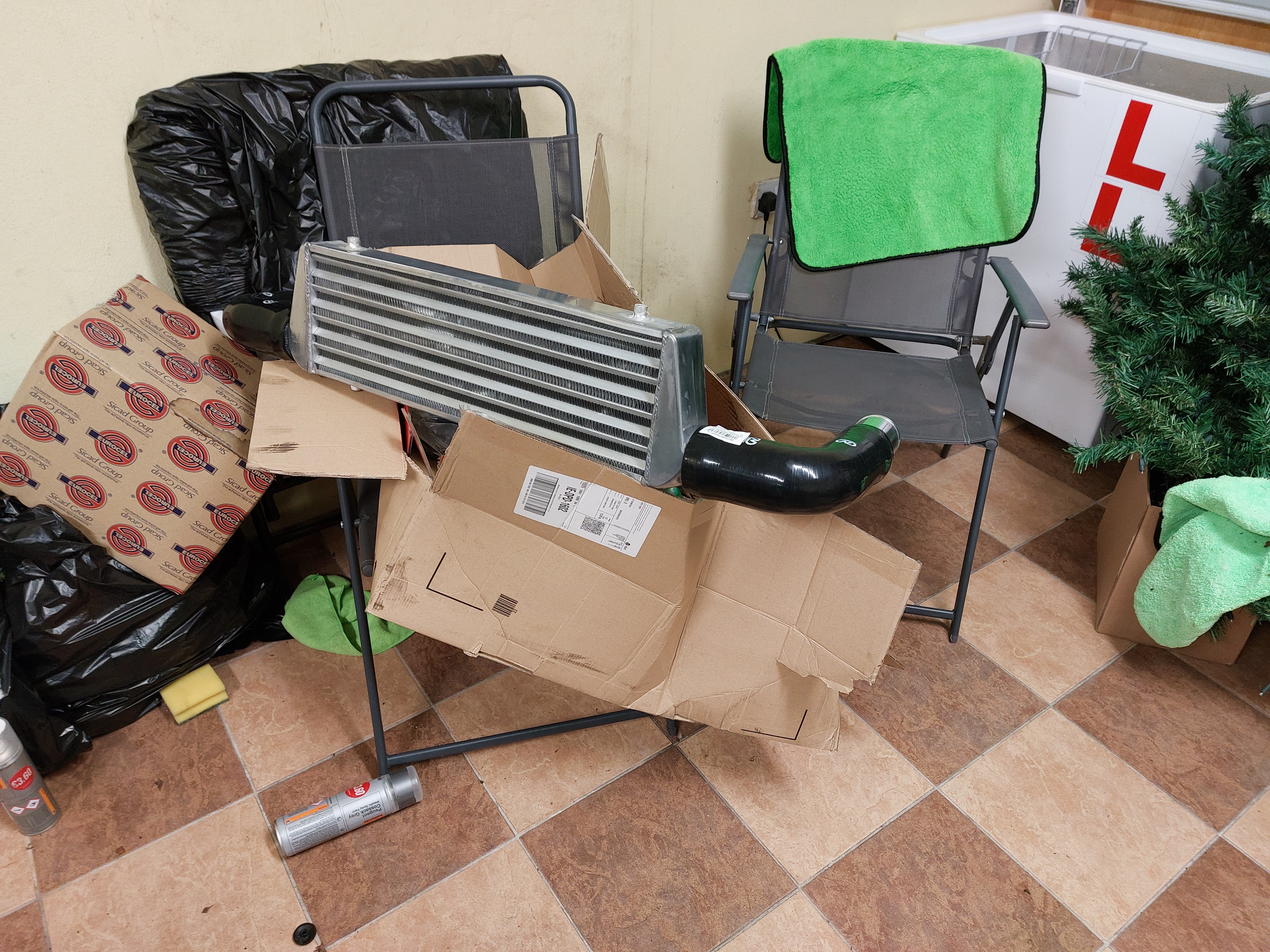

Now for this upcoming project, its an Intercooler. I got an intercooler in good shape off marketplace, and ordered some 90 degree reducer bends and joiners from creations motorsport to get it to join with the original piping.
All it needs now is some good clamps
20220516_213606.thumb.jpg.3572a8e954dd560036a4183a262fe722.jpg20220516_213613.thumb.jpg.8bb1d98c60d8ebf642a3f0f95fa93407.jpg
I don't want to start on this until the Mk1 is back on its wheels however, so this might not be done for a while. Also want to get a catch can to install at the same time, to keep the intercooler clean for as long as possible.

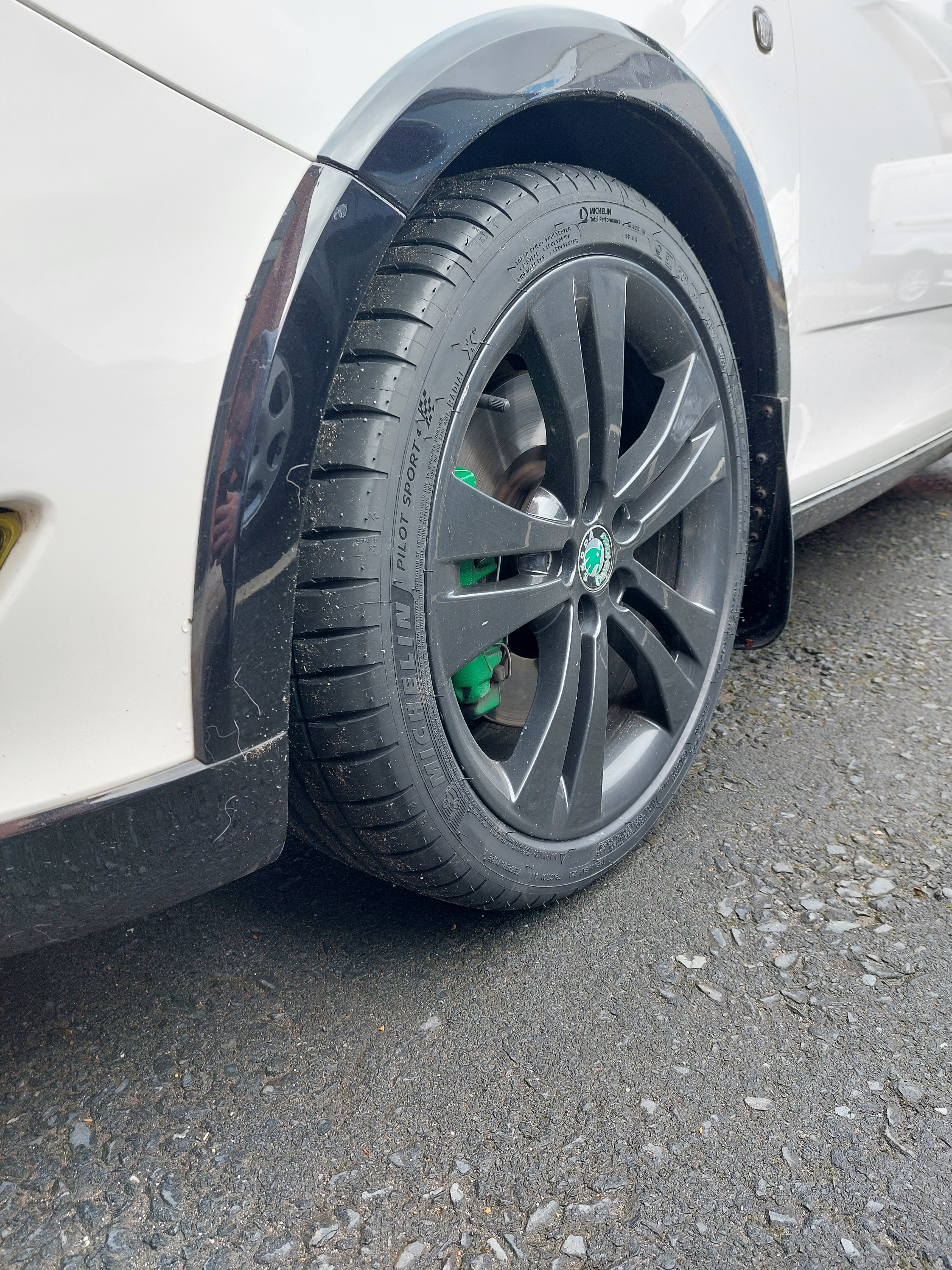

2 Michelin Pilot Sports fitted yesterday
A lot of money for me to throw down on tyres but they have so far proved to be worth every penny.
Done 250 miles on them so far, the bulk of that from a parts run for the other fabia this evening. These tyres seem to have helped fuel economy quite a bit.
And another pointless photo of it at the services.
Will definitely be getting 2 more pilot sports when funds allow, cannot praise them enough.

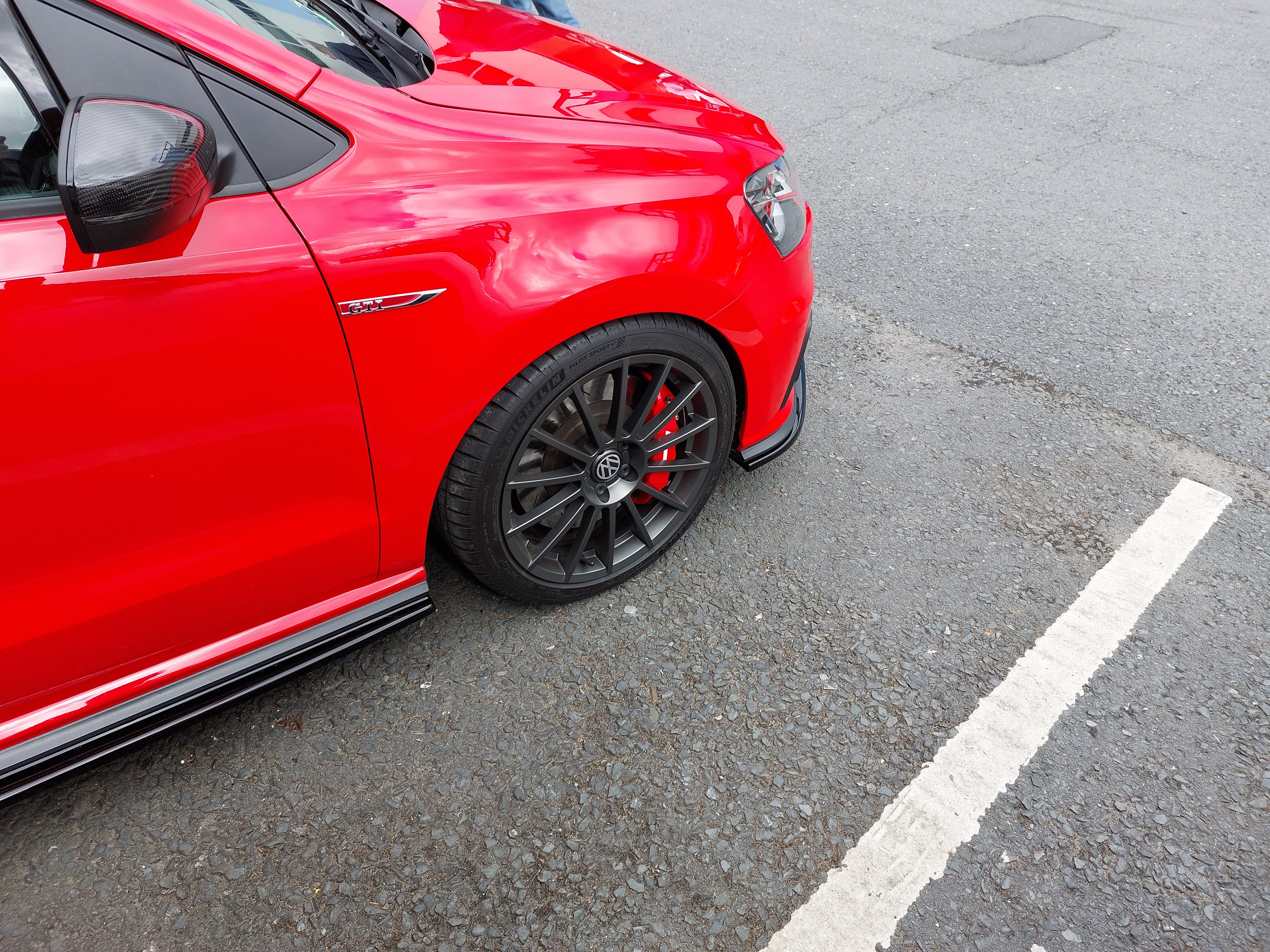

The polo beside me had absolutely HUGE brakes on the front, only had the solid 232s on the back though.

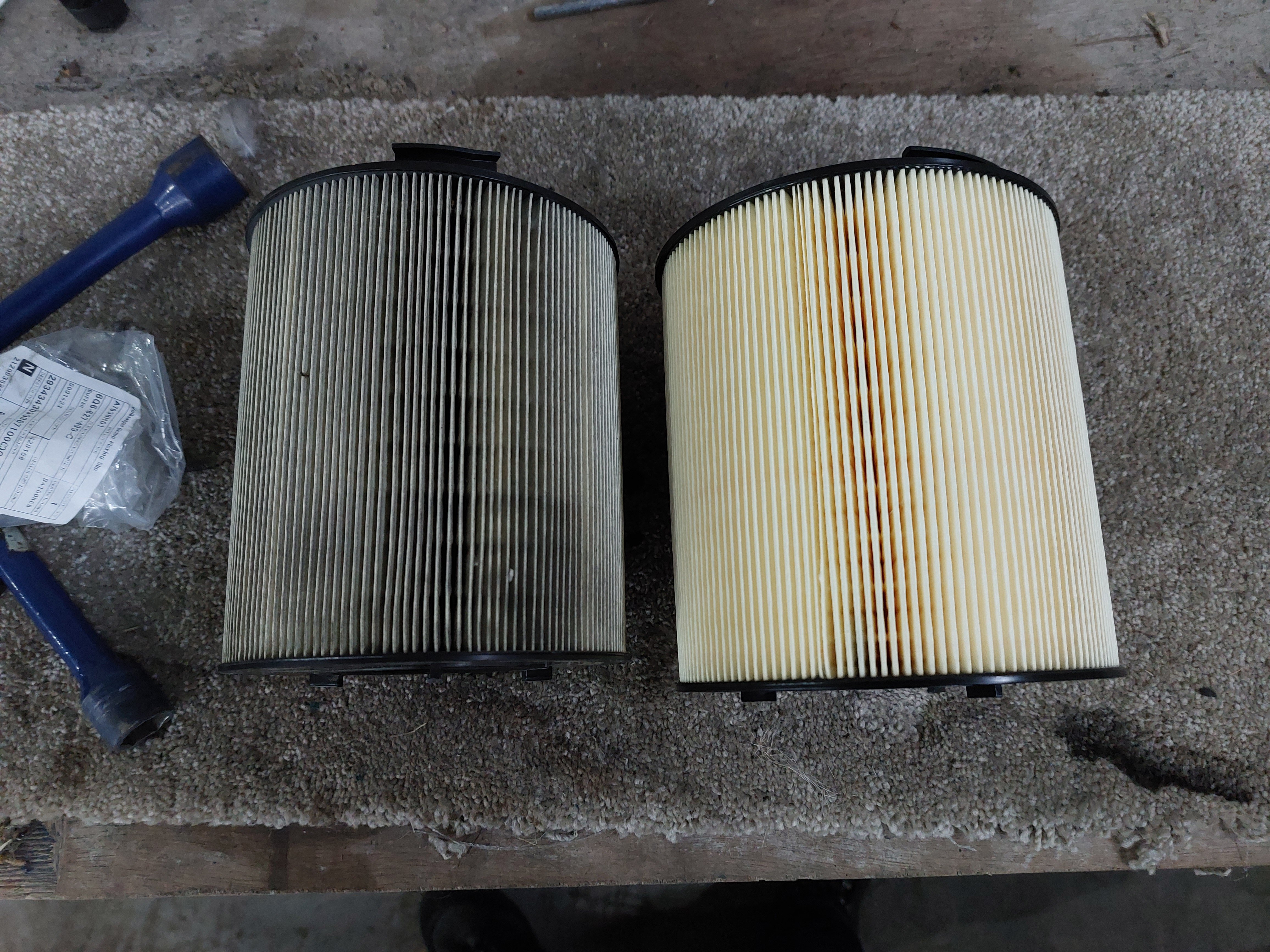

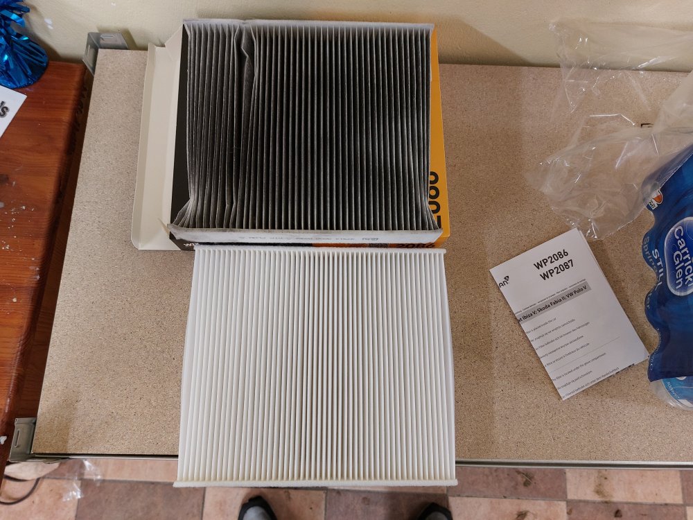

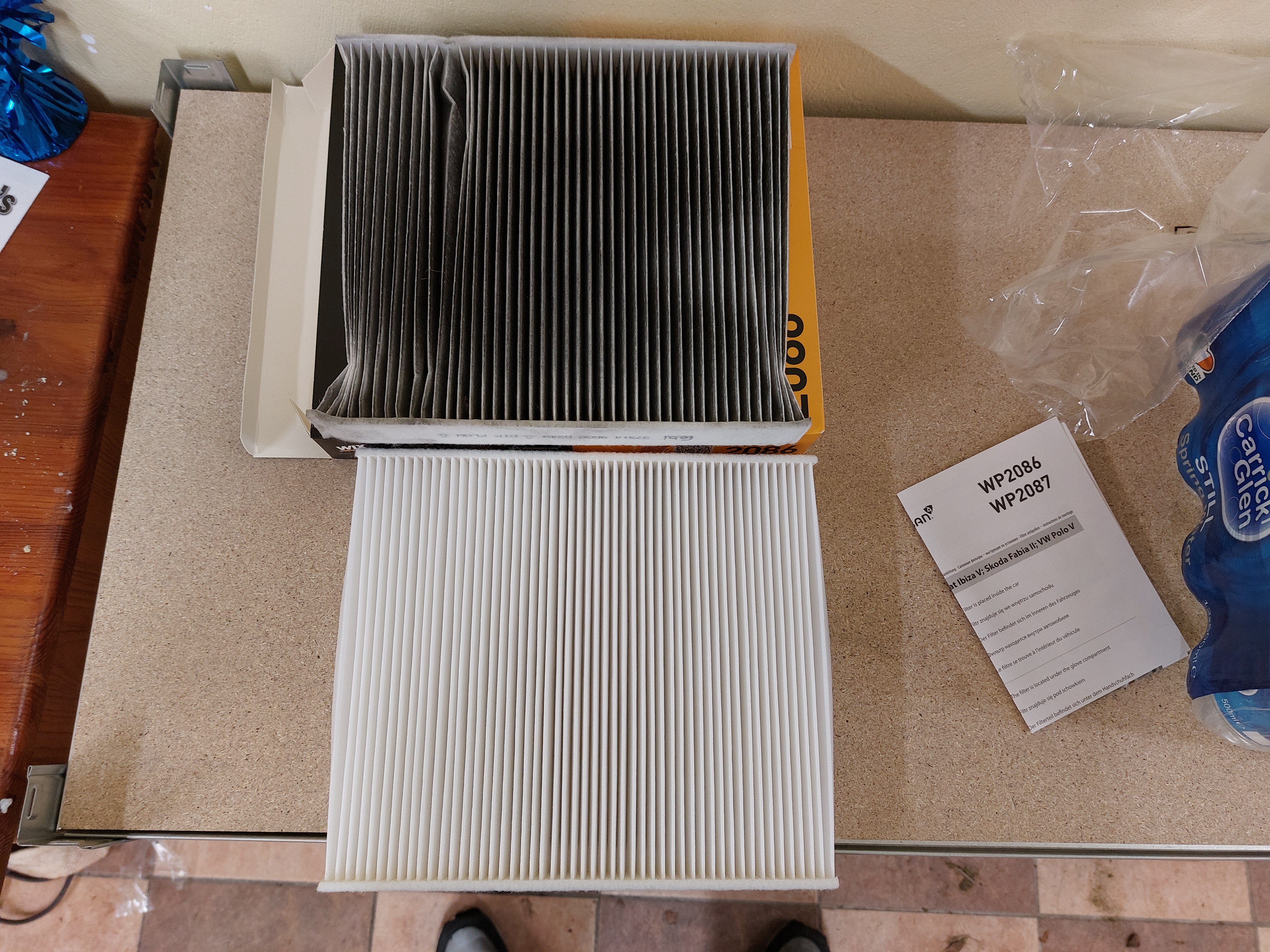

Just changed air filter again after checking it. Just under 6 months from when it was last done.20220531_201332.thumb.jpg.0ef15480f6d3ff18c9c7cc6d292ddbe7.jpg
Was bugs and **** in it, which came out after slapping it against a kerb.
Really only bothered posting to keep track of it myself.

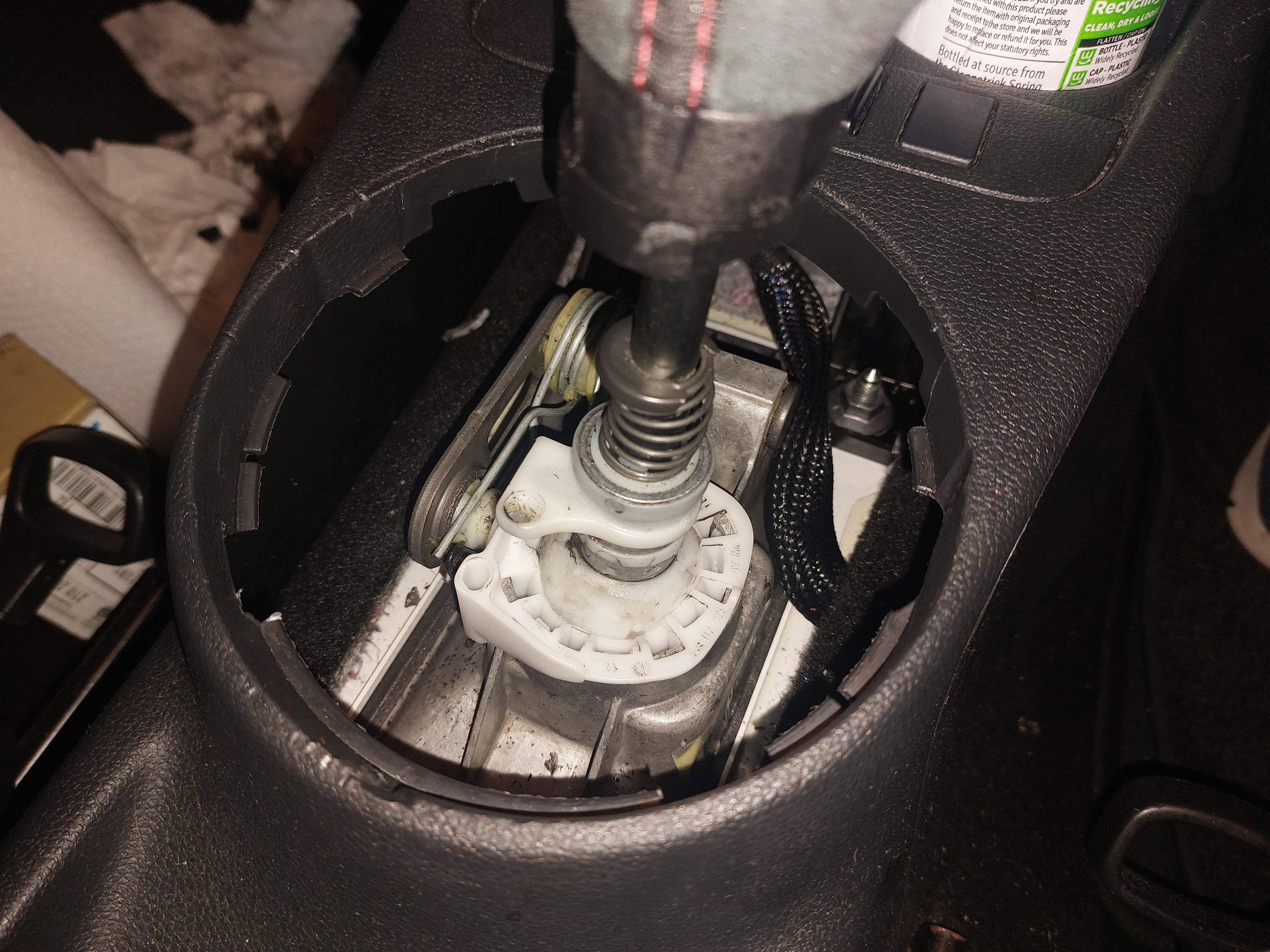

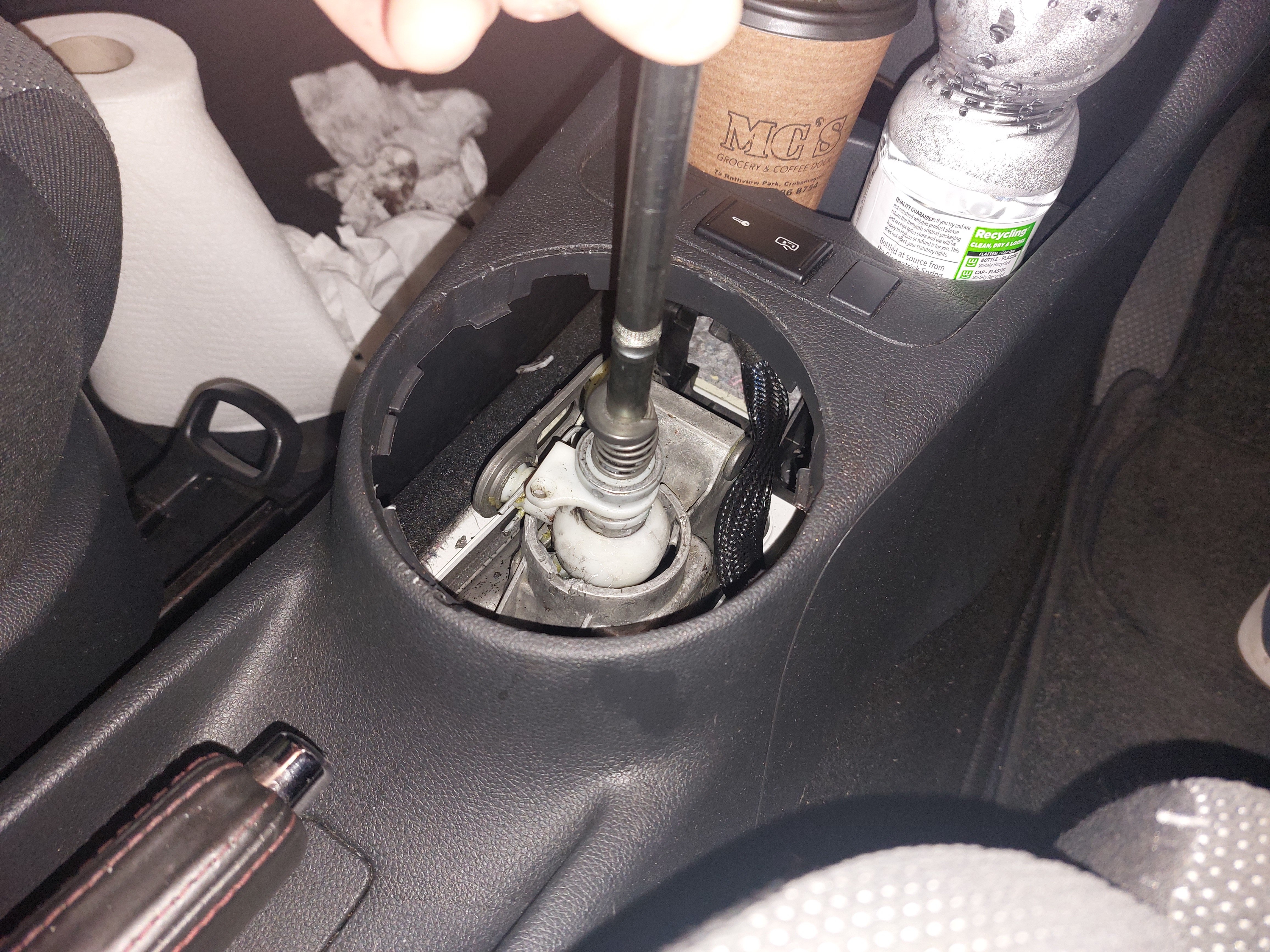

Not long after I got there the gearstick went very slack forwards and backwards. Checked it next morning and
What happened was, the bolt on the short shifter backed off, so it was moving around where you're meant to adjust the throw. It was hanging in barely, but one bad bump and it was gone. Lucky the nut had just landed on top of the gearbox.
Not a big job, tightened the nut and it's fine.

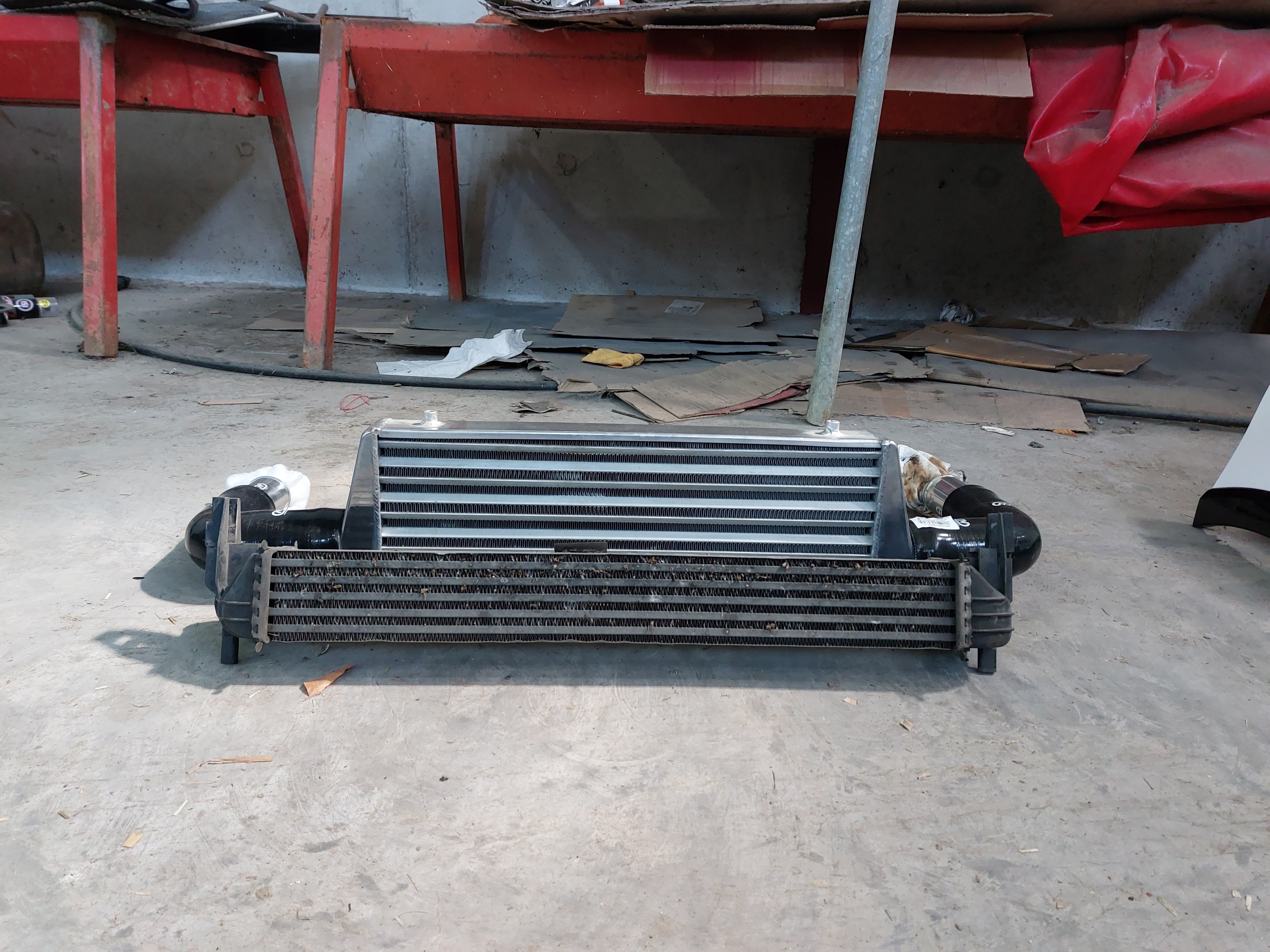

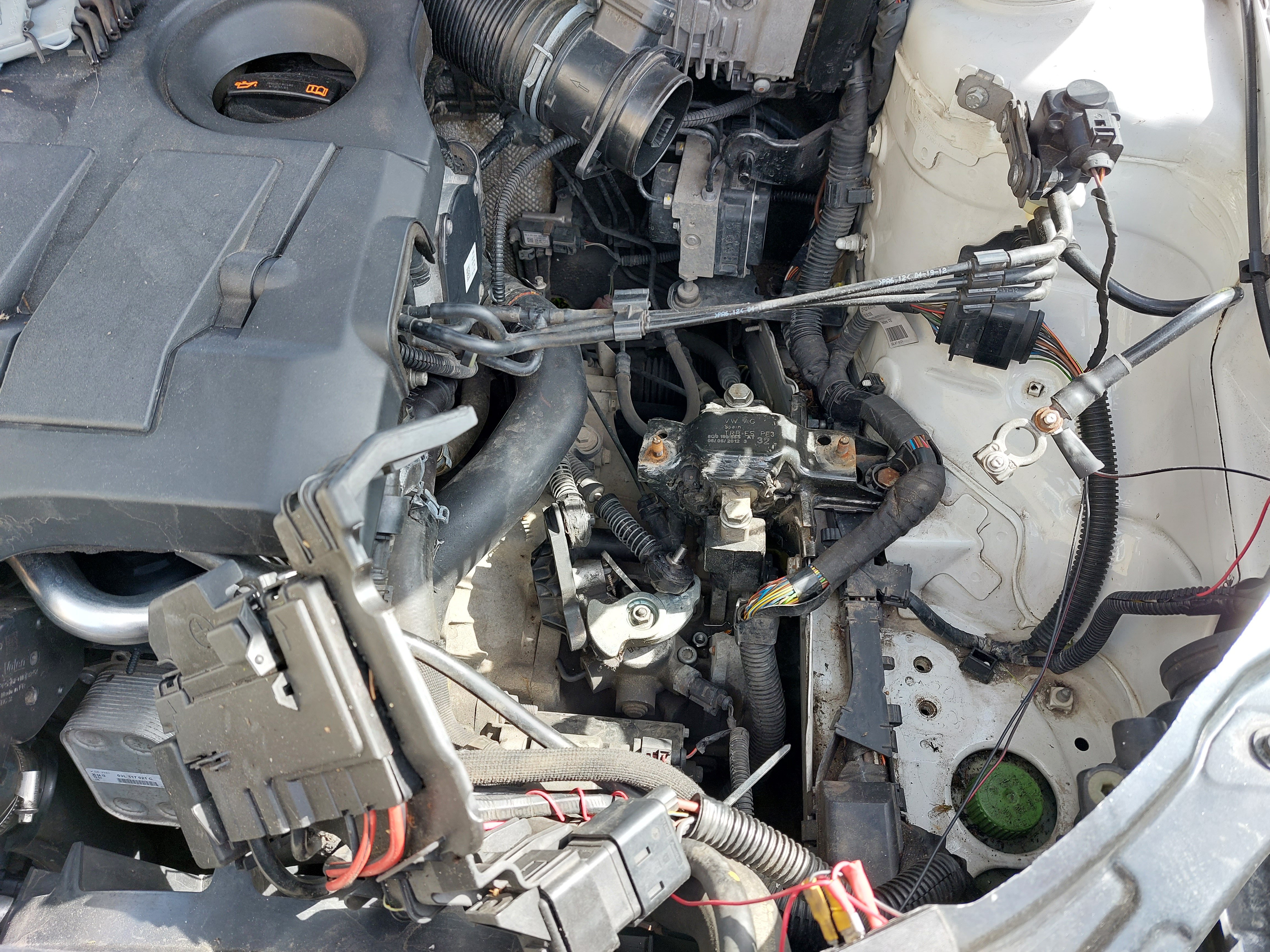

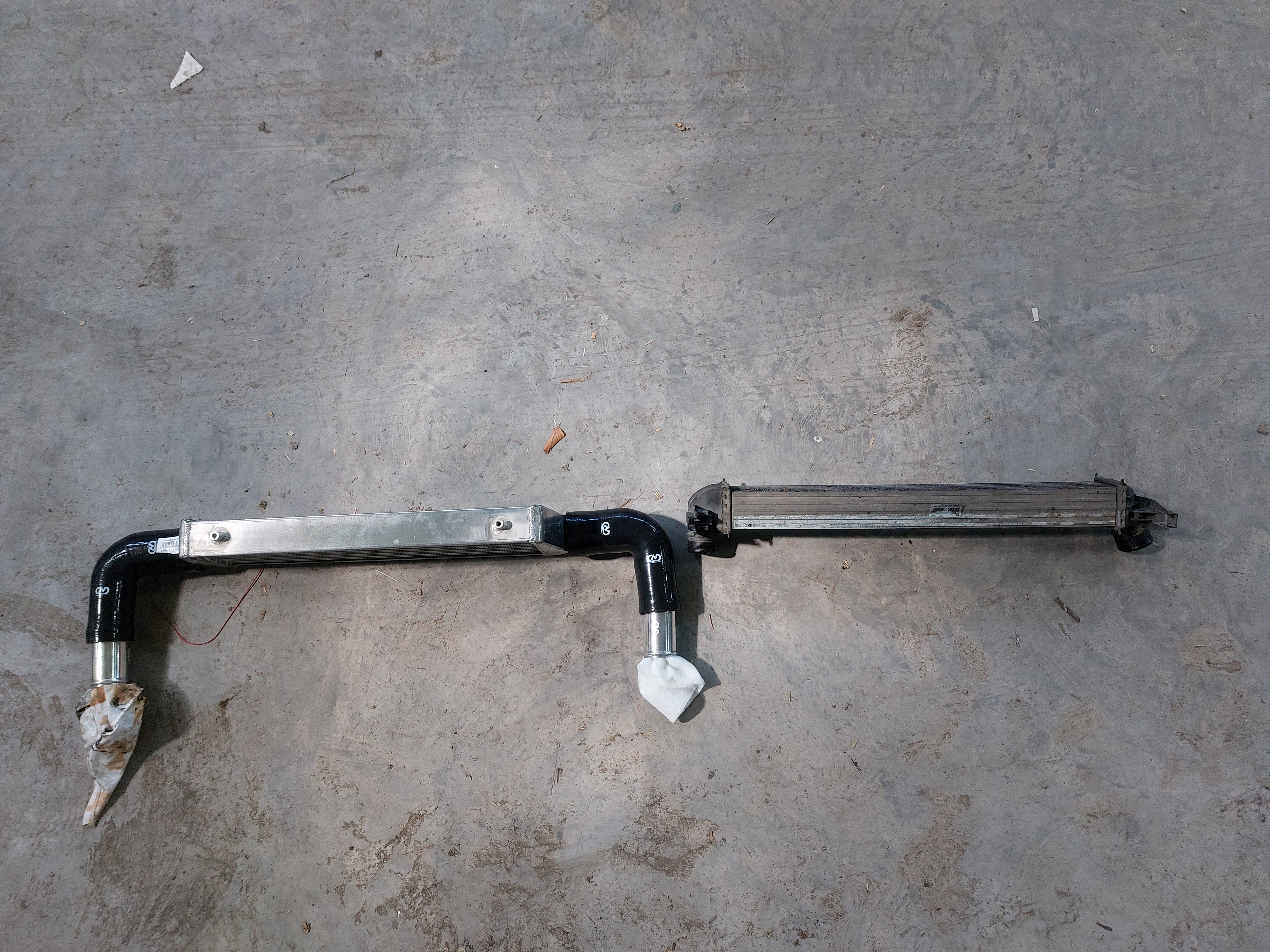

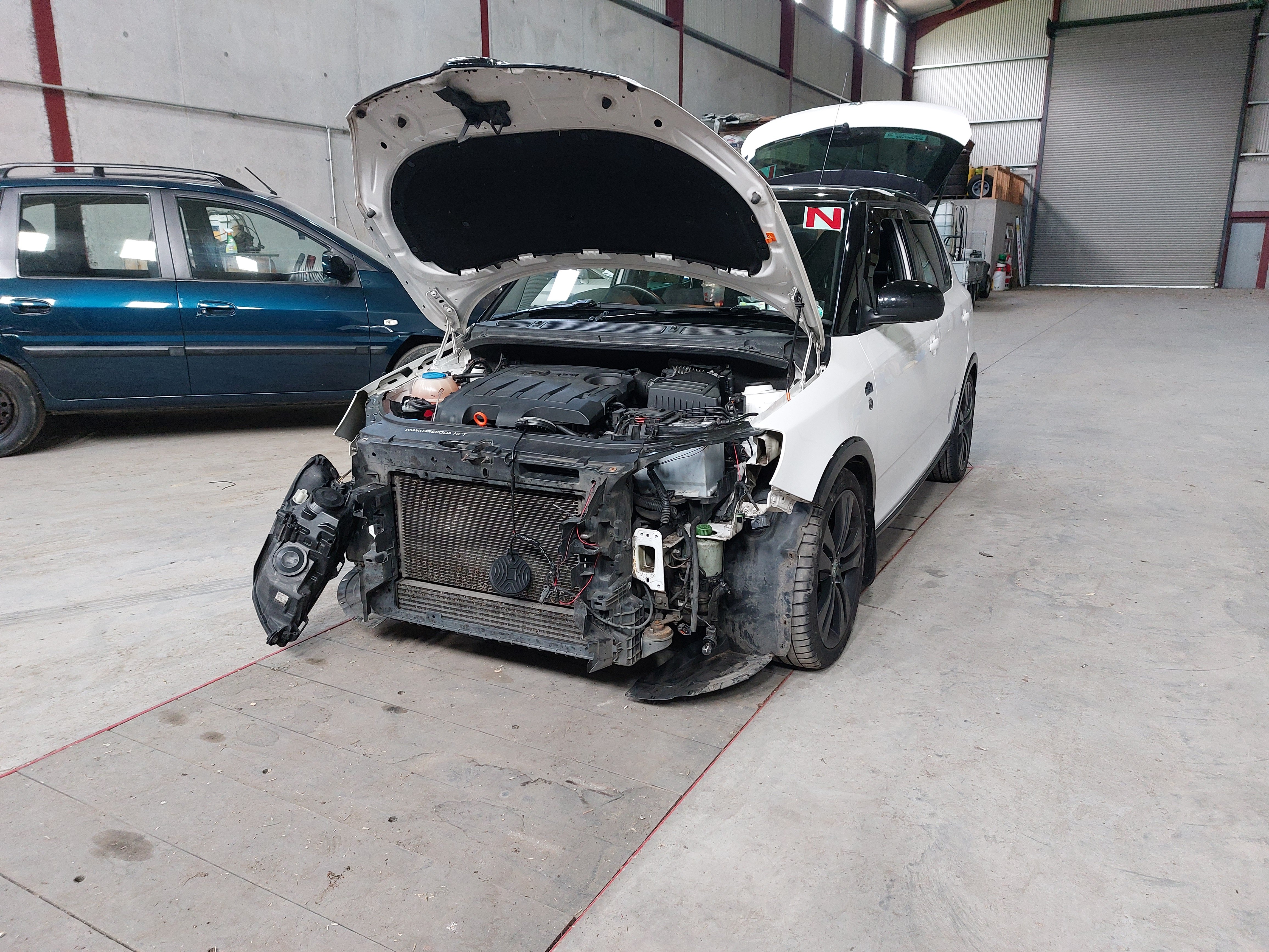

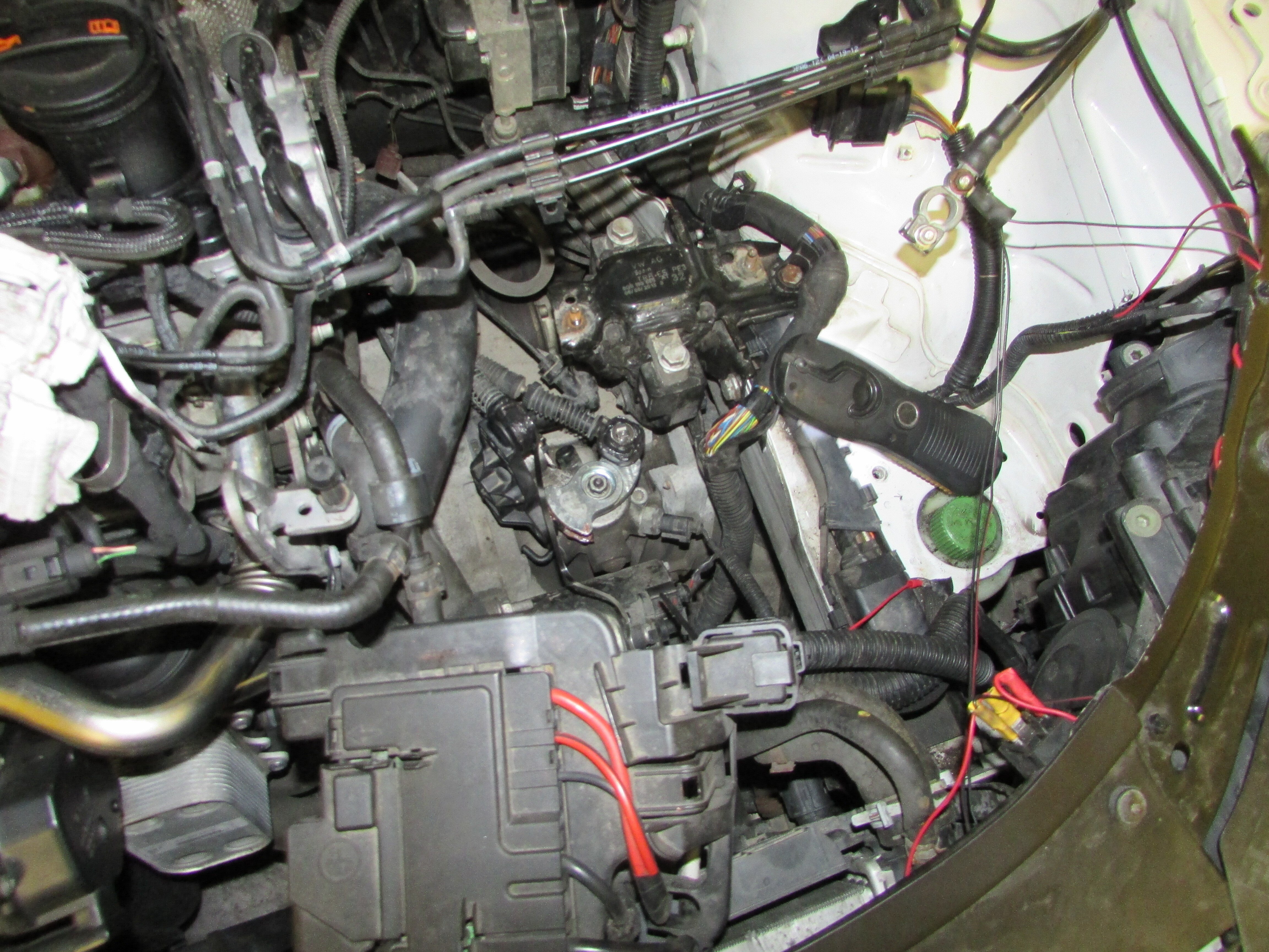

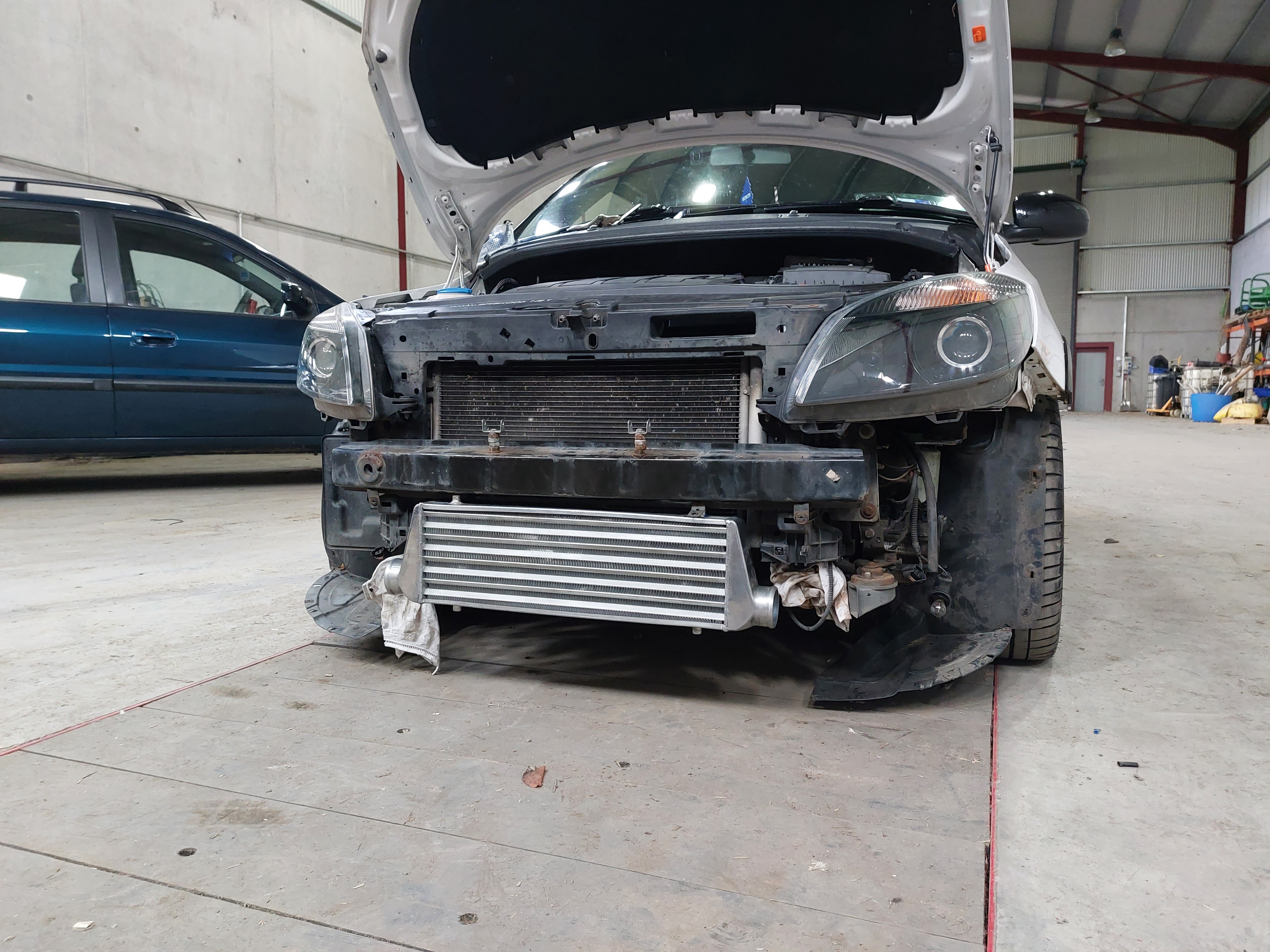

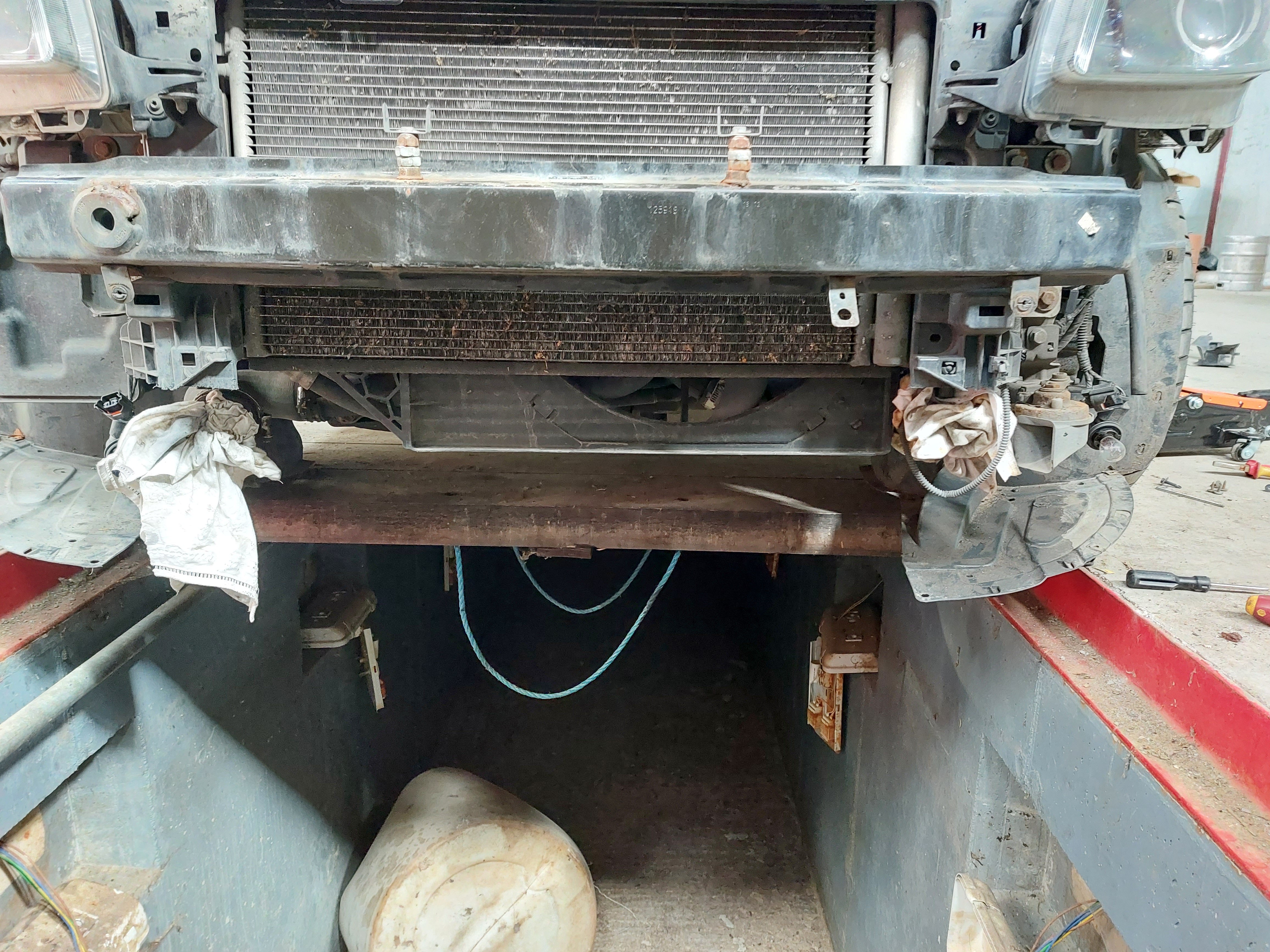

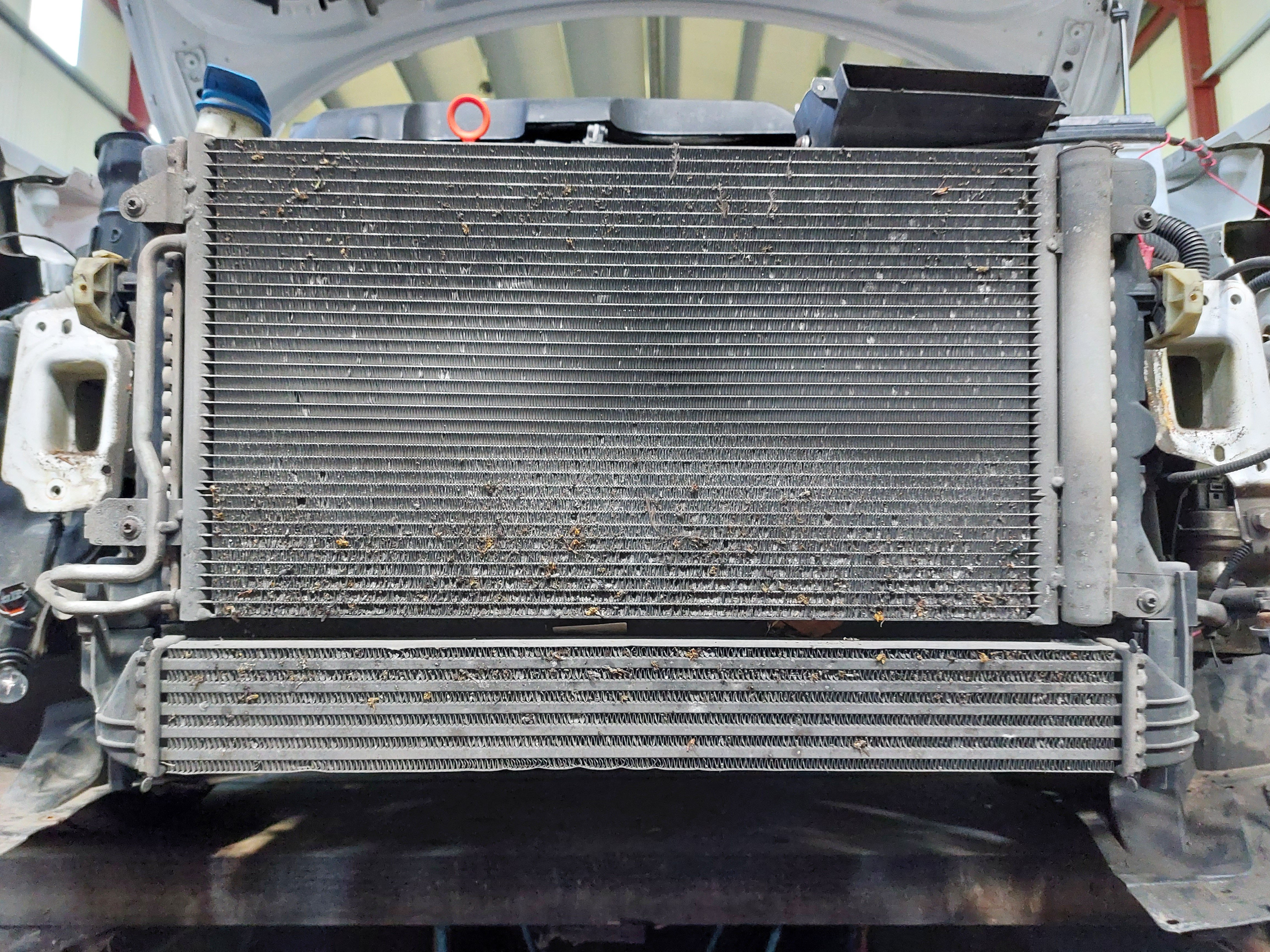

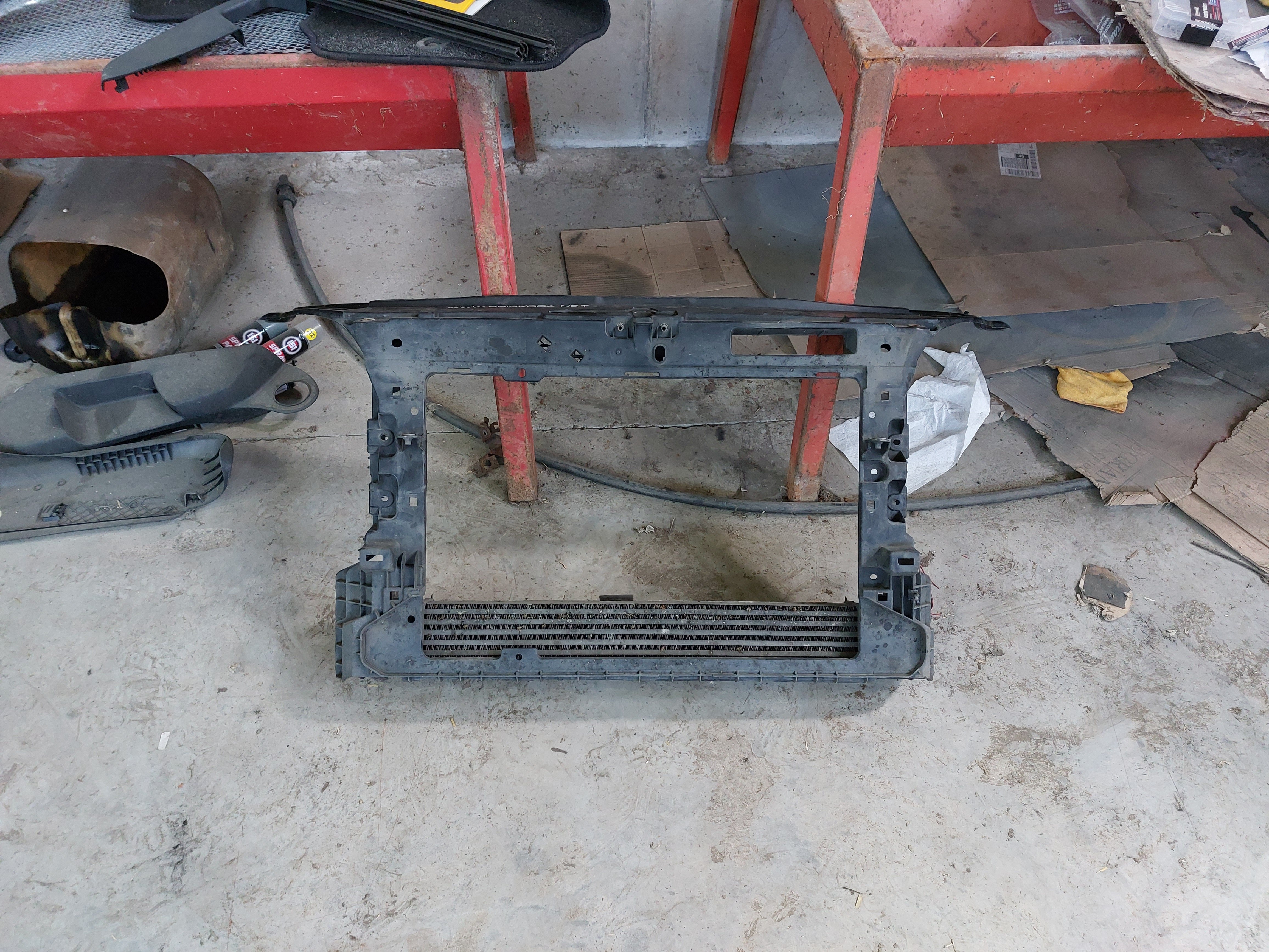

Did the intercooler today. Fairly big job all things considered but If I had known what I know now it would have been a little quicker.
First thing I should say is that I was using a guide for an ibiza of the same platform as my car.
https://www.seatcupra.net/forums/resources/universal-intercooler-guide.13/
This proved very helpful except for when it got to mounting the intercooler, here it seemed my car differed from the ibiza quite a lot.
Wasn't too hard to get the bumper off, the two bolts on the inner wings are a pain however.
The guide I was following said to remove the entire front of the car (more or less) so I did.
Really, I didn't need to with how I mounted the intercooler to mine. I ended up drilling the crash bar and mounting it to that. Knowing what I know now, I would have saved well over an hour doing this.

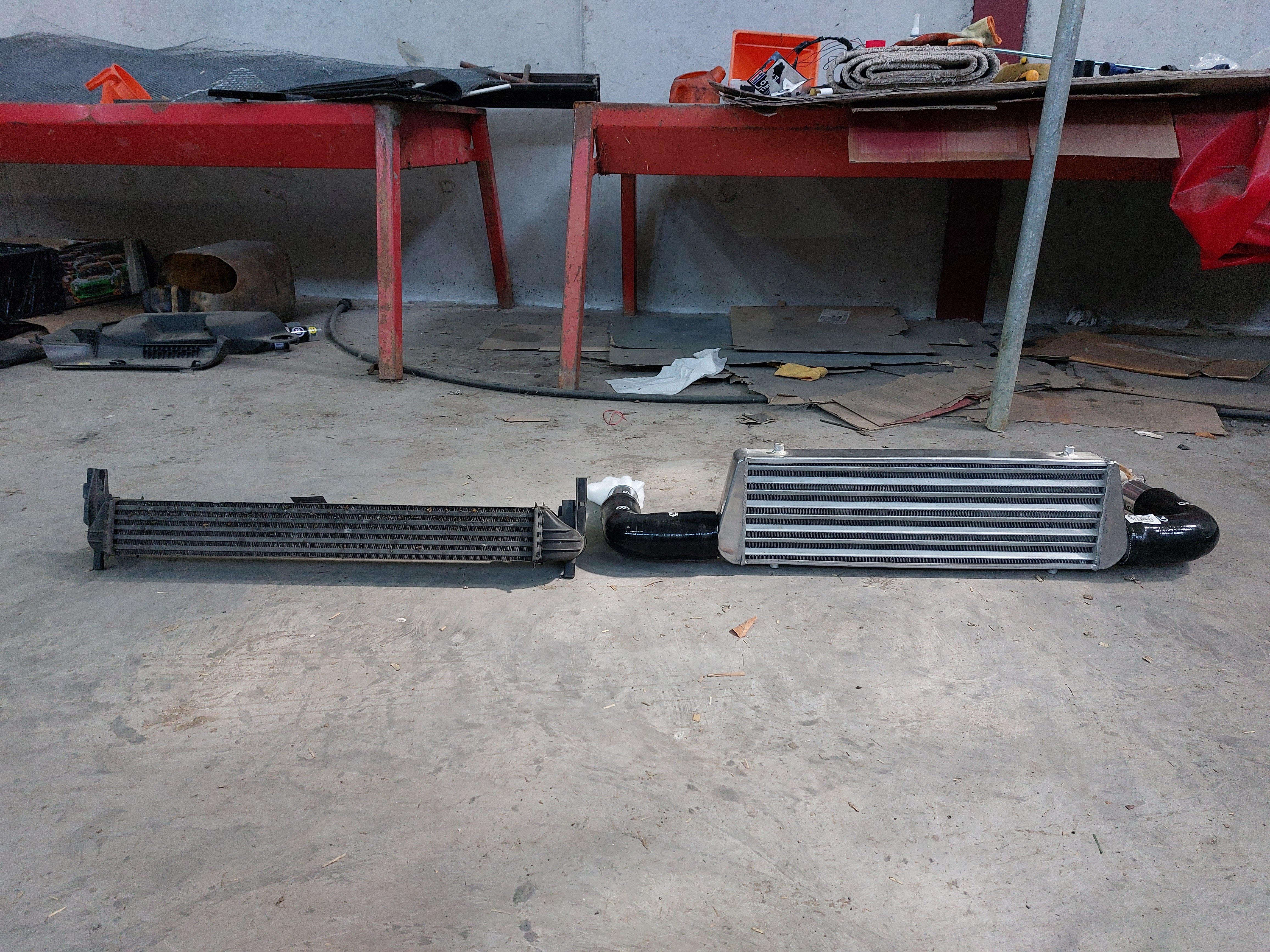

Anyway this pic shows how little intercooler there is that. would have any airflow going through it on the car.

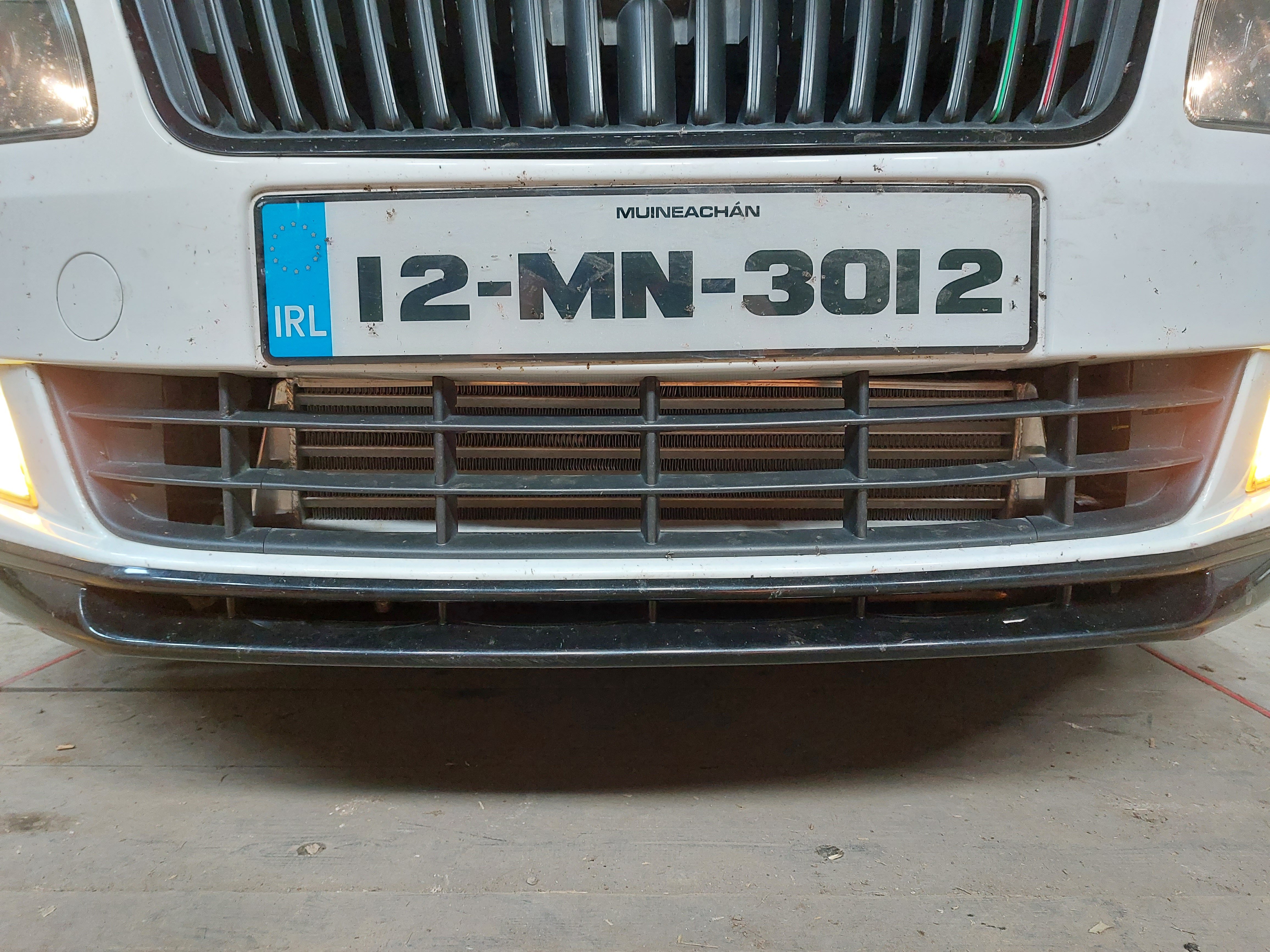

Now some side by side shots of the old and new intercoolers.
New intercooler mounted in place (more or less)
I ended up basically cutting the bottom of the flimsy plastic that holds the rad pack in place to make it easier to run the intercooler piping.
Finished product. A lot more forward than the standard one. It looks a bit small under there but that's fine. Practically all of it is exposed to air going through it, so should do a much better job of keeping the intake temps nice and cool.
Drive home showed intake temps drastically reduced, where they would be 30+°c before, now they are 20°c.
I still need to remount my spotlamps as I removed them before taking off the crash bar.
Overall this job took me about 6 hours to do, not including breaks.
Well worth it seems, but definitely not a job for the faint hearted.

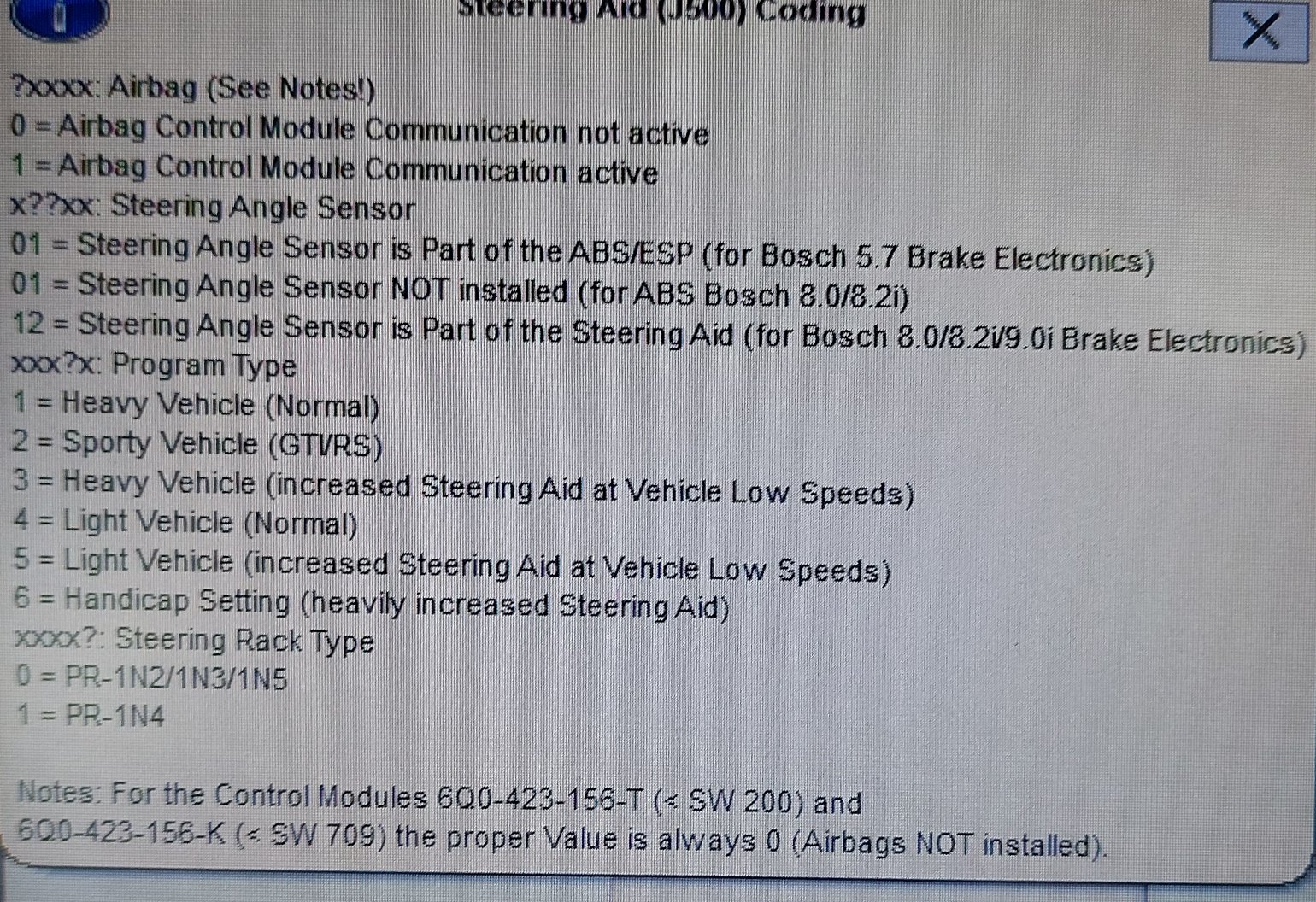

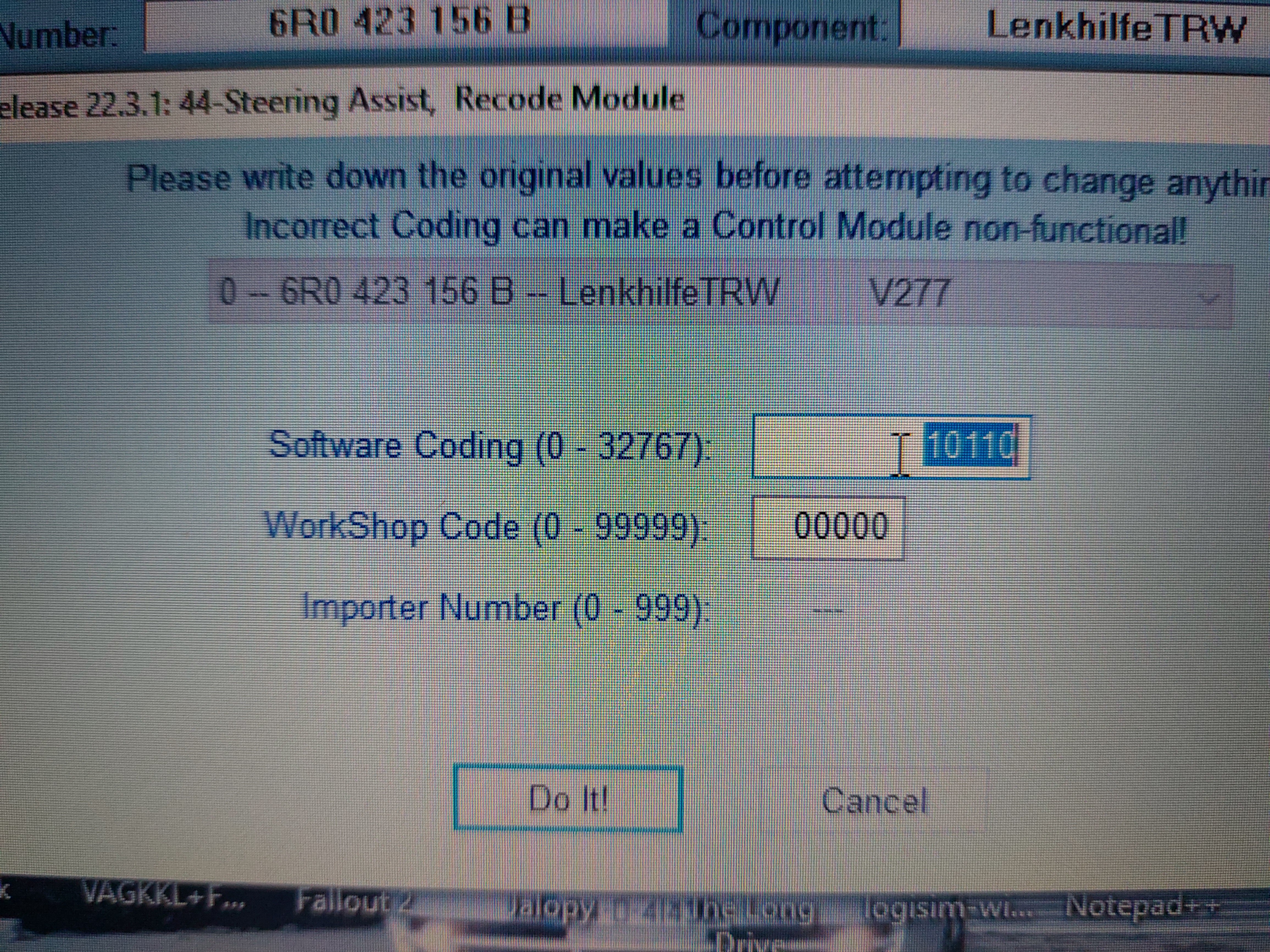

The power steering on this has always been a little odd, I thought it was down to it being a monte carlo and thus probably on a different power steering coding than a normal fabia, and I was right, sort of.

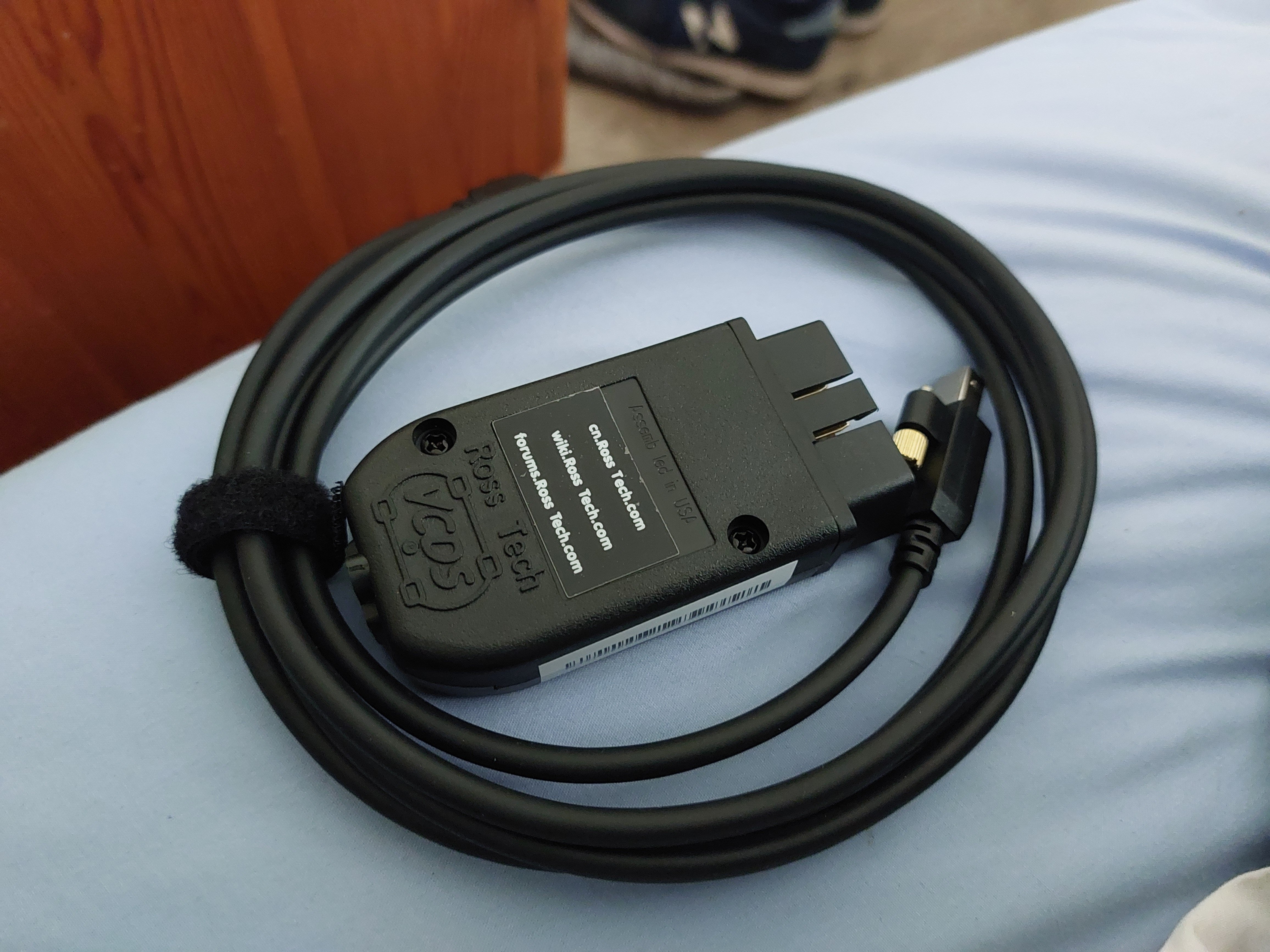

I bought a (fake) vcds cable online and tried it out. It worked, flawlessly.
Anyways, this is what my monte was set to:
I tried most of the settings and settled on 10120, the setting for "sporty vehicles", 10110 is meant to be for "Heavy vehicles" so how it was set to that, I'll never know.
I believe a normal fabia will be set to 10140 or 10150.
The "Sporty" setting I landed on feels a lot better than the setting it was on originally. Hard to describe, bit weightier than before, now steers like you'd expect a car like this to. I'm dead happy anyway and it means I now have VCDS at my disposal for whatever I might need it for.

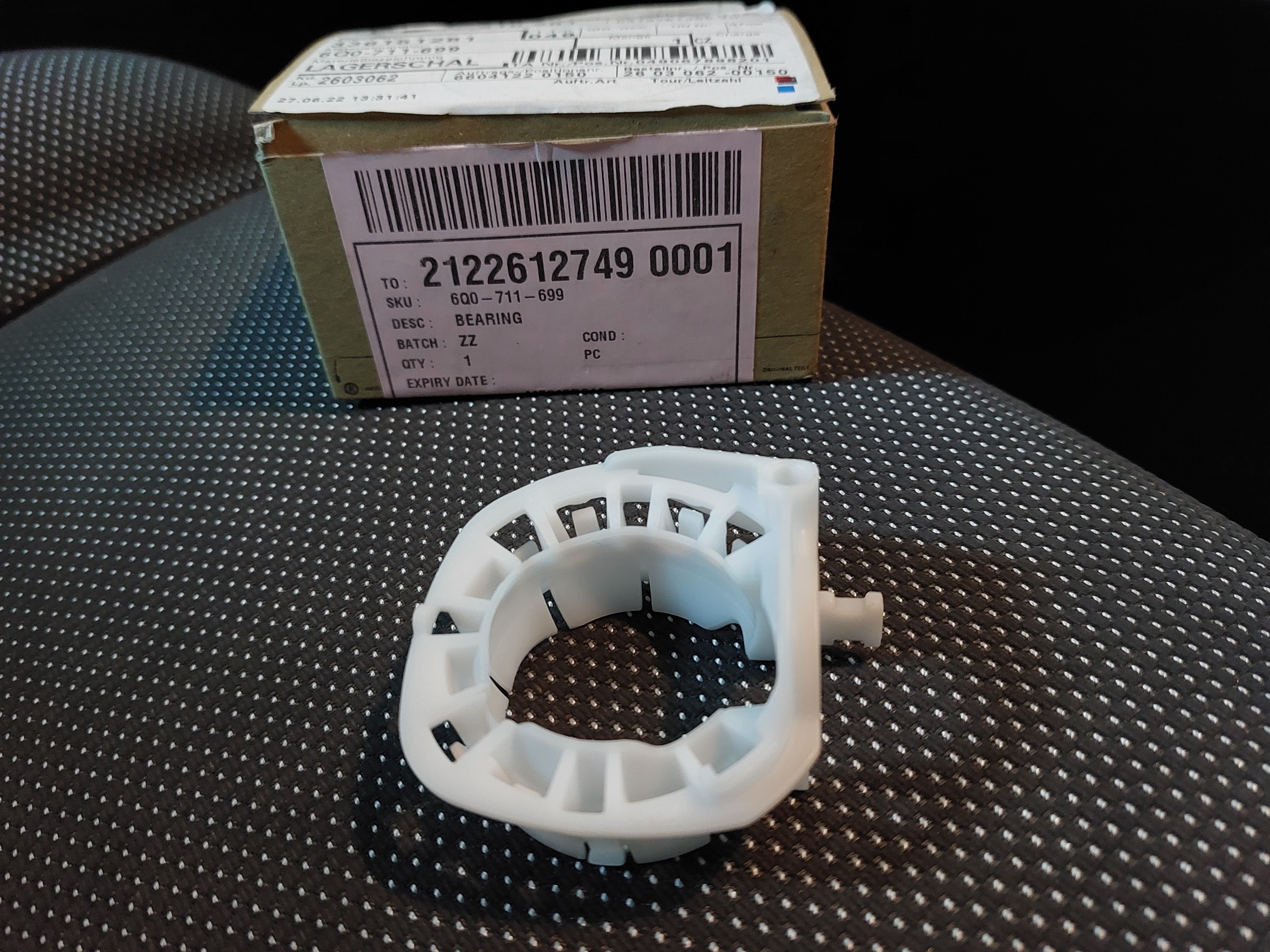

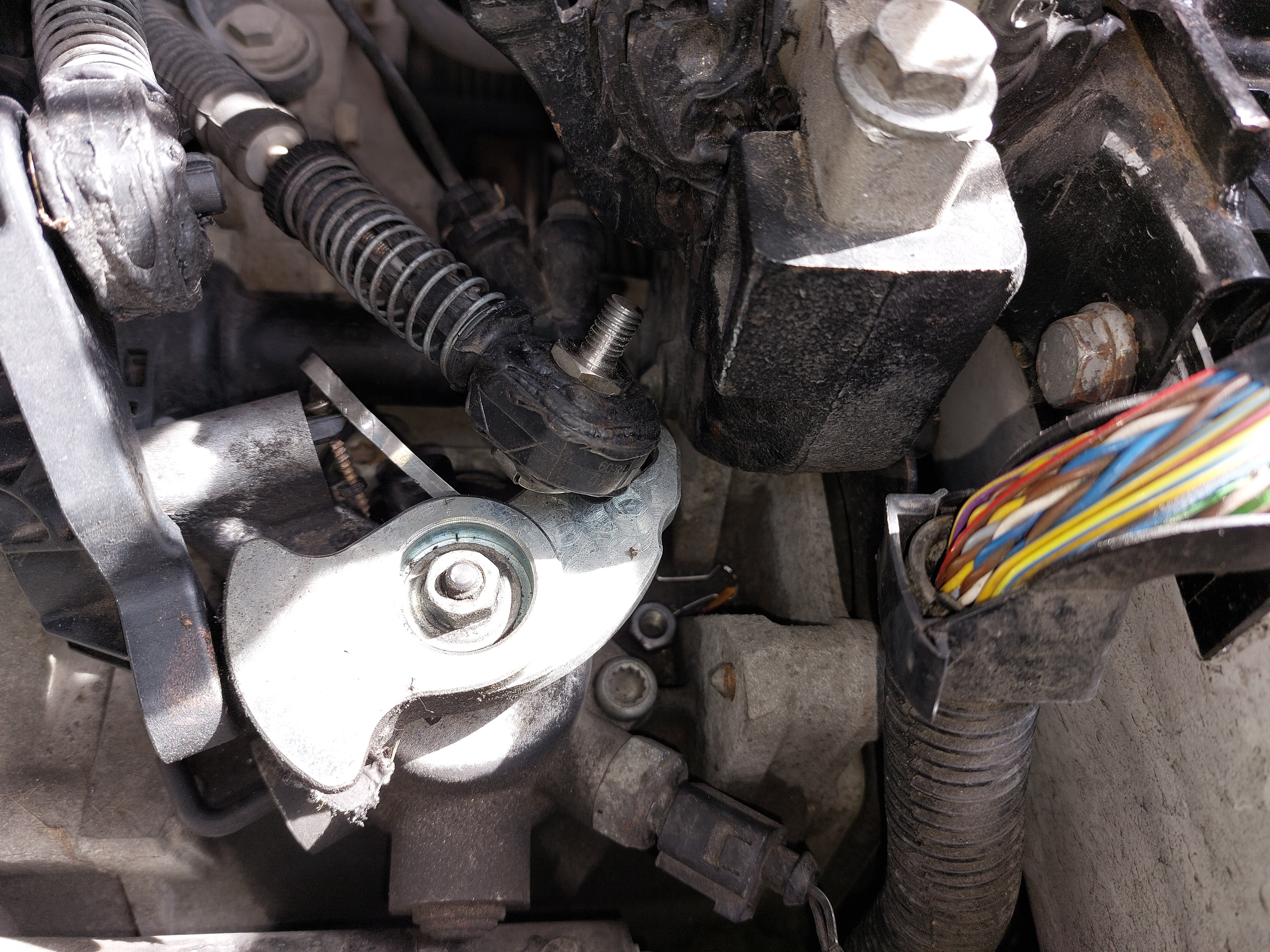

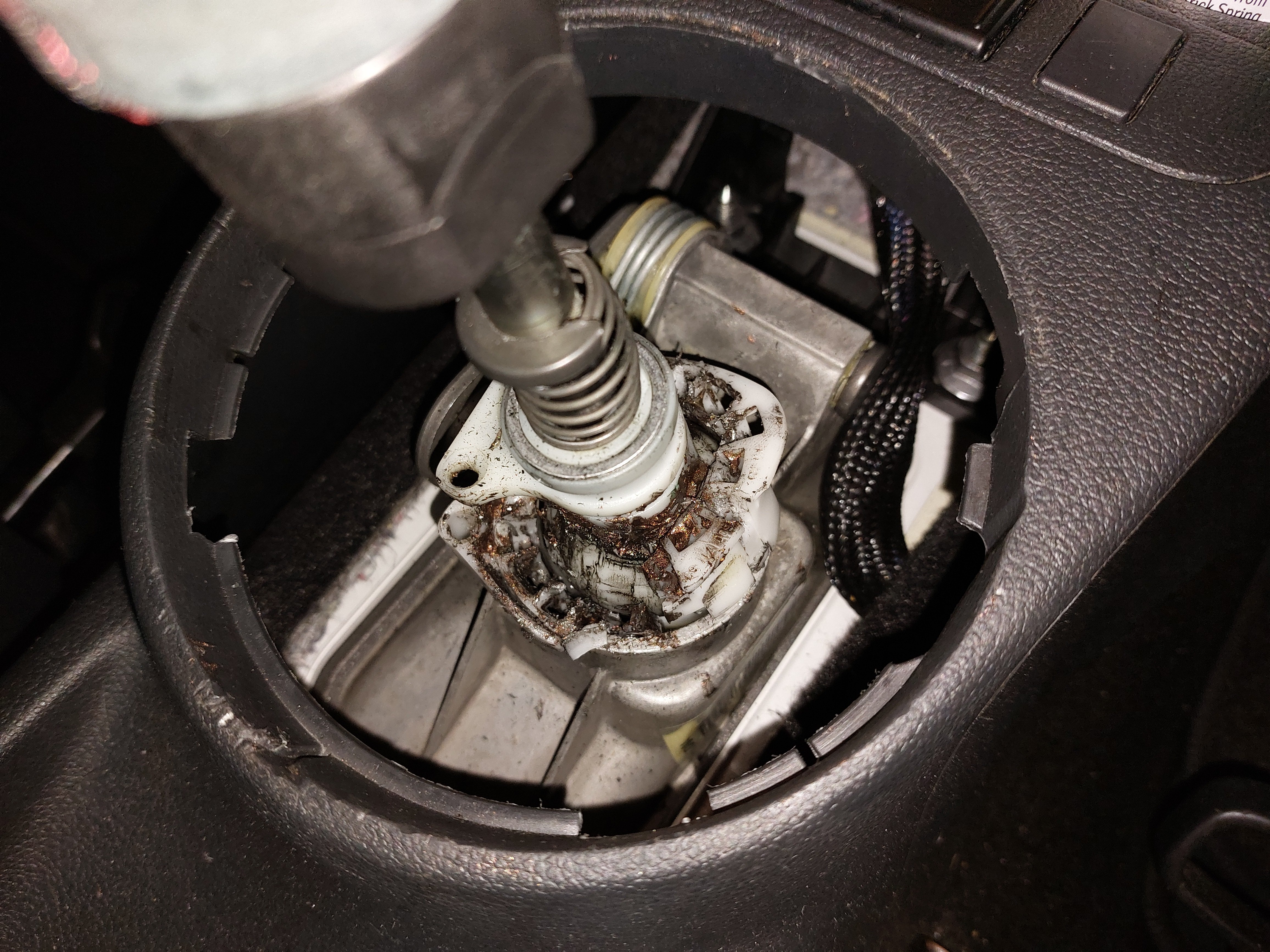

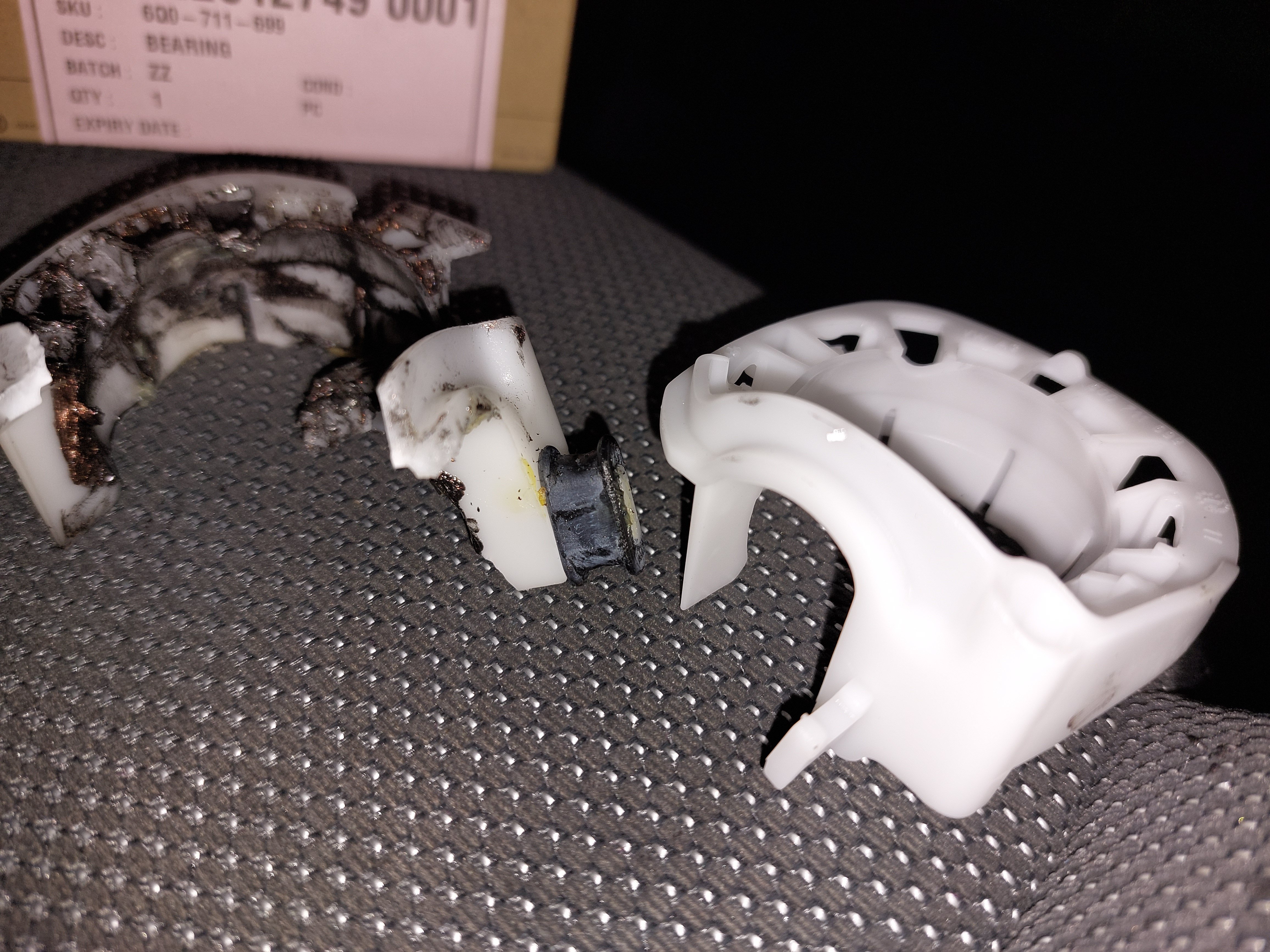

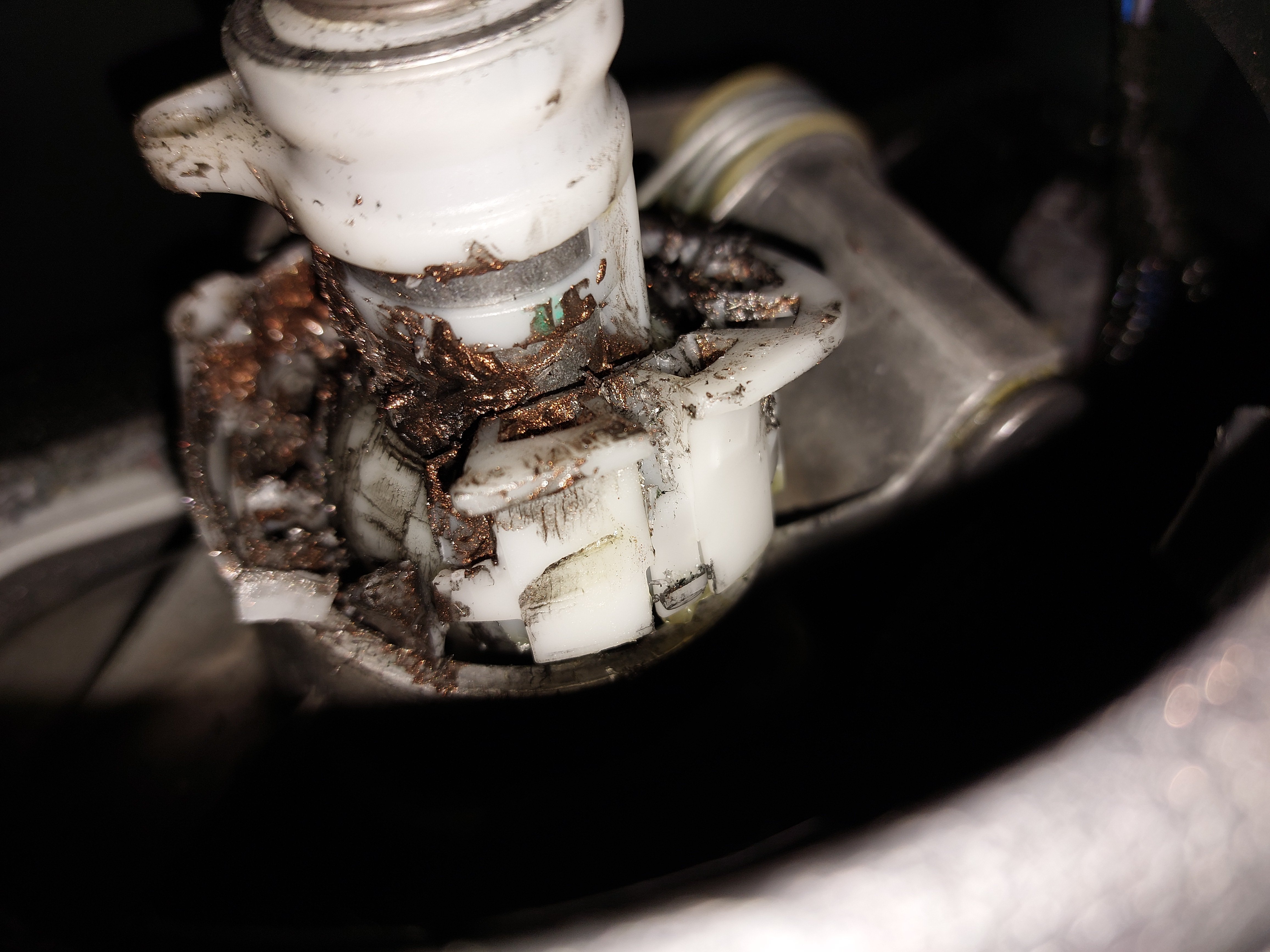

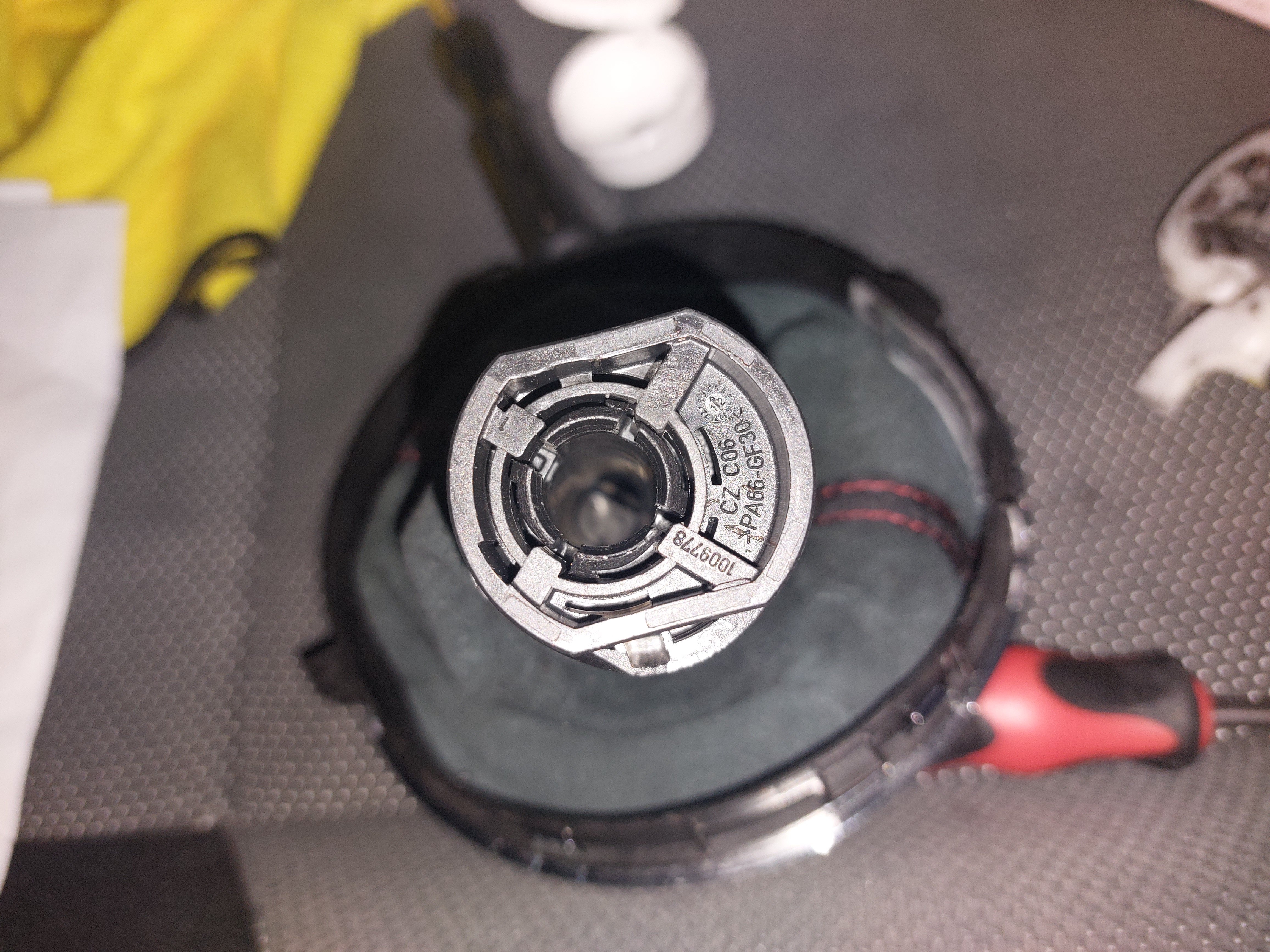

When I did the short shifter I noticed a lot of slop in the shifter assembly
So after posting a thread on the main forum I got the part number for the bearing shell, and ordered it. It cost €11 and took about a week and a half to arrive. Part Number is 6Q0 711 699.
The old bearing needs to be broken to remove it, no other way I can see to do it. I used some screwdrivers to Jam into it and twist until it broke apart.
Be sure to swap over the black elastic band onto the new one, it doesn't come with one.
You need to get the knob off to replace the bearing, easy on my car as it uses a weird clip to secure the knob on.
Cleaned the copperslip off and regreased with silicon grease.
Slip it down and push it over the ball first, then clip it into the shifter assembly.
The finished result
It's fixed 99% of the slop on the shifter and I'm very happy with that. A new shifter is over 200 euro and you need to drop all underneath the car to change it.
This cost about €11 euro and took me about an hour.

I ended up going on a Weekend trip to wicklow this weekend got by, but I had to make a few changes before that.

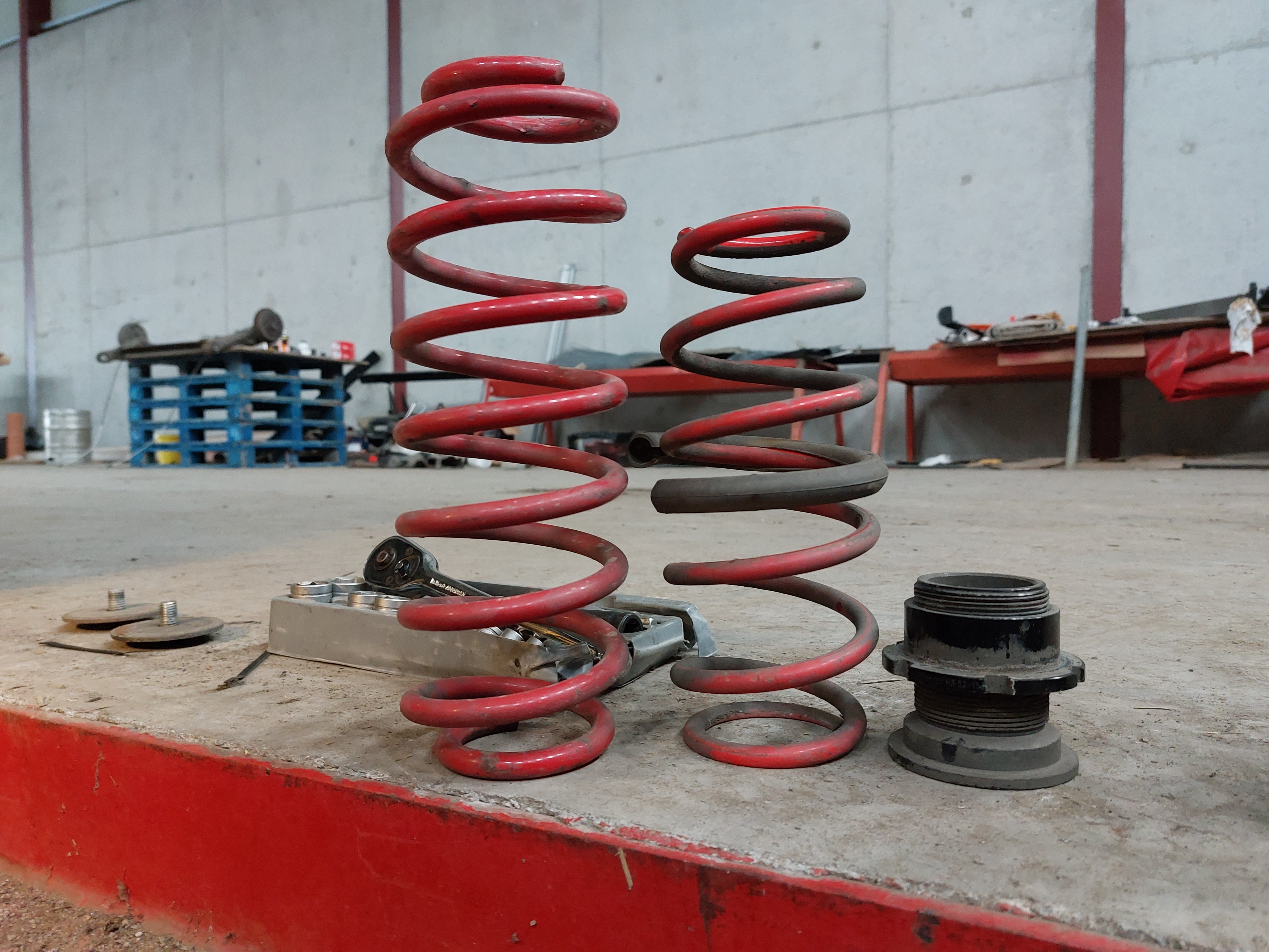

First, I swapped out the springs to the "heavy duty" ones I had from the mk1

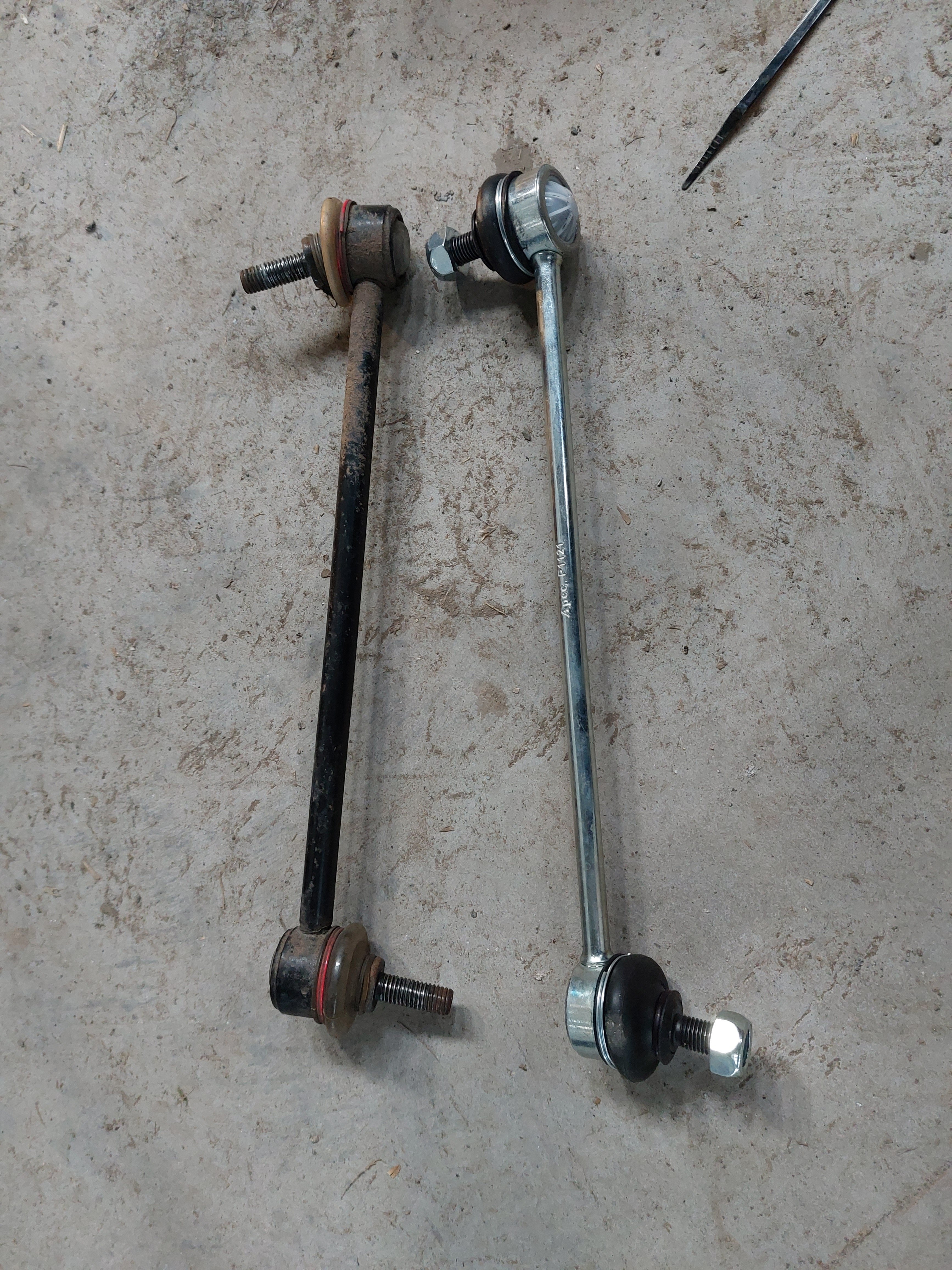

Then I had to replace a drop link which had gone bad (already).
And a cabin filter (Wasn't too long ago that it was changed either)

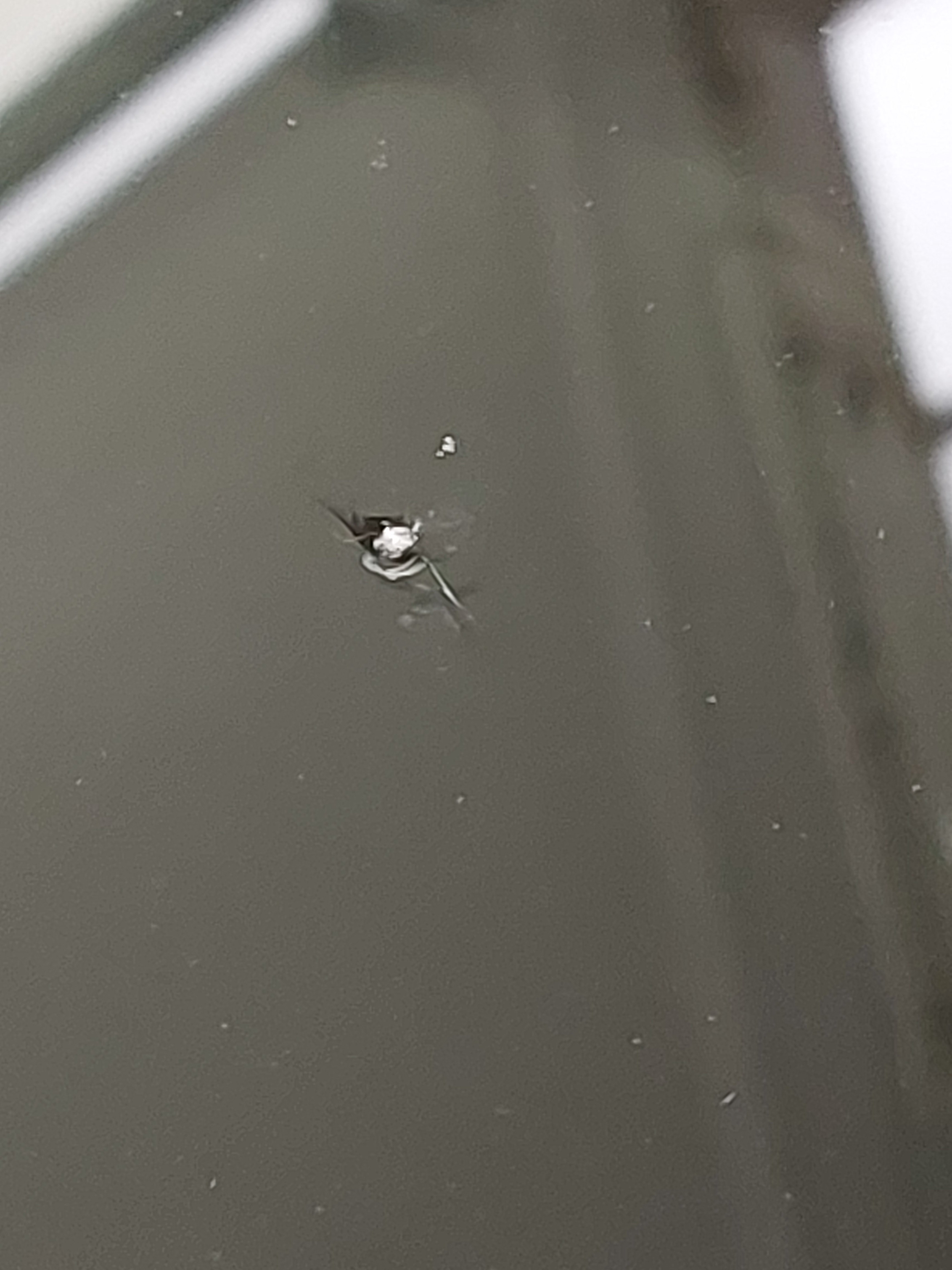

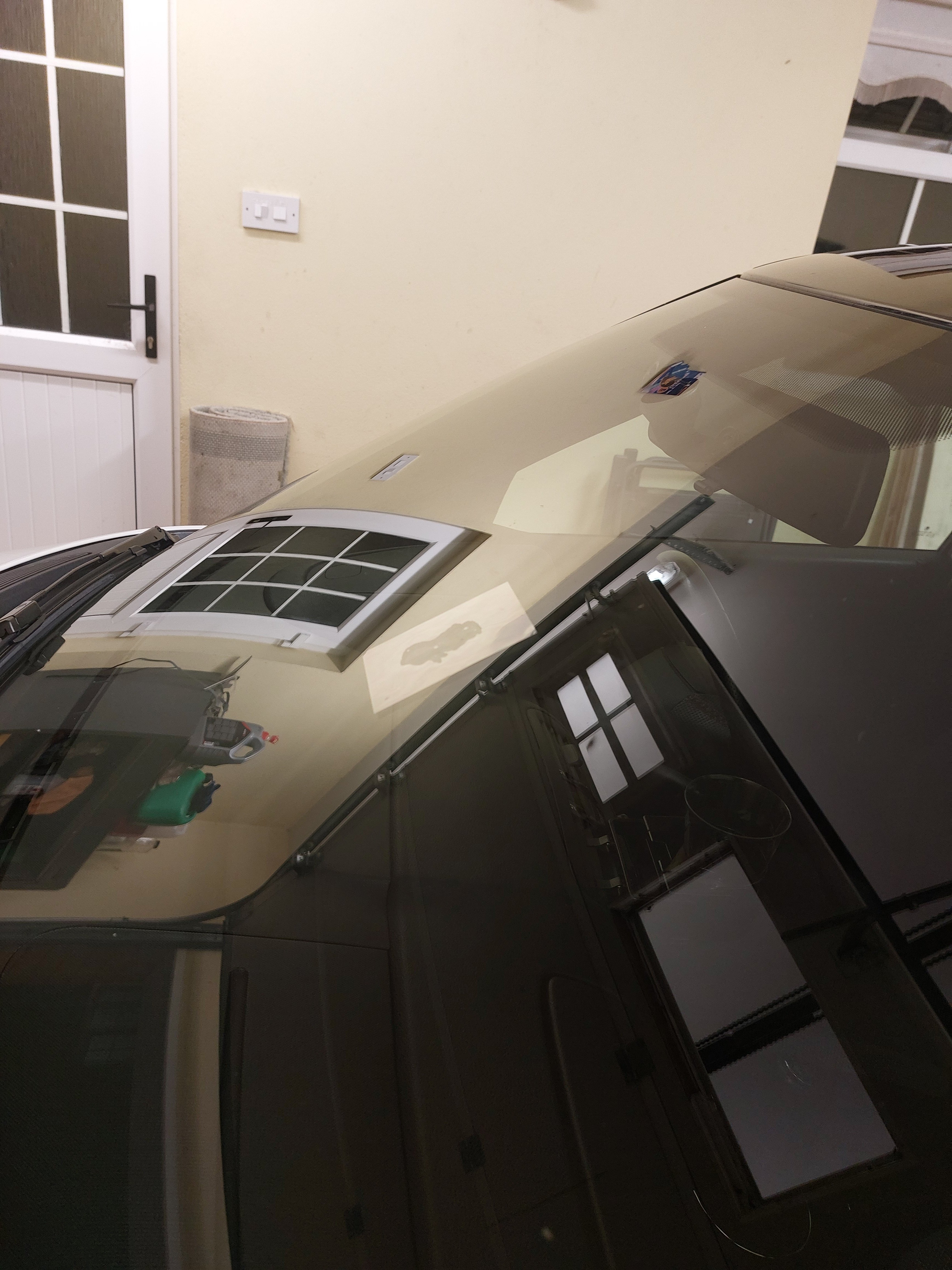

And a last minute fix, just before I left I got a crack in the windscreen that I wanted to fix before I left.
Fixed well enough to not stand out on the rest of the glass.
