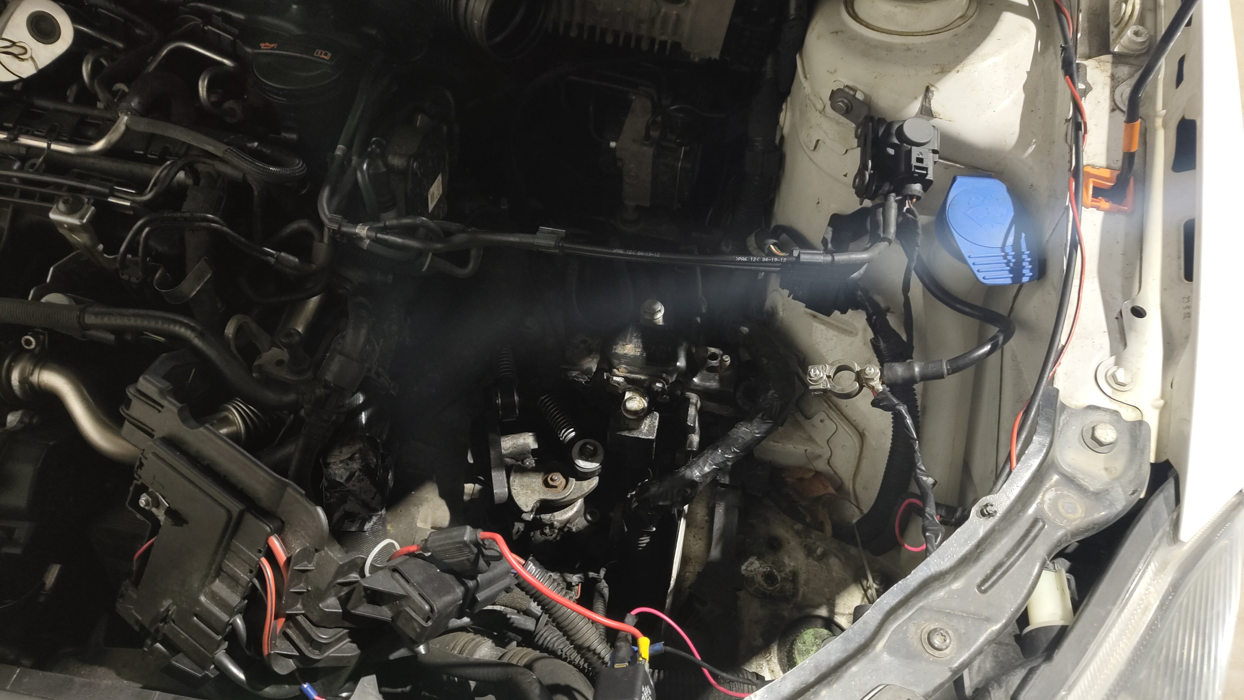

Been tracking down a few leaks, boost mostly.
Seen weeping here.

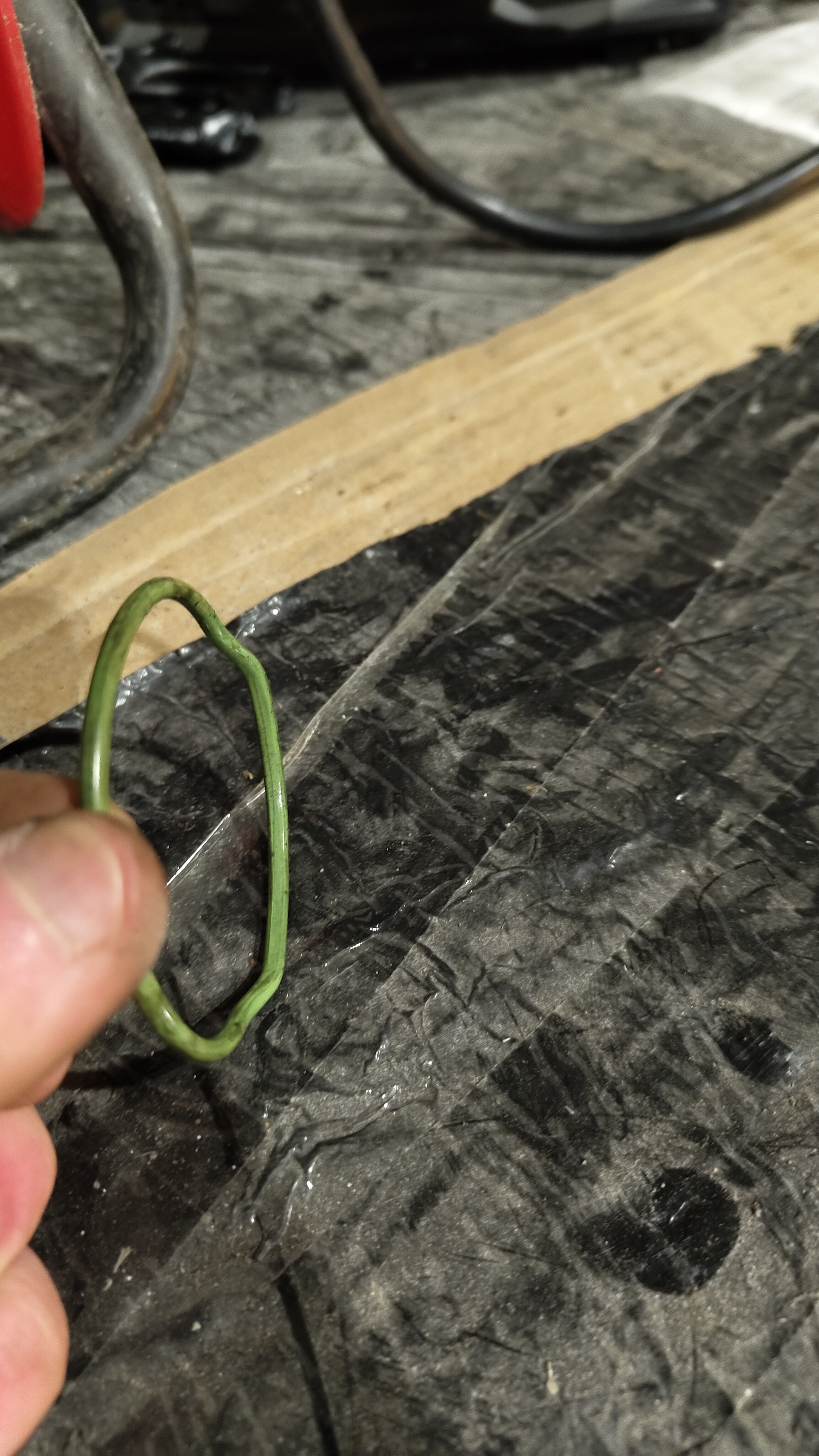

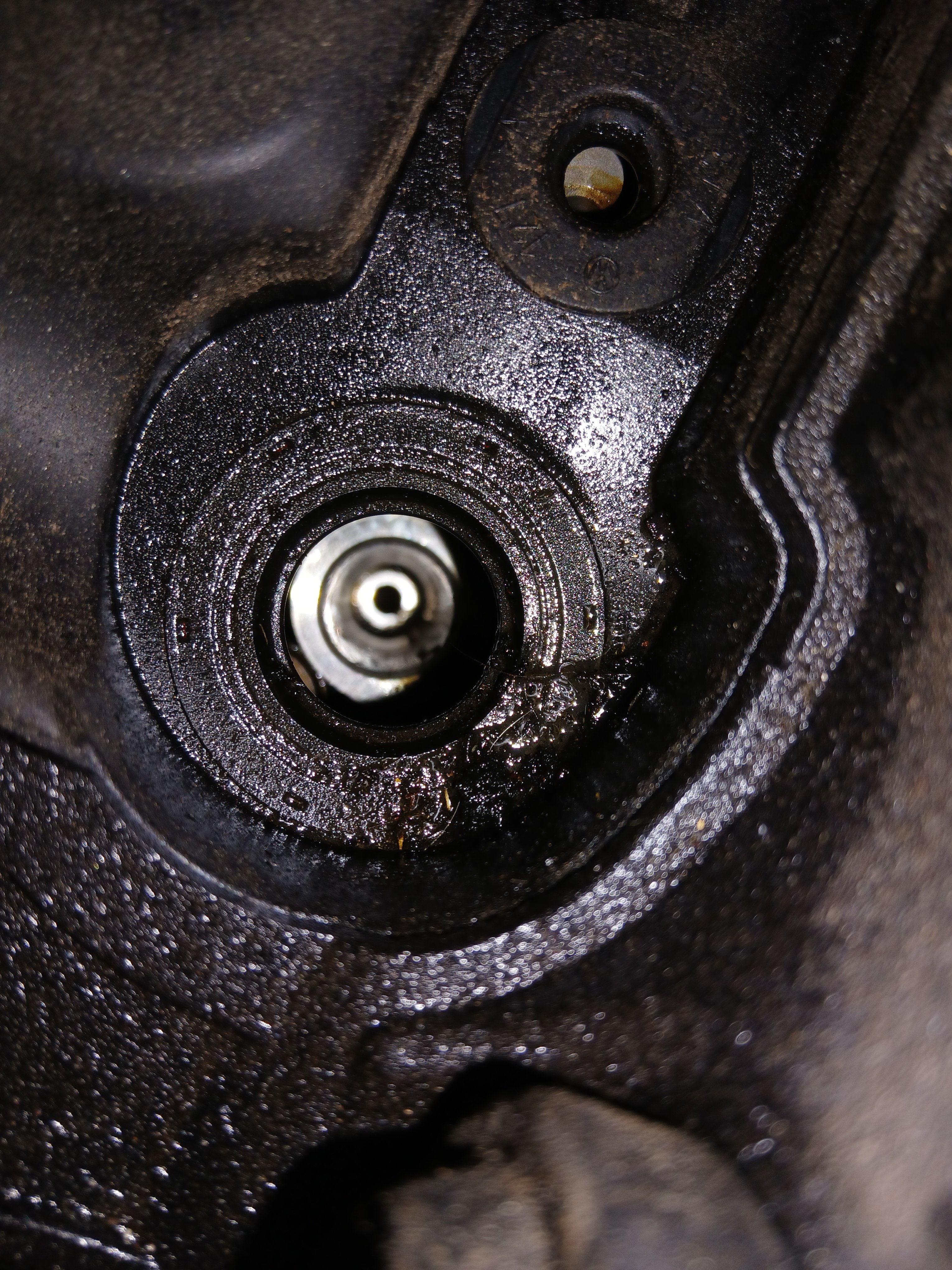

So put a new seal on the damper, genuine of course. Cleaned all up well and replaced.
Egr seal on the intake manifold was suspect too, so again changed it for genuine.
All back together and tightened.

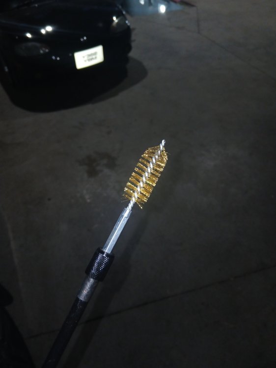

Tightened and replaced some suspect boost clamps too. Cleaned them all out when I was at it.

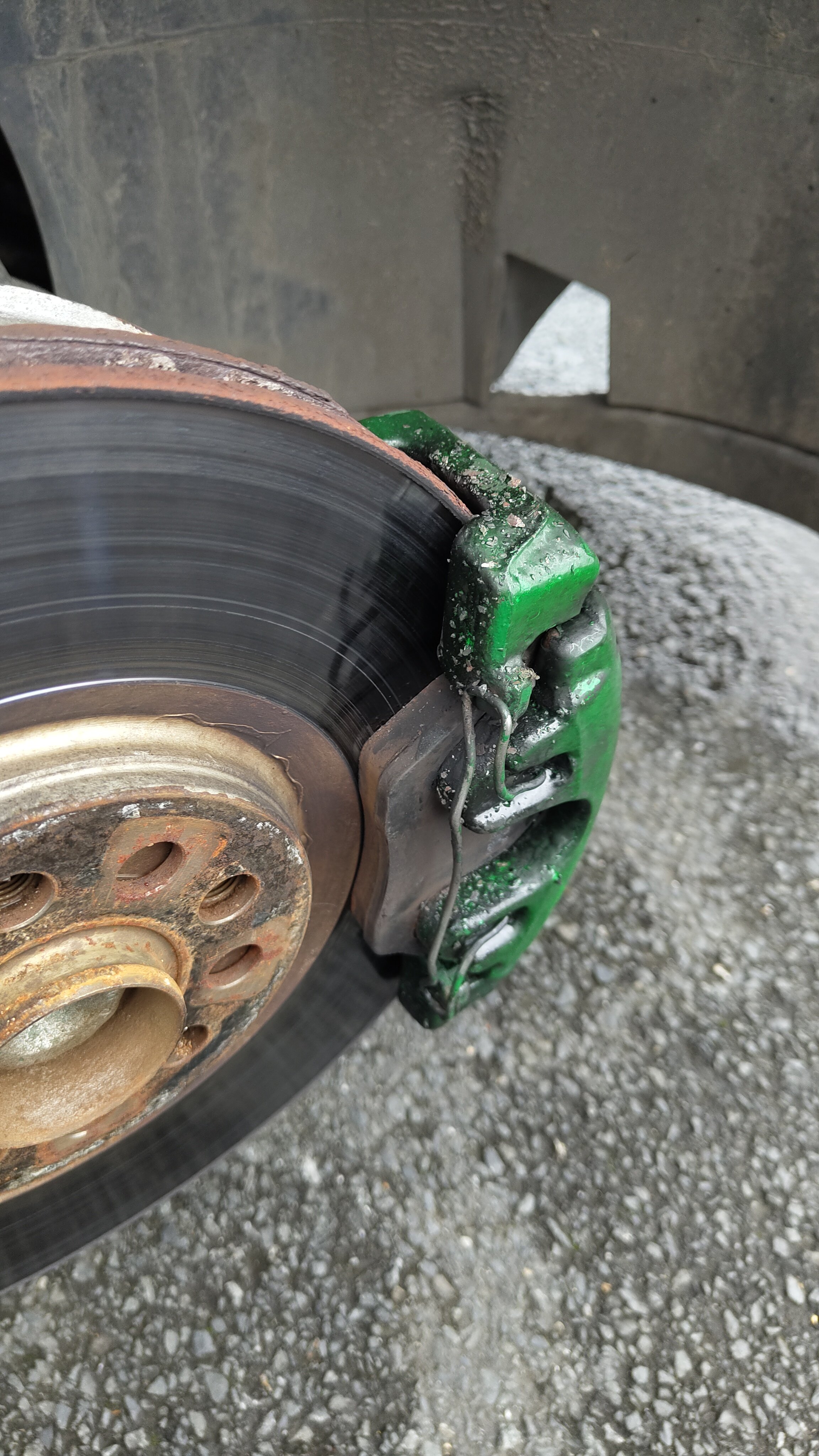

Went on a trip to Scotland, doing my pre trip checks, came across this.
Pad separated, on a bank holiday no less so couldn't get bits.
Ended up getting some textars to go on in.

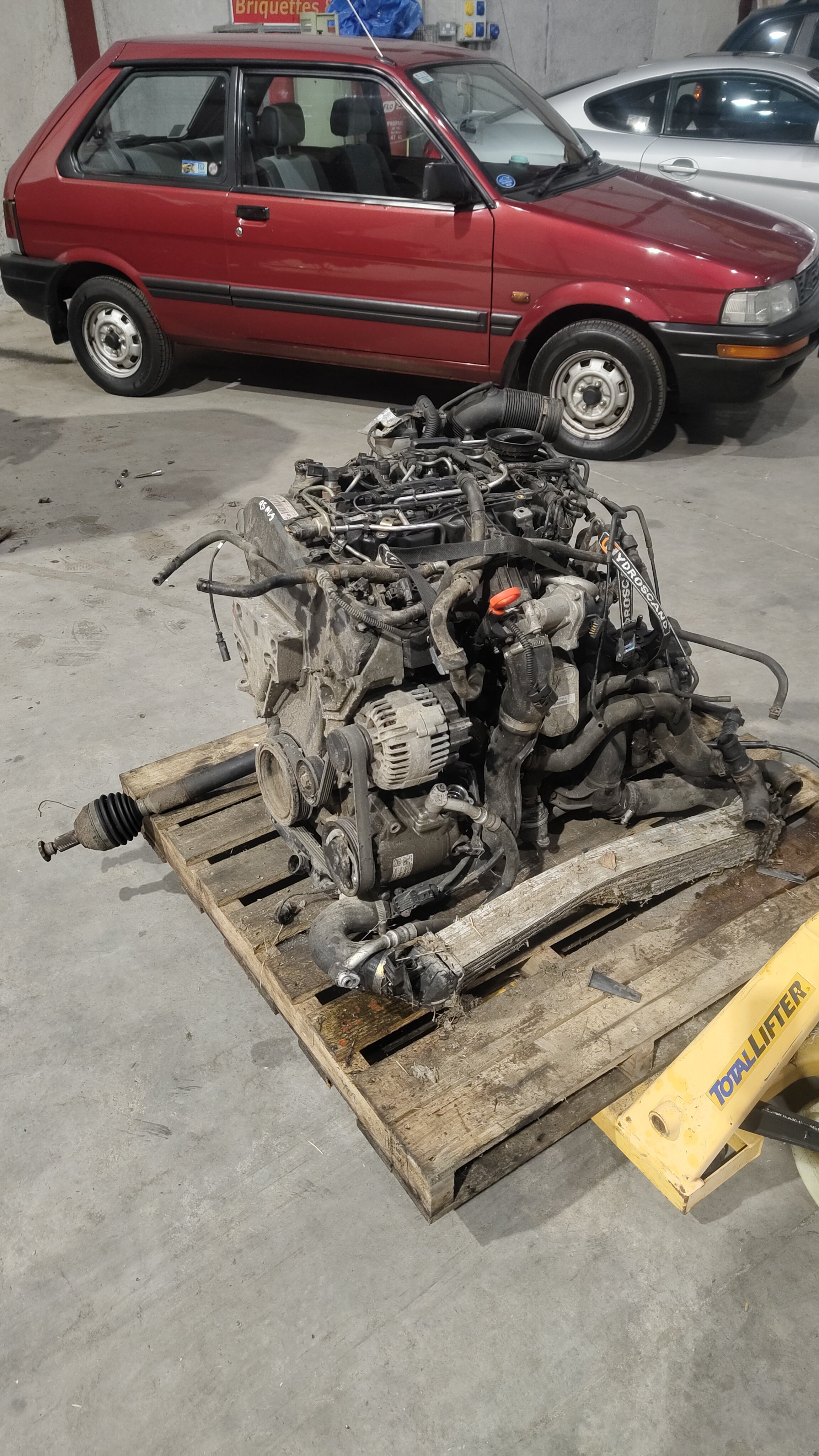

Off the ferry, dropped off the engine and went up through Scotland.

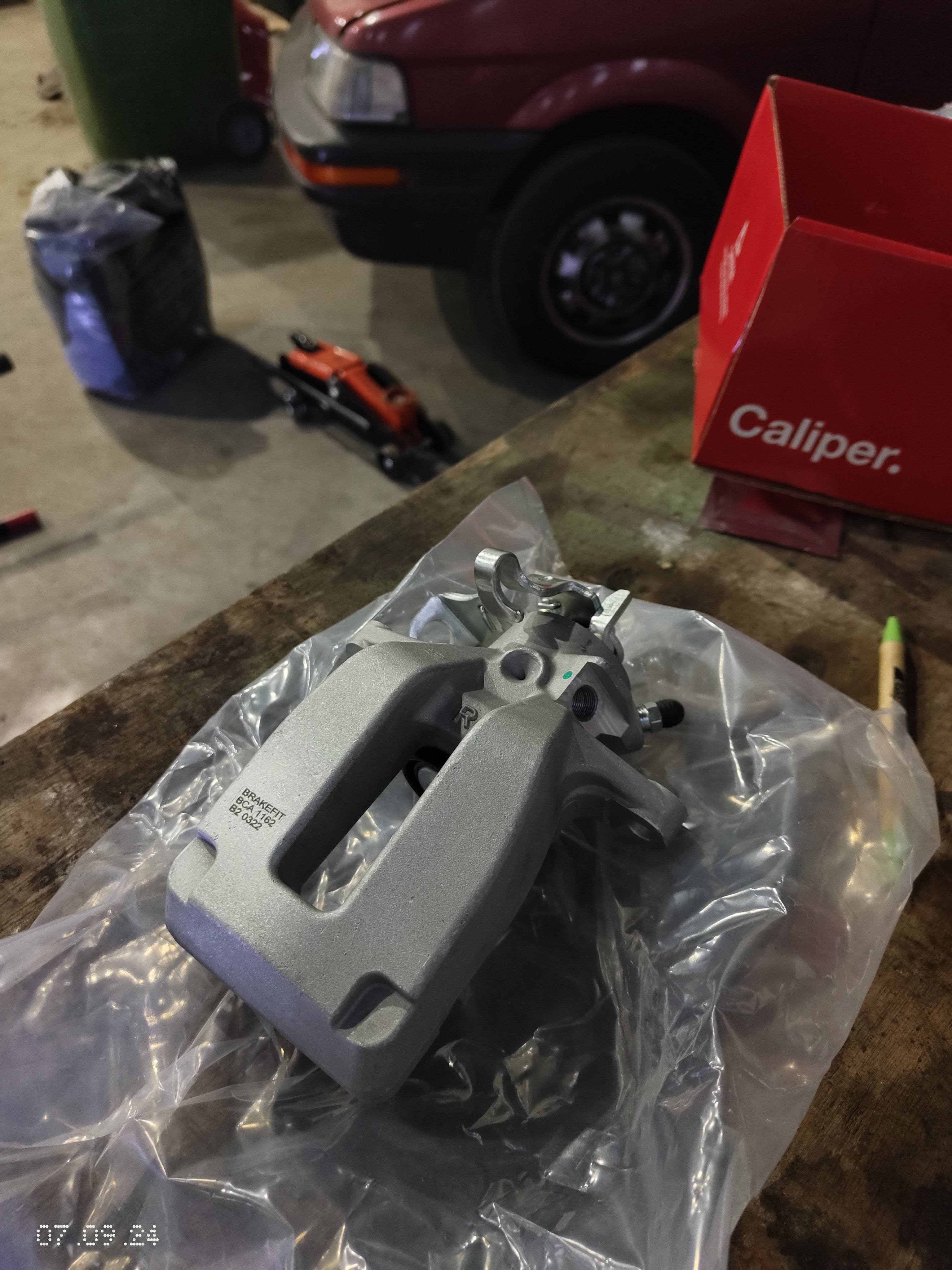

RHR calipers handbrake mechanism failed, even though it's nearly a year old
Otherwise worked fine but having half of an already meager handbrake is very annoying.
Also fitted new handbrake cables at the same time.

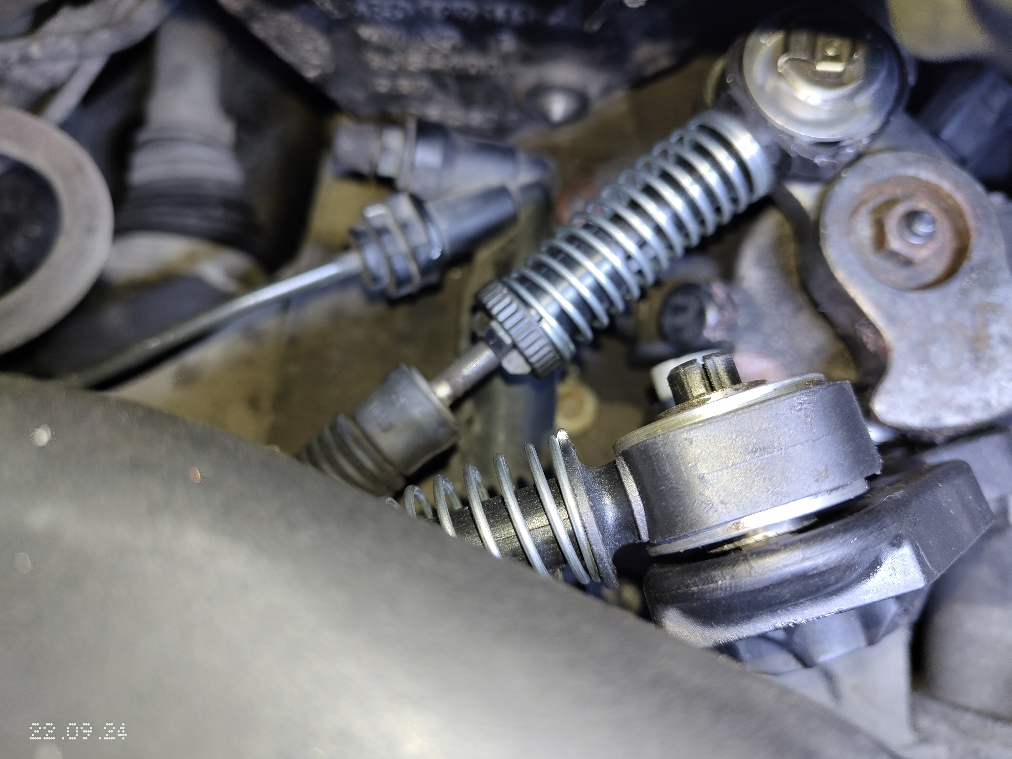

Gathered some bits to refresh the shifter
New cable ends, new bits for the shifter box also.
Can't post the before video but a vast improvement, still not amazing, but better than before.

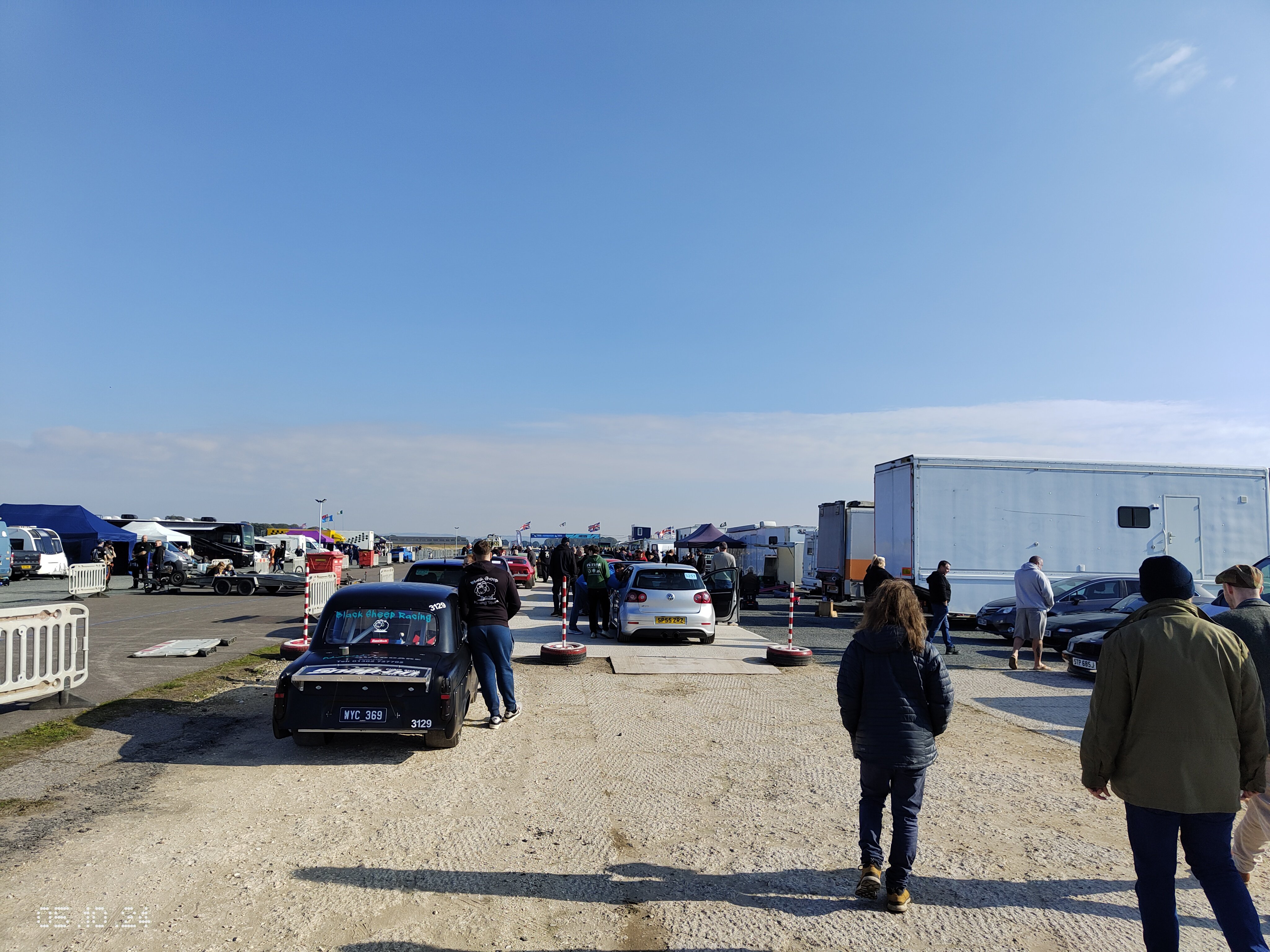

Went to Melbourne last week.
Was really busy all weekend
Still slow but markedly faster than last time

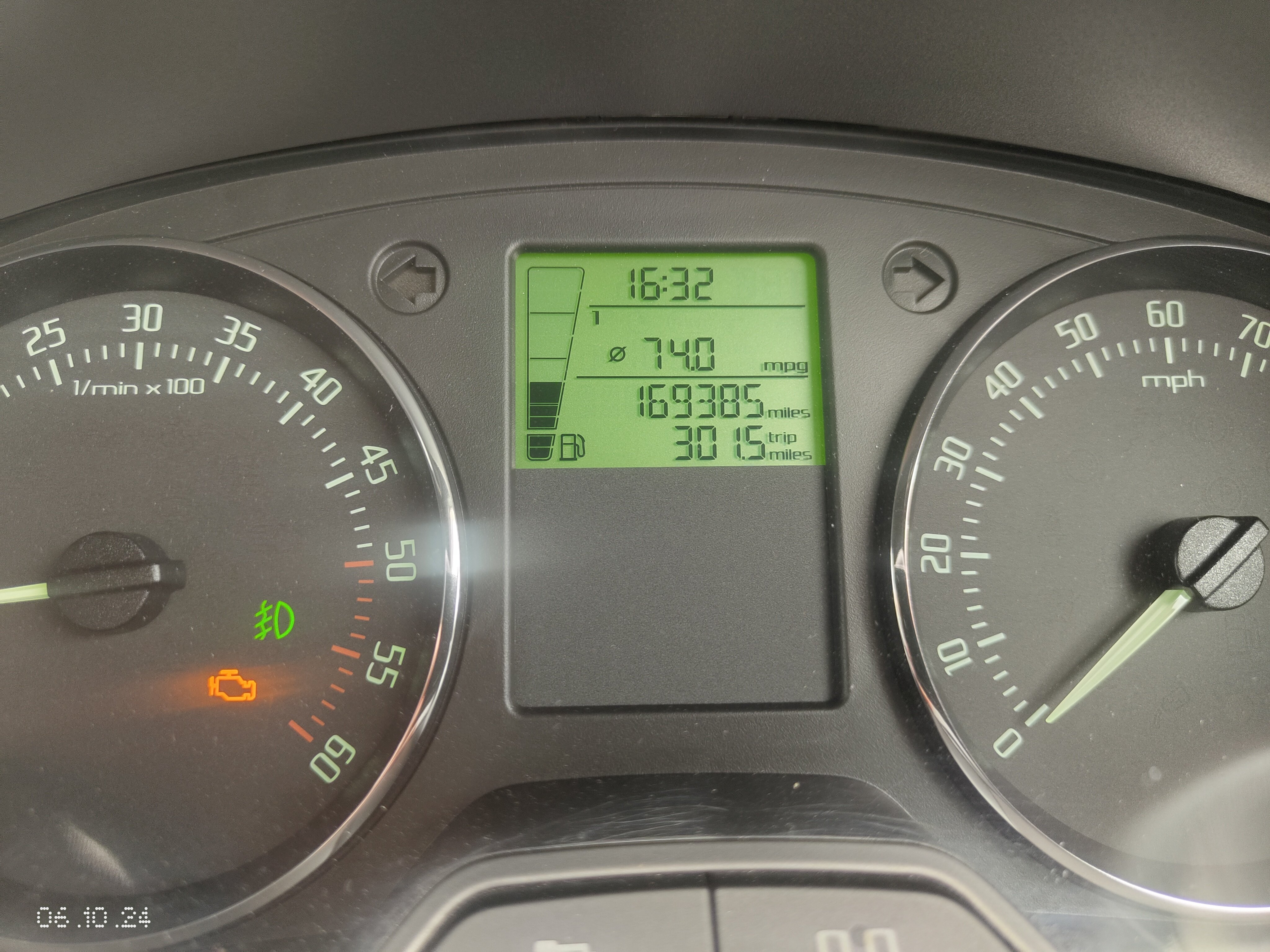

Persistent check engine light which is either the map sensor or a glow plug.

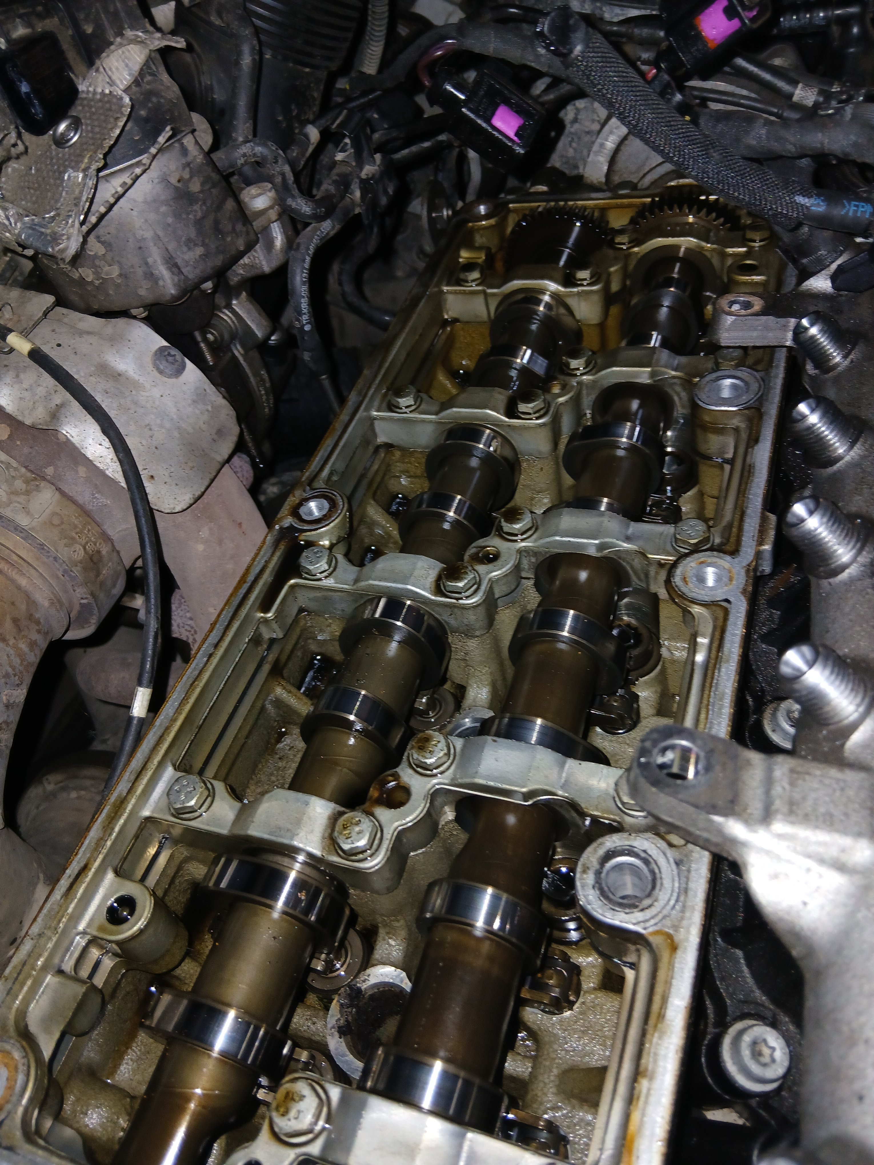

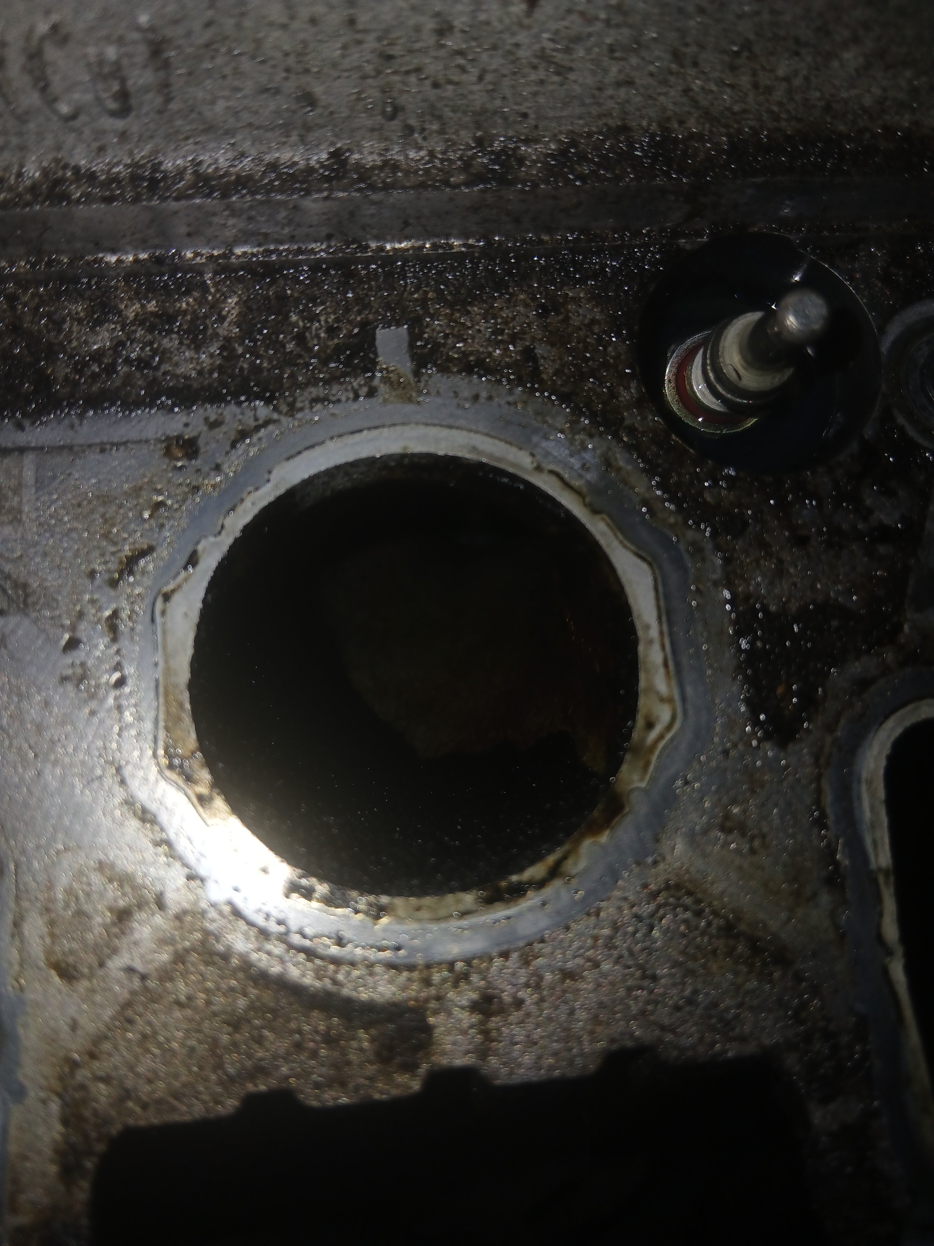

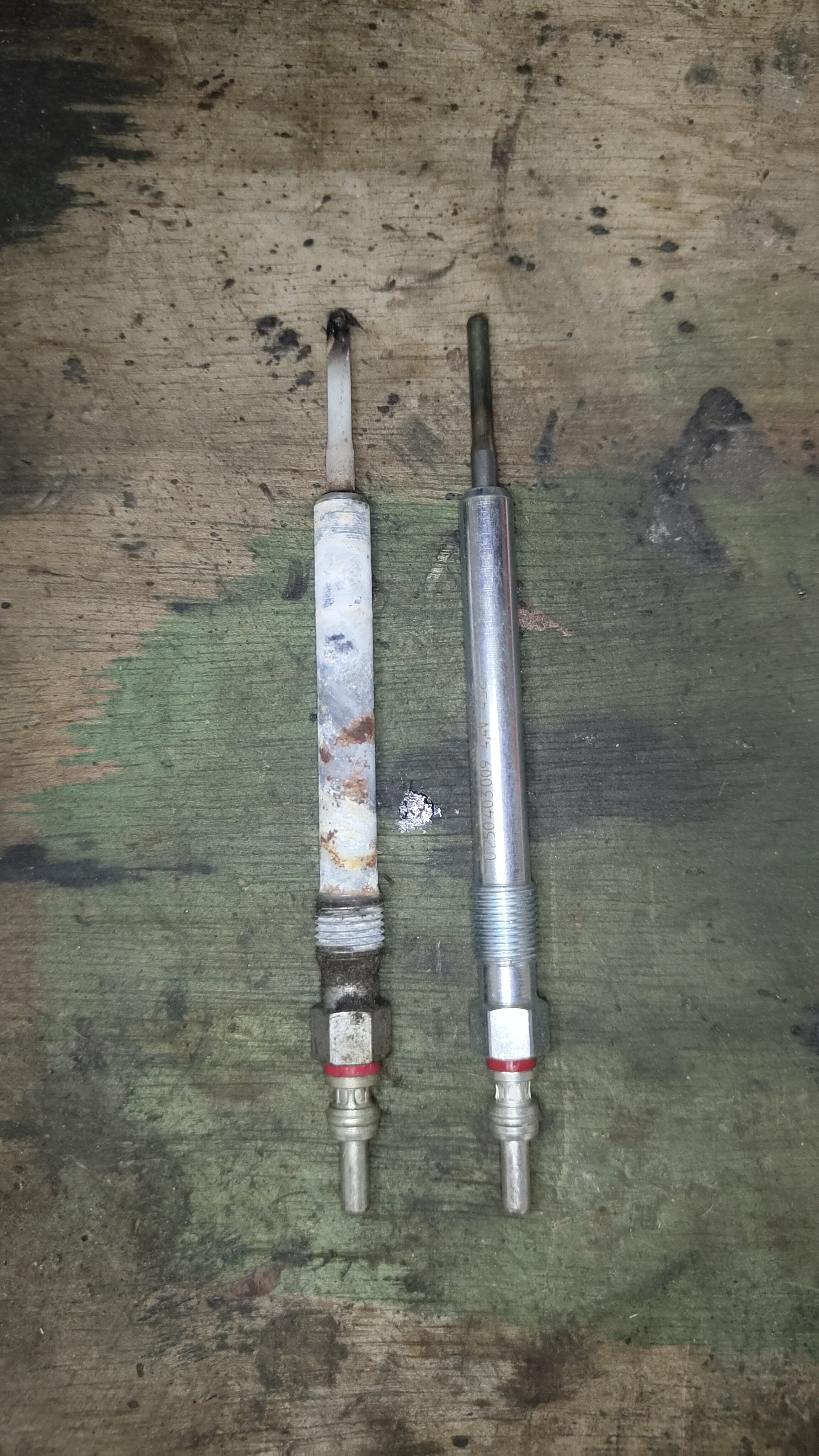

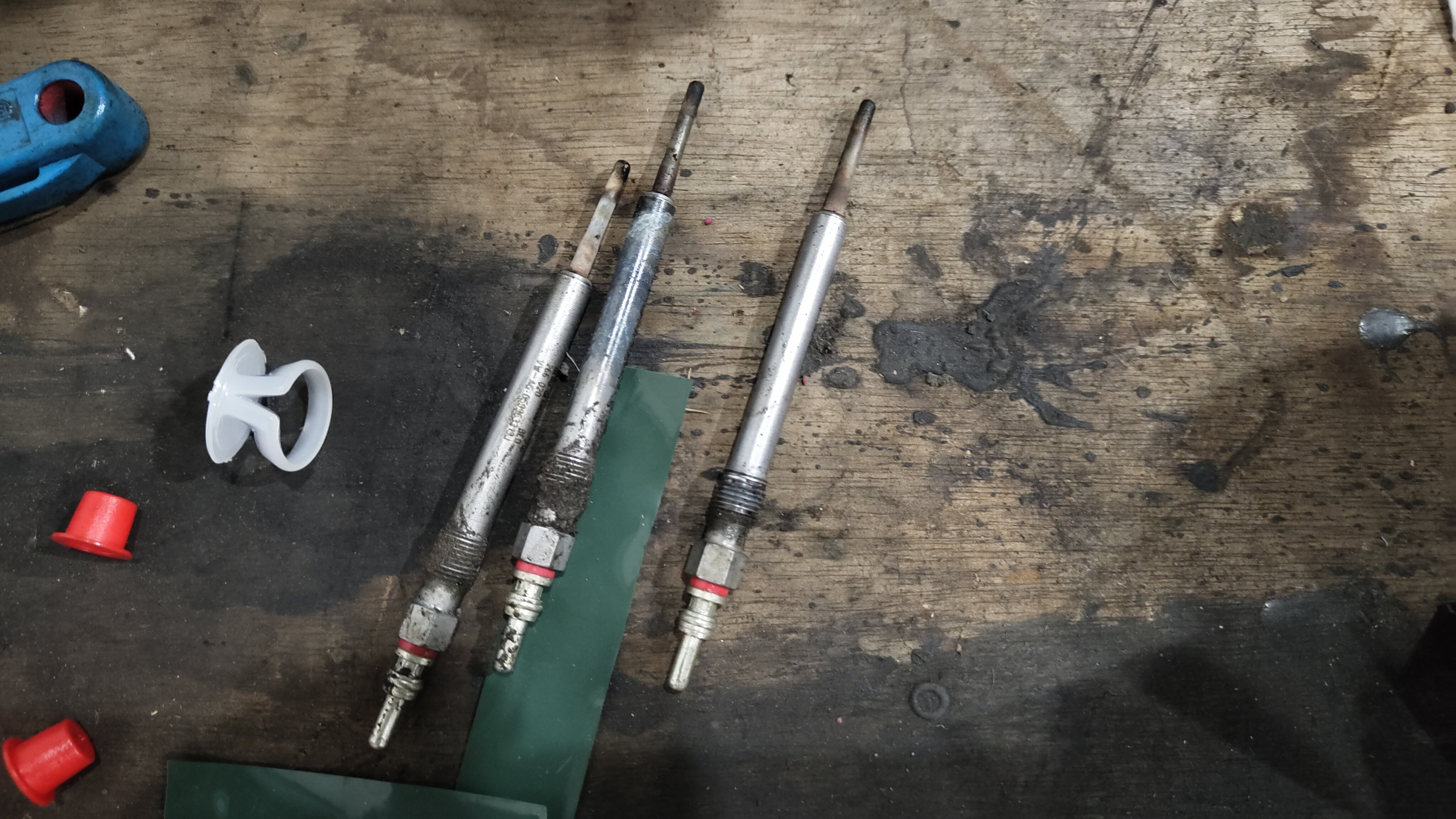

Replaced cylinder 1 glow plug as it was showing a light.
Was well due.
Came out easily considering it's most likely original.
Might just replace the other 3, can't imagine they're far behind.

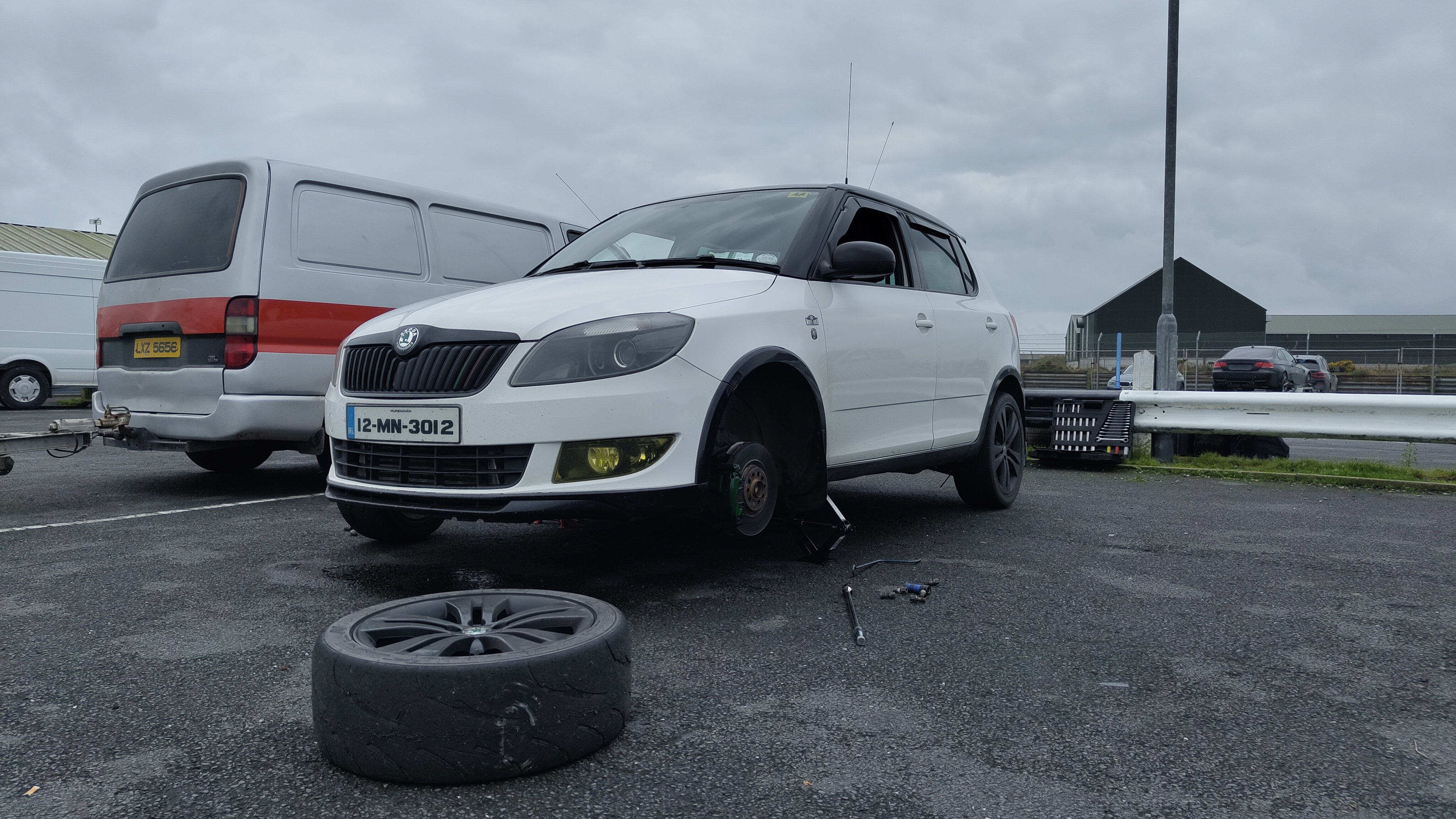

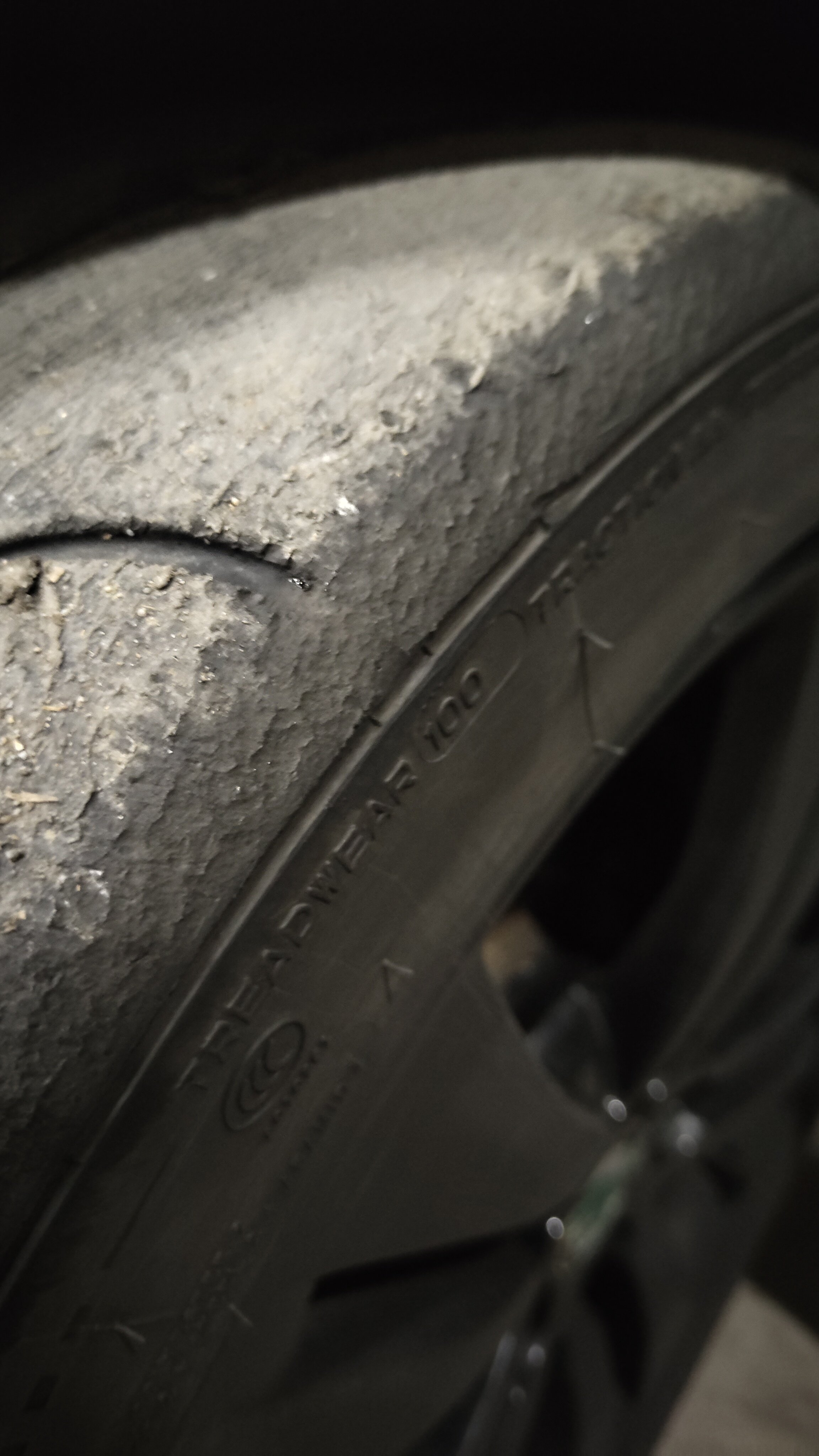

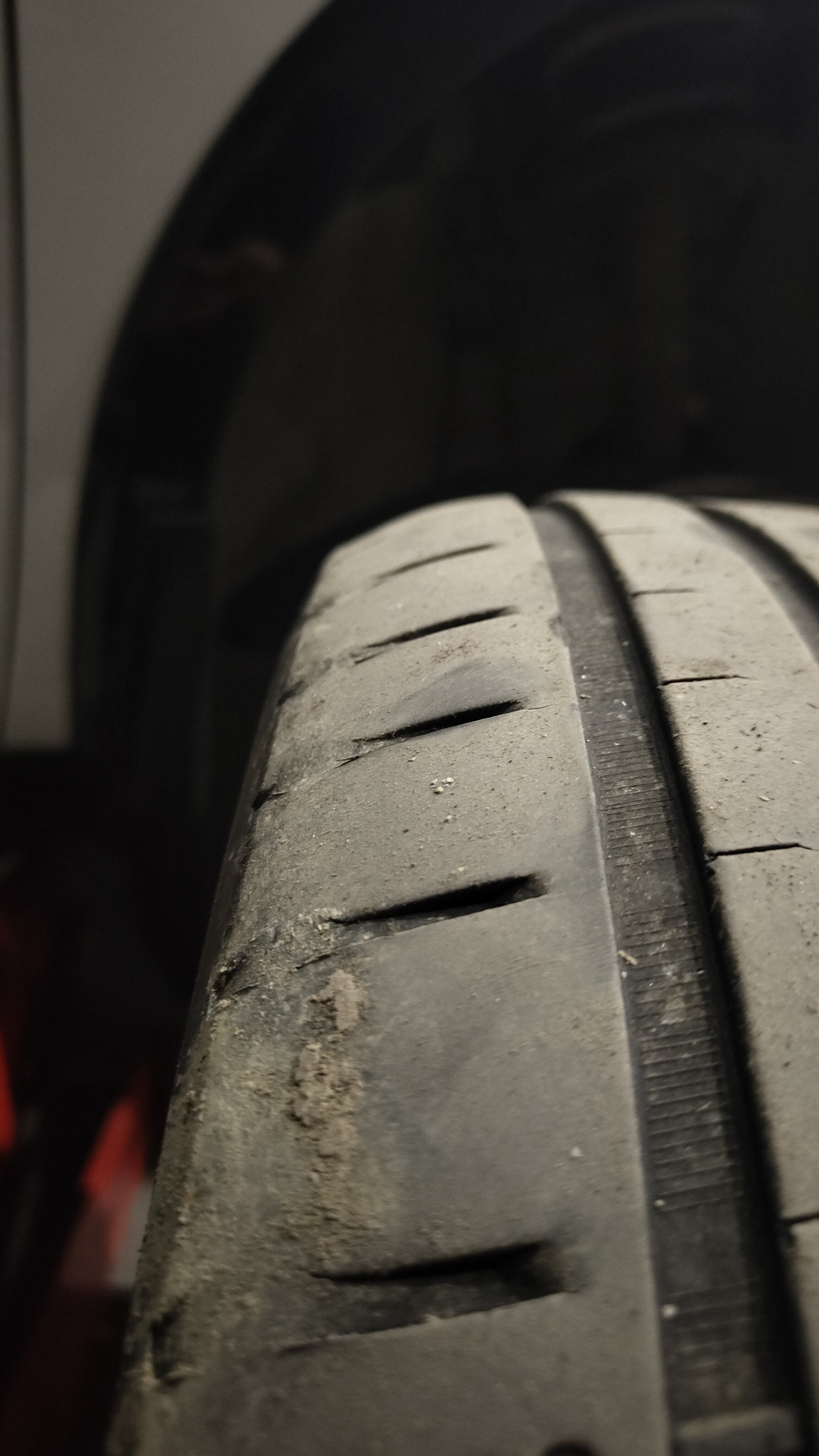

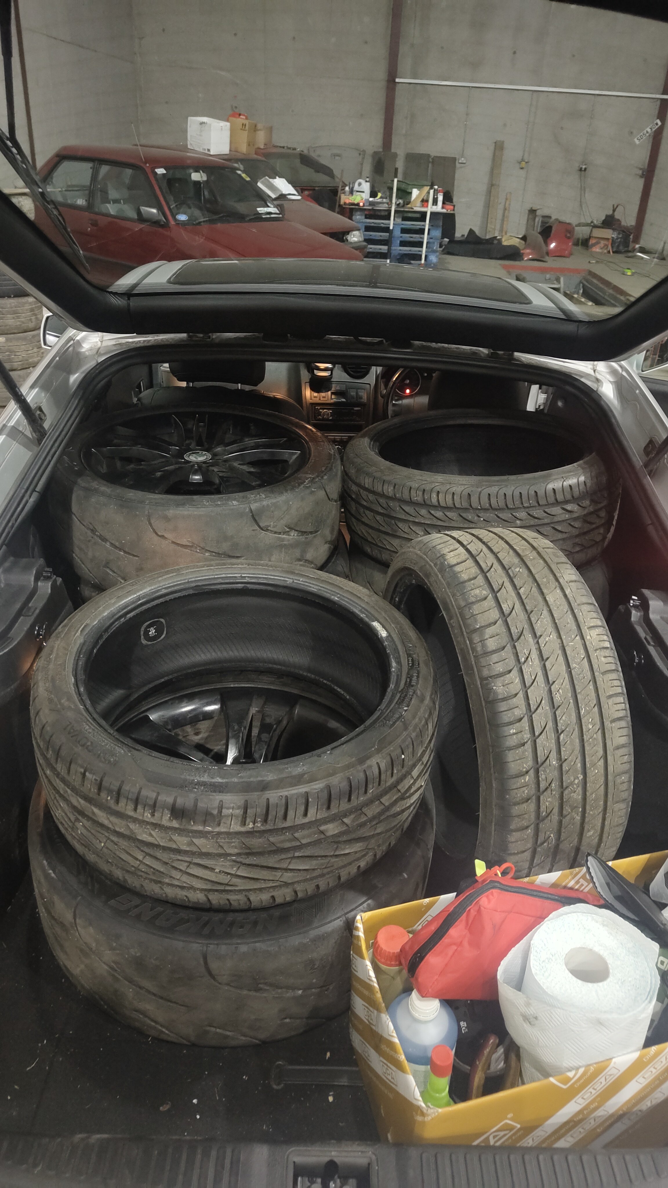

Got my semi slicks on some spare alloys. Tyres that have come off are in really good shape so can use them for the VRSdi
Inners on my pilot sports are heavily worn as per usual.

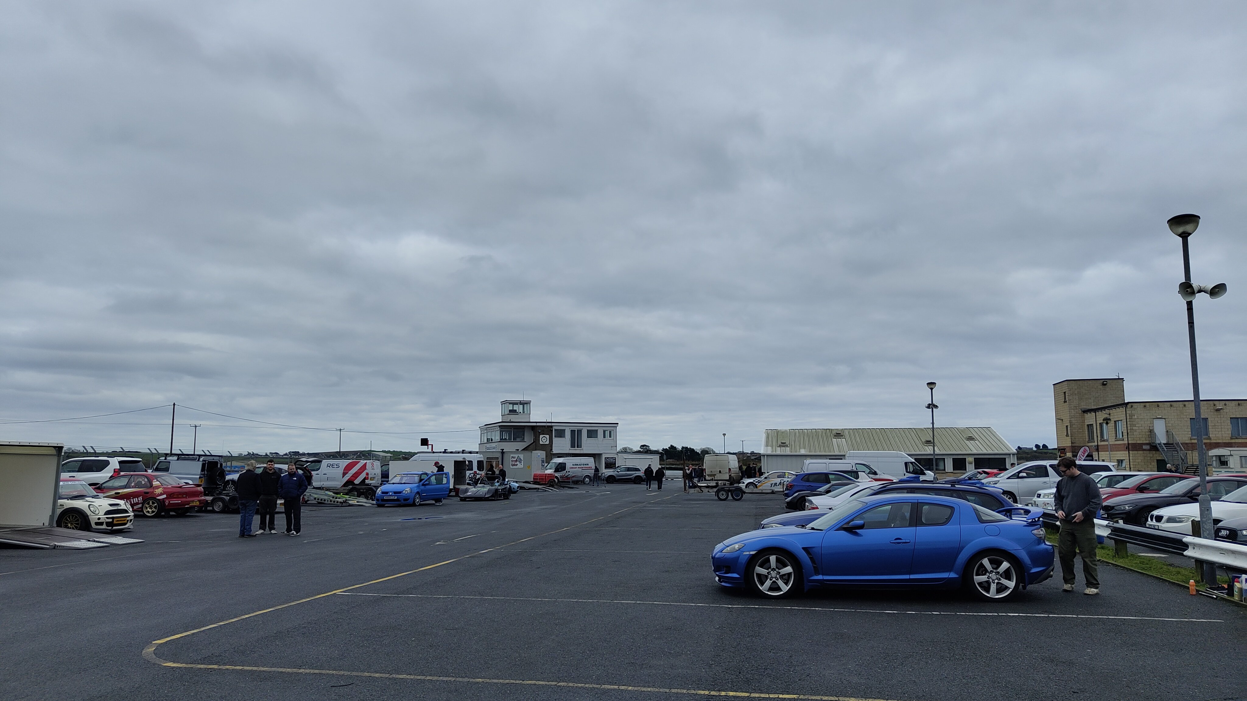

Booked a Trackday at Kirkistown for today so went up.
Just shy of 2 hrs driving each way.
Drove up on the semi slicks.
Quite a few cars. Was pretty nervous for my first Trackday but it was absolutely fantastic.
Everyone was extremely nice, fantastic atmosphere.
Some really quick cars too.
Brakes held up fairly well, paint melted on the calipers a bit, but they were due for a refresh anyhow. Track debris stuck to them like glue.
Kirkistown is a very fast track that's very heavy on the front left tyre, I'd been warned before hand. Made the mistake of having tyre pressures too high, so wore the middle a fair bit.
Was warned to not use the handbrake either so used a suicide jack as a wheel chock.
Intercooler sprayer came in clutch. Even though it is November, and a mild 12°c, intake temps were wanting to stay around 50°. Used torque to monitor water temp and boost. Water temps were quite warm, didn't overheat but peaked at 108°, kept the heater on full and fan on to help. Boost seemed to pull back with high intake temps. Normally peaks at 22.5 psi, pulled back to 18 ish when it was heat soaked.
Swapped the front wheels around to try balance wear.

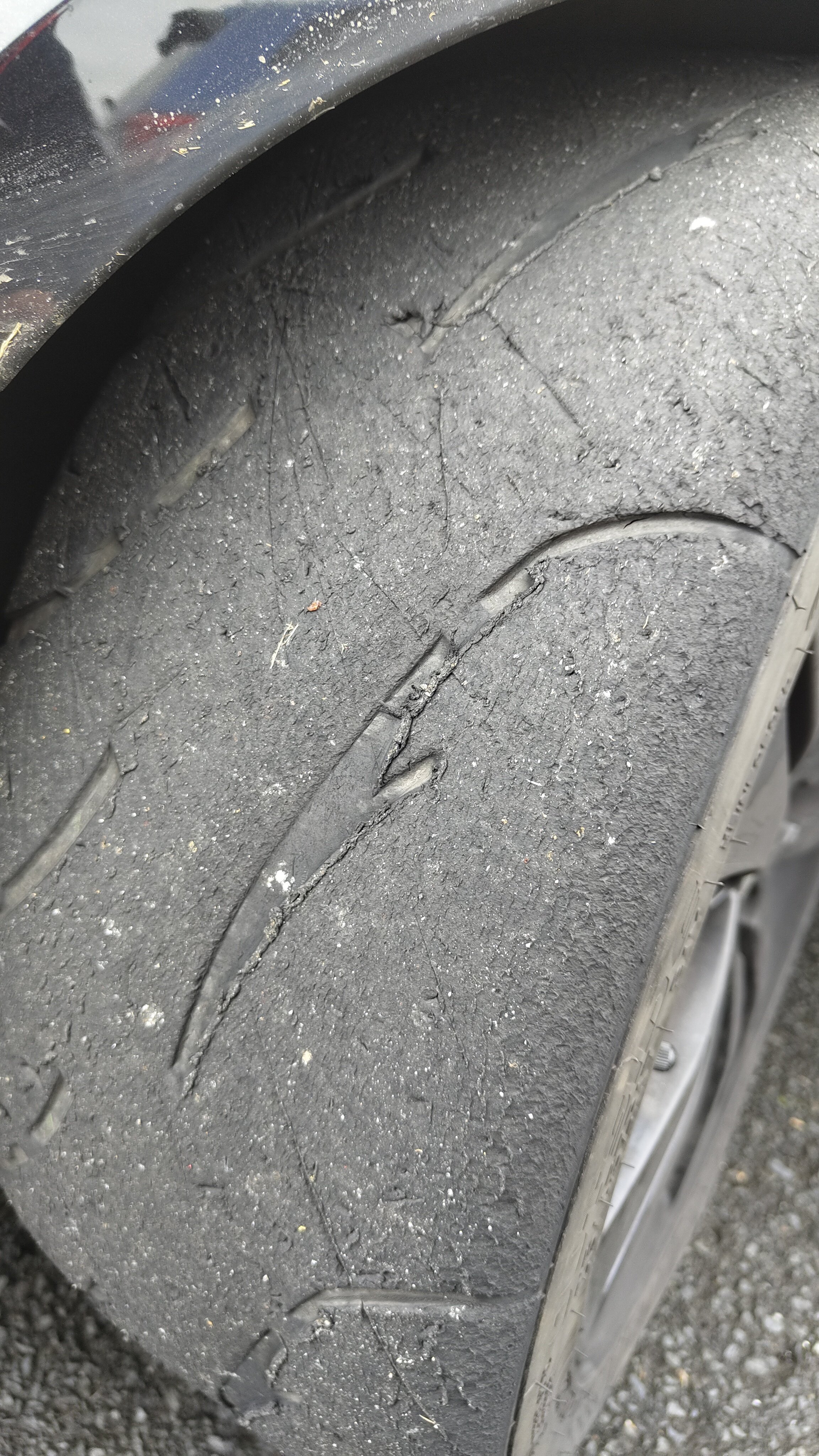

Running 215/45/17 Ar-1s, even though they were near the end of their life they held up really well, and they were free.
Did get some minor rubbing however.
Was careful to cool it down after each session, not leave the handbrake on etc. Opened the bonnet and let it idle between sessions to cool it as much as possible.
Few people came over and had a look,
Some very fast cars and drivers, did my best to keep out of the way and keep pace. Didn't want to leave a bad impression.
Think I did fairly well for a first time out, the semi slicks were a big help, but otherwise it handled pretty decently for what it is.

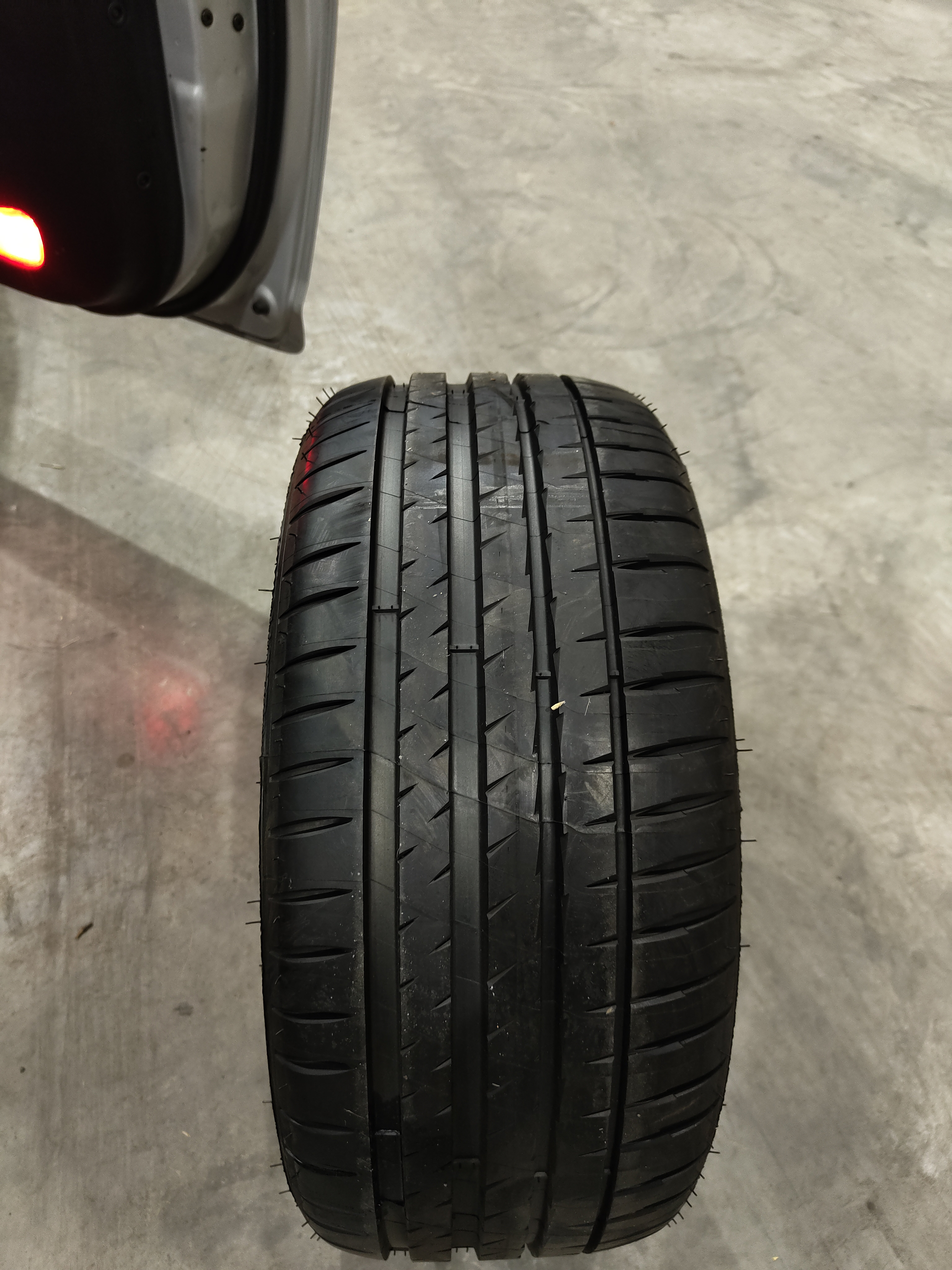

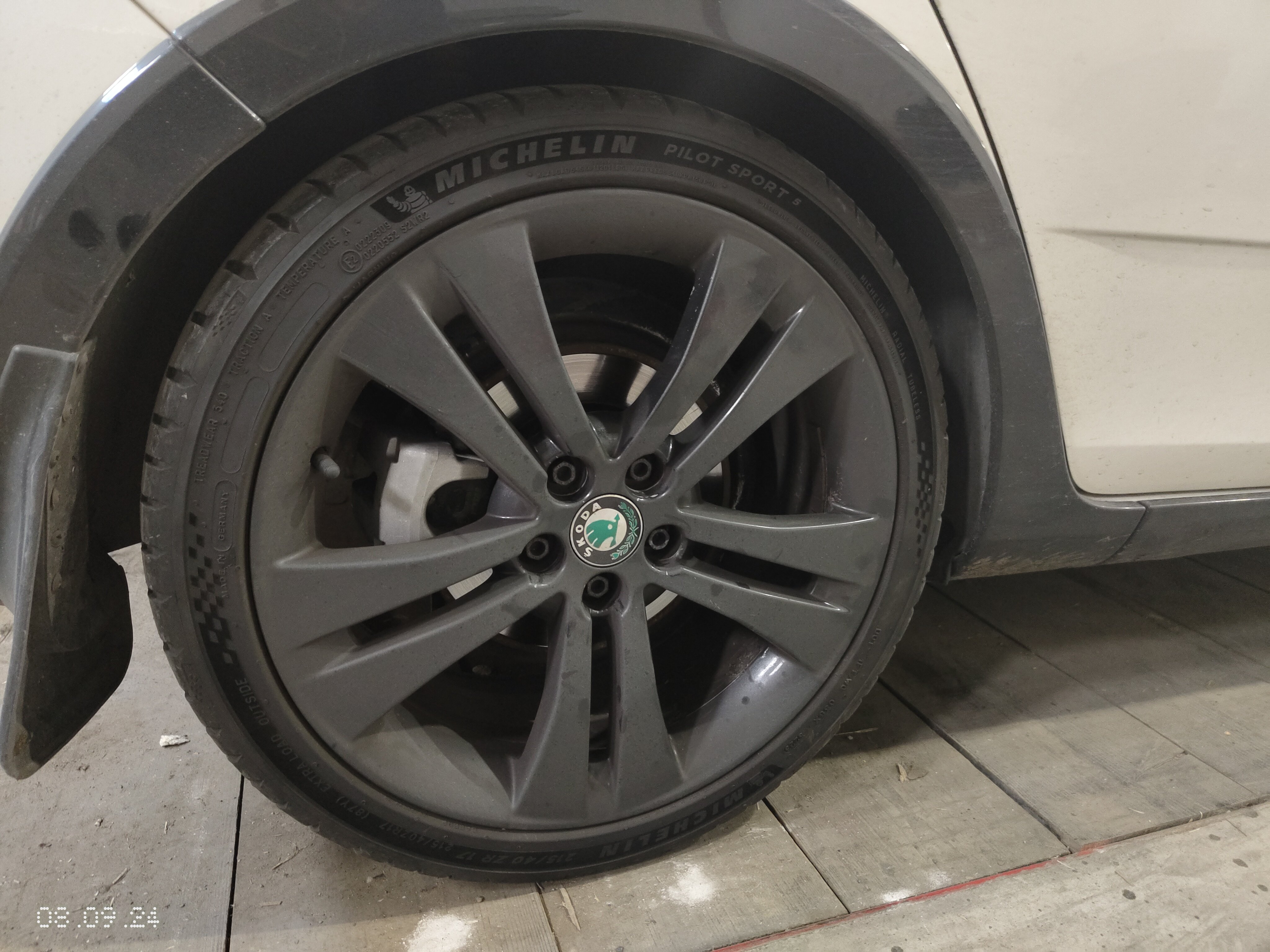

Also got a new set of pilot sport 4's for cheap, so these will go onto my normal wheels soon enough.

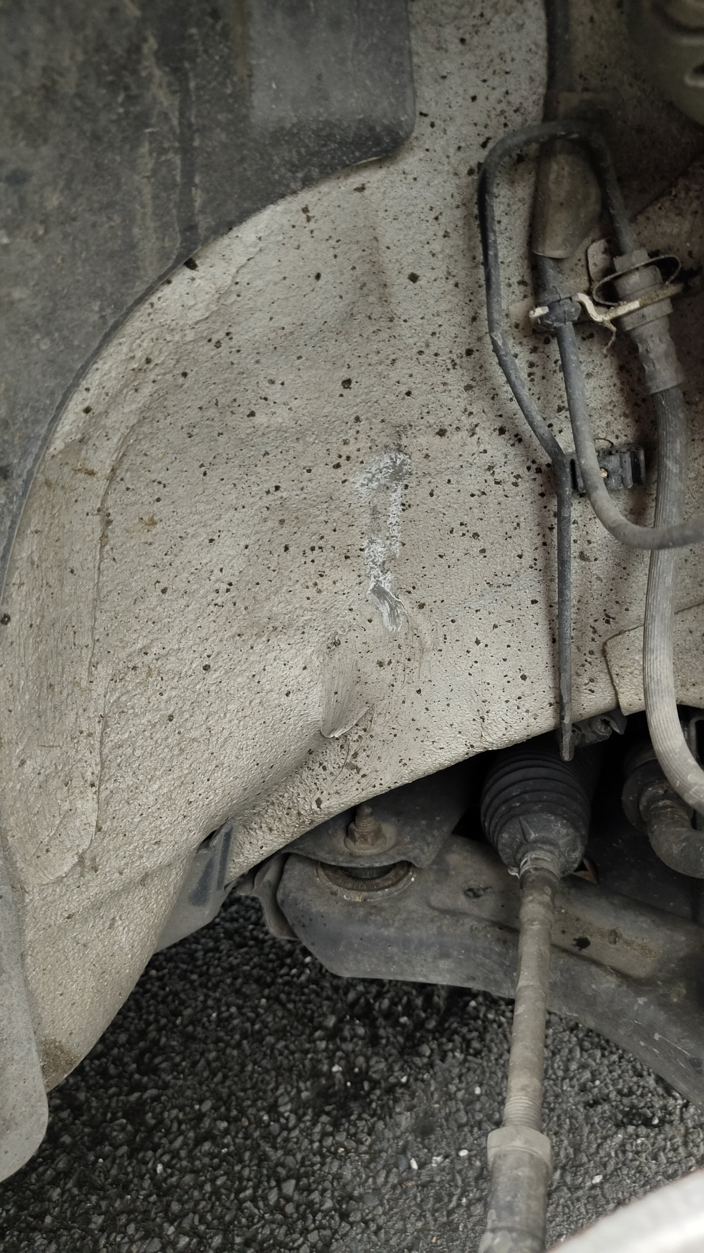

Since then I've blown out my undertray. And I need it soon for test.
Pulled it off, not much if any damage aside from it.

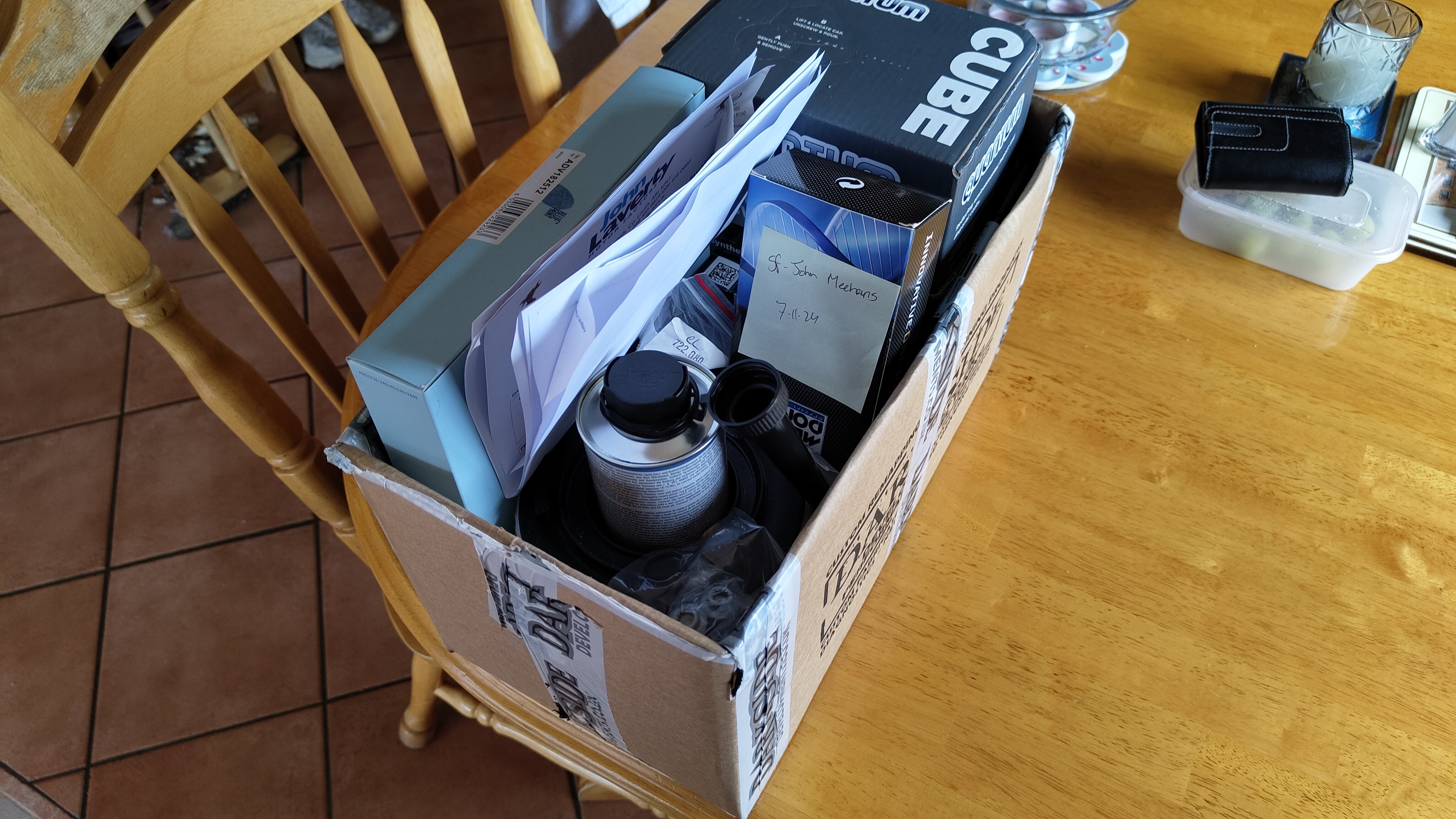

Got a full service kit for 170k
-Quantums finest bag in a box oil.
-Oil Filter
-Air Filter
-Fuel Filter
-Pollen filter
-3 remaining glow plugs
-Magnetic Sump Bung
-Liqui Moly engine flush (on the cheap)

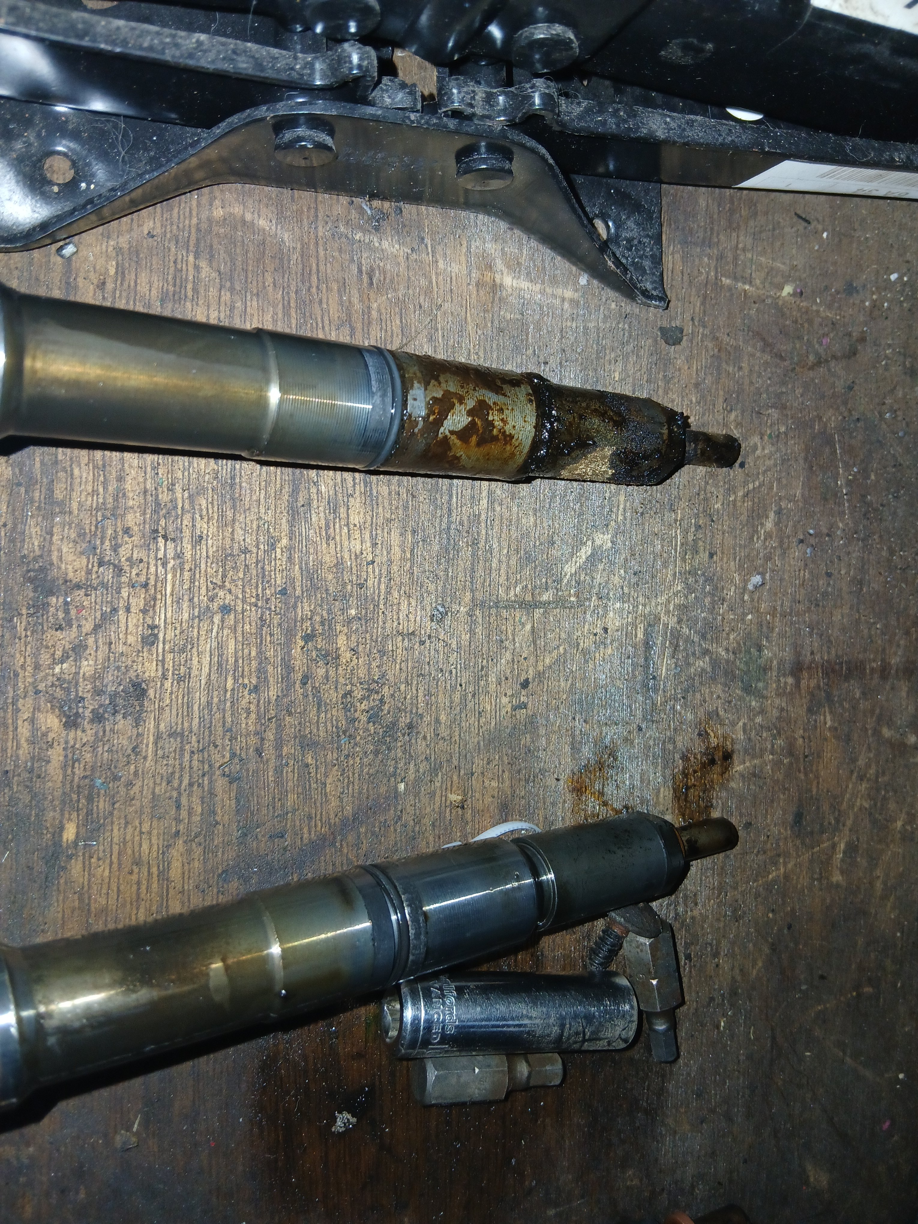

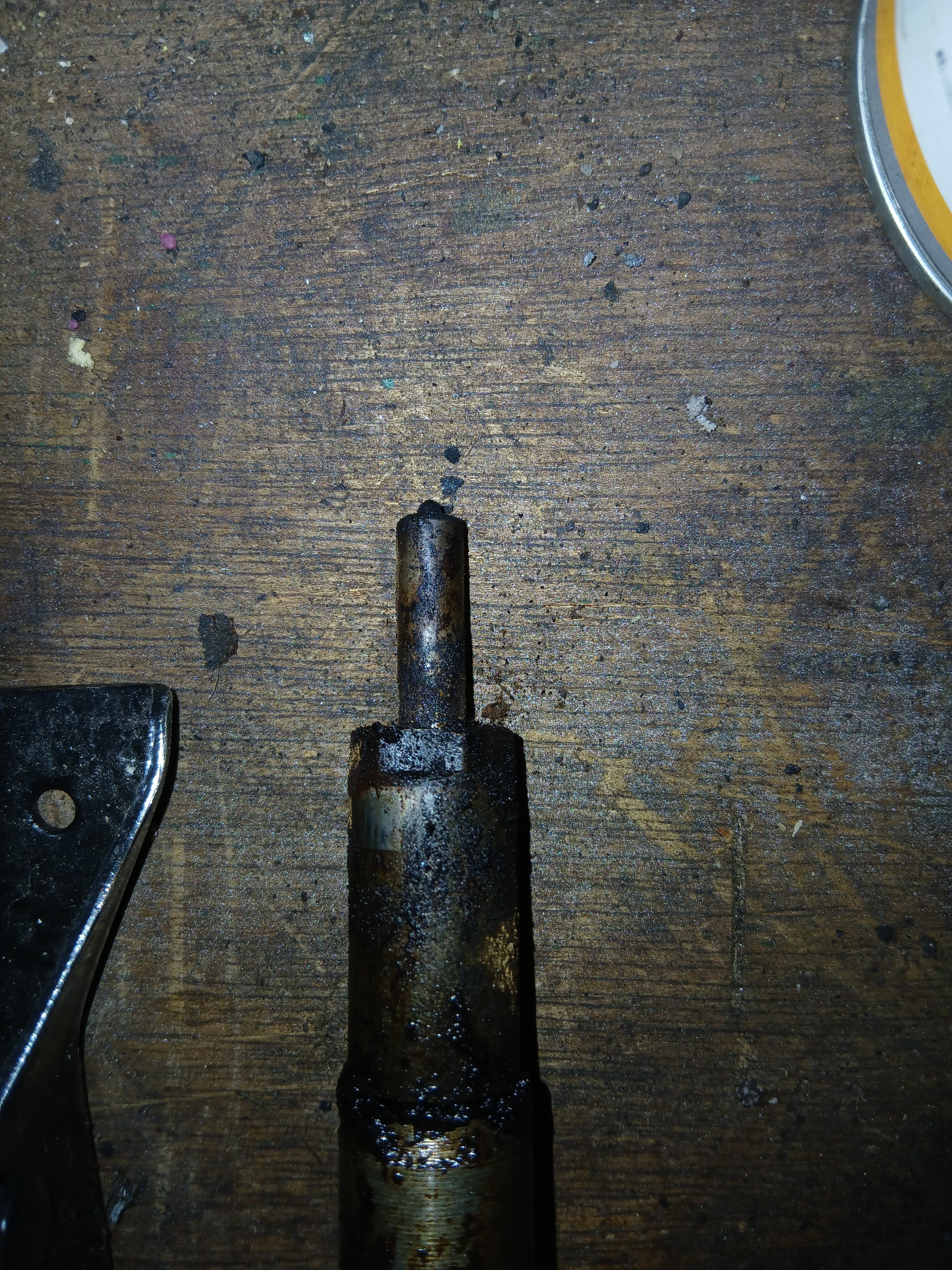

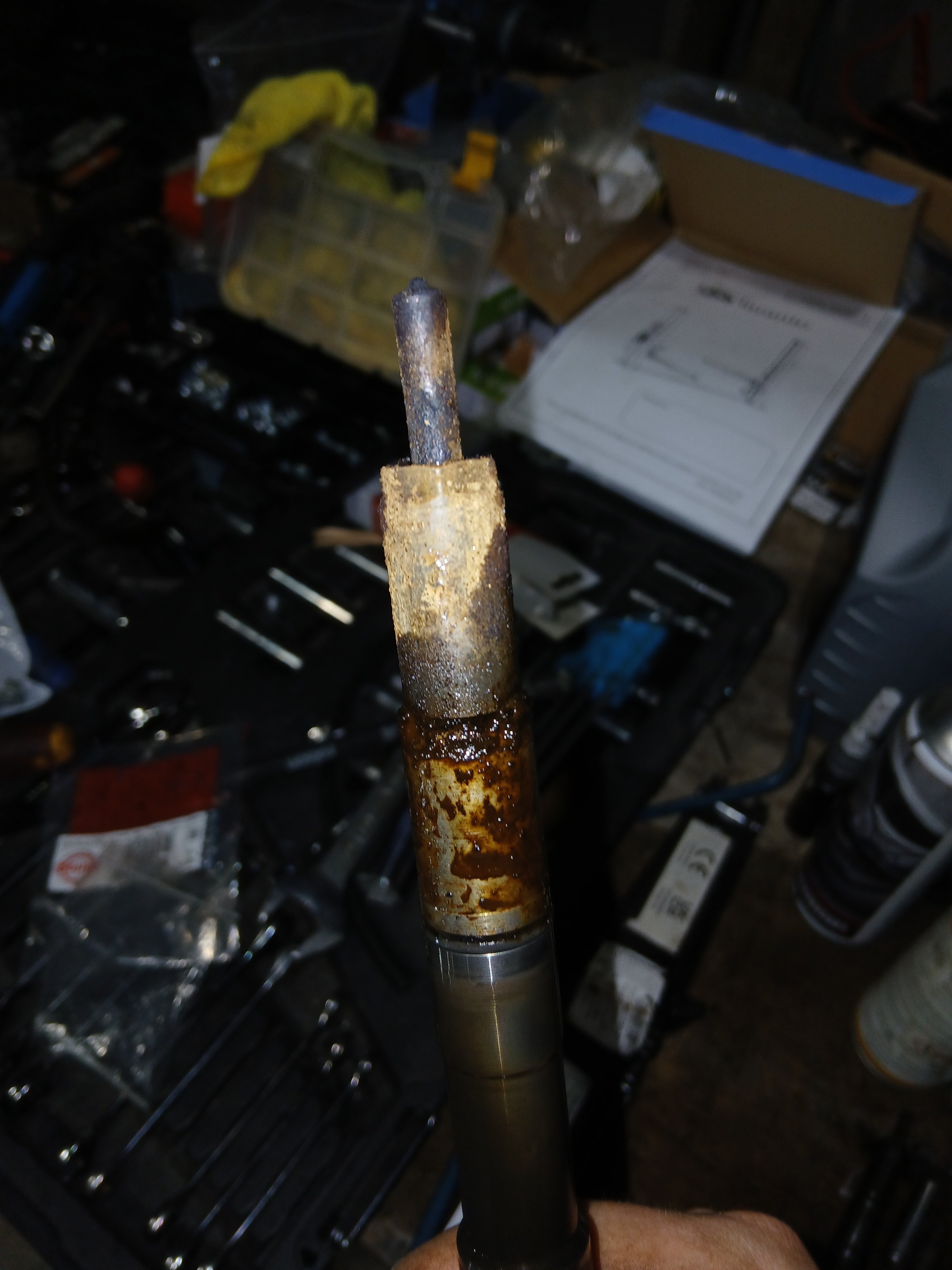

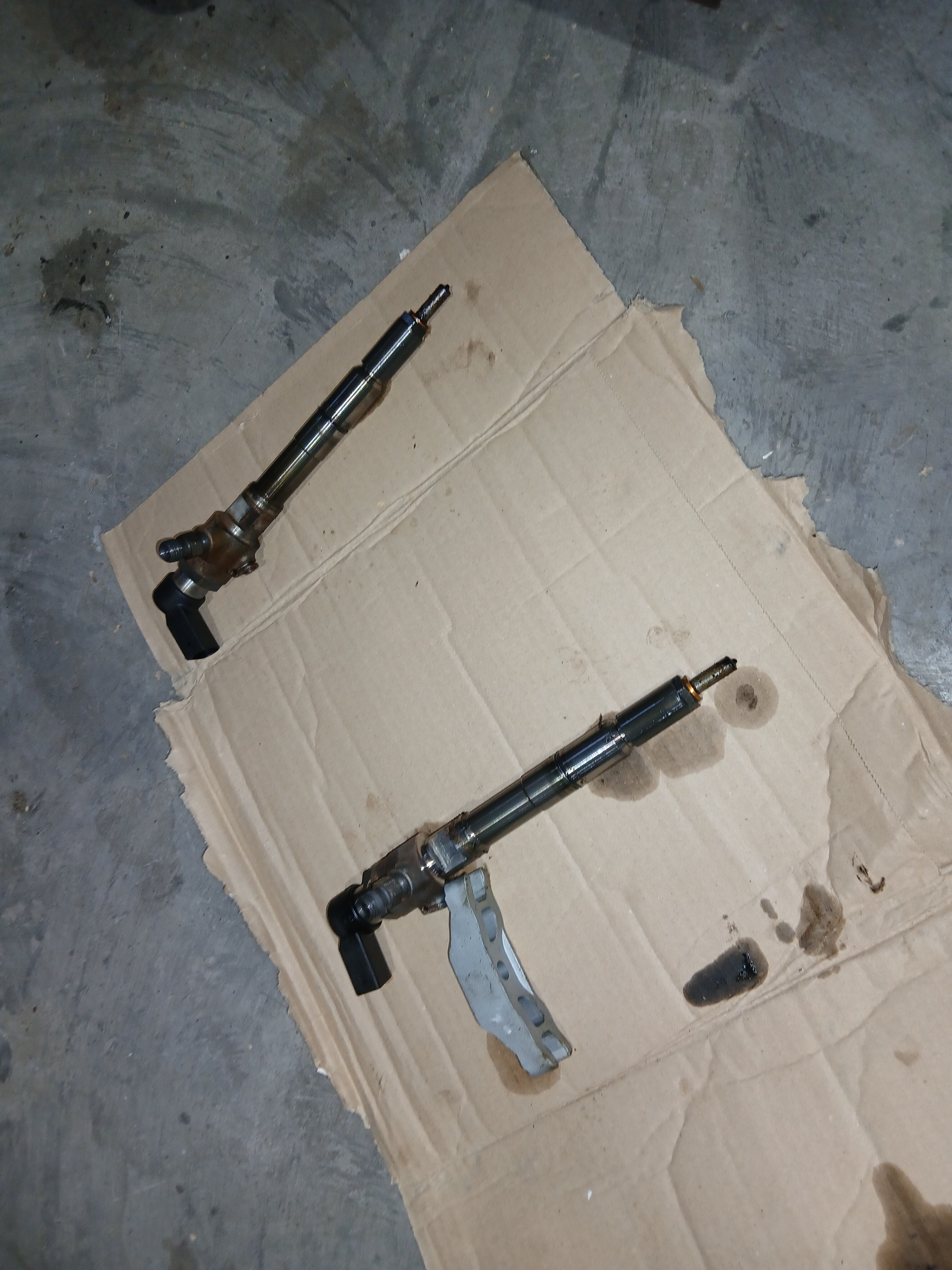

Also got some injector seals and bolts from darkside, but didn't get doing them.
New rocker cover injector gaskets too.

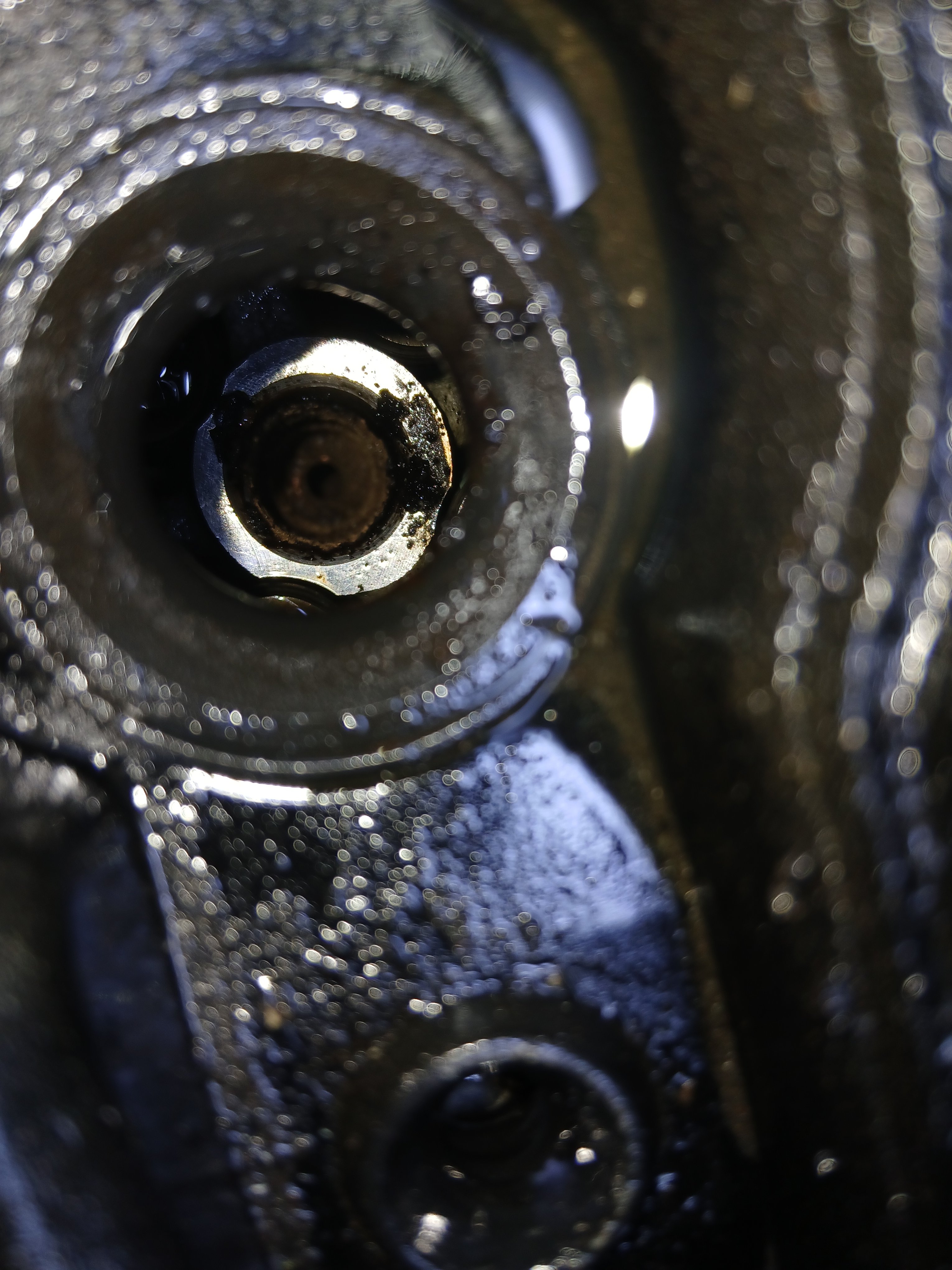

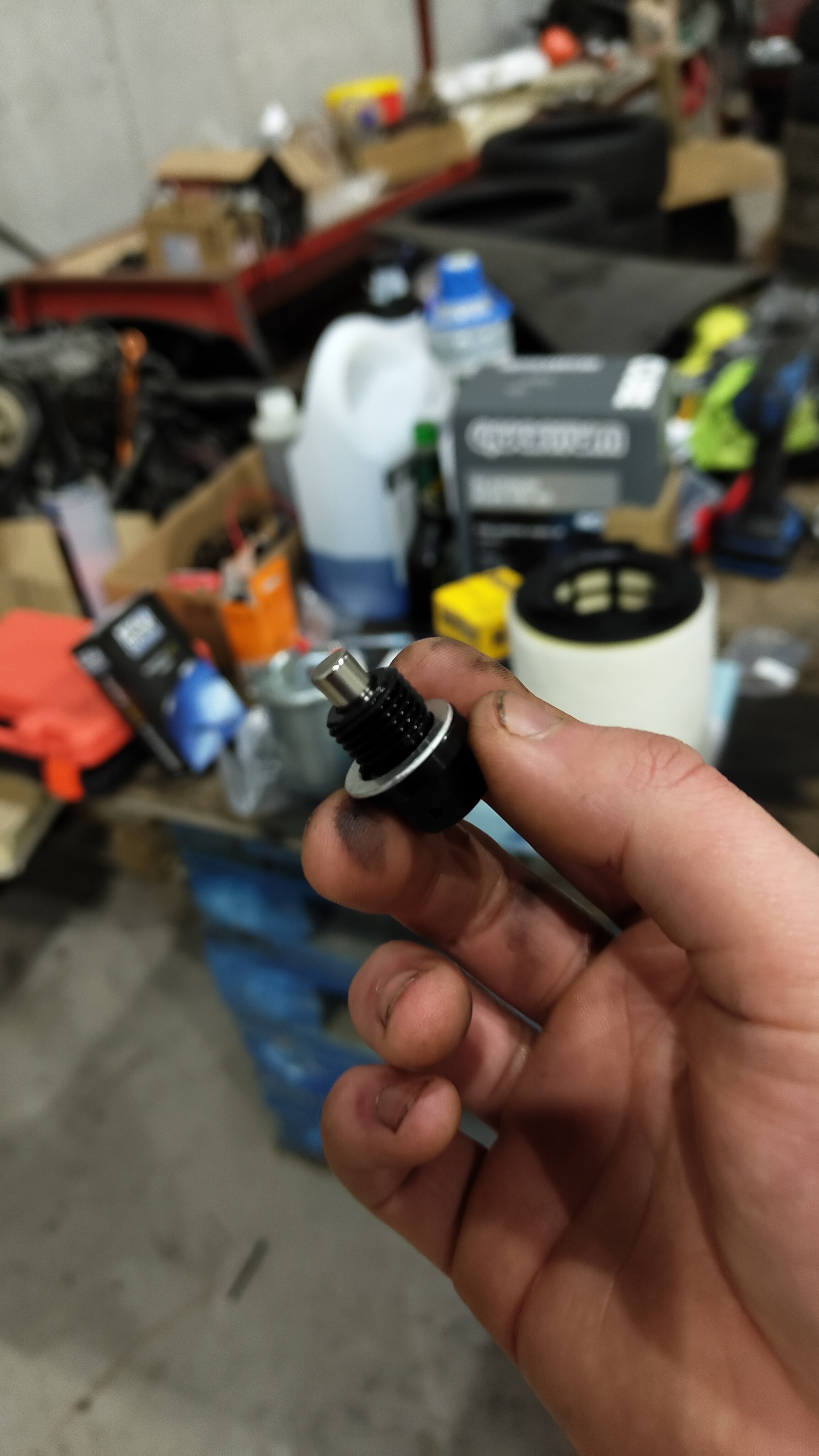

Hoping to not see anything on this sump plug when I change oil next. Magnet on it is really strong so if there is anything in there I'm sure it will be caught.
Remaining plugs looked fine, fair bit of gunk around the top of them so was careful to blow air around the wells to clear them, soaked the threads in penetrant too. New ones in so all should be working as intended coming into winter.

Tightened up a few things, greased the shifter tower, etc.
Not a hard job to do and considering how cheap I can stiffen these up for I don't mind replacing them every so often.

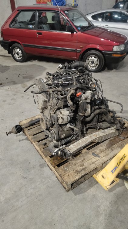

Also dropped the engine and gearbox out of the parts car.  Know it ran fine beforehand and although my engine refuses to die it's nice to have on hand. Been debating stripping and refreshing it or leaving well enough alone. It's there when I need it anyhow
Not much, near due it's next service, already started pulling more off of the spare engine, relatives car popped an injector so used one off it and spare bolts seals I had for mine to do the job.

Play and knock in the steering too, knock was always present but the play seems a bit excessive lately, all joints good (you would hope Considering) most likely the rack or Intermediate shaft for the column, also finally will do Injector seals since I know now for sure how to do them properly.

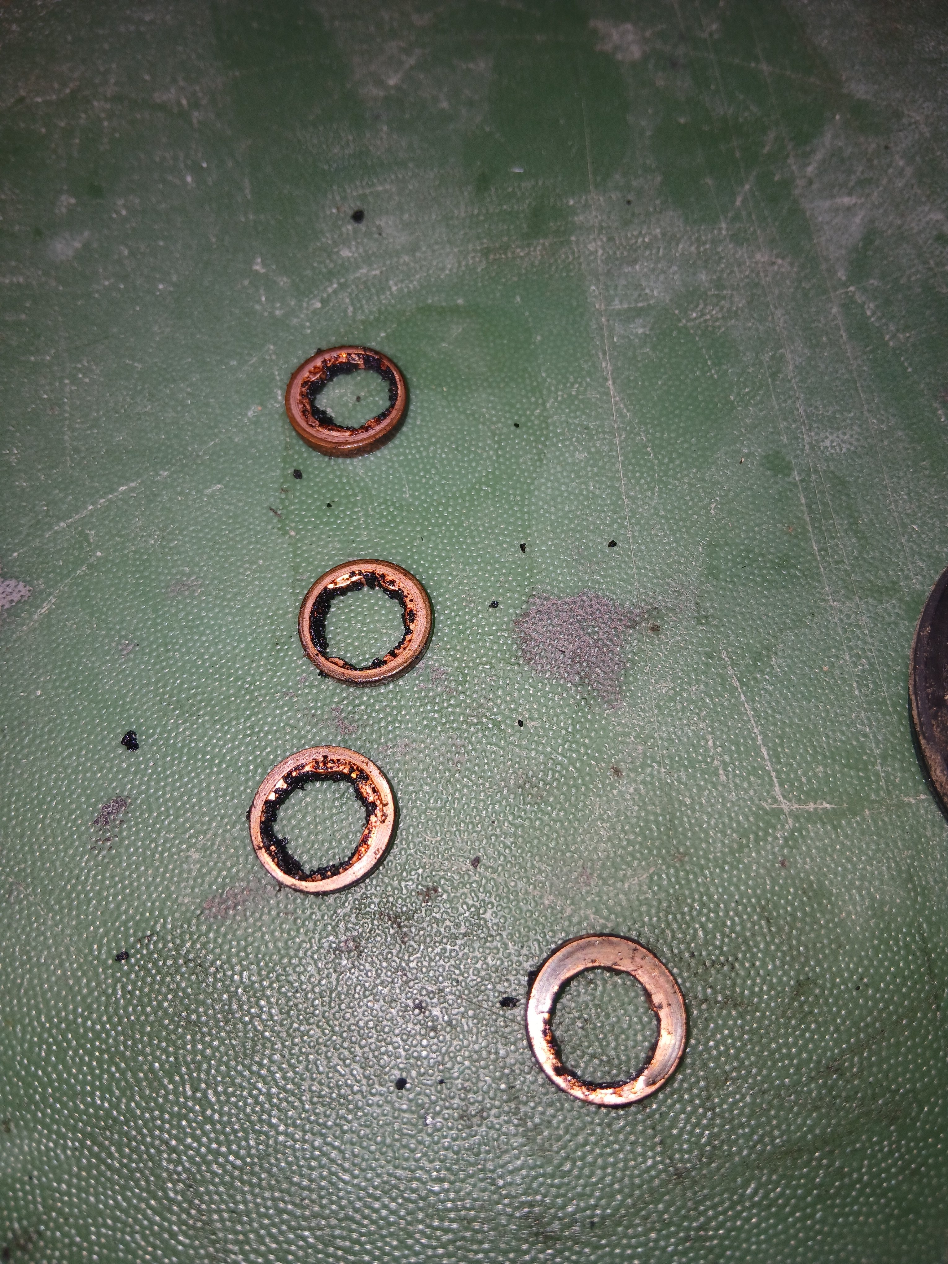

Injector seals done, went pretty poorly, you'll see why.
Injectors 3 and 4 came out fine, no trouble at all.
Slightly grubby but dont look too bad.
Injector 2 and namely one were seized in.
Took ages of prising, spraying penetrant etc to try free them, after hours and hours, they did come free. However,
Pretty bad looking.
The hole for number one was as bad.
The rest werent horrible.

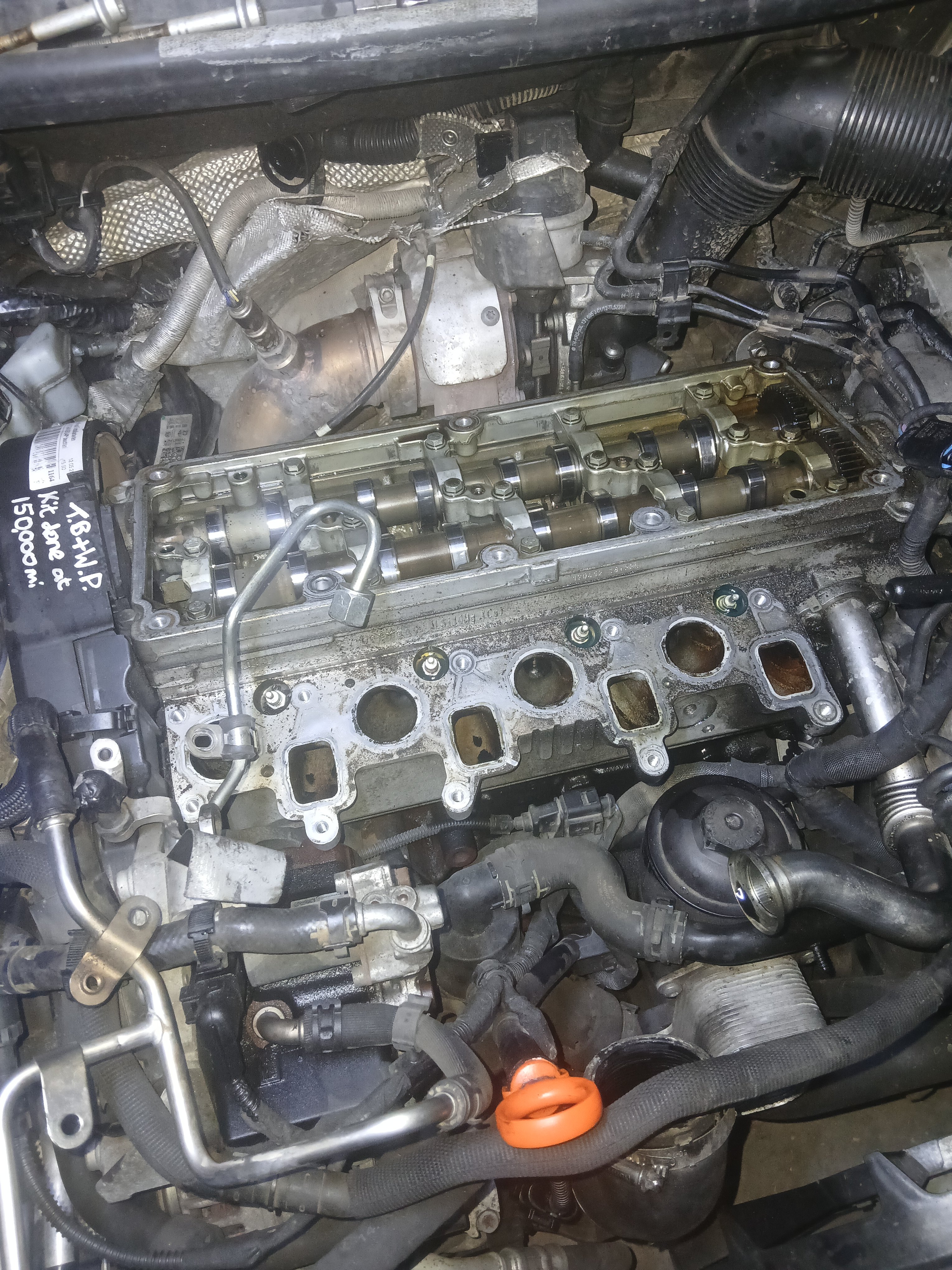

Ended up pulling the rocker and intake manifold.
Aside from the hole, the cambox looks really fresh, for almost 180k now its really very clean.
Same for the intake, very little sludge built up.
Did clean up what i could, not that it really needed it.
Suspected intake seals were leaking so got new seals for it.
Copper washers were well used.
Got an injector bore cleaning kit to make life easier.
