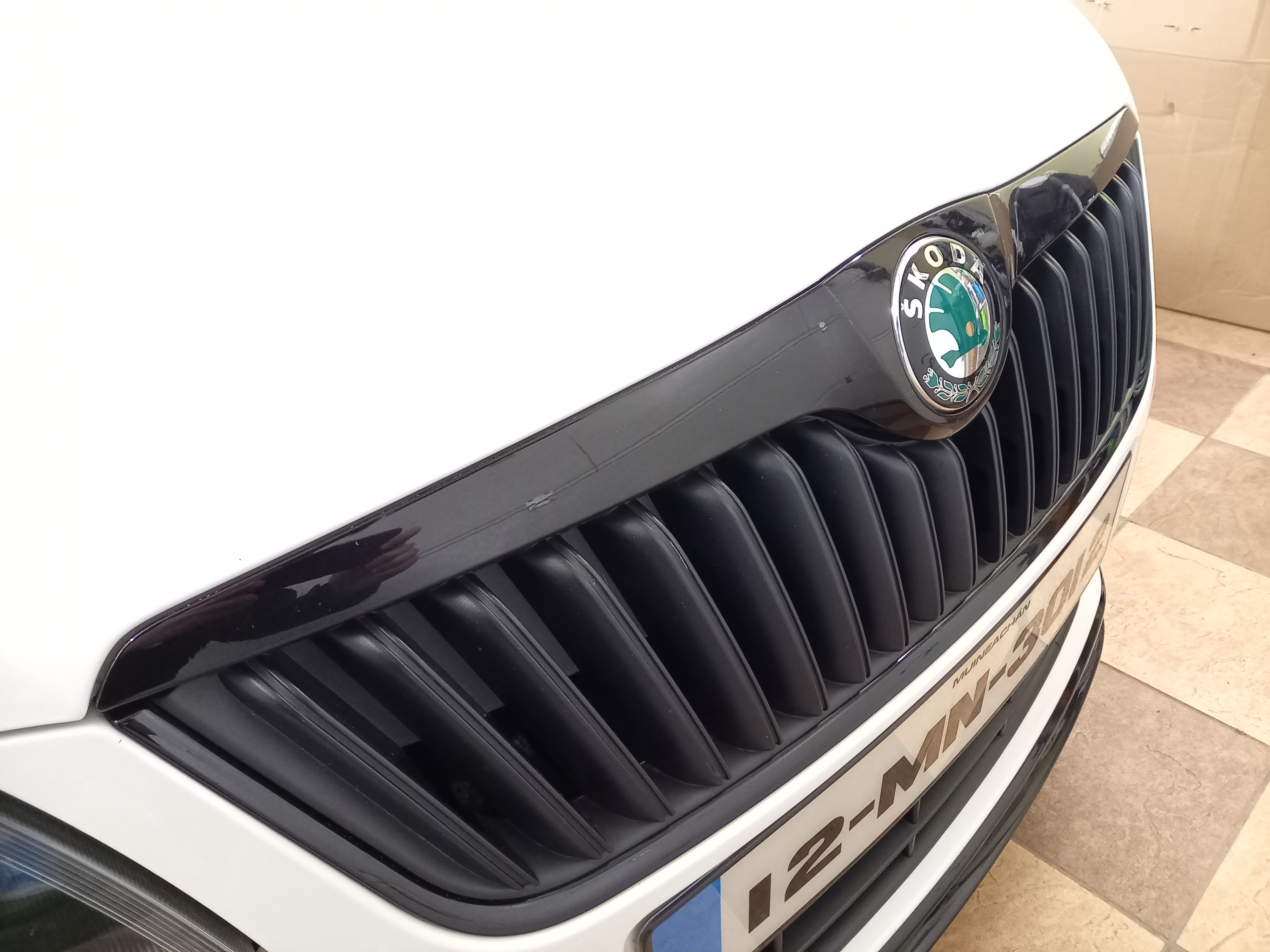

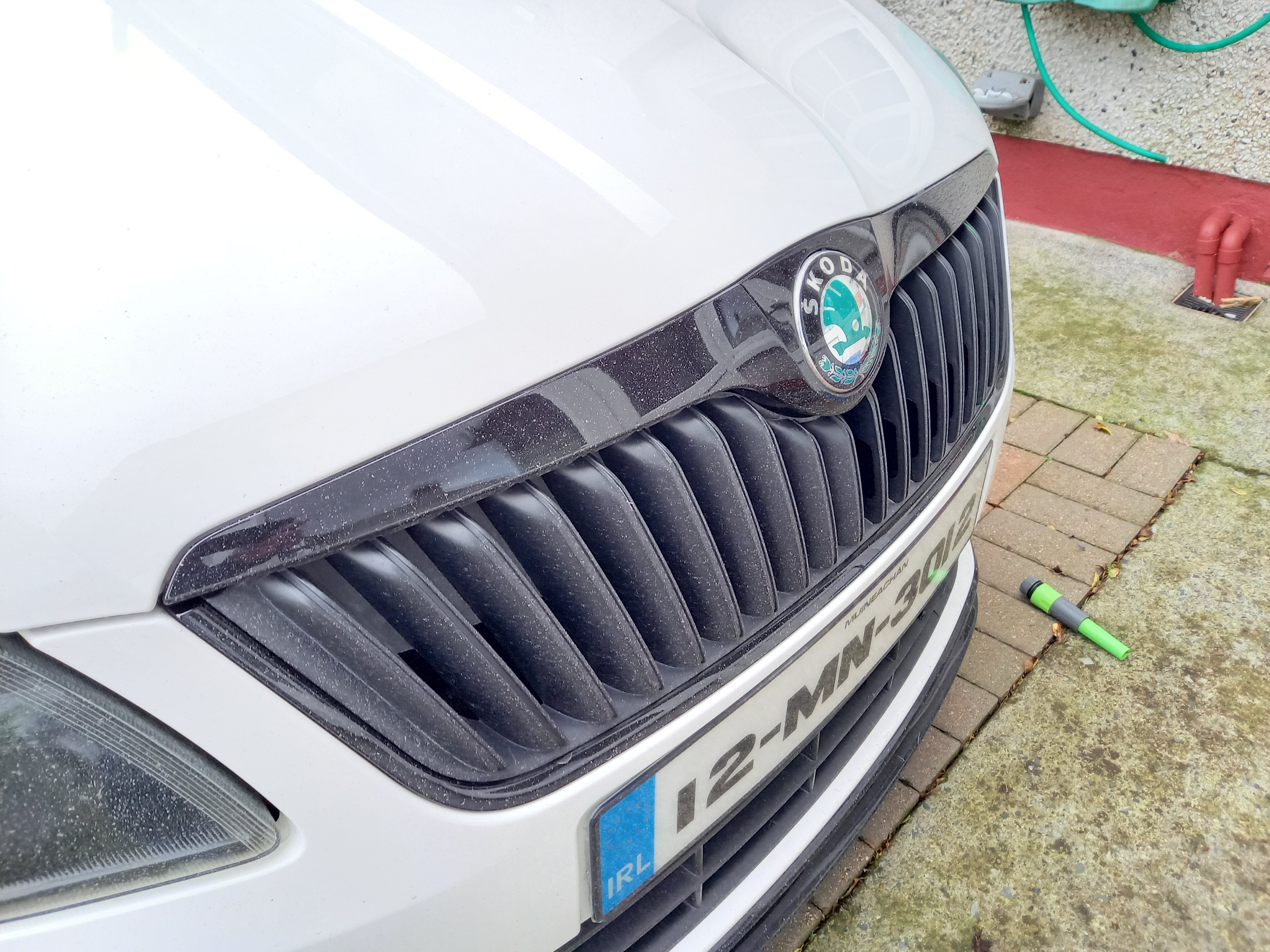

Got some stripes for the grille in the post today. Only cost me a few pound on amazon and I think it looks quite smart.
That looks very very well.. ! Simple but effective detail ! :thumbup:

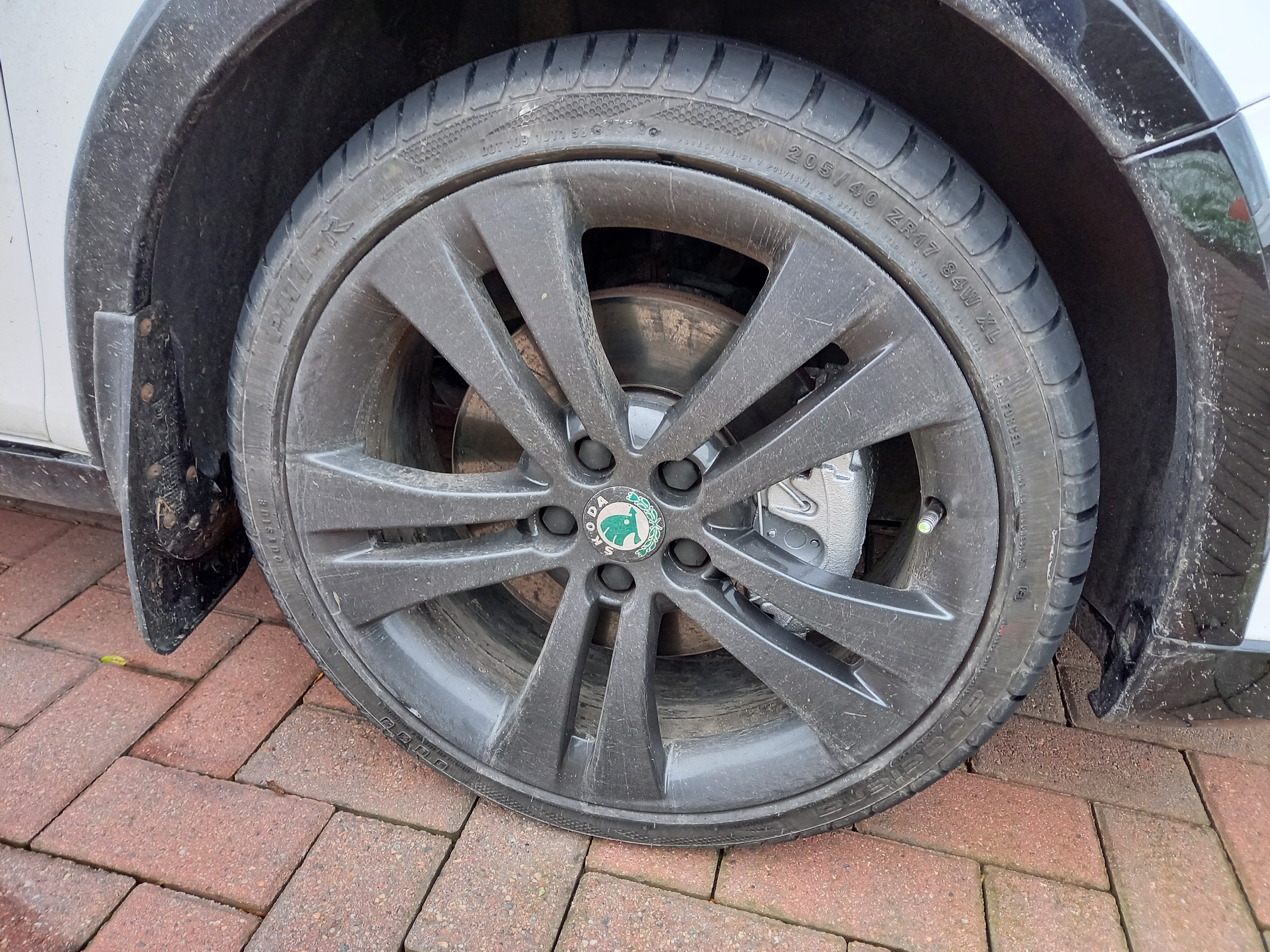

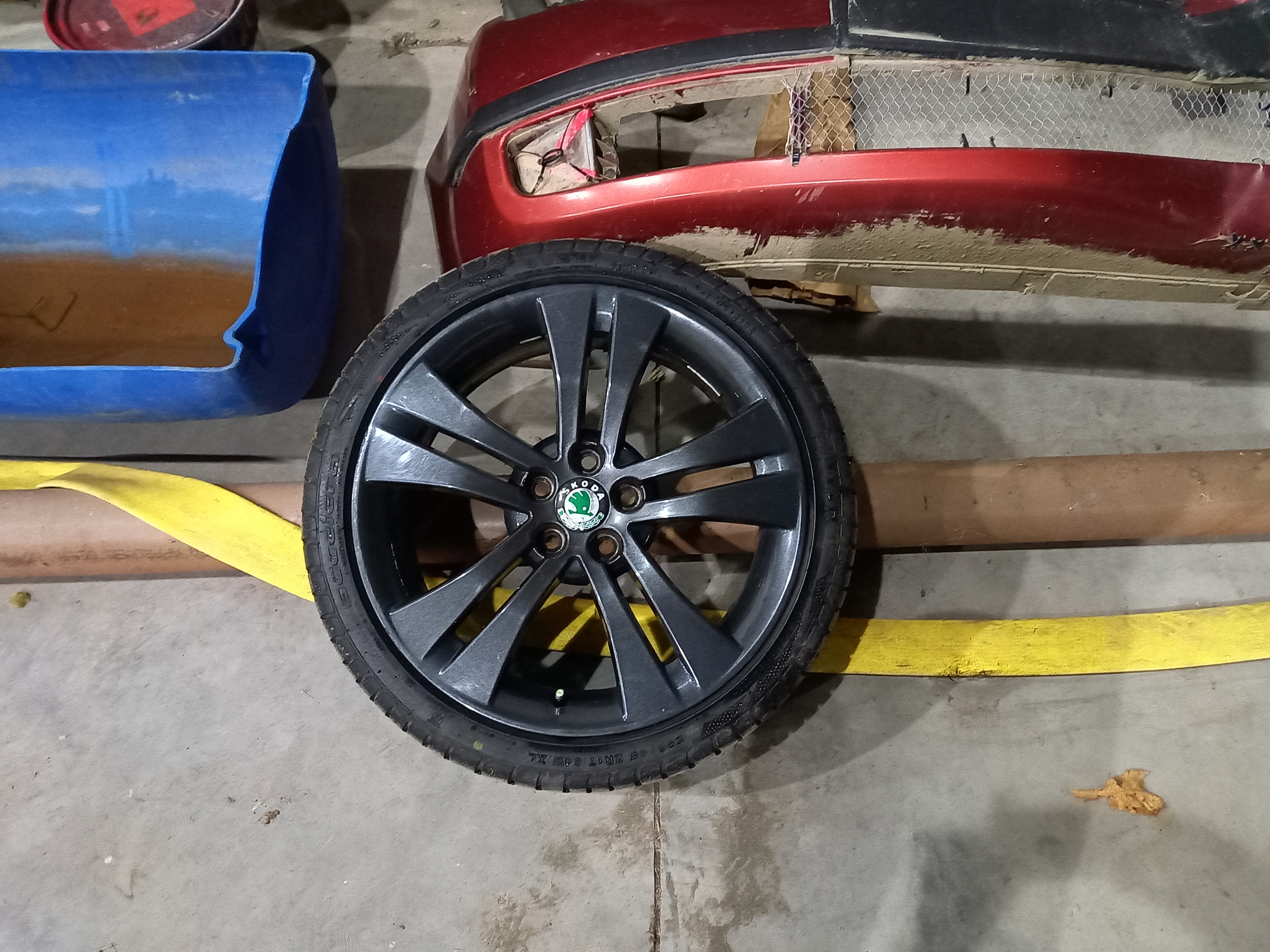

I had one of the vRS wheels off of my mk1 fabia and wanted to see how it would look on this. Honestly not bad. Might need to get some tires on them and use them for the next month or so, The frost has taken chunks out of every road and it'd be nice to have some extra rubber to soak up the bumps.

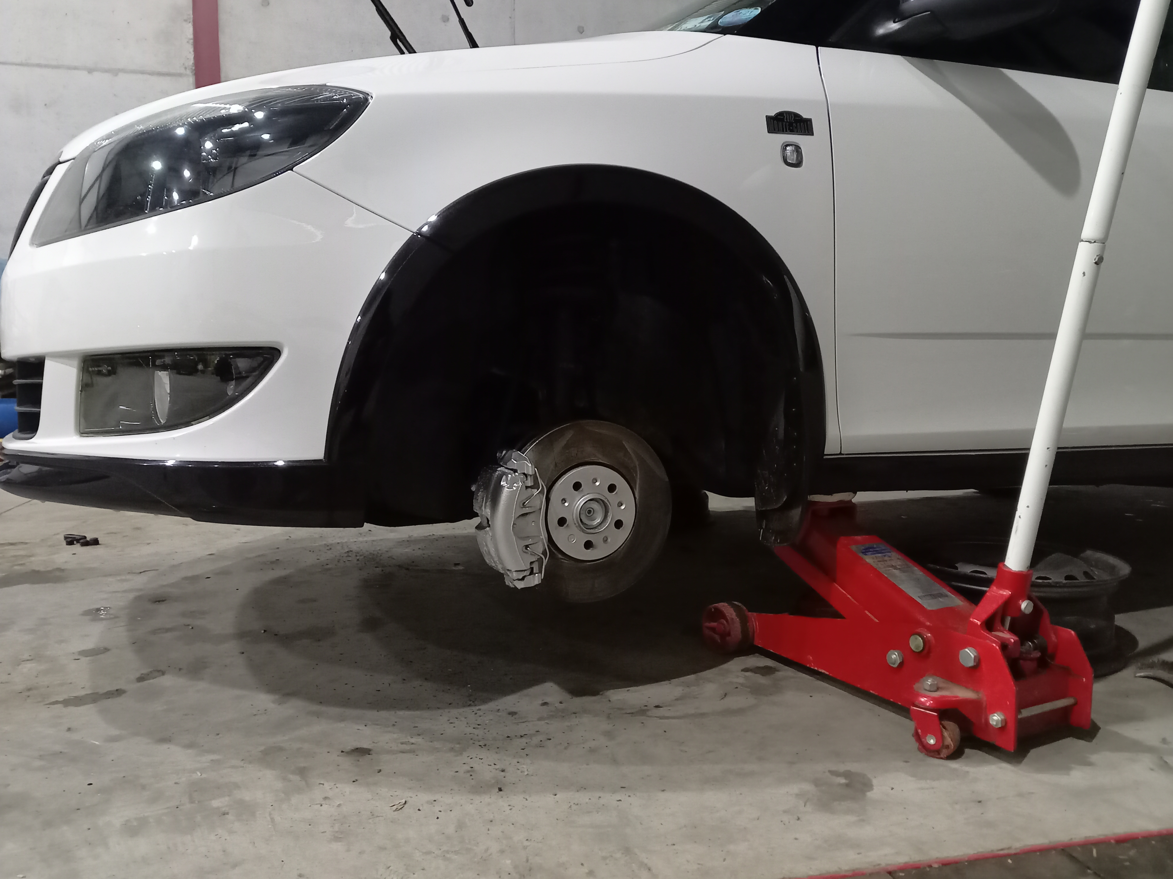

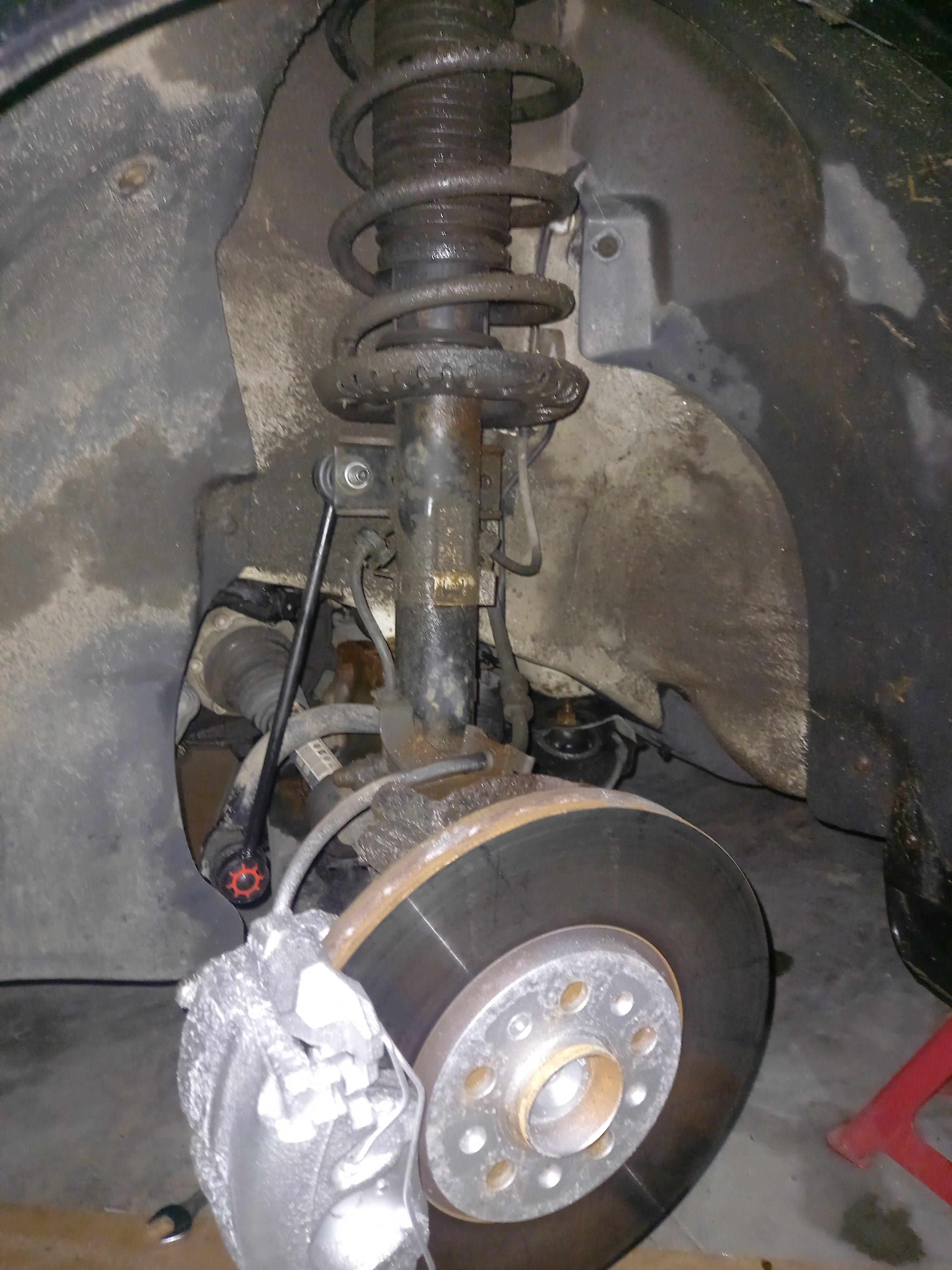

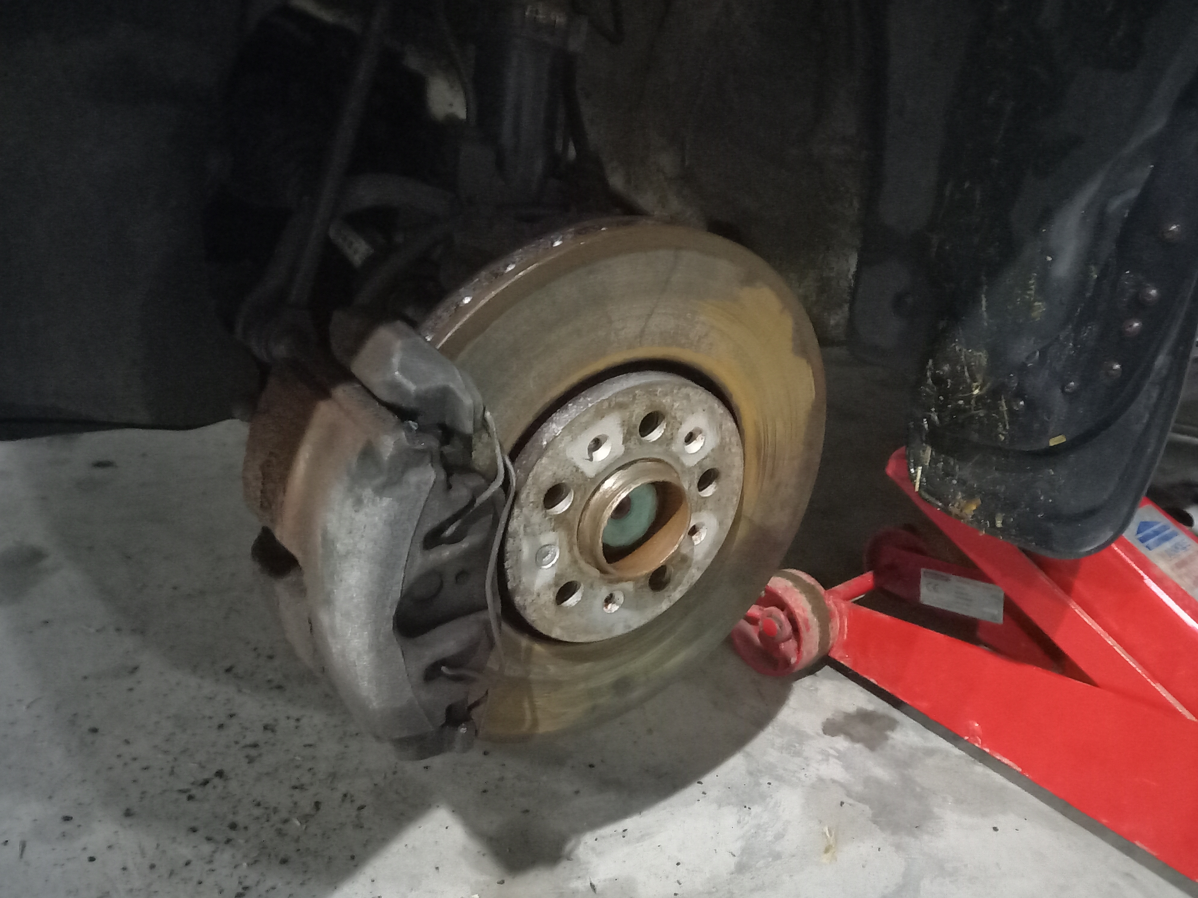

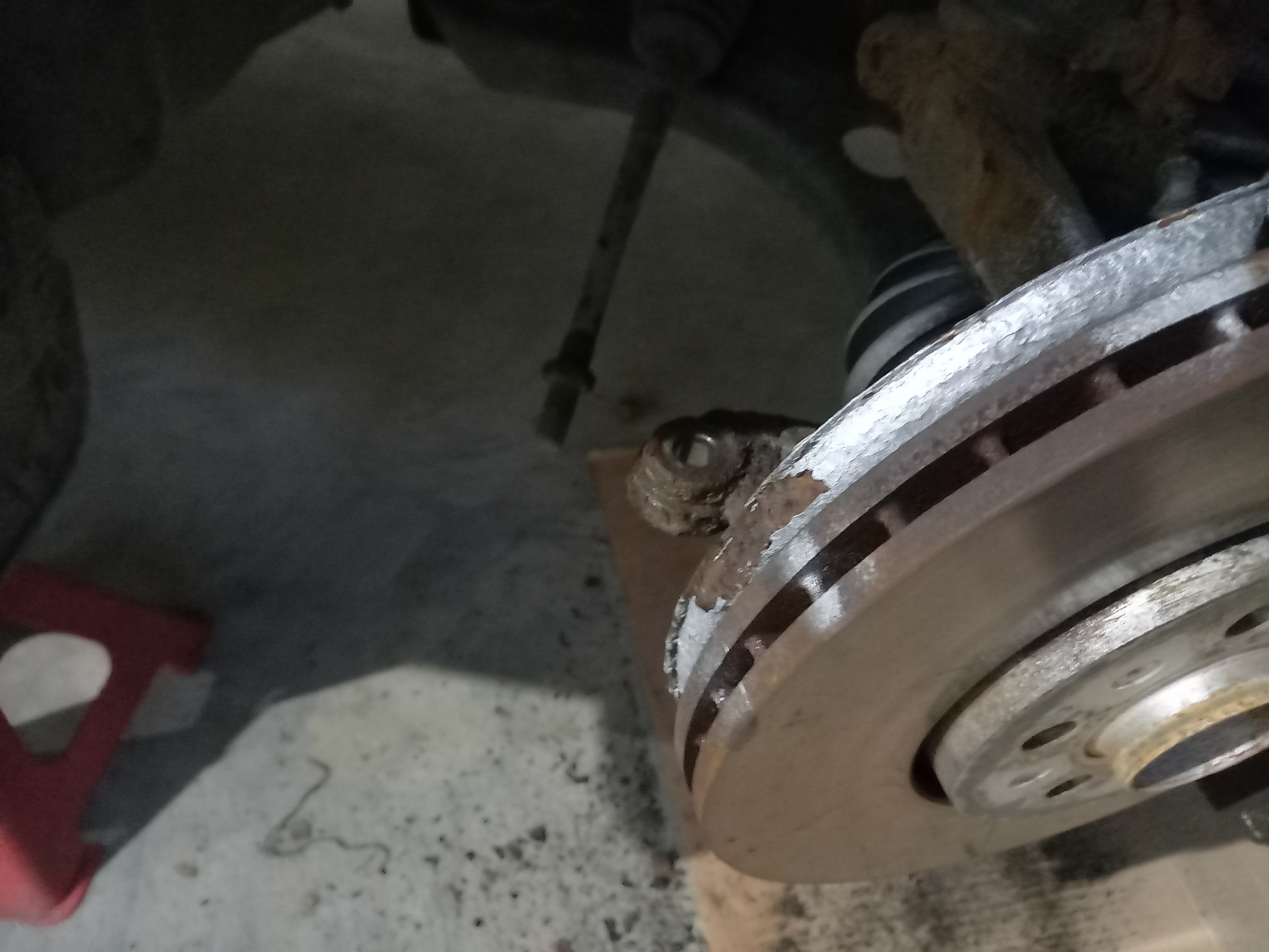

Had the front wheels off today to check the tie rod ends. They certainly look bad but I couldnt feel much wrong with them. I'll keep them in mind to replace sooner rather than later though. Anti roll bar D bushes looked ok, drop links I'll probably replace because they seem past their best. Also, when I was under there I noticed that the springs look to be done not long before I got the car, I can still see the coloured dots on them. I noticed the rears were like new when I was under there doing the Whiteline also.

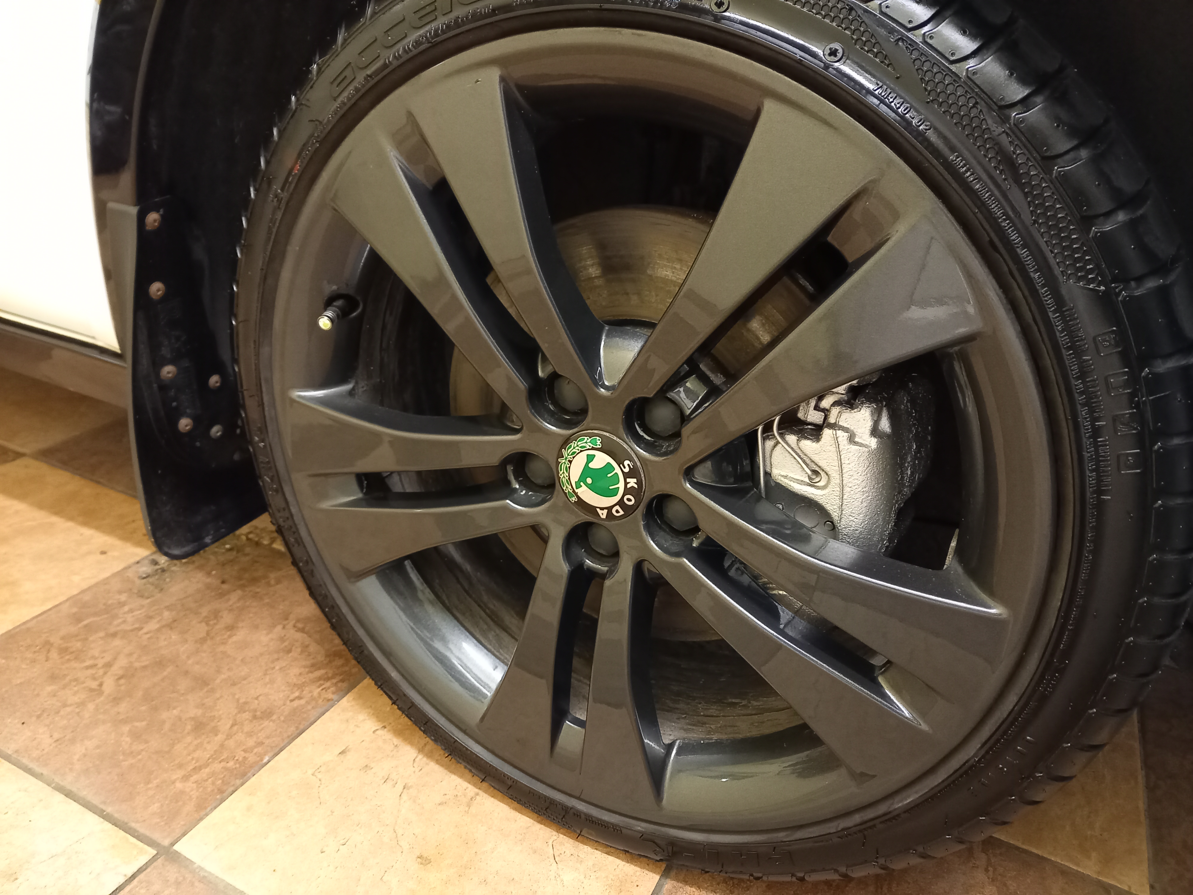

Since I had the wheels off I gave the calipers and hubs a very quick spray of VHT silver. I wire brushed then sanded the hubs and calipers, sprayed them off with compressed air and sprayed them silver. It was a very quick job and I did it mainly to prevent the wheels from welding themselves to the hubs. Its a good thing I did because I could see rusty sludge forming on the hub, made sure to sand the hub smooth. The brakes are rusty because it was sitting straight after being washed. I didnt mask anything though, I just sprayed the paint on and got some petrol on a rag to clean off the disc. Brakes painted wheels back on. Drove the car around to scrub the discs off, first stop was sketchy but it was fine after that. On an unrelated note, I'm impressed with how well the wheels have held up. As far as i'm aware these are the original wheels and were never powdercoated or anything other than a bit of touch up paint here and there. Might try and see if I can use the polisher and make them really pop. In fairness that picture was not taken in the most flattering light but my point still stands.

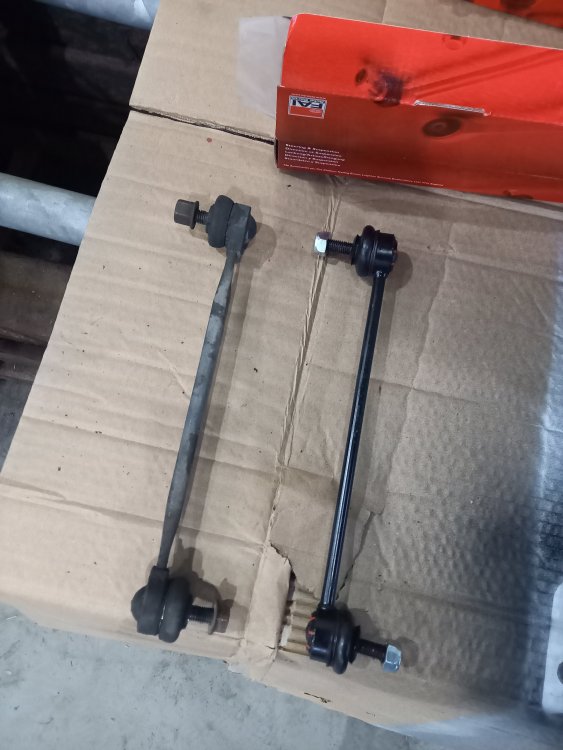

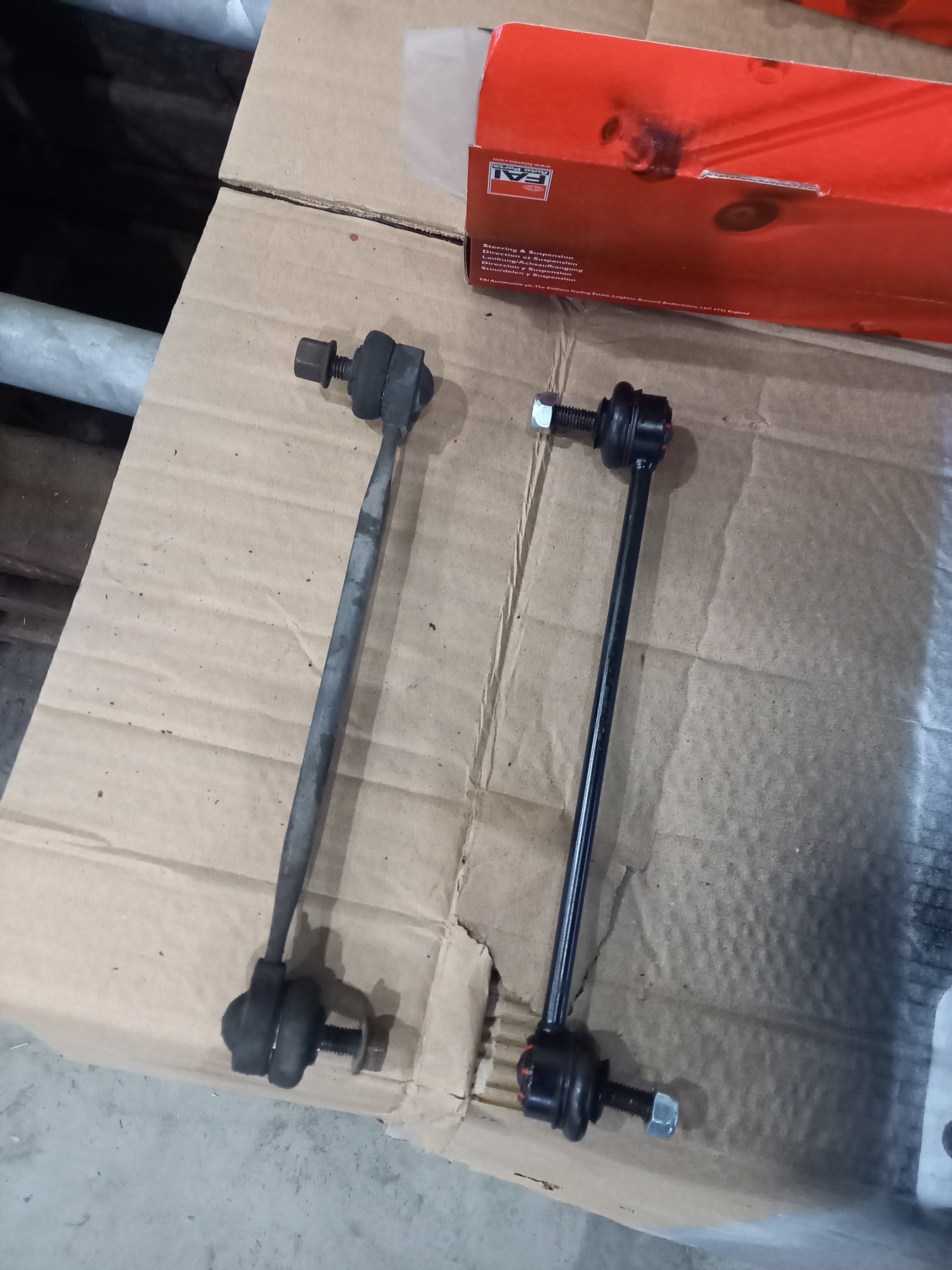

Wheels up again today, decided to price out a set of drop links at the motor factors. It was 36 euro for the pair so I got them. They are made by FIA, not familiar with the brand but the look and feel to be decent. Took out the old ones and didnt realise how loose they were in comparison to the new ones. Not much of a job to install them but I dropped the plastic cladding under the engine for easier access to get a torx bit into the bottom tie rod ball joint. Newer ones are a stronger design by the looks of them, they look to be a solid piece in the middle instead of the weird design of the standard ones. I would hope that these arent 94000 miles old, they certainly werent done recently. Finished the job and went for a test run. About town its noticably quieter and much more stable over the numerous potholes in town. Took it out on some backroads, the difference was night and day. Its now much more stable on these rough roads, has made a noticable improvement in feedback and the whole car feels tighter when cornering. Combined with the whiteline the car has been massively improved. It still has a touch of the clunk when its stationary, its faint now but still there. Should probably do the tie rod ends when I can, feels fine to drive though, just has the clunk.
I think that the wheel looks good in dark grey, I spoke to a bloke about re furbishing my Fabia wheels last year but on hold at the moment, might try to refurb them myself although I cant stove enamel them.

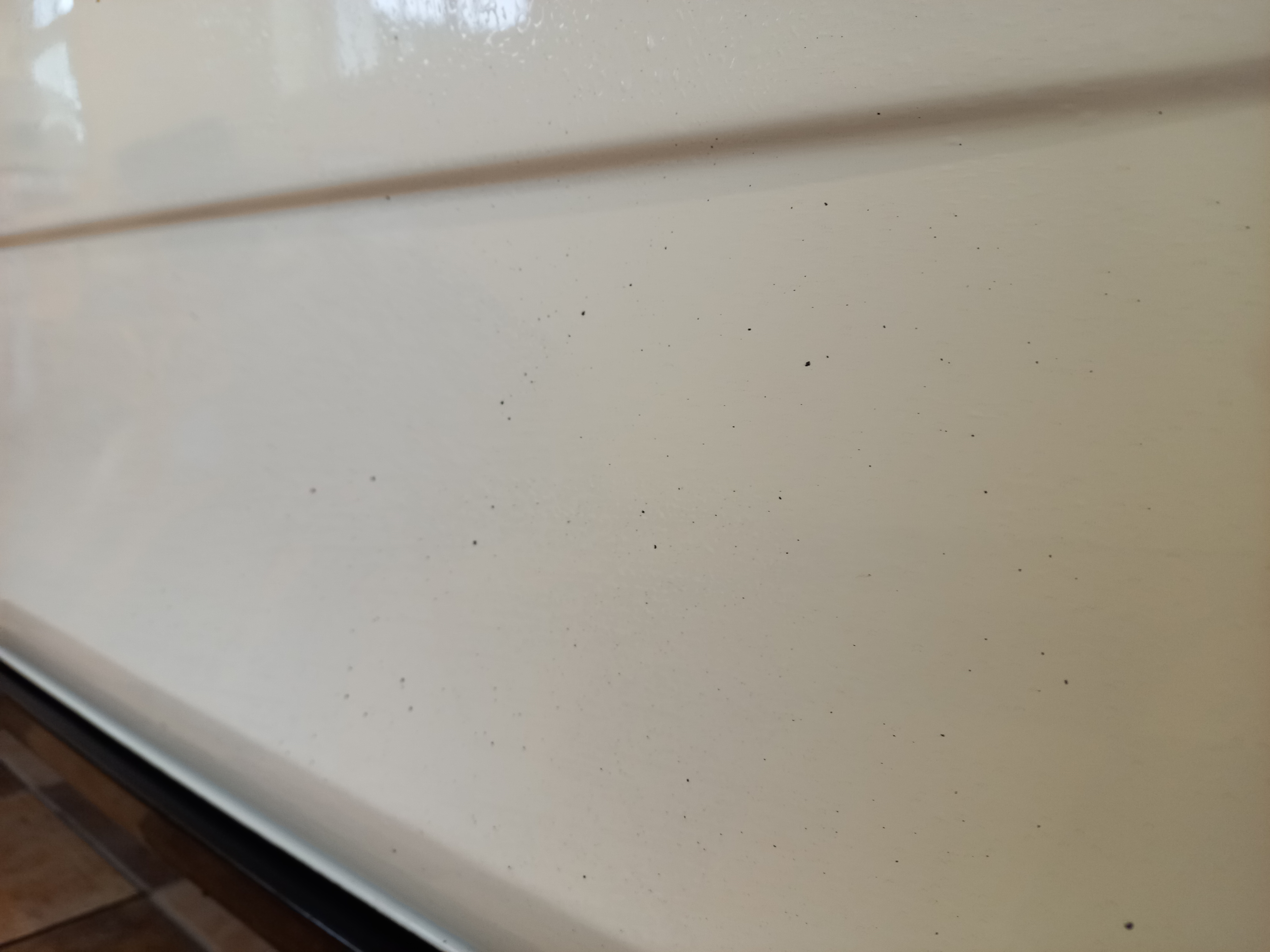

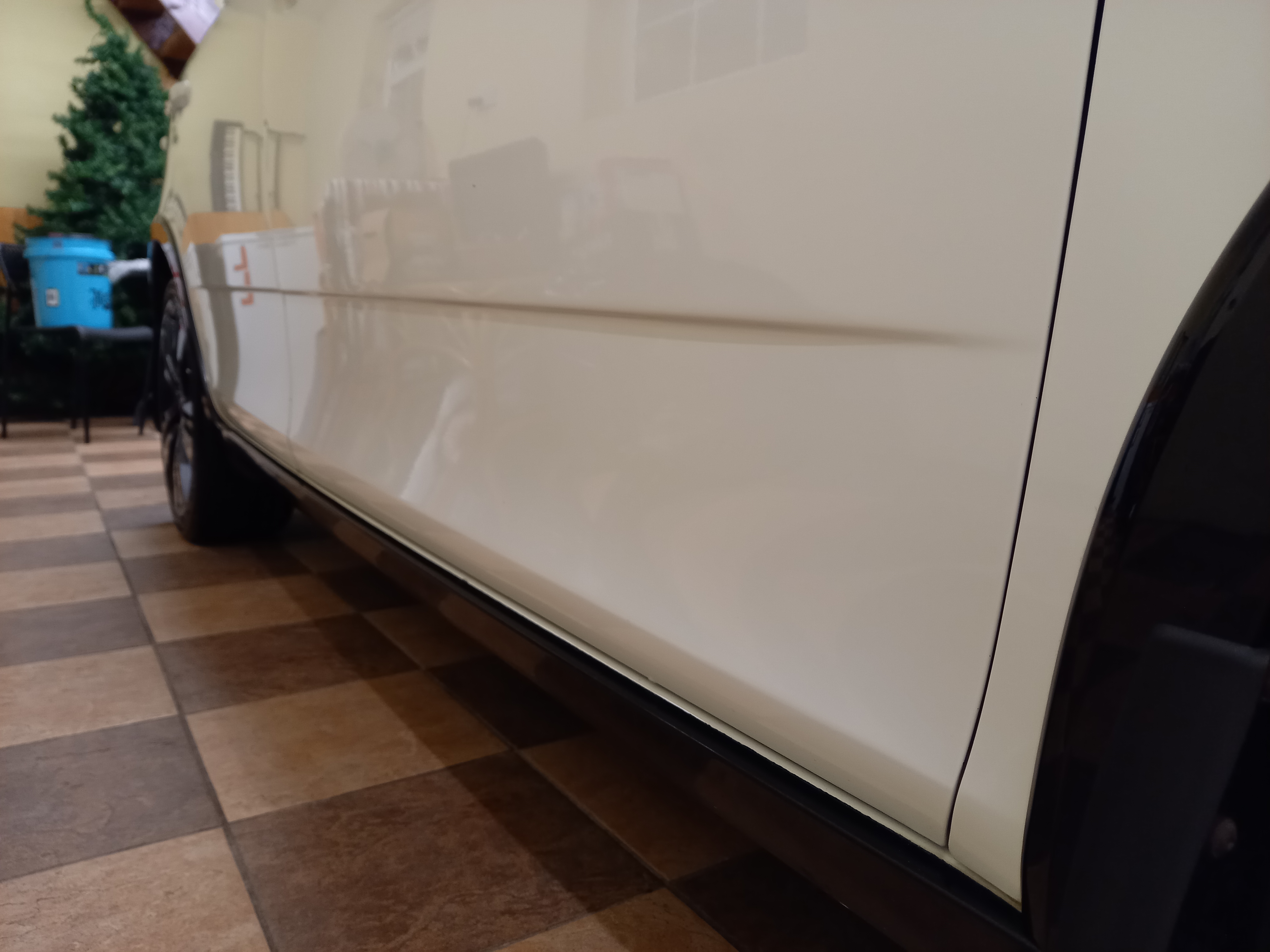

Gave the car a good detail over the past few days. Claybarred first, then took two passes with Meguiars ultimate compound. One with a wool pad and one with a foam pad. Then I moved on to Ultimate Polish, covered that with poorboys world white diamond glaze and black hole glaze for the roof and trim. Lastly, I used up the last dregs of Ultimate liquid wax I've had for a while and done about 8 cars with. After I did the body, I moved onto the interior. I've kept on top of the interior and had given it a good clean about a month ago so it was mostly just using apc to clean the plastics and giving everything a good hoover. I had to clean the glass again as I put stuff on the trim to dress it up and it appears to have just off gassed and stuck to all of the glass, leaving a greasy film on it. It was easy to clean off but I'd rather have not needed to do it again so soon. Overall, the car's gone from looking great to looking pristine and hopefully it should stay that way for a long while.
Pictures don't really do it justice, The lower part of the car was chock full of tar and fallout. Lastly, I gave the wheels a quick rub with black hole glaze, they look to have a better shine to them but I doubt it'll last too long.

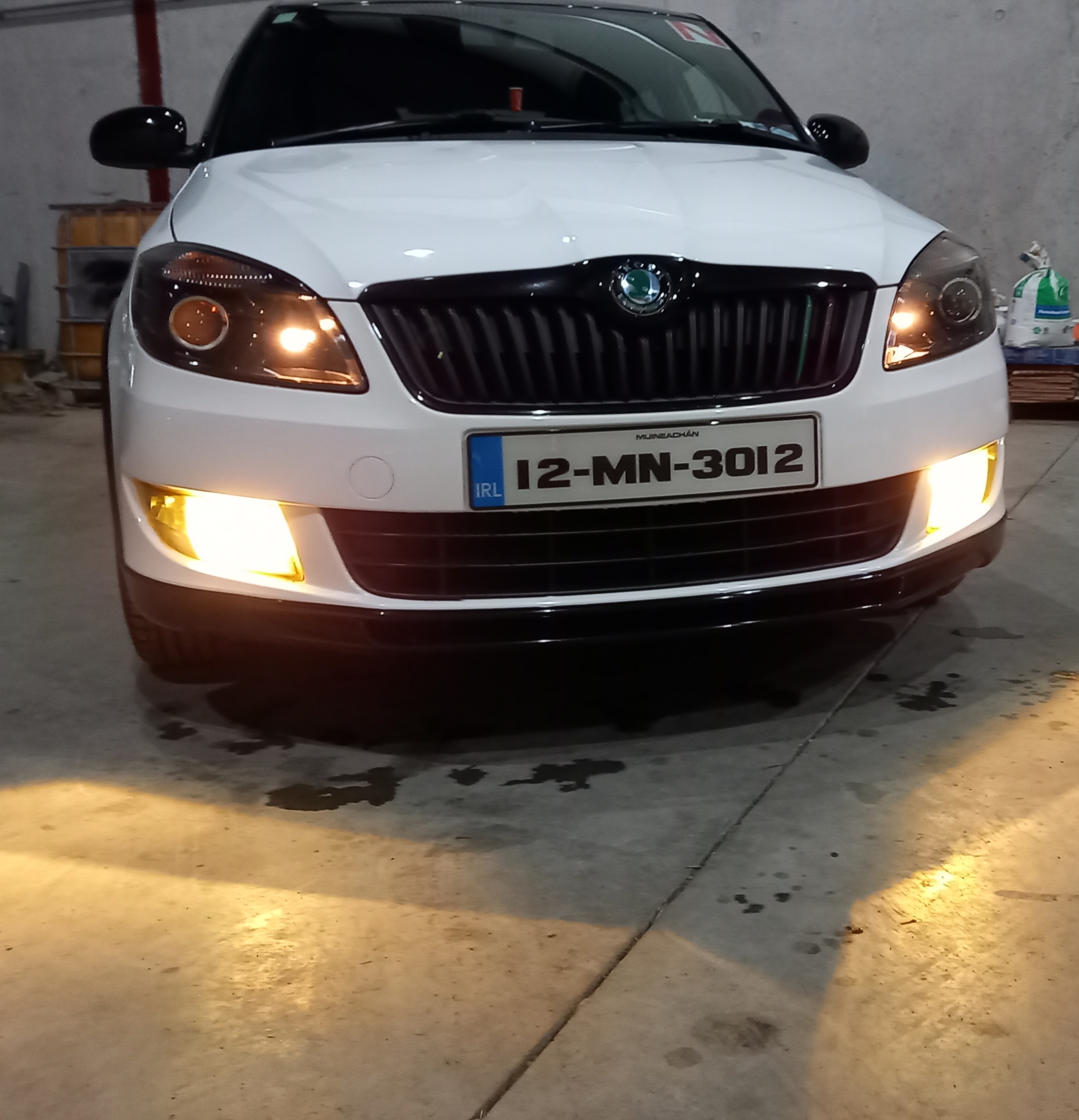

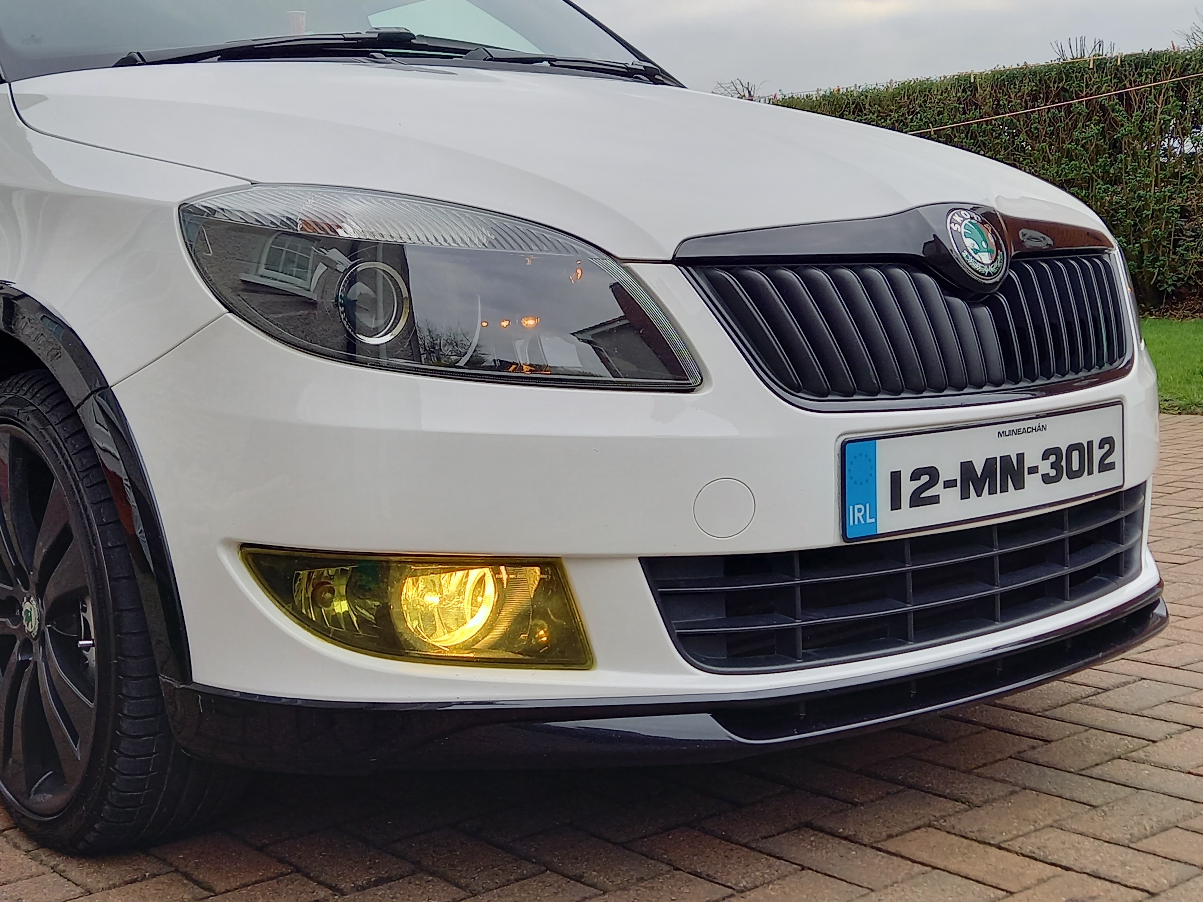

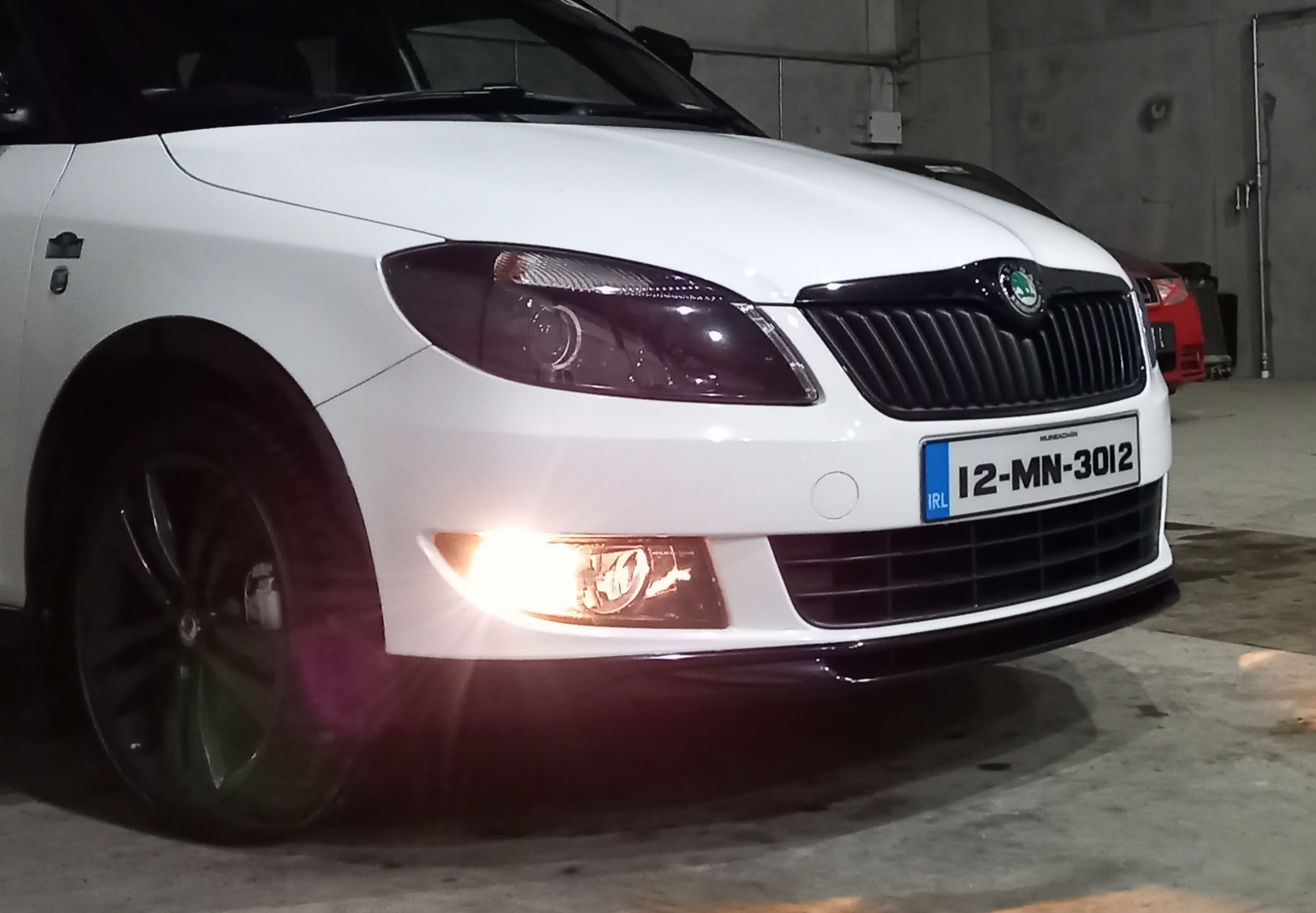

Got some foglight tint on ebay for cheap.
https://www.ebay.co.uk/itm/262621985443

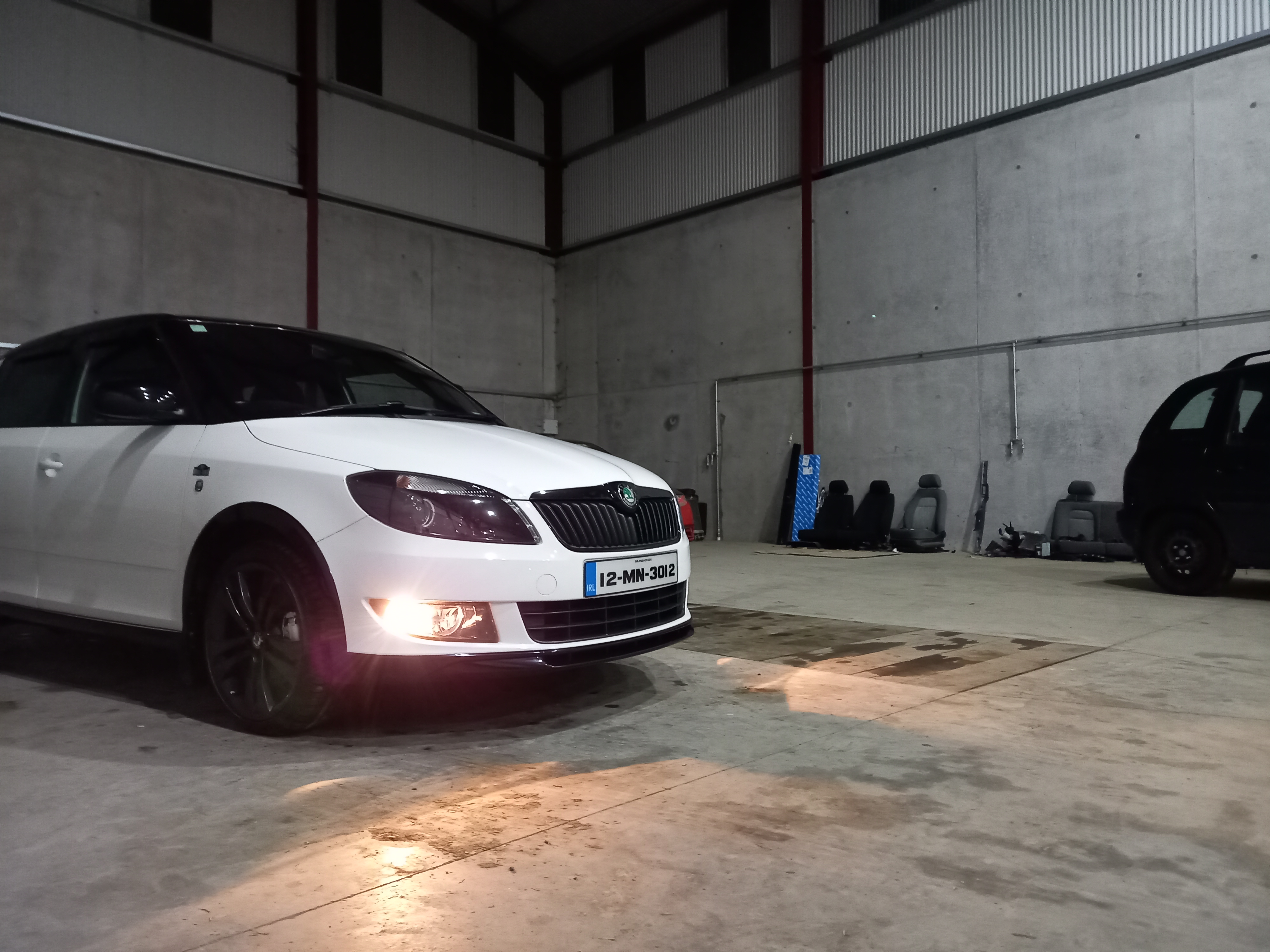

Arrived pretty fast so I washed the car and put them on. In hindsight I shouldve tried to tint the foglights on my mk1 first. The big wide foglight housings on this car made it a massive pain in the ass to do. I kept creasing it just under the DRL bulb because of the curve in it. So I learned to start from there and it came out perfect on the other foglamp. Its easiest to take out the foglamps on this, its a matter of a few clips and 10 seconds of work per side. It came out kind of crap at first on the drivers side but the passengers side is damn near perfect. Some pics of the before and after. I think it looks good. Some of the imperfections on the drivers side arent as obvious now, I always use the foglights so I imagine the heat from them helped stick the tint better. The good thing about getting a roll of tint is that I have enough left over to do my mk1. I even was able to use the excess from tinting these foglights to tint another set on another car, 3 cars in total and I would've had enough to do 1 or 2 more except that I wasted some figuring out how to do it. Overall, I'm happy with the results. I use the foglights always when driving to help spot hazards (namely potholes) and I could swear that the yellow contrasts against the potholes better than the standard white beam. I imagine the yellow beam is a bit less harsh on oncoming drivers too so its a win for everyone.
That's another good bang for buck mod 👍
The French had yellow fog lights for a time and I recall people covering their lights with that yellow wrapping from a Lucozade bottle - Showing my age now :o

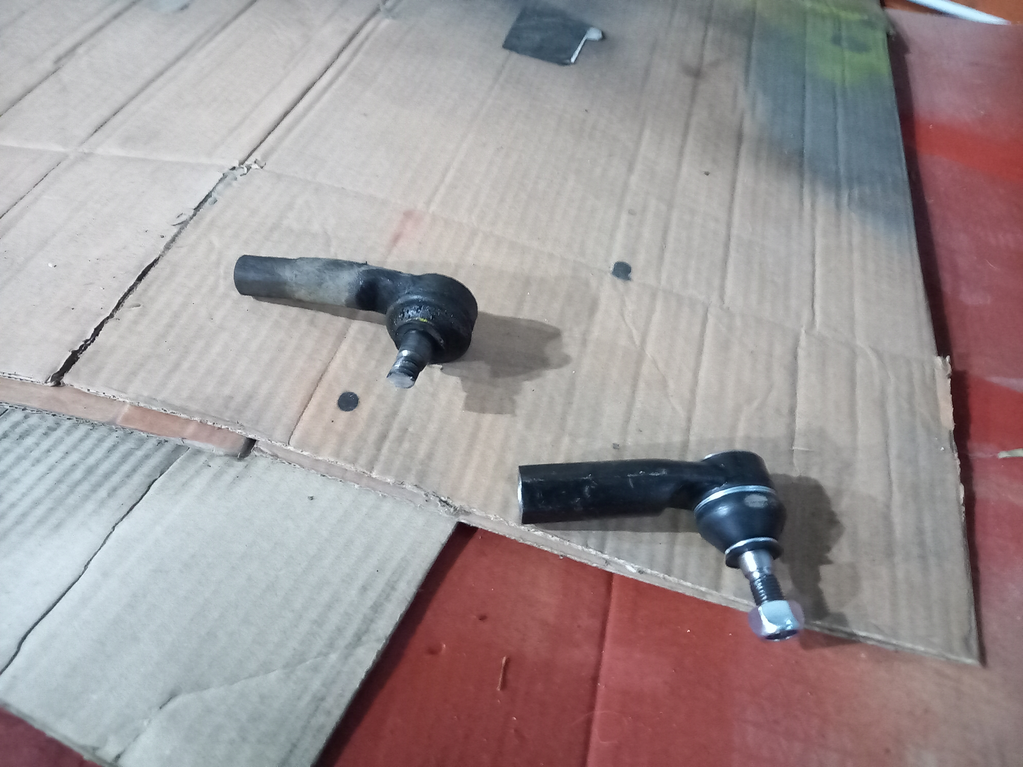

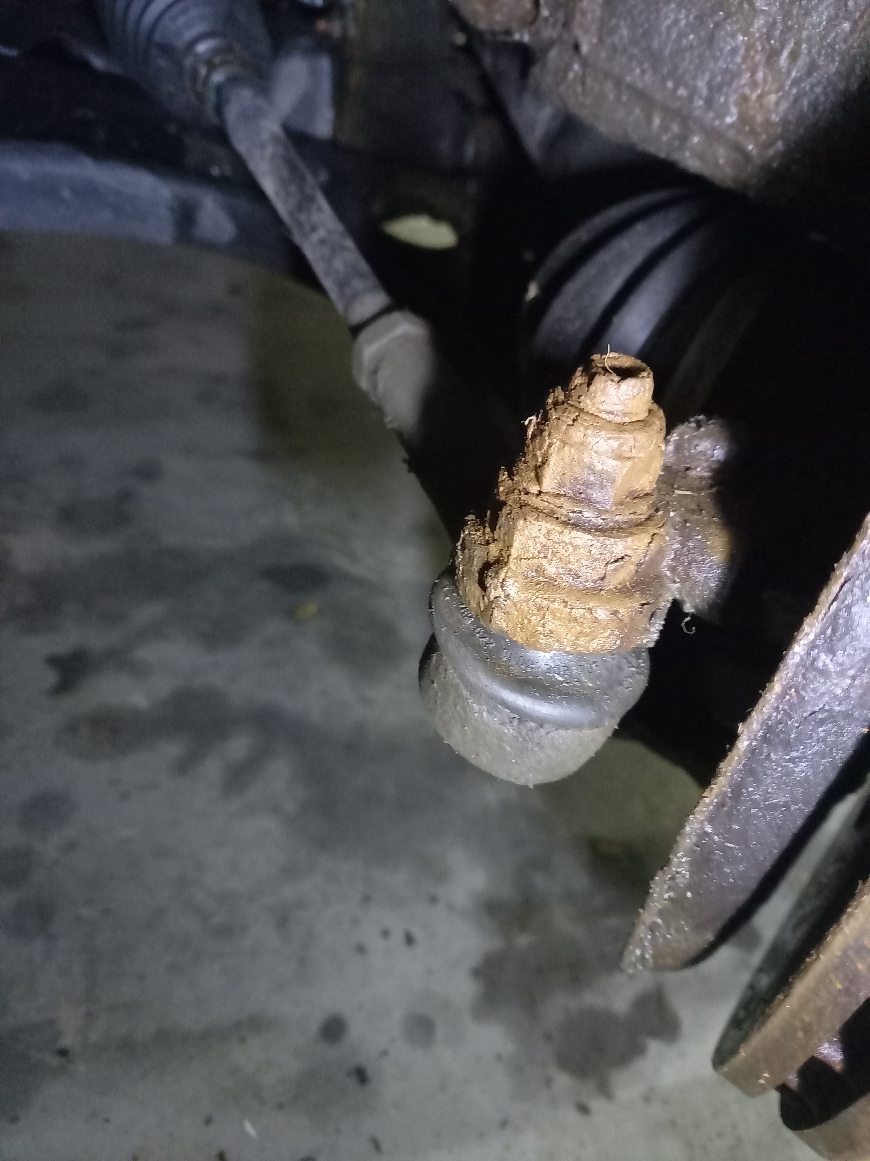

Track rod ends done today.
Got firstline ones 26 euro for the set at the local motorfactors. They certainly seem to be decently made bits and for the price they seem very good quality. Fitted them relatively easily, only trouble stemmed from having to resort to using a sledgehammer to free them from the hub. I got it aligned close enough to drive home and its honestly near perfect as is, will still get it aligned first thing tomorrow.
The clunk I felt is still there it seems to be stemming from the Top mounts so i'll tighten them when I can. I needed to do the Track rod ends anyway, the standard ones were wrecked, inners seem ok though.

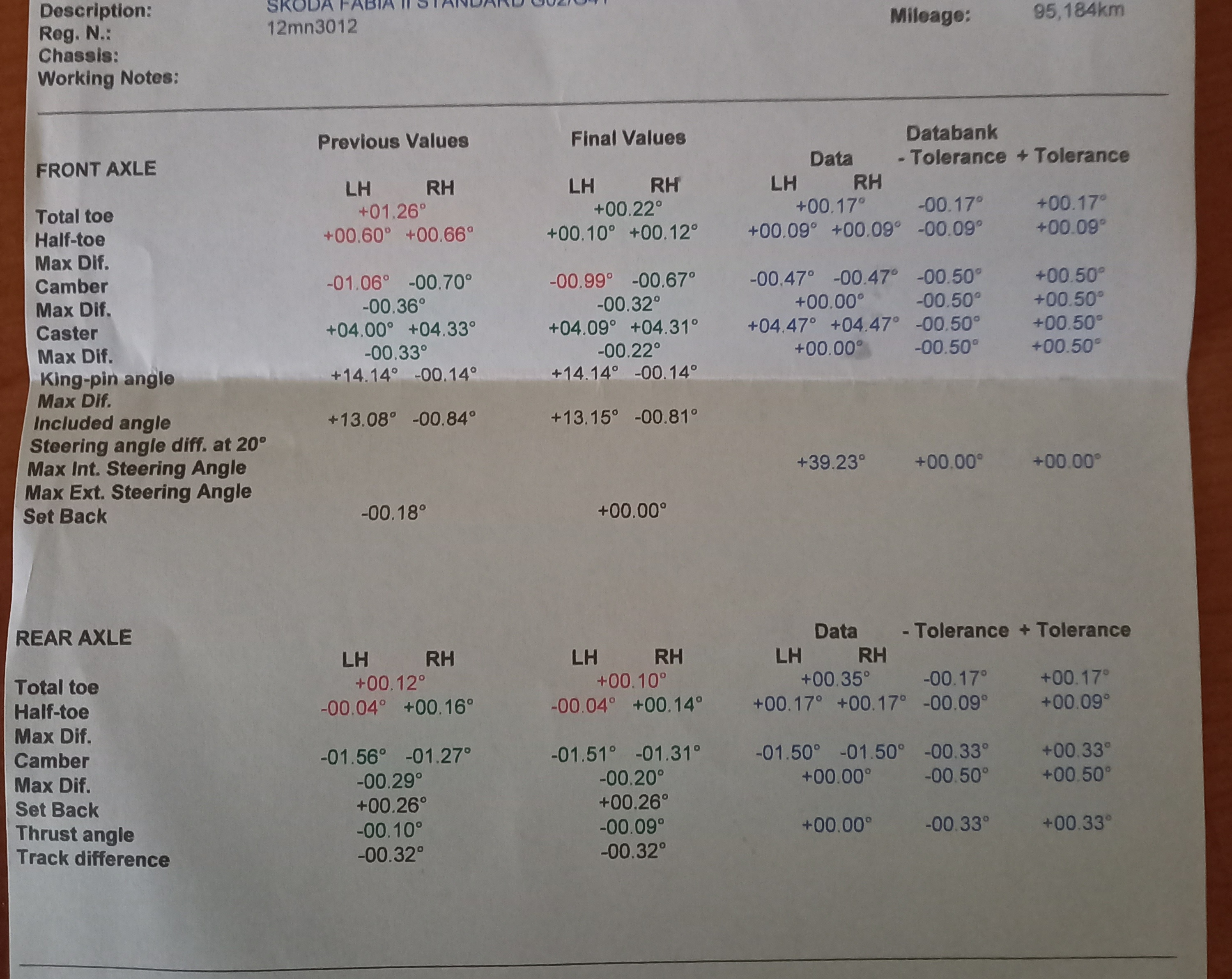

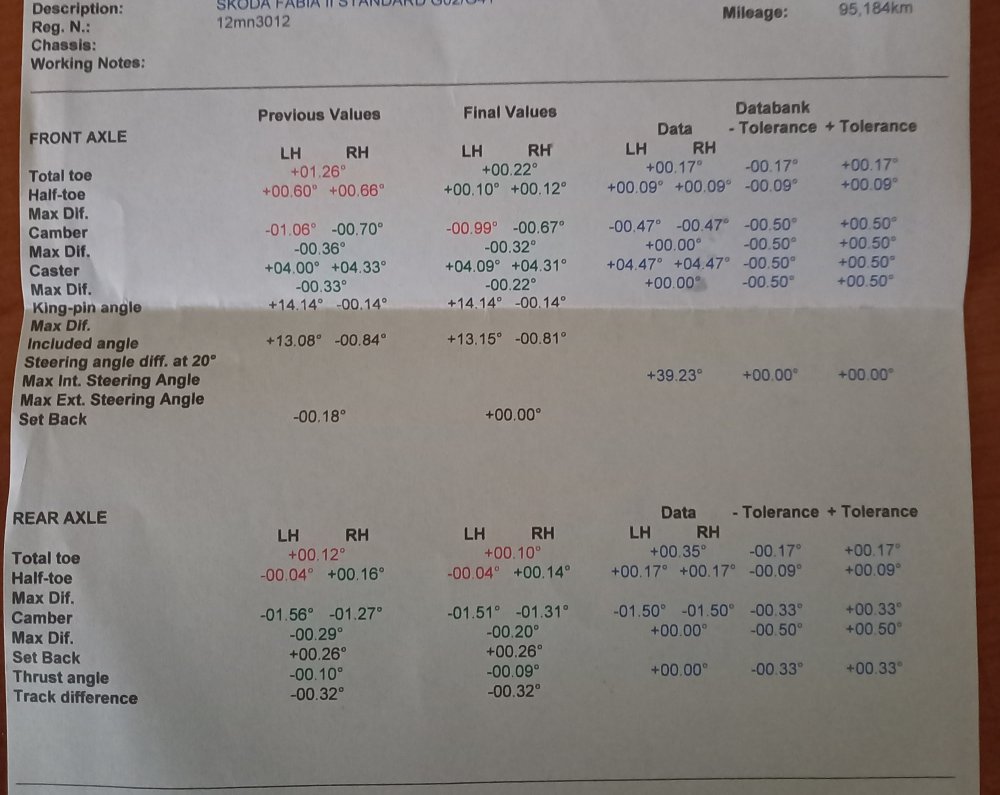

Thought I'd upload the alignment sheet. Car drives straight as with the wheel straight now. It would seem that I infact did have the toe adjustment set decently. Now its set 100 percent properly so hopefully I wont have to worry about it for a while. Camber is slightly higher on the passengers side, seemingly the bushes being worn out is the cause. I think the wishbones are going to be next.

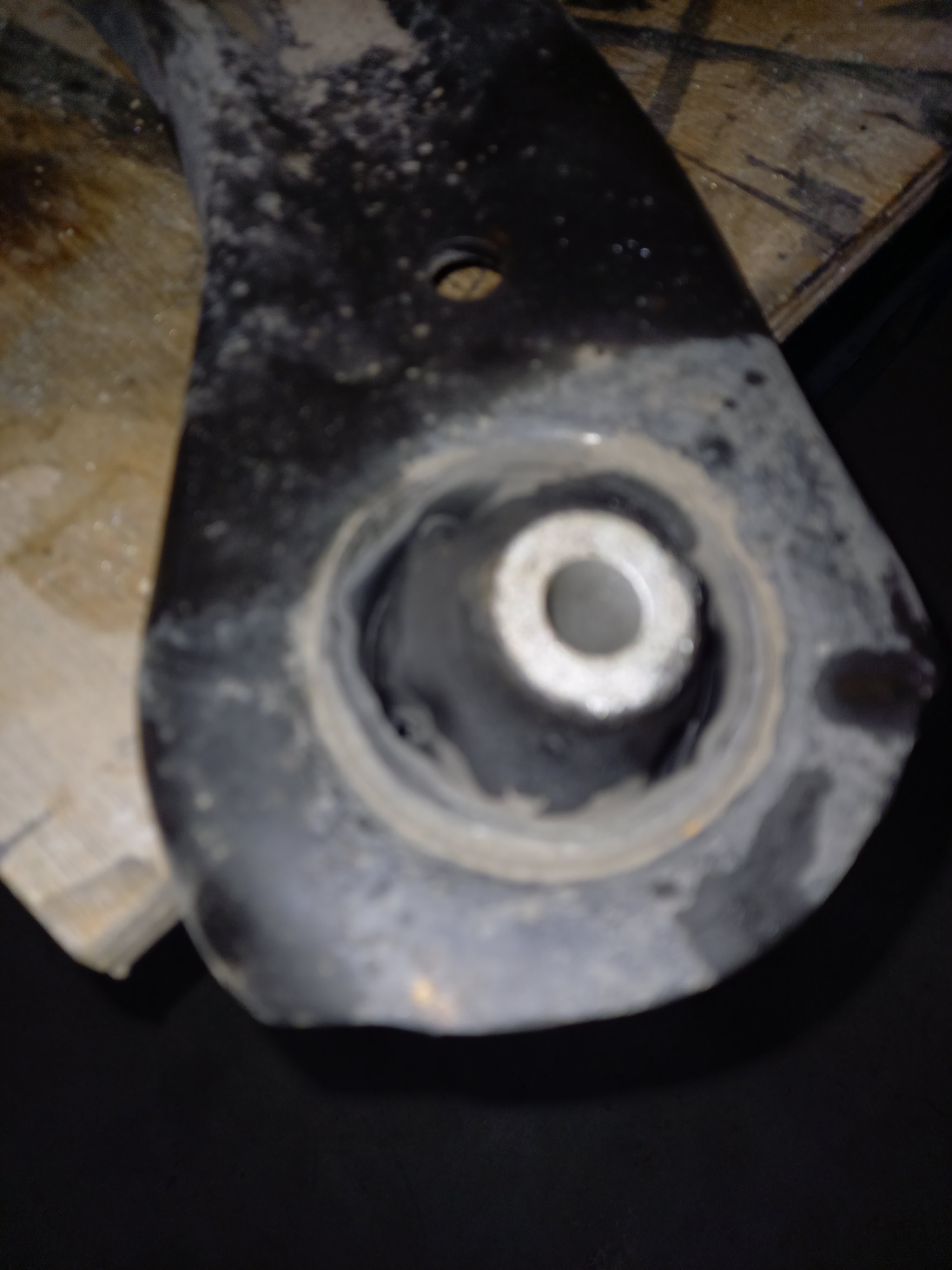

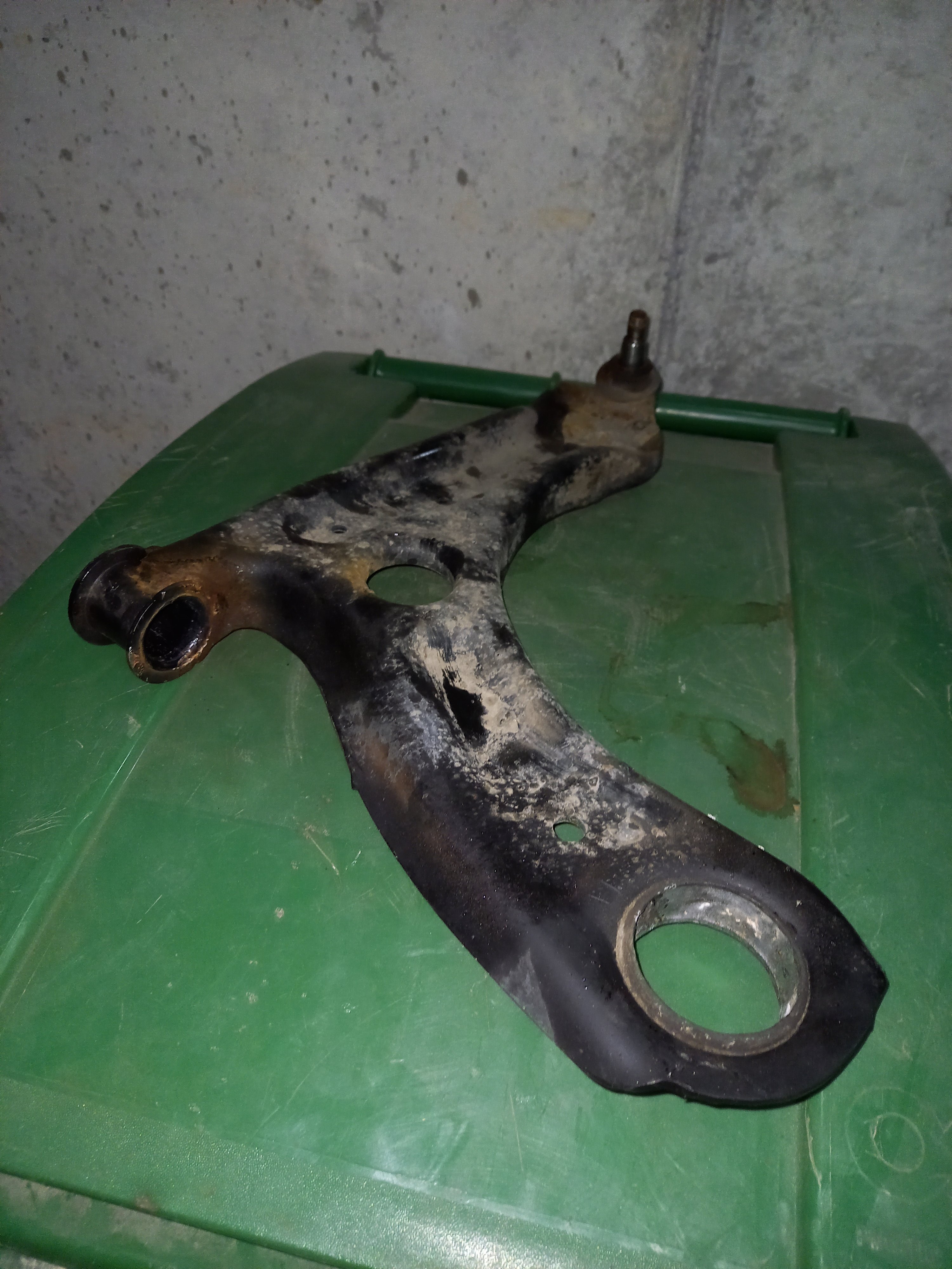

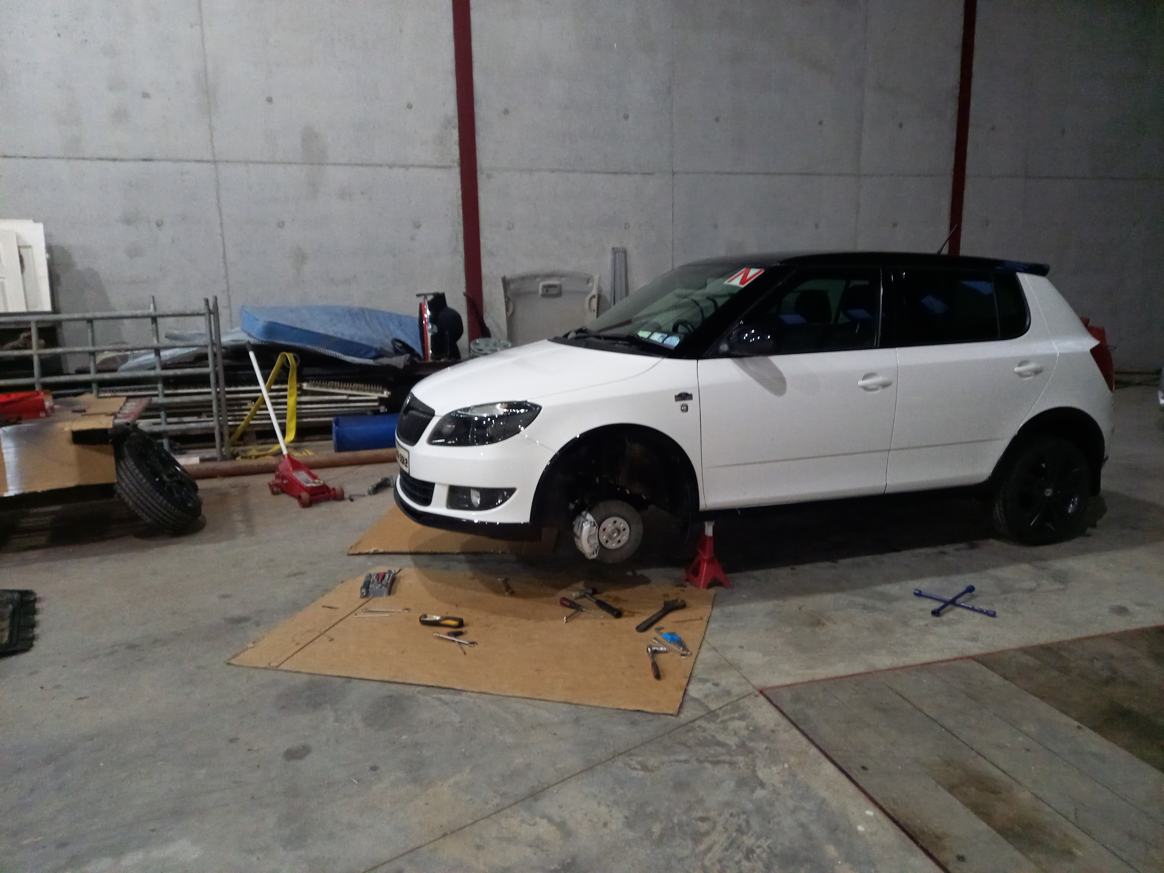

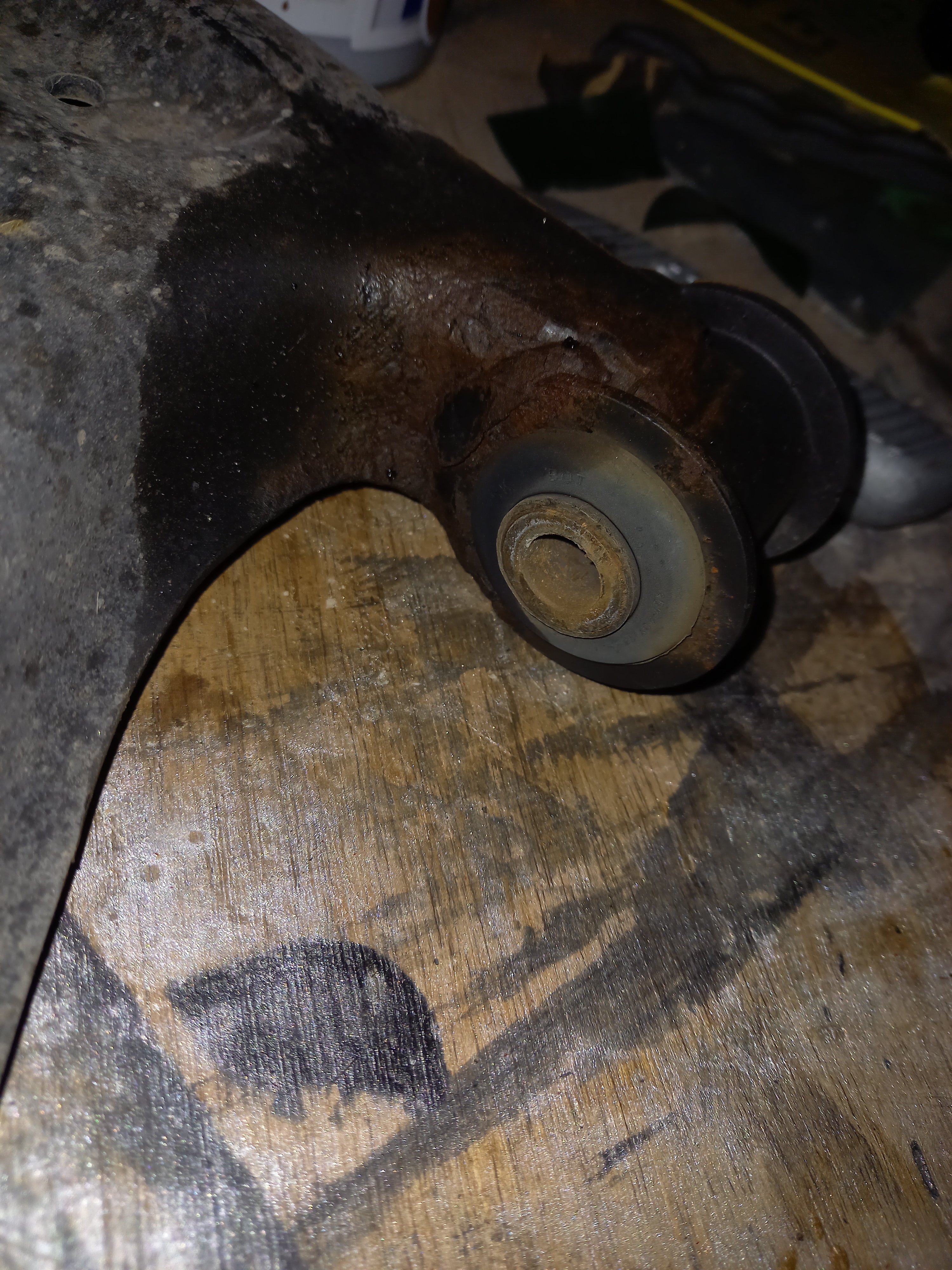

Got the wishbones out last night, pain in the hole, The two wishbone bolts where stuck fast on both sides. I was very lucky I got a impact gun last week, even it struggled to get them loose.

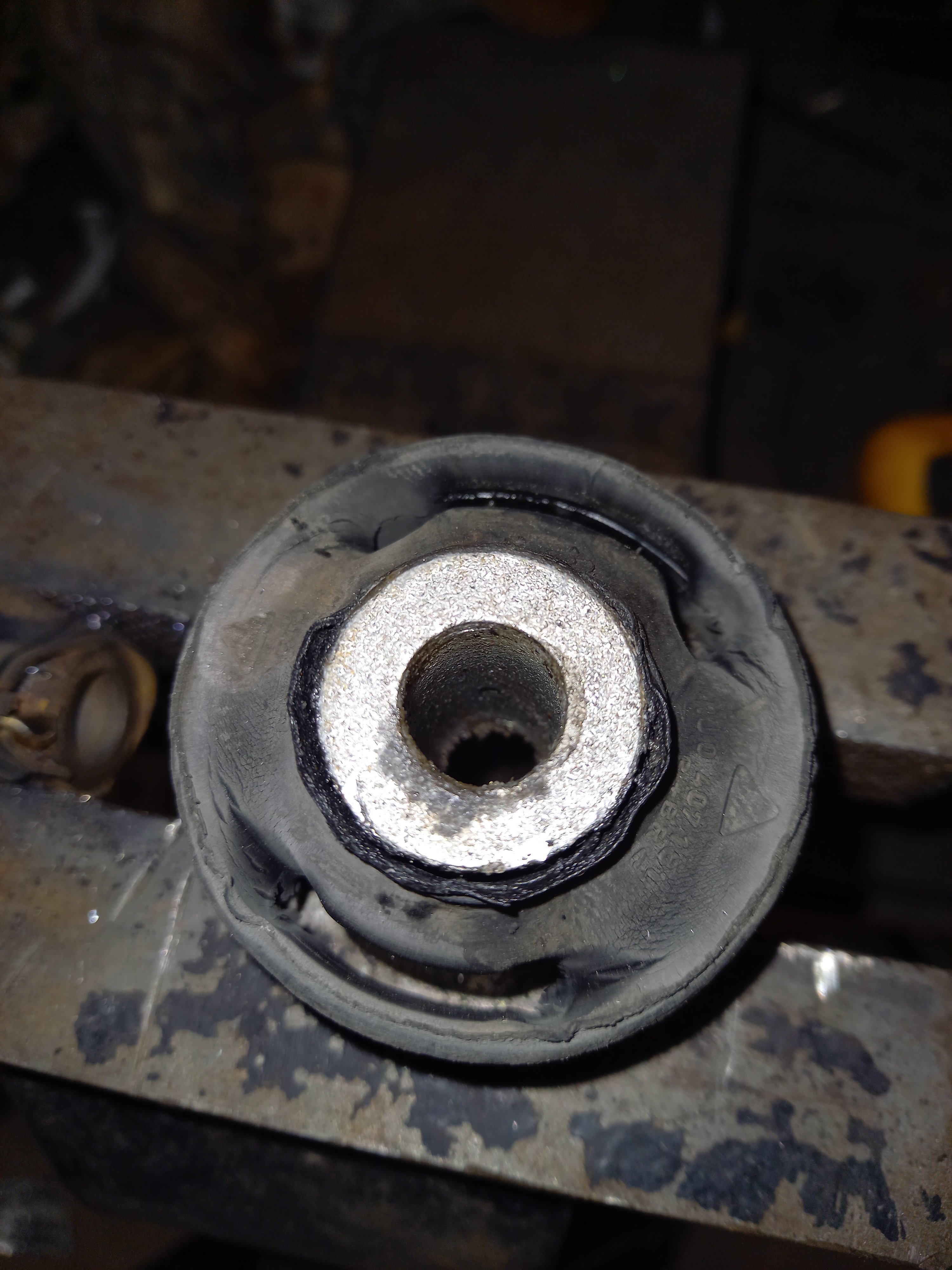

Console bushes themselves practically fell out of the arms, they werent even sitting properly in the arms.
Front bush was a little more difficult, I ended up drilling the rubber out and making a press to get it out. I'll need to sand the holes smooth, probably will give the whole arm a bit of paint.
Hard part seems to be done. Should get the car back on its wheels this evening and get some shakedown runs in. Car ran pretty good before this, considering how worn the old bushes were, this should really tighten up the handling.
