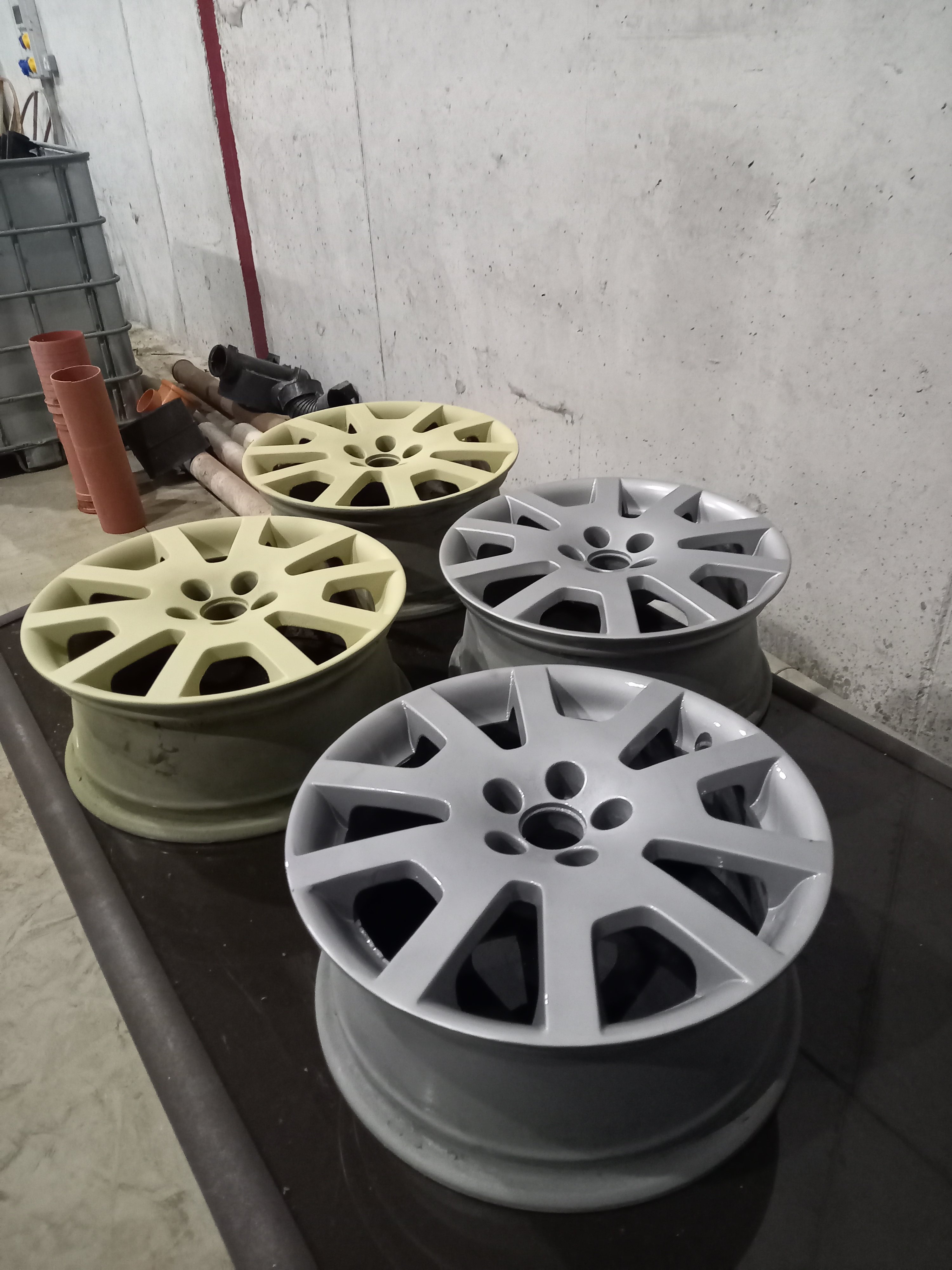

All I have to do now is paint the other 2 and clear them so they will be done tomorrow.20211014_193242.thumb.jpg.a72f28e031bbaac003b09cb6ed0070e6.jpg

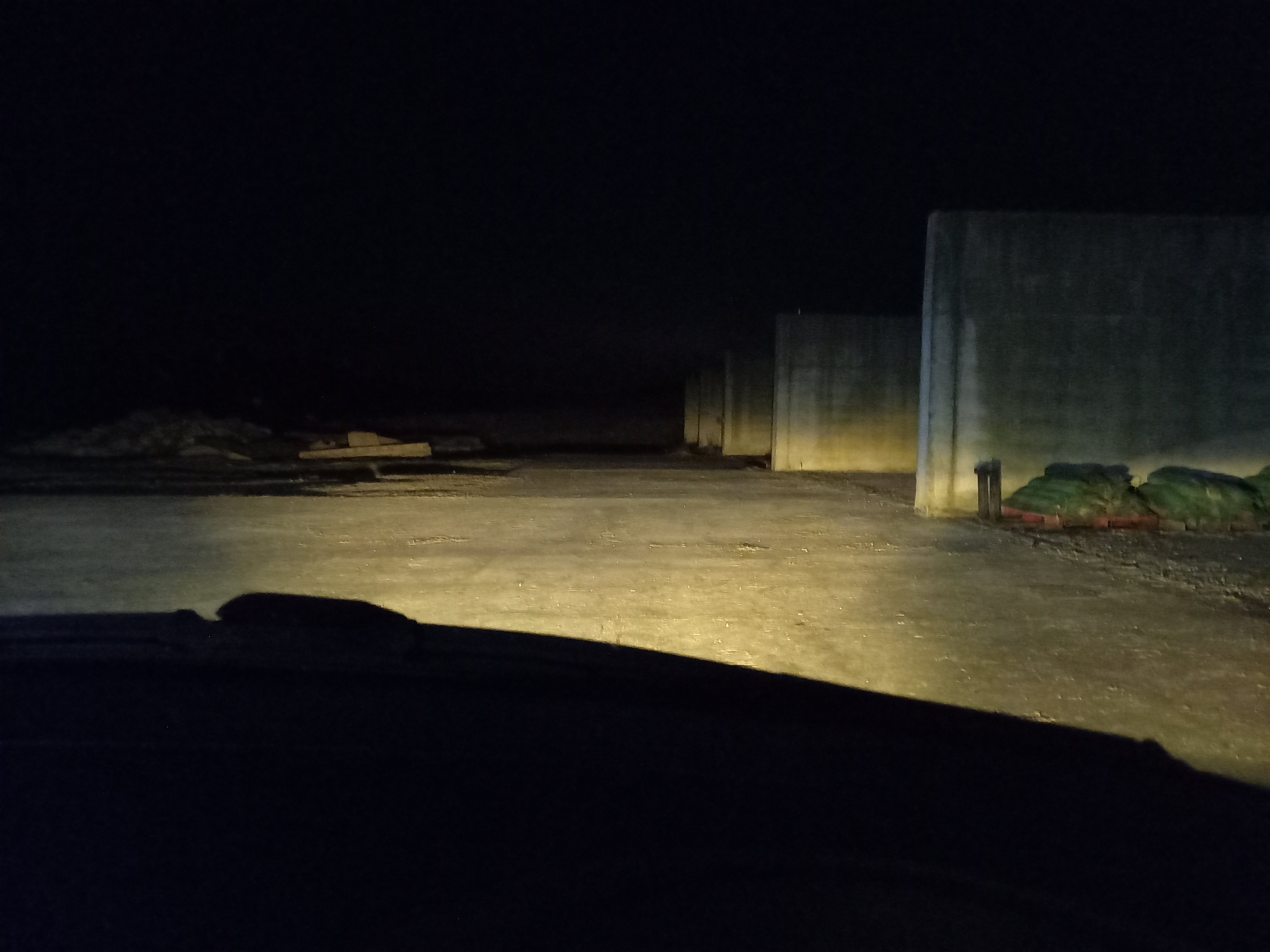

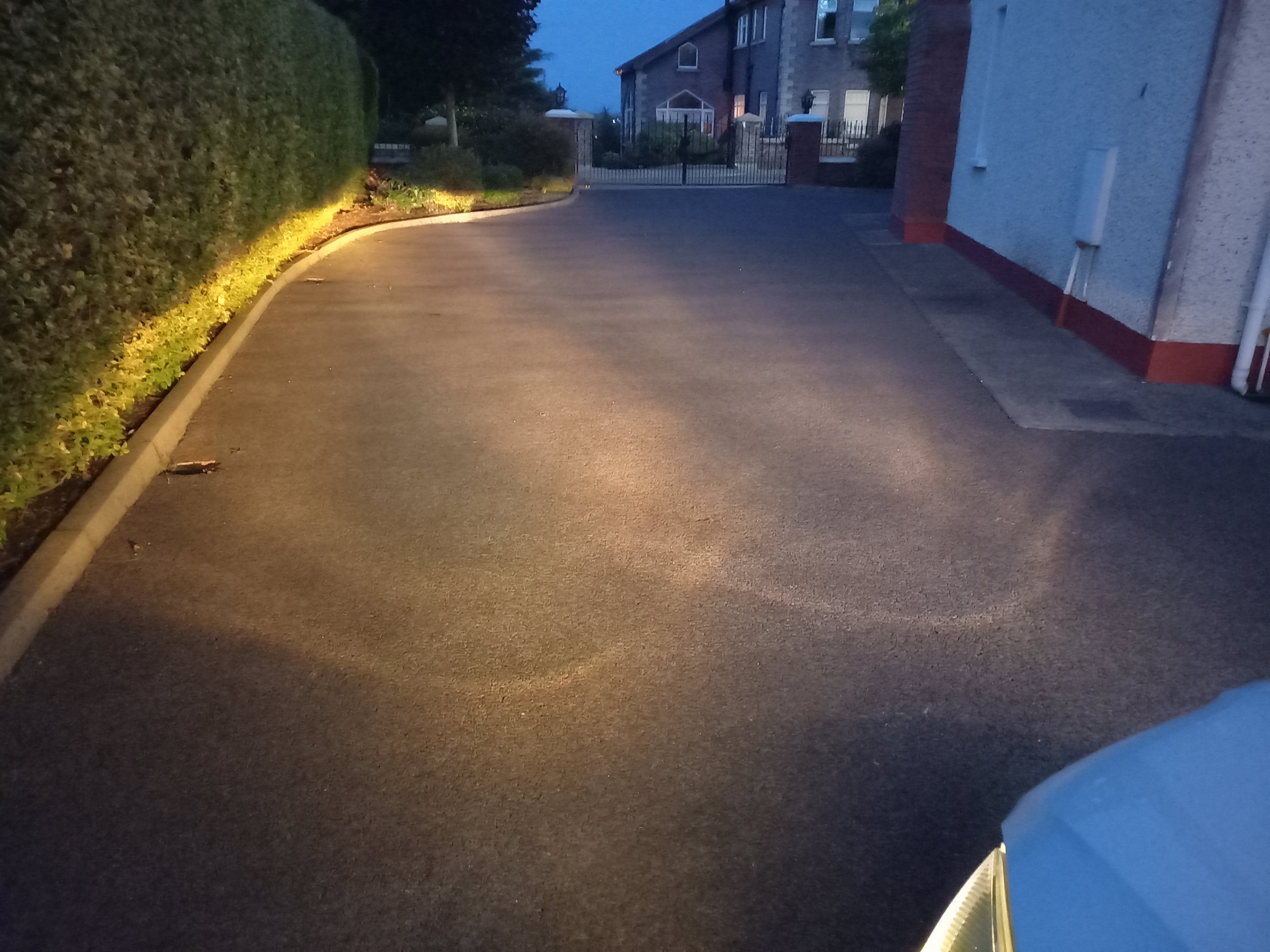

Did a bit of experimenting with bulbs, the secret bulbs came quick as expected, a pair of 3000k Michiba bulbs.20211011_191203.thumb.jpg.e33efc18ab4df86bf24ed2ab8eb11794.jpg
Now I liked the colour of these, and they are legal judging from the NCT guidelines. One problem with these is that my car only has the one bulb for high and low beam, but they had the same range as the original cheapy white ones in it.

Ha! I don't think you'd say that if you saw them up close! I probably would have a go at painting some wheels again but ideally ones in better shape to begin with.
Although having such rough wheels to start with meant I havent set extremely high standards for the finish of them, once they look halfway decent I'm more than happy.
That hycote paint is very good , great spray from it and its almost a dead match to the original silver.
Might have a go at test fitting the two I have finished this evening and see if all my hard work has payed off.

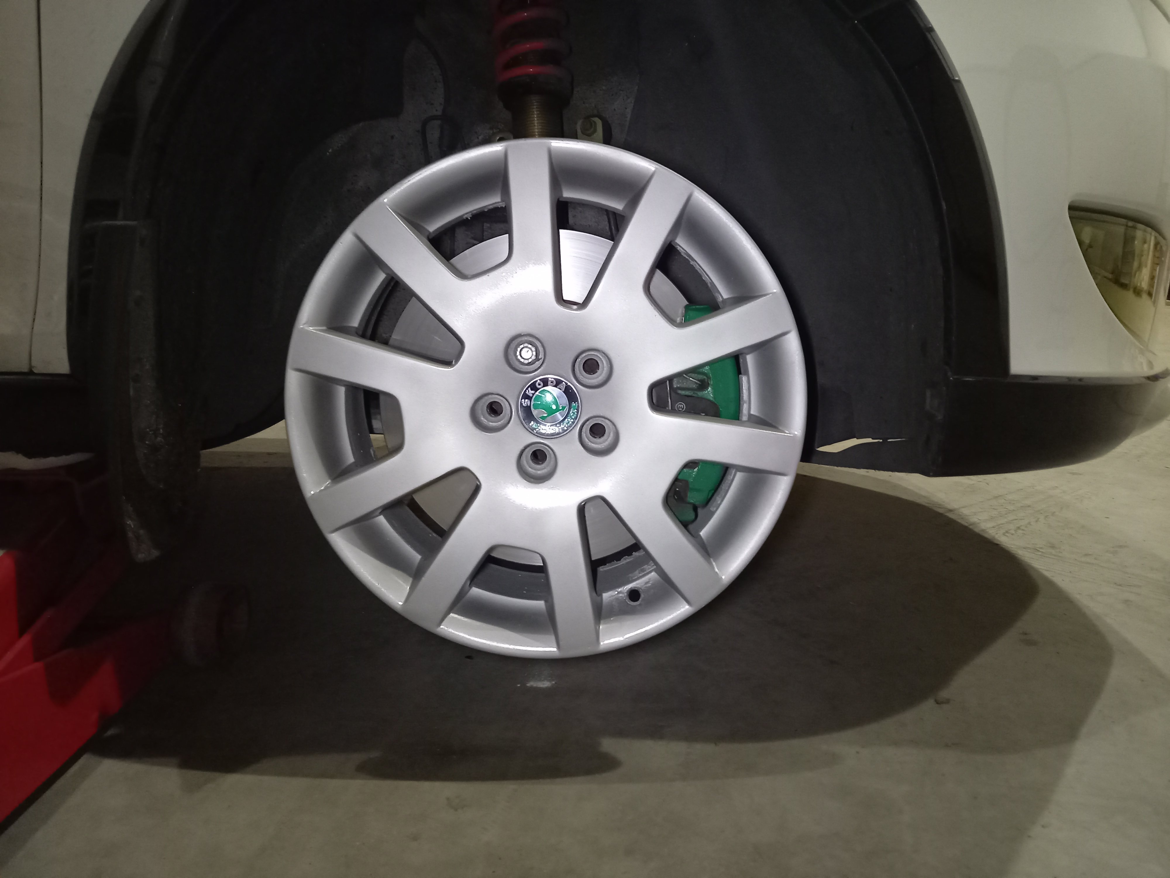

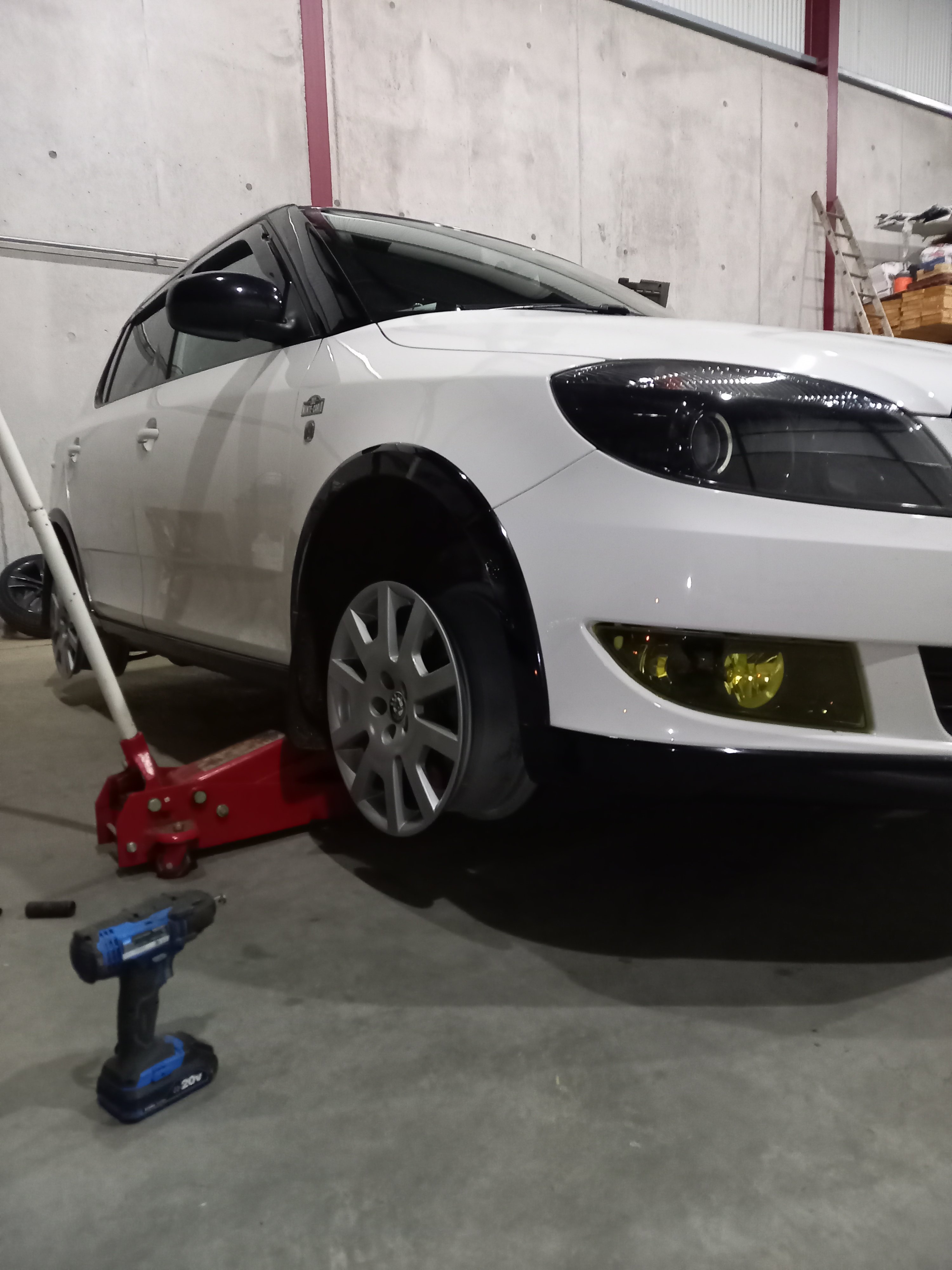

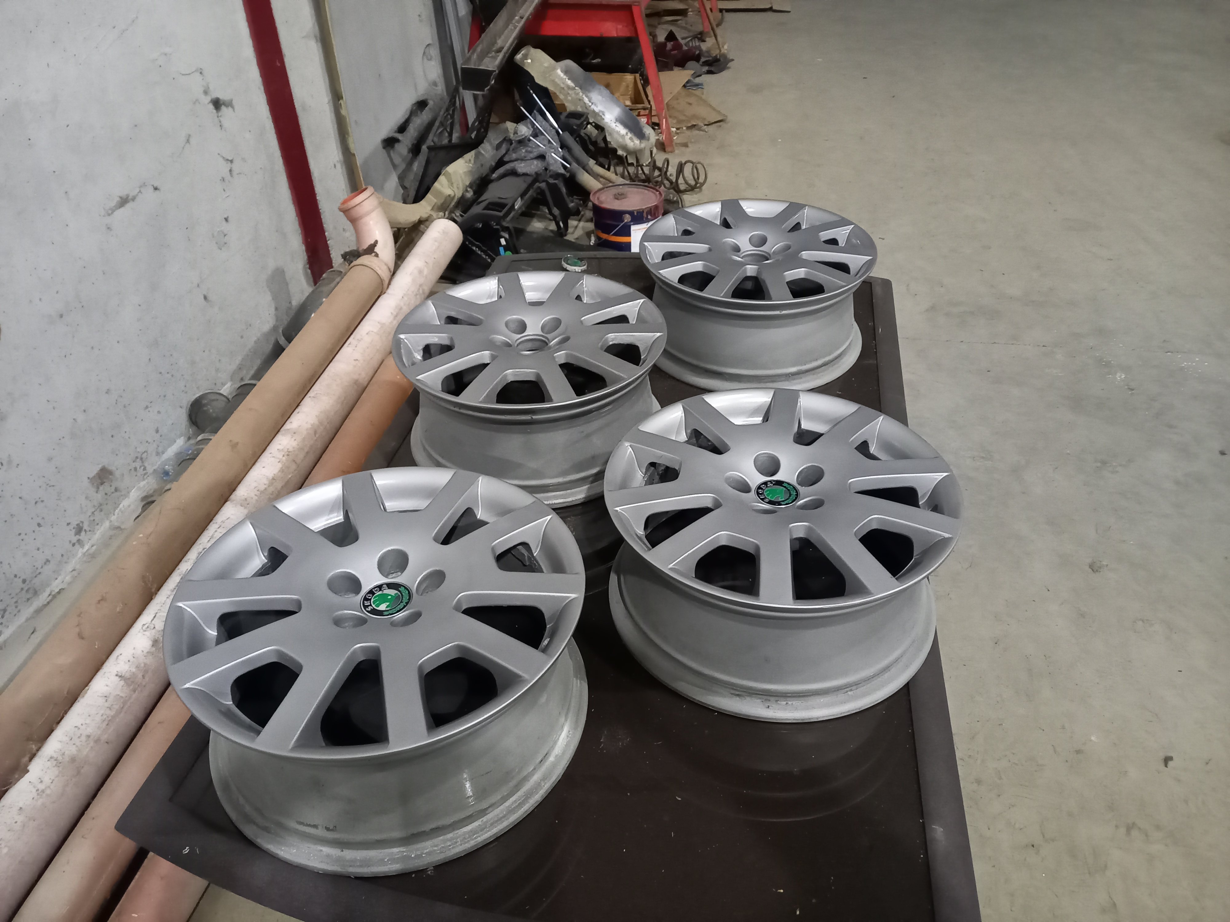

Test fitted 2 of them this evening while the others are curing.20211015_195447.thumb.jpg.98b8b4603f142ca03e9d81b0d12bdff1.jpg
Looking decent on the car, not much room under em for the 312s though.
Other 2 are cleared now and just curing. Basically ready to get tyres on them whenever.
Reckon these will look great with some chunky tyres on em.

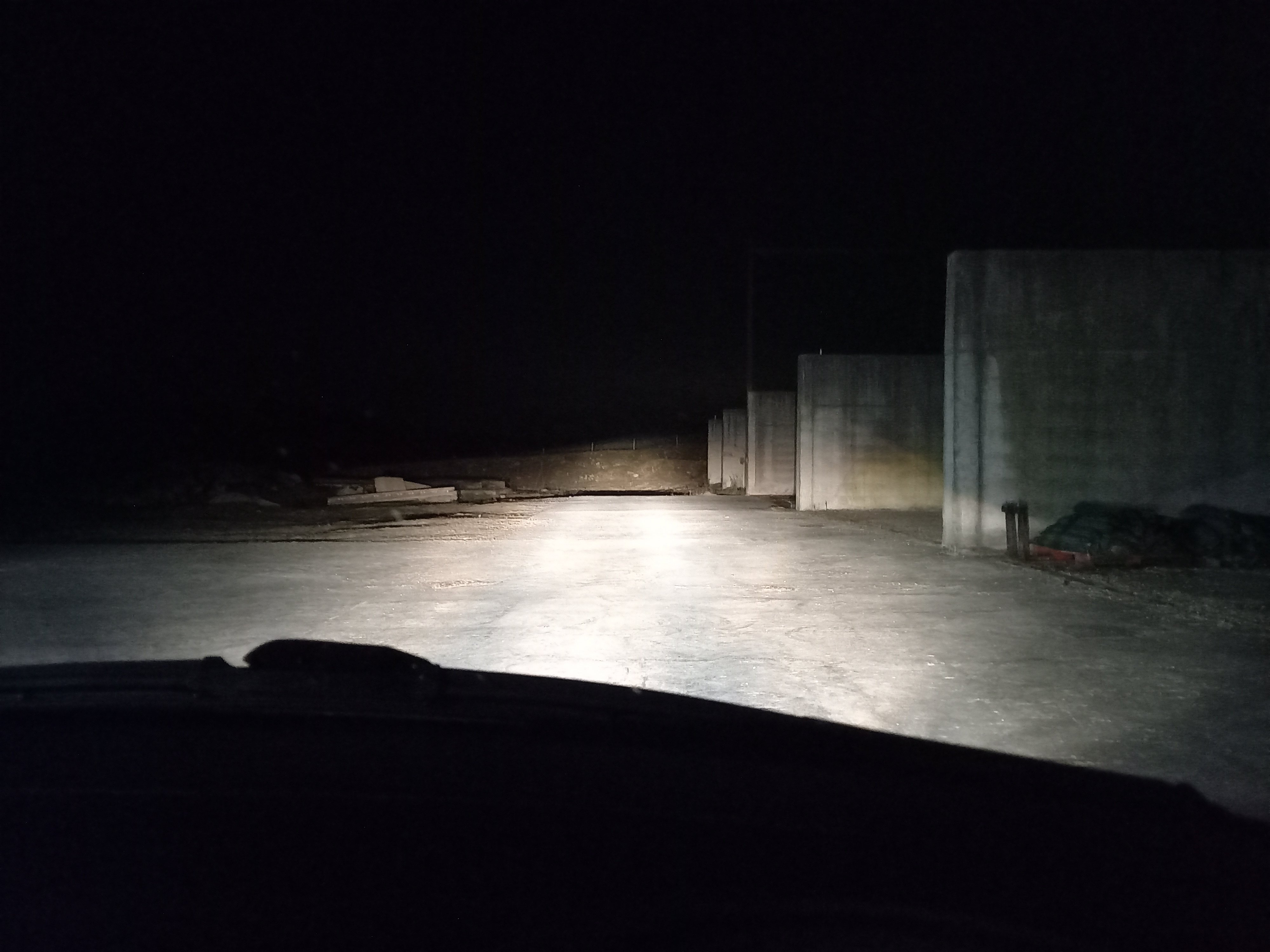

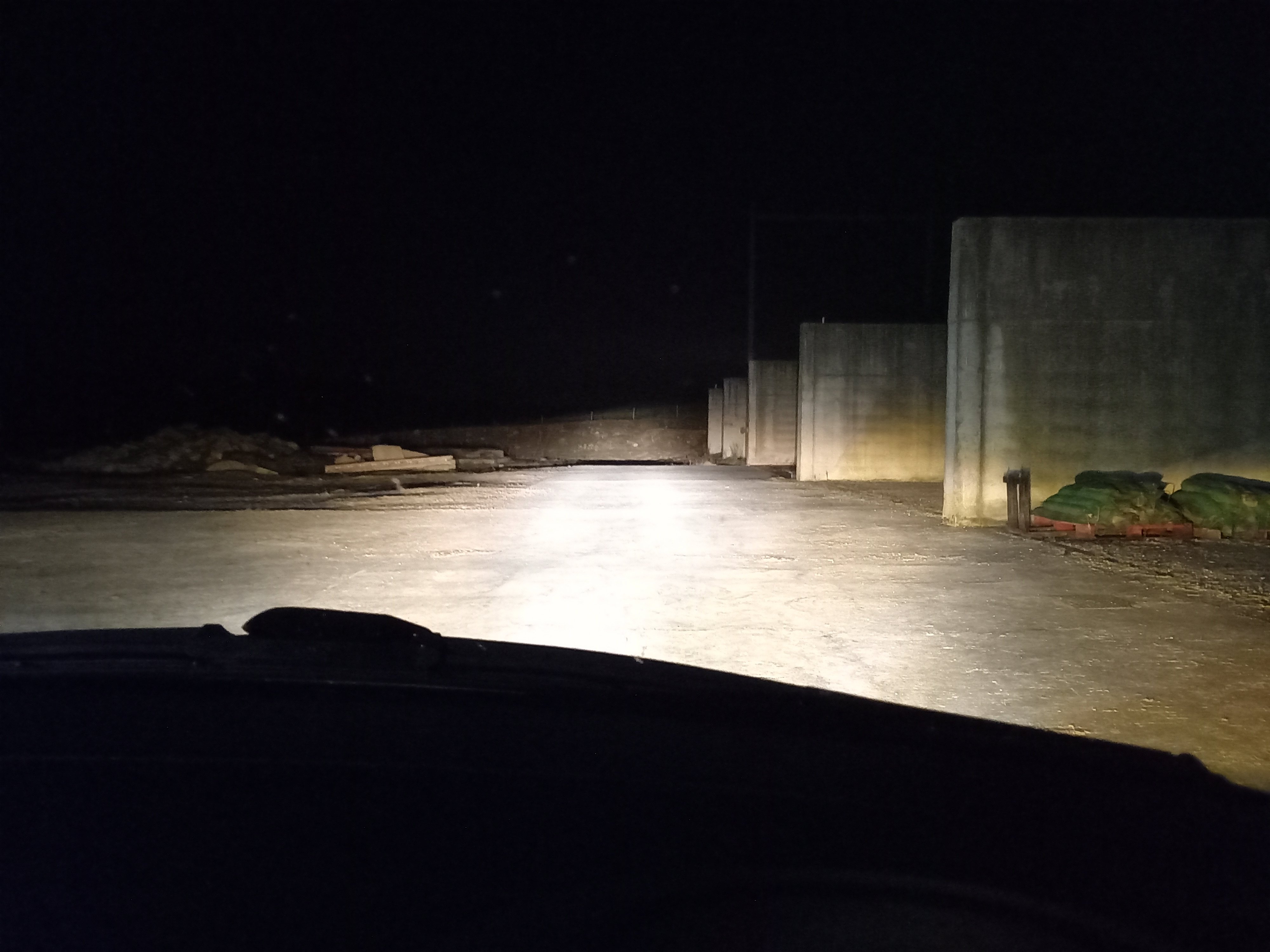

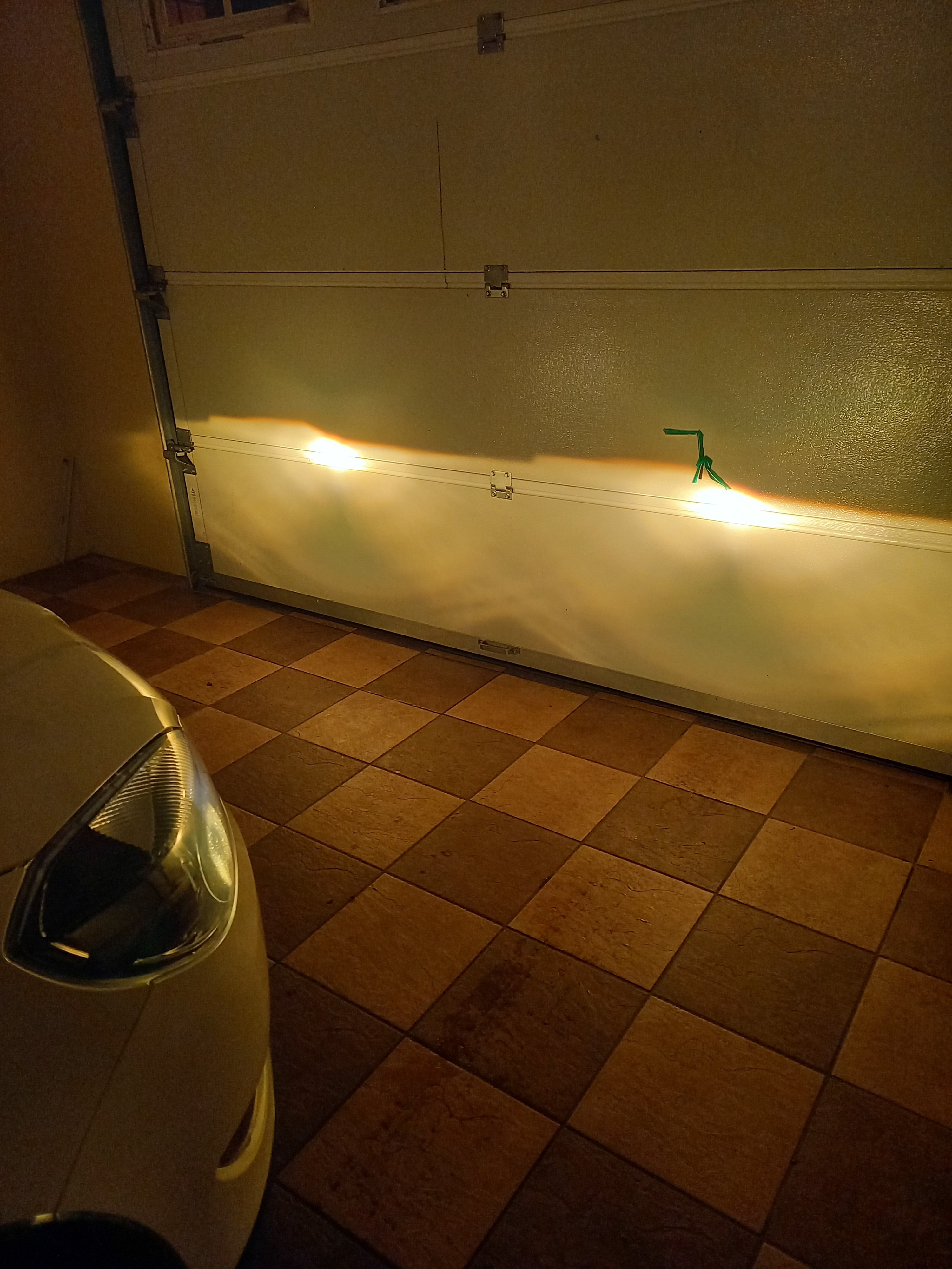

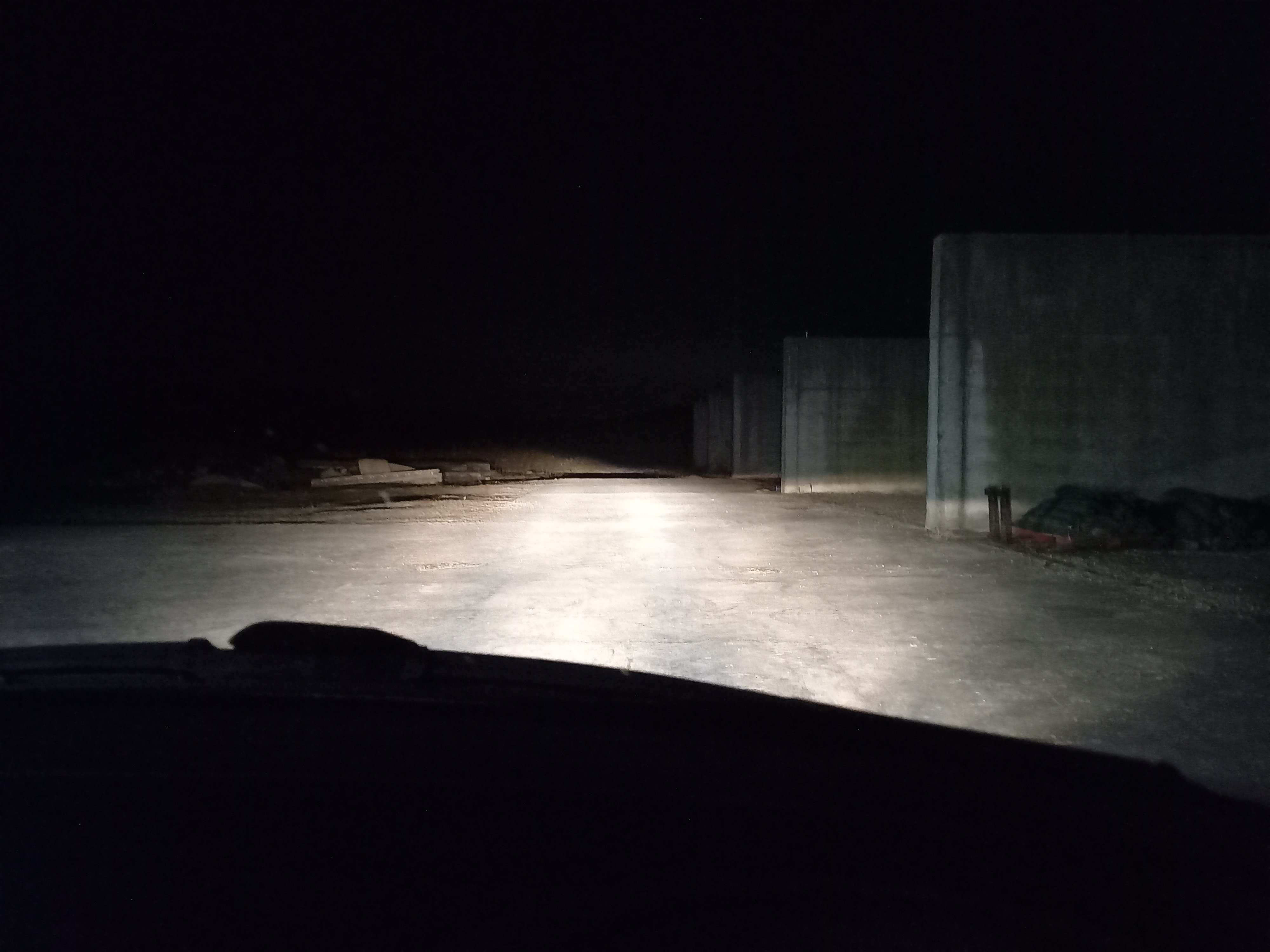

Well I took some photos with my phone positioned on the dash, on top of the gauge cluster. In a completely unscientific test I put the front tyres on a crack between 2 slabs on the yard and aimed for a pile of dirt at the far end of the yard.
First up is just the Nightbreakers on low beam.
Second up is the nightbreakers on low beam with fogs on.20211015_221241.thumb.jpg.b1c9b3bdb54cfdb427c2dd3ca27f7d3b.jpg
Next is the Nightbreakers only on Full beam.20211015_221221.thumb.jpg.bdb042a0fcbe3ae992399f076793699f.jpg
Finally is the Nightbreakers on full with fogs.20211015_221246.thumb.jpg.0f20075445f976a2860a99a508e580aa.jpg
Feel like I should include pictures with the fogs as thats how I (And every one else in rural ireland) drive. They do help a lot illuminating the sides of the roads, just last night they saved me twice from foxes running out on the road.
And this is just a photo with fogs only for reference.20211015_221207.thumb.jpg.66d514cf1bcbc4a99657d9c019f2b57c.jpg
This part of the farm had no lights on so there was no lights interfering with my "test".
They are a definate improvement over the normal bulbs from what I can see. The Michiba yellow bulbs are in the mk1 so next time I take it out i'll get a photo of those.

Thanks for the pictures...   Those night breakers look good...   Definitely whiter and they seem to be a lot brighter than the fogs for example...   So I'm convinced!!!  Thanks!

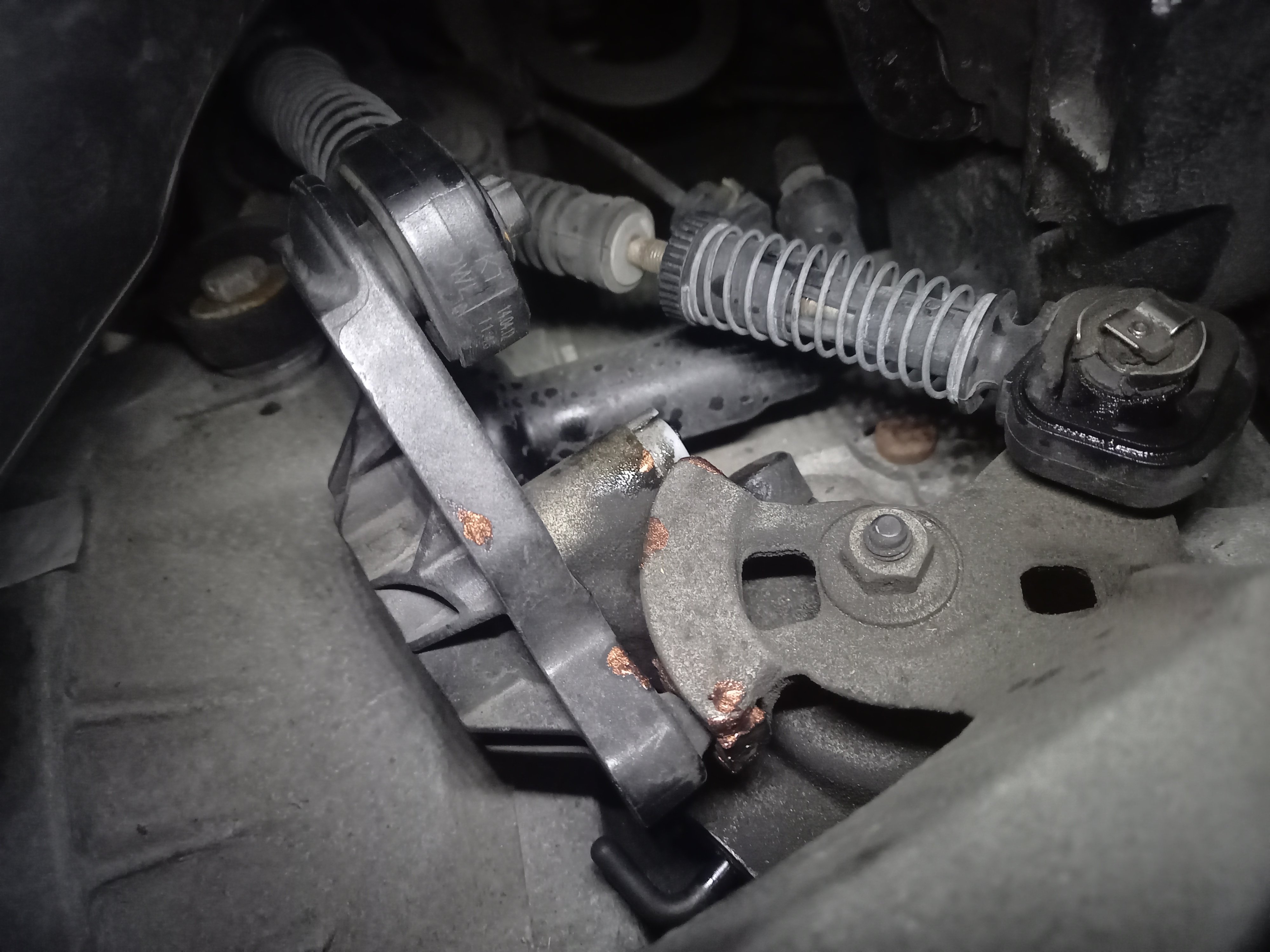

Had a go at adjusting the linkages on the gearbox, very easy job. Hardest part was removing the airbox and battery to get to them. Greased some bits on top of the gearbox and sprayed ptfe spray on the ball socket in the car.
Have to say for a few hours work its made this car SO much smoother changing gears, always took a while to get into fifth gear, and reverse could be a bit of a pain too. Now it feels almost buttery smooth getting into any gear, almost exactly what I was looking for.

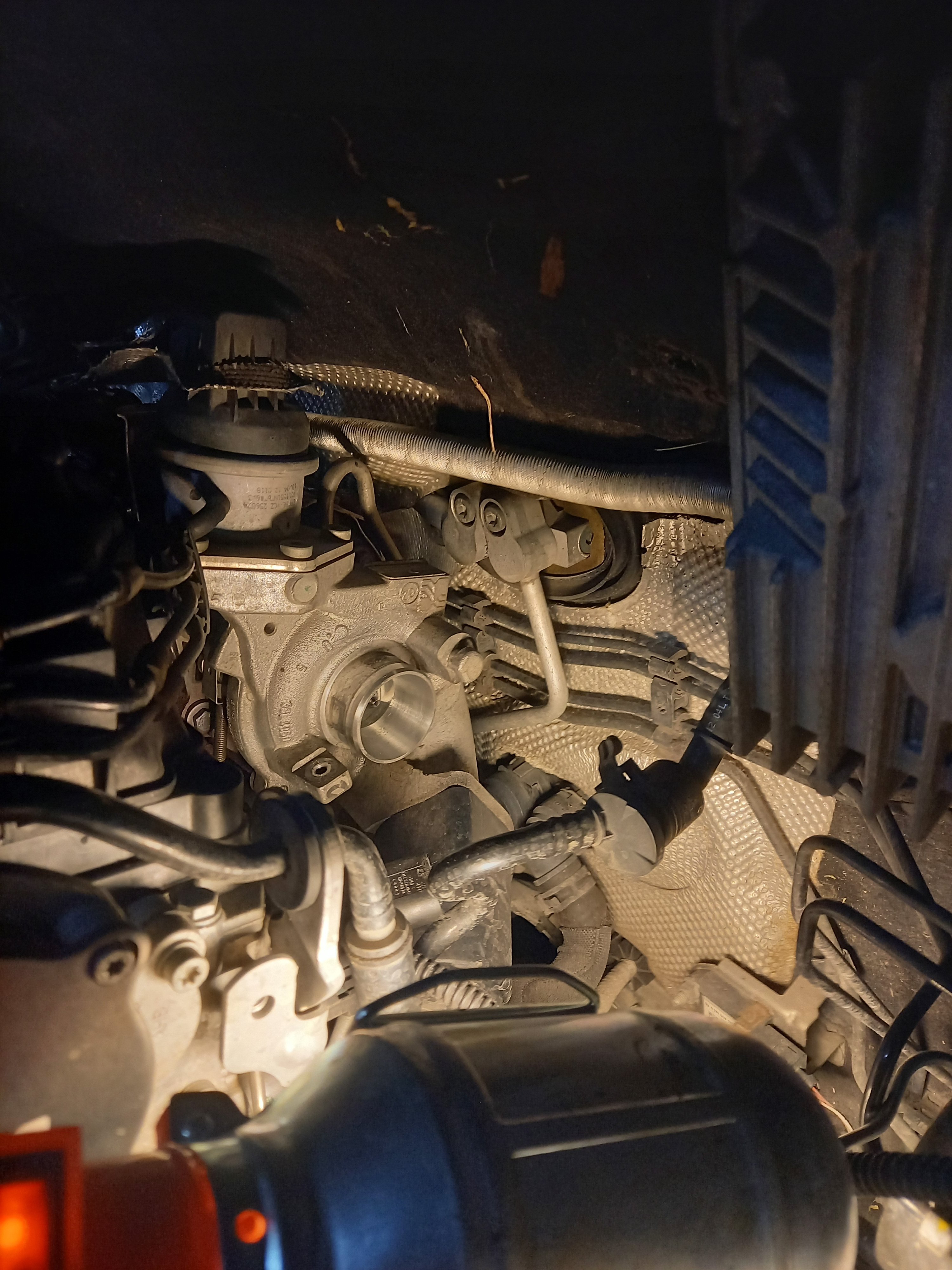

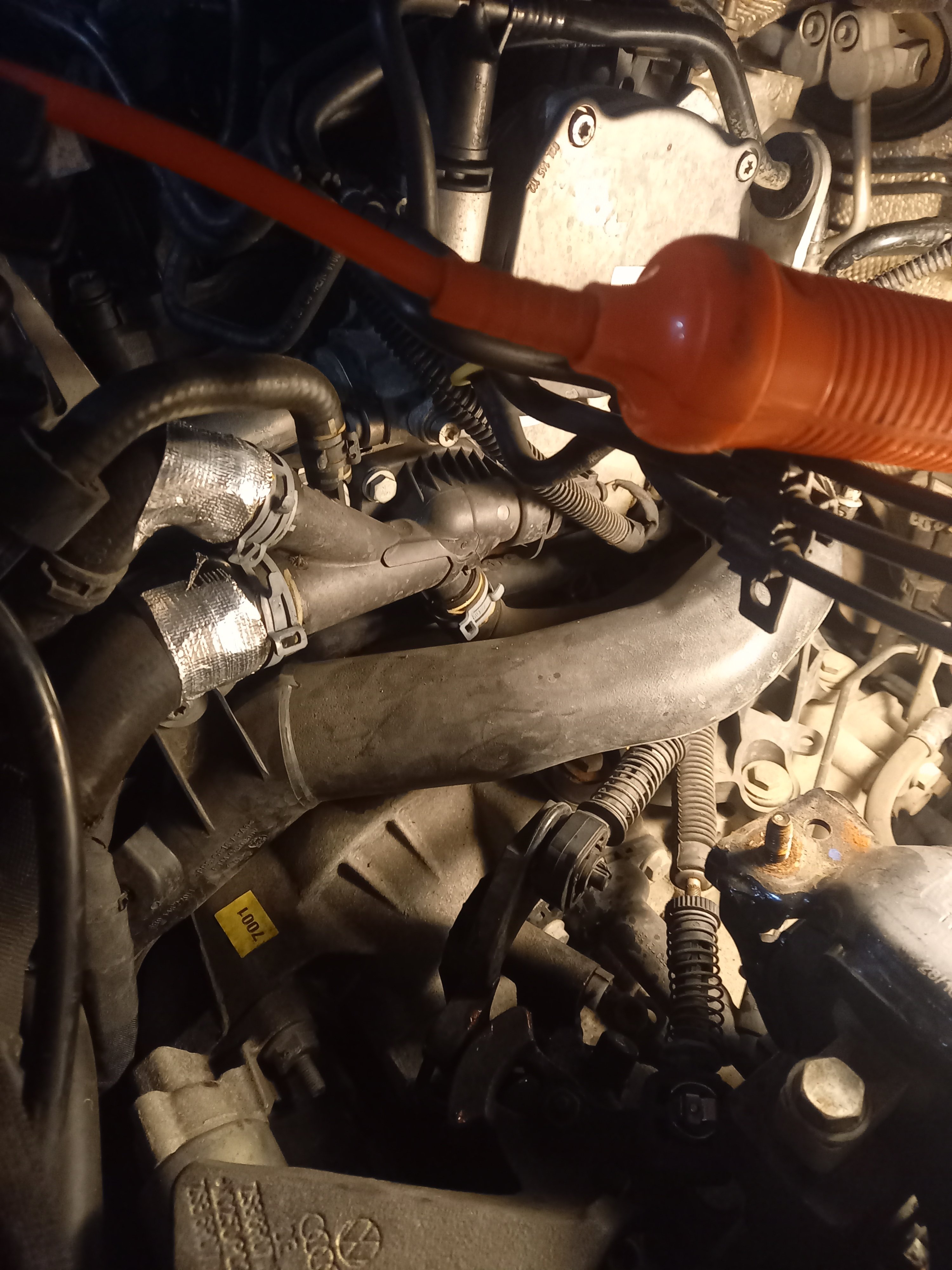

Also, found my vRS intake was rubbing against some coolant hoses. Not too bad yet so I simply put some of that heat tape over the rub spots as a layer of protection for the hoses.
When I was so far in the car I checked the turbo out, feels like its in good shape still touch wood. When I did that turbo damper "mod" ages ago I cleaned out the intake hose and infront of the turbo of oil coming from the breather, and there was a fair bit of oily goop. Checked it today and there was barely any goop there to clean up. Fairly productive evening then.

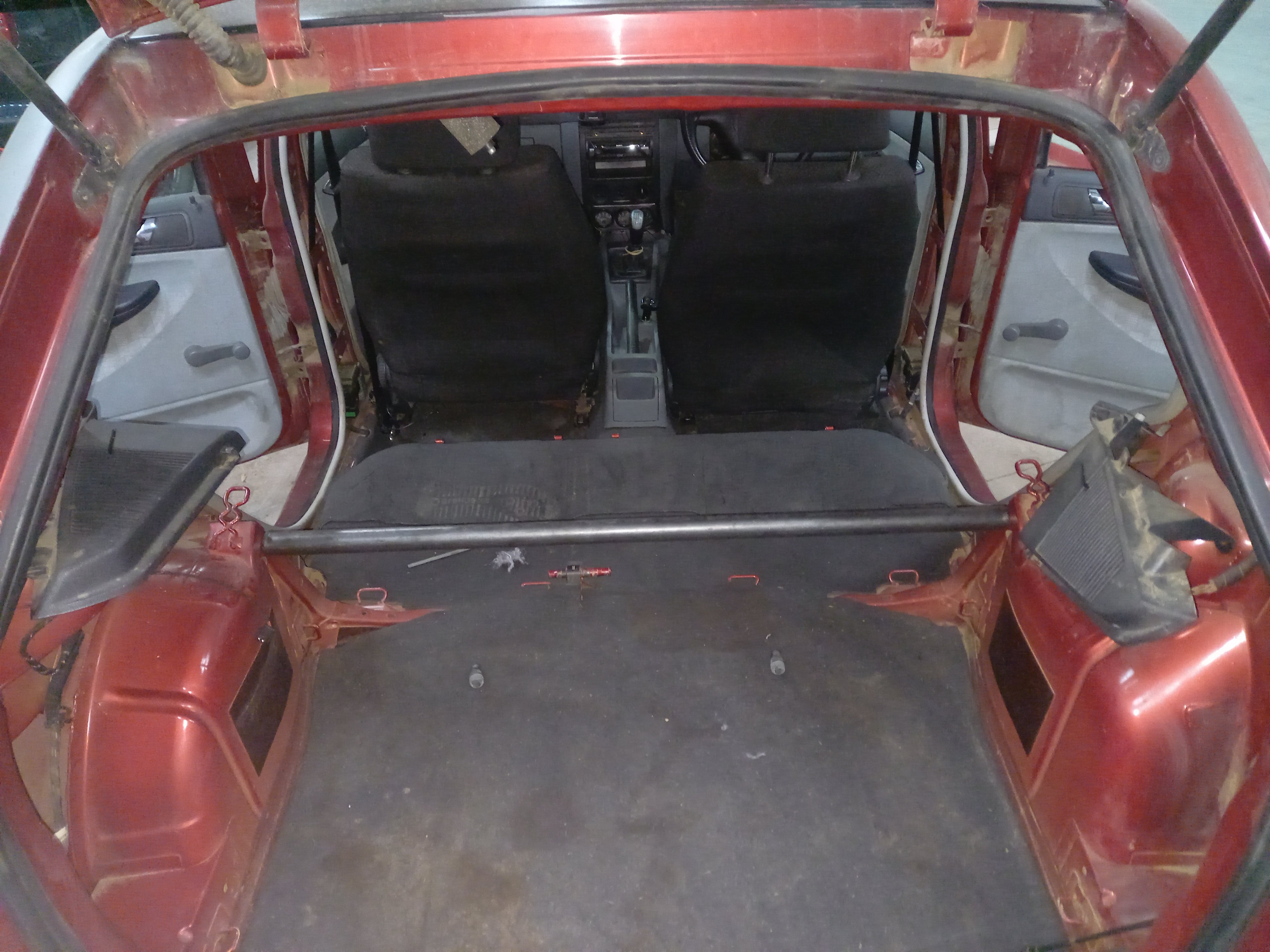

Next mod, rear strut brace.

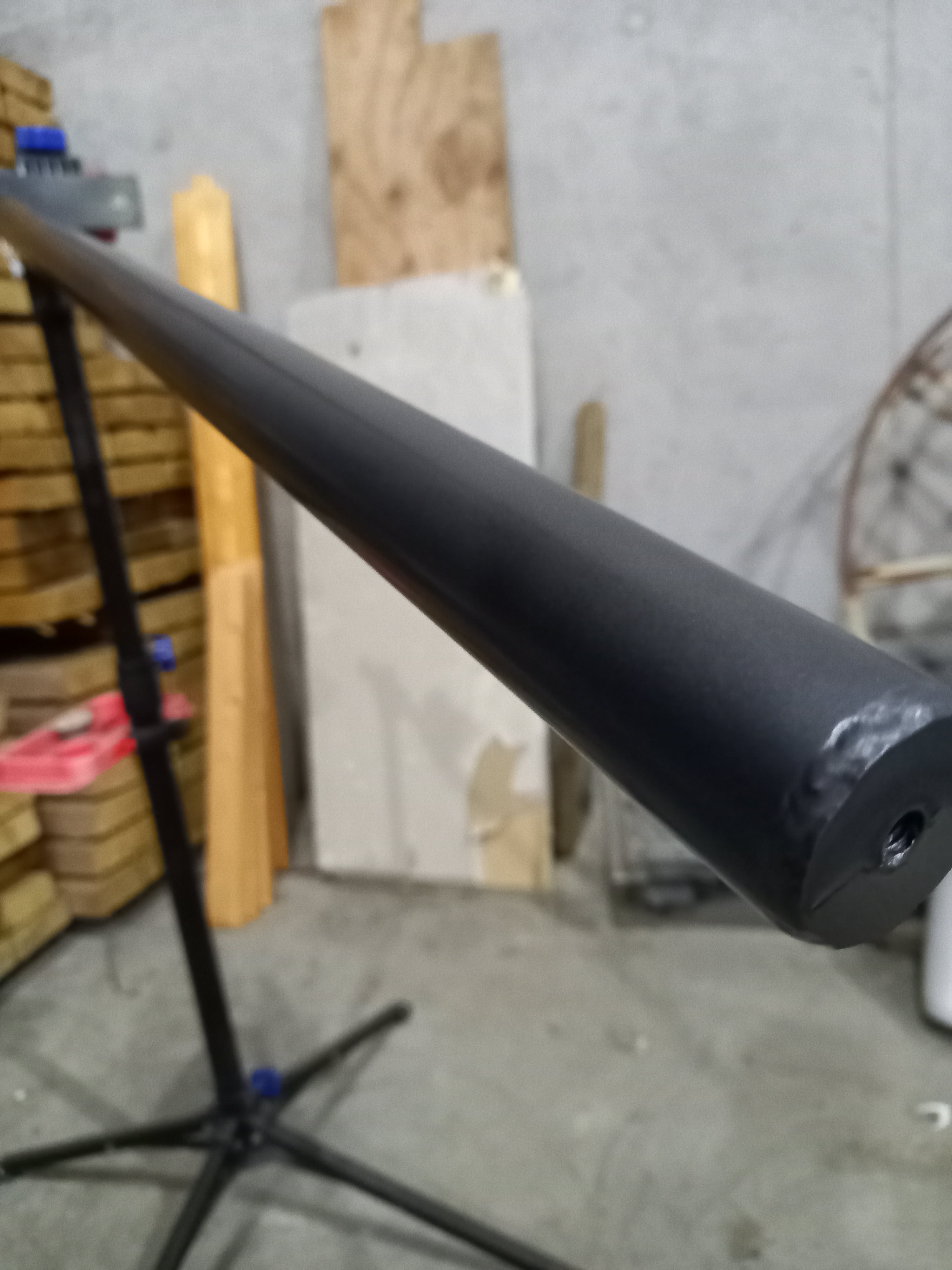

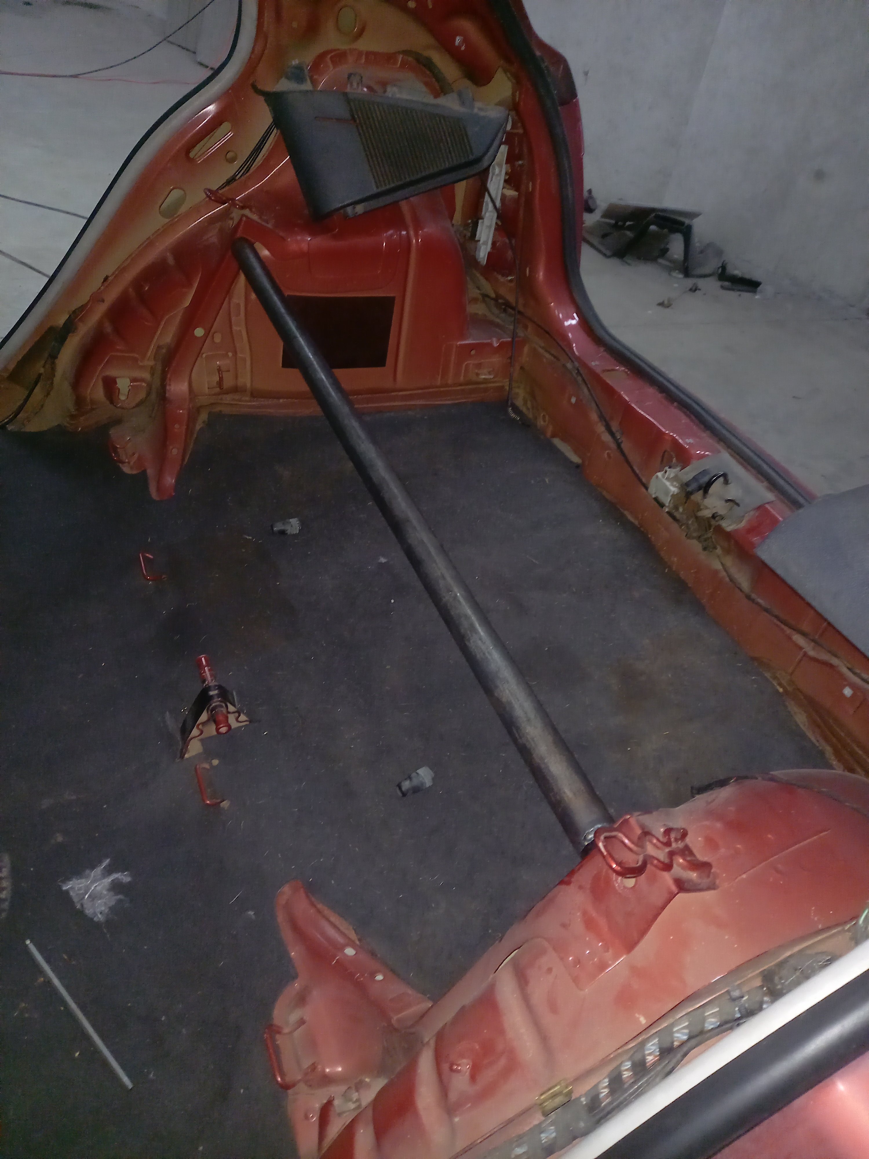

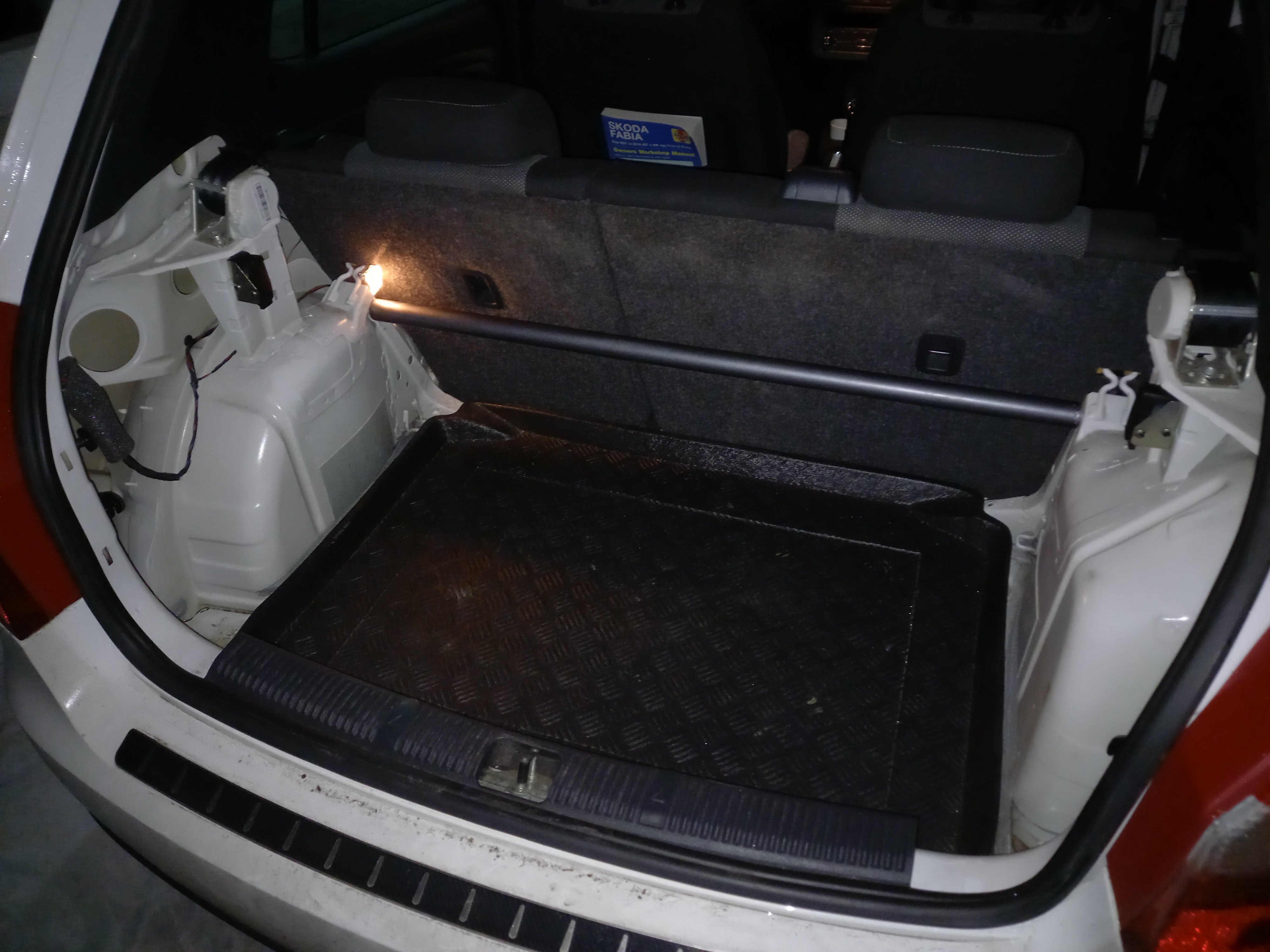

Arrived Saturday gone by but i've only gotten around to test fitting it and painting it this evening.
Test fitted it in the mk1 first to see how it fits.
Then a few coats of primer before being given 3 coats of Peugeot Cossack Grey, looks pretty good now.
Next day i'll get the boot trims off and fit the brace in place. Doubt it'll make a world of difference, but if it stops a few of the creaks in the car i'll be happy.

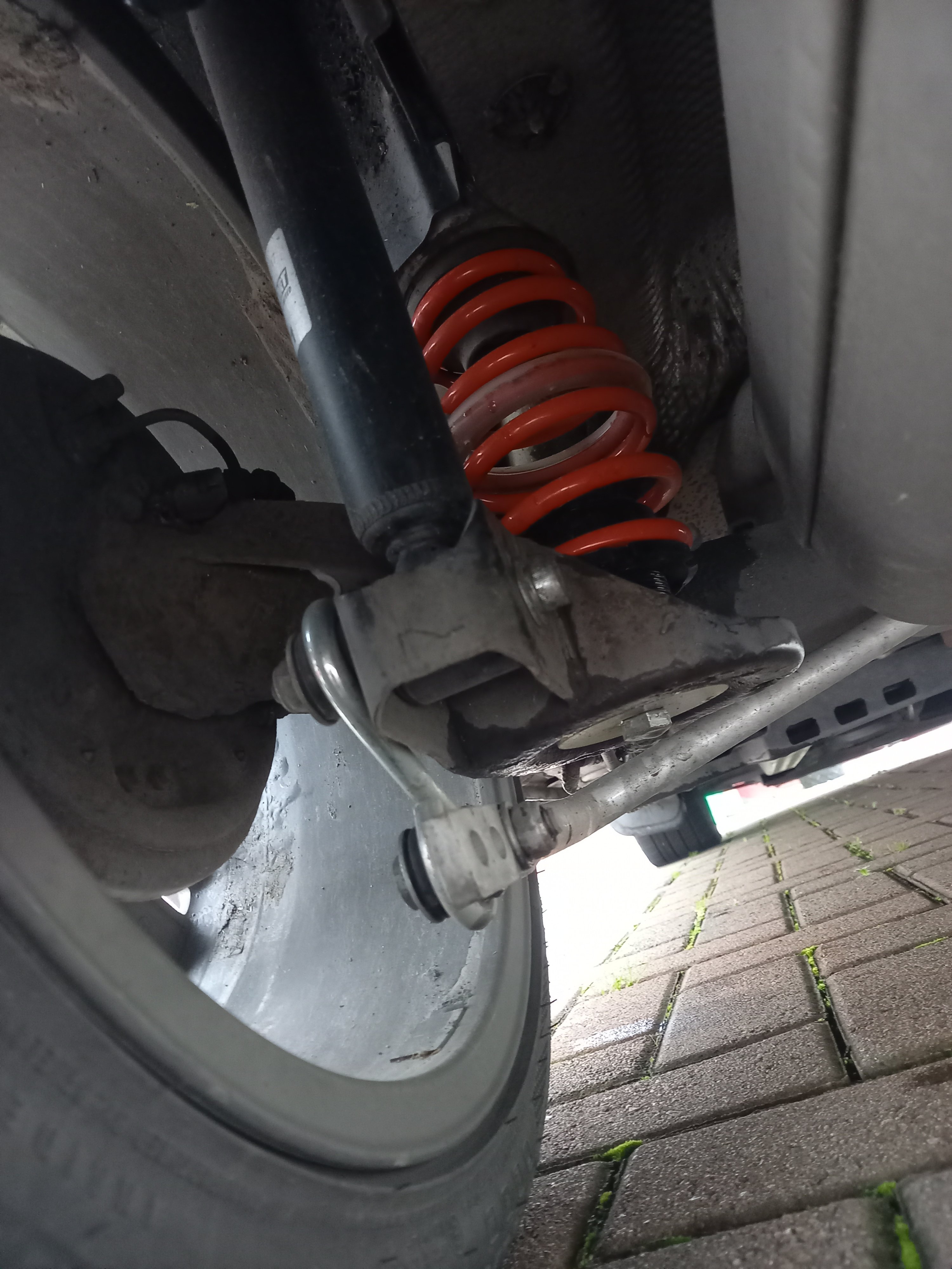

Yesterday when I was waiting for the brace to dry between coats I went and swapped out the springs for the ones I got with the coilovers, liked the springs I had but I think they were either just too long or too stiff for the shocks so changed them.
But anyway, thats why I took the pic but it shows how the rarb bolts on. Only thing you "change" from the original suspension is the lower shock bolt, original ones too short to get the drop link on.
A strut brace is a lot more permanent as it (in my mk2s case) will require a bit of cutting out of the rear trim to fit. Again doubt it will make much difference and I'm 100% sure it wont make as big of an improvement compared to a rarb. RARBs are the go to mod in on these cars for a reason, makes them twice the car to drive.
Fitted the rear brace last night, forgone the rear trims for now as I don't want to cut into the trim if i'm not keeping the brace. Managed to fit the rear bag hooks on their own, and thats one thing I don't want to remove as its so handy. Only thing I'd like to put back in now is the parcel shelf, not the end of the world though.20211028_182743.thumb.jpg.6a261194407c8027403cc2803dbb35ea.jpg
Havent noticed much difference in the car except that the creaking from the back is indeed gone, result enough for me.

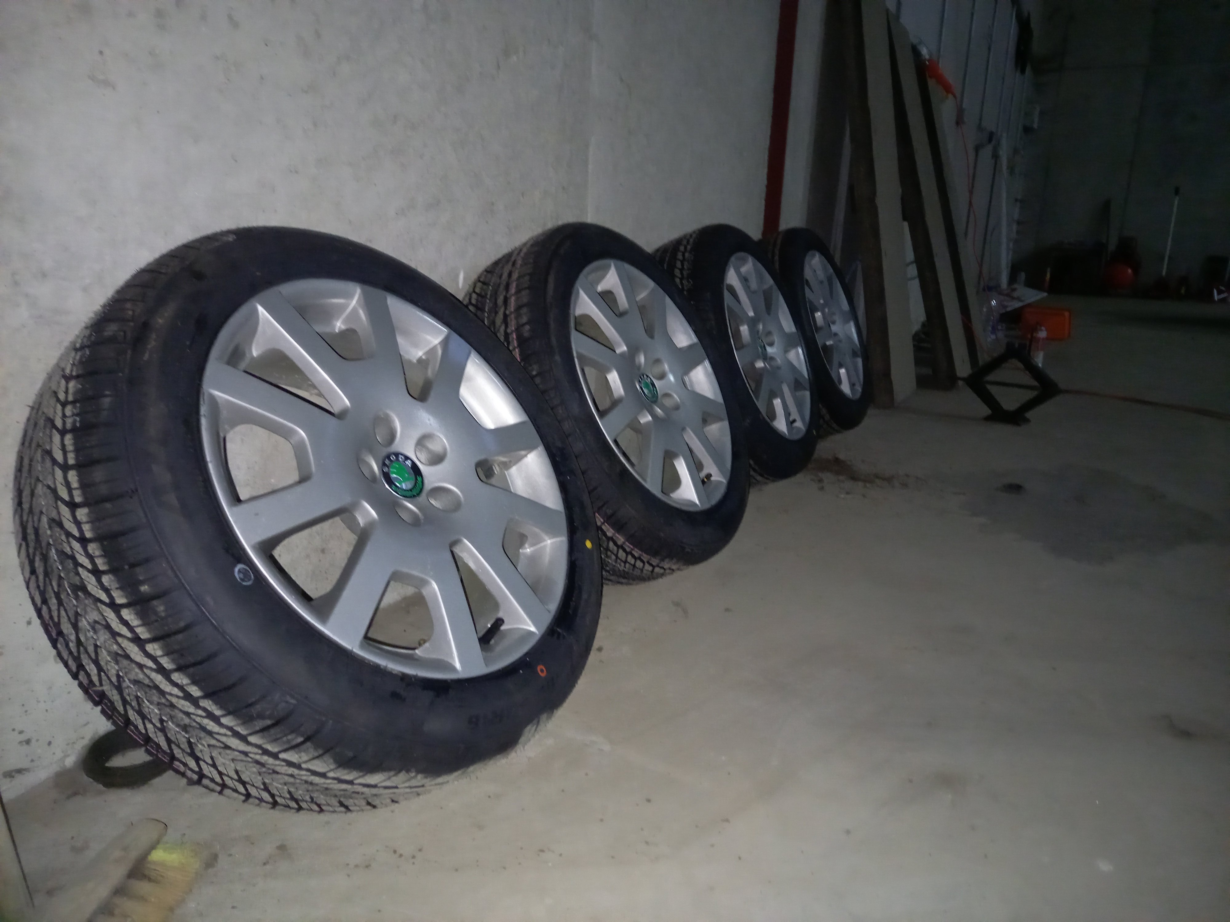

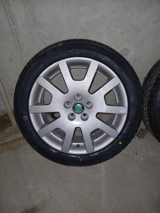

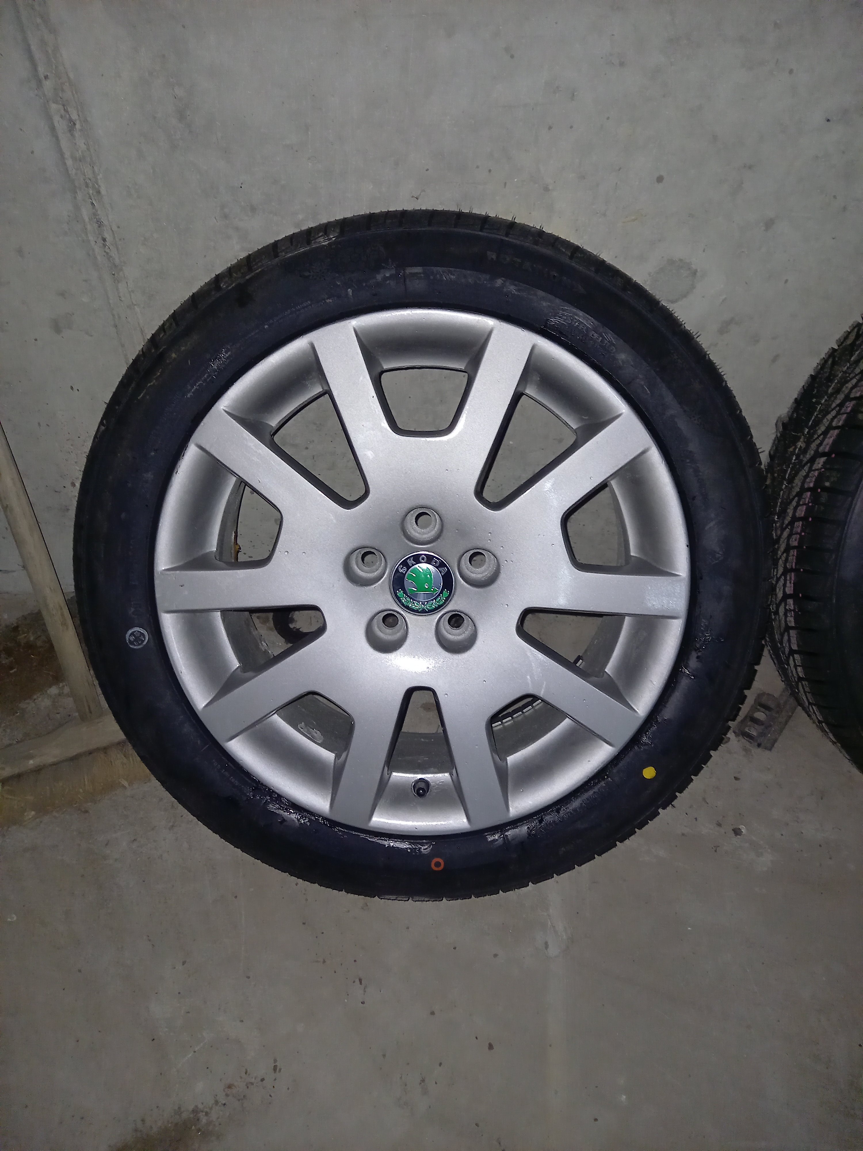

Got tyres fitted today too, certainly looks the part and definately will be a better job for winter weather than the tyres on the car now.20211028_175908.thumb.jpg.2848241e87d9ce5a522dee54a93f2677.jpg20211028_175916.thumb.jpg.247bec91d7d54ab4eb12bc7aeab4b48d.jpg
Edited by DieselMonte
What tyres have you gone for?
