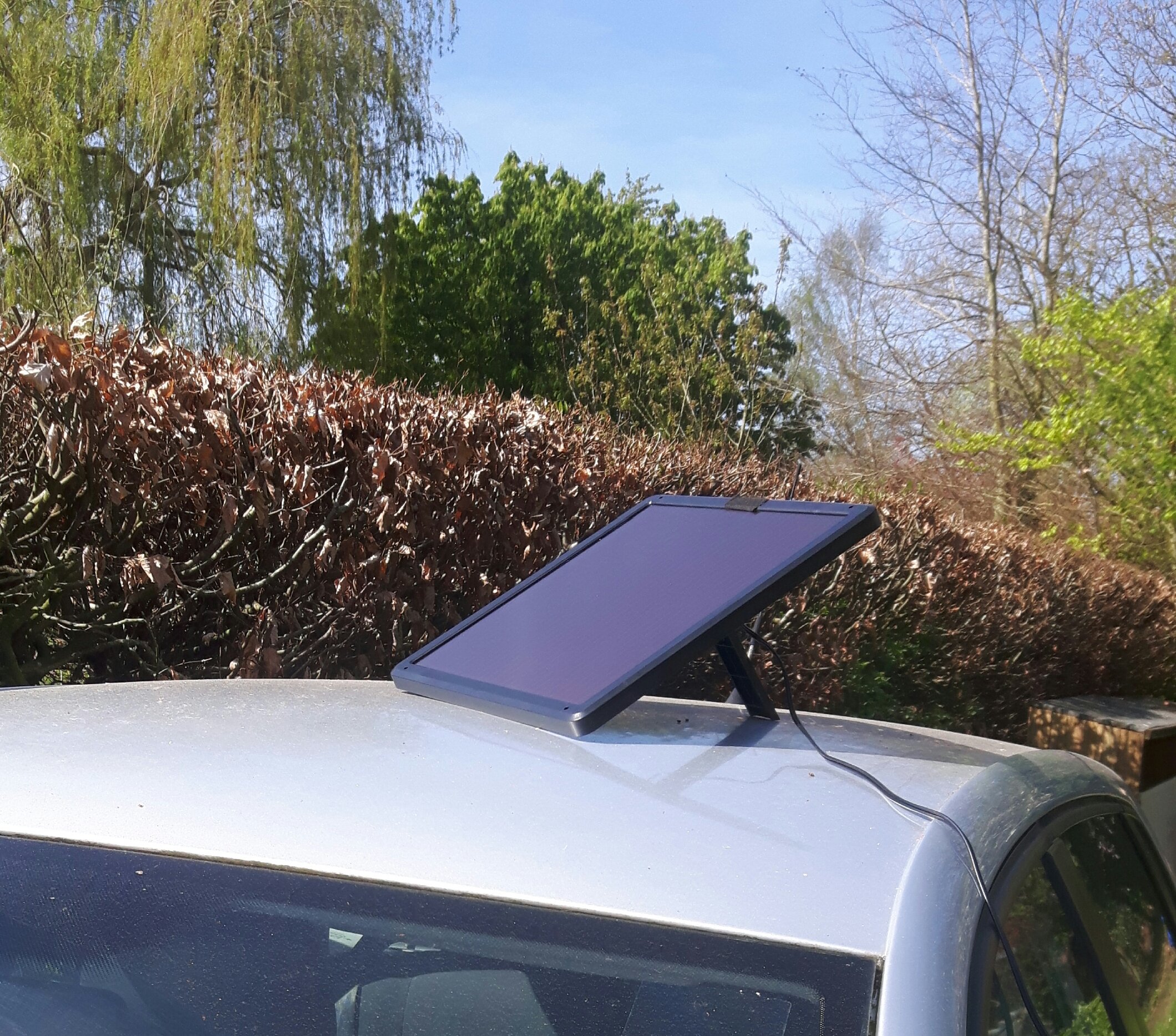

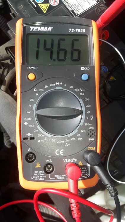

I have to retract this post (will strikethrough in a minute) as I have just taken two photos that prove it to be duff information (based on measurements of a rather smaller panel years ago that was very disappointing).  I have a 7.5W rated panel now that I've had sitting on the car roof facing directly at the sun, at a favourable inclination.  Battery was reading 12.4-ish before connecting, this is after half an hour:
With current meter inline it was reading around 0.5A, which at that voltage suggests the 7.5W spec is being achieved.  Wouldn't want to charge at that voltage for long so turned it away from the sun a bit which dropped it straight down to lower output, obviously.
Won't do as much behind a windscreen; it was managing only 300mA the other day in one of the other cars in similar sun, inside the windscreen, which didn't result in a between-battery-posts charging voltage of any more than about 13V.
So some form of regulation might be a good idea after all. Will see what I can come up with as a cheap and cheerful bolt-on. High power zener diode might do it.

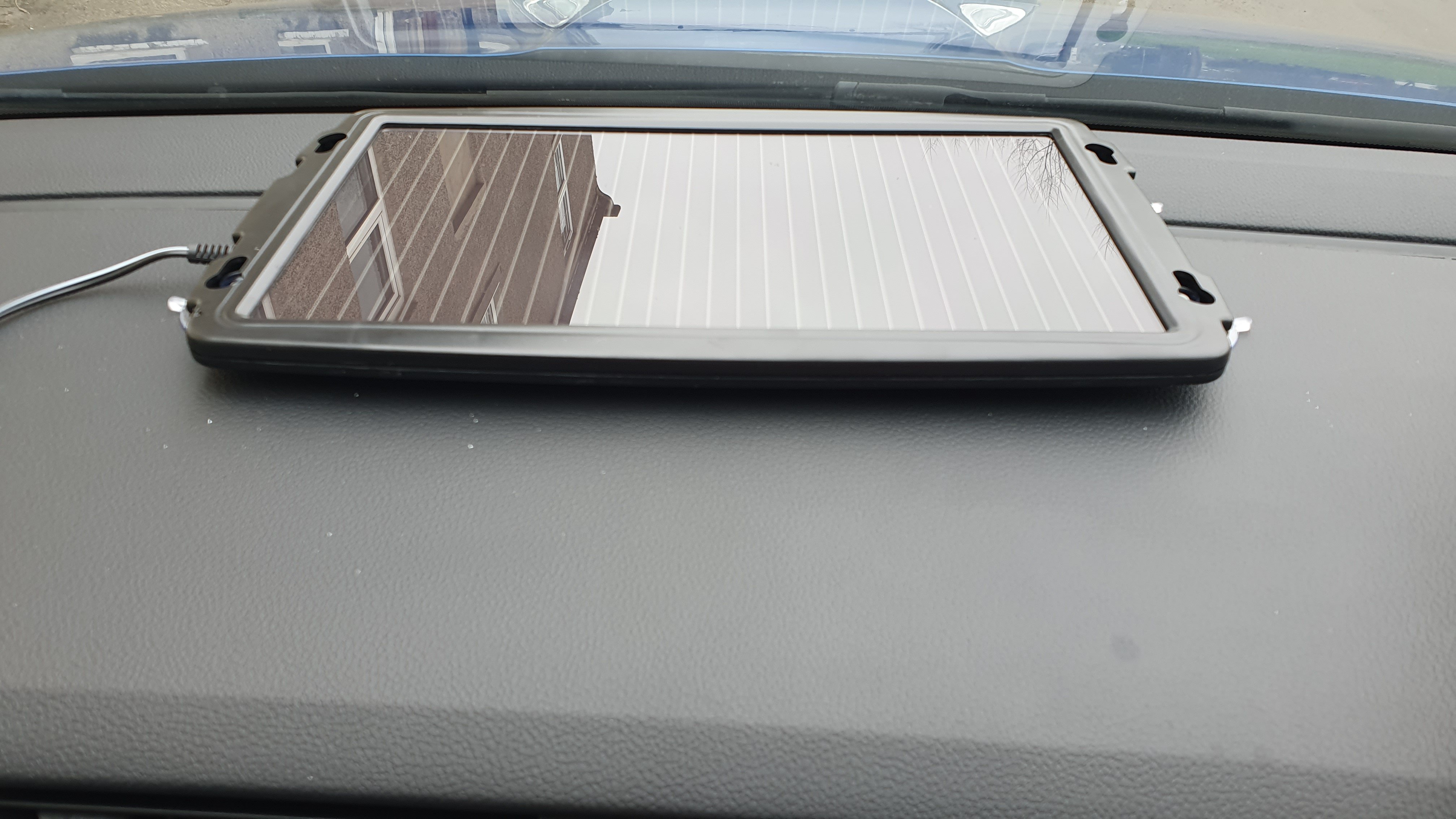

I shall go an double check my battery voltage right now and report back!
Looks fine. 12.47v in full sun on the dash inside the car. Maybe it would generate more if it was outside on the roof, but its not.
I originally got it to charge the battery on my jetski which gets rarely used, but the battery is tiny in that thing so I never used it. I've finally found a use for it now! BTW, that looks identical to the panel I have, even down to the folding leg. Mine is waterproof (aparently). Anyway, it looks ok to me...
Edited by NikTheGeek
  • Sponsor
Good news, but please keep an eye on it voltage-wise, and I'll feed back soonish about implementing a cheap and cheerful regulation, to be on the safe side.
