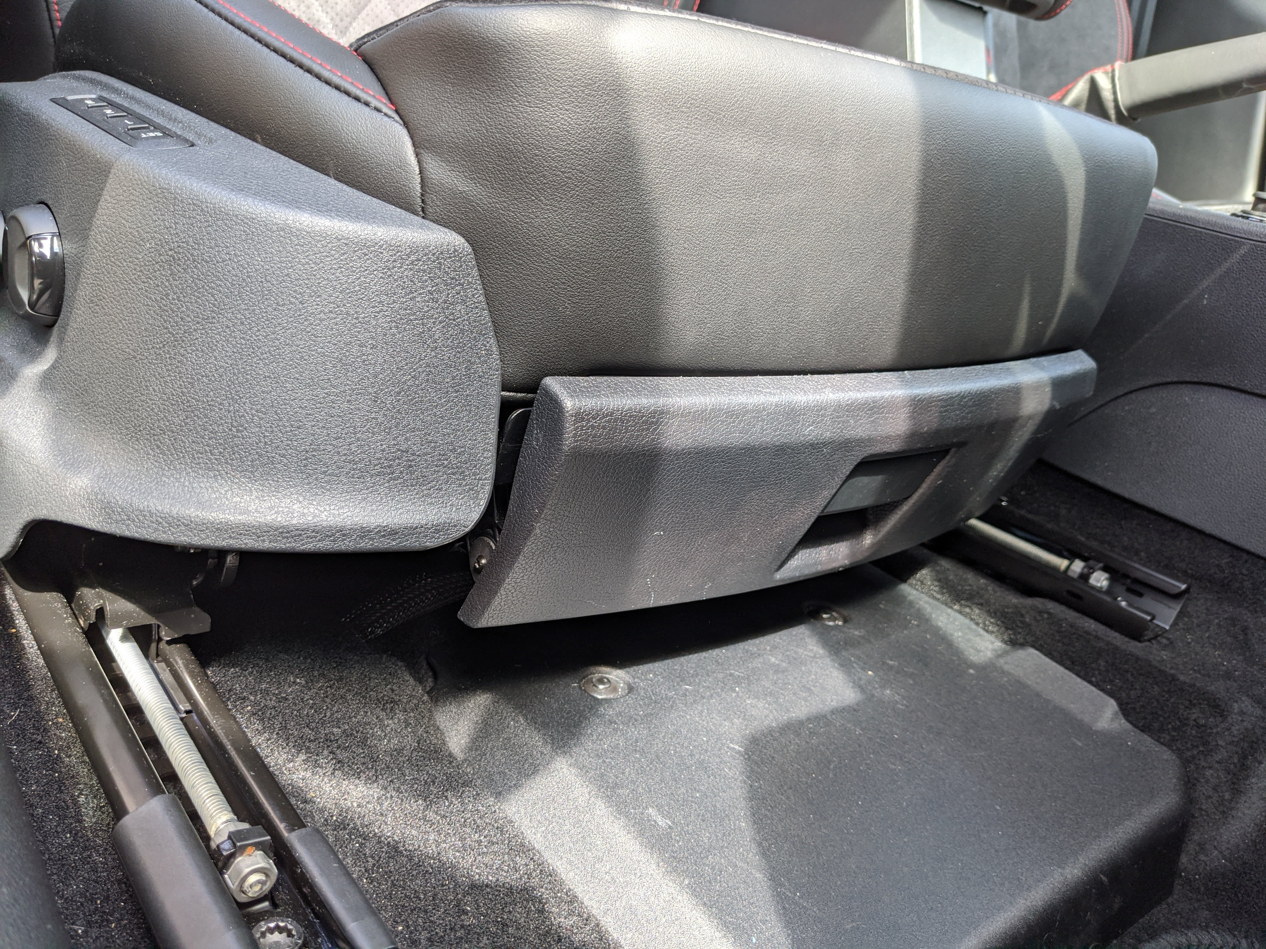

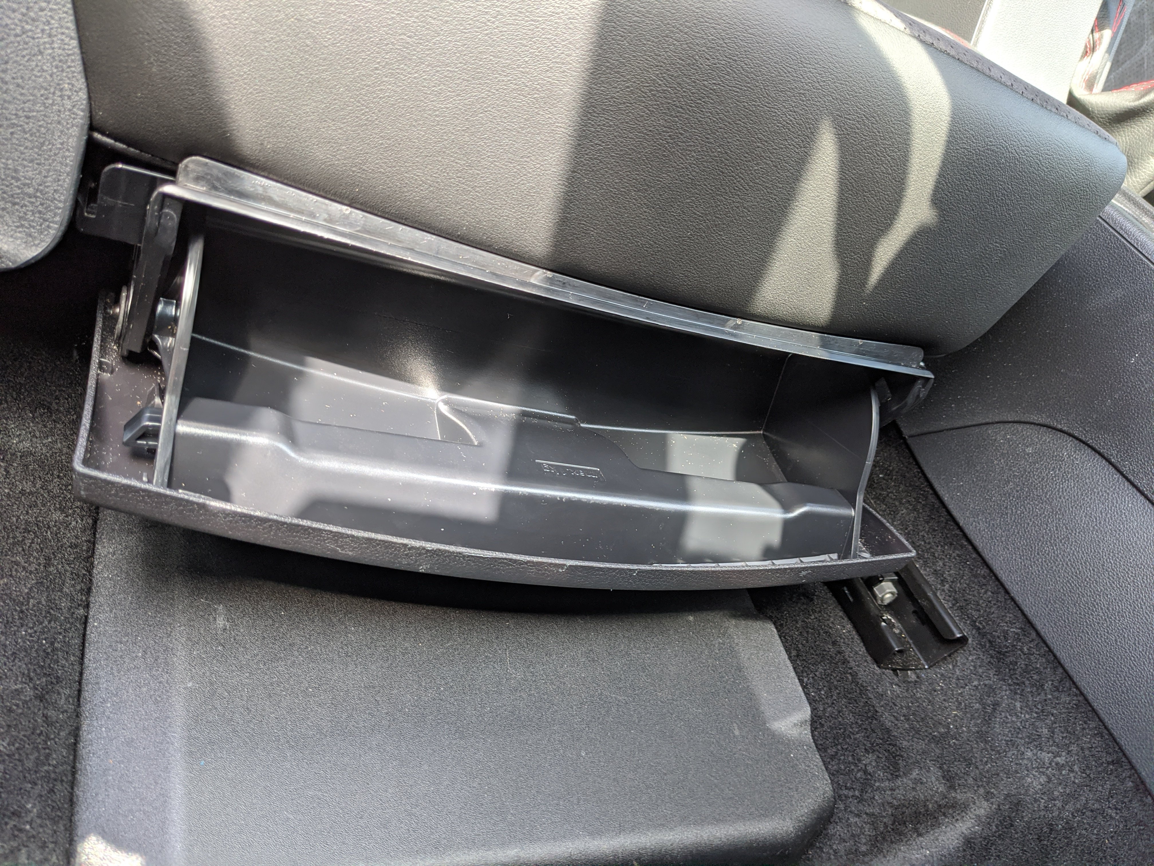

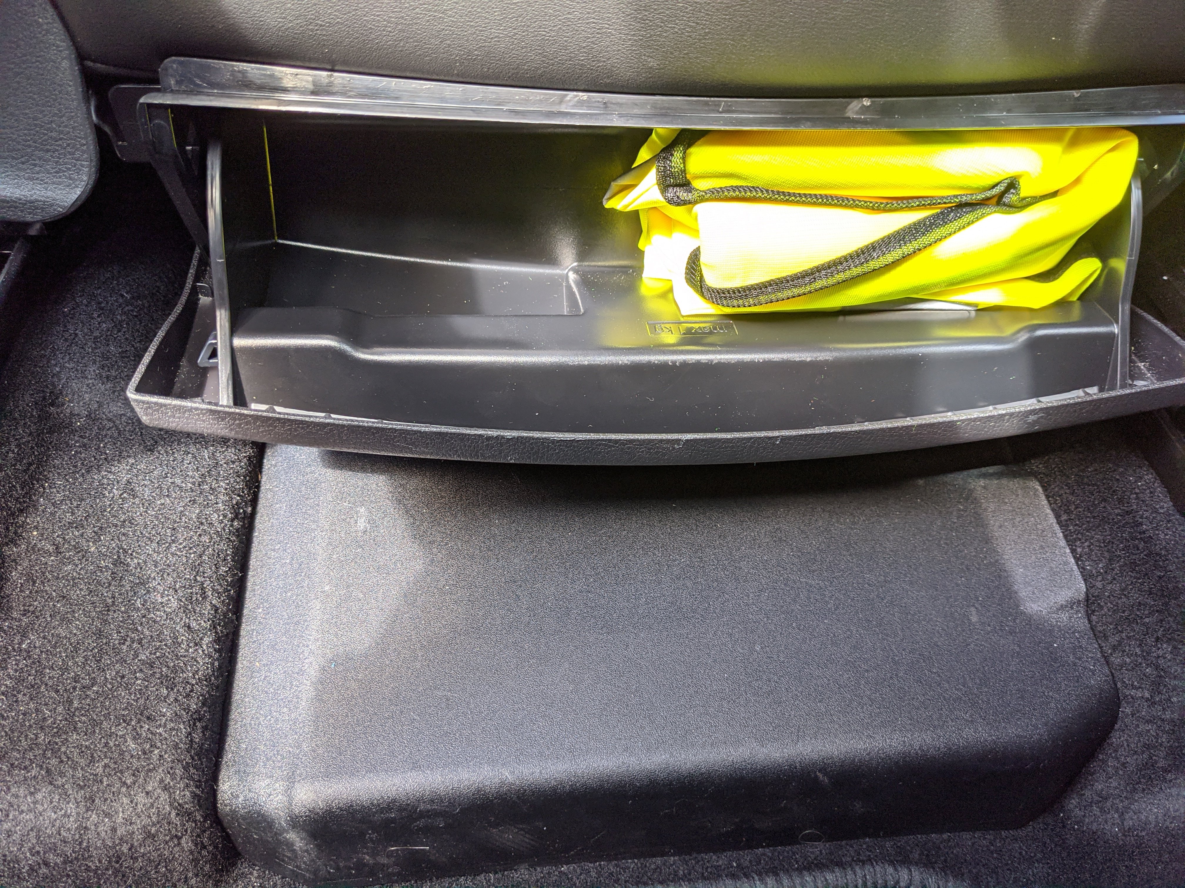

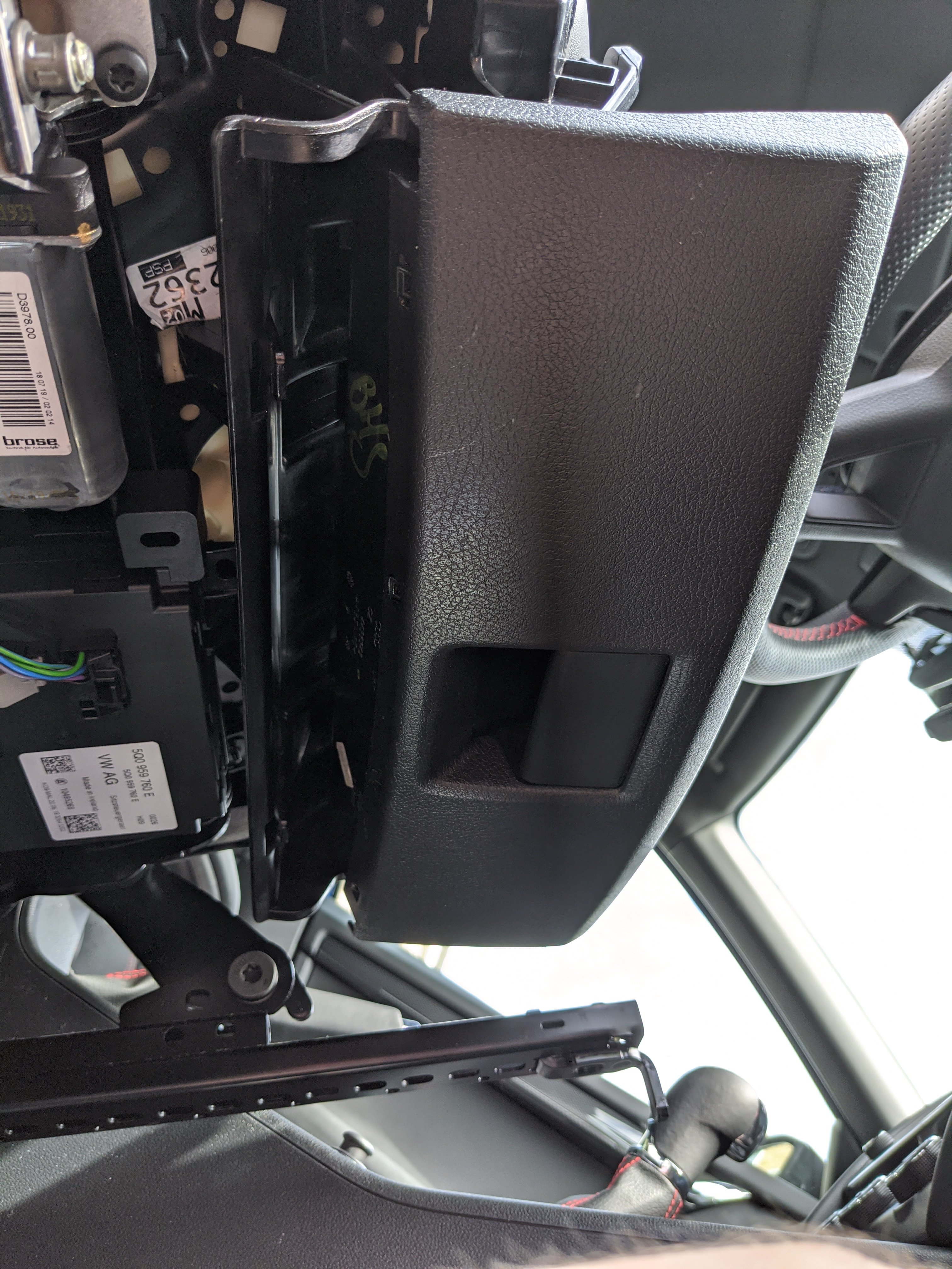

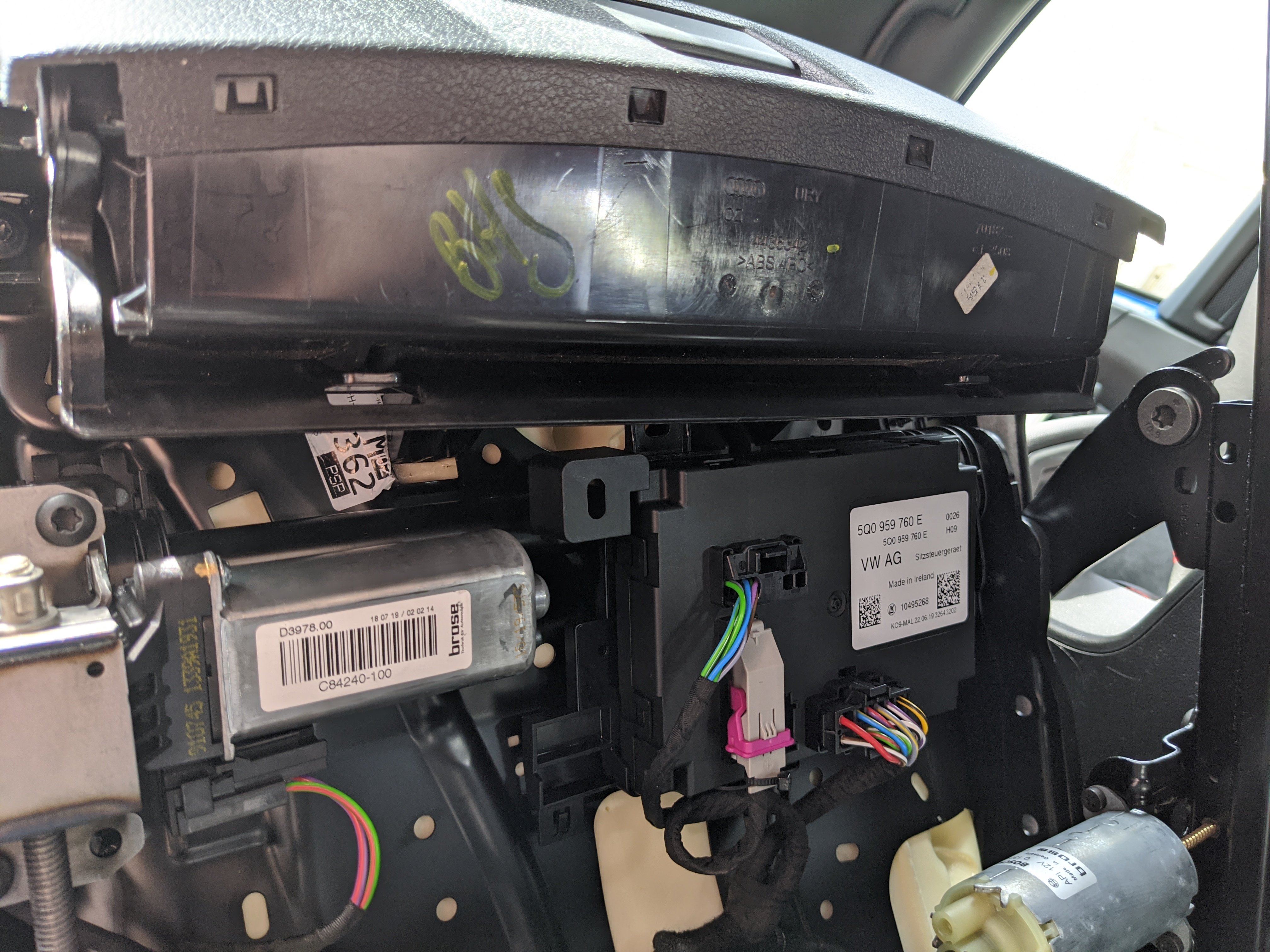

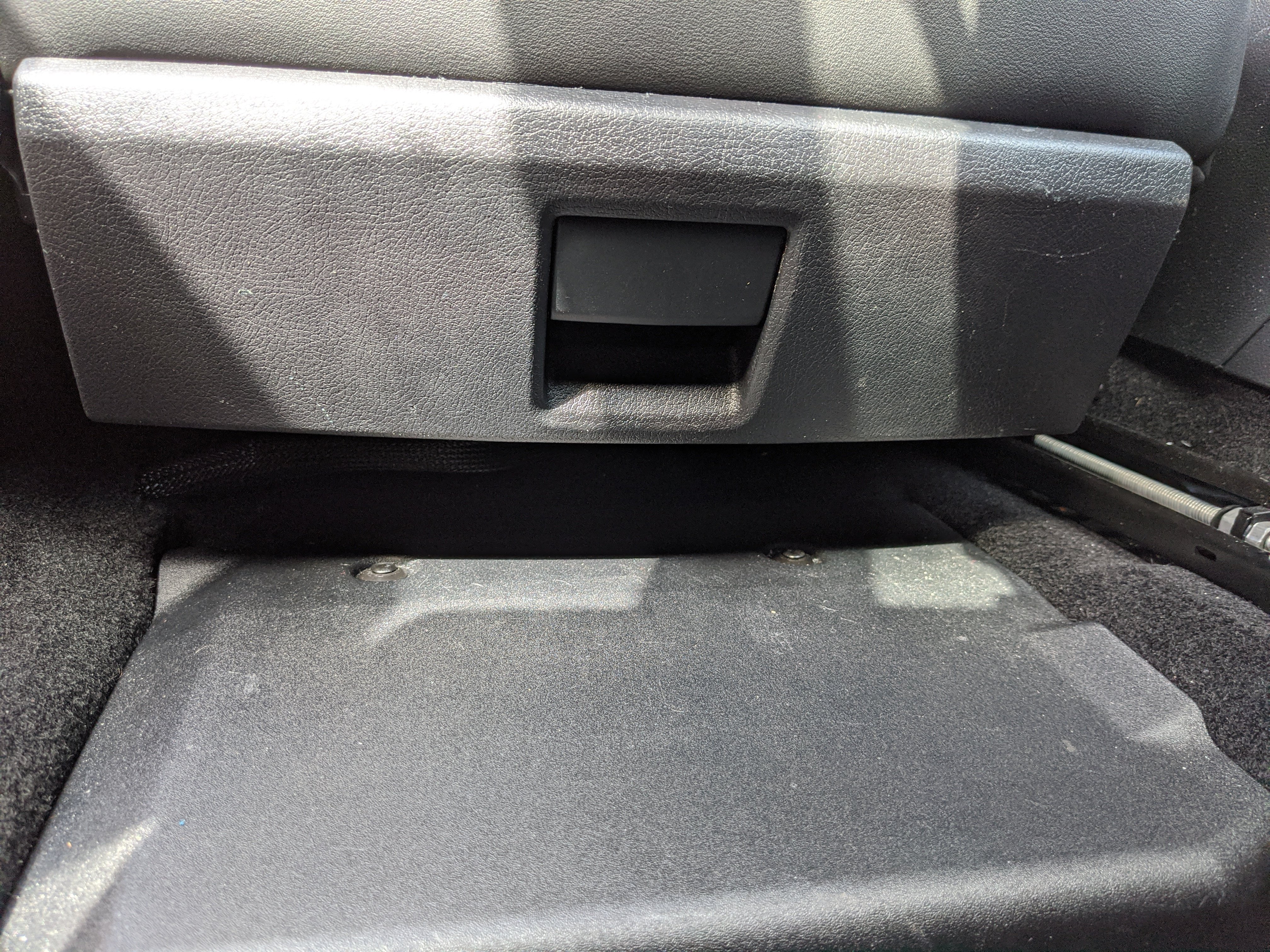

I've installed an Audi Q3/Q5 box (8K0 882 601 C)  today on my vRS electric seat with canton. Fits into the base with 2 keyed slots and 2 speednuts/bolts required. I think this is probably the best compromise, it'll hold the umbrella or a couple of adult high-vis vests for continental trips, so suits my requirements.
It fits well as long as you have the seat base tilted back a little. For reference, my seat is adjusted all the way back, as low as possible and seat base pitched back in the photos shown below. It would physically fit and still open with no tilt, but would just brush the carpet at the sides - so with an amp needing some airflow, probably not advisable if you are short!
The genuine part is fairly expensive new and not that common on ebay. There are loads of copies(?) on Aliexpress though, under the Asian market part number 8KD 882 601. I've put this used box on my driver seat and have ordered one of the 8KD parts from China now, to fit to the passenger side.
