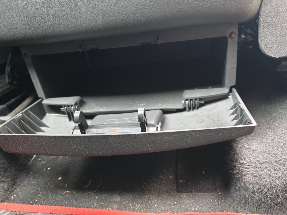

Mine was fitted when I got the car a month or so ago, it is probably the size to fit the manual / service pack etc.
While I was taking the picture I noticed the drivers seat has a holder for a high Viz vest

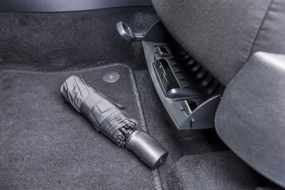

The Octavia umbrella holders are enclosed, like this
The one you have linked won’t fit, I took the one out of the Citigo and tried it, the seat rails are wider on the Octy. I’m thinking LHD umbrella holder to go under the drivers seat then I have the box under the passenger seat and an emergency umbrella under the drivers seat.

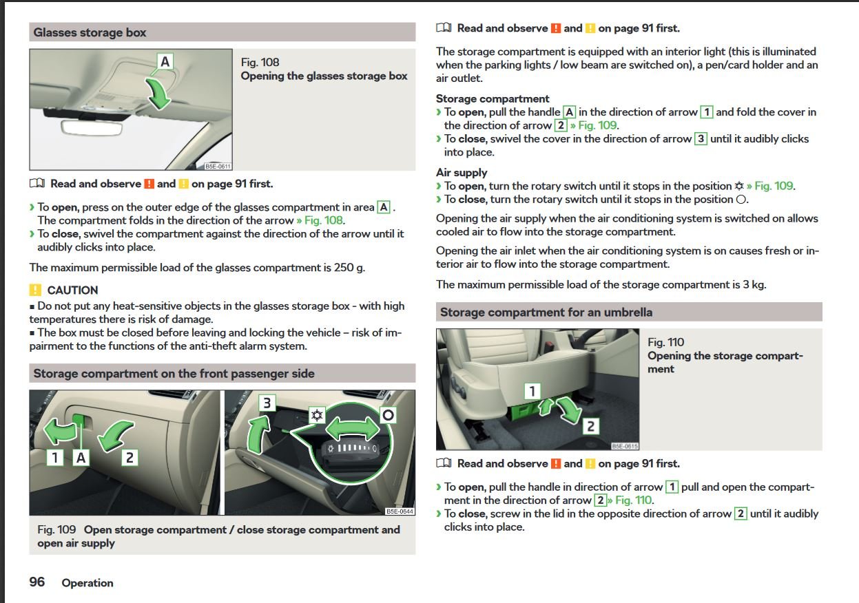

When I asked the dealer about this the first response was "you don't get an umbrella with electric seats".  I thought this odd and went on the web where I found several photos showing the umbrella in a holder beneath an electric seat. Unfortunately all the pics, including the drawing in the on line manual page 96, are for electric seats in a left hand drive car.
Has anyone got a RHD car with an electric front passenger seat with an umbrella stored beneath that could post a photo for me. Better still a link to the part numbers. The link above is for a manual adjusted chair and I am not sure if the parts would be the same.

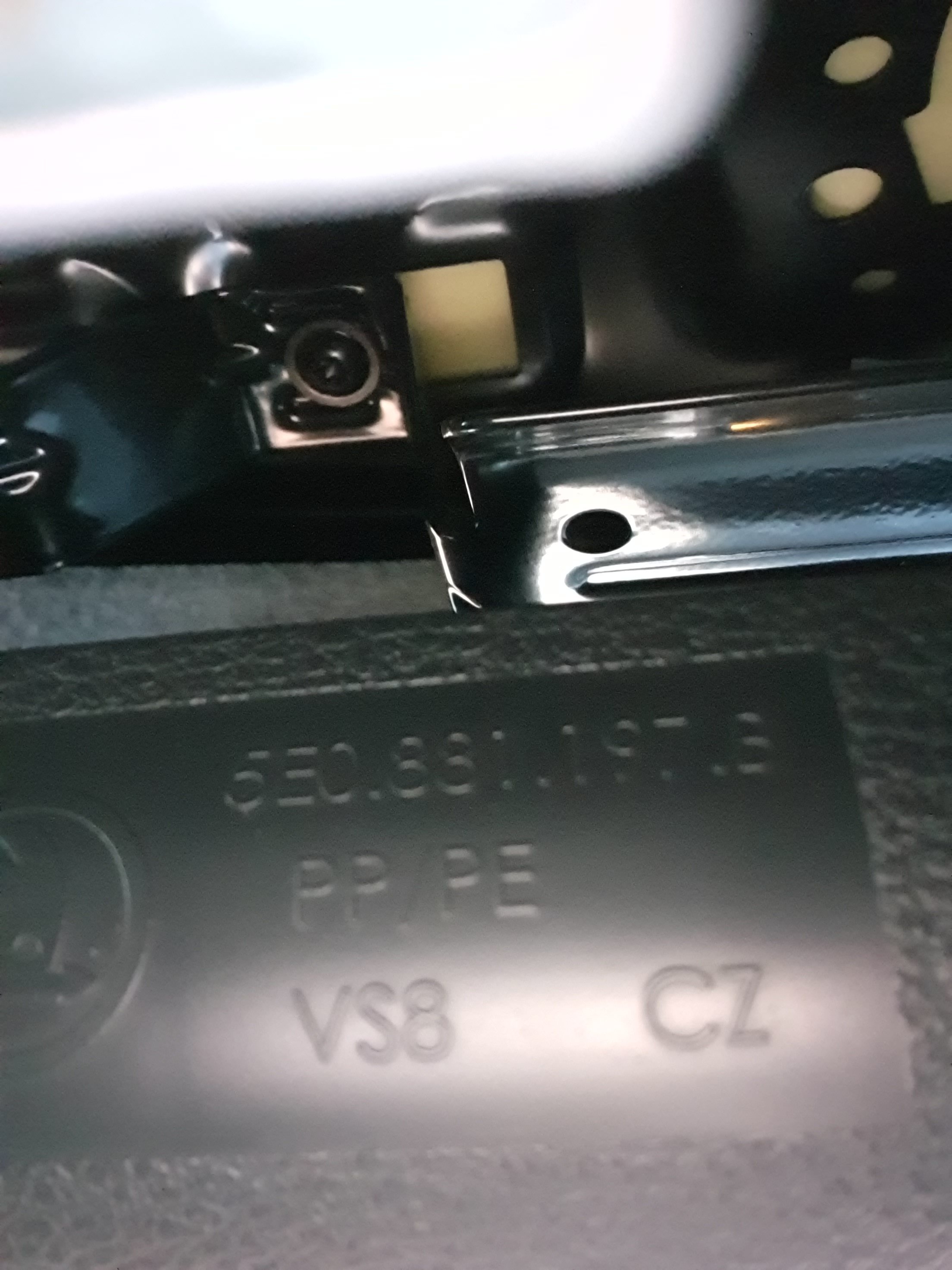

Errr. Not really much to photo but, I can definitely say, it's not handed, it will fit either seat. I haven't removed it (due entirely cos some complete & utter bellend wanted a 30kg combination microwave delivered to their 2and floor flat today) but, I can't find any part  numbers on it

@SashaGrace finally after a soak in the bath my back let me find enough agility to photo the part No. I think
@themanwithnoaim thanks so much for that, that’s the right number and 5E0 makes it universal so it’s not sided. Awesome, will get one of those ordered ASAP.

Hi there, any chance of a photo of the passenger seat please.  According to the Superskoda site the ones they sell are for manual adjusted seats only and won't fit the electric seats.  From what I can see the canton amp does not seem to be high enough to get in the way but it would be nice to see a pic so I can show the dealer who doesn't seem to know very much.

5E0 881 197 B 9B9 — the plastic "shelf" itself (number for black)
5E0 881 646 B — a metal bracket that is screwed to the seat, a shelf is inserted into it
