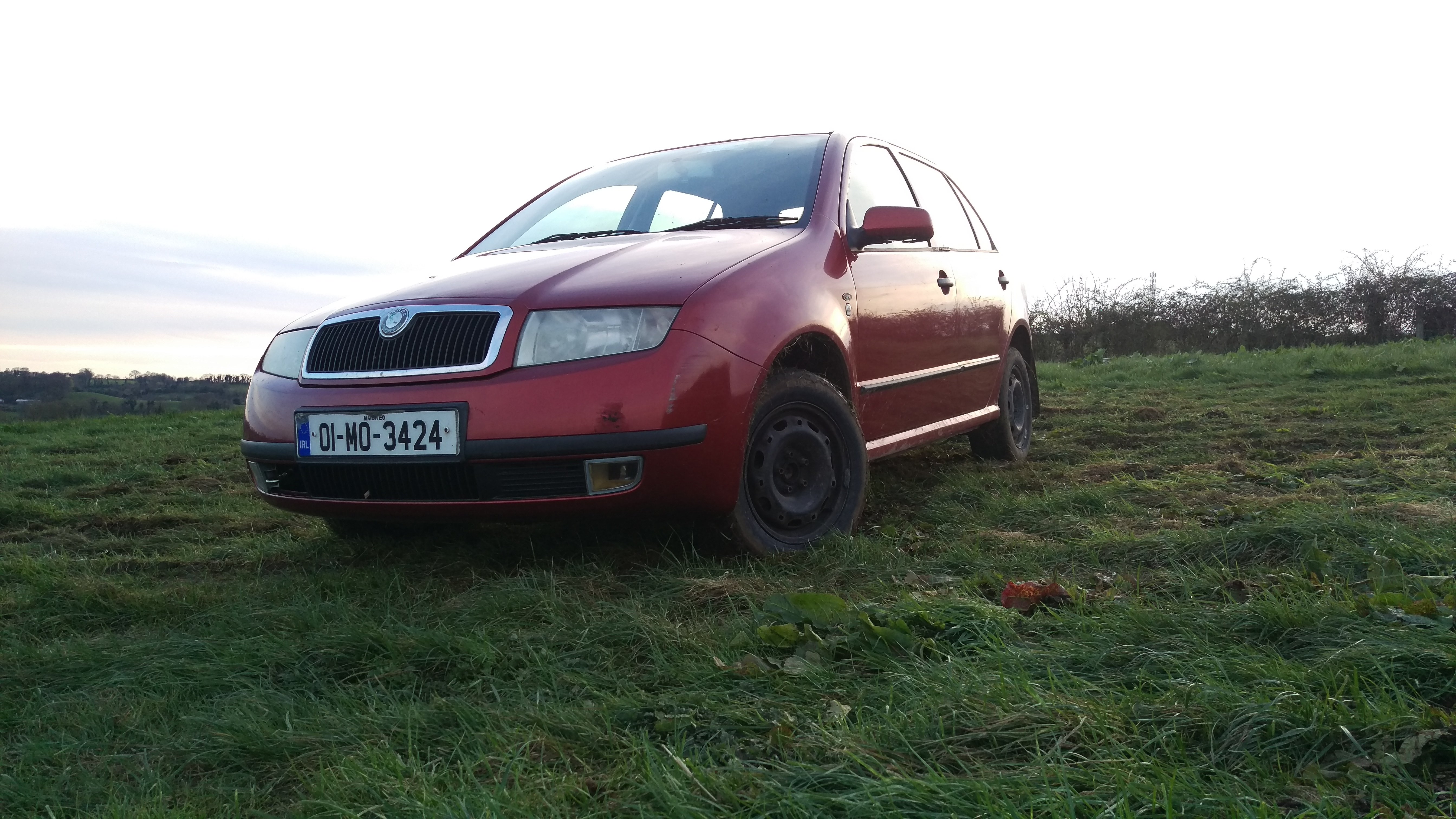

    So finally took it for its first spin outside in a long time. It runs, and drives. Had an issue where it died, not sure if it's the battery that was in it (very possible) or a charging issue. Wel

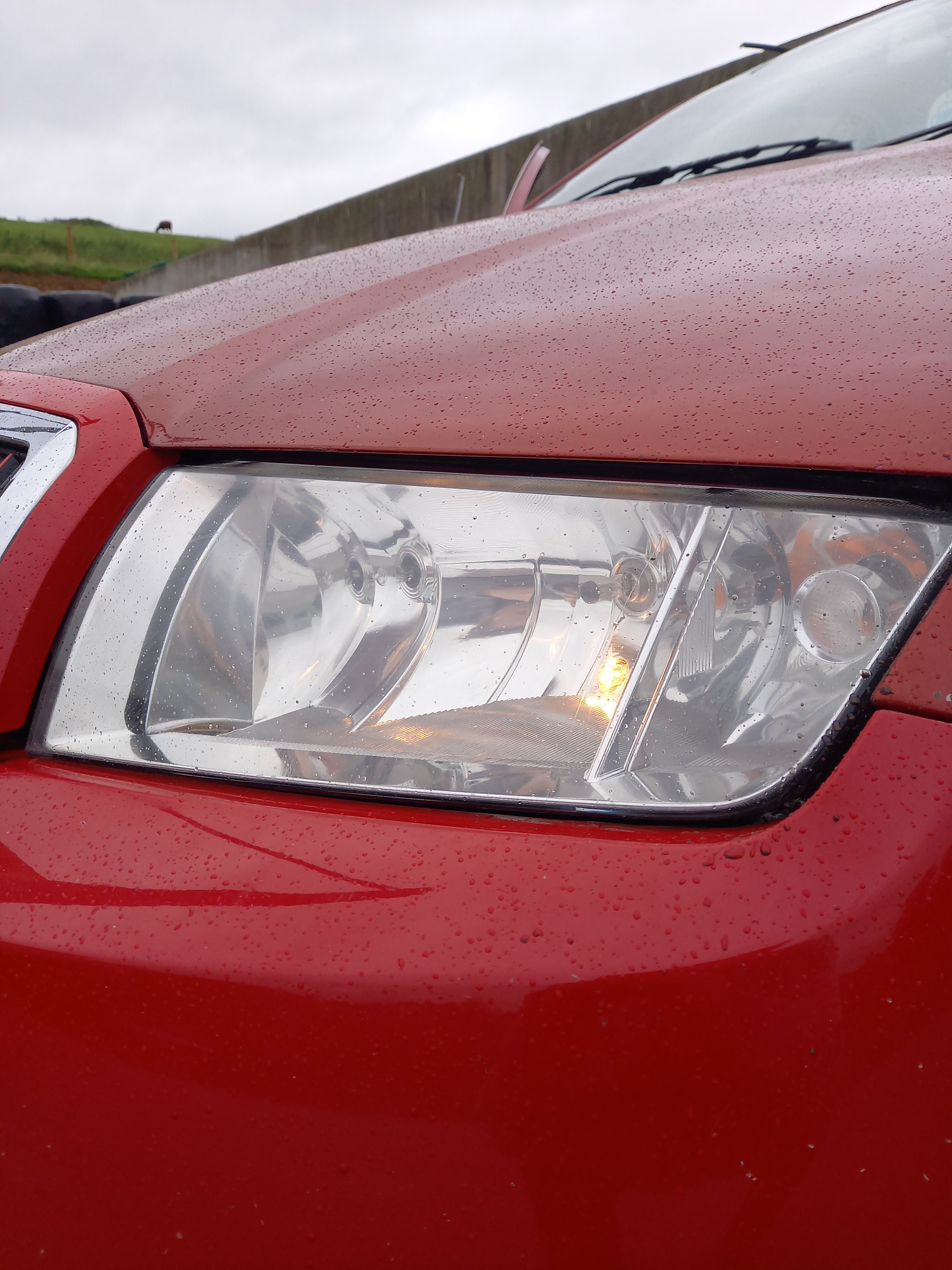

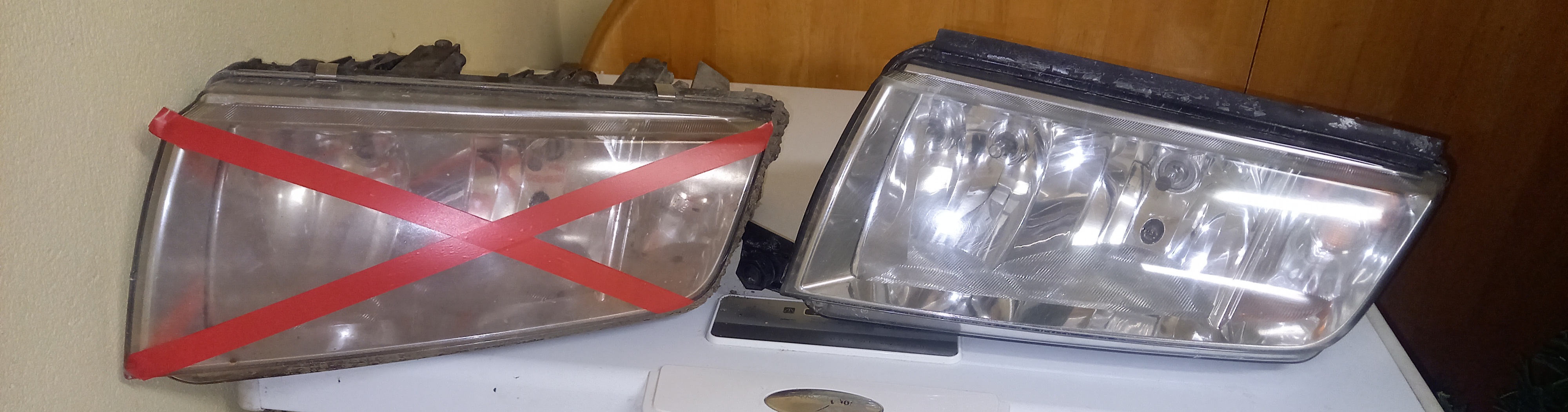

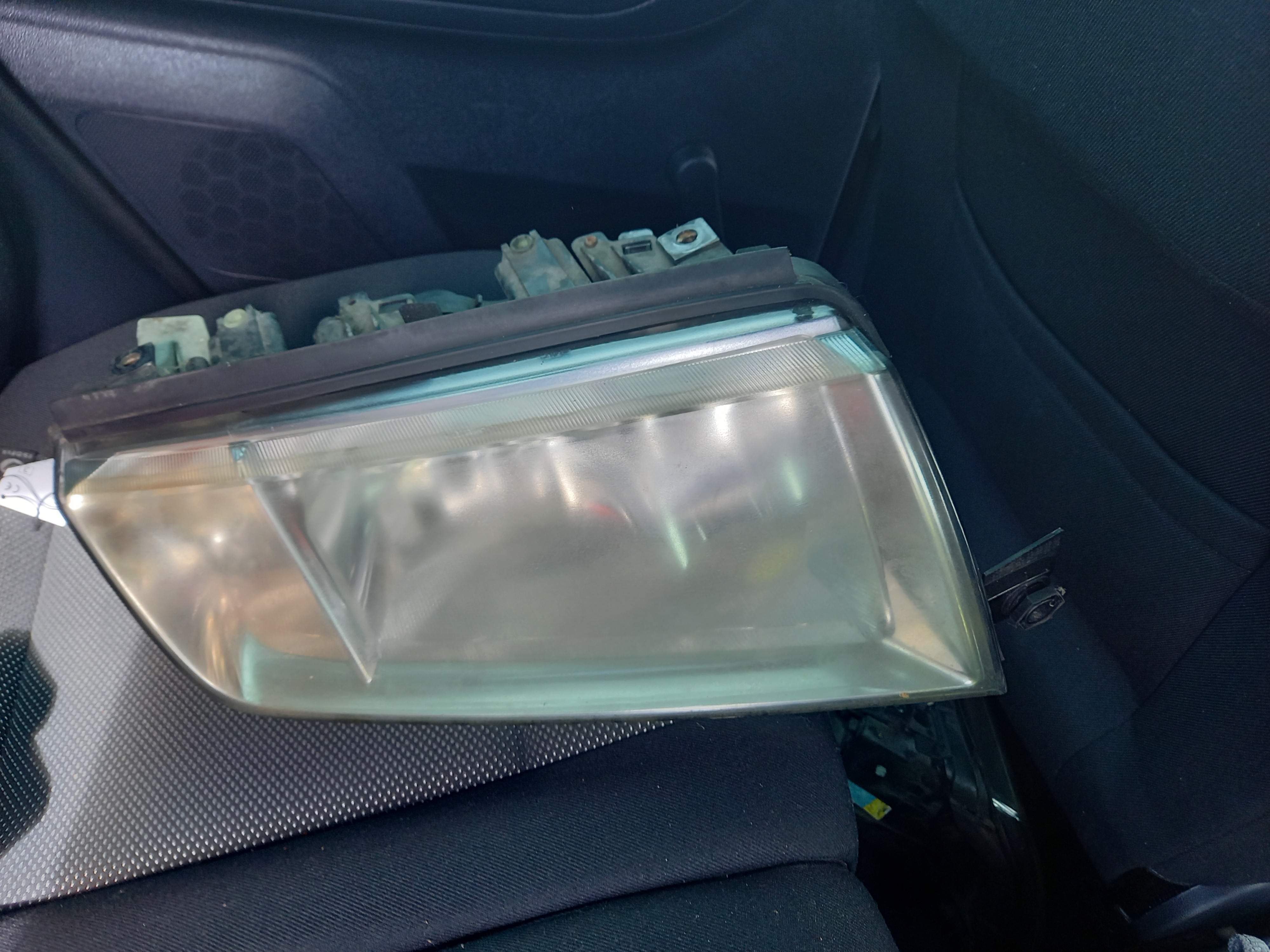

Was down the country and picked up some lights for the mk1. Initially I wetsanded them and clear coated them, only to have the clearcoat crack and craze on me. Great. Had to sand all off and go back up the grits to 2500. Then I polished them up as good as I could get them. Far from perfect but they are a decent improvement over the old ones. I broke one of the tabs on the passengers light as I put them in the boot at first and they started sliding around because I have a trunk liner in the mk2, my mistake. Bit of superglue sorted it.
Anyhow, they're a bit fiddly to fit and the connectors were giving me trouble fitting them. The passengers light kept the indicator on instead of the main beams, maybe some sort of failsafe if the car thinks both bulbs are bust? I like the look of it if i'm honest. If I could wire them to work in tandem with the sidelights (and still work as indicators) I would.

Headlights done and dusted, working 100 percent. Drivers main bulb was broken, so I nabbed one off the original lights, same bulb happily.
Far from perfect but more than good enough for now. Still, another BIG item off the list.

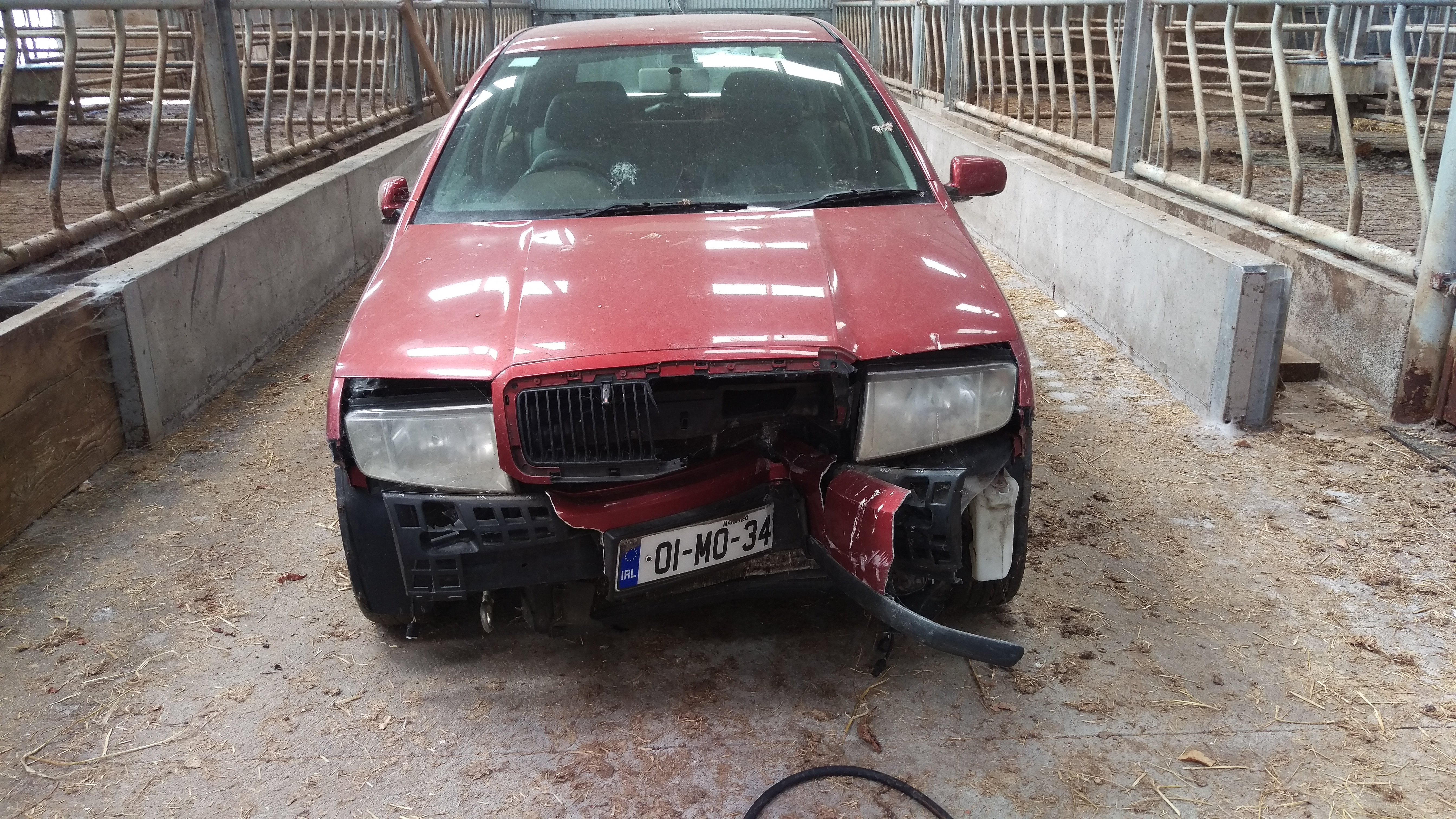

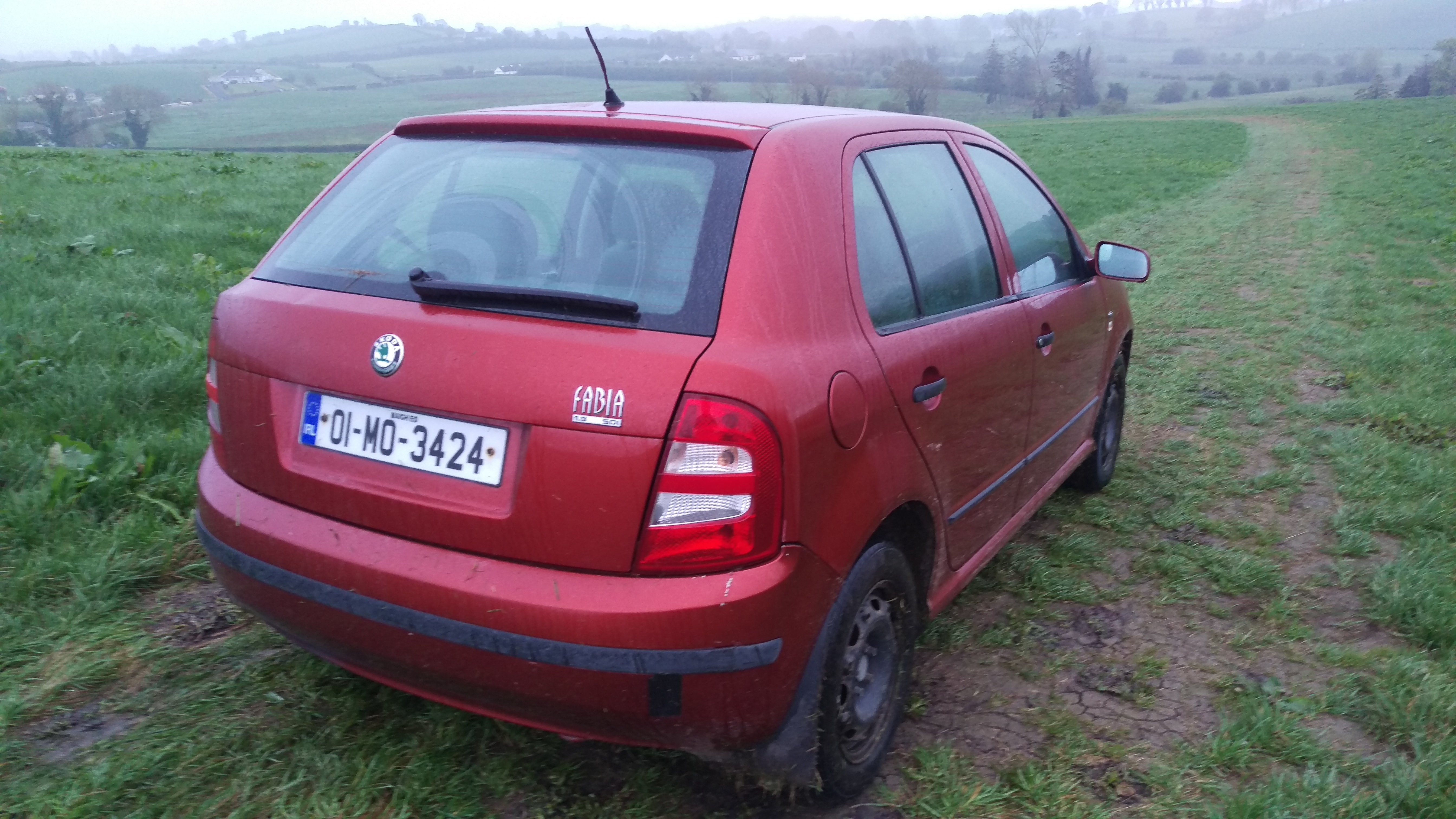

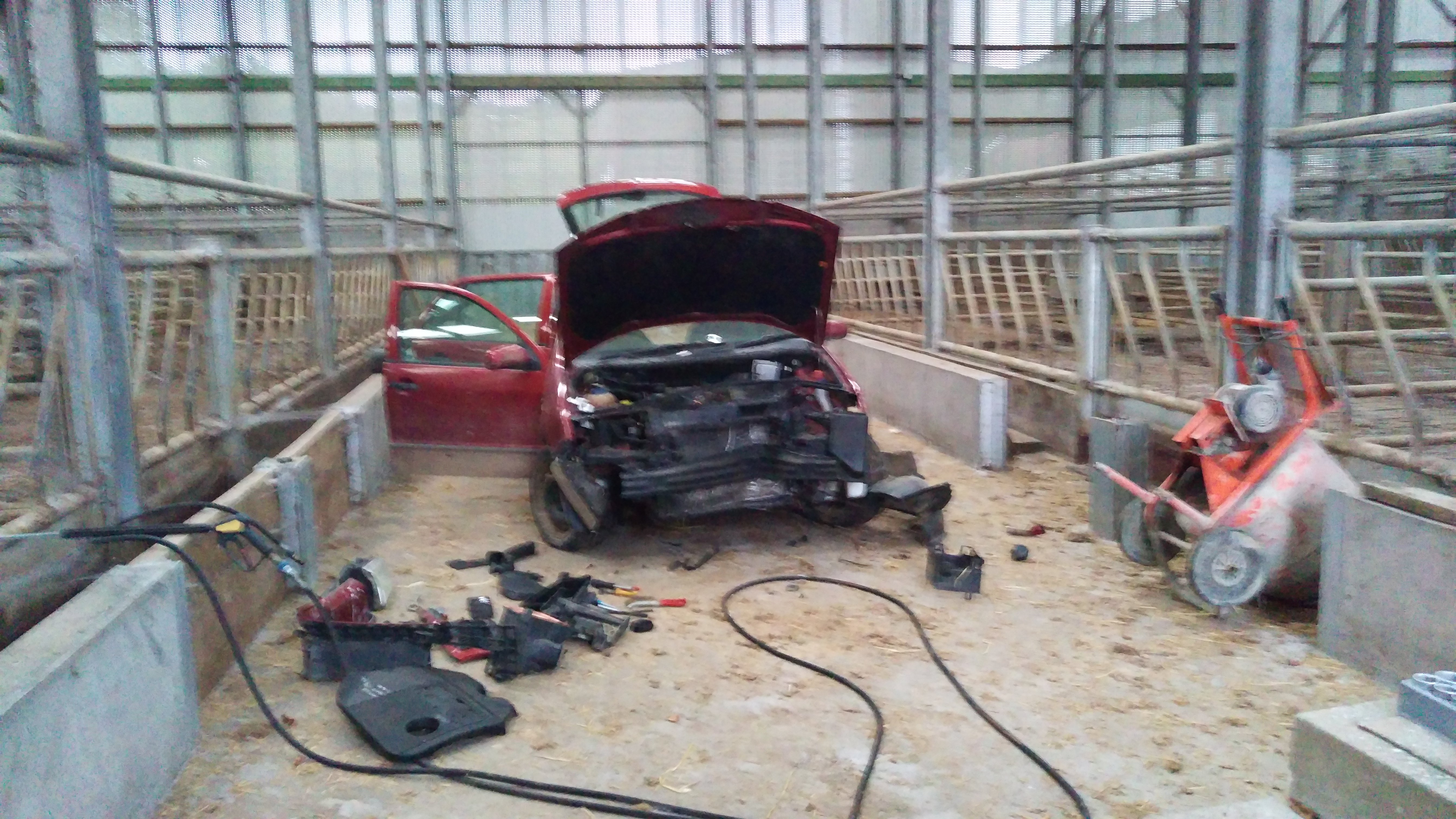

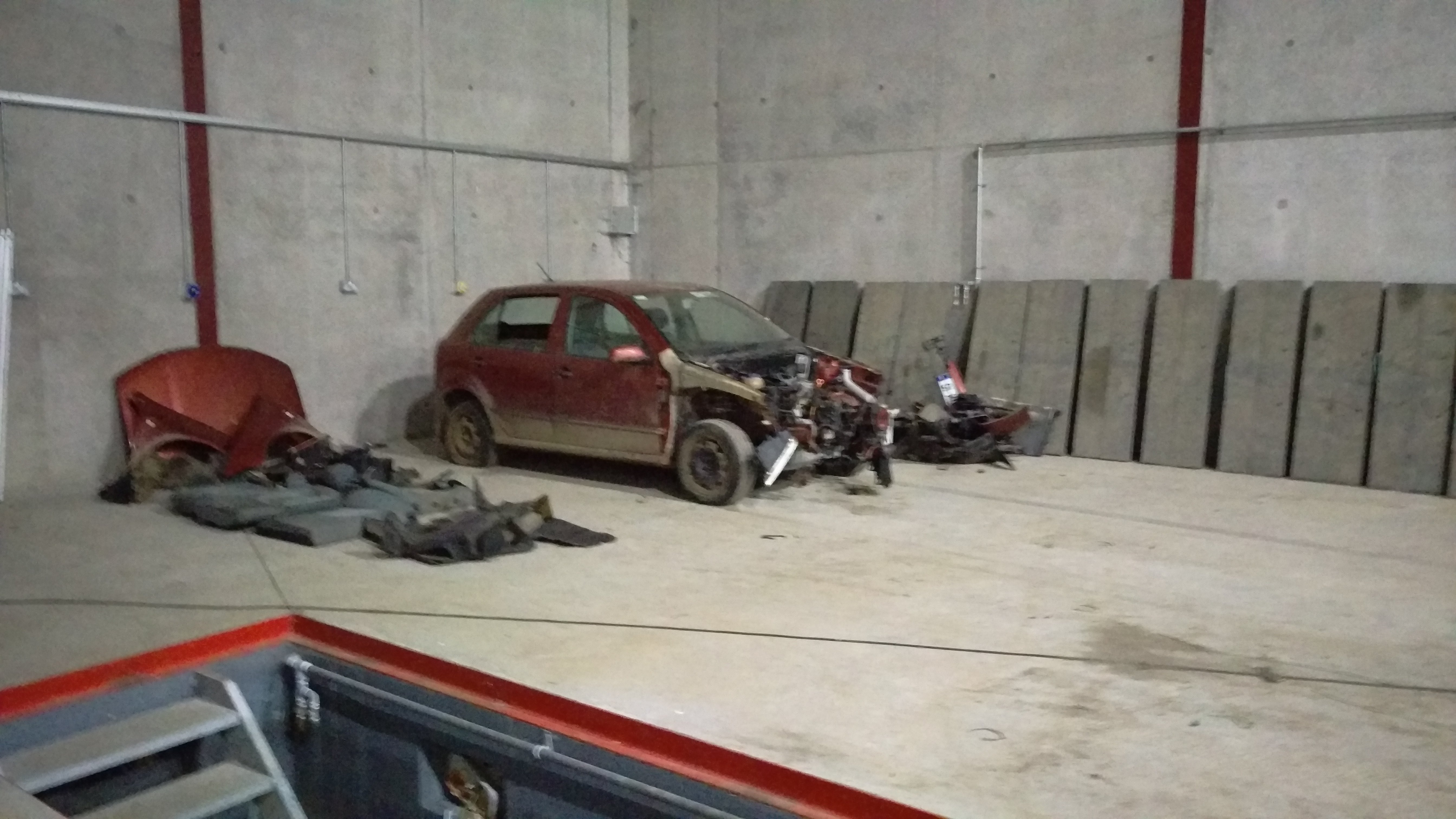

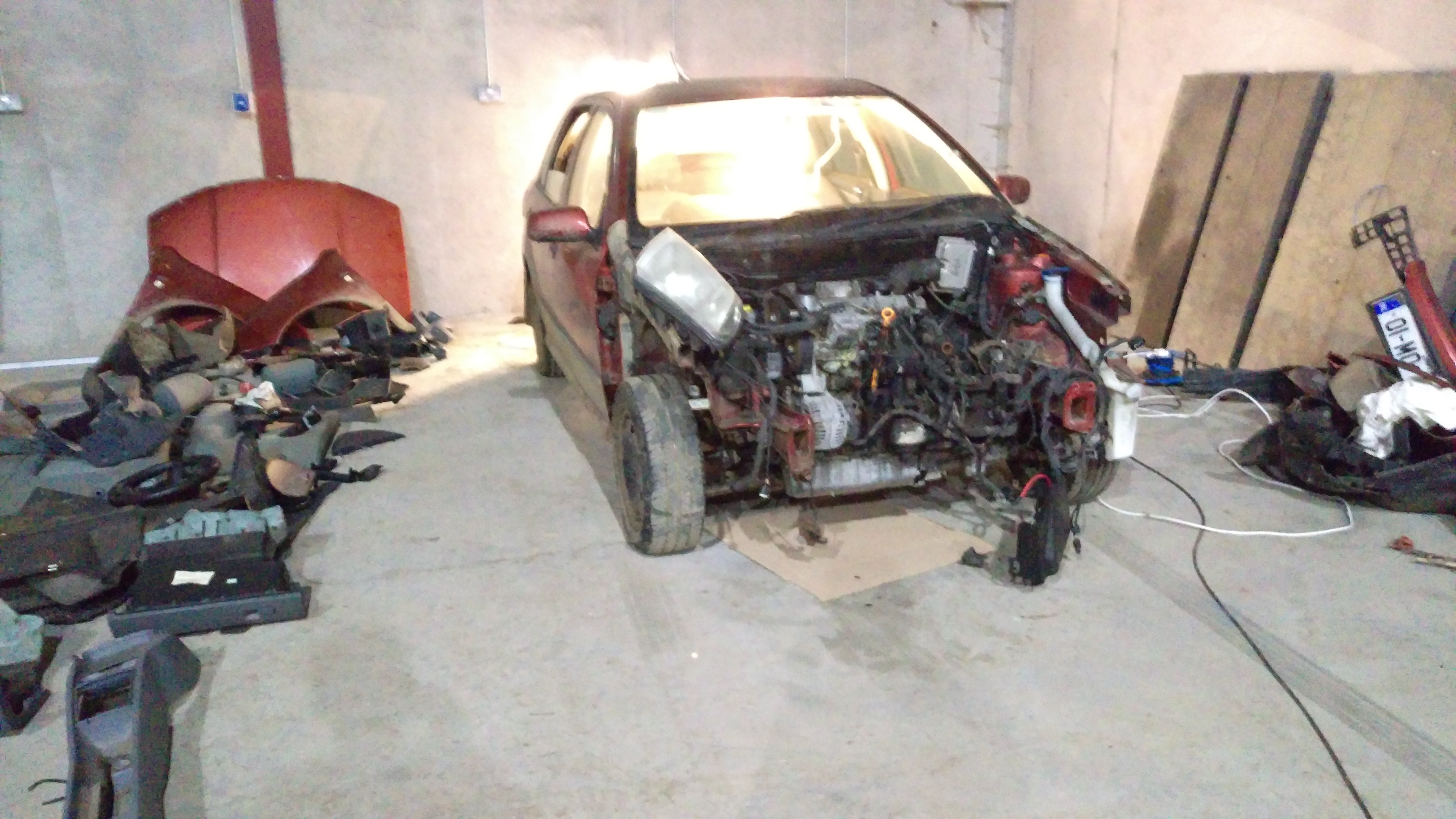

Found a few pics I took when I first got the car, and a few more from me putting it back together. Felt I may as well upload them here. For a 100 euro junker its proven itself to be as tough as a brick wall, rather a concrete drinker given thats what I hit. Trust me, the drinker lost that fight.
Not sure, some of these might have been uploaded before.IMAG0064-1.thumb.jpg.2bda1e73b004f86a1983e07b59d35292.jpgIMAG0065.thumb.jpg.74f4e2d897fe9e0ca34d35d5eacebe43.jpgIMAG0146.thumb.jpg.25fcc071c63b0dca0d0294207165562c.jpgIMAG0149.thumb.jpg.11e0623fb527dd03aaf3d2b87ca3edb1.jpgIMAG0166.thumb.jpg.a35a9988e2a8a481de2bf6f767920c74.jpgIMAG0172.thumb.jpg.321712142e7d25dd4bd6dba64d5c1f8d.jpgIMAG0191-1.thumb.jpg.561112ed1fd52ff12ab69e9a15e95297.jpg

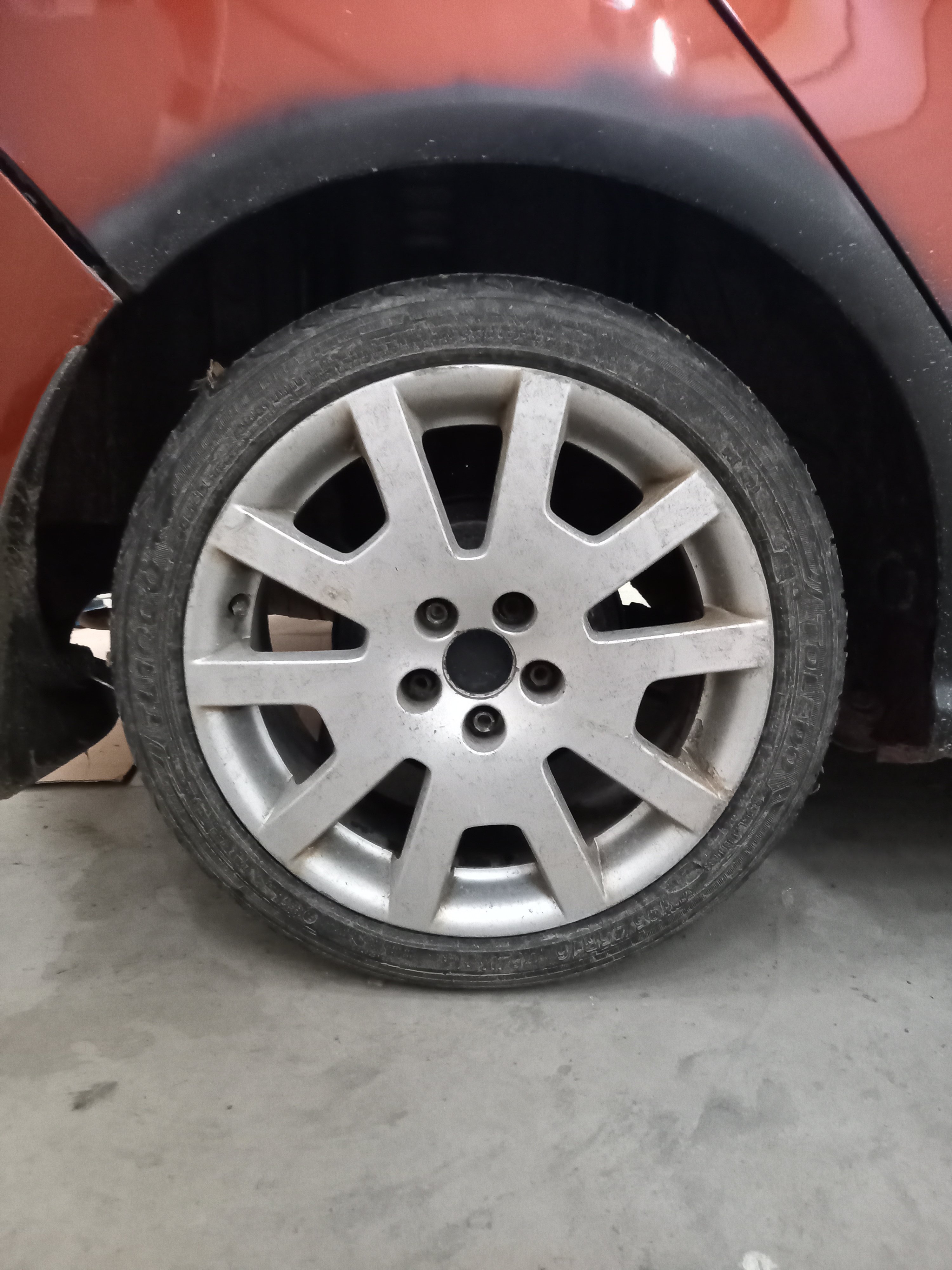

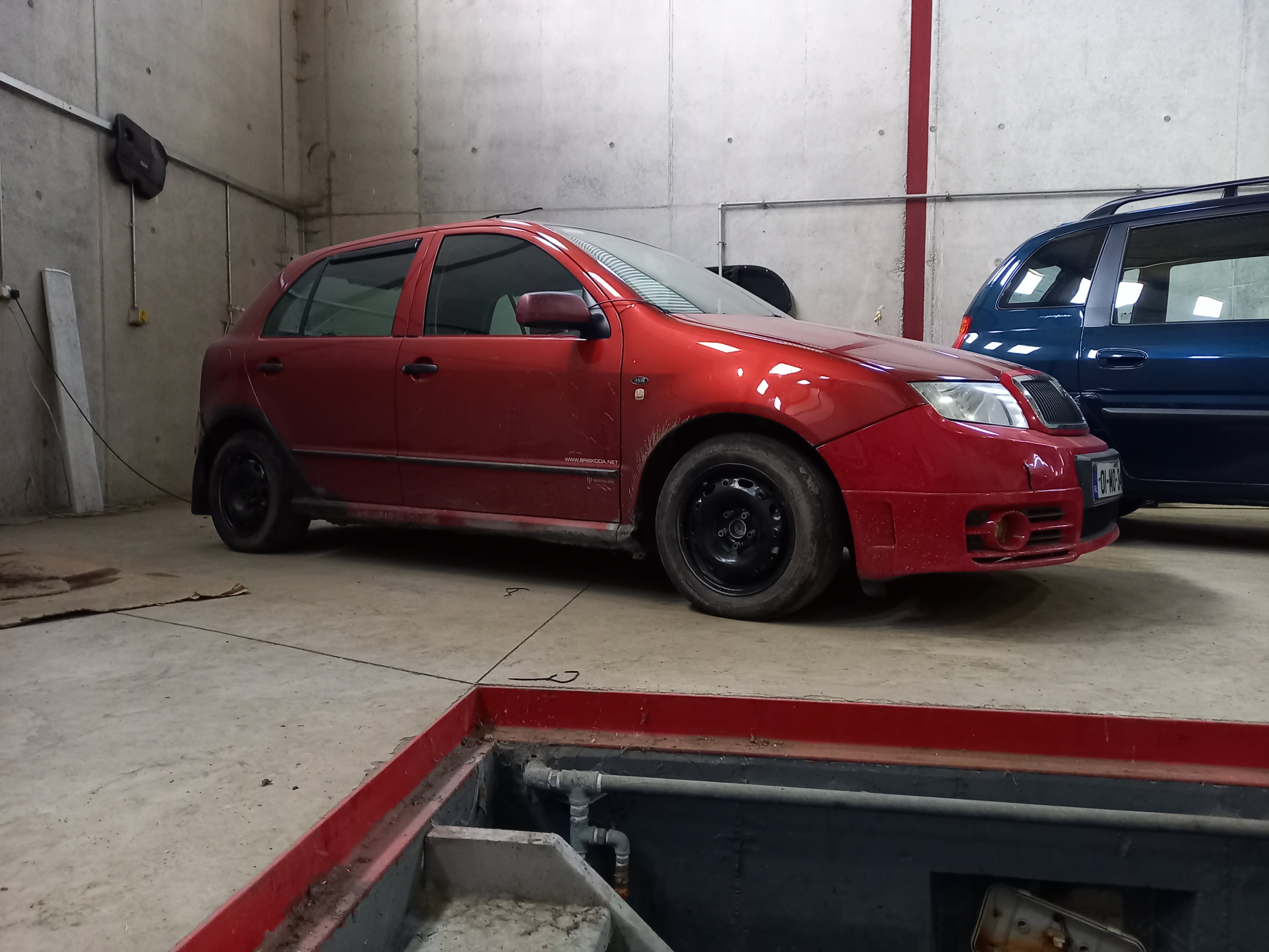

Back on Steelies for a bit,
Wheels taken off in order for me to do a bit of a refurb on the rims. The spyders will be going onto the Monte for Winter so naturally i'll use that thread to detail whats happening to them.

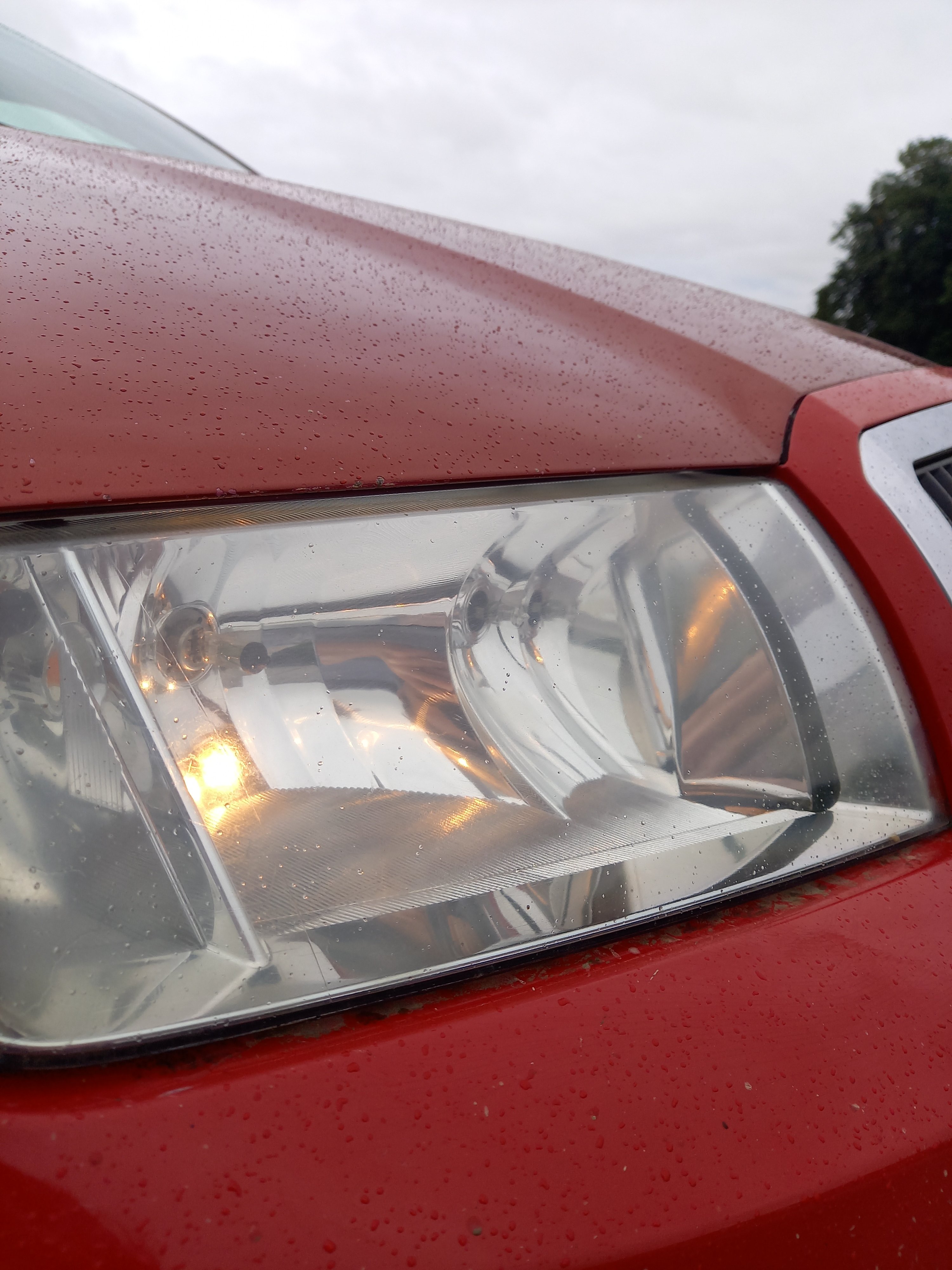

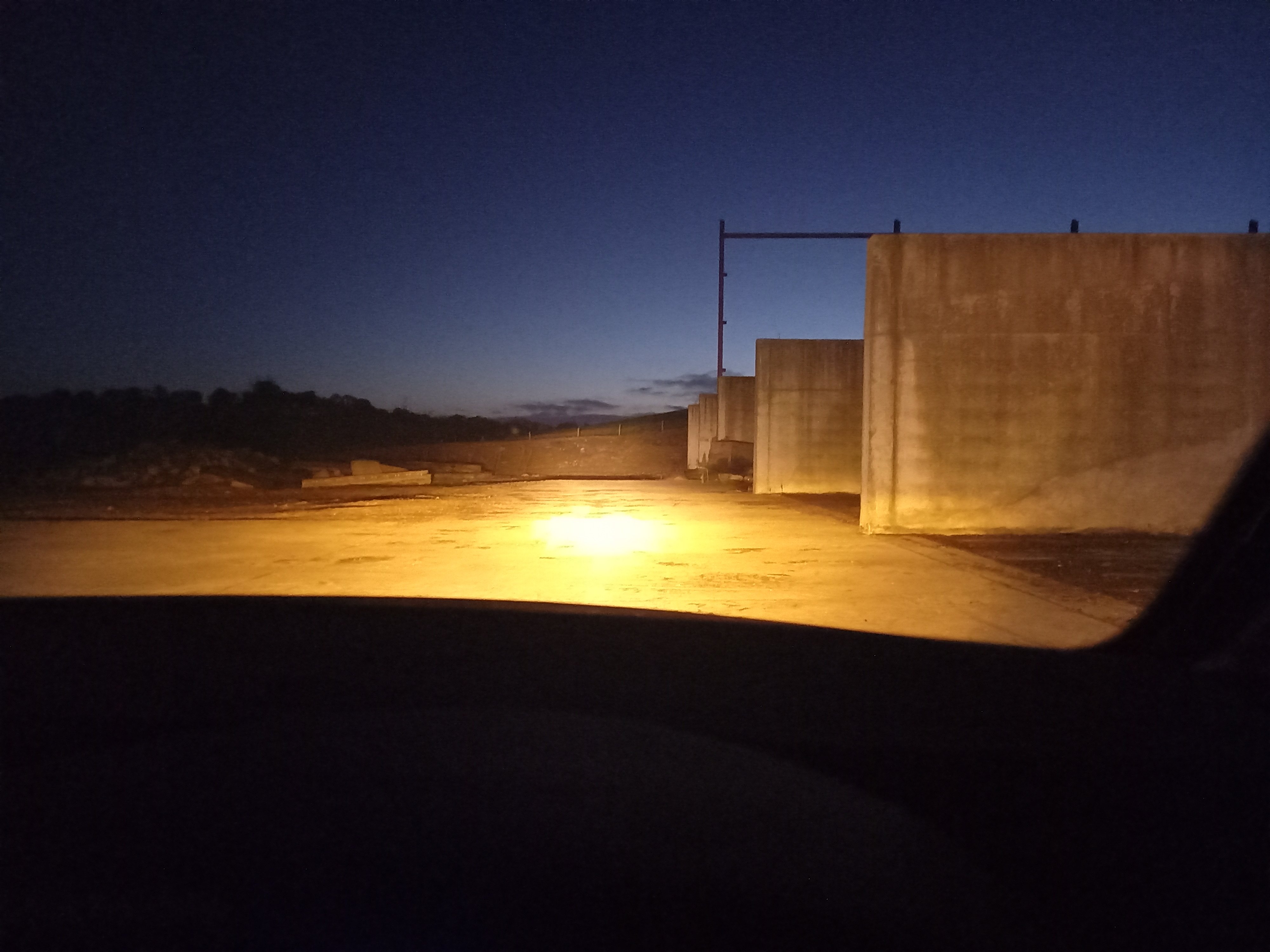

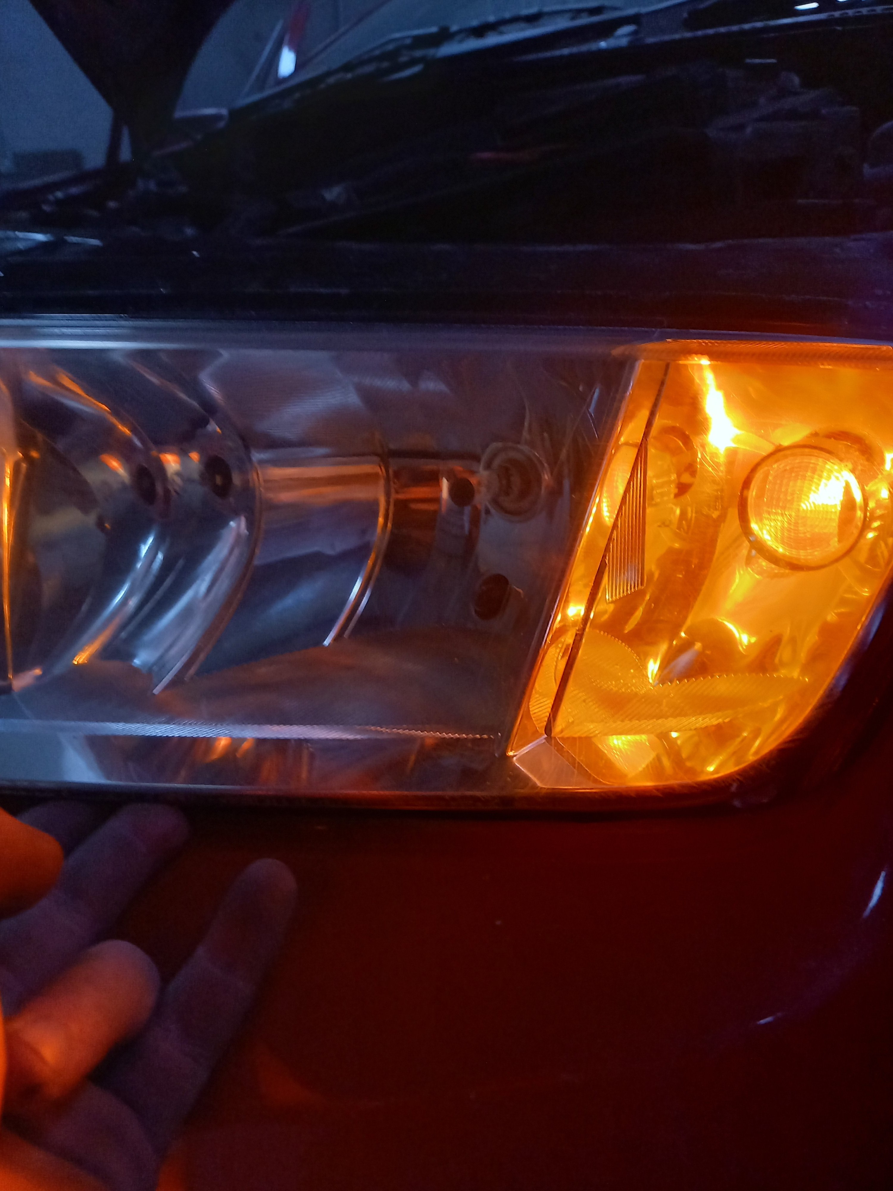

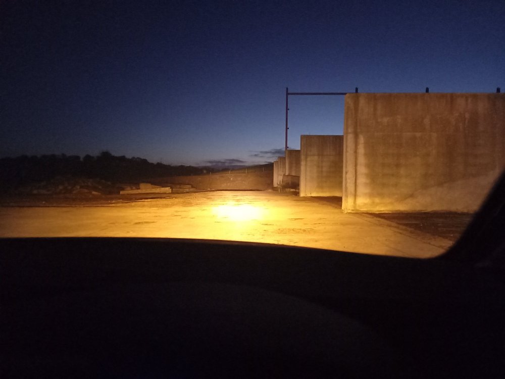

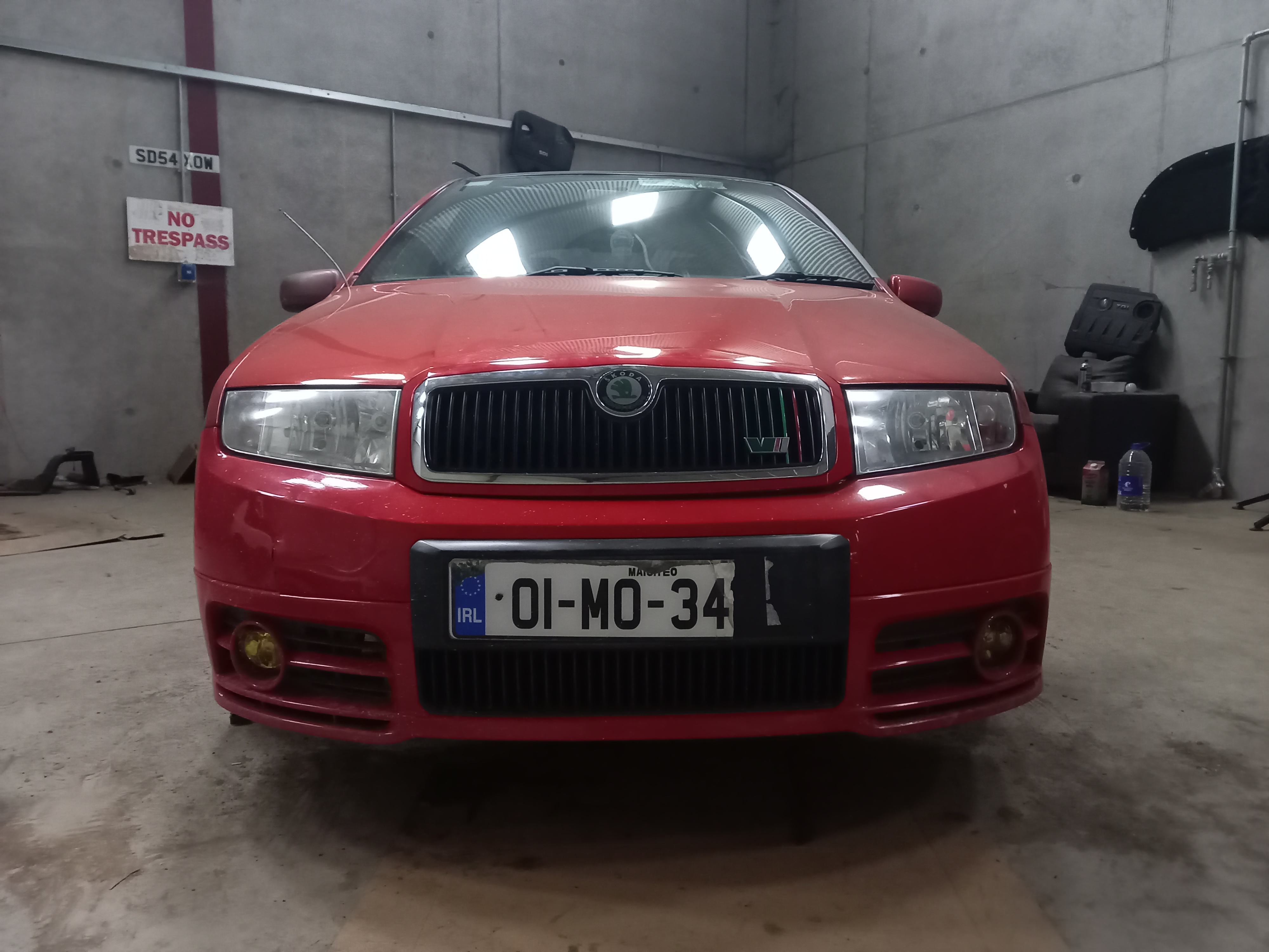

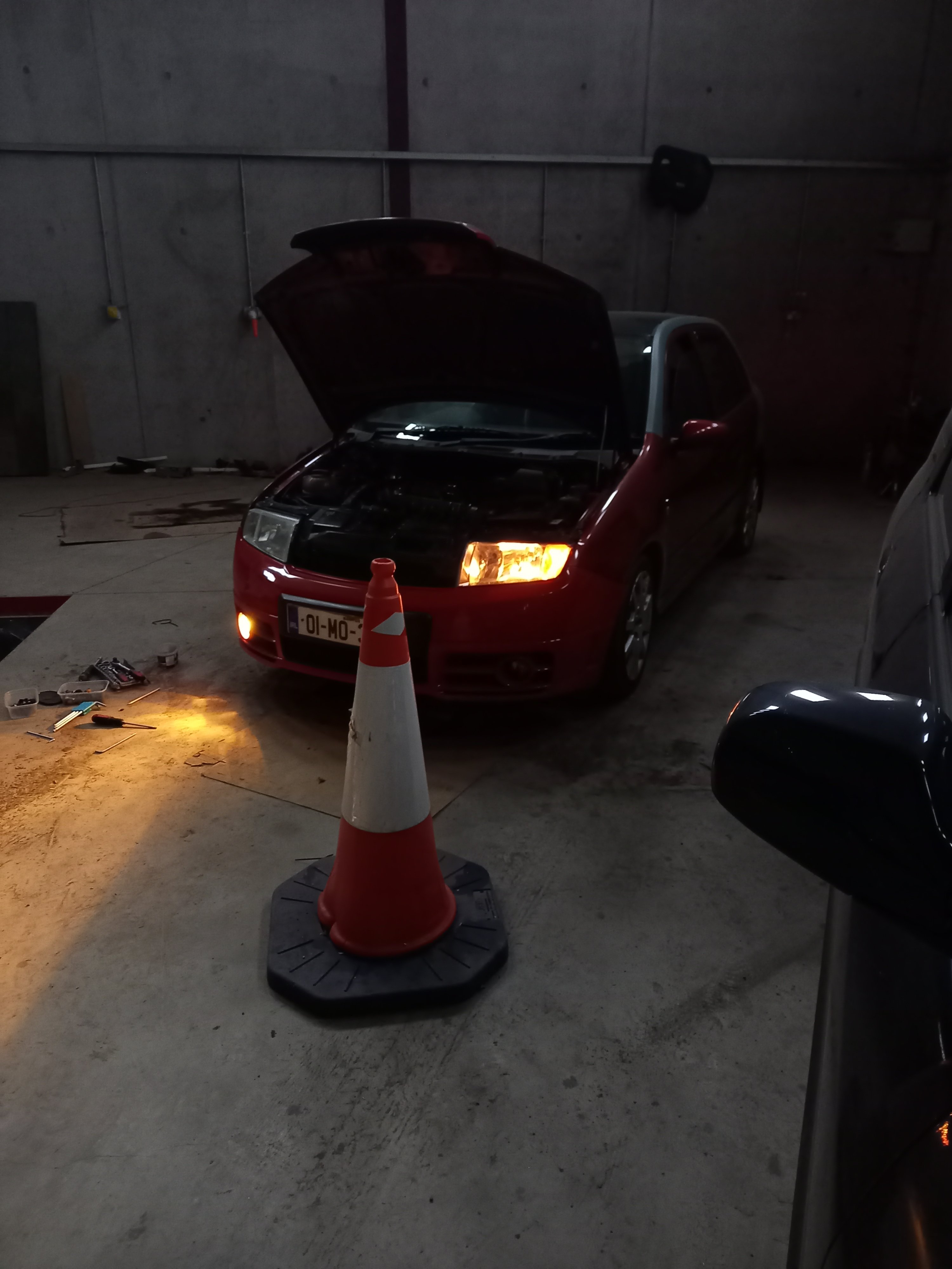

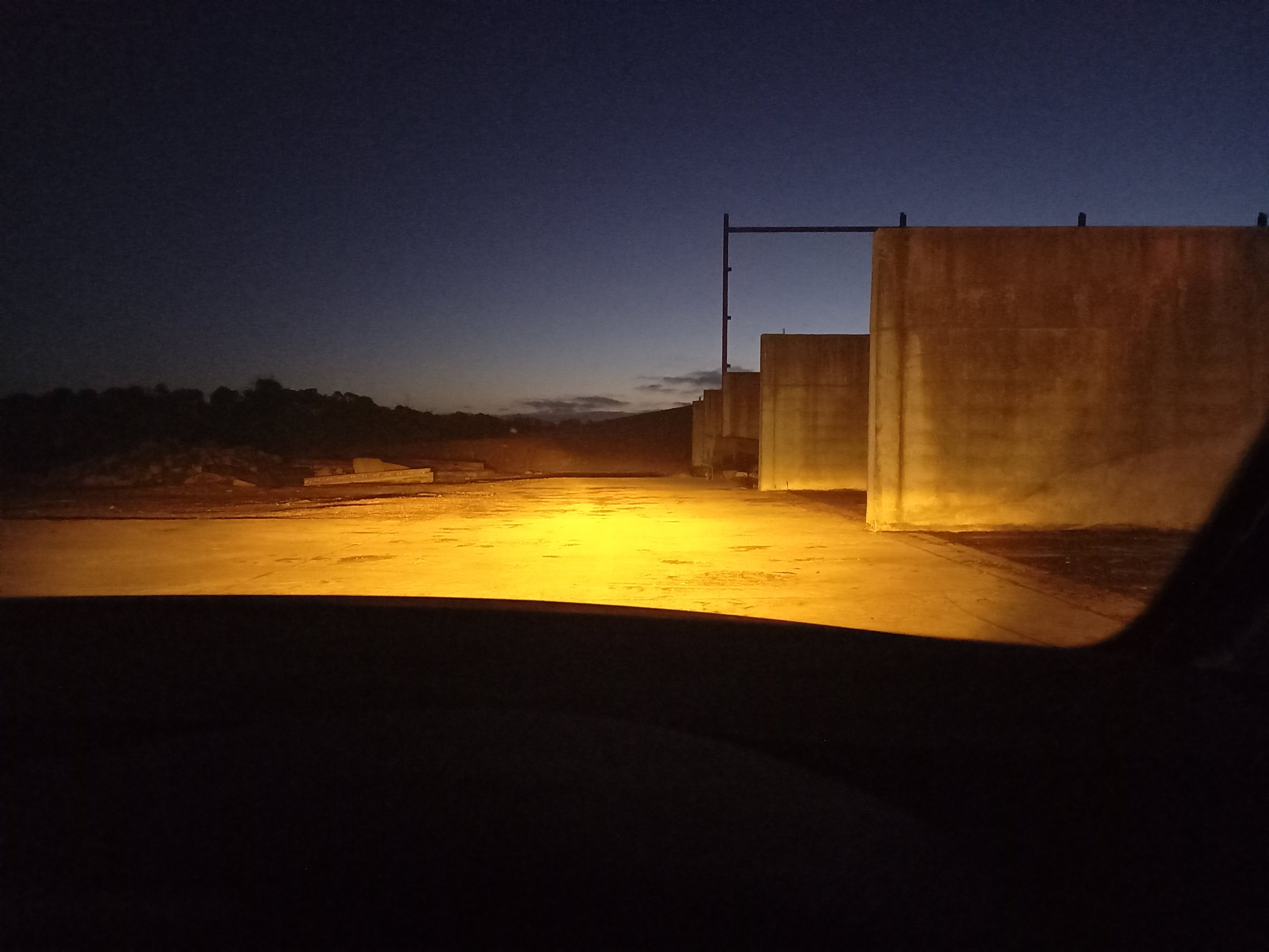

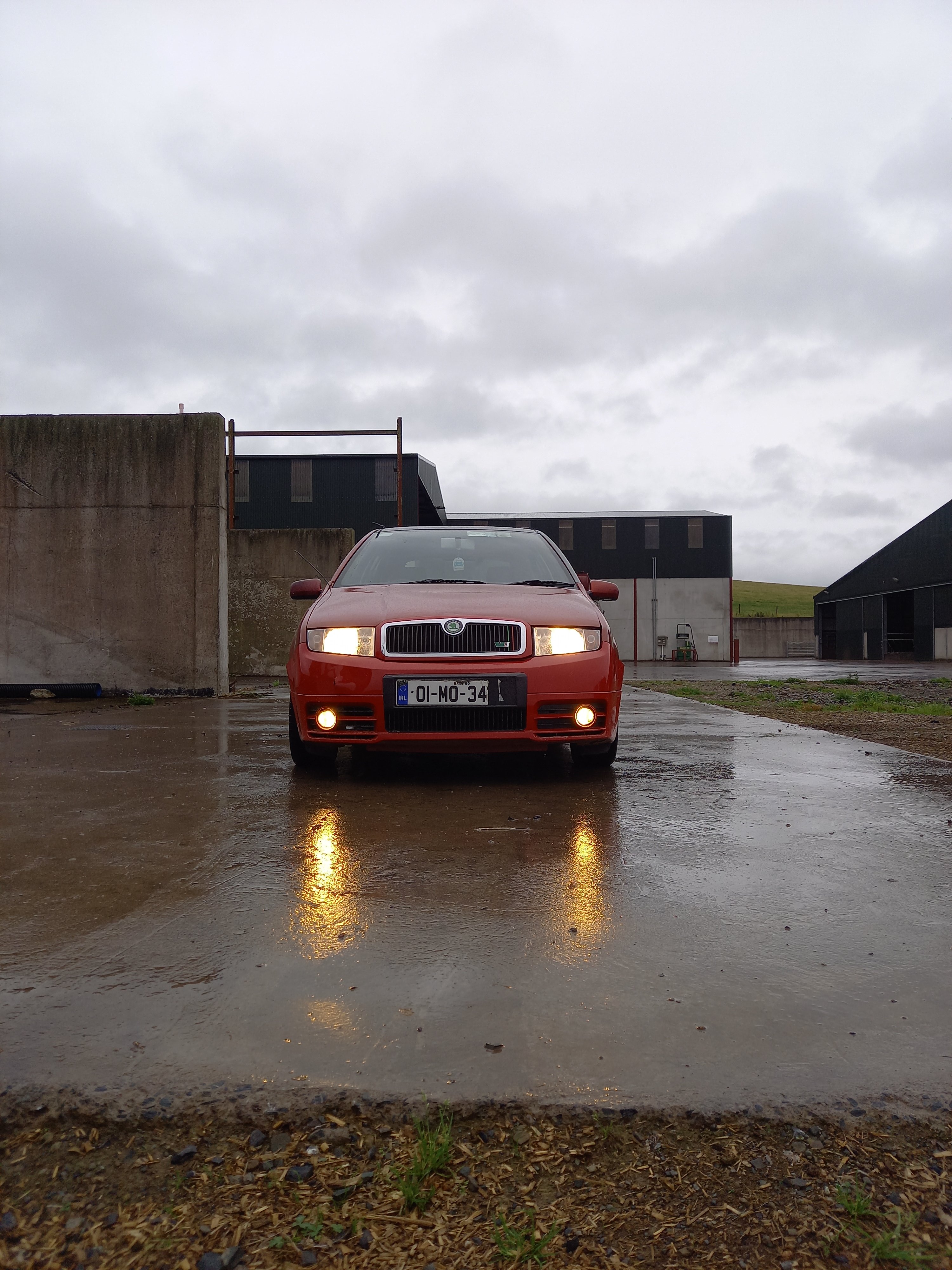

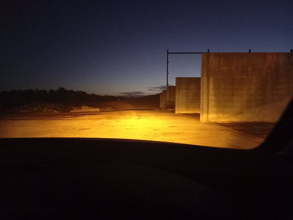

Just if you were curious about how the yellow bulbs look, I took some photos this evening with them installed in the mk1. Not quite as dark mind.20211019_191757.thumb.jpg.d4bd42e87b0eaf06f07cf516a2a92a0f.jpg20211019_191808.thumb.jpg.f876c79779ba8e6d76dd35f4697c6005.jpg

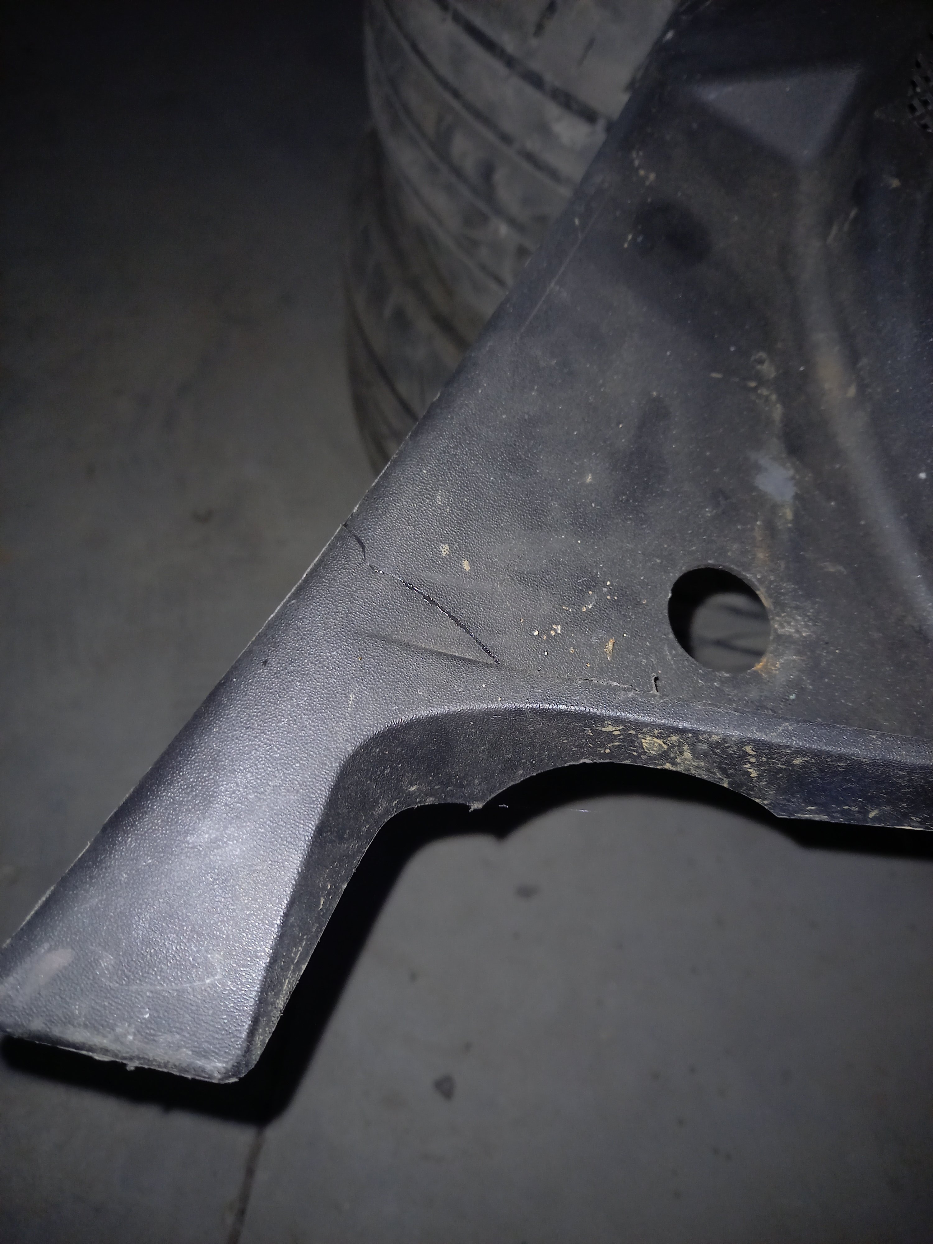

Also, the wiper cowl was cracked so I took it off and glued it back together. Glued it from the underside so its not terribly visible when its on the car.20211019_194616.thumb.jpg.4cadc2ce953e16d244ba0a8c8ff511de.jpg
Yep they are very yellow...   I had some in a Mitsubishi years ago for a trip to France when they were needeed and left them in when I got home...   I did find them better in bad weather though!
Interestingly I was out in the kodiaq again tonight and noticed how much worse the lights were than the OE LEDs in the Swift so have decided I will invest nin some new bulbs...   Either the night breakers you have or the twenty20 equivalents.  I'd like to try some of the twenty20 LEDs but am wary of the legality (or lack of) and the fit given the Kodiaq uses a specific bulb holder arrangement...
Looking at the way the projector light works in the monte I'm not as much against using LEDs in it. Because its got a shutter that cuts the light down for the dip beam i'd say LEDs wouldnt be as bad in it, going to keep the osrams in mine anyhow.
HID's in our Octavia with projector lights were perfect so LED's might work.  The Kodiaq is reflectors though so not really worth the risk.

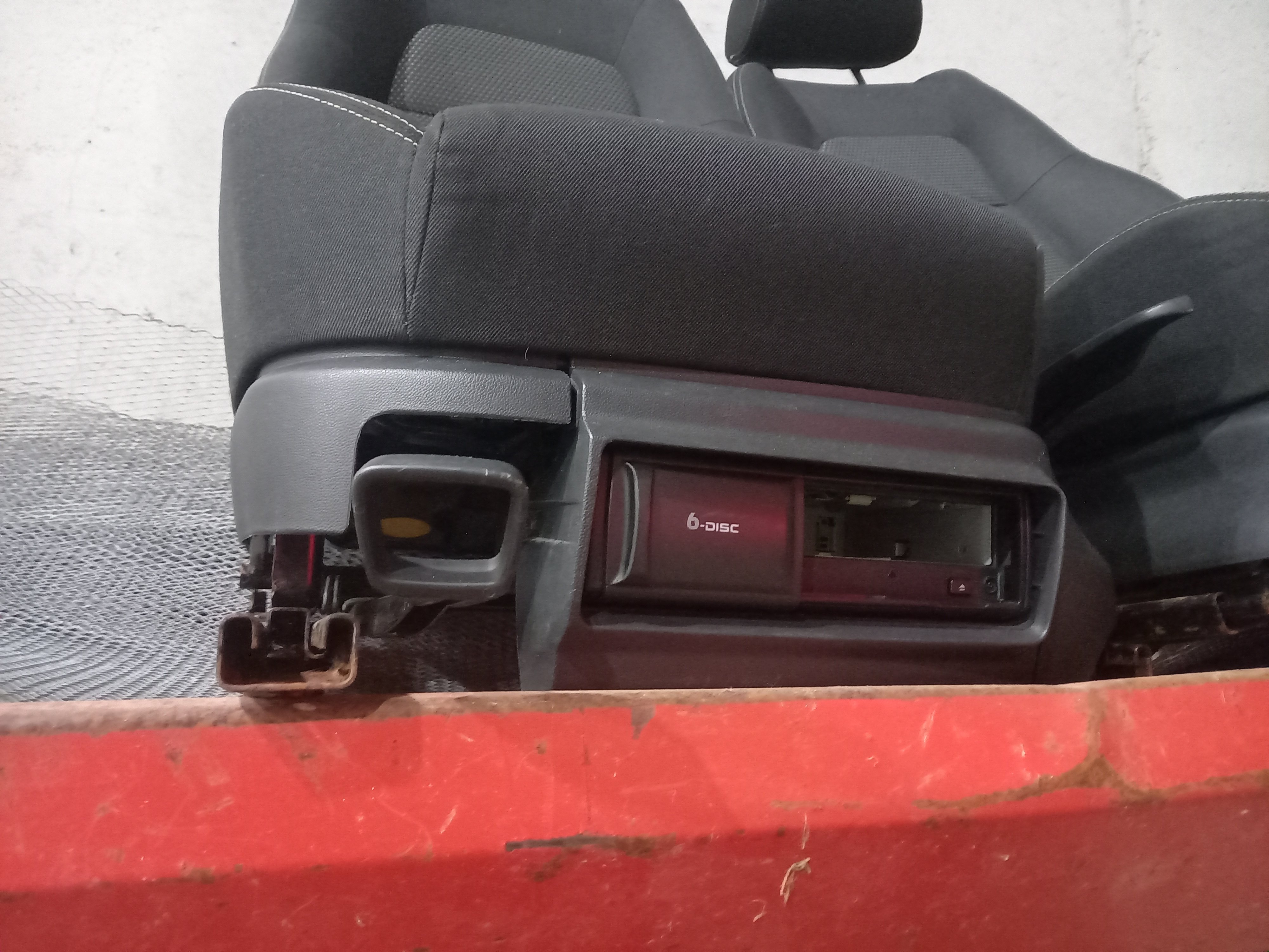

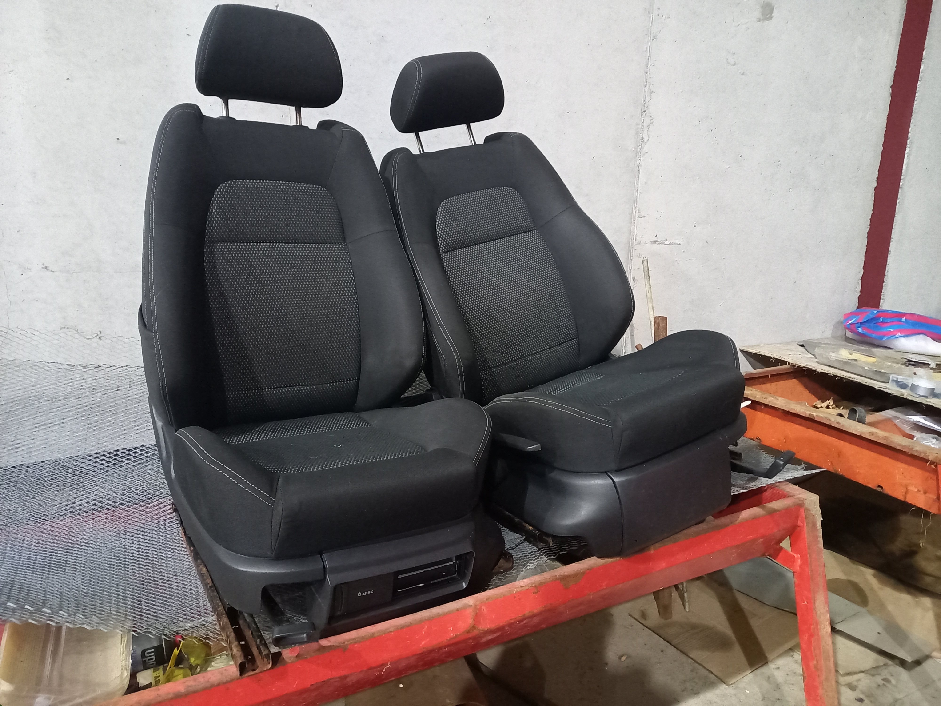

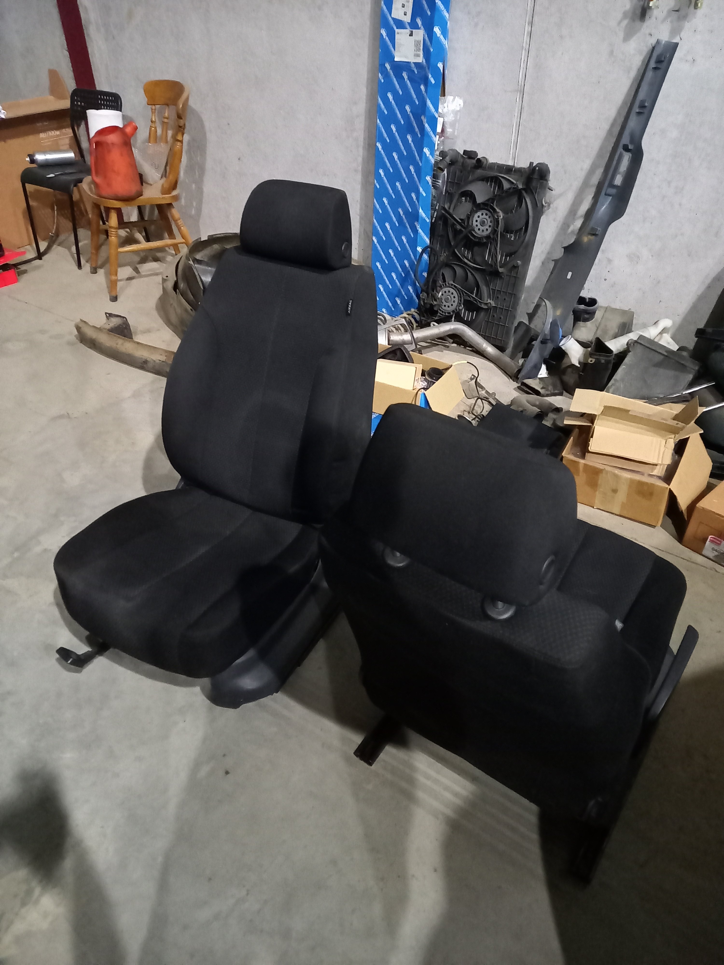

Found these up on marketplace and had to have them.
Set of fabia sport seats, I have the rears too but didnt take a picture of them. No rips, need a bit of a clean otherwise fine. 20211108_203910.thumb.jpg.793babd400490ee67b21e9557557264c.jpg
In case you couldn't see these seats must have come from a fabia with an oem underseat cd changer. Not much use to me but still quite cool.20211108_203914.thumb.jpg.df0349558d3832ab92a049b831c47769.jpg
These will most likely see their way into the mk1, unless I take a notion of putting them into the mk2. In that case the mk1 will get the mk2 seats and vice versa.
You're living my dream DM! I believe you can buy the loom for the CD changer, but you'll also need to get the magazine for it to use it. If you feel like it of course. These will look great in your Fabia.

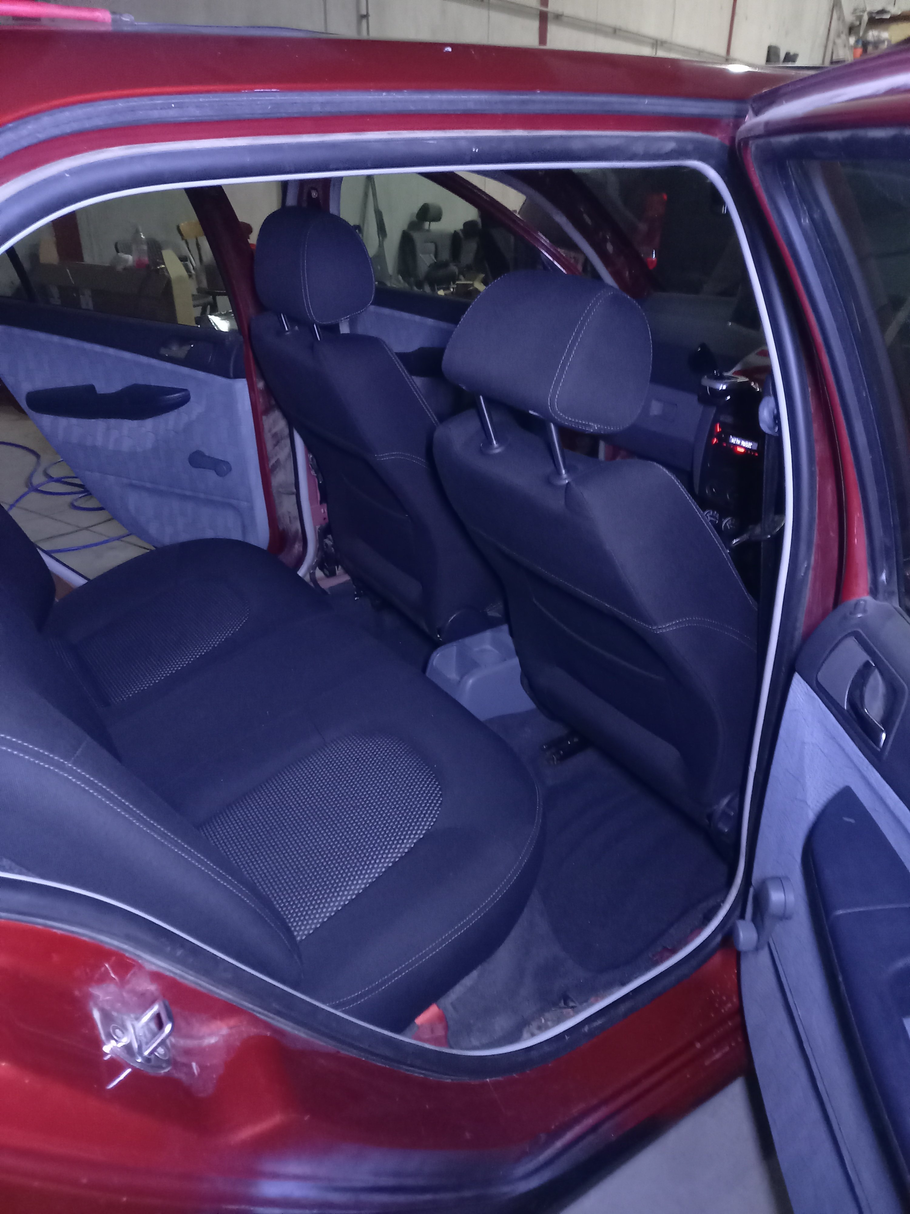

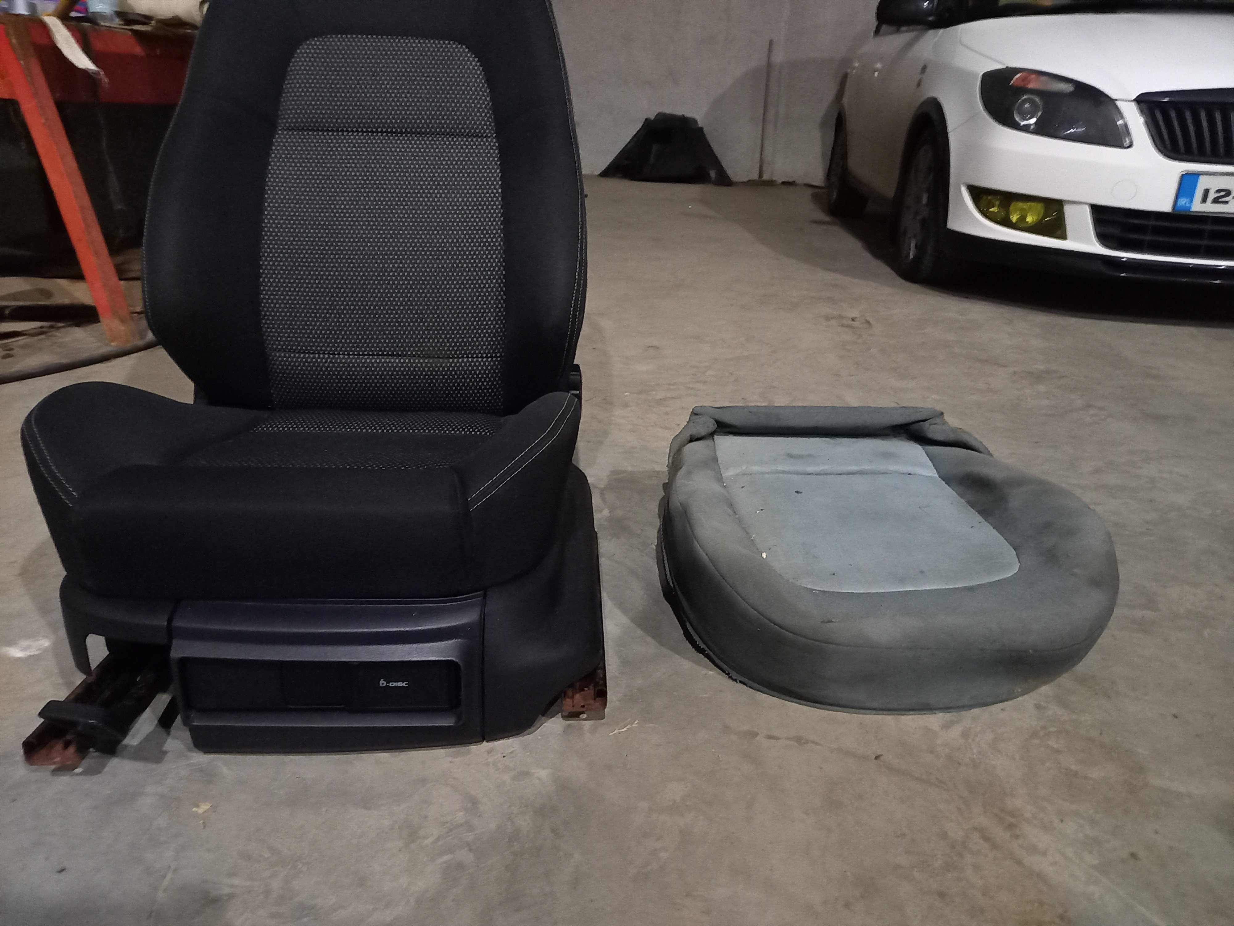

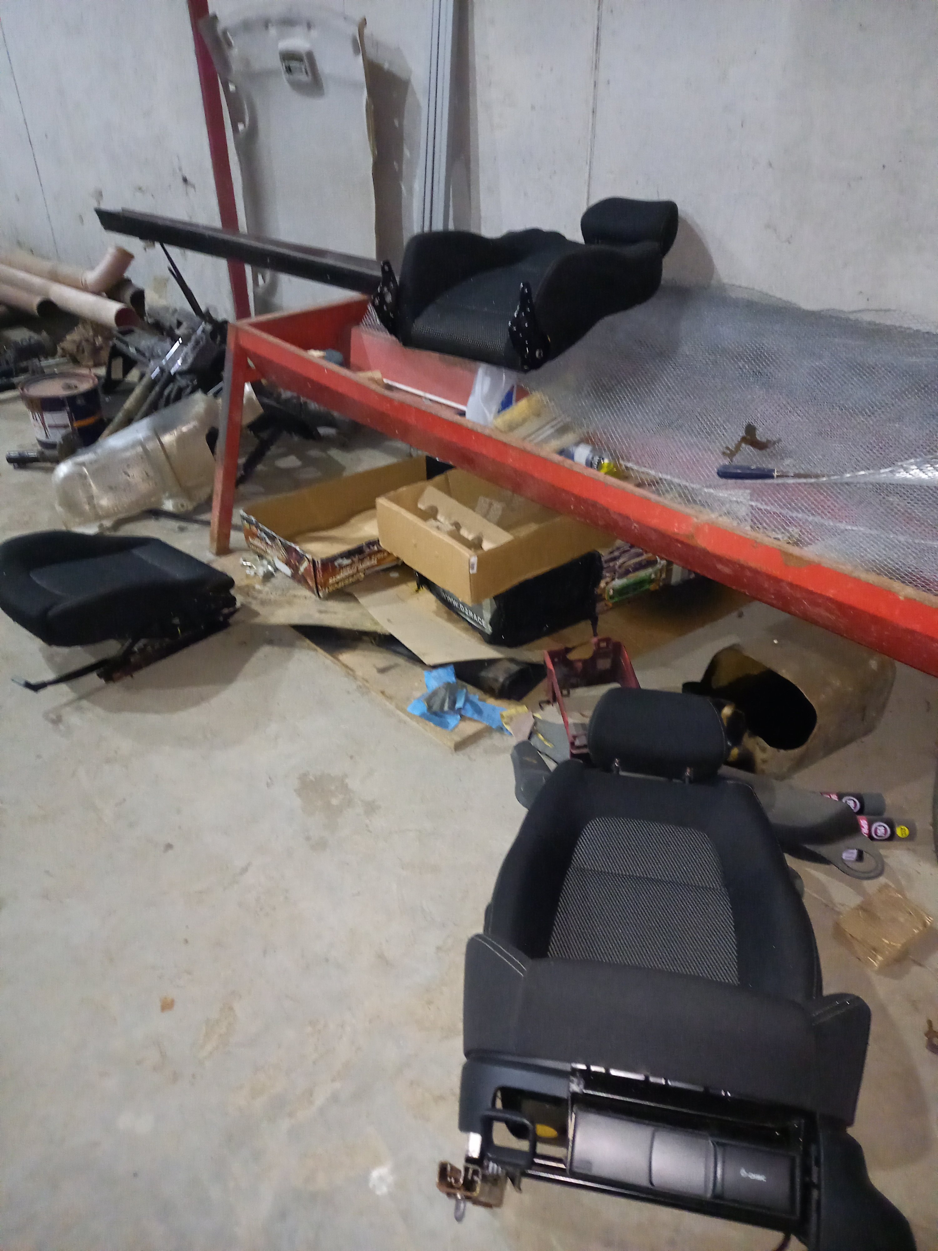

Progress made on the seats, decided to swap the seat bases as the passengers was significantly better than the drivers, like new even.
Hard to show how much more bolstering there is on these seats but for comparison heres the original base off the mk1 next to the sport seats.20211109_182305.thumb.jpg.51a21fd4b023006127ffe55d138f0b0d.jpg

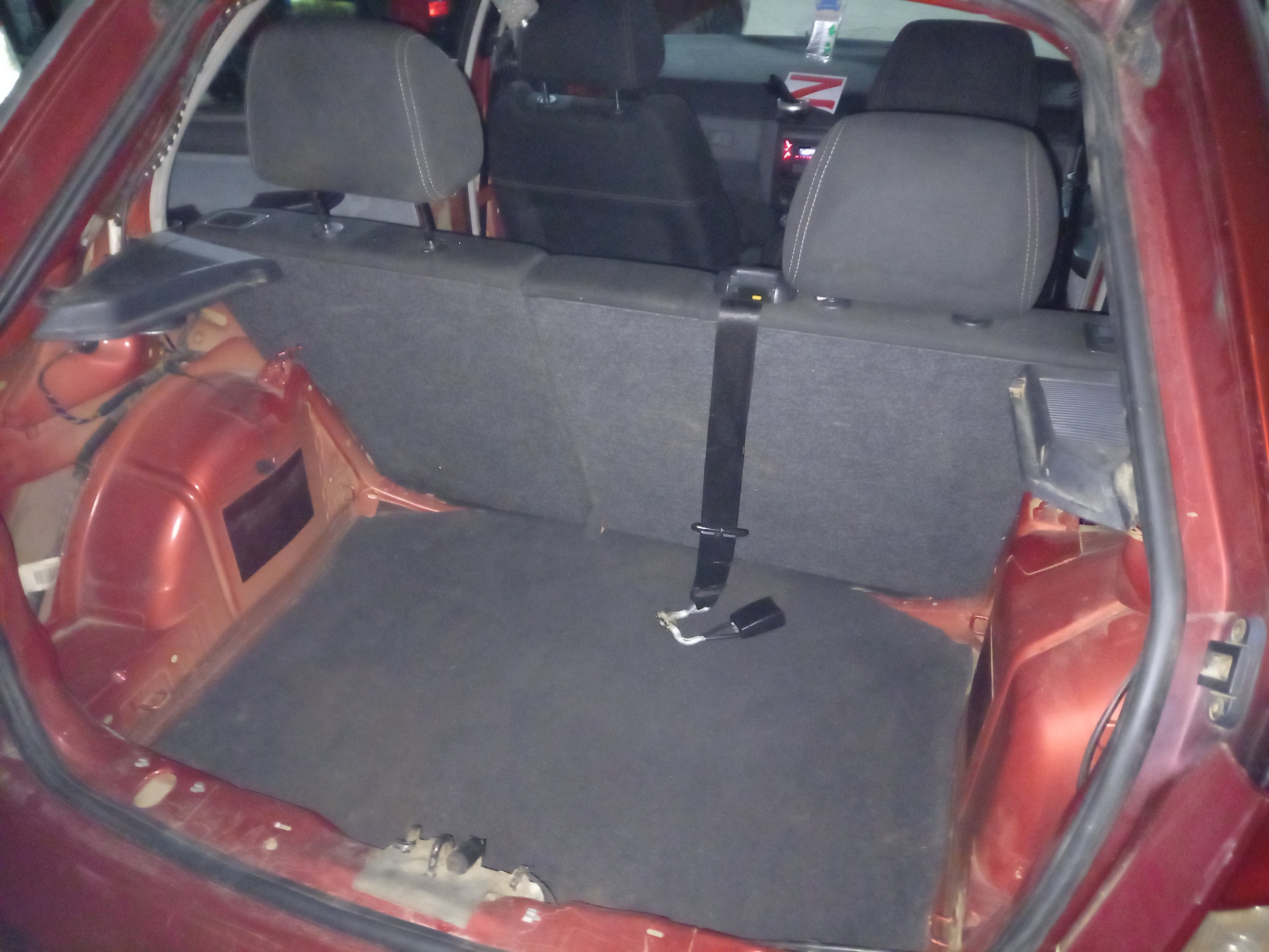

Had to remove the passat seats prematurely as I needed to take the belt buckles off them, these seats did not come with them.

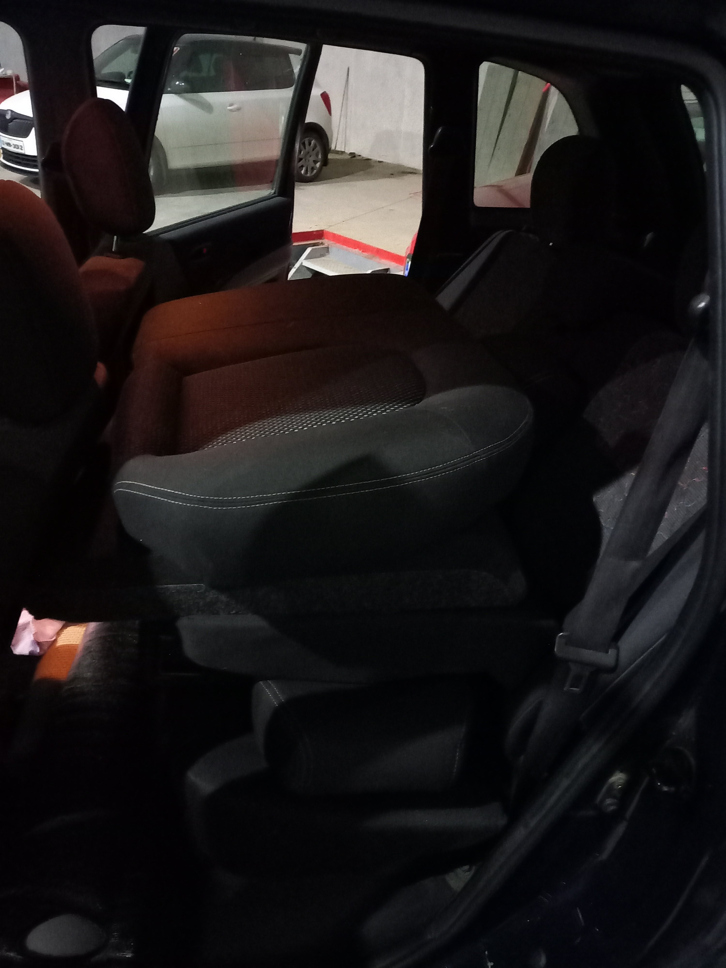

Quick pic of the rear seats stacked into the back of the Matrix, to keep them dry.20211109_203858.thumb.jpg.11f0bfad6f6323b1467604b78c4f9aab.jpg
I'm really liking the bolstering on these seats and they aren't even in a car yet. Still have to give them a clean and then they can go in whichever car I decide.
Come to think of It I could swear my mk1 originally had a lapbelt in the middle seat, but these have a 3 point middle belt. Fingers crossed this won't become an issue.

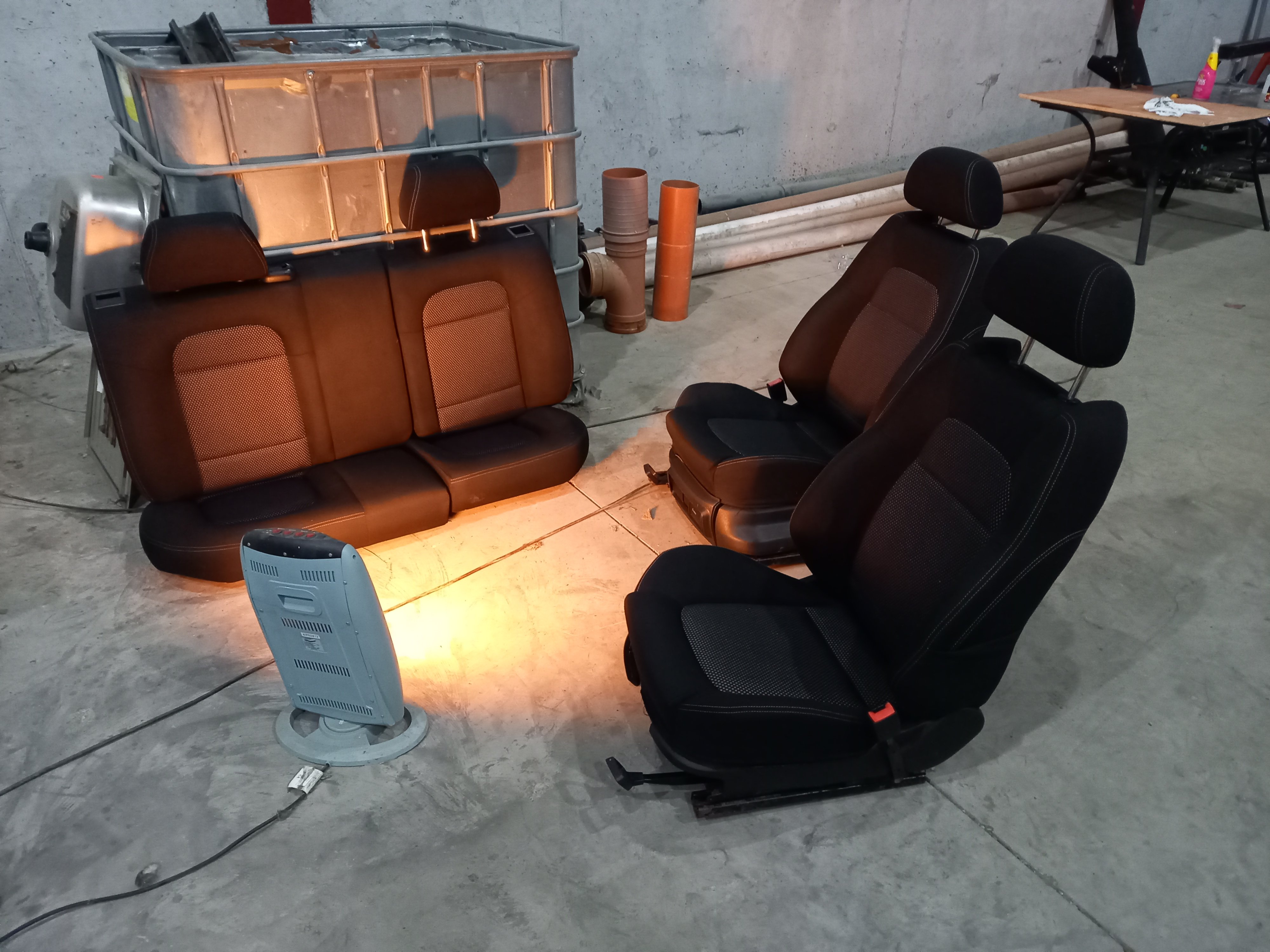

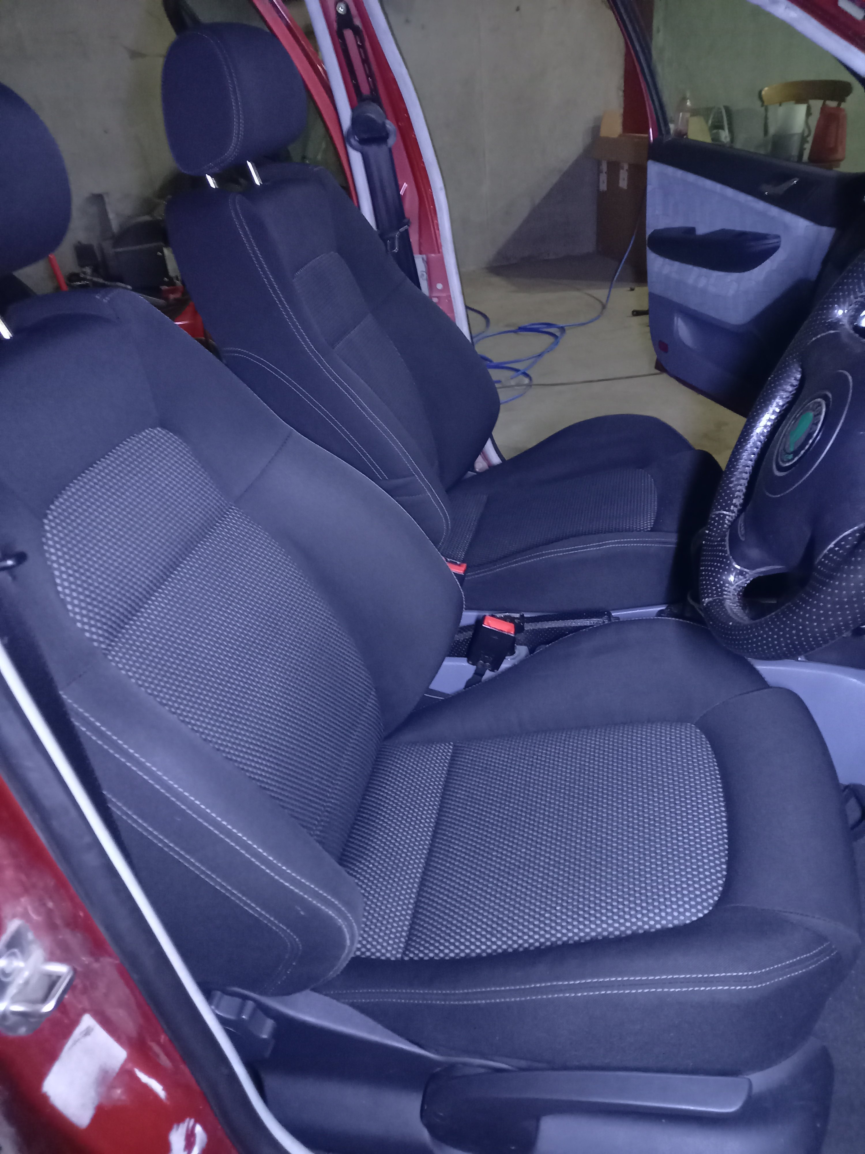

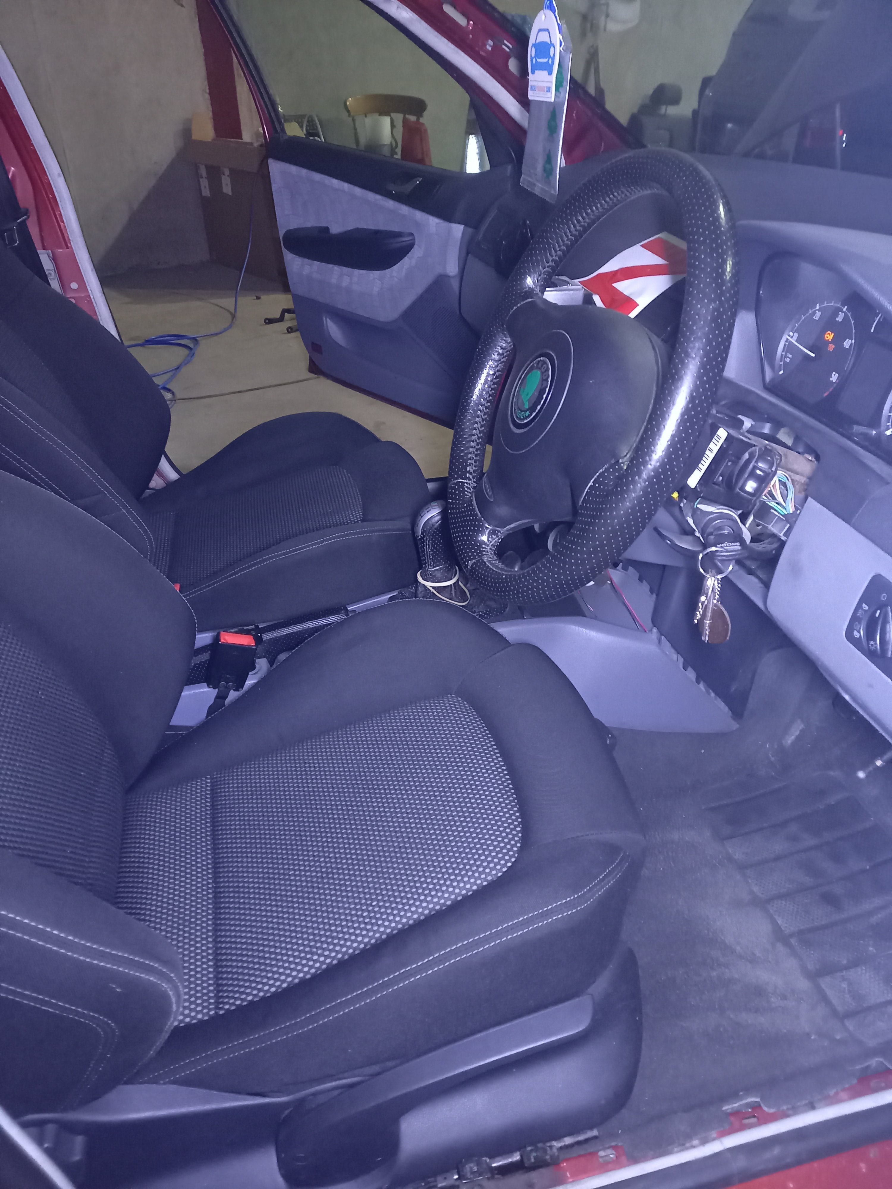

Seats are done and in.
Started off by spraying them with a bit of vinegar to kill any mould that might be on them, let that do its job.
Then I used some car plan stuff to clean the seats off. After that I set them infront of the heater to dry a little.
Then I set about the insides, I wasn't going to touch them initially, but figured I may as well. For these I used a spray can of turtlewax stuff and in fairness it did a great job, did the door card fabric, boot carpet, floormat even the headliner with it. Needless to say thats used up basically the whole can.

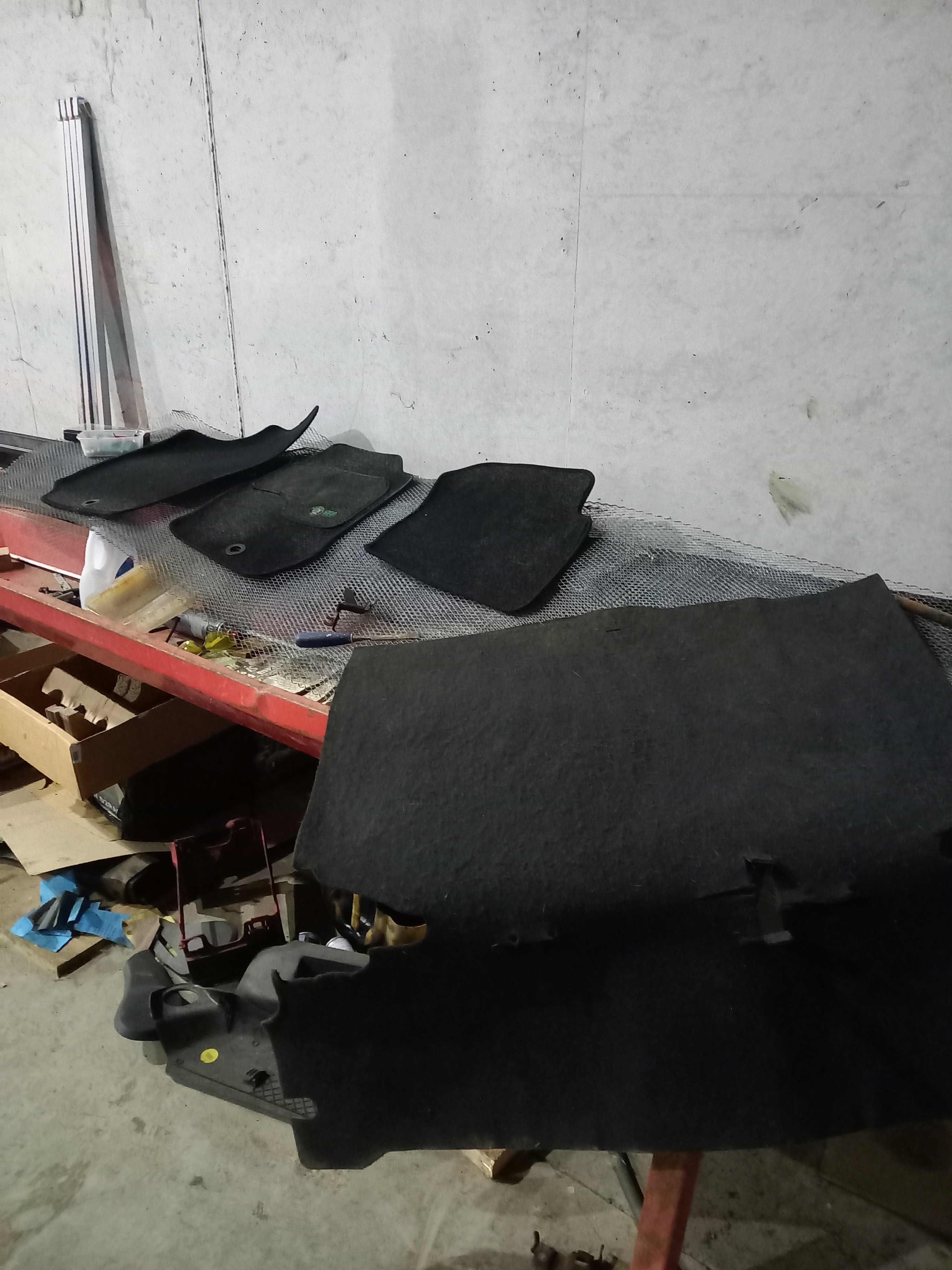

Had these out of the car, drivers floormats been put in the mk2 for winter.

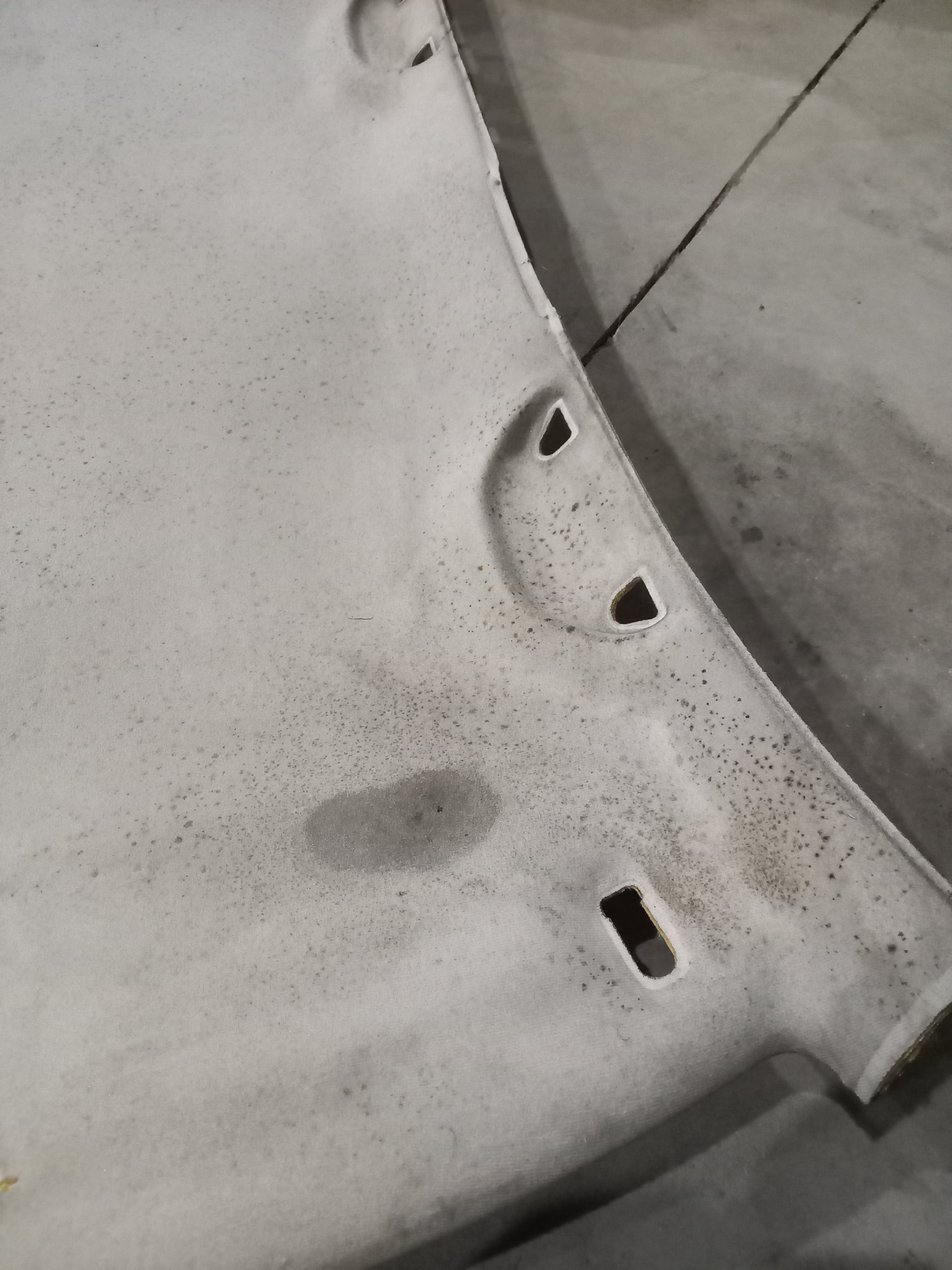

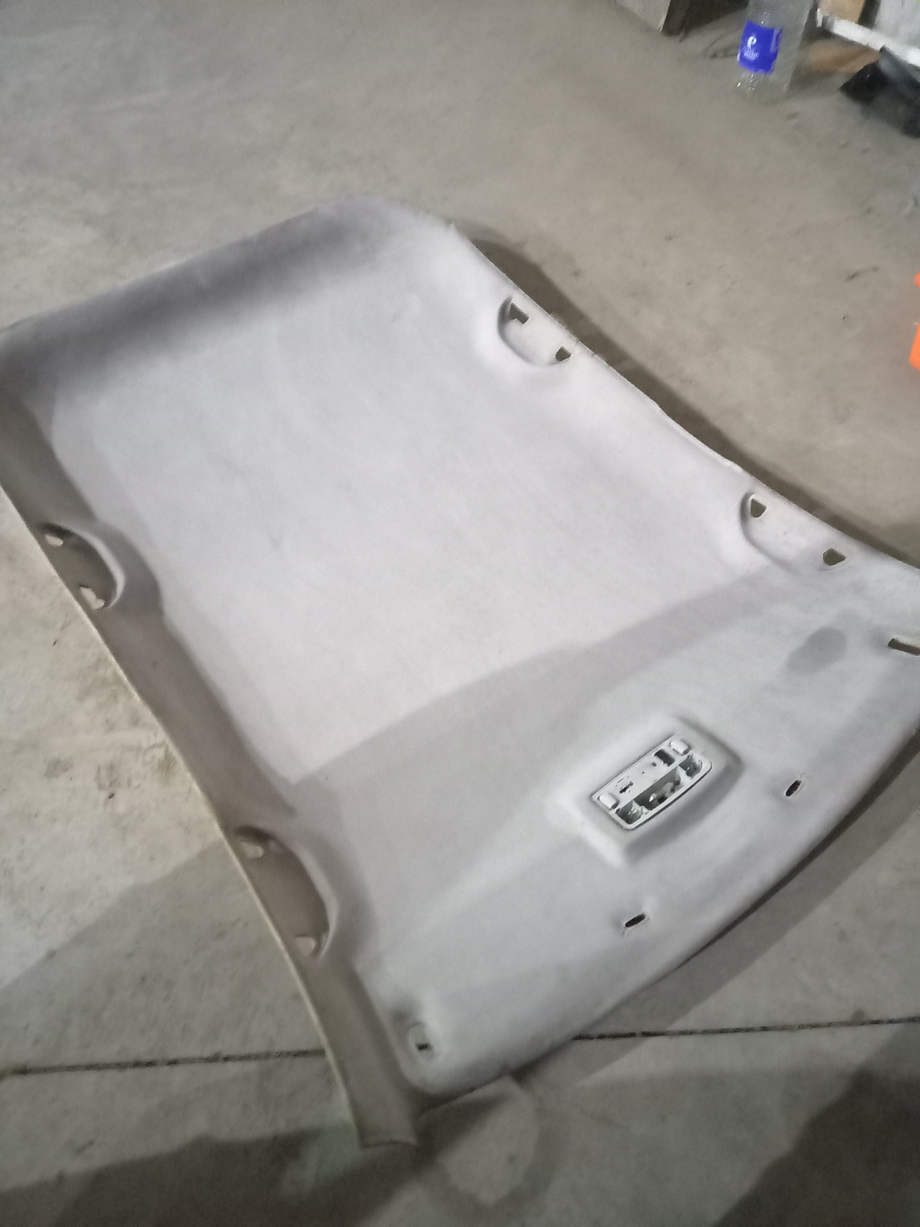

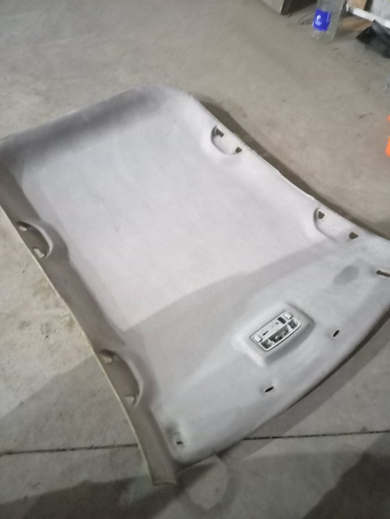

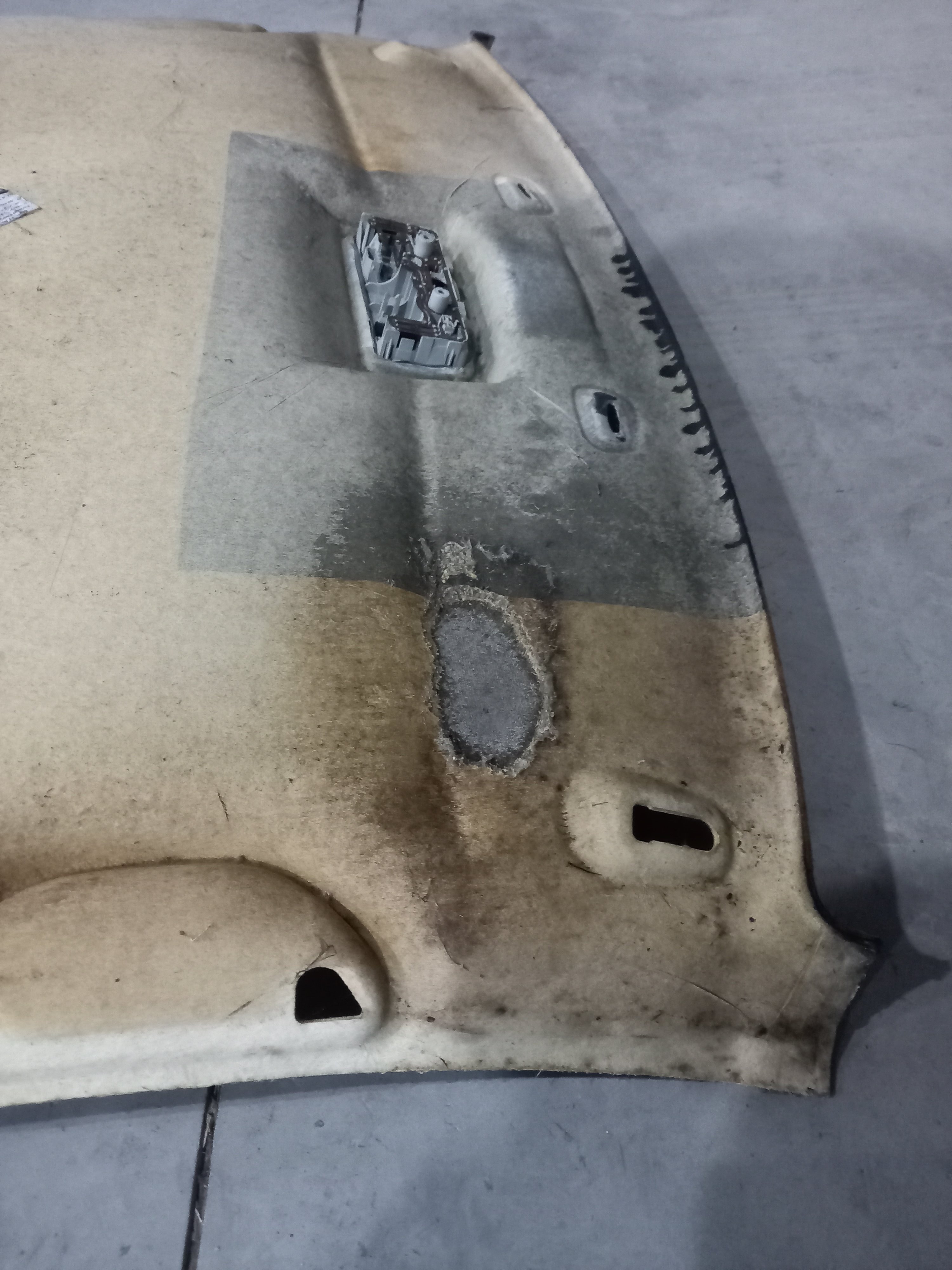

While these were drying I set about trying to clean up the headliner.
Lot of mould.
That damp looking spot is really just a hole where a mouse had made a nest between the headliner and the roof.
And of all the spots, this nest was right above the drivers side.
After a lot of effort, while it did clean it up a lot, its still got some mouldspots.
I think I may have a go with some fabric dye and dye it black, might be worth a try.
By this time the seats had dried a little bit but what I did was start the car and let it heat up, install the seats and all back in the car, and let the heater go full blast for about an hour. This worked and the seats felt dry as after. 20211111_203631.thumb.jpg.73b25f49855be5a7b7533af49fa6310b.jpg20211111_203626.thumb.jpg.93d93f667fd04cd1e5ae153ba126cf4a.jpg
As much as I liked the passat seats, I think these fit better.
20211111_203615.thumb.jpg.8fdf9bb406e4fd816a72a9ea27d6a121.jpg20211111_203601.thumb.jpg.ac9c58ba841ea9e96bc429113b8cd8c1.jpg
Well happy with them so far.
Still have to find, demould and reinstall the rear belts but its getting there.
