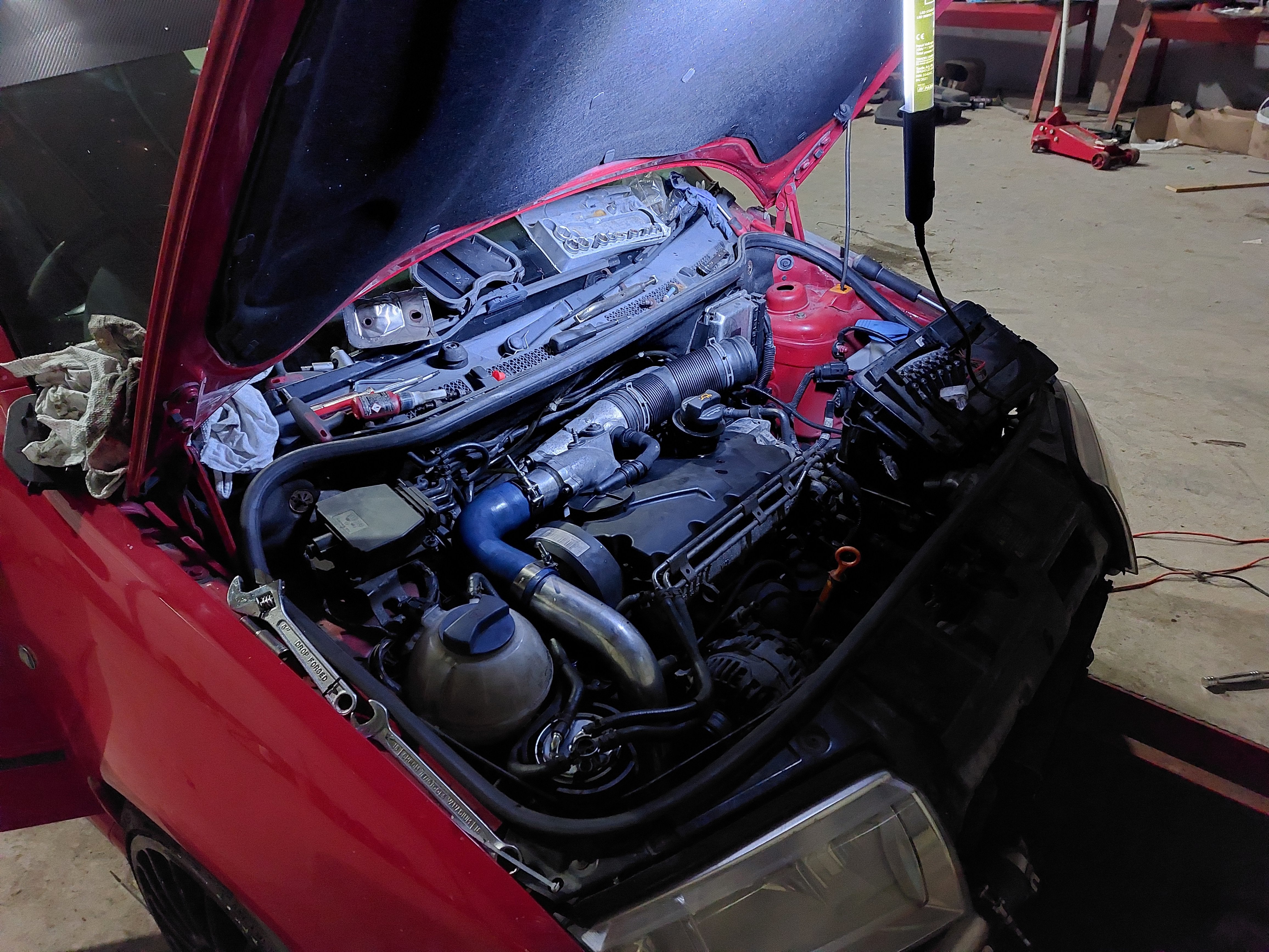

Had a bit more work to do than I realised, biggest headache out of this whole thing was fitting the return properly. Mounted it to the turbo at first but found out it needs to be fitted to the block first, THEN you need to somehow slip a gasket onto the piece connected to the turbo and tighten all up.
Must have took 40 minutes to just sort that out. Nearly gave up there it was that bad.
Pushed through, changed the oil, got the downpipe on and gave it a few cranks to build oil pressure.
I pulled the fuse for the "diesel computer", fuse 14 on this, so it would crank but not fire.
Seriously good battery on this, same battery that came with it all I did was charge it.
Made sure to record the first start up
Died after a few seconds seemingly run out of fuel.
After cranking it a bit more it fired again and stayed on this time. Changing the fuel filter must have got air in somewhere.
Gave it a few revs even, found where the popcorn limiter is on it
Not brave enough to let it pop and bang away just yet.
Didn't even move it under its own power but I was happy to leave it there for tonight.
Extremely impressed at how healthy that engine sounds, given the miles and having bought It with a grenaded turbo.
I'll take it for a few laps next day.

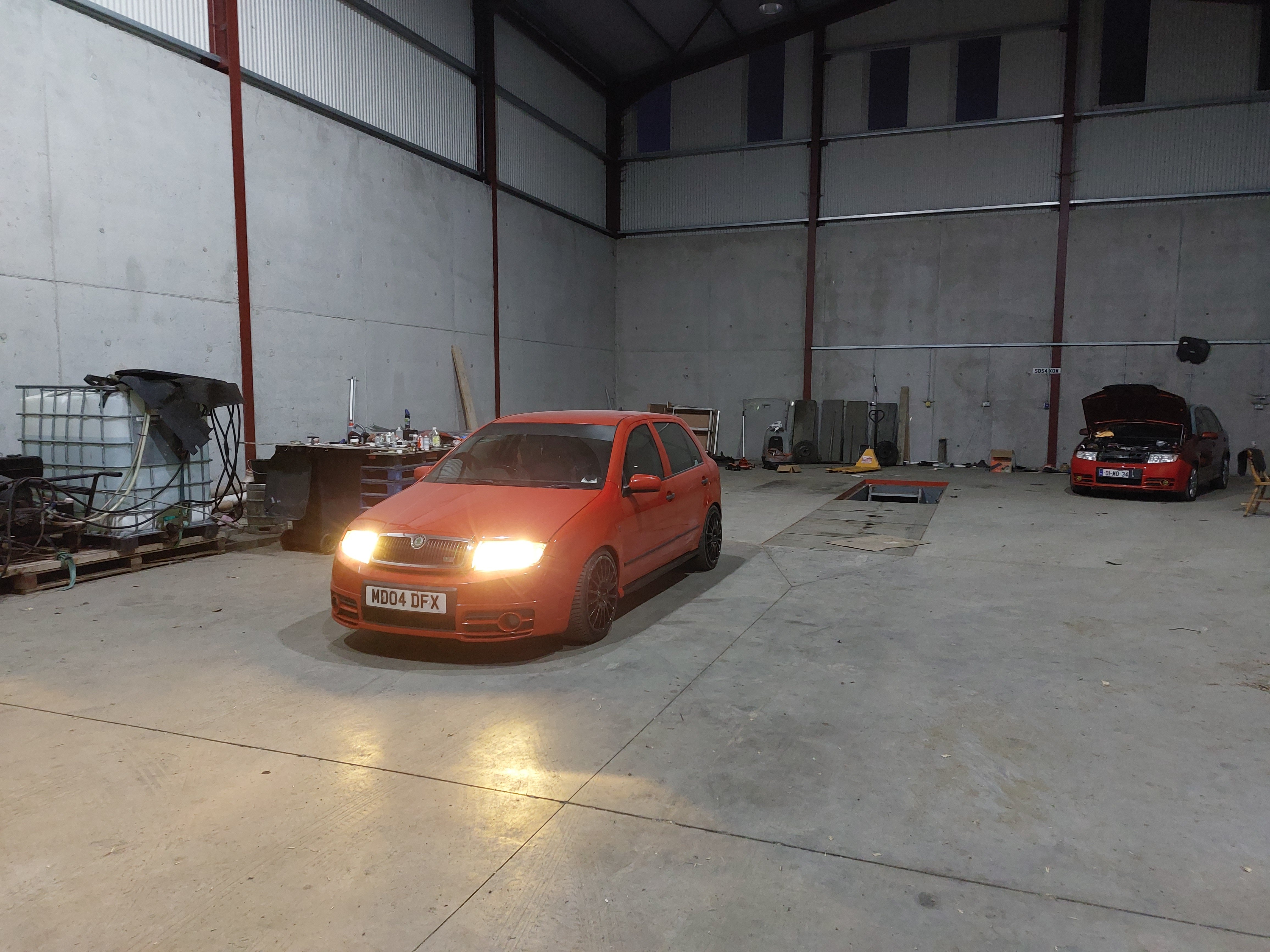

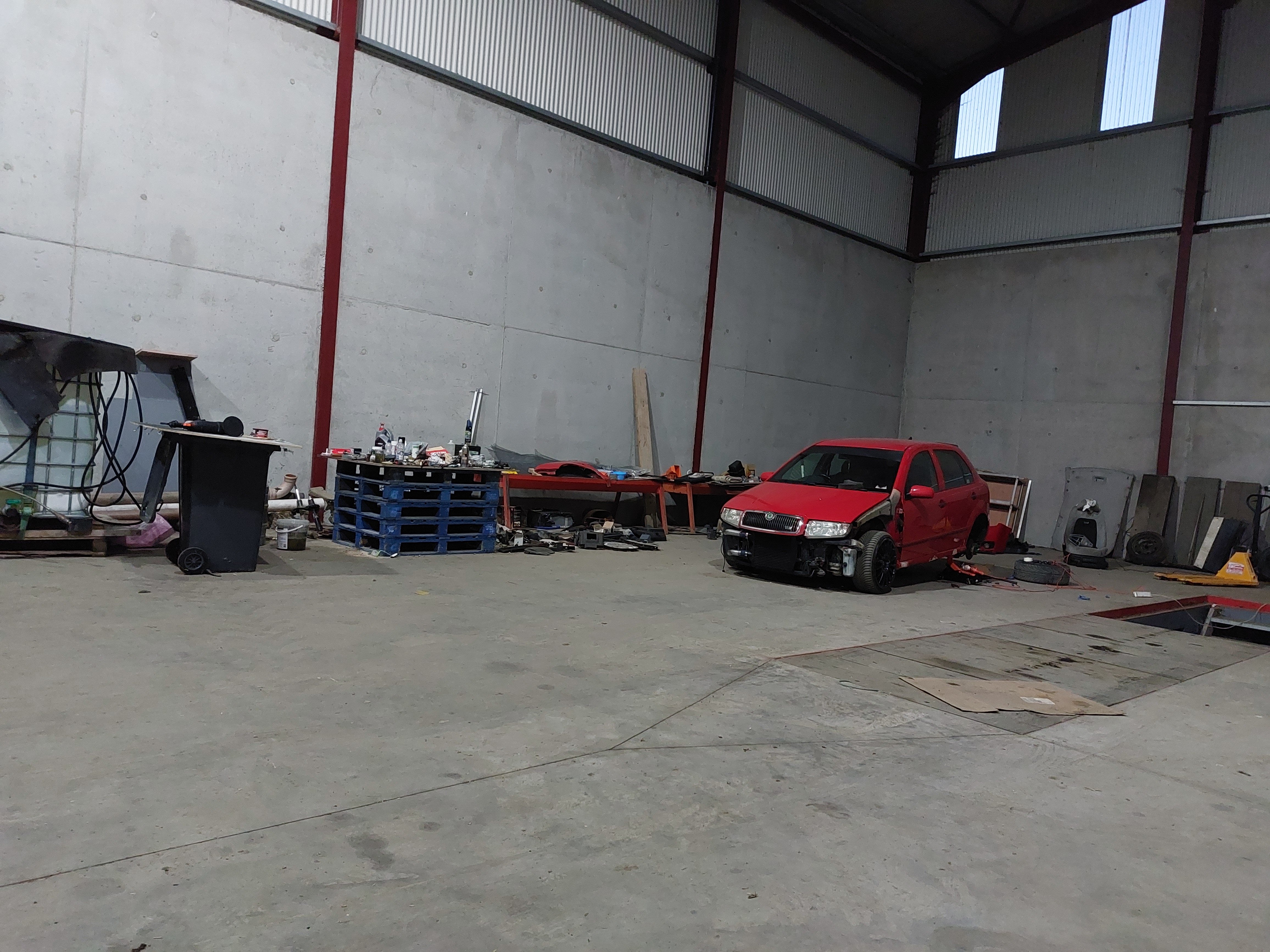

    So finally took it for its first spin outside in a long time. It runs, and drives. Had an issue where it died, not sure if it's the battery that was in it (very possible) or a charging issue. Wel
  • So had to put it aside for a while due to ongoing work in the shed. But I now have functional pit lights, and better overhead lights. New injector loom, new cam sensor, no luck. G
  • Never ending pain. Timing belt and water pump done. Little drama here, water pump was poor so well I changed it, no clue when it was last changed so atleast I'll be starting from "now"

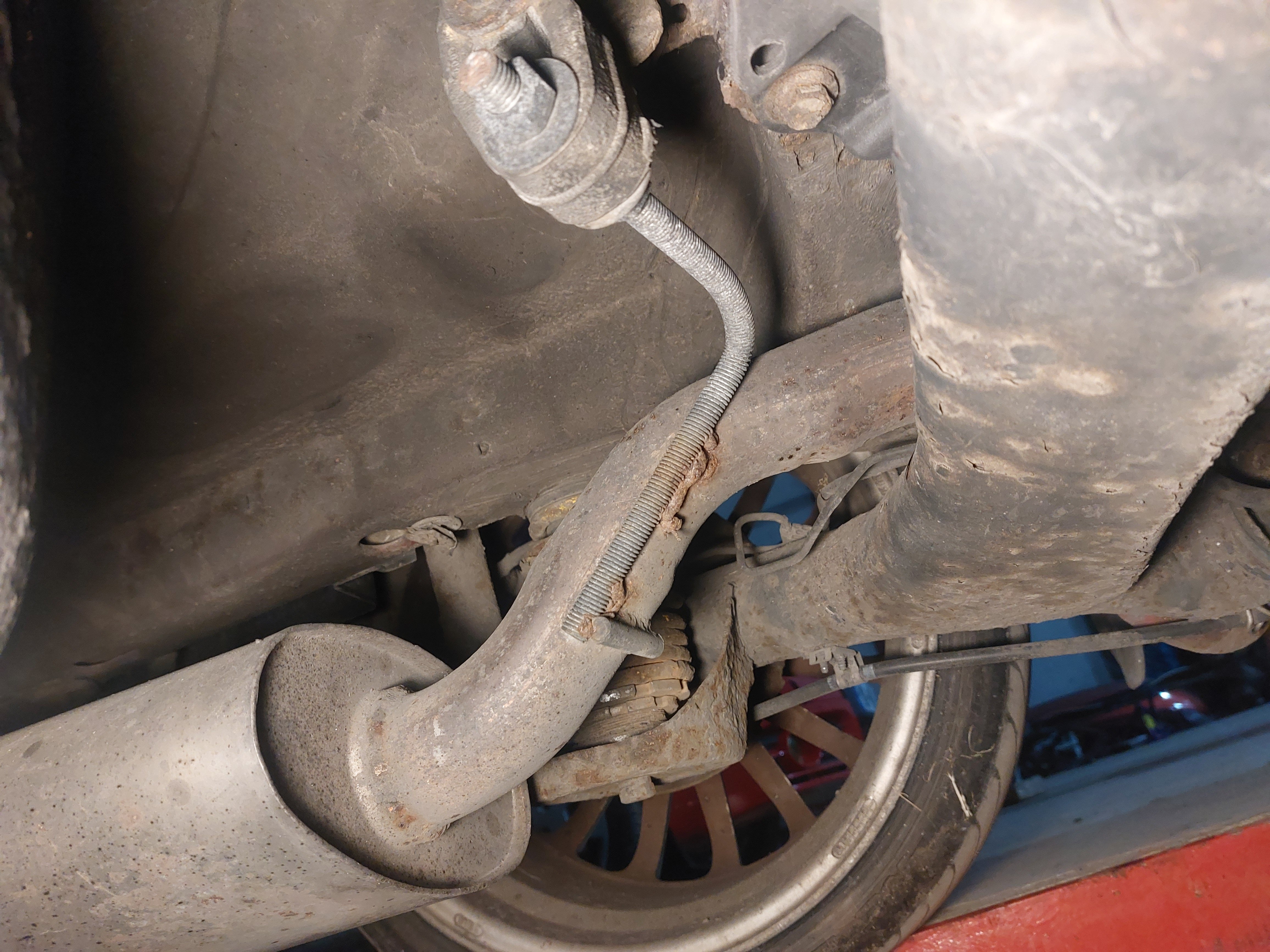

Still open downpipe, had a look under it and I wasn't bothered trying to get the exhaust back together this evening.

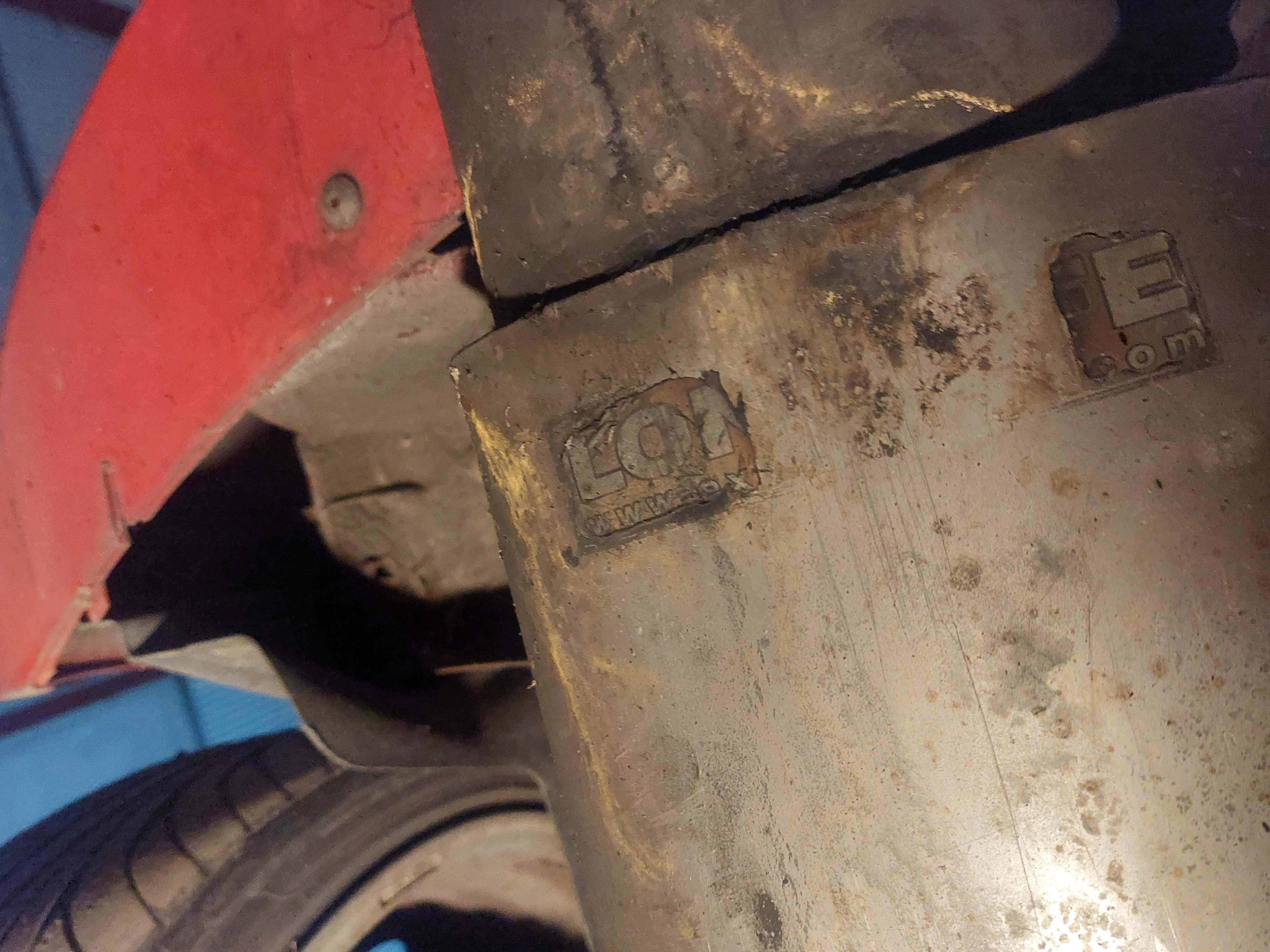

If anyone knows what backbox this is, or what company this sticker belongs to, I'd love to know
I'd say you're right on the money actually. Seems to be decent reviews for longline exhausts, so must be a decent enough company.

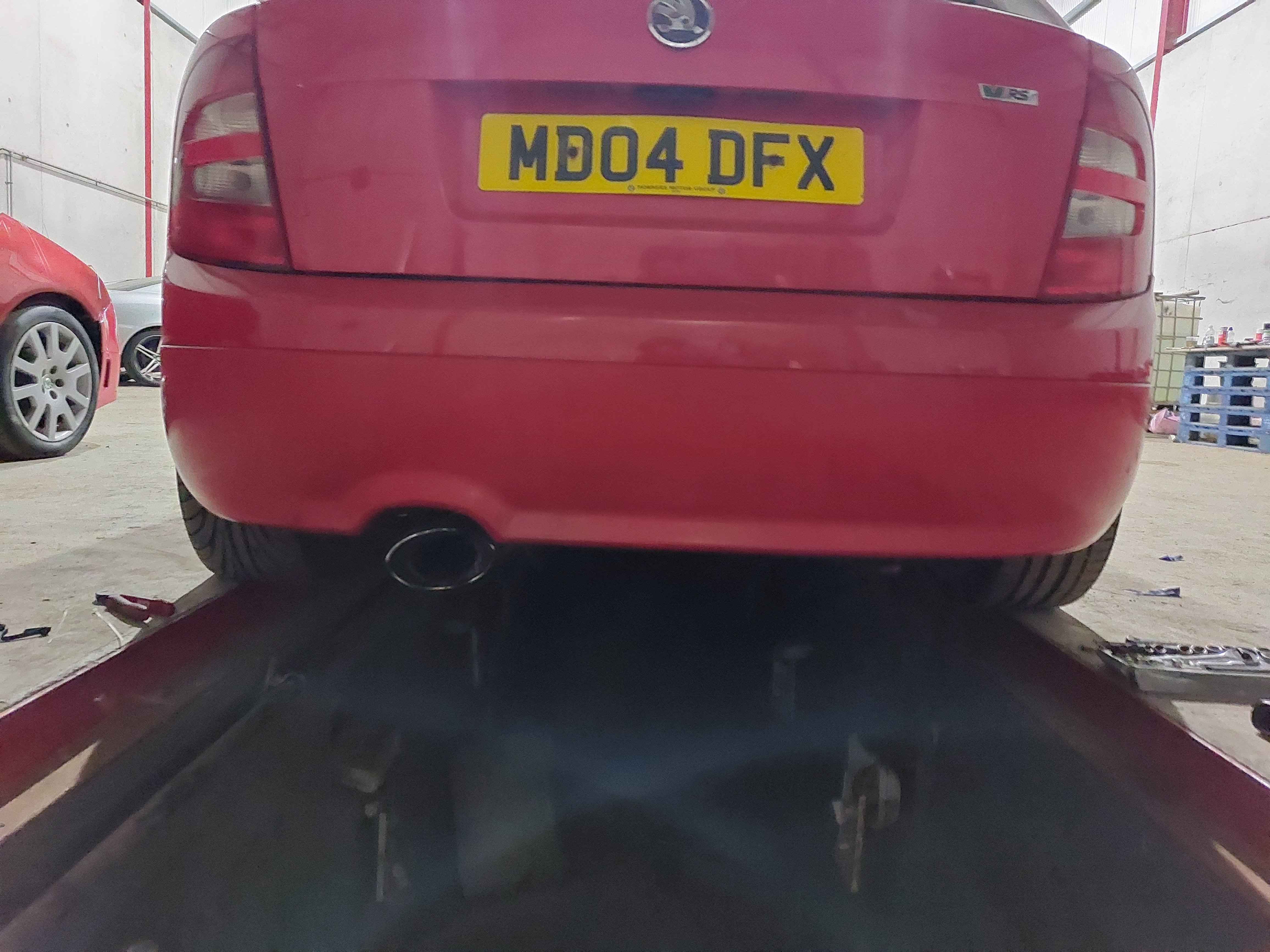

Got the exhaust sort of back together.
Was a pig, and the absolute hack job of a backbox mount failed so had to hang it with zip ties after this video was taken.
It's remarkably quiet to be honest, not complaining. Doesn't look pretty here but it's not dragging the ground so It'll do.

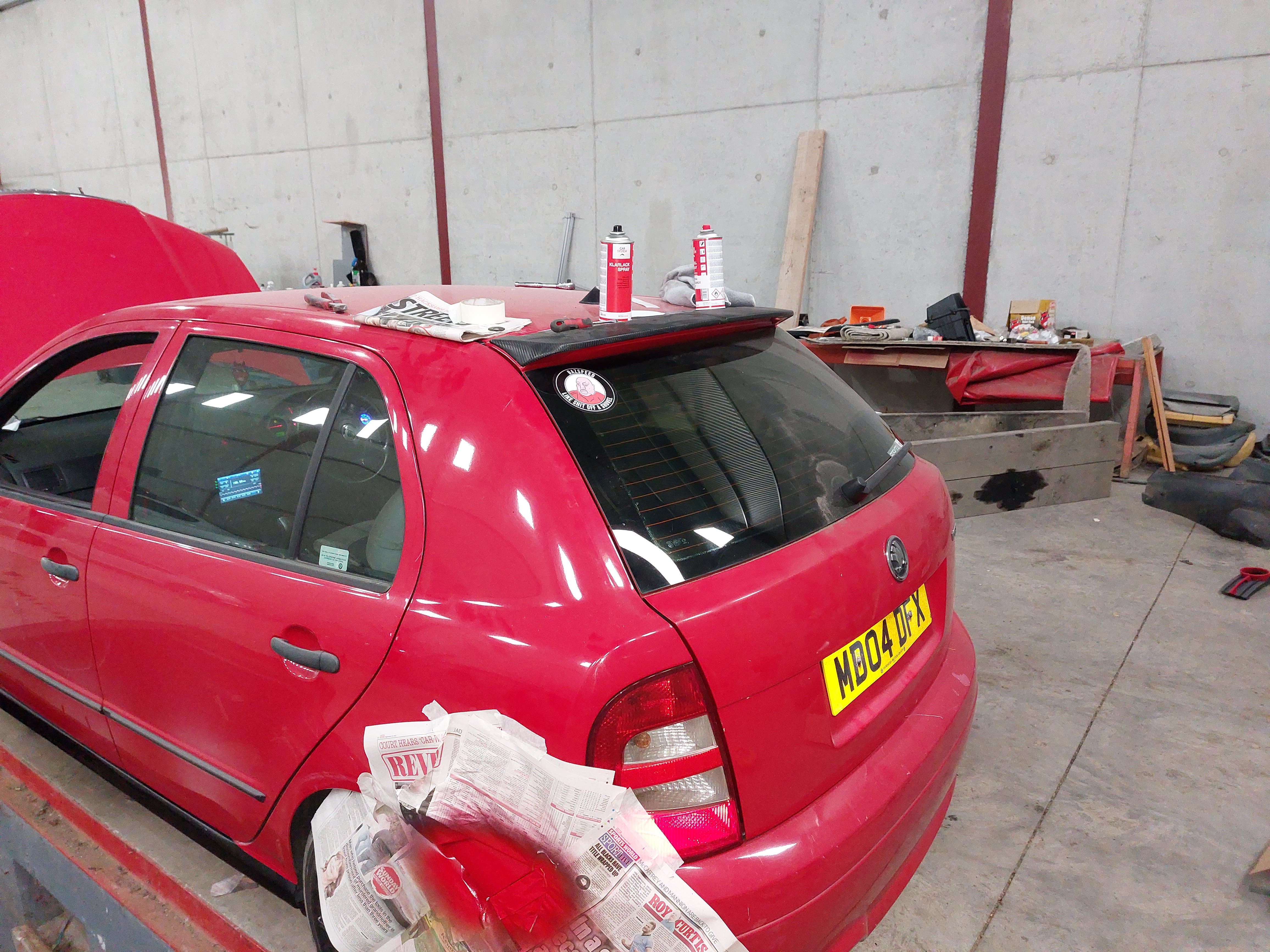

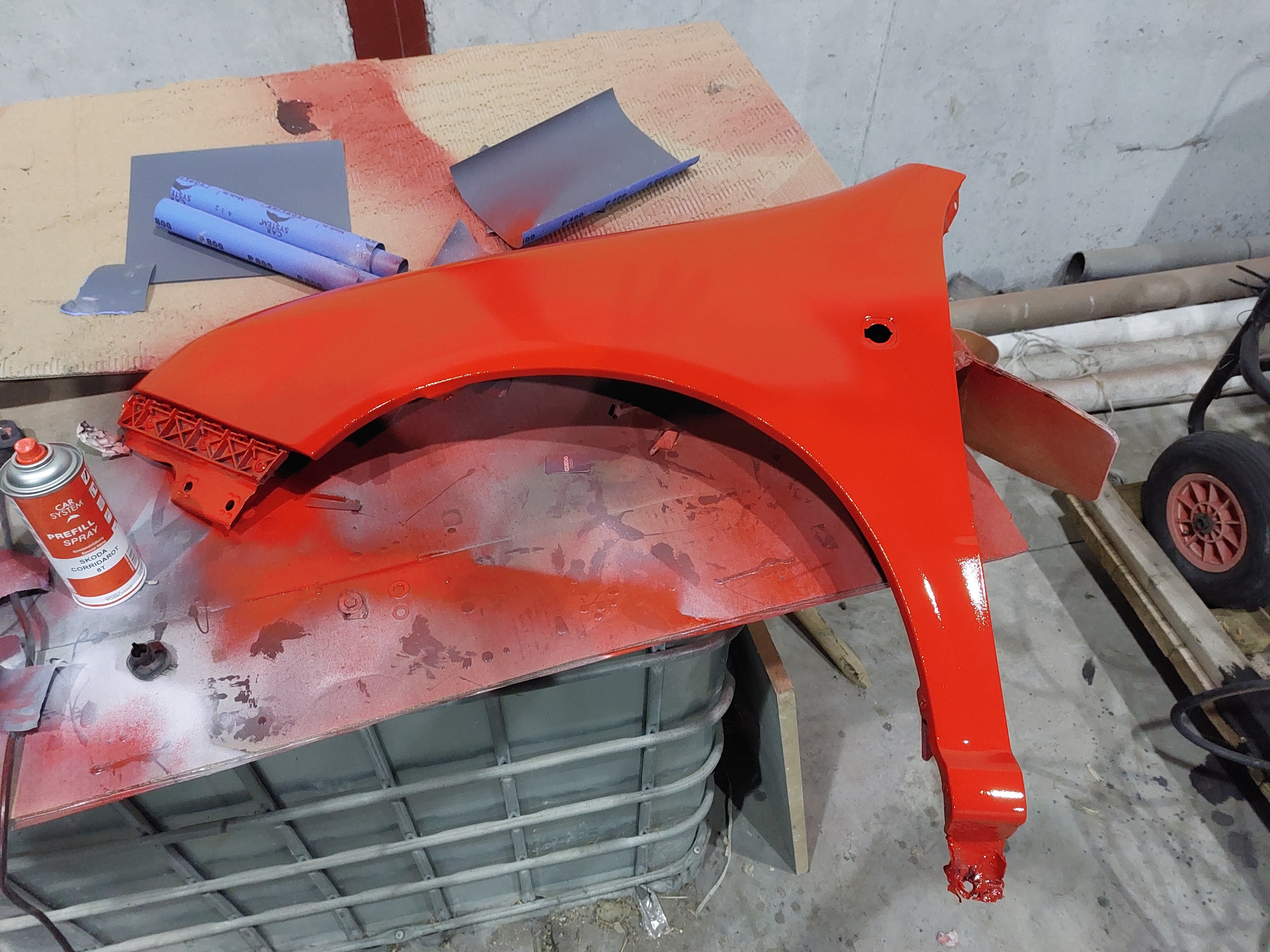

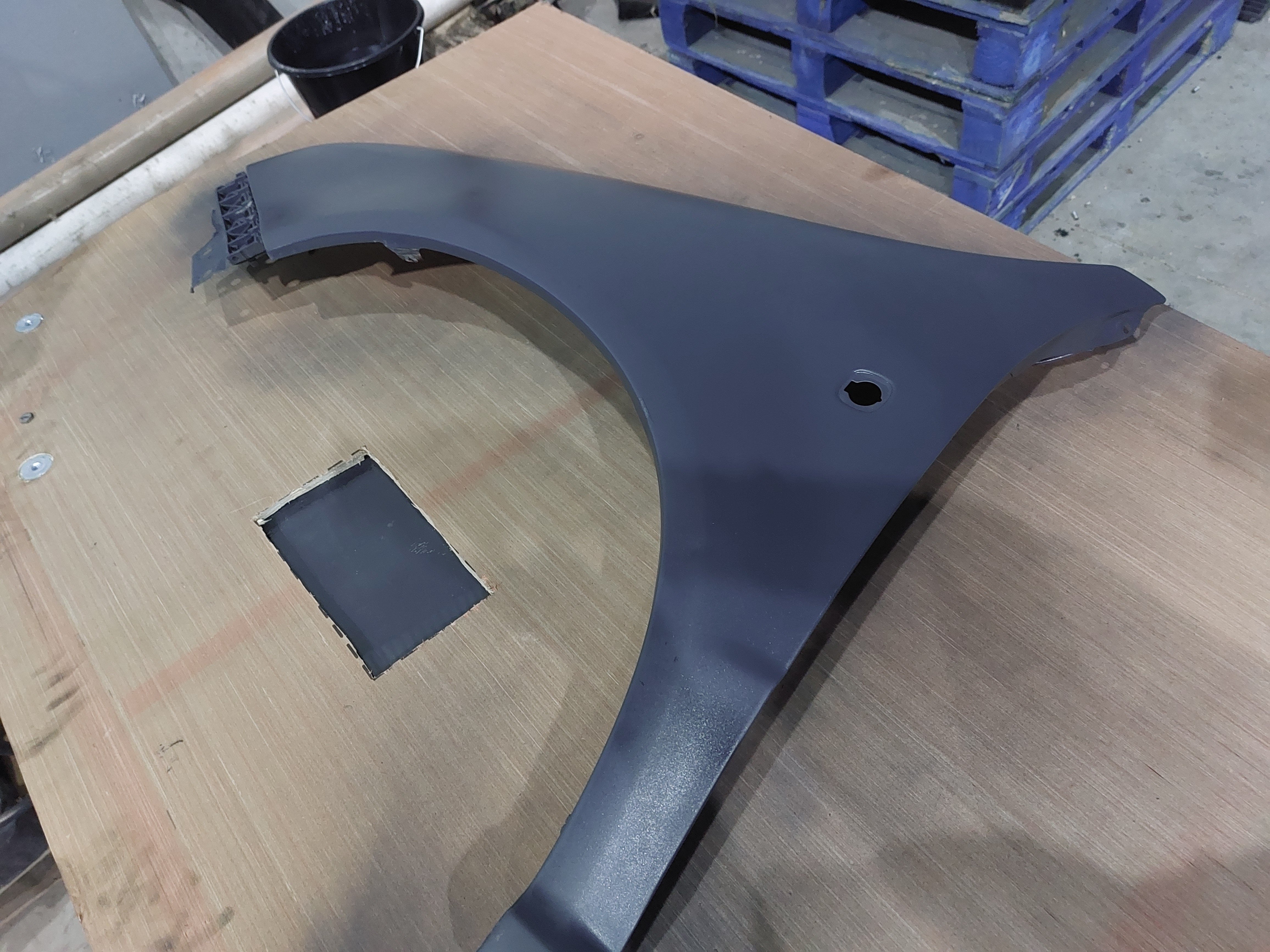

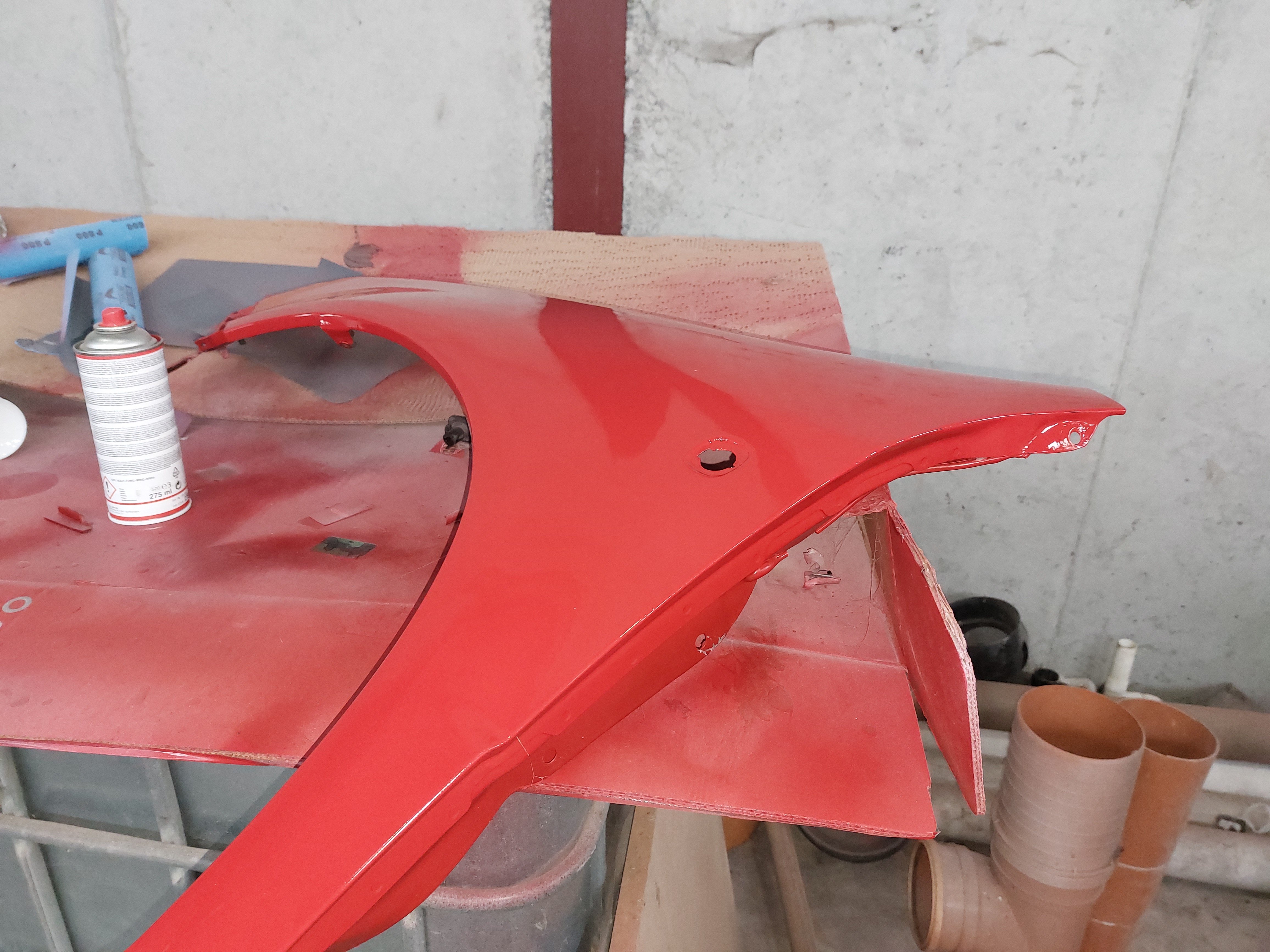

Also started painting the wing.
More work on the vrs

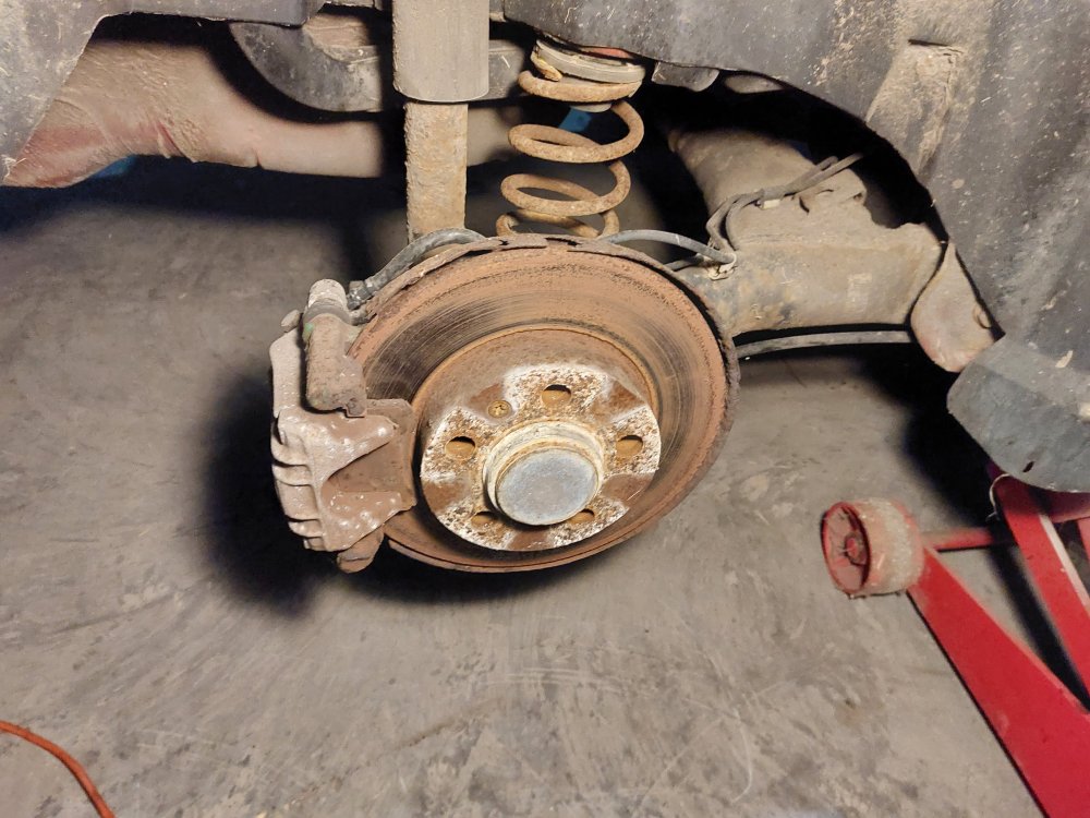

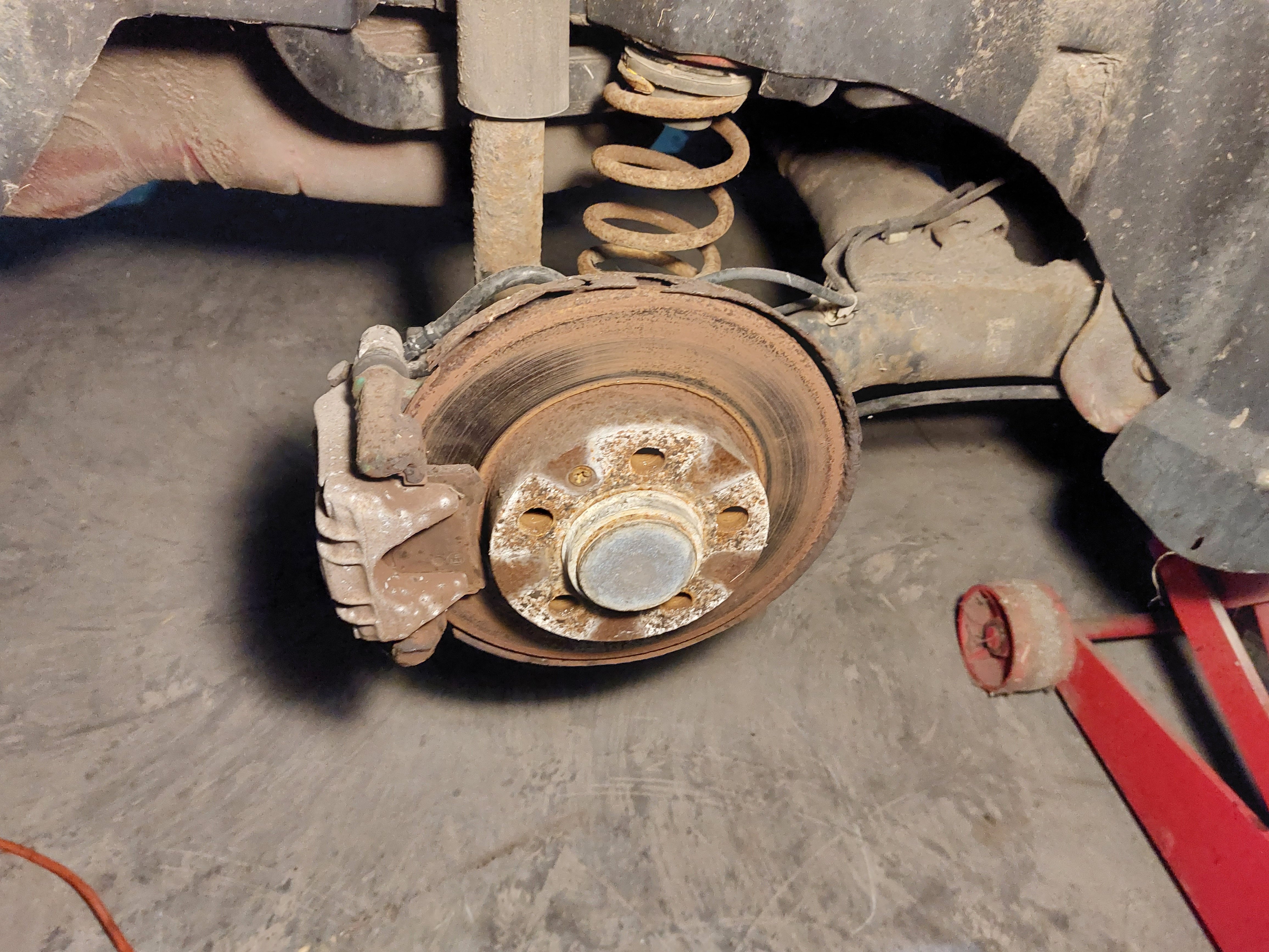

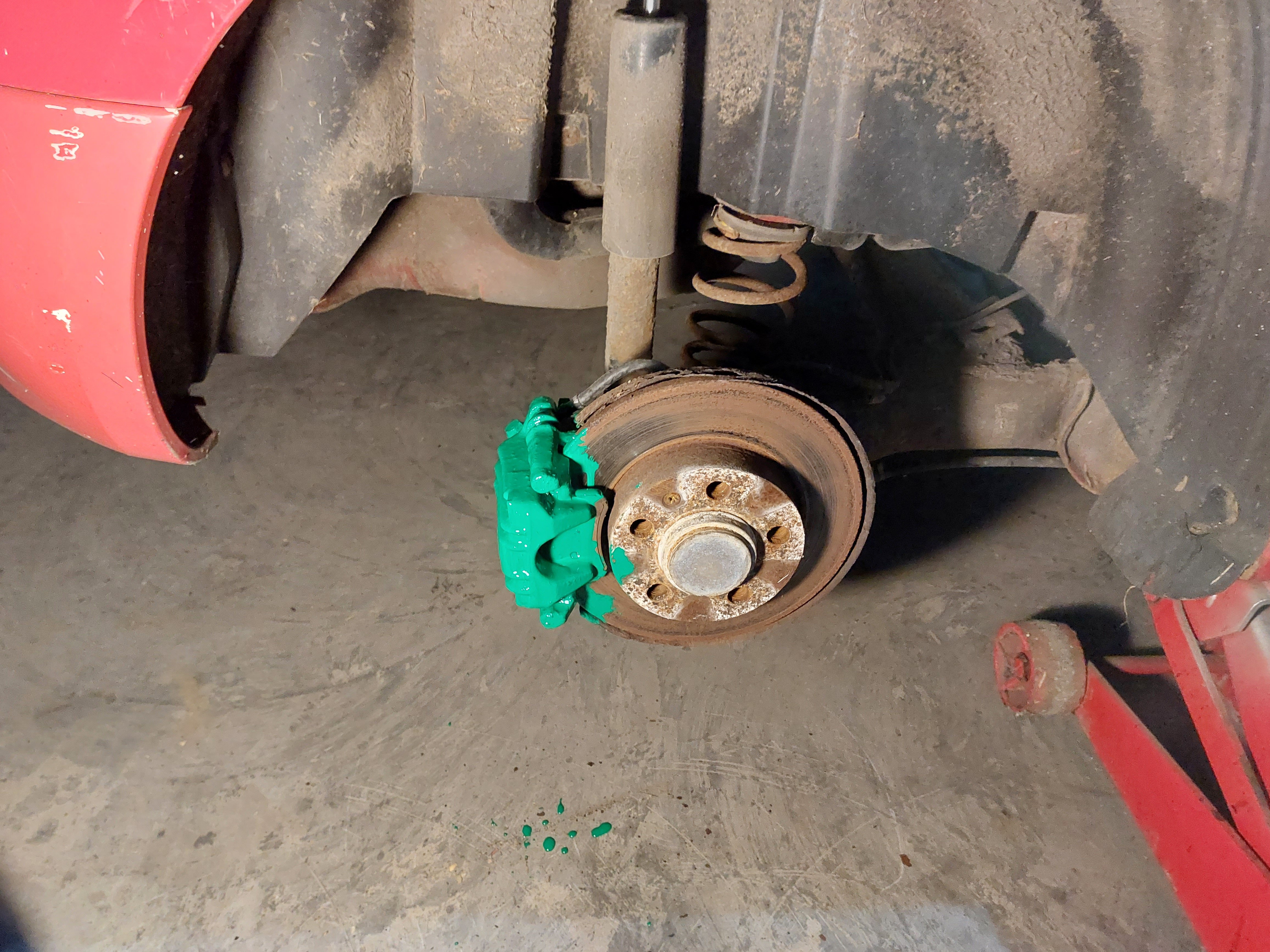

Very quickly slapped paint on the rear brakes.

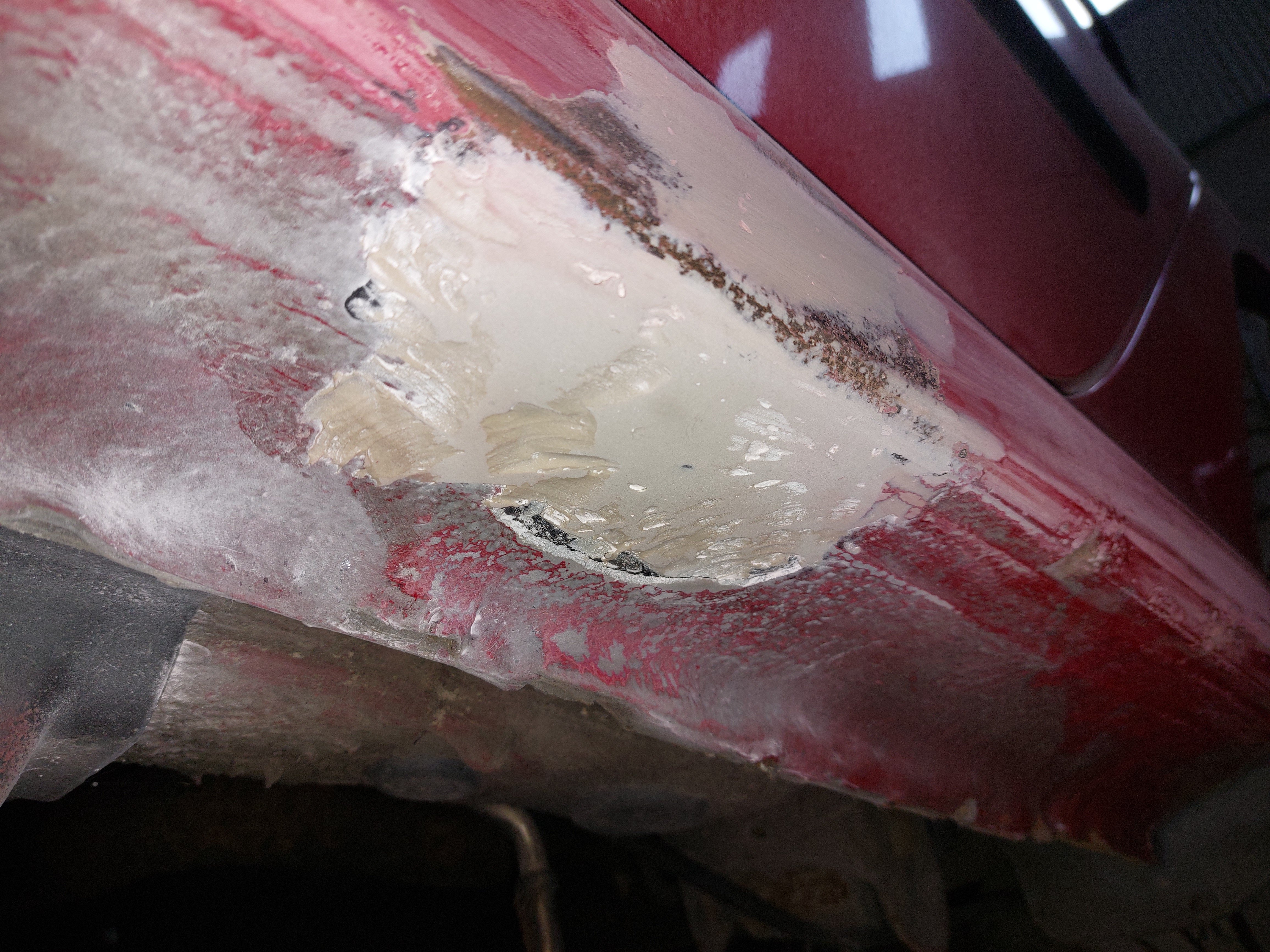

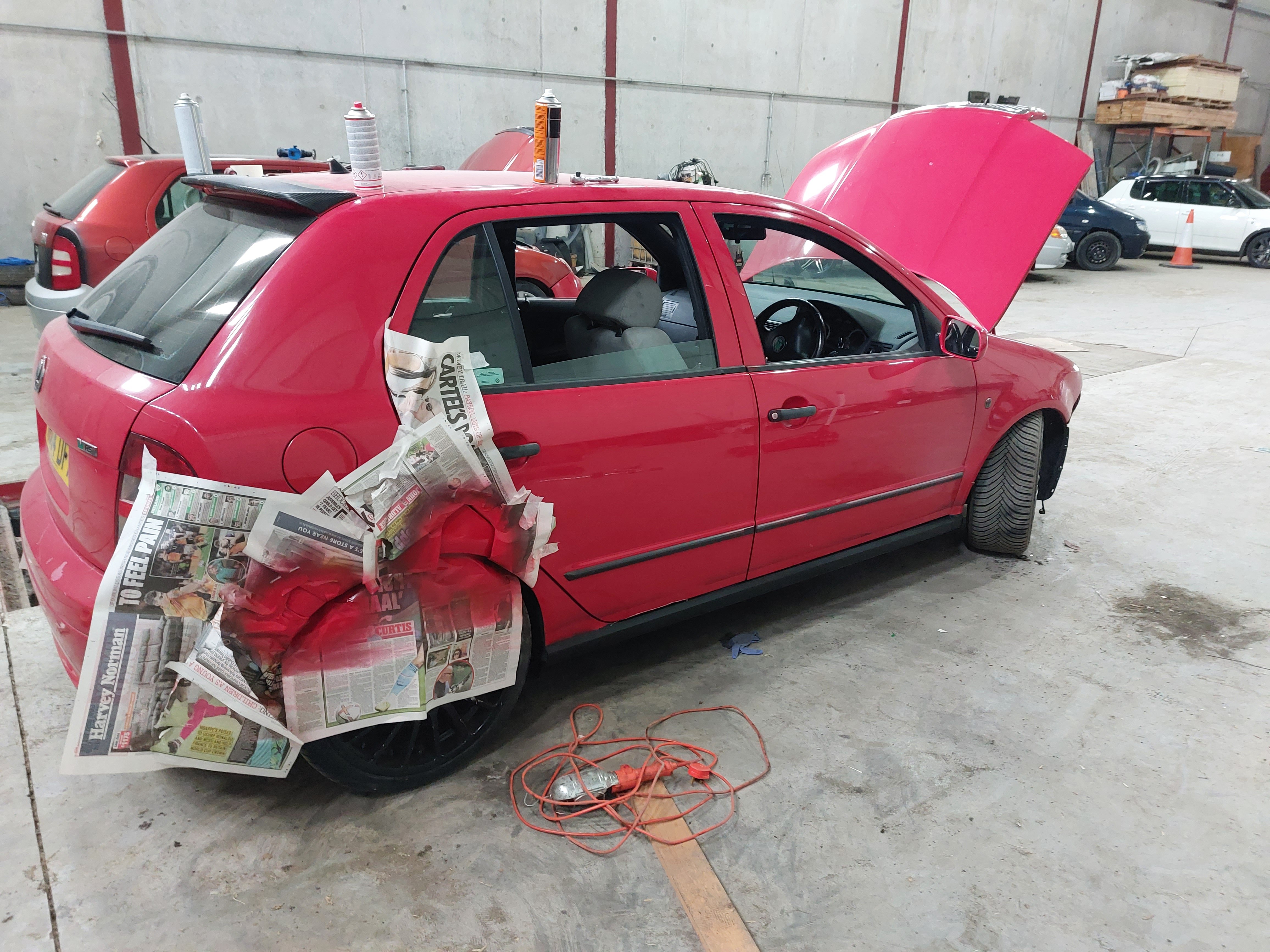

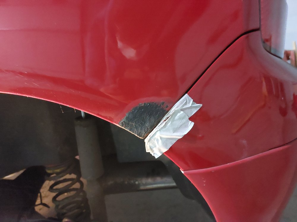

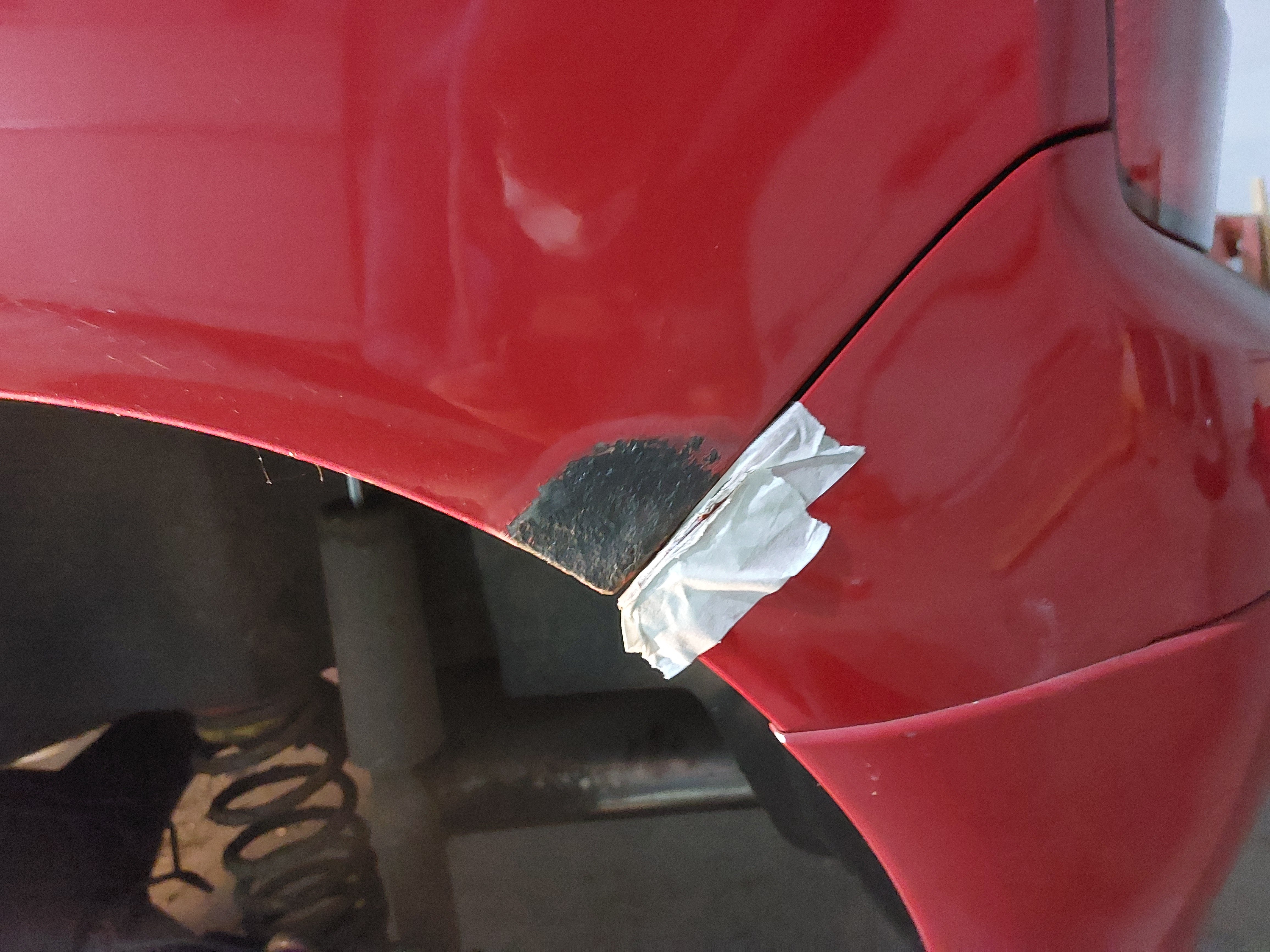

More work filling in a few dents on that quarter panel

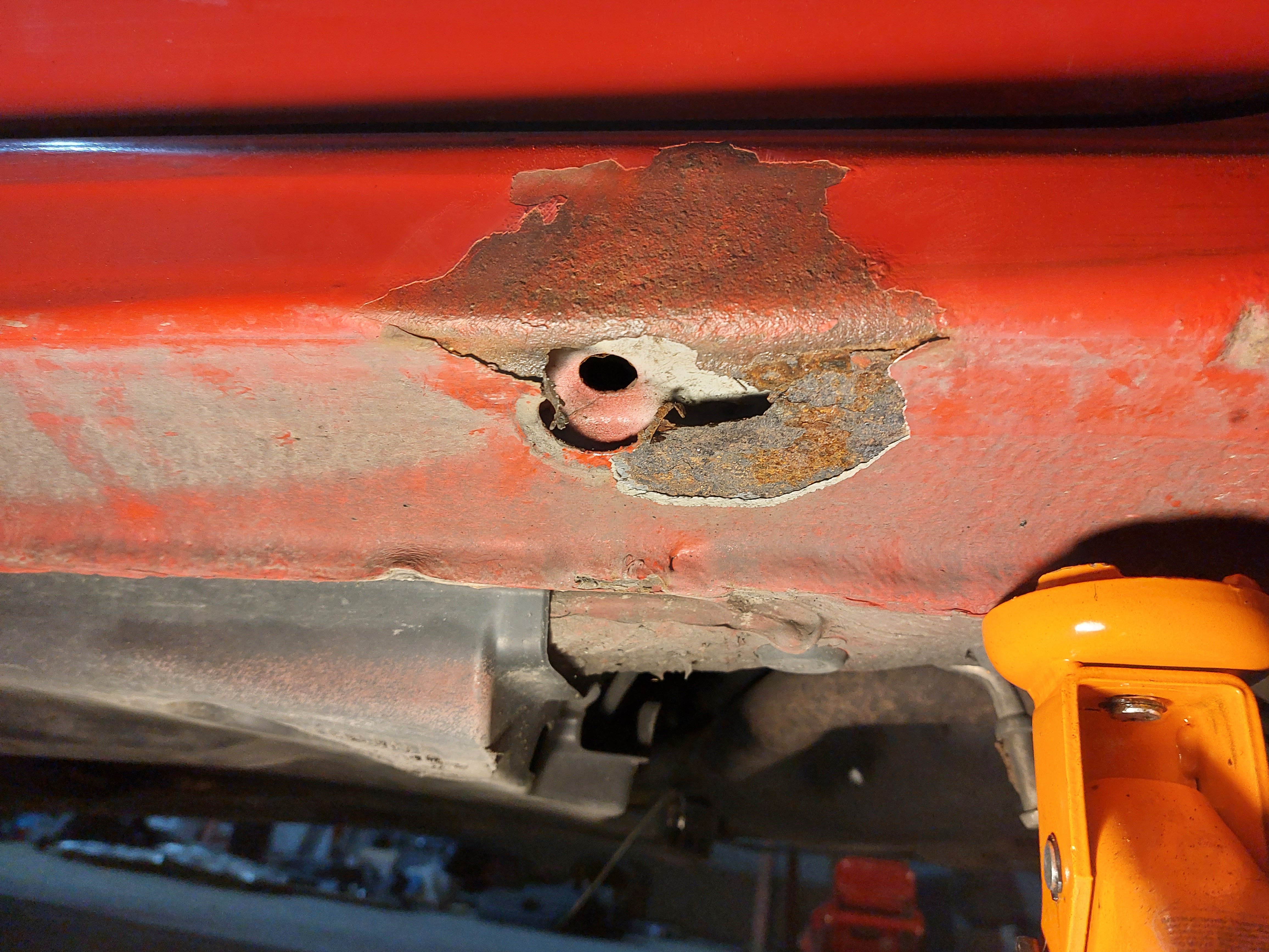

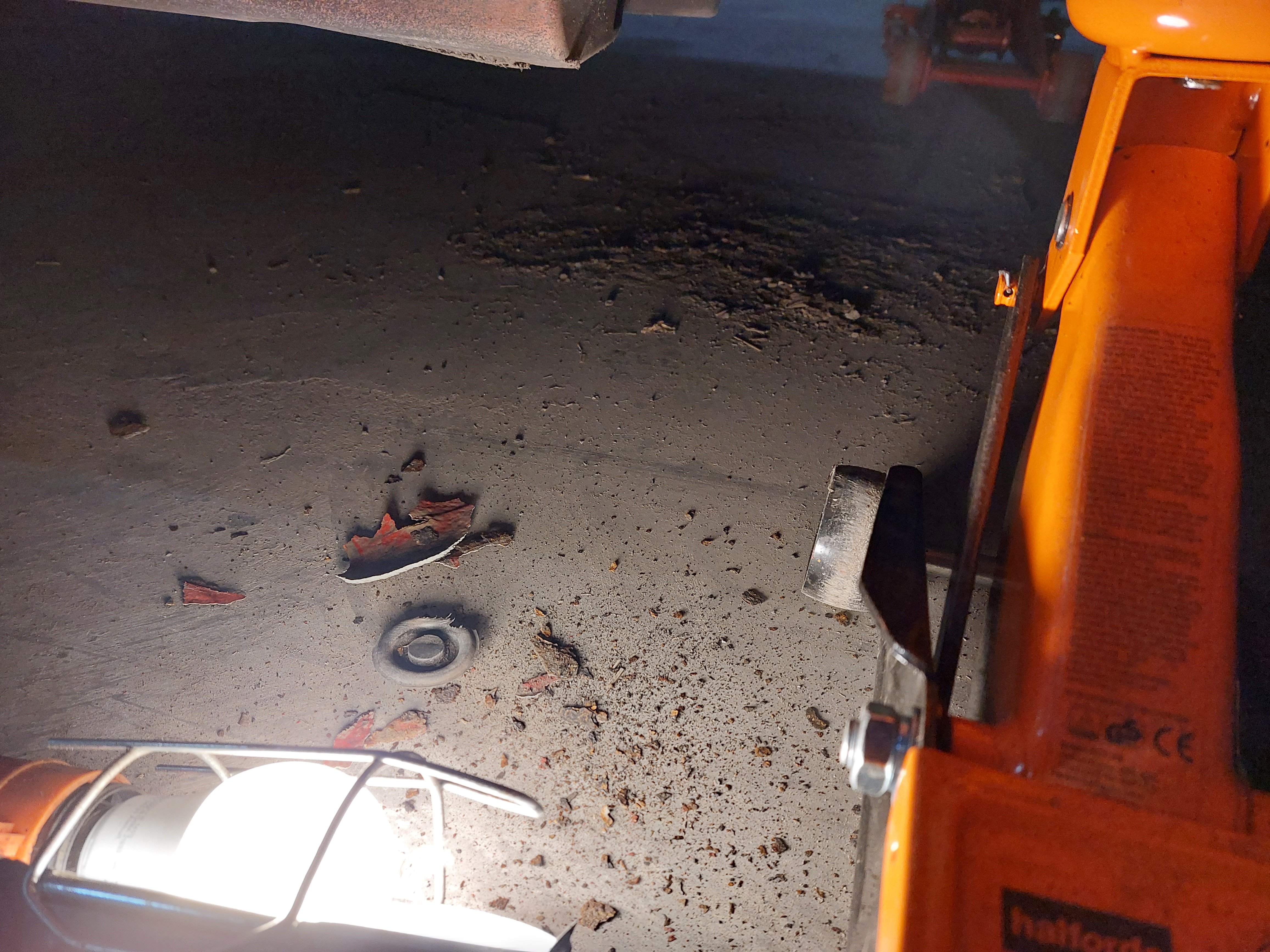

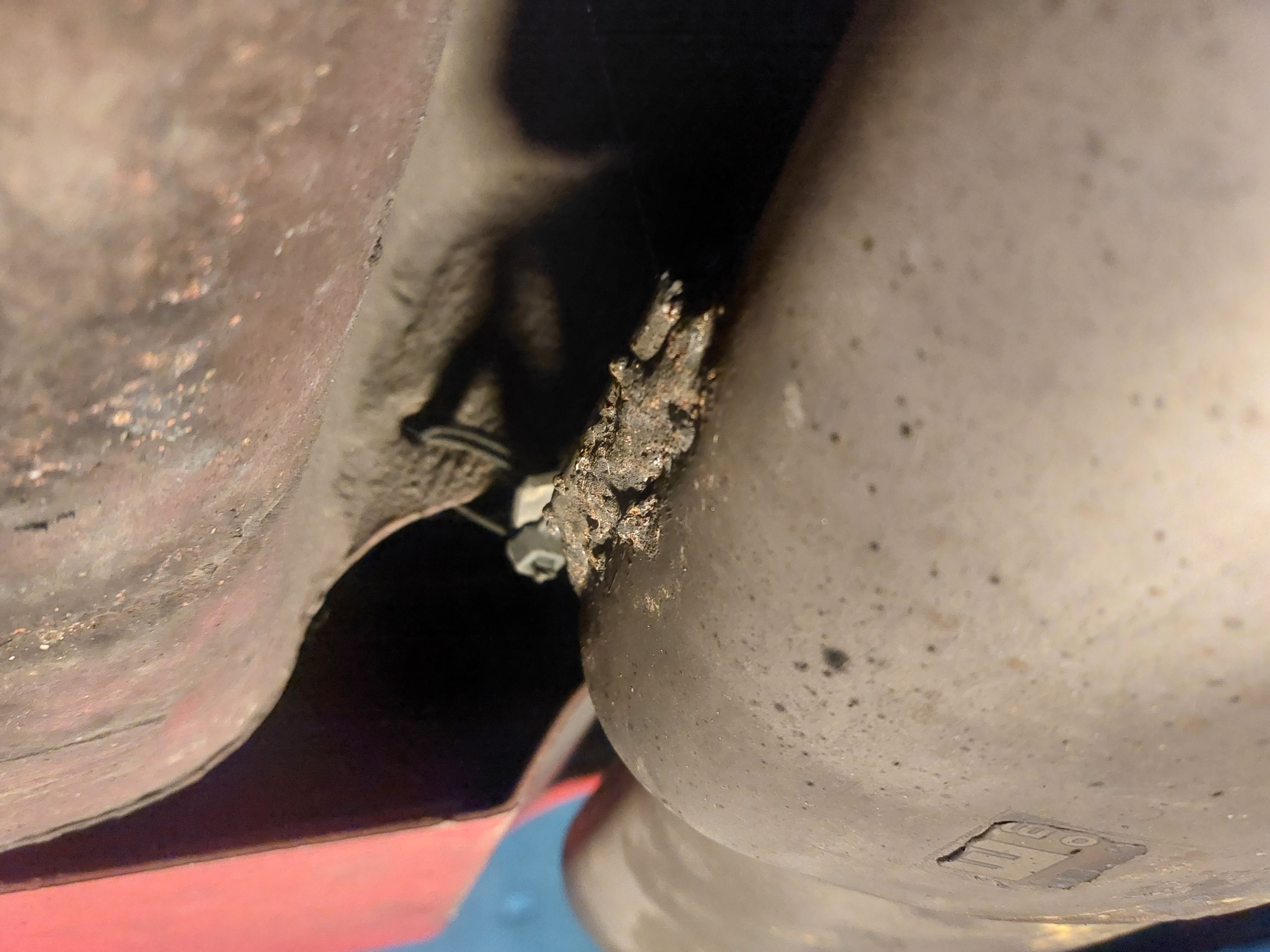

Doing a lot of wire wheeling and kurusting on it and poked through just a little bit of the sill
No holes on these little bits luckily.

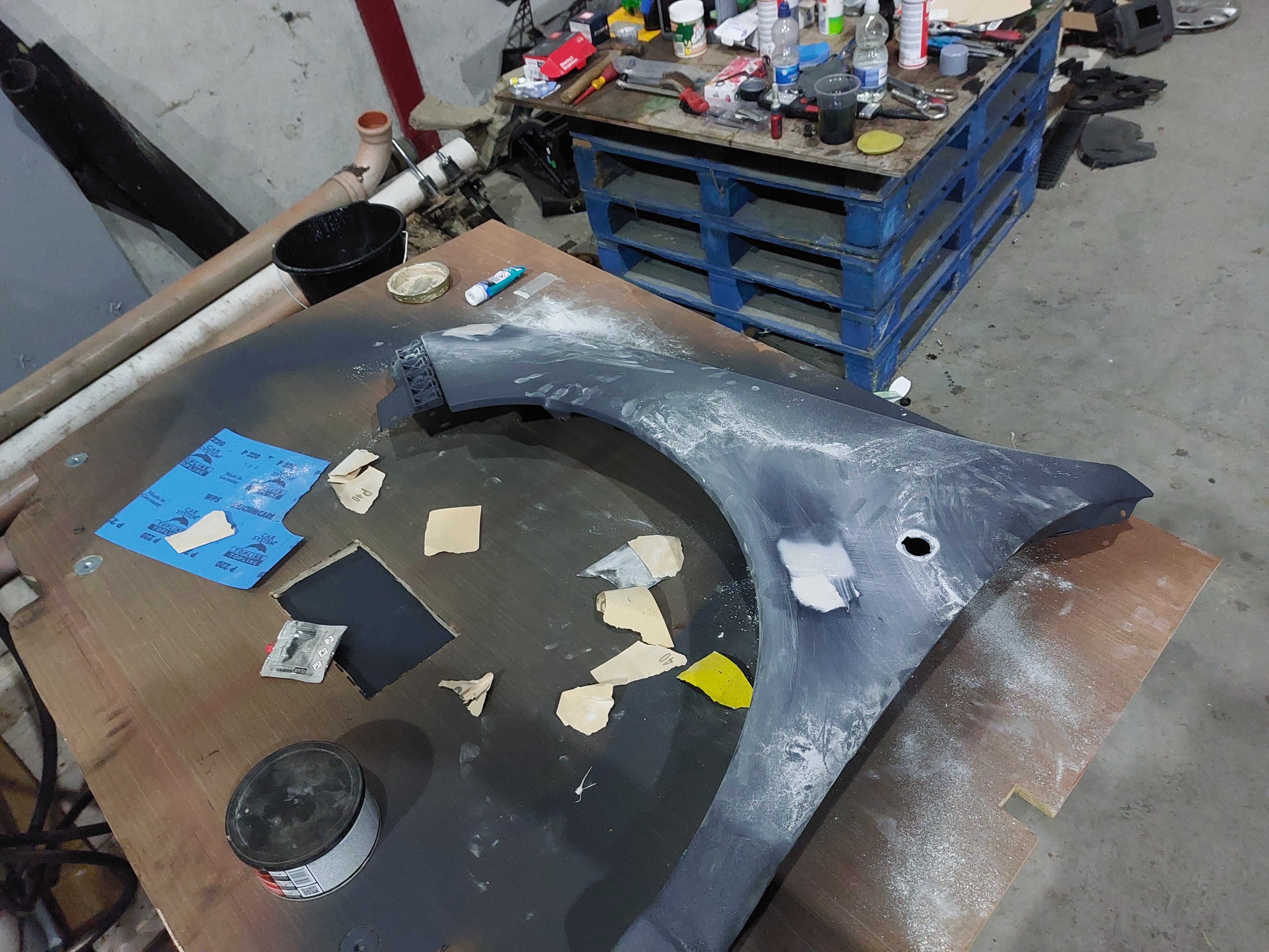

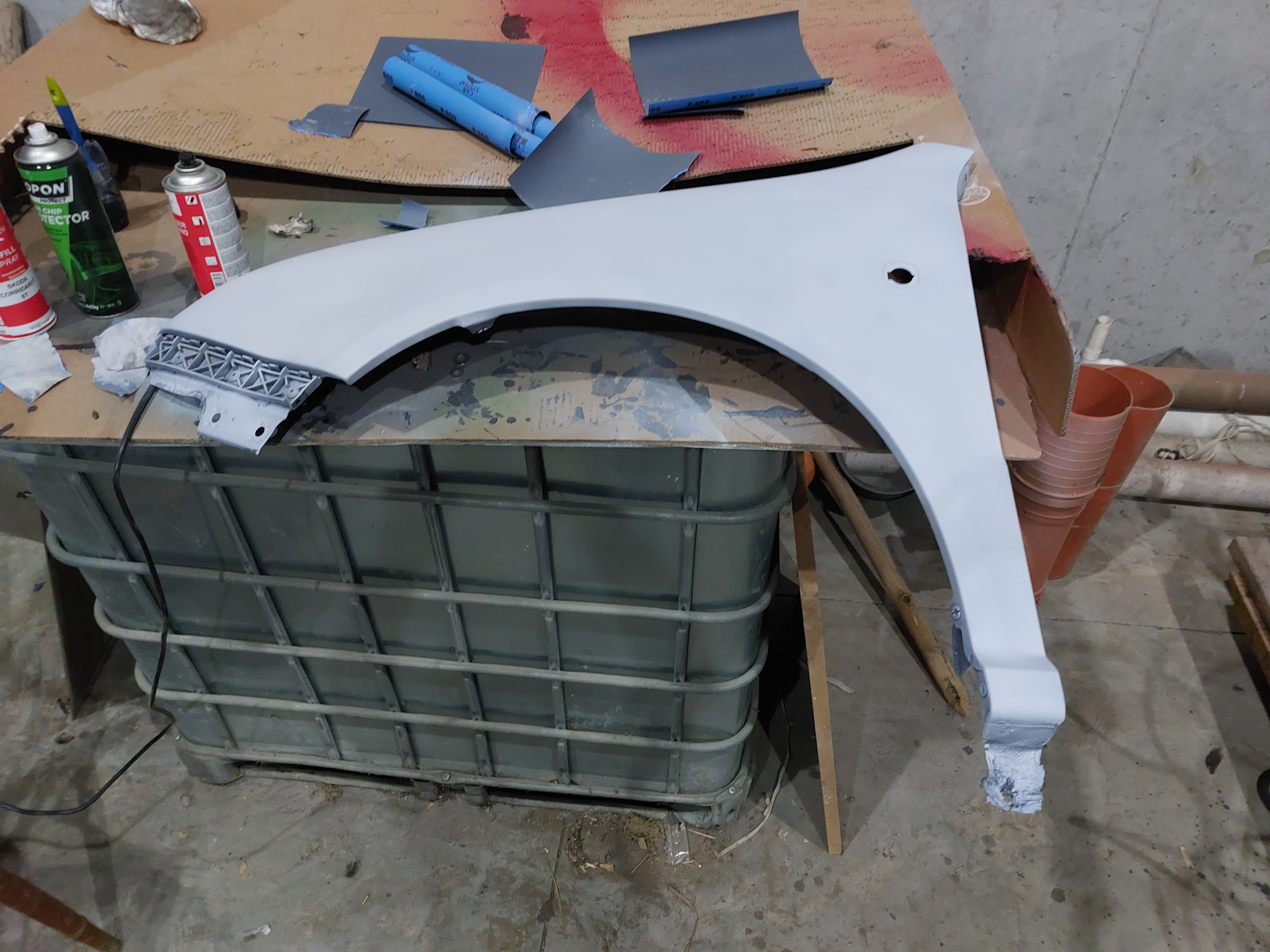

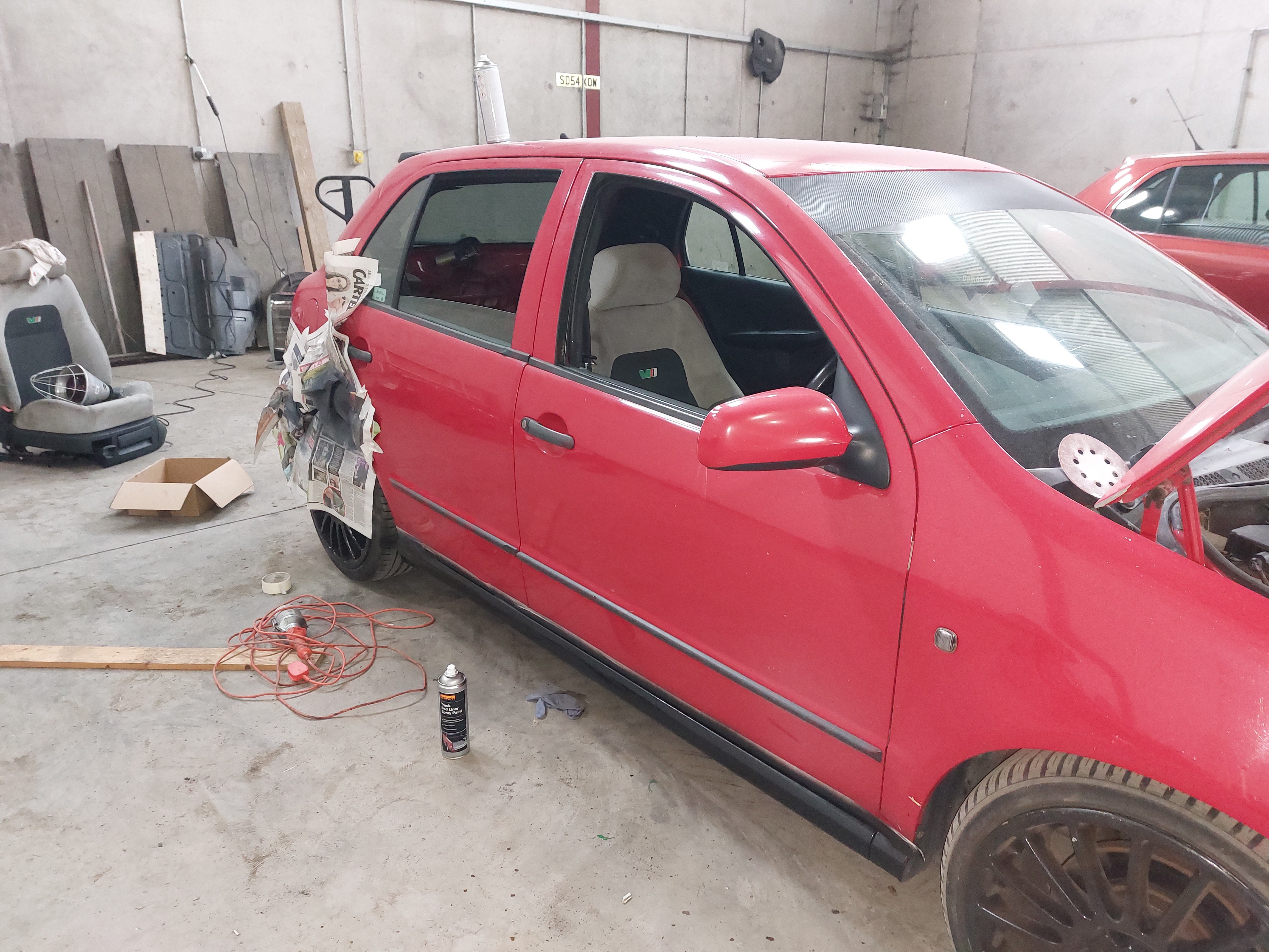

More painting and sanding and priming and filling.
Half ass spray can job.

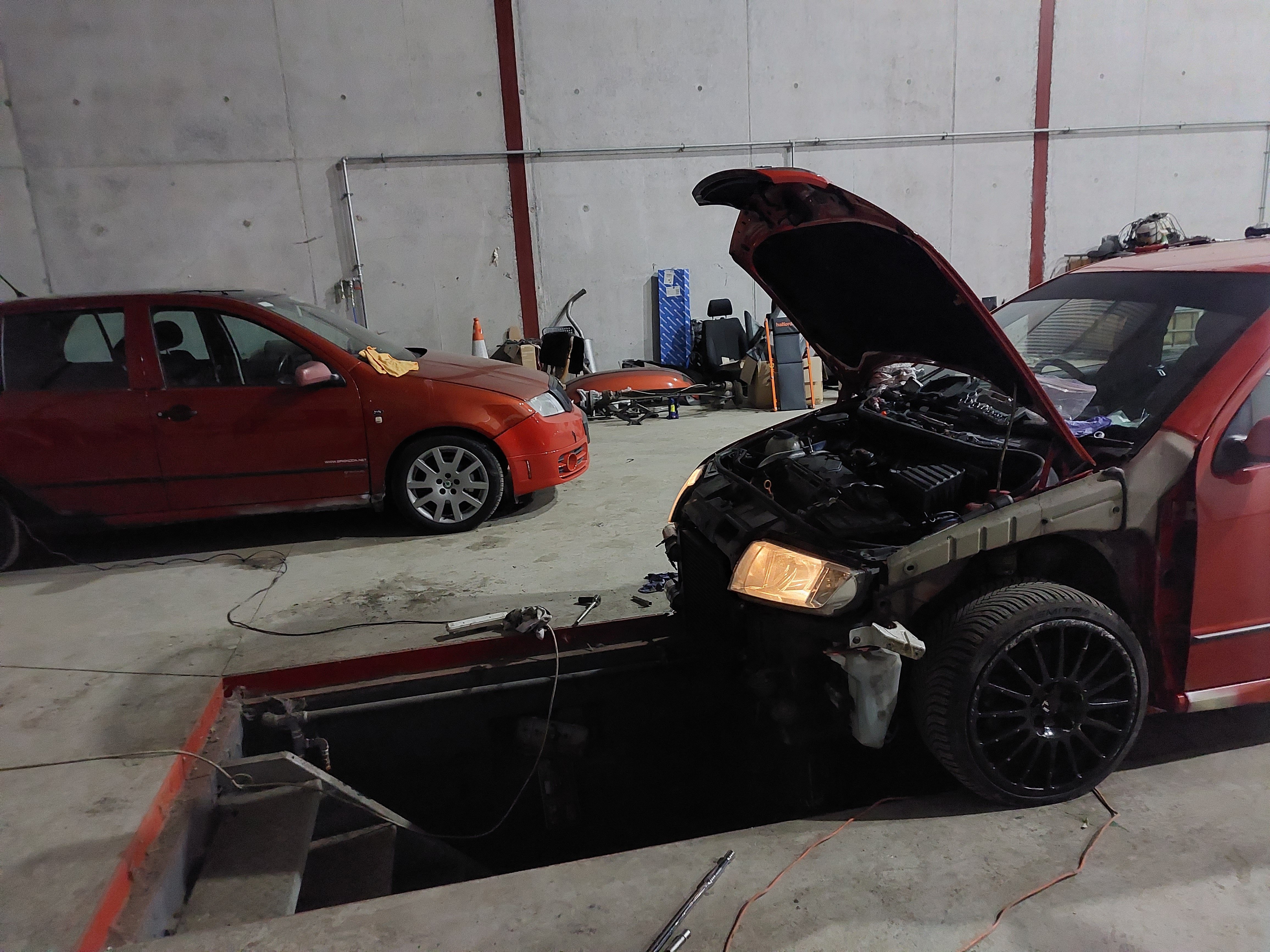

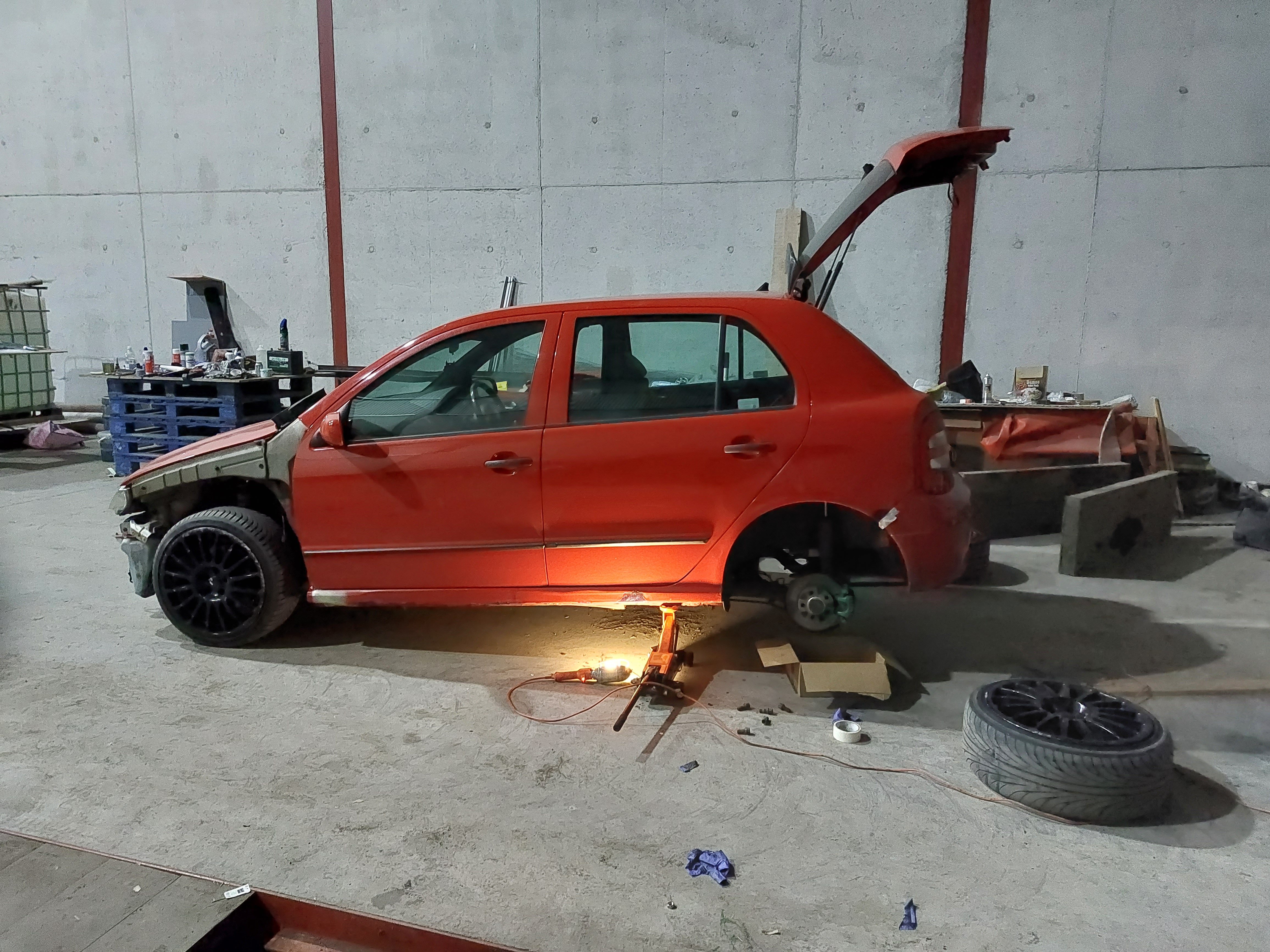

Bit more on the vrs.

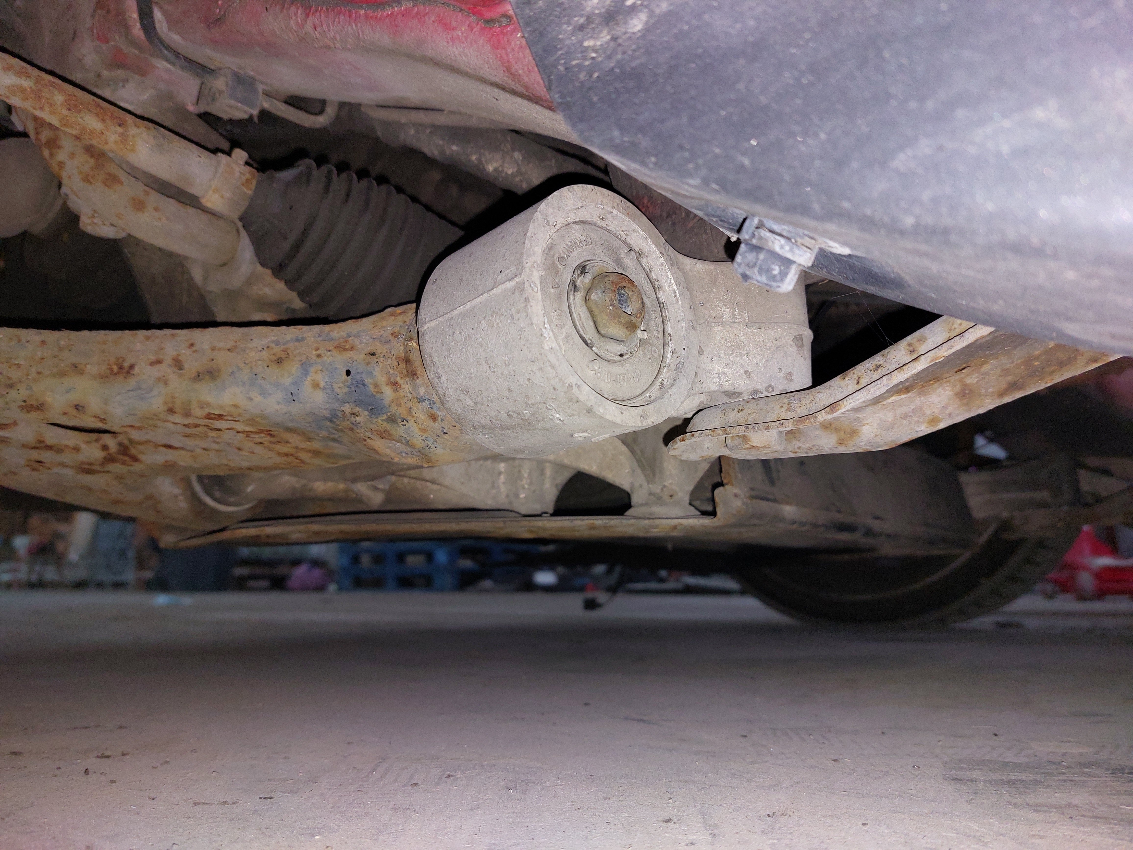

Noticed its got solid cupra bushes in

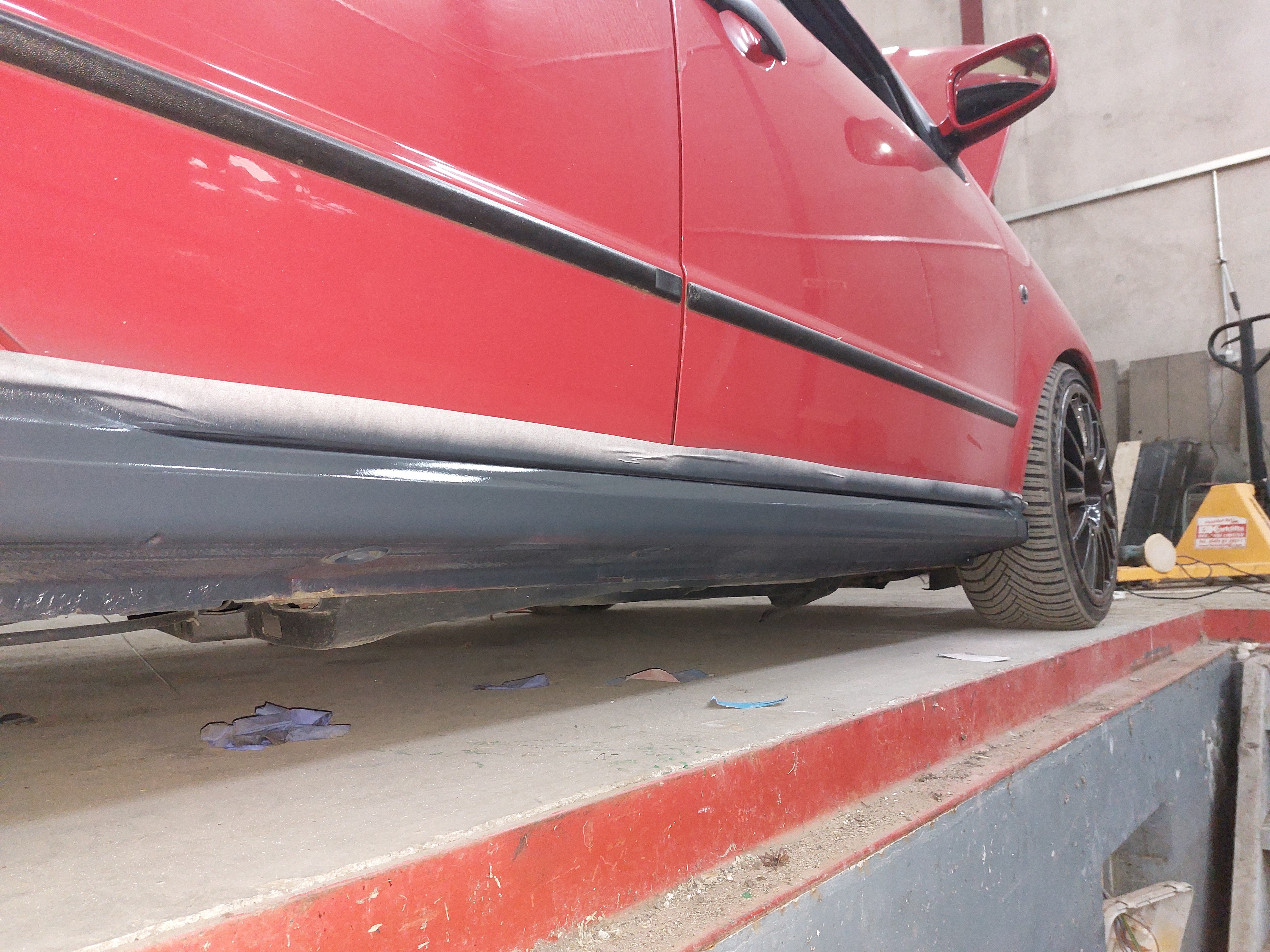

Filled over the rust hole on the sill
Primed both sills
And hit them with bedliner
Quarter panel is done
Bits of rot on the rear quarters are painted in
See a few spots on the bedliner where it's not perfectly straight. Will do it again.
Whole car will need a heavy cut and buff, and wetsand in and around where its been painted.

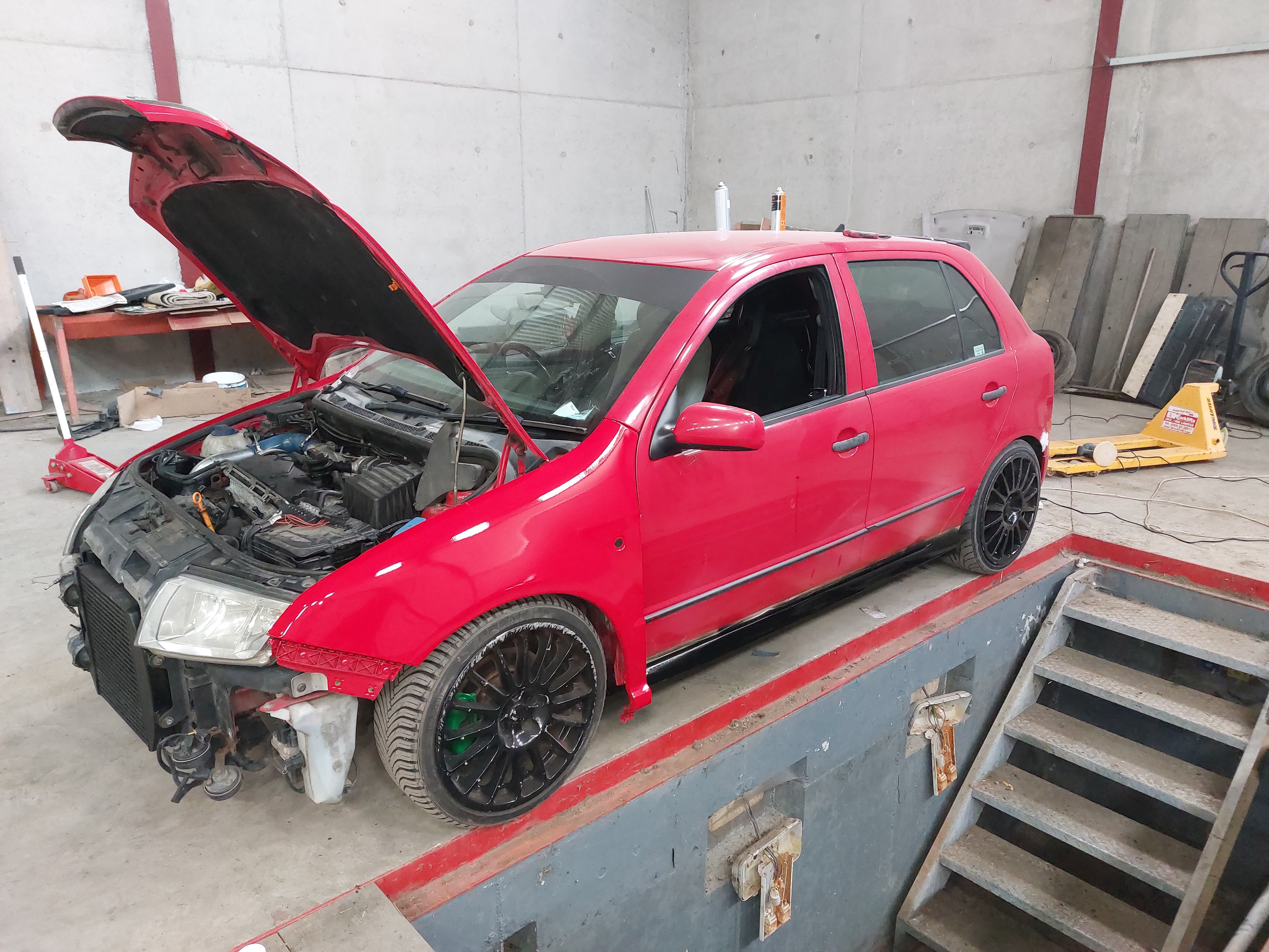

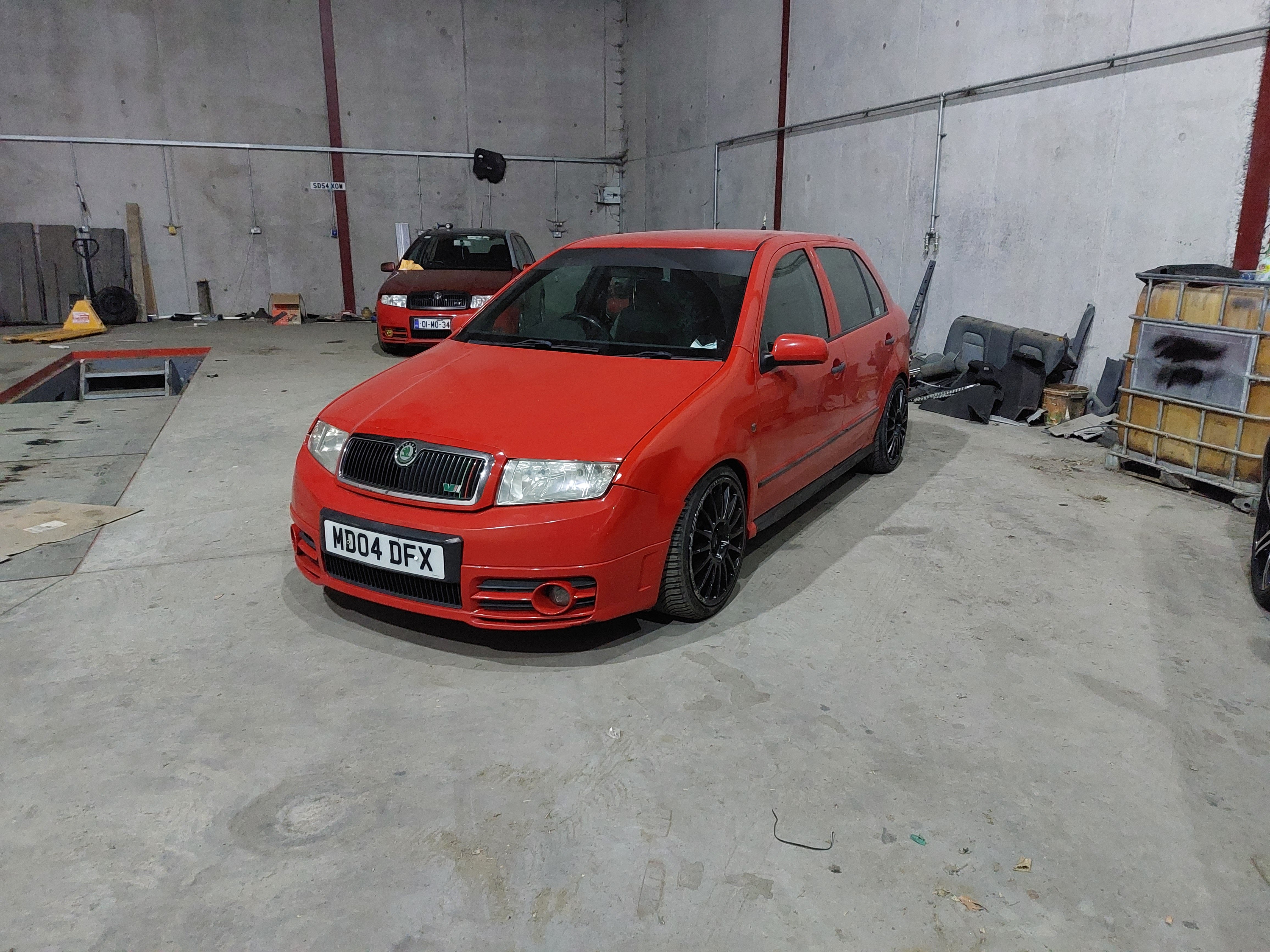

The outside of this is more or less back together now.
Fogs aren't plugged in but they're bust anyway. Few other odds and ends need sorting, big one being an interior.
Engine runs very well, very smoky on pulls, whether that'll clear out or not I'm not entirely sure.
I think I may try for mot on this, beat on it through the winter. Would be nice to have a spare car for a while.

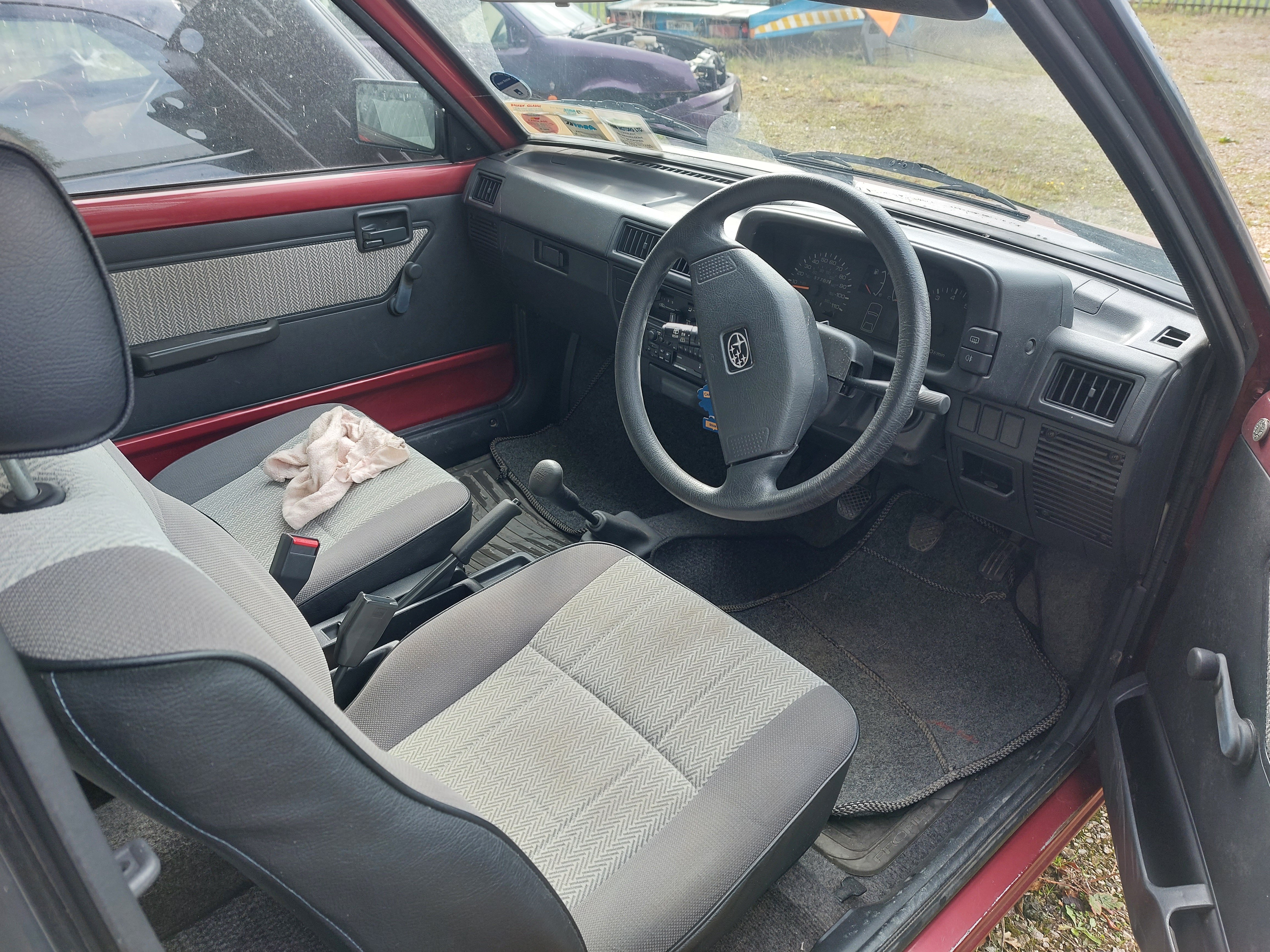

37000 miles, one owner, like new inside and out.
Been in a garage since 2010
Drove home.
Needs very little, tyres and a full service.
