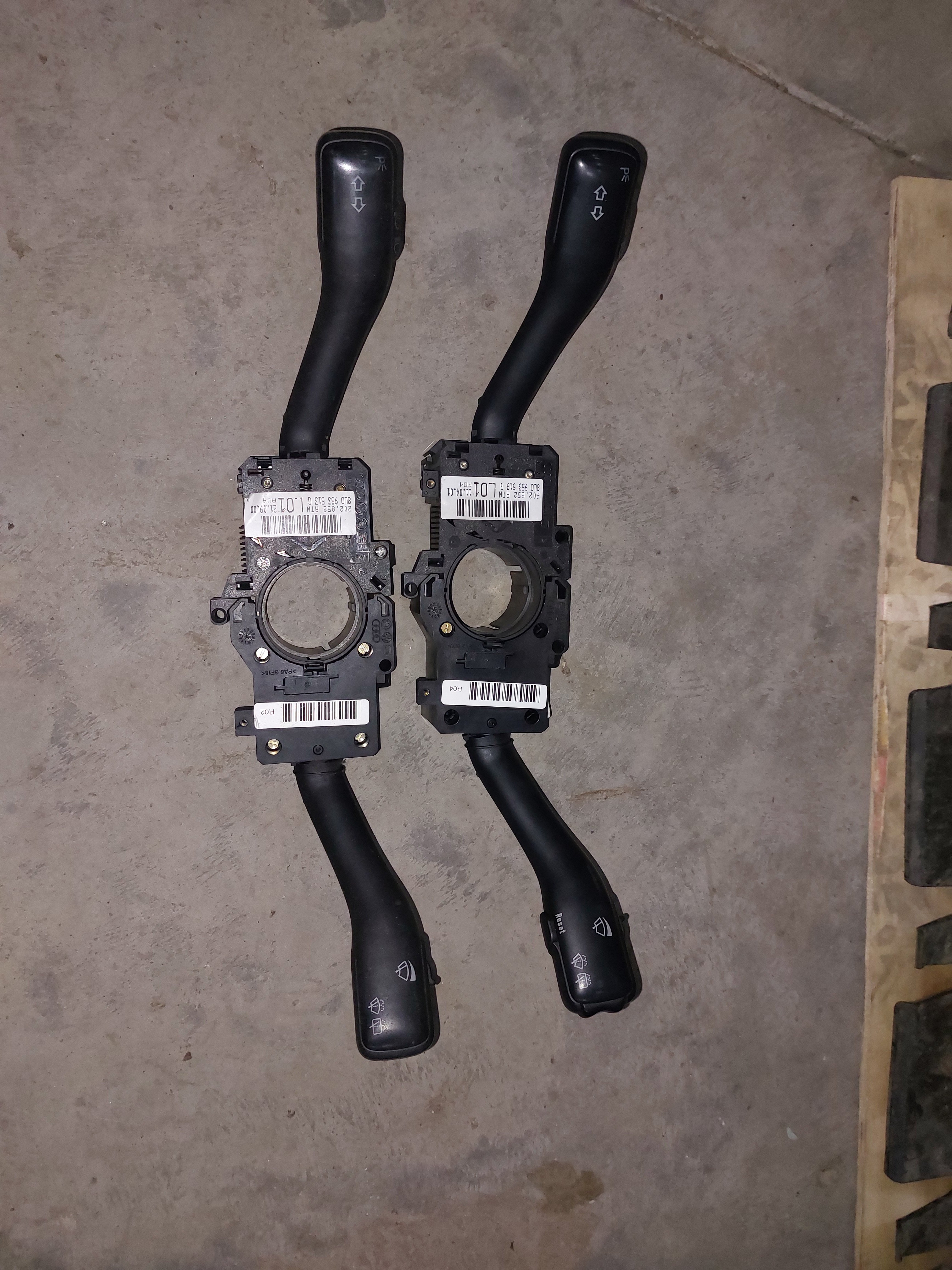

Had tried to change the stalks today and the airbag would not come out.

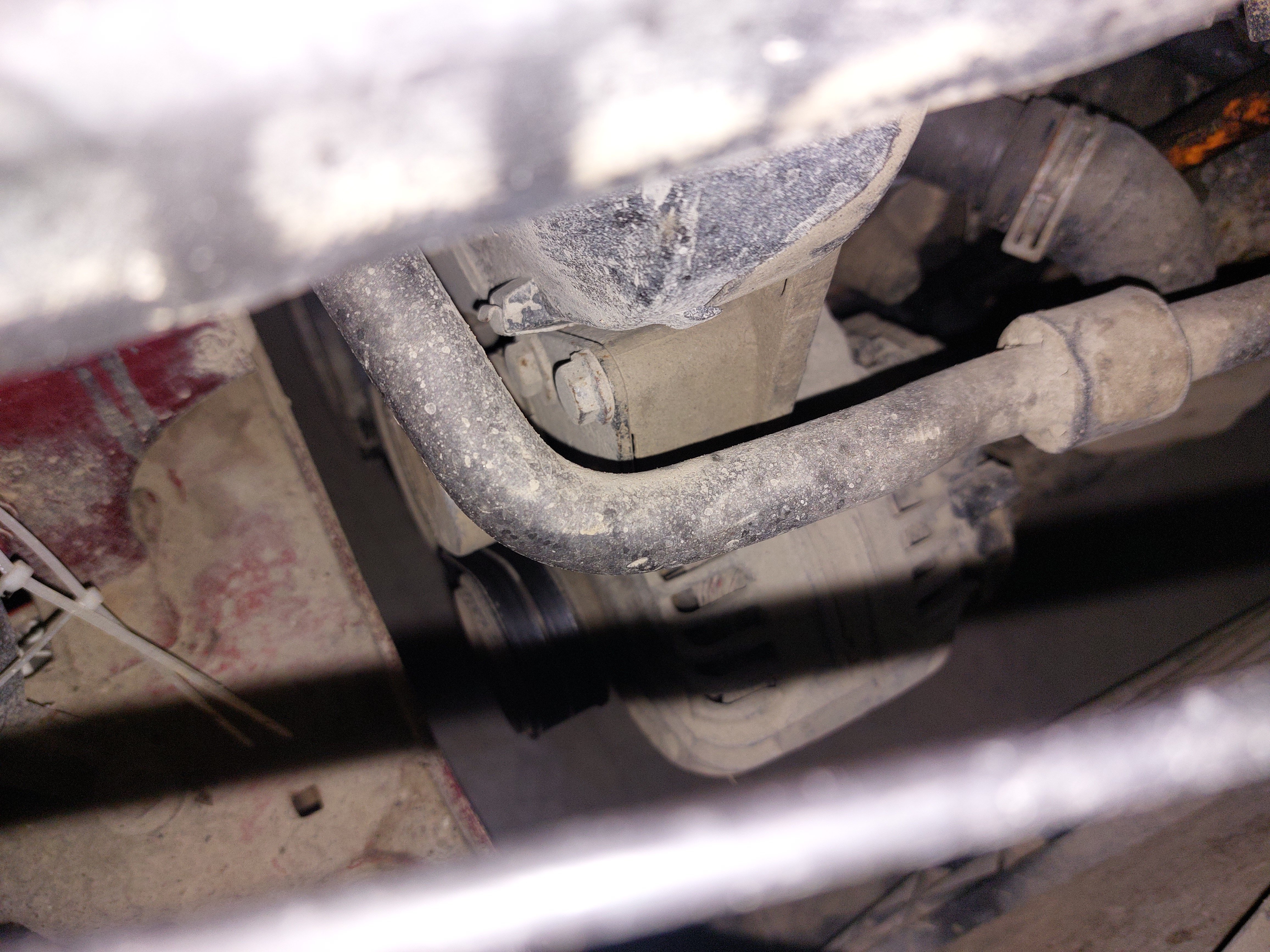

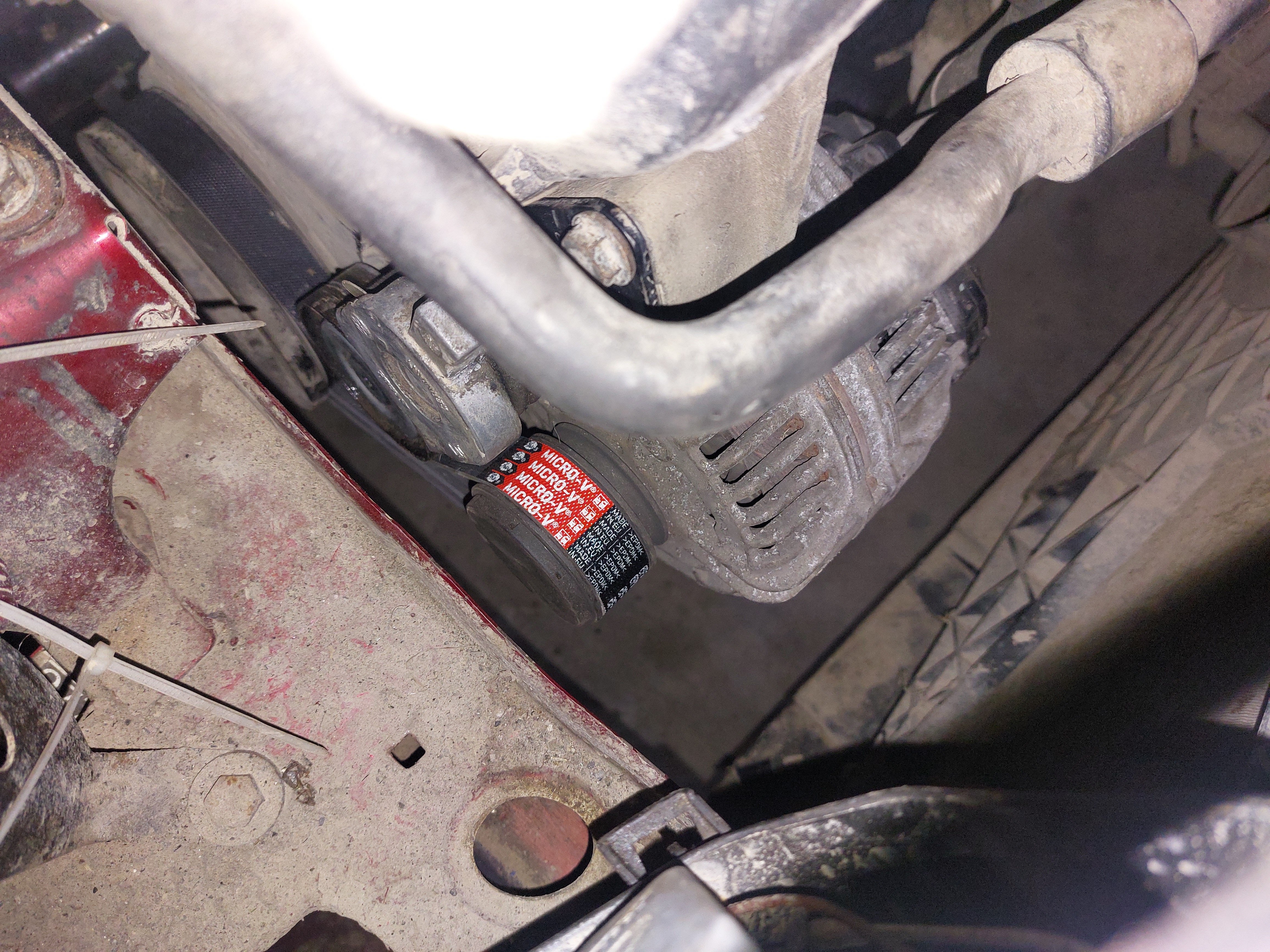

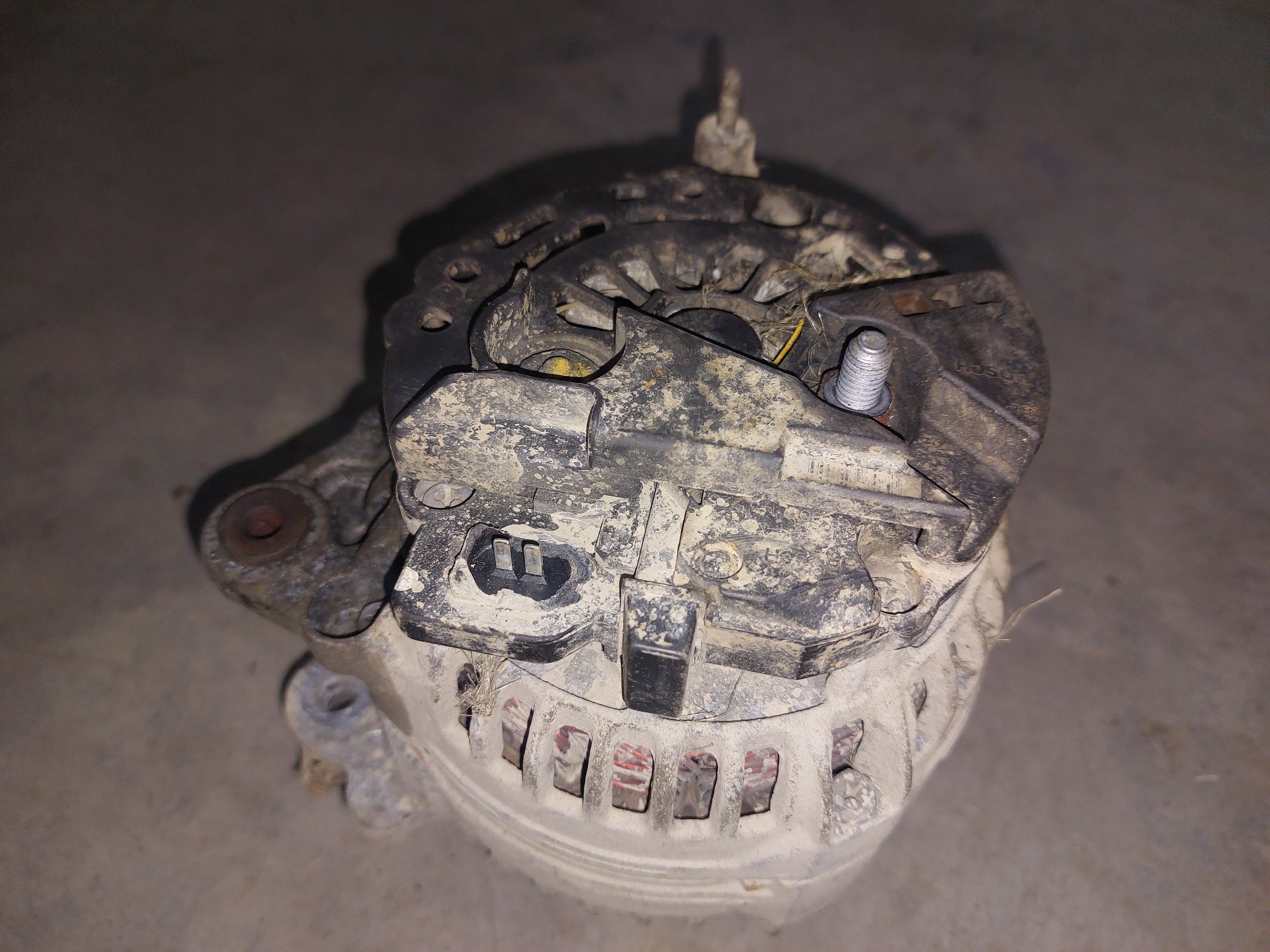

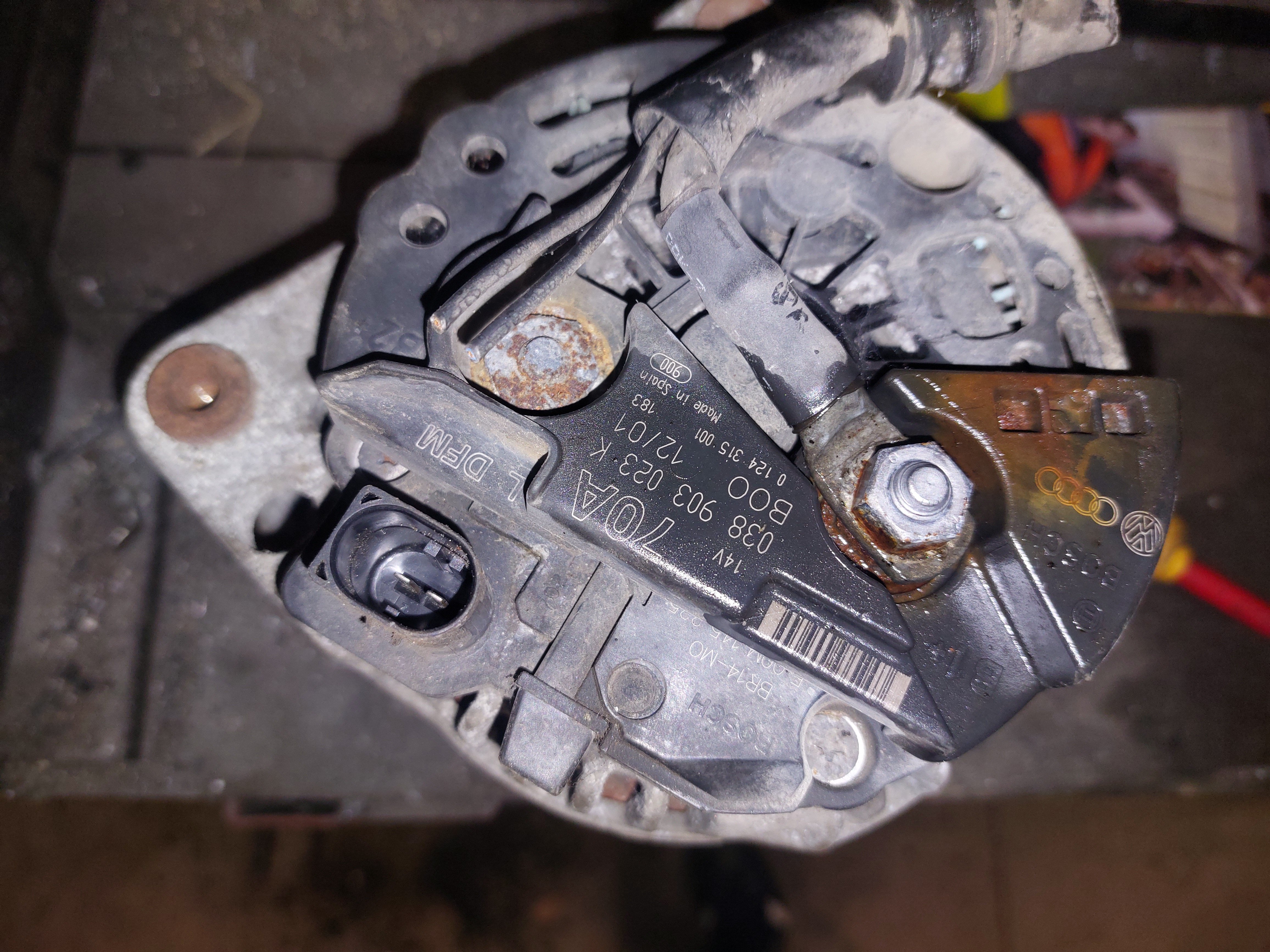

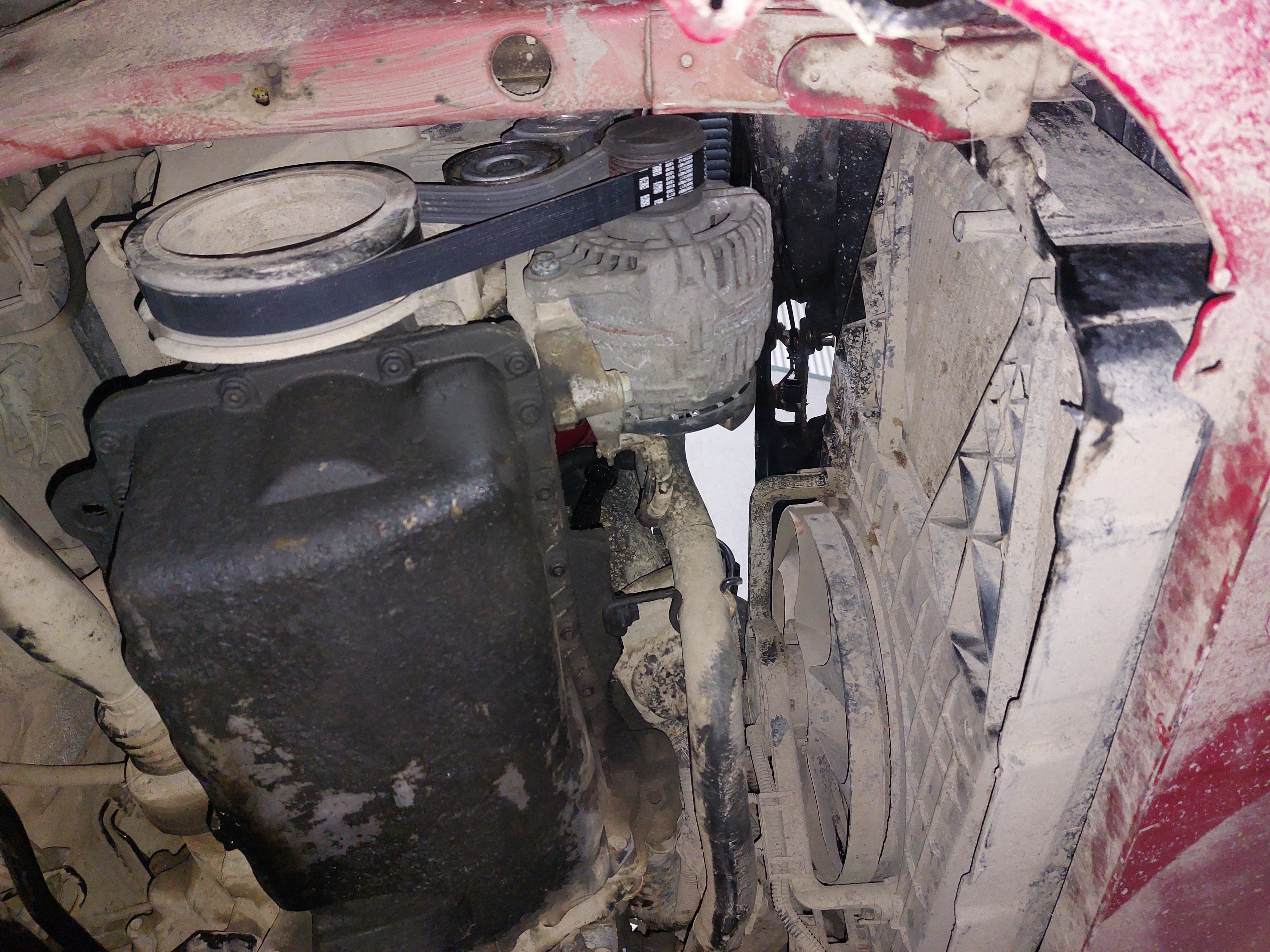

Replaced alternator this evening,
Was very easy to do and there was plenty of access.
Old alternator was missing its plug and the 8mm nut was missing.
New alternator is in better shape, looks a lot fresher.
Have a video of the old one compared to the new one.

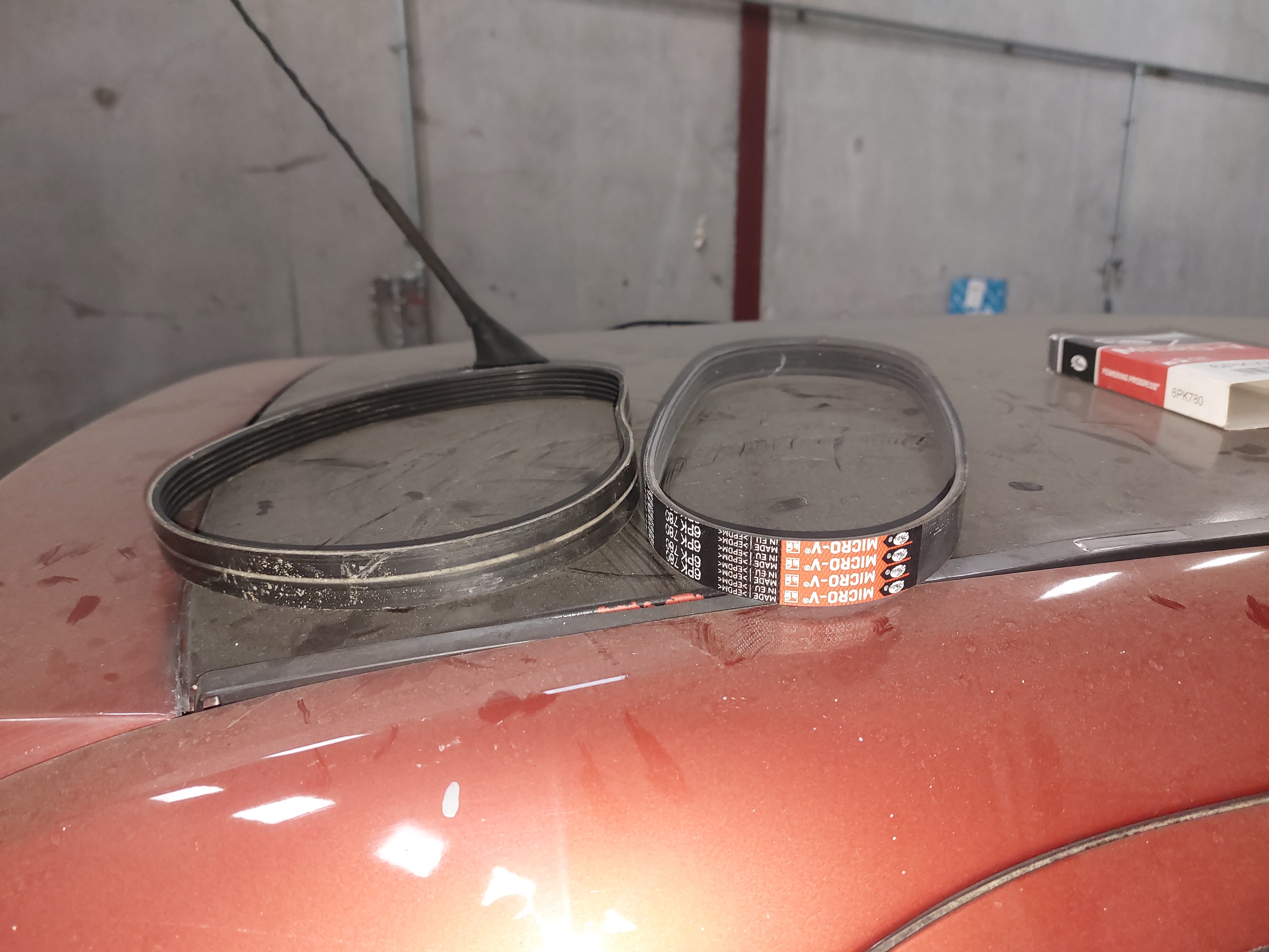

New Belt to go on aswell, old one looked a bit rough.
All went back on very easy too.
Also replaced the stalks, fixed the wiper problem but the new stalks are missing a few things, good enough for now but I'll need to get a different wiper stalk eventually.

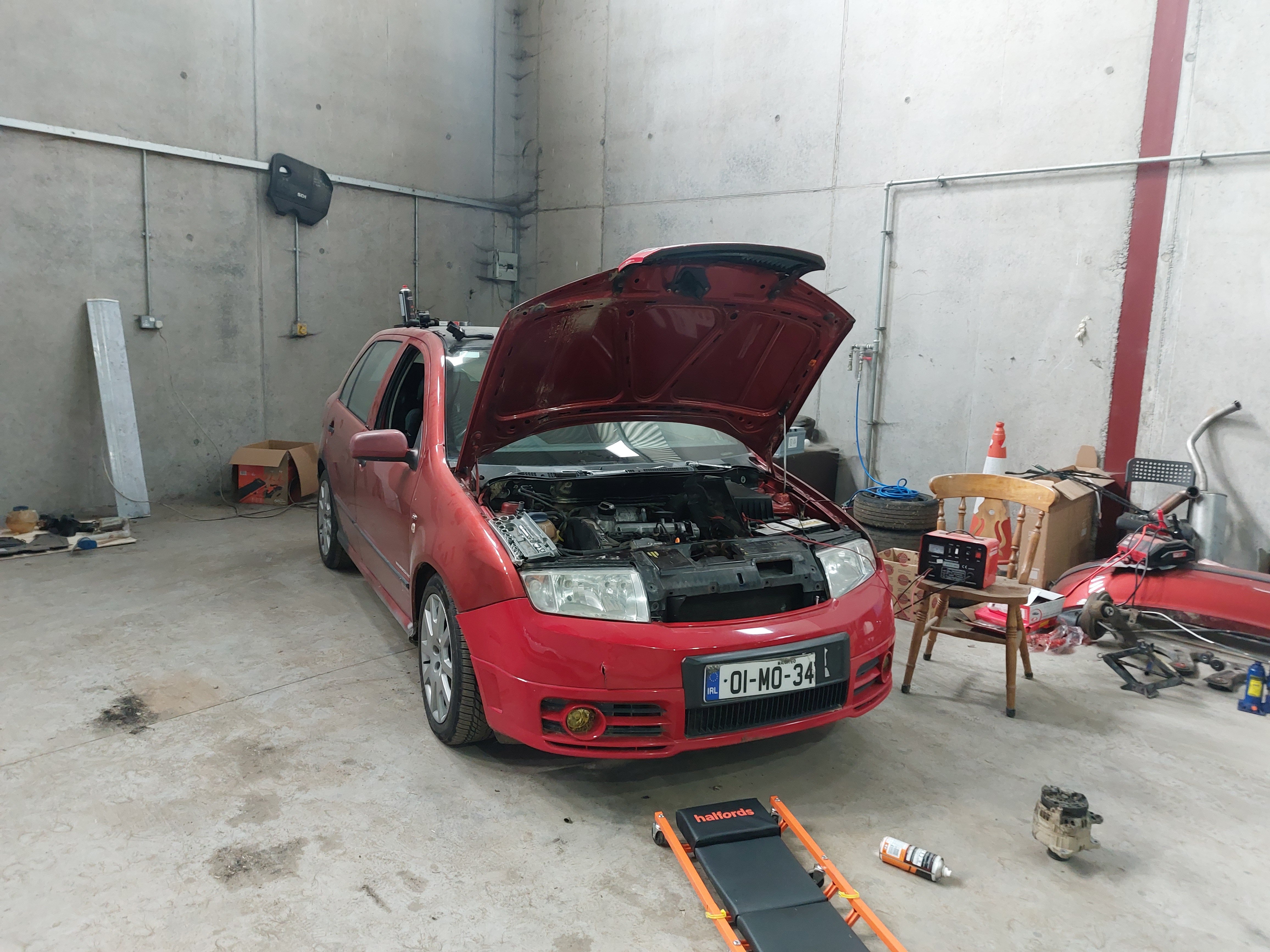

Needs to be put on the charger before I can drive it, hopefully the last time it'll need charged.

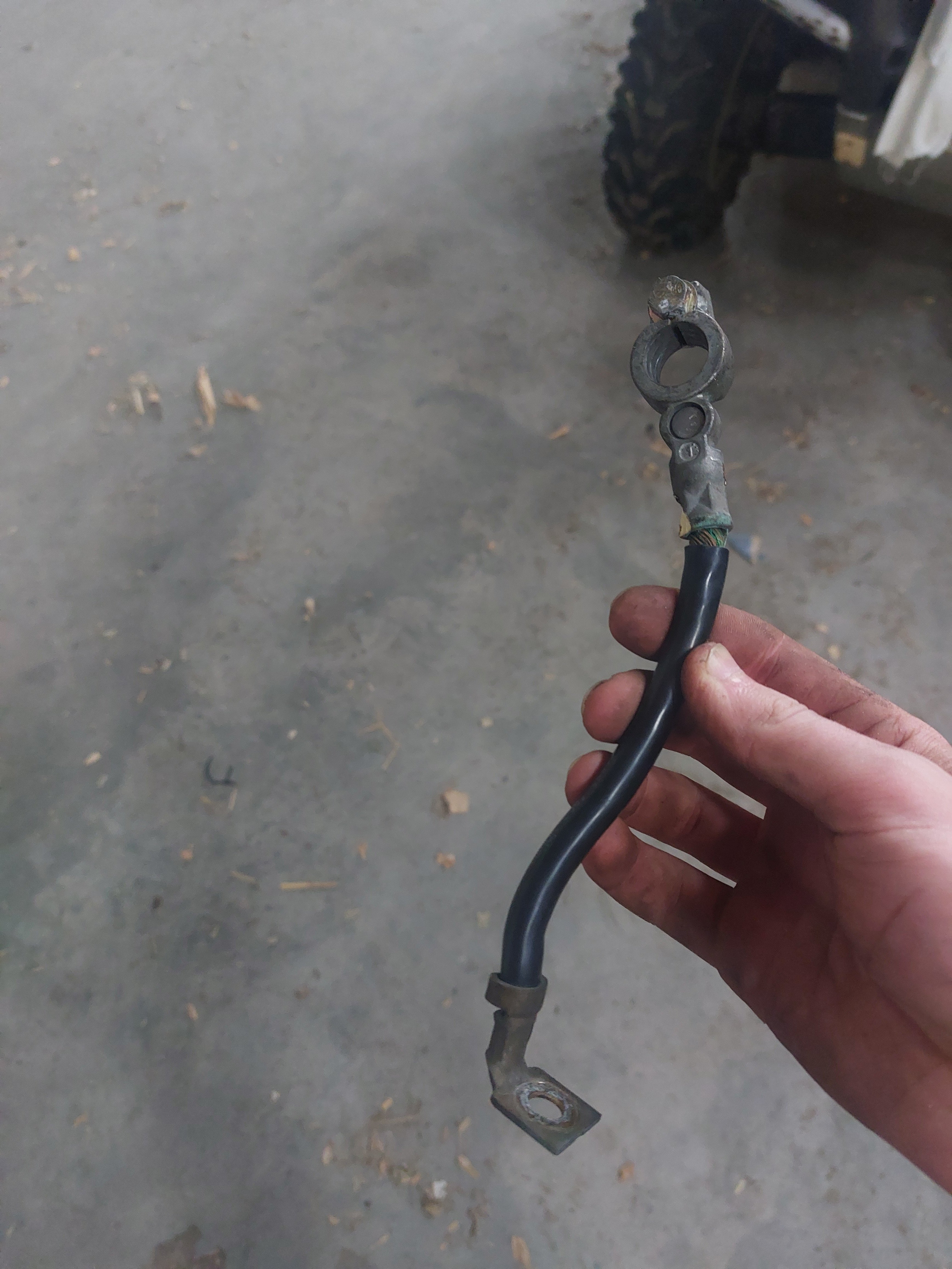

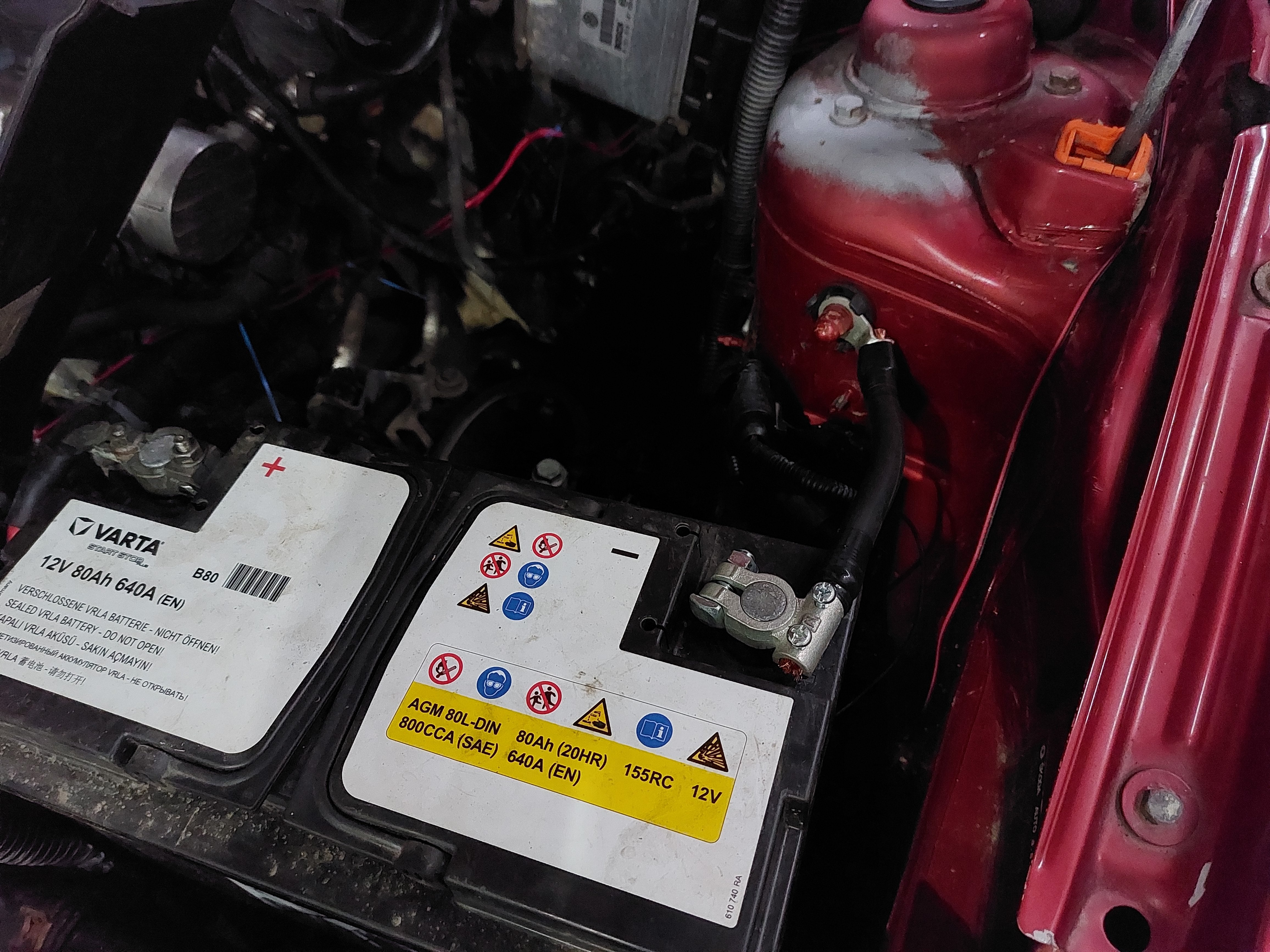

Got a new negative cable made

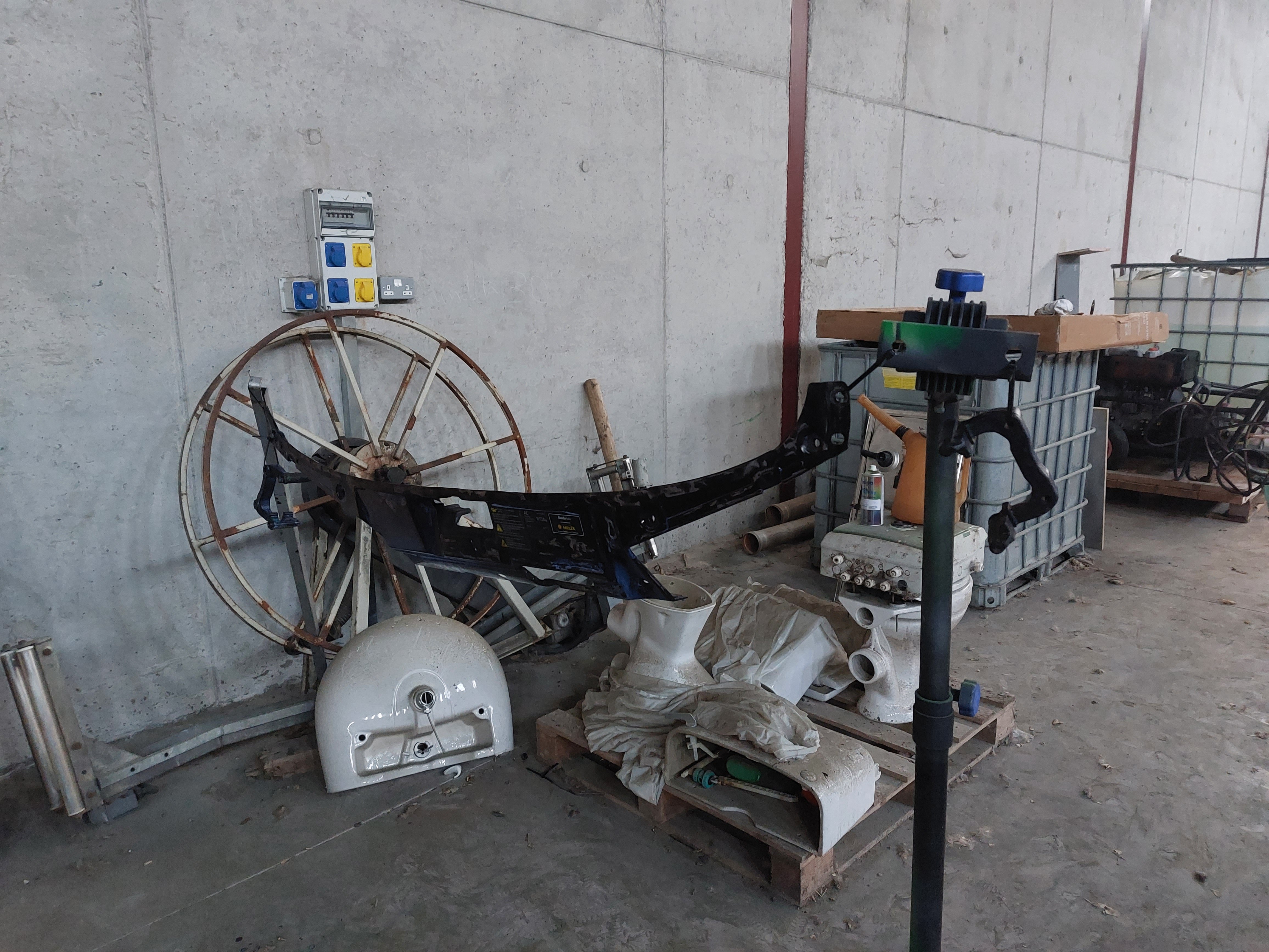

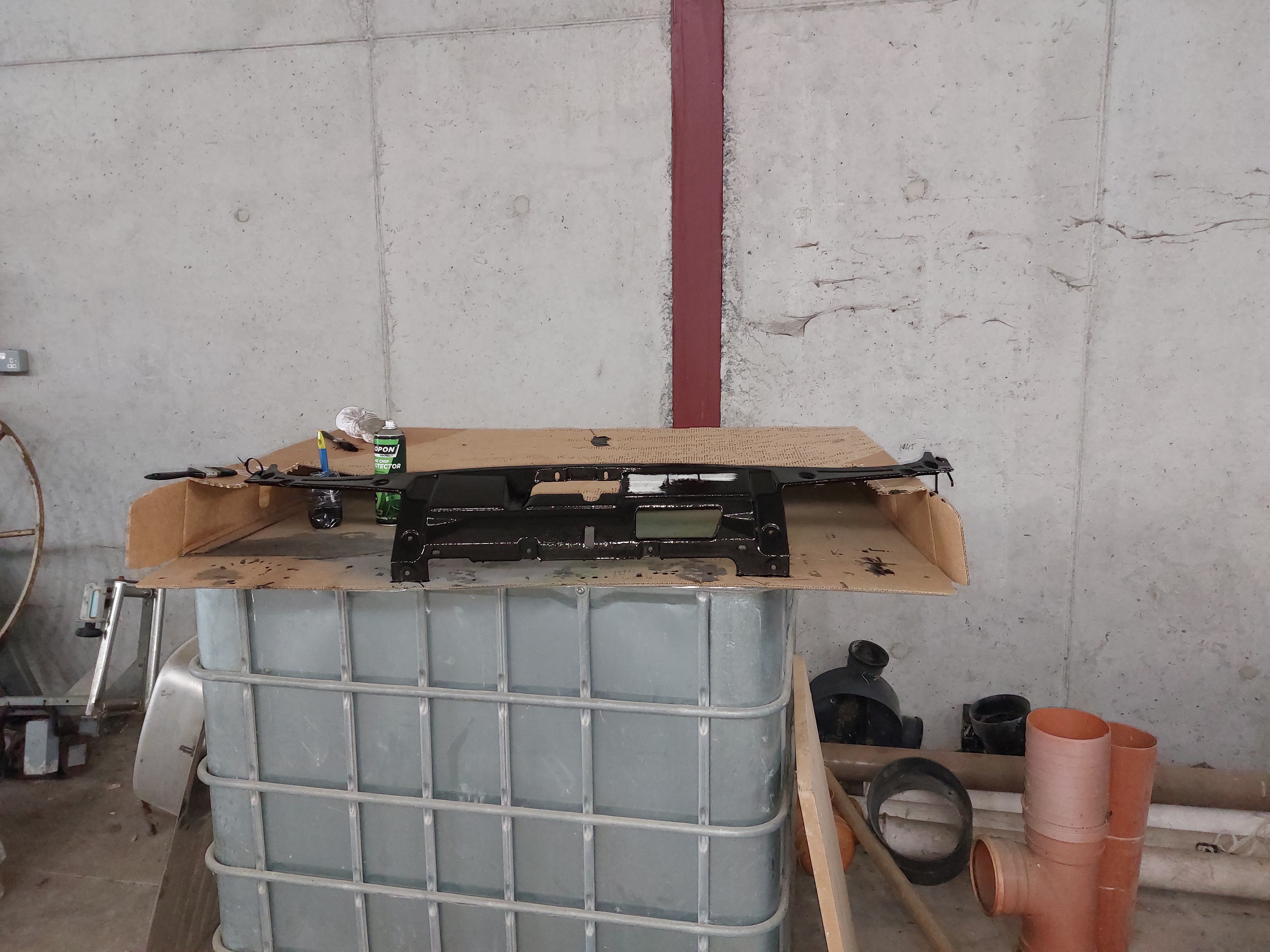

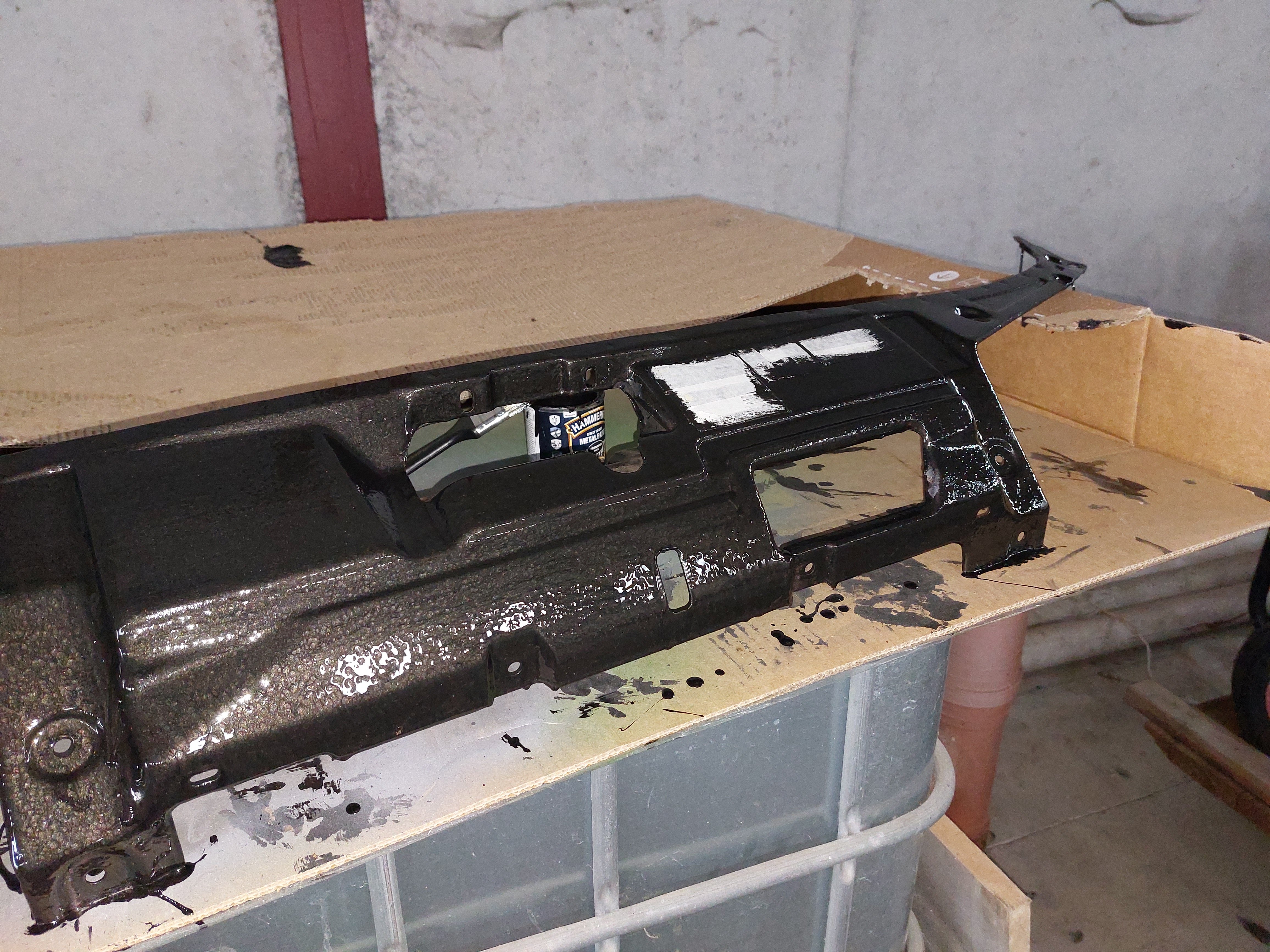

And done a bit of painting on the slam panel and some 232mm carriers.
Really nice to have a working charging system for once int this car. No problems cranking it, and the battery itself is holding a charge just fine seemingly.

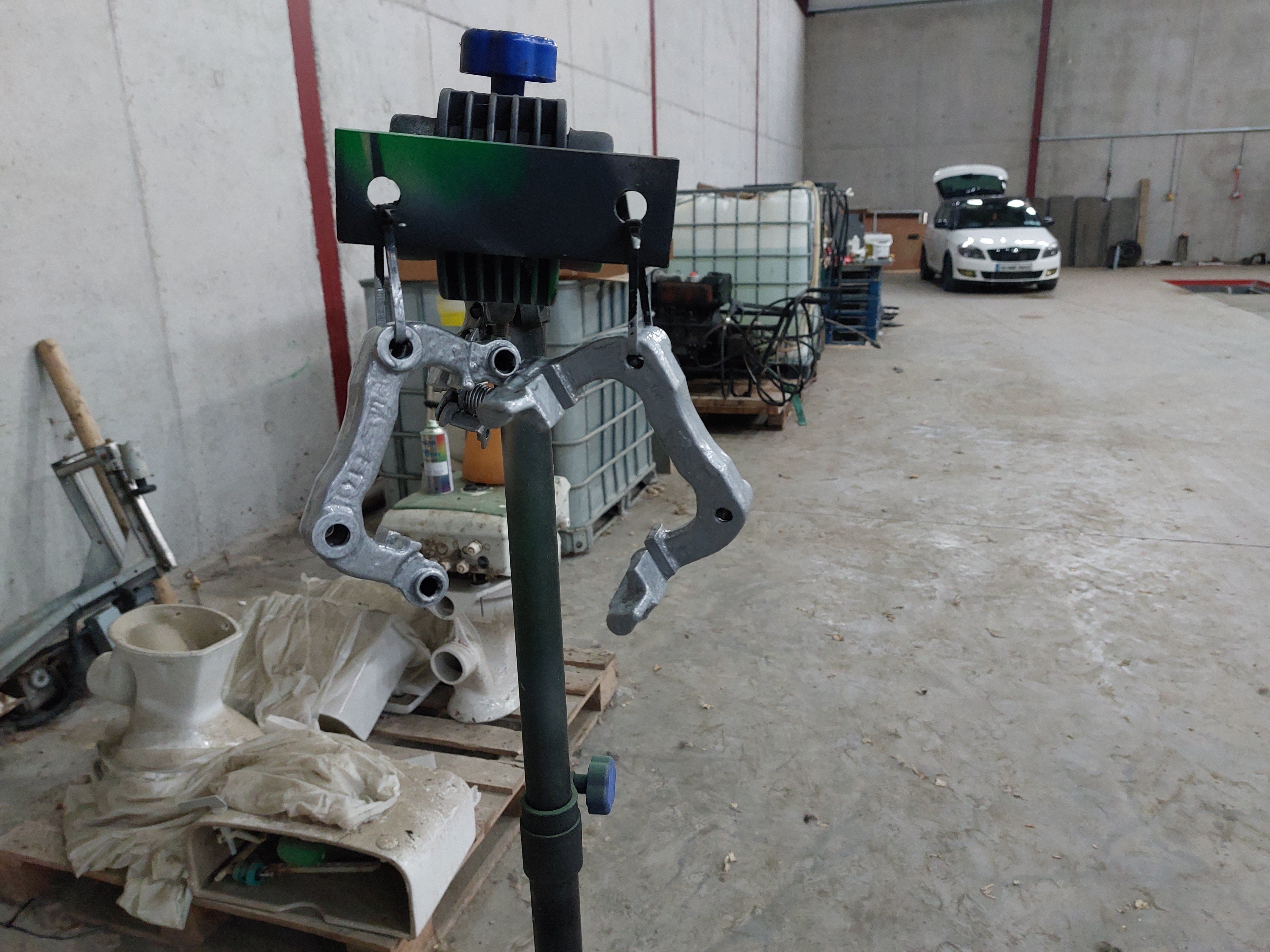

Sort of aside from this but I'll include it on the same post, some photos of the slam panel I painted compared to the one on this car
