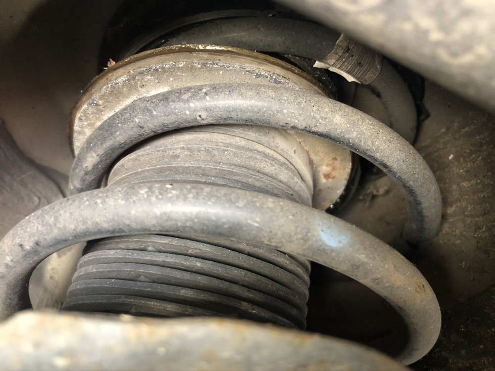

When I drove the car to buy groceries this morning, the front was making a strange noise. I thought it was brake sticking because the car has been sat a long time. But after driving a mile or so, I think I heard something snap. Then whenever going over bumps, there would be sickening noise from the front off-side suspension.
From the attached photo, does this look like a broken spring?
I can't work out what is the round thing protruding from the spring and how did it get there.

Ye definitely something broke, dont go any further than a garage, unless you know what your doing.

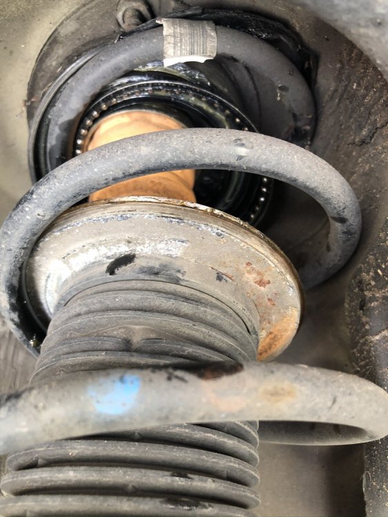

Ok. Took the wheel off.
Coil spring broke at the top. It took the "deep groove ball thrust bearing" with it.

I see a blue and possibly brown dot in the top photo.
