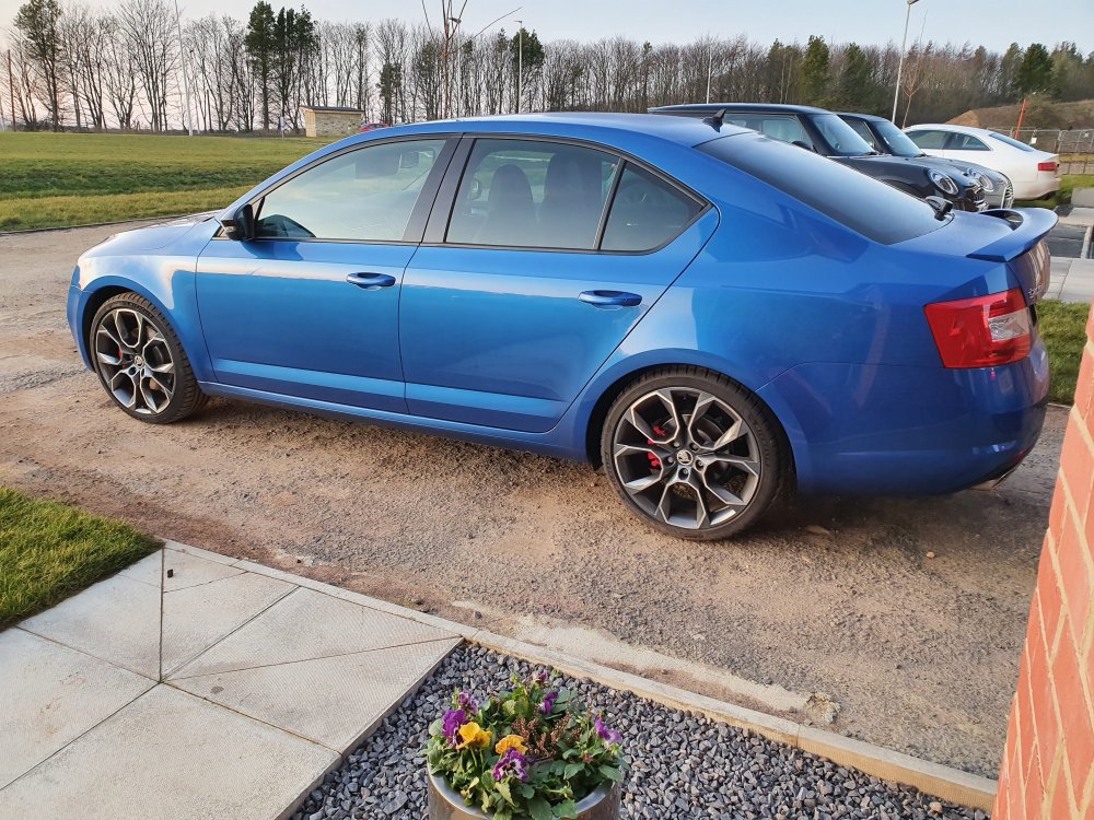

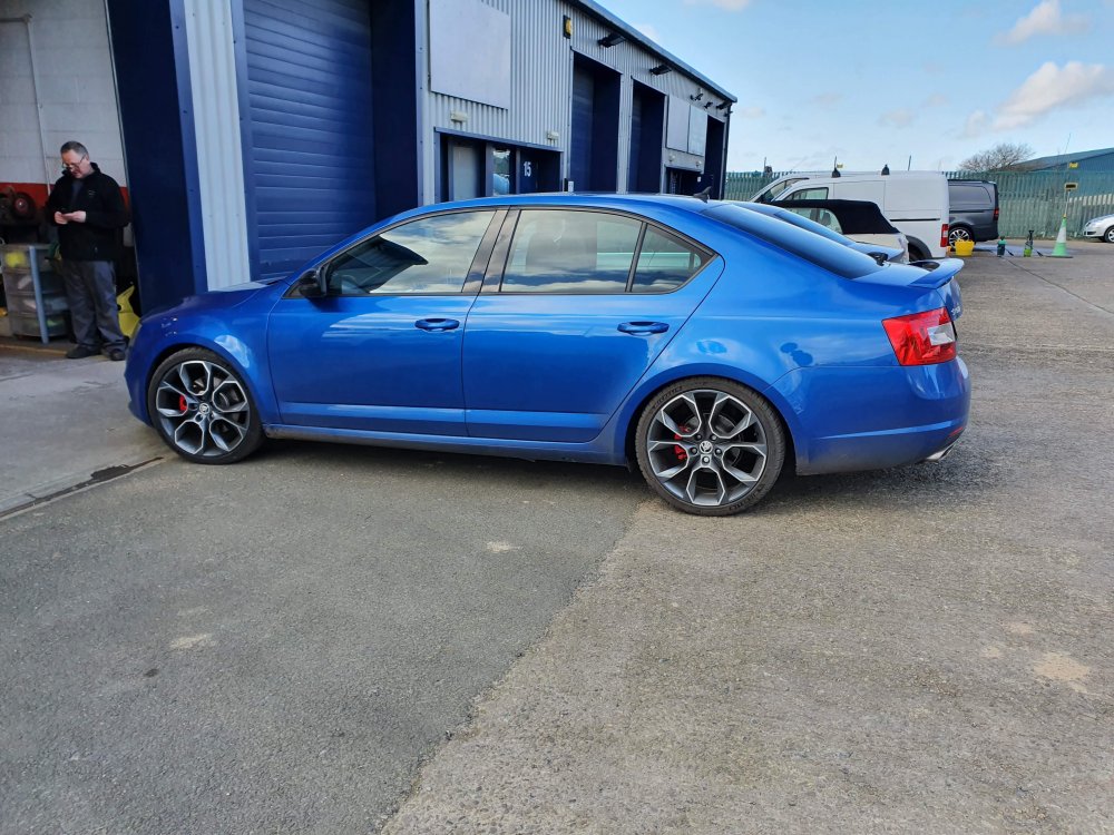

  2. Lowered with H&R 40mm springs
  3. 15/20mm H&R Spacers front to back
On Collection:
Lowered and spaced:

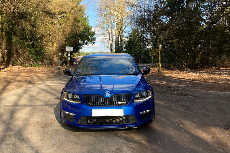

Rieger V2 front splitter fitted, nice and easy installation. I think it sets the front of the Octavia off nicely, a little bit more aggressive look but not too much in your face.
Next up Maxton side skirts.
Hows the ride on the 40mm drop mate? Iv got the stock 18s on and will probs not change to 19s as I want a comfy ride but want the lowered look. Them H+R springs good? Its either them or the Eibach pro springs 20f/10r which ill pick from. Cheers
Rides well mate considering the 19's so should be a little better if you keep the 18's on 👍. I don't find it too firm, still retained that comfort, i do 80mile a day on it commuting prior to the lockdown and not felt fatigued by it yet. In comparison my ST on the same commute lowered had me absolutely knackered. I don't think you'll go wrong with either brands of springs mate, guess it ends up depending on how much drop you want, the drop with the H&R's does help the wheel fill the arch a bit more though.
Edited by Towelie
Typo
How much did the car actually drop with the H+R mate? Iv read its about 25 front and rear? If you don't know then would it be possible you could maybe measure the top of the wheel arch front and rear to the ground for me if u could? Just so I can work out the drop on my car and see if that's the way to go. I really don't want a slammed look but im on the 18s and u have the 19s. Ur car looks spot on just not sure how itl look with the 18. Also might add ill be towing a trailer with 2 motobikes on the back. That might lower the rear even more! Maybe the Eibach pros might be the safer bet?
It is roughly 25mm drop on a VRS due to them already being 15mm lower at stock. No bother, my drives not the smoothest (thank Persimmon homes for that haha!) Fronts are approx 645mm, rears are at 650mm (measured highest point of arch to the ground), cheers, I think it'll look good on 18's.
Yeah understandable, I've had mine brimmed and its been fine on the back end. No scrub. No catching speed bumps either. Most of that weight with the bikes will be on the trailer won't it?

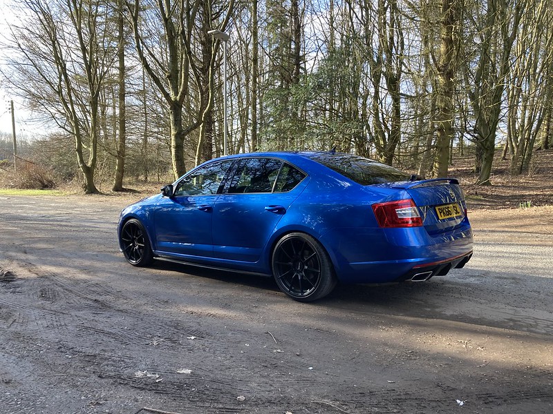

Over the course of the summer last year I fitted Maxton Side Skirts. Think the overall aesthetics really set off by the front splitter, side skirts and rear diffuser combination.
Bit of LED interior lighting was completed as well which smartens the cabin up nicely
So first update for 2021, fitted a Whiteline Rear Anti Roll Bar today, turn in is feeling neater / tighter and that rear end isn't wallowing about. Shame the weather isn't really up to testing the improvement in handling but once its dried out I'll do another review. But so far so good, very impressed with how the car feels with the stiffer rear bar.
Next, is likely to be poly bushes and uprated dogbone mount, also thinking about wheels... but we'll see. With working from home for a year now the cars barely getting used, wishing I could swap the engine for a 245.

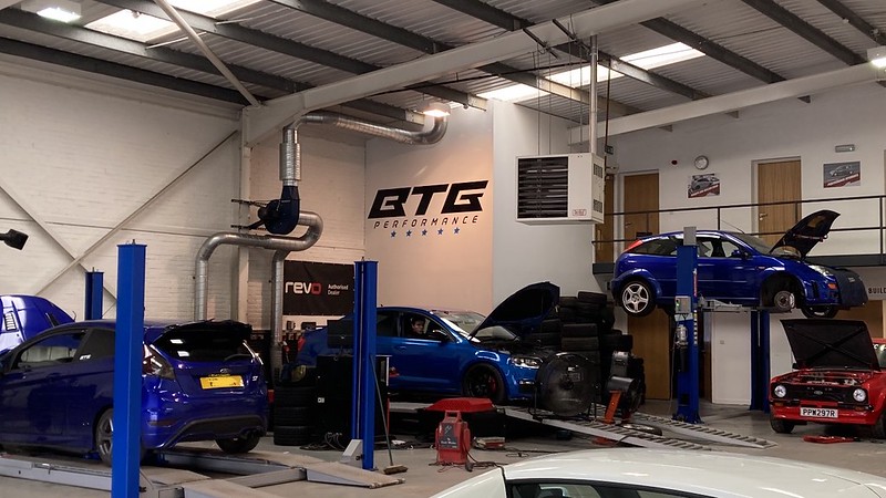

Update today...

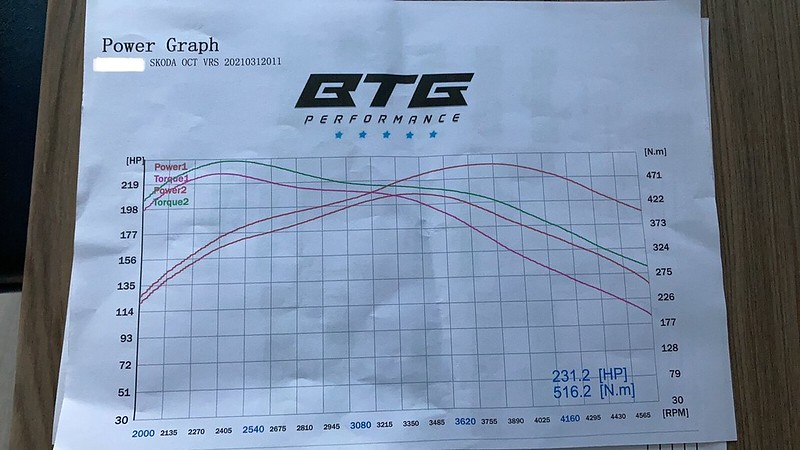

I took the car to BTG Performance in Newcastle to get its alignment done and more interestingly to complete a rolling road session to check how it was truly performing with a DTUK tuning box fitted. I had always fitted the box as a sort of stop gap when I first picked up the car and I have never been satisfied with how it has performed. There's always felt like a flat spot or a dip mid-RPM and its constantly done my head in.
The car ran four runs on the dyno with tuning box and the results came back as expected - it was nowhere near the acclaimed figures, putting down 209bhp and 490NM; the torque figure to be fair is close to quoted peak DTUK quote. So tuning box is out! and... Revo stage 1 installed. I'm surprised with how well the car actually took to the tune 231bhp / 516Nm on the dyno. Here's an overlay comparing the power curve of both the tuning box and Revo.
(Just to point out I never expected the tuning box to peak at the figure quoted online, however its putting out less that their multimap power box (225ps) let alone their ultimate (240ps)...:wondering:)
I haven't driven the car much so my review of the new tune will be brief. It is night and day :biggrin:! Pick up is much quicker and from third gear the car pulls and pulls strong and consistent, the main thing is that where the tuning box would feel like it's run out of steam the car now just keeps going much further into towards the top end.
Just a final one to say how good BTG were, their service was spot on!

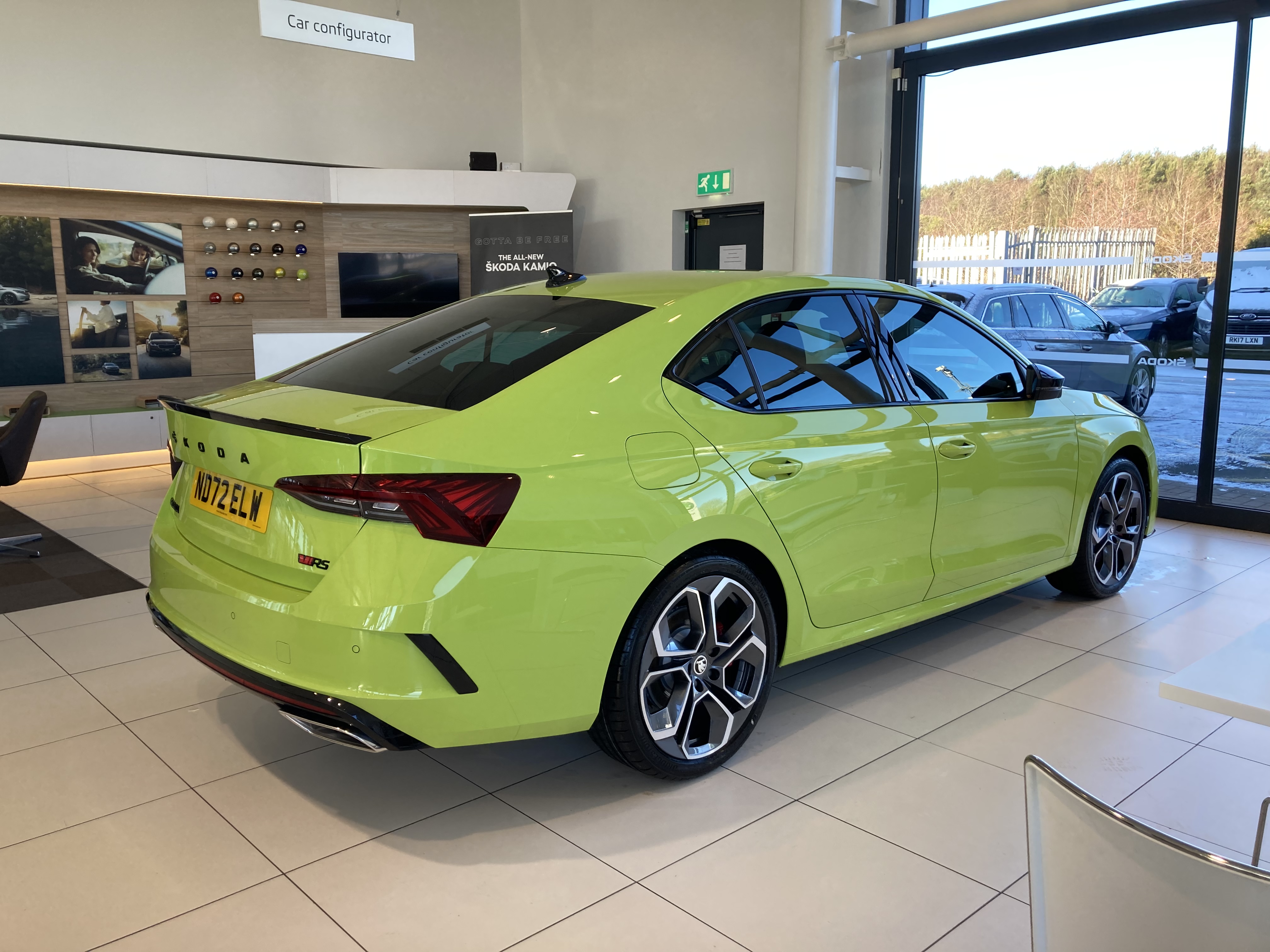

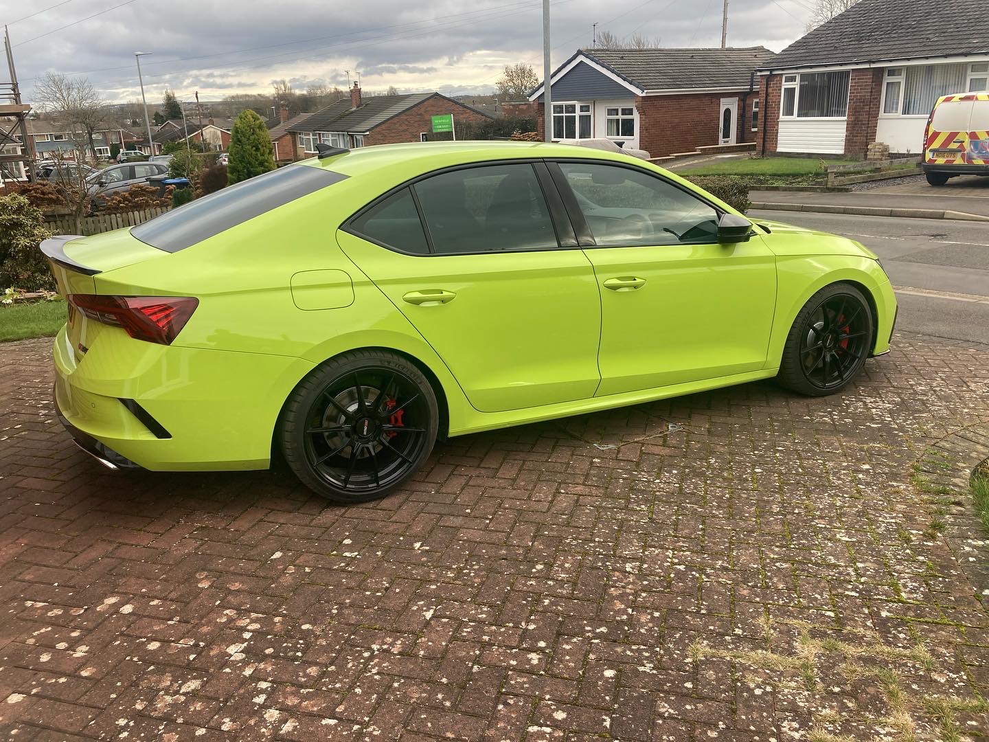

Well I didn’t stay away too long! Traded my GTi pp mk7.5 in at the weekend as need a bigger car again. New motor shall be unveiled soon… mk4 VRS 2.0 TSi hatch.
Tis not Blue… but Hyper Green, a silly colour 😂
Still got my motec wheels so they’ll be going straight on along with my R600 intake from the golf.
ST XA coilovers are on the way along with some Maxton part as well.
Photos shall be added soon.

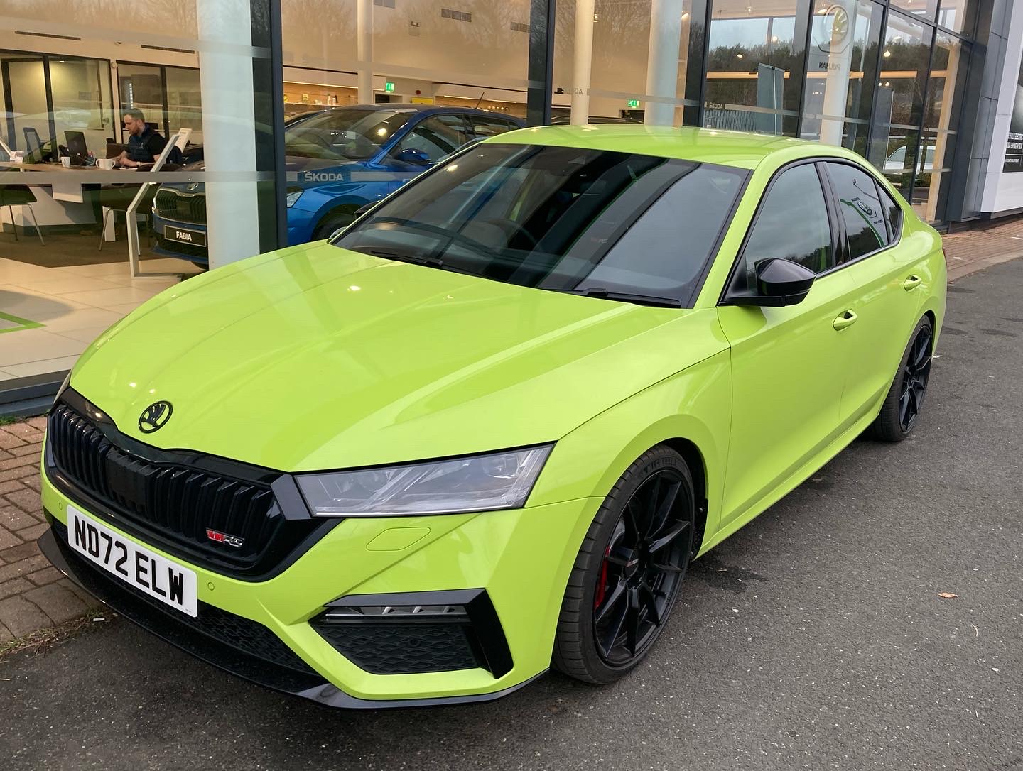

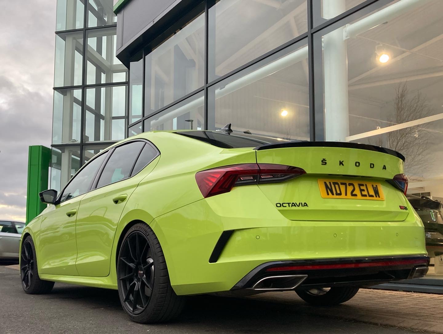

Changes made:
ST XA Coilovers fitted, lowered to remove that arch gap but not slammed to a stupid height.
Ride comfort has remained superb which I’m really pleased about.
Only other changes are my Motec wheels which I think has really improved the look over a standard car and a front badge change courtesy of SuperSkoda.

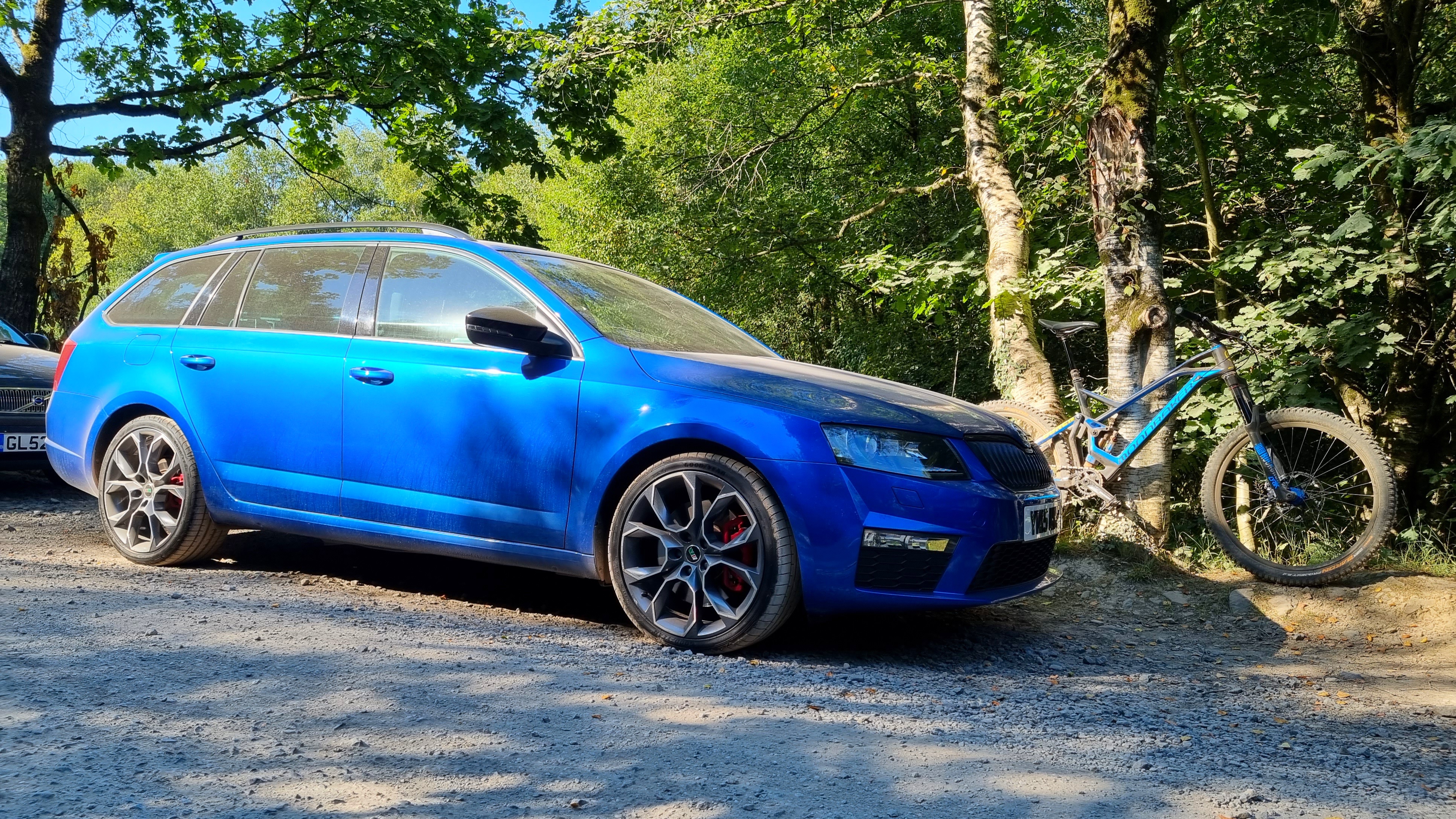

With the bike I opted for an estate. It is a big car but handles well and takes several bikes and kit easily. I have Racingline 20mm springs to fit as it does look very jacked up.
