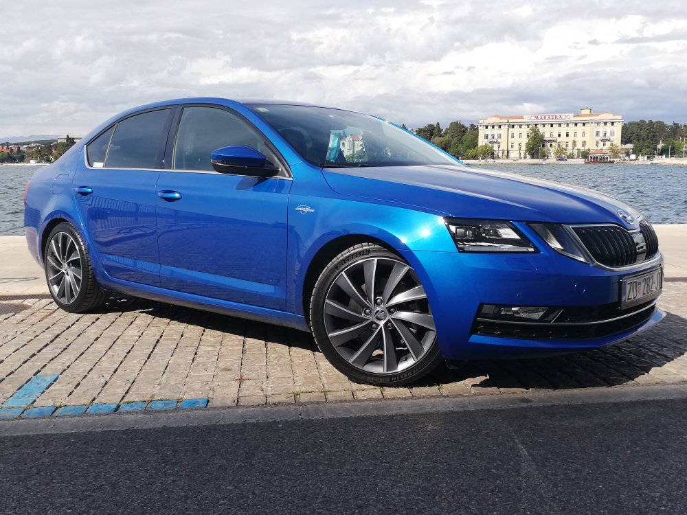

  • All skodas stance is too high. I also lowered my normal suspension with coilovers but not too much because I don't like it too low, for me this is how normal octavia should look from factory:

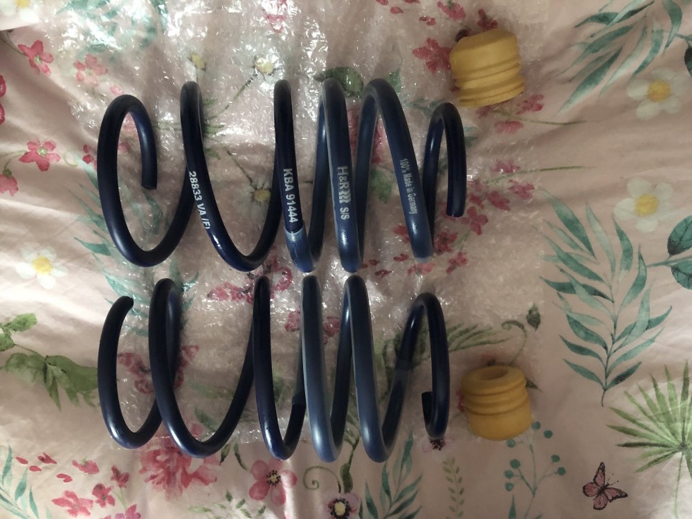

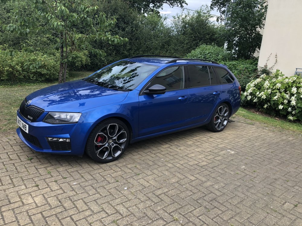

Anyone who has ODIS and knows how to use it can do it. I’m sure a lot of people don’t have this done but it should be done to benefit the system. Consider your choice of lowering springs carefully if you want to make use of DCC, I don’t have it and I run H&R’s and I will gladly accept that the ride is a bit harder because the car does handle better and looks nicer but I doubt Comfort mode with the DCC would be worth using on my springs so do consider everything. Eibach Pro’s aren’t as low and are a bit more forgiving I am led to believe.
My car on H&R’s

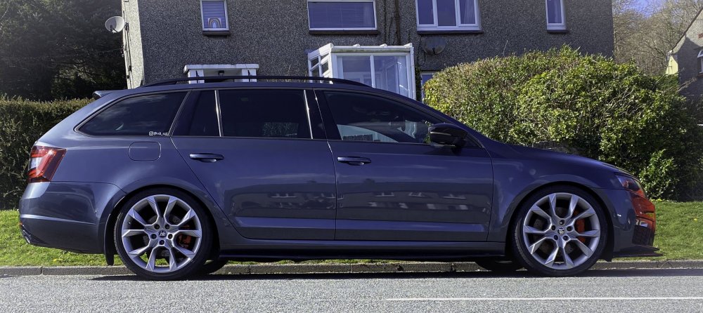

Sasha your car looks the business and exactly what I’m after really. I just need to figure out does the car actually have DCC. I have the vrs mode button but I don’t know if that’s suspension related or just solely engine and steering related as it mentions fuel economy in one of the modes as well as sport mode. I’m just a bit confused on that.

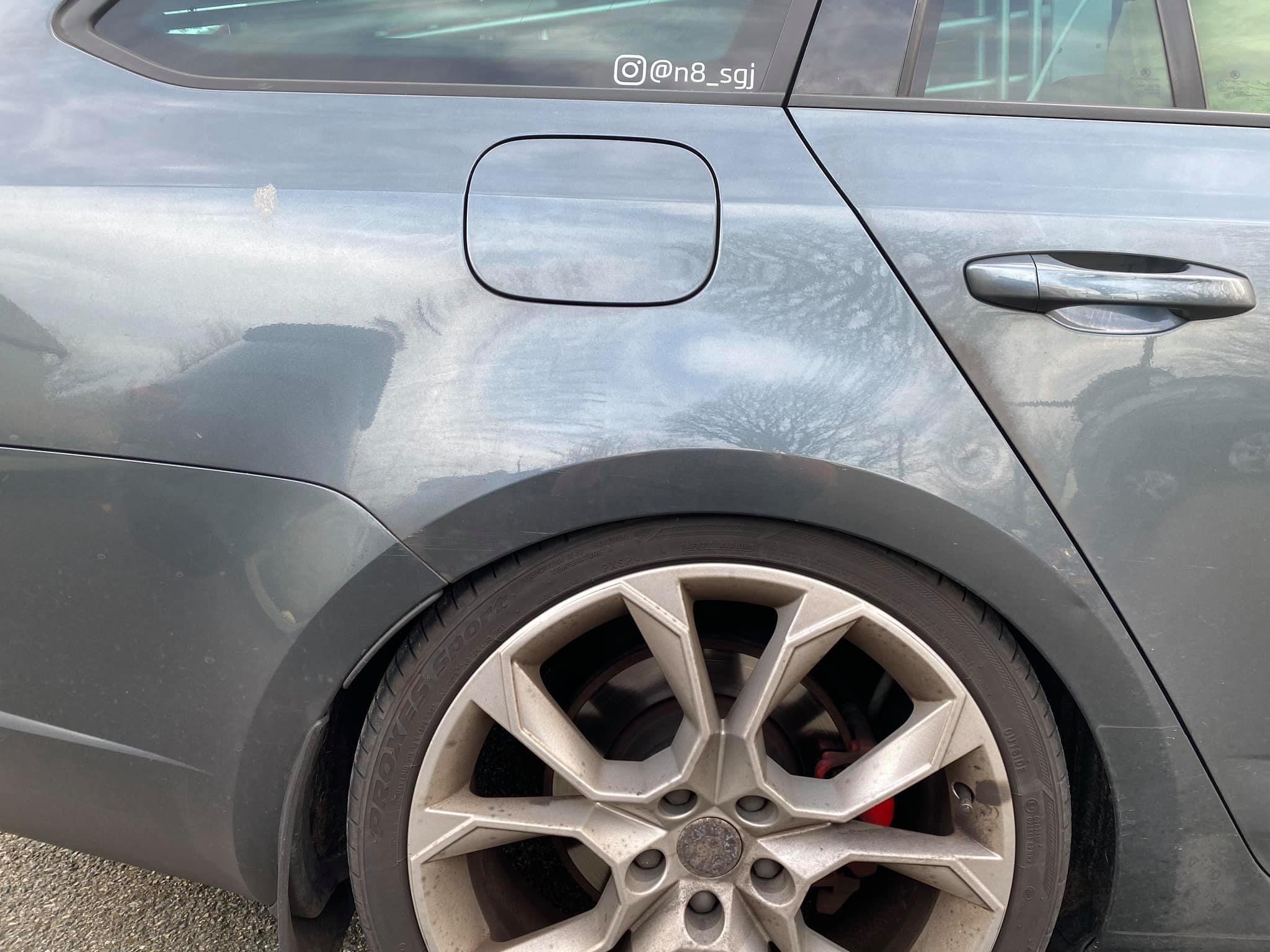

No problem with 2 adults in the back, a boot full of gear and a 5.5 meter rib behind it. I’m spaced 25mm on the back.
That's a good example image of a lowered car in a normal situation.

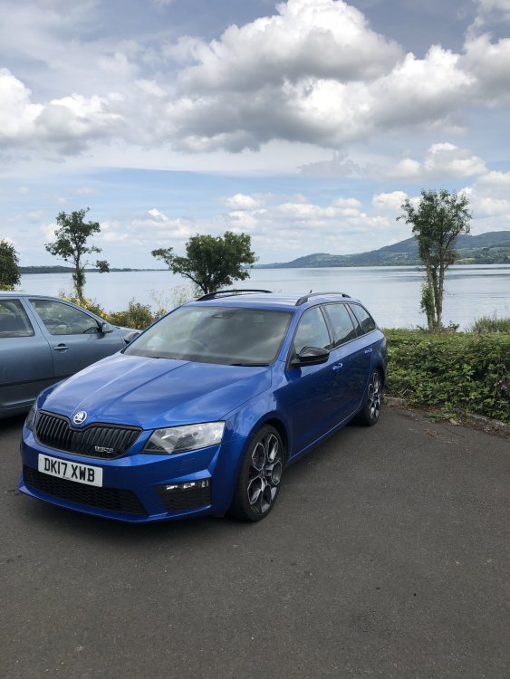

Nice one. Looks well 👌 I presume those wheels are 19’s too? Looks perfect. I’ll be going with the same set up as you then once everything is back open again. Thanks SashaGrace 😊

2x adults about 90kg each, boot full of boating gear plus 40kg dog, 55 odd kg of nose weight on the towbar and the boat on a braked trailer, so pretty heavy all in. Copes fine.

Yes, the Xtreme’s, and I’m on the H&R 40mm’s and it sits great when it’s not fully loaded.
