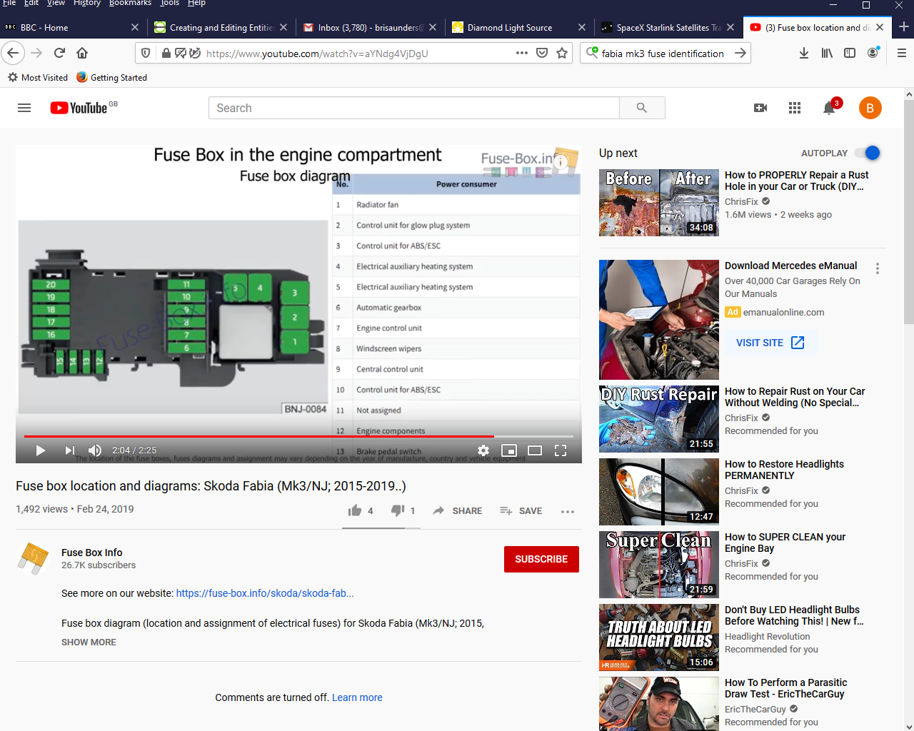

Hi,
I found a fuse layout for the car on the internet and discovered the fuse for the radiator fan was blown!  So hopefully panic over.  I will get one next week and ,fingers crossed, all will be well.
Let us know please and the fuse number/location.
Hi,
I am pleased to report that the fuse had blown and now that I have replaced it all is well.  It is a 40amp "slow blow" fuse.  the fuse is in the fuse box under the bonnet, top right hand corner.  The fuse is number 1 fuse which is positioned bottom right hand corner of the fuse box. See below. The fan now works OK.
