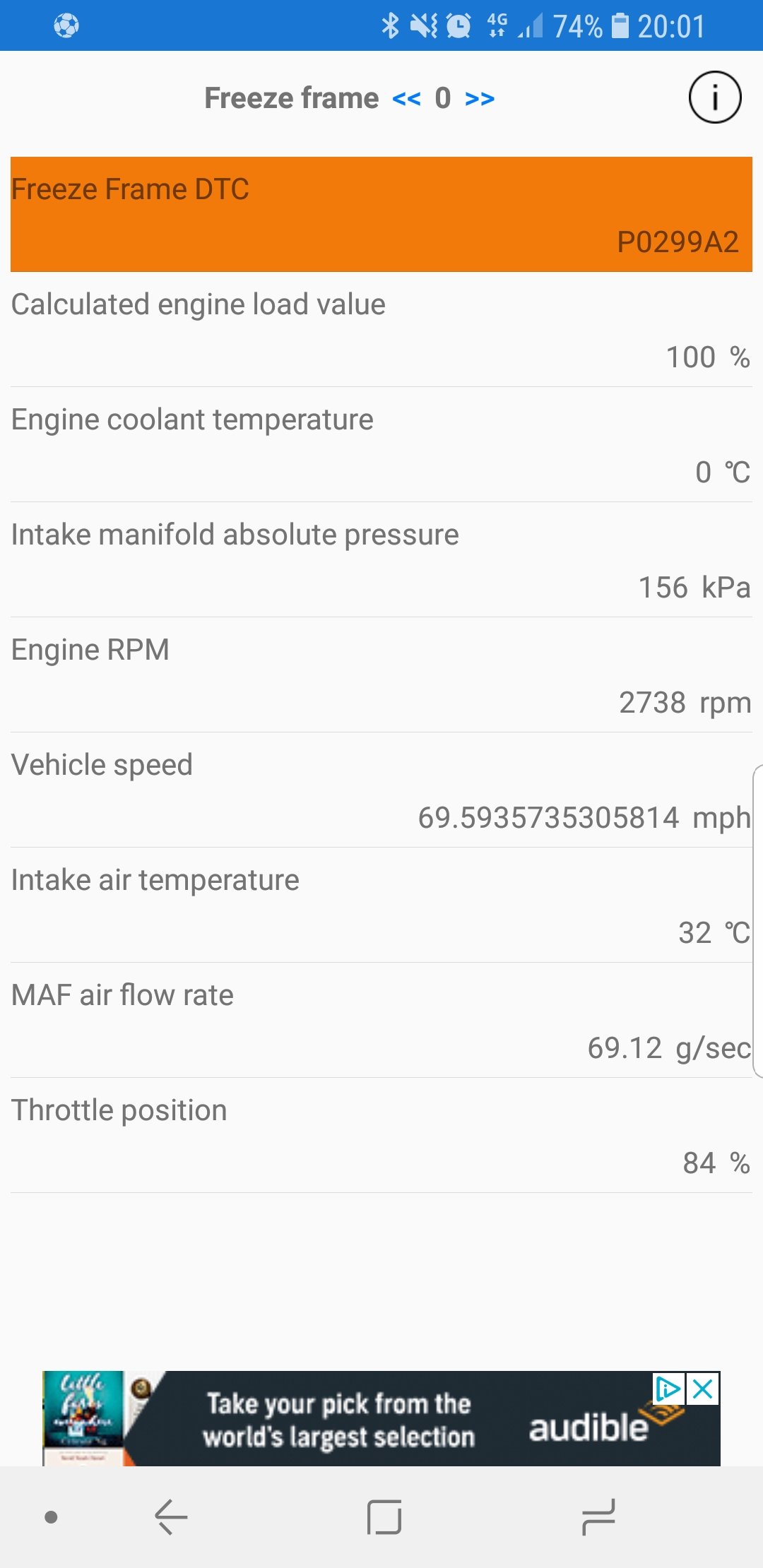

I have attached the screenshot of the freeze frame in case that can shed the light.

Just an observation, coolant temperature 0 degrees? Did this happen right at the start of the journey?
No, it was right mid journey... so no chance of being 0... especially with all that hot weather recently... I wonder how much is that a bad reading or a faulty temperature sensor... but then I would have an issue with overheating... I've seen a post somewhere that a guy had the same problem until he changed a thermostat...don't understand the link but it worked for him...
