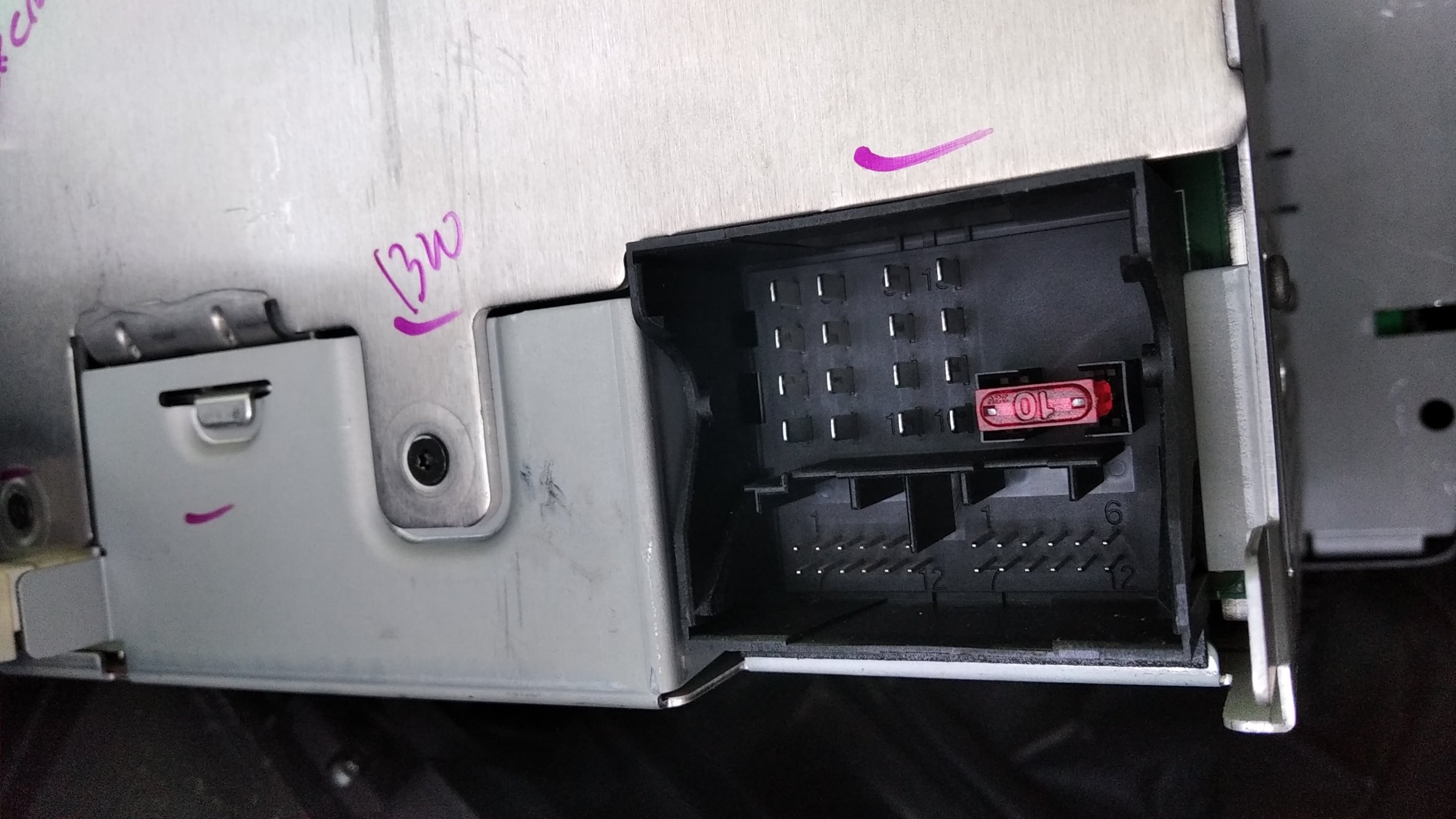

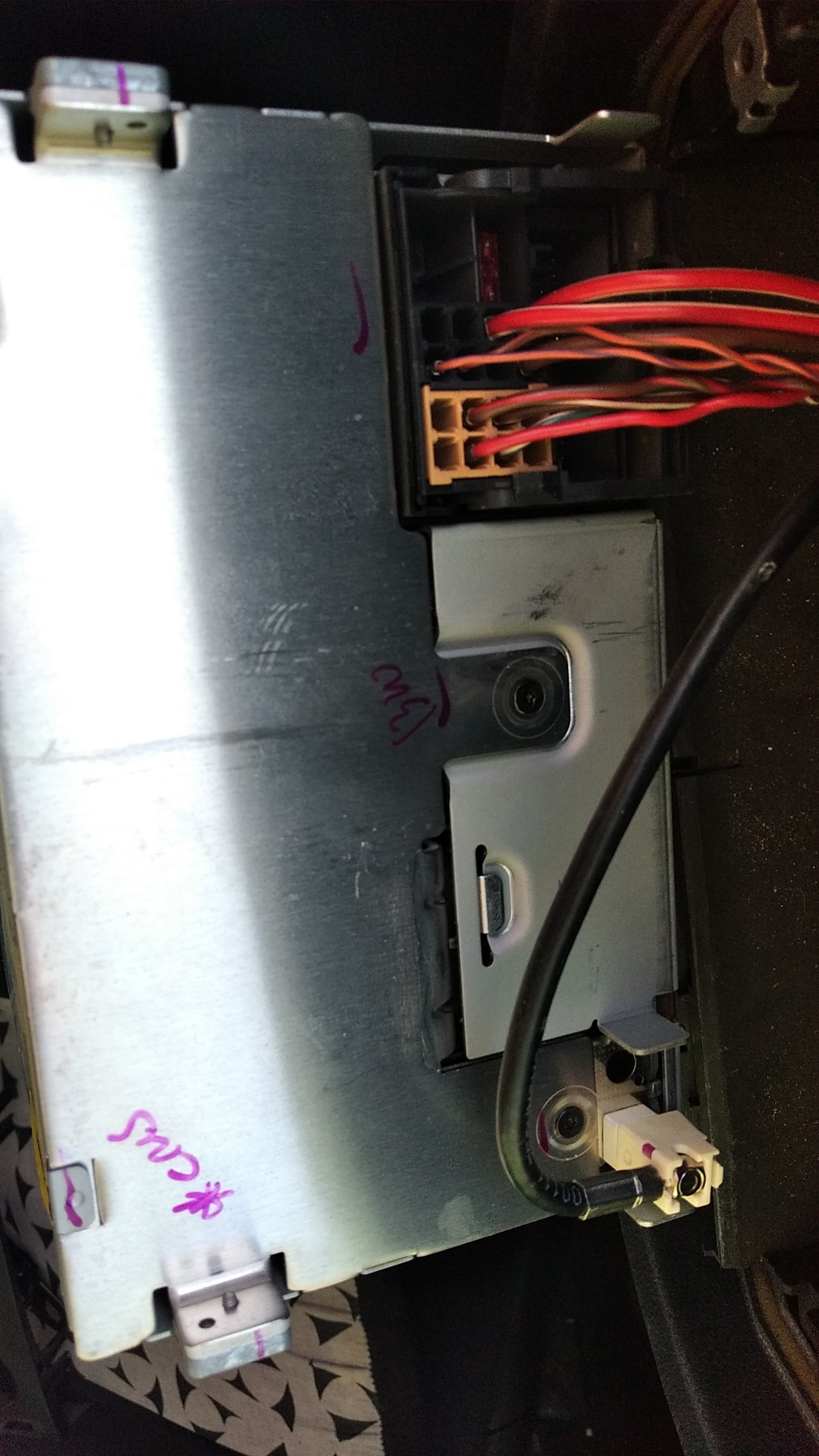

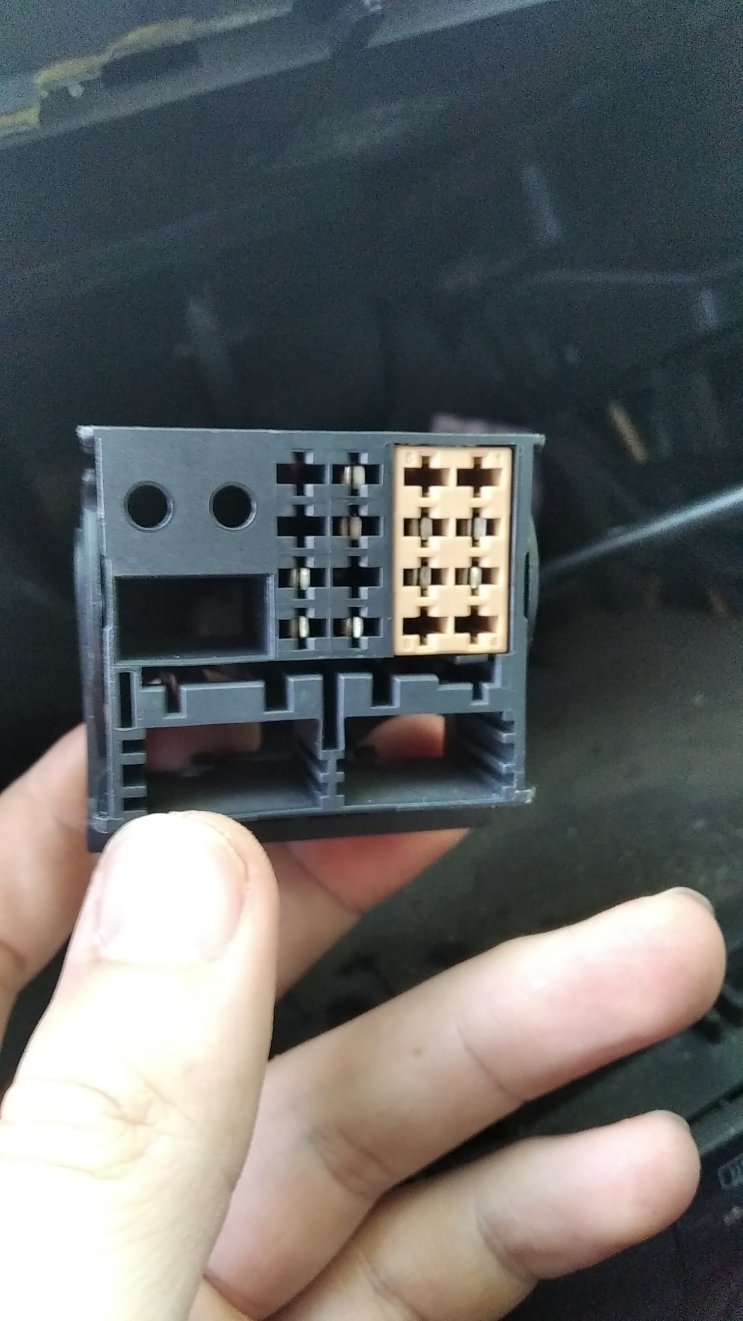

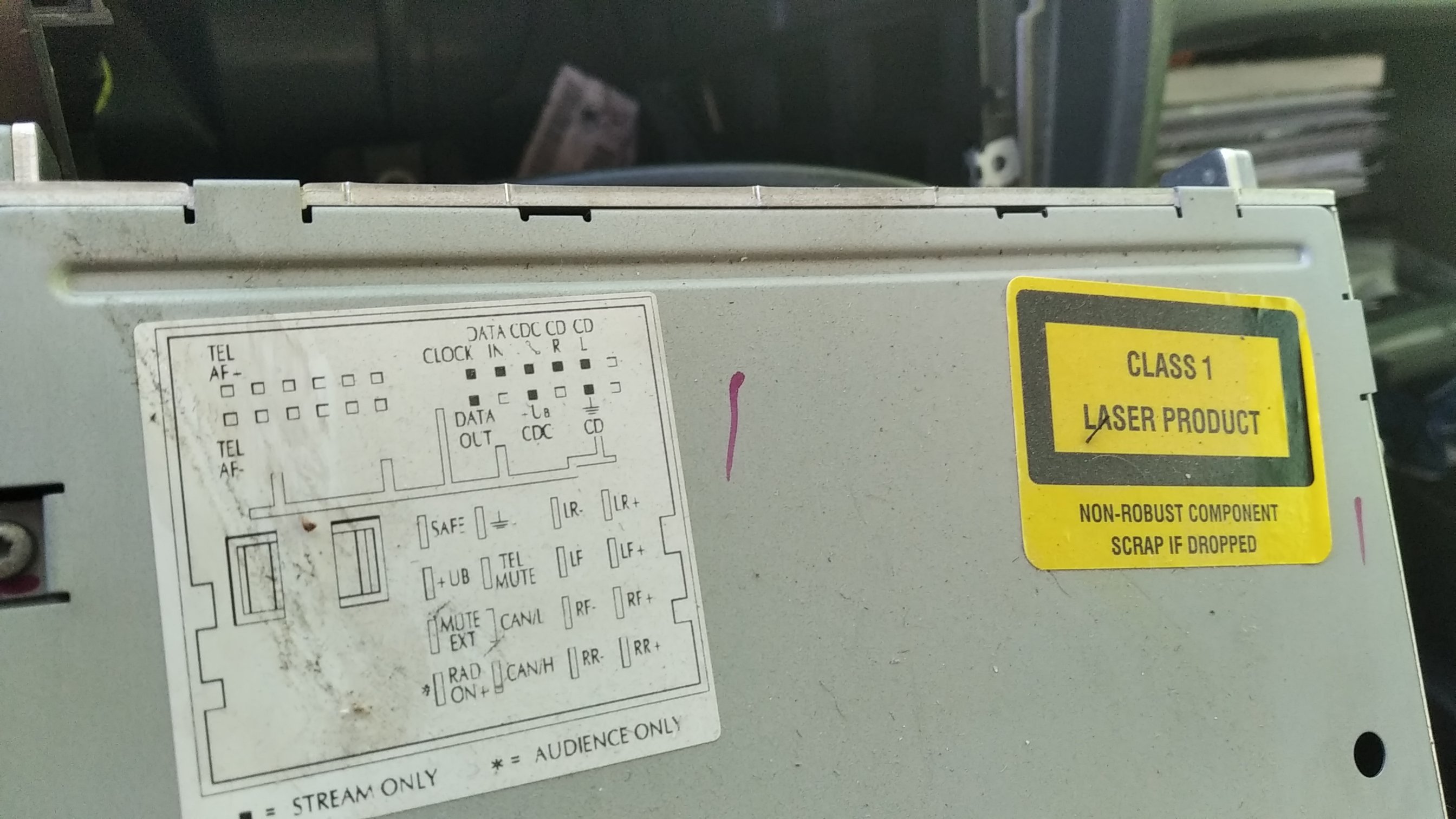

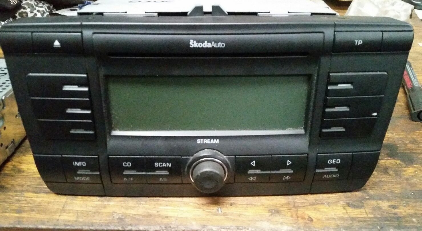

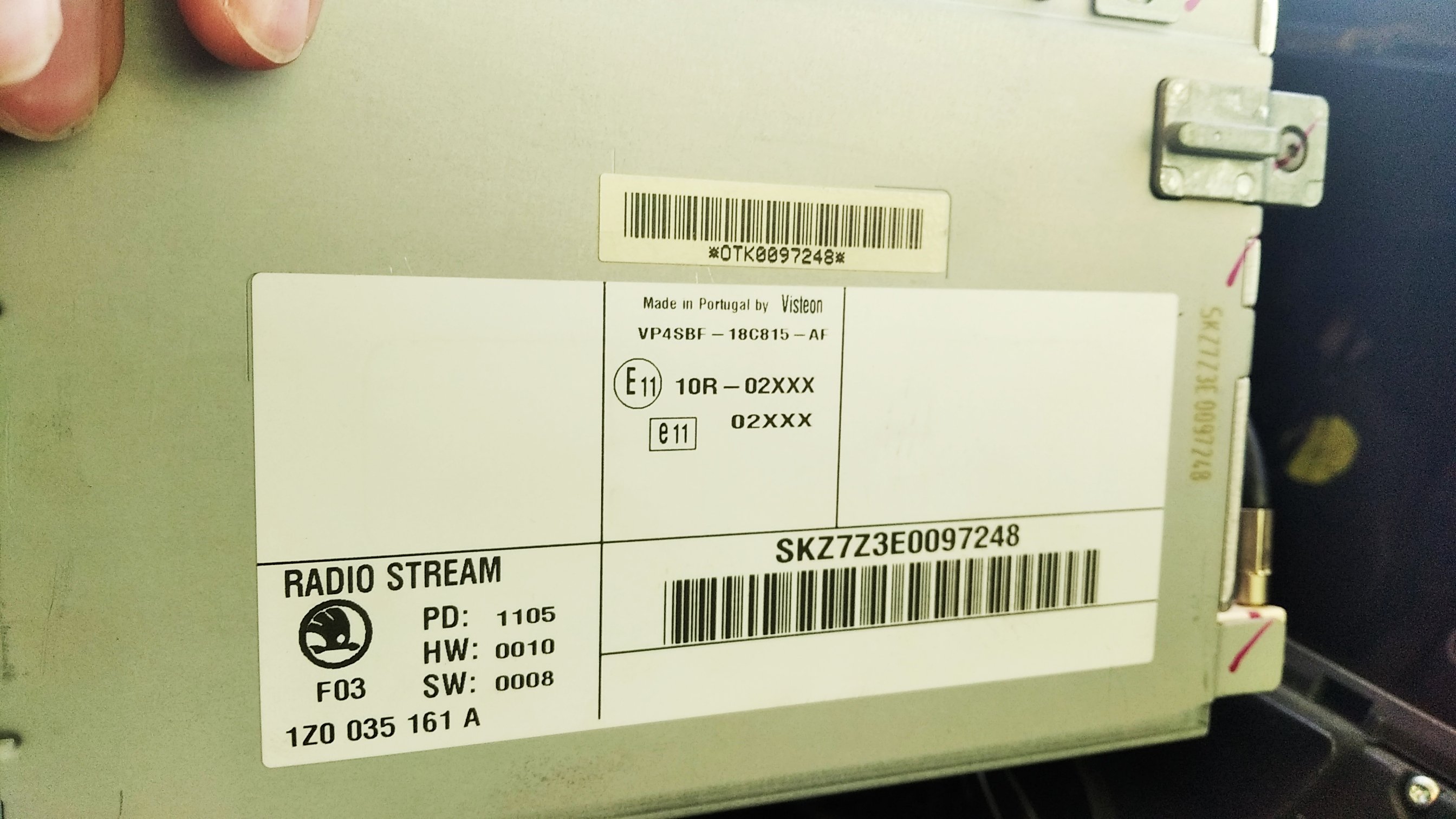

Here's some photos of my radio

That looks the same as my head unit,
Get a bluetooth transmitter

Ideally you need the Stream MP3 version of this head unit as it has the Aux In option. You can then add a lead to the connection block at the back to terminate in a 3.5mm Jack. I think you need to move one of the pin connections in the block as well.  I have done this exact upgrade but can’t remember the details as it was about 10 years ago. Stream MP3 players are cheap
https://www.ebay.co.uk/itm/SKODA-OCTAVIA-MP3-CD-RADIO-PLAYER-2005-2006-2007-2008-2009-CAR-STEREO-CODE/223717032142?_trkparms=aid%3D1110006%26algo%3DHOMESPLICE.SIM%26ao%3D1%26asc%3D20140205112123%26meid%3D1ba348921fa14e38b89daacf53a6df0d%26pid%3D100171%26rk%3D2%26rkt%3D6%26sd%3D123227915653%26itm%3D223717032142%26pmt%3D1%26noa%3D0%26pg%3D2332490%26algv%3DSimplAMLv5PairwiseWeb&_trksid=p2332490.c100171.m2965
You’ll need the wire loom that costs about £5 too. Can’t find a link at the moment for this.
