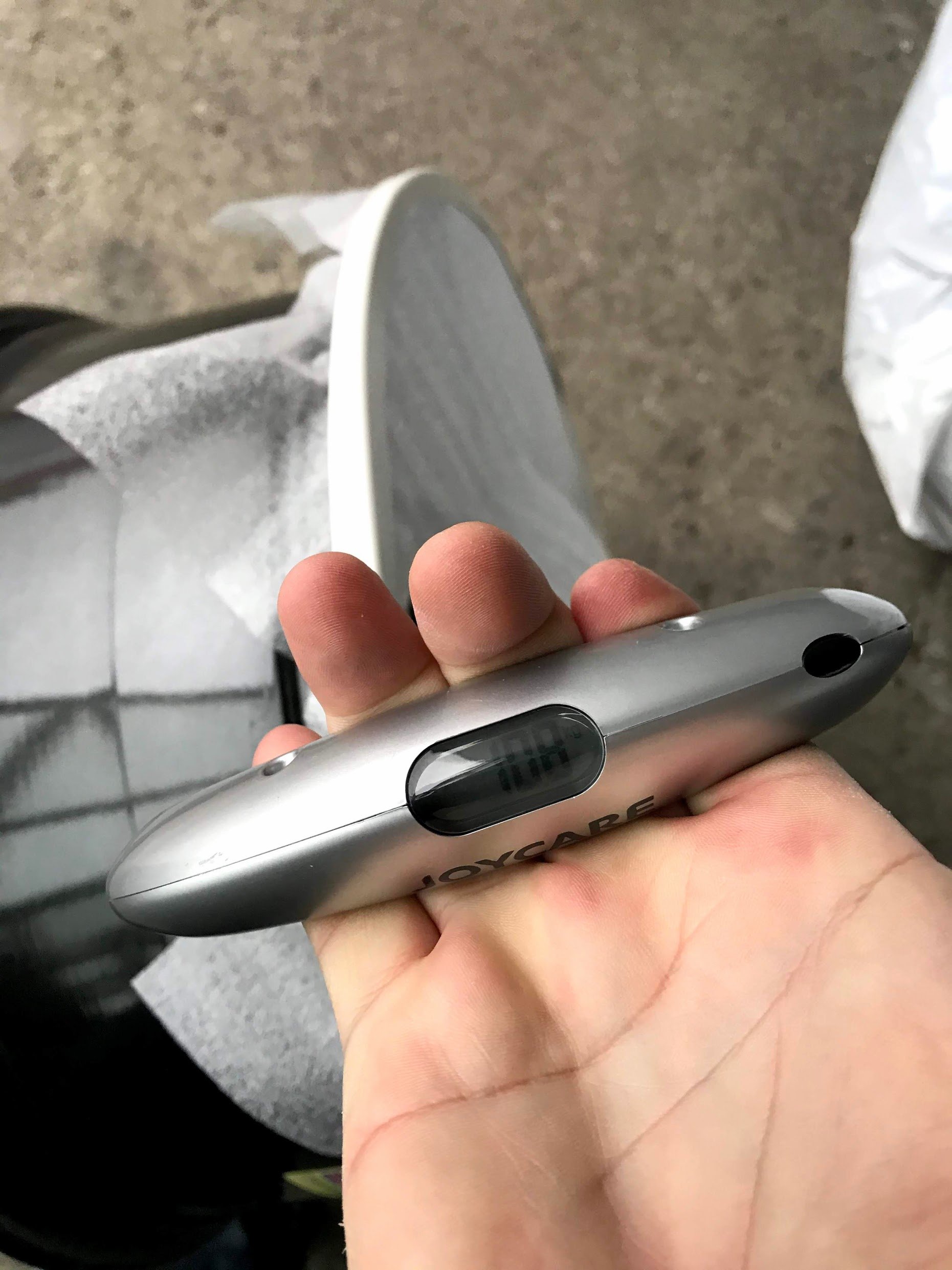

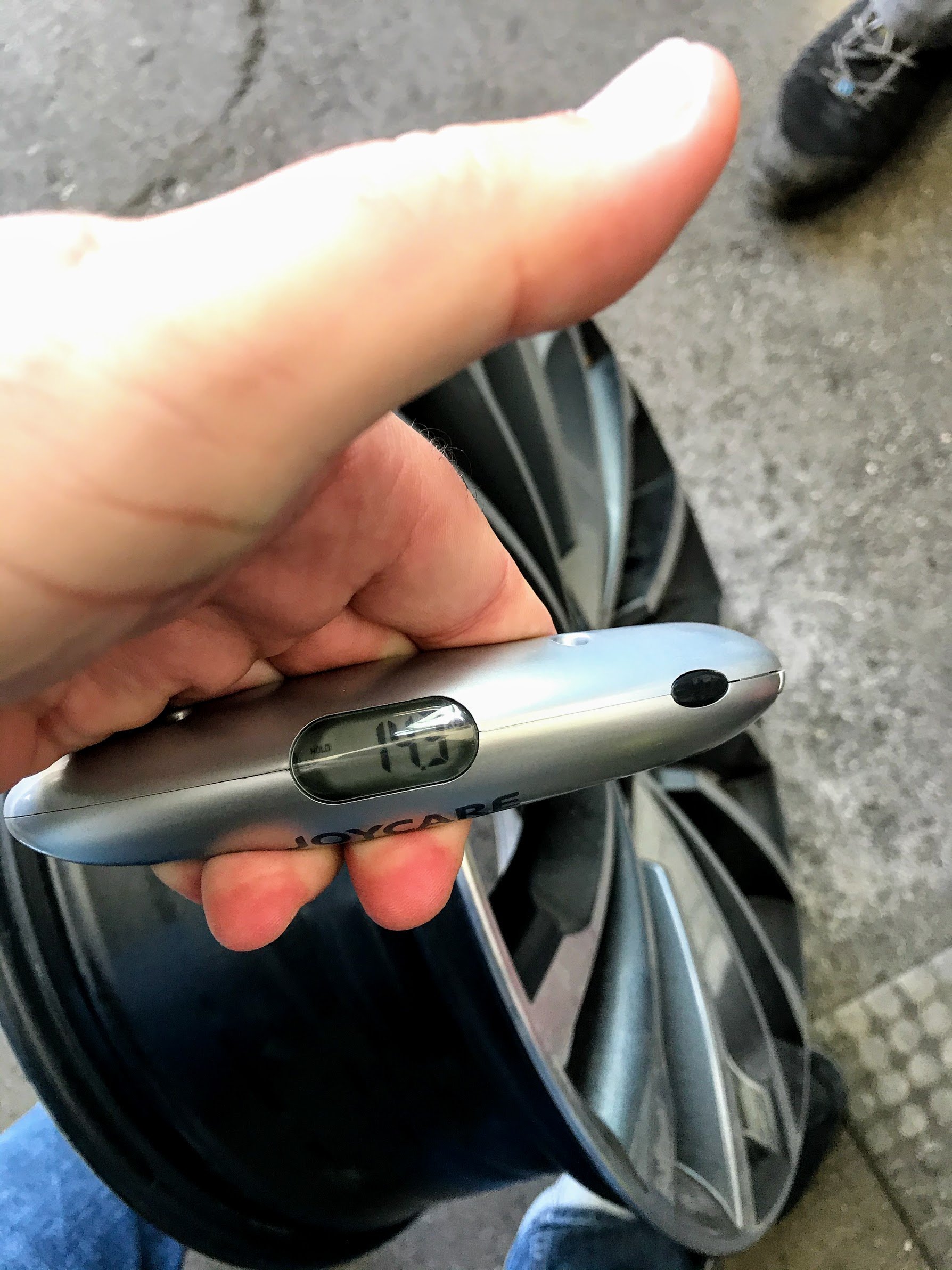

1 hour ago, newbie69 said:
Me and you are also on lighter wheels which save almost 20kg off.
14 kg in my case but i didn't consider it because i think (but i'm not sure) that I added something with the 390mm bbk.
My 19x8'' trinity are 14.3 kg, the Racingline R360 19x8.5 are 10.8 kg.

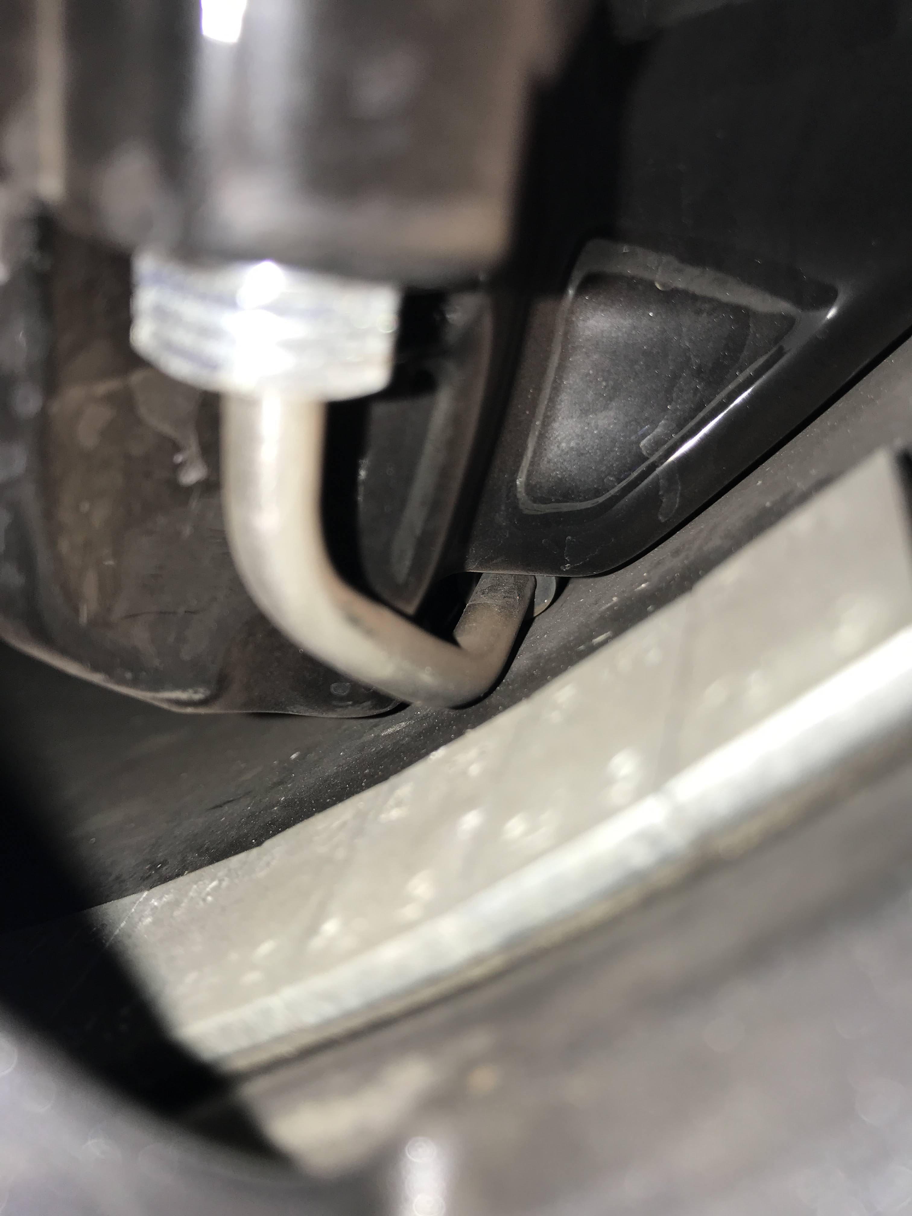

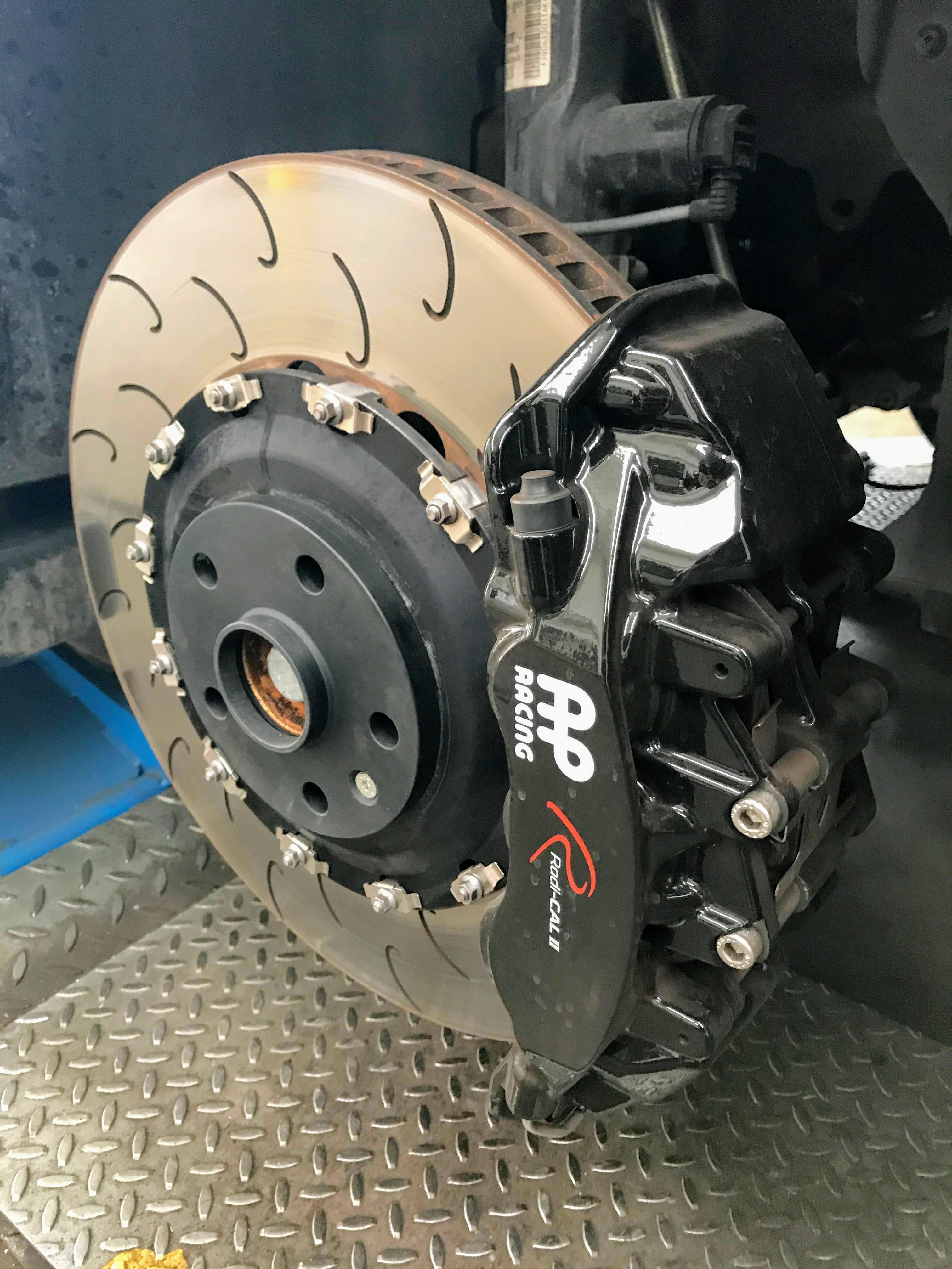

Time for winter tyres, and back on the heavy OEM trinity wheels.
Had to put 13mm spacers on the front due to bbk, and wheels still fit barely.
I risked not being able to mount these original rims...but at the end it was ok with a margin of almost 1 mm! :D
Also fitted 16mm spacers on the back.
IMG_1798.thumb.jpeg.77a6df146748d0ab3d033755e5c01e74.jpegIMG_1800.thumb.jpeg.b4840ad5208f98b728e05d2d1980c5ac.jpeg
13mm spacers:
This last photo shows how close the caliper is to the inside of the rim...
Love your brakes but that's worryingly close! I'd be scared what happens if little stones get trapped in between the caliper and the barrel... hoping you'll be fine!
PS, You NEED to add the Sportline's boot spoiler!! :tongueout: (200 EUR at Superskoda)  It will look amazing!
Edited by newbie69
Yes those are very close each others, but it should be fine.

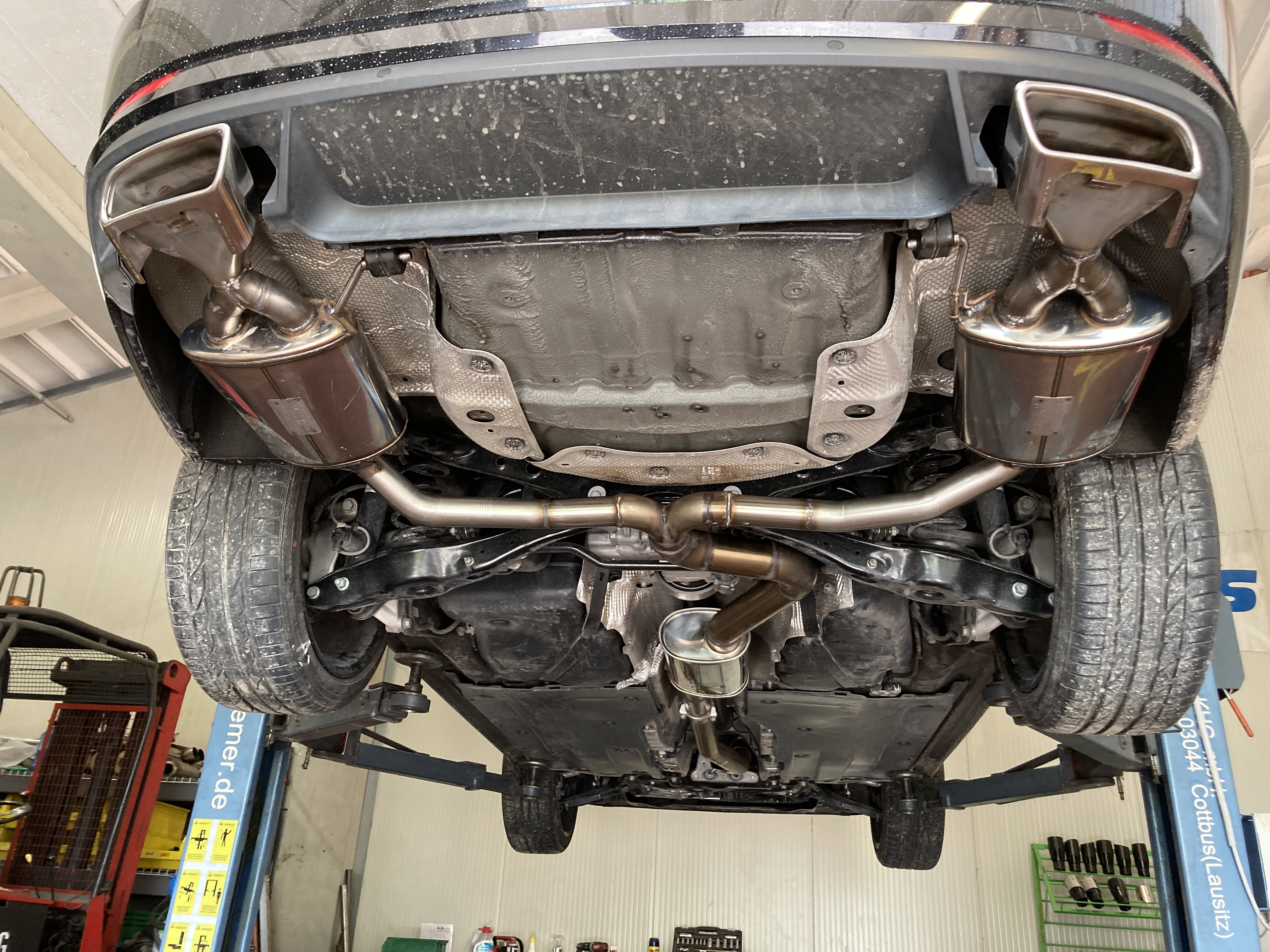

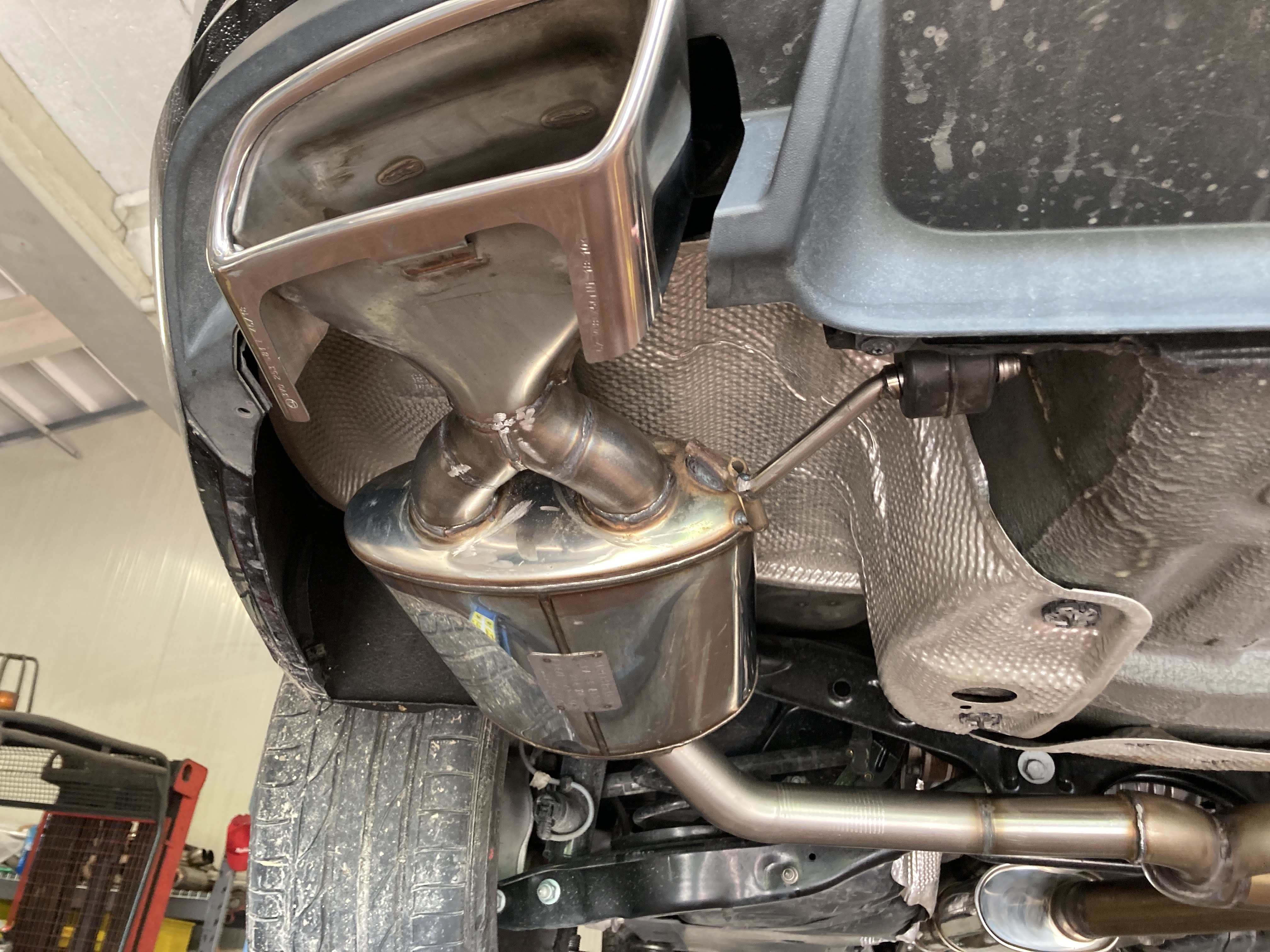

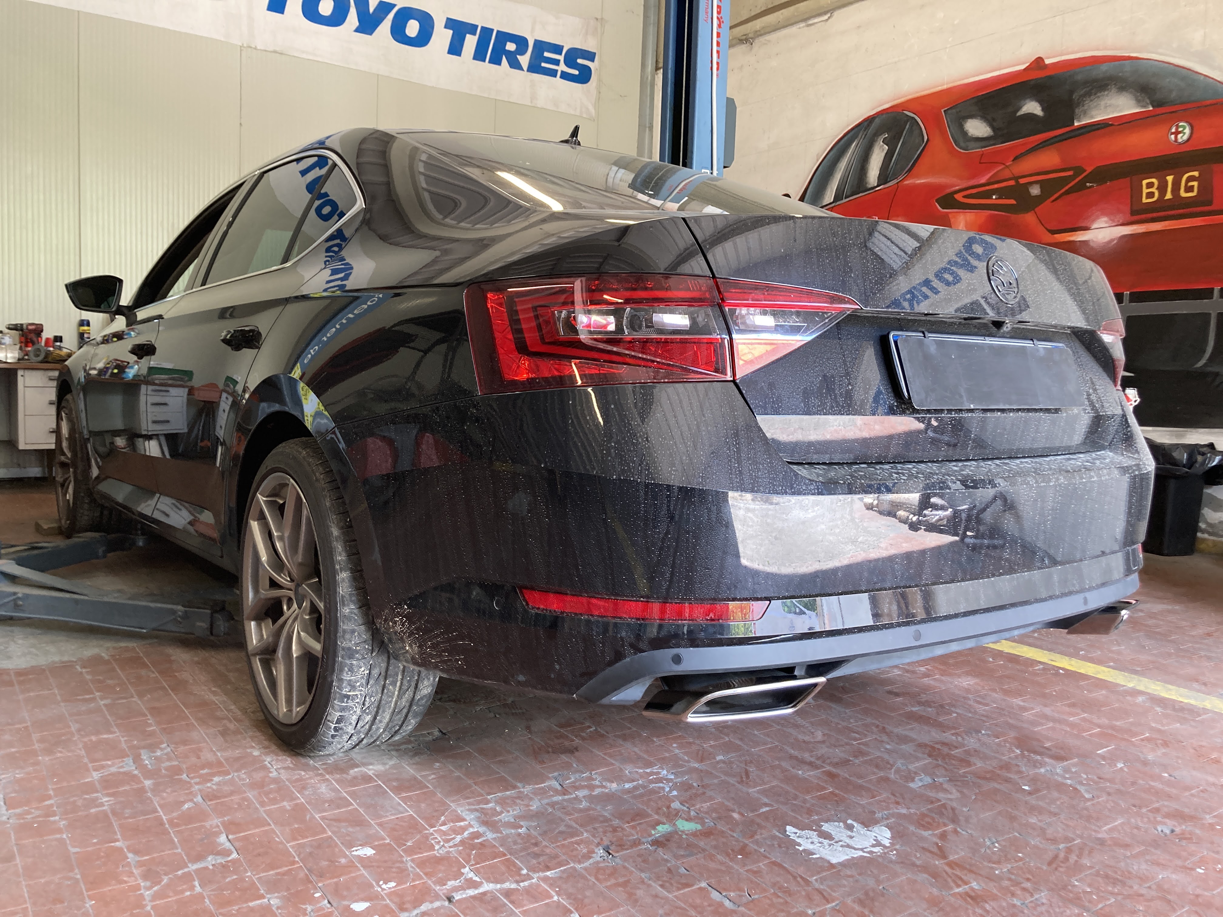

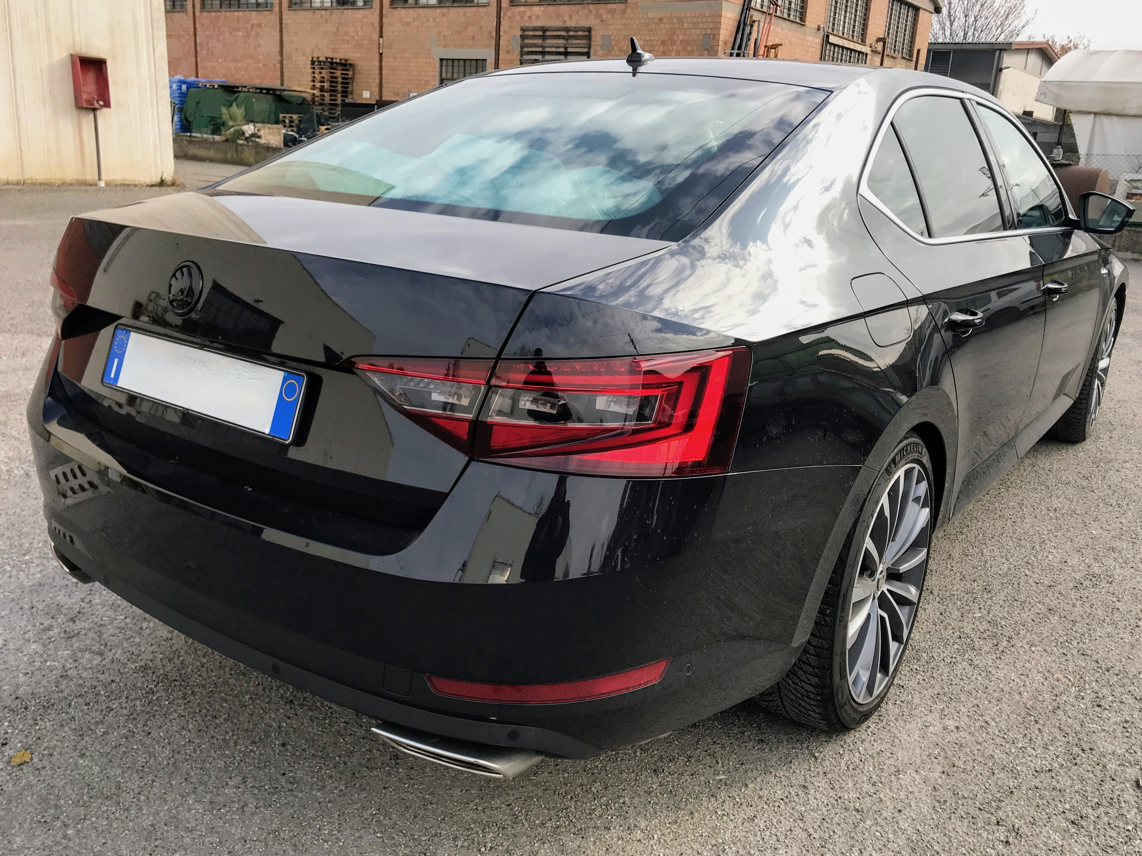

Small changes to the exhaust system, I replaced rear boxes with Supersprint ones with ECE homologation.
I wanted it to have a sportier sound, and to keep the stock look. Adapting OEM tips was more challenging than expected, but in the end they managed to fulfill my request.
I am satisfied with the result, the sound at idle is more intense and darker. Much louder when pushing hard.
The look is exactly like the original.
Looks great - what kind of money were the boxes each - I have looked at these on their site - a full system was fairly pricey. I am running an APR downpipes - so wanted to get something that sounded a bit more meaty.

Yes, prices are those shown on their website.
I recommend them if what you want is a darker sound. Compared to the originals they completely changed the tone of the car.
Before the sound was like a vacuum cleaner, now it's sporty.
Now even when traveling in D, upshifting under 2000 rpm, the exhaust sound is always distinctly heard. It can annoy anyone who's not a petrolhead.
In S mode i can now hear DSG farts. Shifting at 7200/7300 rpm those little farts becomes a sweet little "bang". Very satisfying.

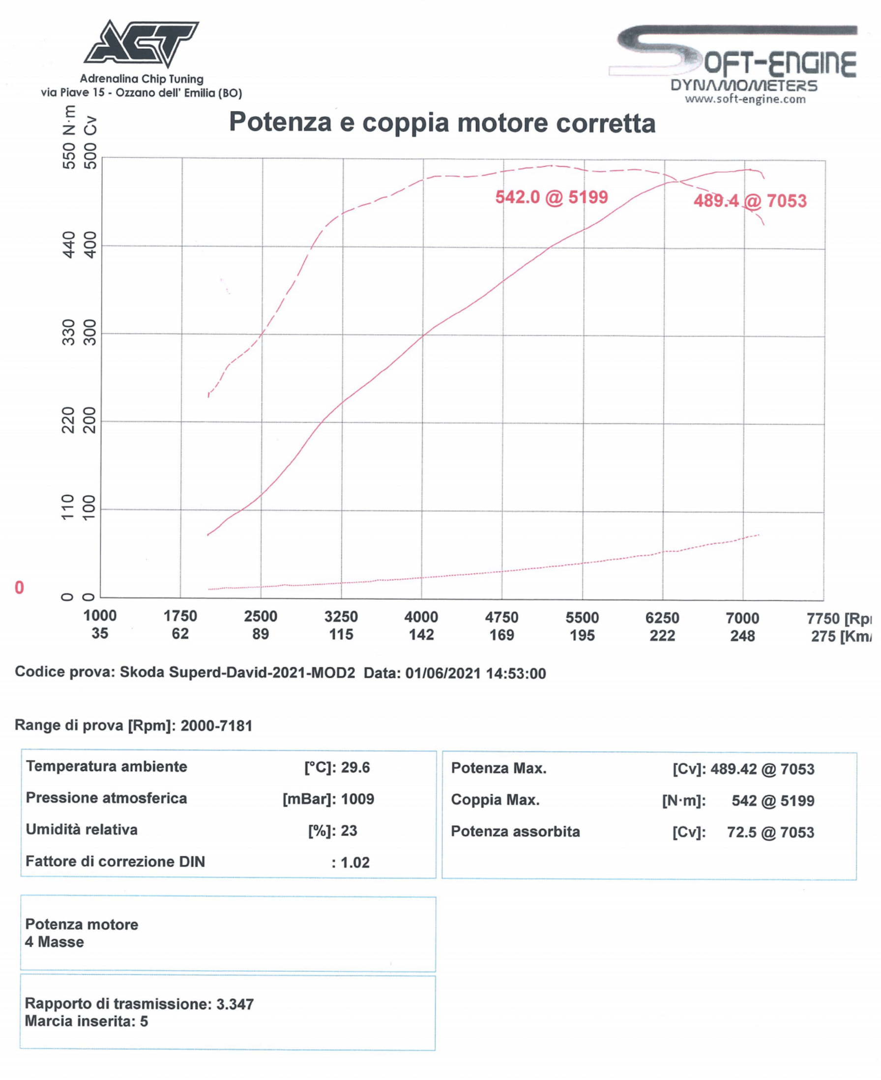

I wanted a little more sound, but performance has not changed at all with Supersprint backboxes. Here's the new dyno chart (almost the same as previous):

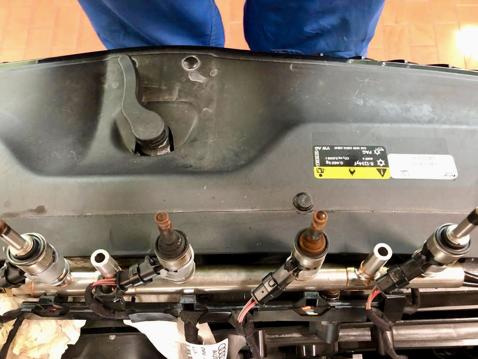

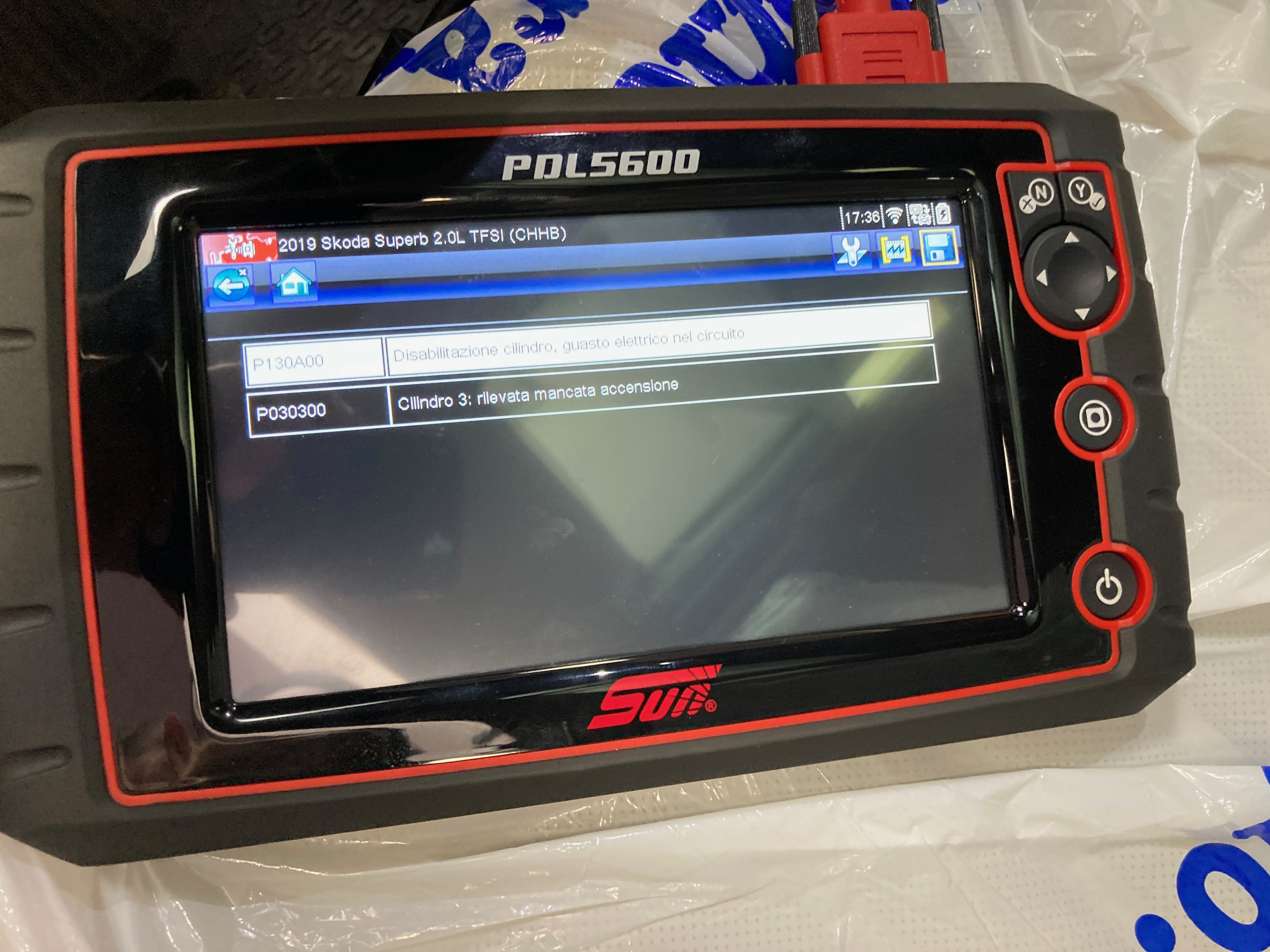

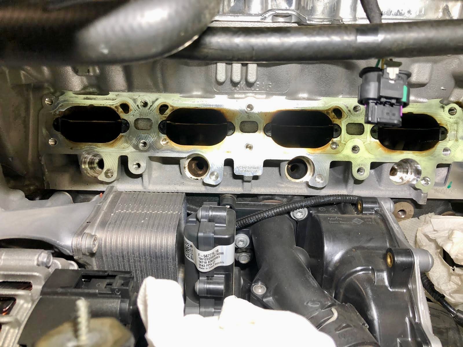

quick update:
had to replace all the injectors, probably damaged by bad gasoline (100 octane from IP wich is the first italian distributor). Normally i refuel with 98 octane Repsol + octane booster, but unfortunately not this time.
Apart from this problem i finally got the rear brake kit i ordered months ago from uk... but the wait was worth it!
