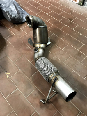

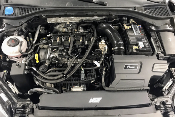

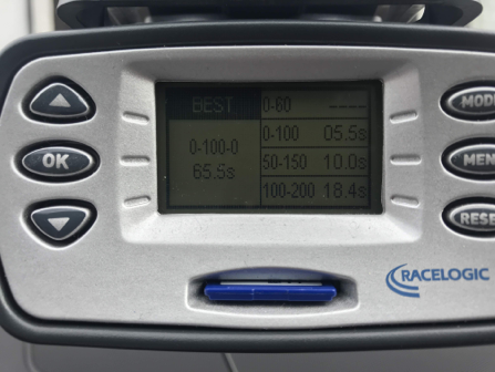

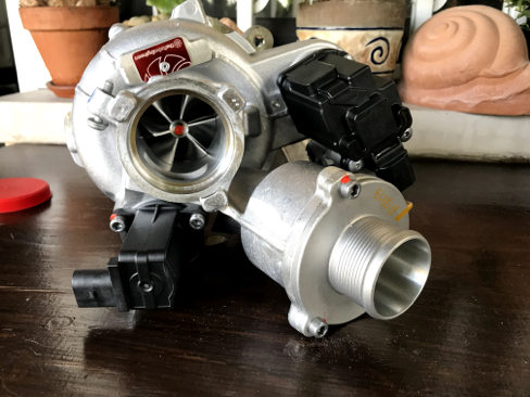

  • At the beginning i thought that this project would be fine with a catted downpipe and OEM cat back. Then i got that central resonator is very restrictive. It retains heat, that is not good for turbo

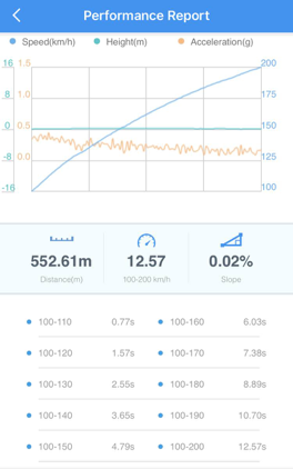

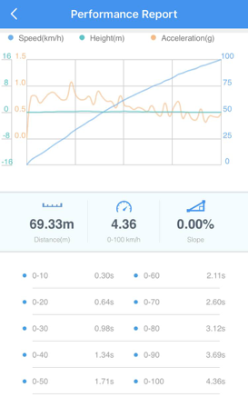

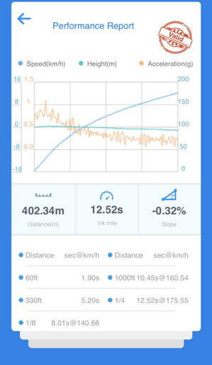

  • The stage3 map has been completed... resulting in 489 ps, more than 470-480 I asked for! And 541 nm of torque. Stock fuel injection, stock low pressure fuel pump. LPFP works at about 70% in this

So If I understood right you currently have all the hardware installed but running the stage 1 map still until the stage 3 map is completed? Interesting what you say about the downpipe, so it passes the wife test?! It's the one thing that I fear will make the car feel "modified" for me. I also am waiting for a GPF retaining solution as there's rumour that a GPF delete will fail the Swedish MOT and I'm not fancying having to swap downpipes once a year if that proves to be true!
Out of curiosity did you consider other turbochargers or you had your mind set on it from the beginning? Also did you use their exchange program? There seems to be a great discount with that option.
Looking forward to your new times! this will be an actually fast superb :thumbup:  (not something to just tease people at traffic lights like mine  :D)
More or less yes, I am using a "safe" map also to verify the correct installation of all the components. And coding the right map takes very long time (using the dyno), because every time you have to set a different value in the ecu it takes about 20 min to upload. Then dyno test, parameters check, adjust and upload again. But i think next week we will have the map almost done, and hopefully don't need for now to add MPI (i would be happy not to be the Alfa tester of MPI on DNU engine...)
I assure you it sounds absolutely original. Traveling on the highway at 130 km / h is as silent as you already know.
For the wife test, however, I do not go into the substance! Before I spend a single penny, I always ask my wife.
But about feeling the car "modified", i have to say that above 3500 rpm the sound is much louder, but it is a sports car sound, not like the kids who remove the catalyst from the 500 to make noise.
I've always had the feeling that TTE was one of the best on the market, so I already had quite clear ideas on this. I ordered a new one (which I have kept closed in the garage until now from November 2019!).
I would have liked to rely on HGP-Turbo, but it's too far from here in Italy. I watched their videos with interest and they gave me the feeling that they work well. They also produce their own OPF exhaust!

Yes TTE have a good reputation but the competition on this platform is fierce! Several options depending on your budget, power target and drive characteristics. HGP are a joke price-wise. They are pretty established and are capitalizing on their reputation, plus they TUV-certify everything but their pricing is out of this world (4200EUR for a stage 1 :blink:, 13.200EUR for a BT setup :blink::blink::blink:)  irrelevant for anyone outside Germany.

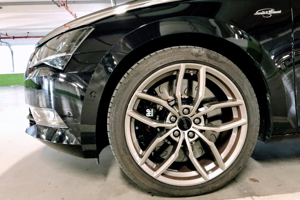

Absolutely true, this is just inspiring for other small subtle tweaks. I've always liked better brakes and as components wear out, get close, I toy with alternatives. Afterall no matter what power you have, the laws of physics still apply trying to stop it, or change it's direction :D
Exactly Roscio 92bhp plus 164nm gain for me for £450 and improved fuel economy as a bonus. Almost 2 seconds gained in most acceleration tests. 40-70mph in 3 seconds is very useful for example.:biggrin:
exactly, I personally tested that a few downhill curves are enough to undermine* the original brakes. So i changed brakes first... I'm for sure not a crazy driver on streets, but braking for the same downhill corners i have not been able to undermine* this bbk! Very pleased!
*is "undermine" a correct term to use for brakes that does not respond well?
Either Fade or Overwhelm perhaps a better description.:thumbup:

Slightly off-topic probably but with such major modifications in power and brakes, may I ask if there are any plans to also upgrade the 3rd fundamental element that will complete the package, the suspension?
Now I don't disagree that for straight line performance and daily driving it is not necessary (if that's all you're after), but with that sort of transformation done already I think a good suspension to match would not only perfectly complete the project, but would allow you to benefit from and appreciate the other mods to a much greater extent, plus it's probably definitely the smallest of costs even for a DCC compatible solution like just B6 shocks (better than OEM but not too harsh) or the full cream B16 Damptronic (firmer setup, but still manageable in Comfort).
And of-course I'm not looking for someone to test-drive these suspension mods for me, not at all... :D

1 hour ago, ColinD said:
if I overcooked on road driving... I’d be driving like a loony and in a hedge. Although plenty of road in Wales and Scotland where fade can appear quickly.
normally fluid and better pads are enough for fast road. But the superb is a big old lass to haul to a stop.
I agree...but just to clarify, in the hills where I live there are roads with a speed limit of 70 or 90 km/h. On some of these roads, the 90 km/h speed limit may seem almost a challenge even for a motorcyclist! By this I mean that on some sections of these roads it is easier to get to the car limit than the speed limit.
Therefore, wanting to test the capacity of the original brakes, just accelerate downhill between one curve and the next, and in a few km the brakes are "faded". As you said, we are talking about a 1,600+ kg car!
