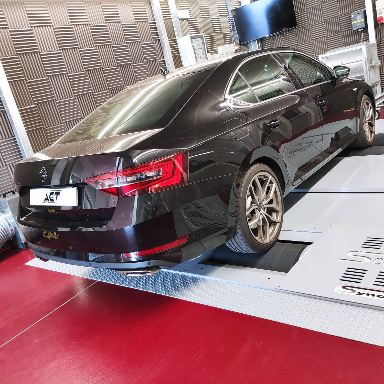

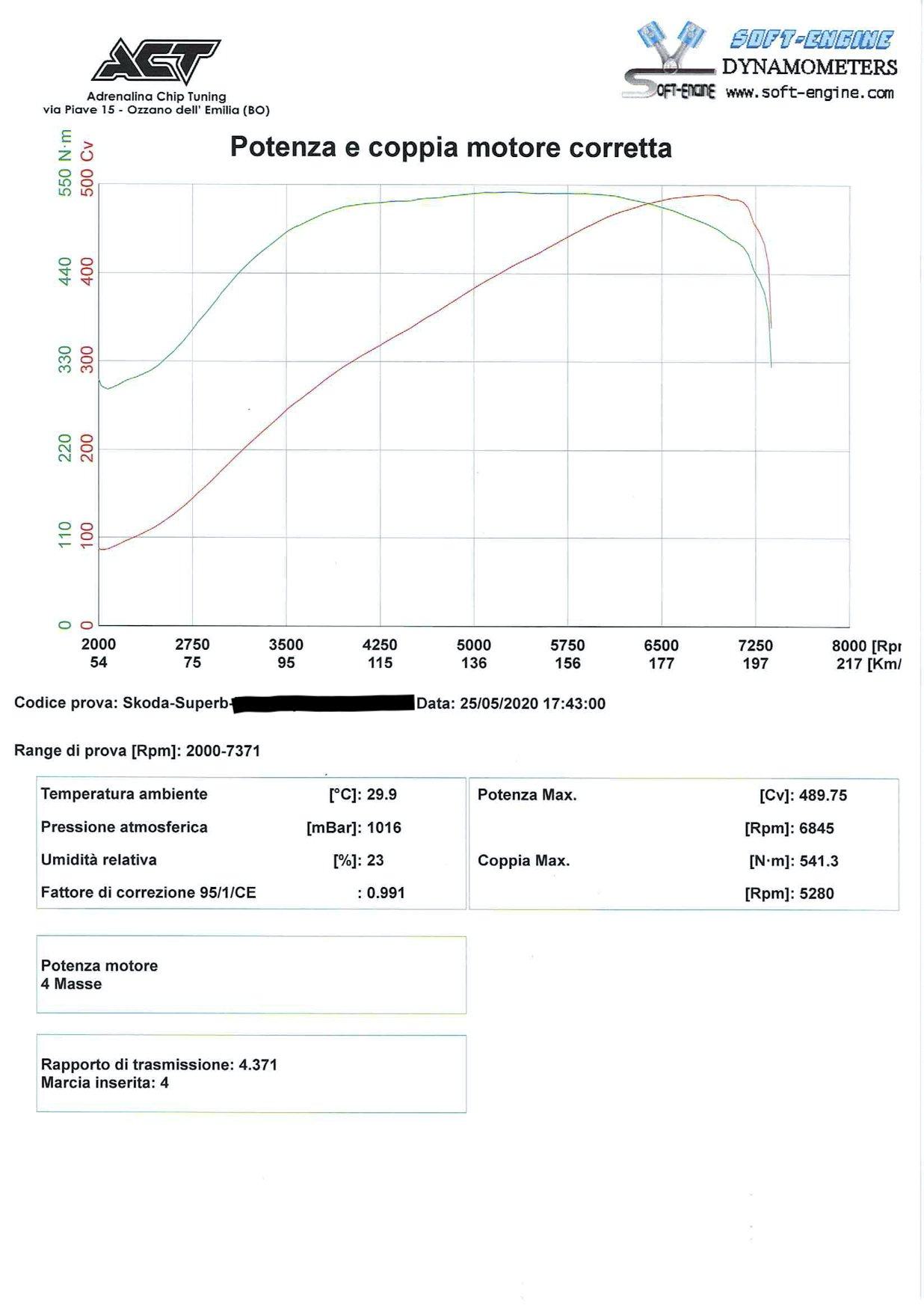

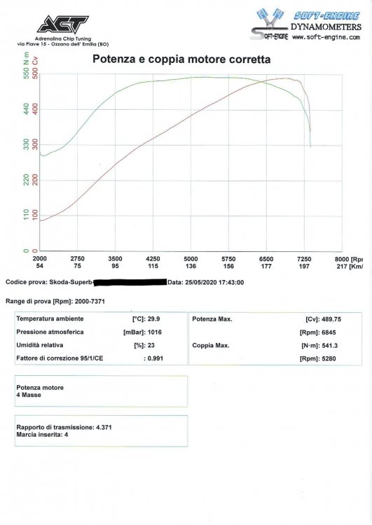

  • At the beginning i thought that this project would be fine with a catted downpipe and OEM cat back. Then i got that central resonator is very restrictive. It retains heat, that is not good for turbo
  • The stage3 map has been completed... resulting in 489 ps, more than 470-480 I asked for! And 541 nm of torque. Stock fuel injection, stock low pressure fuel pump. LPFP works at about 70% in this
  • I know it's not relevant to this forum but I just want to introduce you to the newcomer. For the record, Superb remains in the family anyway...

Very impressive and compared to my weedy 363PS at 5,900rpm and 514nm at 2,600rpm yours has a completely different character when it wakes up.😅
Great  work! Finally you can enjoy the benefits from all that hardware you had sitting there for some time, I really admire you for that I have to say, I would have gone mad having a down-pipe and turbo sitting in my garage for months! :D
From your numbers but even more from the graph, it's obvious there's more for the turbo to give, but I understand you want to go bit by bit and confirm fueling is up to the job first :thumbup:
Apart from peak figures, does your tuner think it would be possible to advance spooling a bit earlier than 4K rpm with further optimization or is it down to this particular turbo's characteristics?
We need Dragy data!!! :tongueout:
Edited by newbie69
Having these toys and not being able to use them for months was frustrating, but the reward was above expectations.
I really thought that with the stock injection system I wouldn't get more than 430-440 hp so I imagined having to continue studying to add MPI right away, just to get 470-480 that I wanted. But 490 is a great result for me, although I am aware that the injectors are at their limit. When the time comes, or when the injectors will break, I'm going to add the indirect injection anyway. Maybe in the meantime APR or someone else will have commercialized a plug-in system for our DNU engines!
About the late turbo spool, there is not much that can be done unfortunately. It's the physics of big turbos.
Now I understand what people say about going stage 3 from a stage 2, when they say it's somewhat frustrating. Because with a stageII you have max benefits from the IS38: low spool and the car is always ready. It's like on and off no matter your rpms.
With a big turbo you'll get very low torque under 3.000 rpm, I would say worst than stock (with stock ecu). The power comes all at once at 3.700-3.800 rpm. And it continues to push ever more strongly up to 7.000 rpm. It's like drive with all or nothing.
Dragy data will obviously be shared, for the moment I want all the components to fit well, I am convinced that after traveling 5-600 km the car is perhaps even faster!

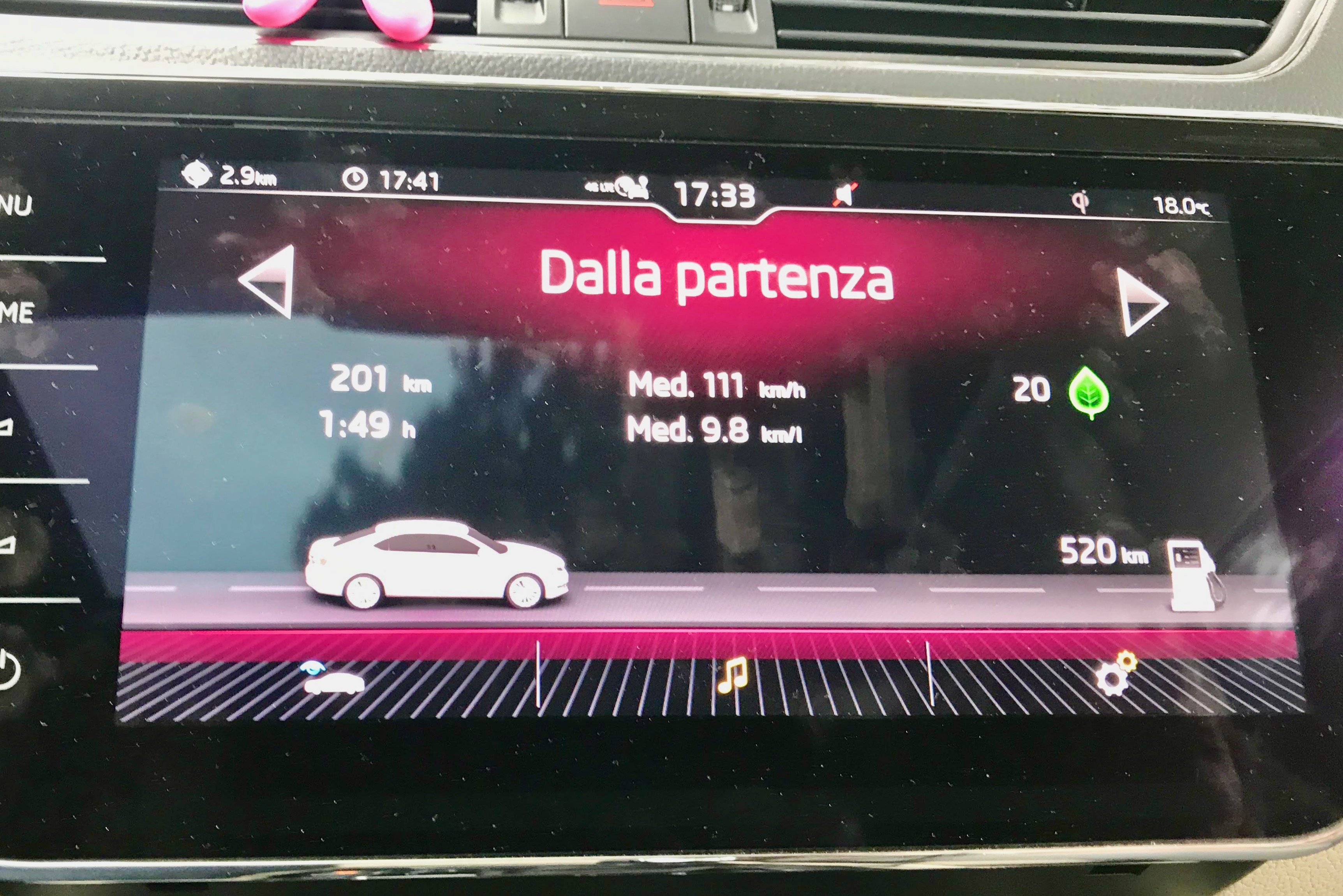

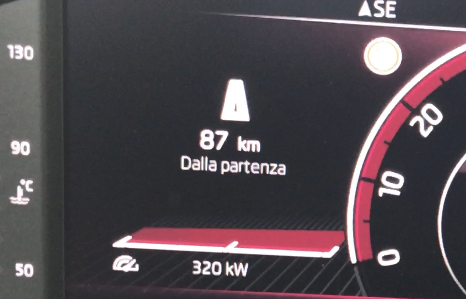

Yesterday, while cruising on the highway, I noticed that the power indicator was reaching 110kW before its half bar. From that moment I realized that power indicator has also been updated :D
And just to say my own on consumption too, I have to say that I am amazed!  Indeed, I am almost convinced that in the right conditions it can also make the same consumption as previous stage1...
That's a very good average speed almost 70mph. I would have to driver very fast to achieve that unless most of your miles were driven on the Autostrada.
Those kms were only driven on the Autostrada, and nowadays it is so empty that you can set cruise control at 143 km/h from start to finish...
