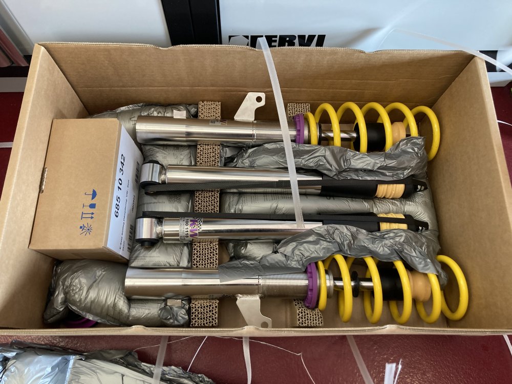

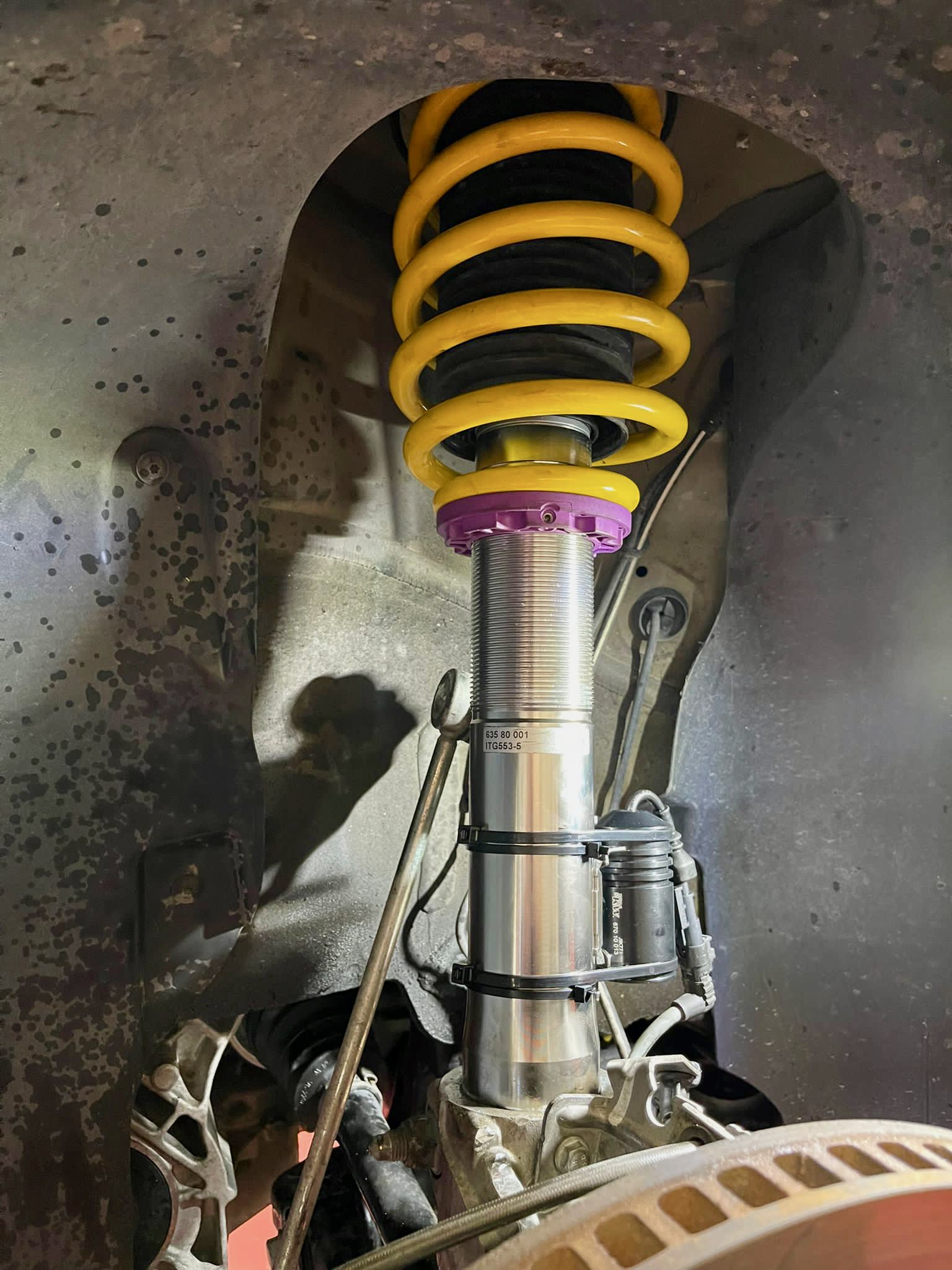

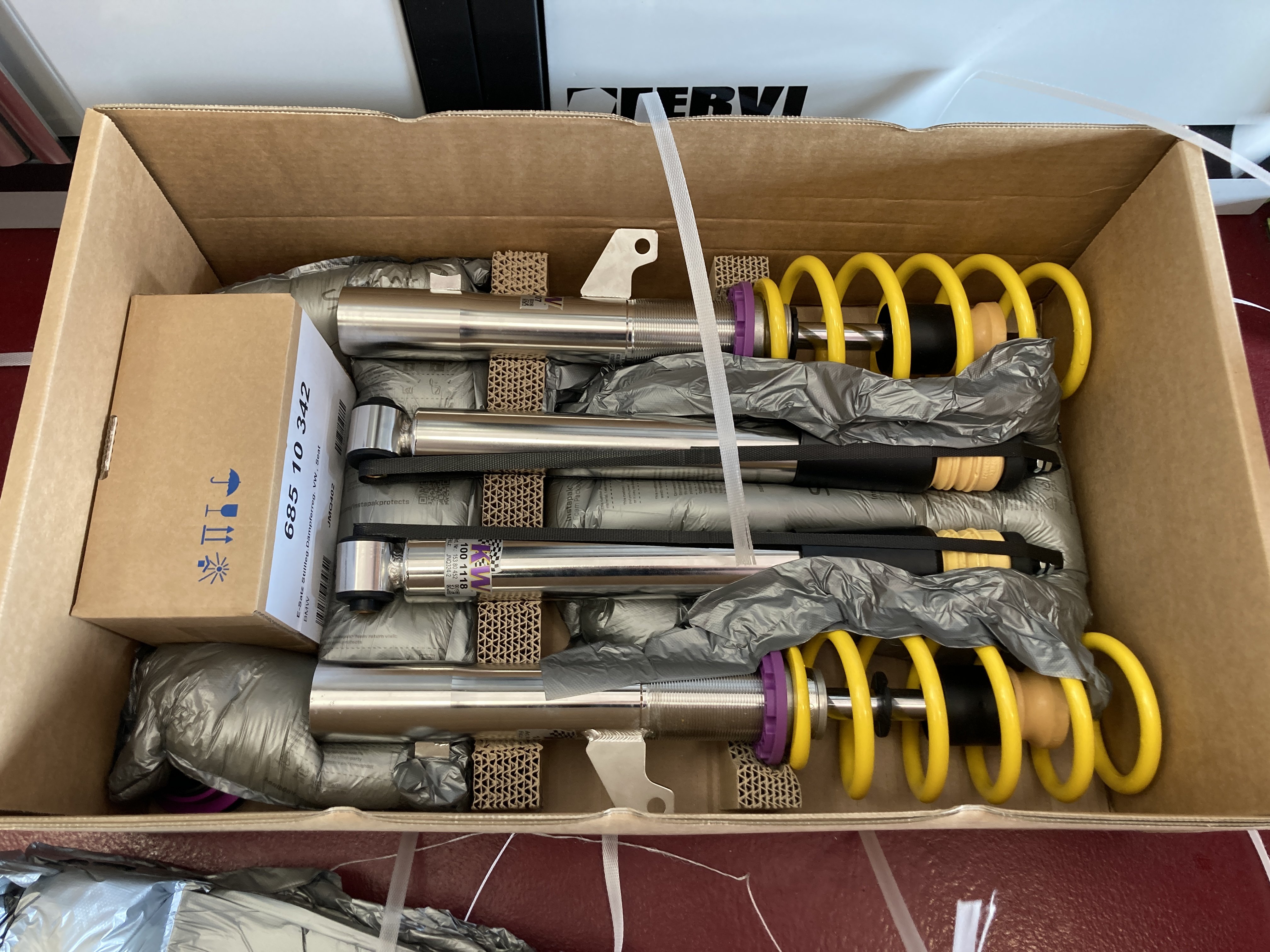

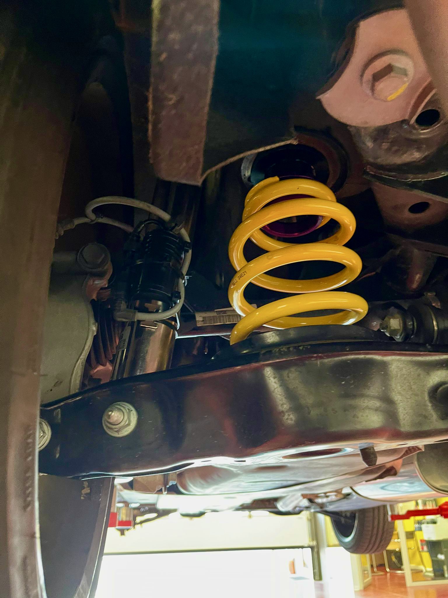

Finally, after months of deciding what to install, after other months to receive the suspension kit, here they are !!
🤩 KW V2 with dcc deactivation
Very nice!  One of the best coil overs, I would slight better than my B16's!  The best one I would say for ride comfort are the KW V3
Have you got them installed yet?
Yes! They have significantly improved driveability.
It has certainly lost some comfort, but totally acceptable considering the end result.
Here're some pics:

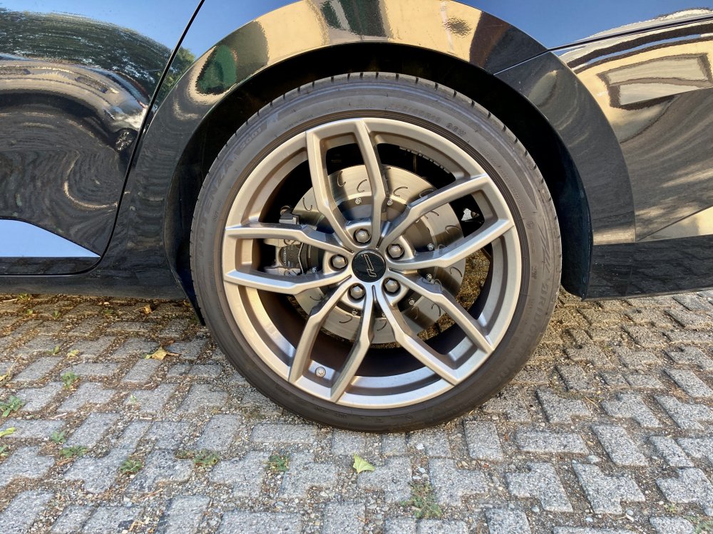

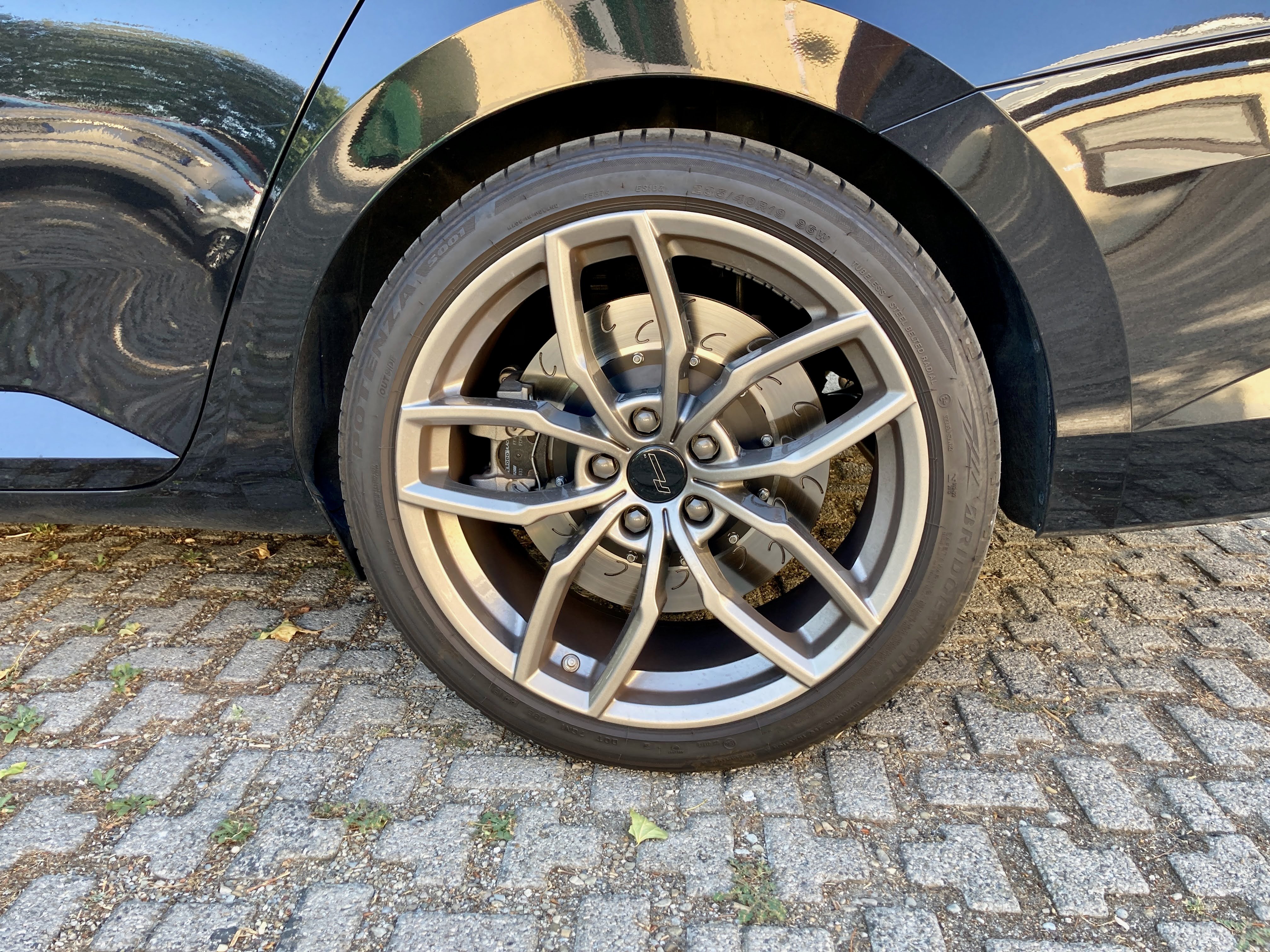

Apart from this problem i finally got the rear brake kit i ordered months ago from uk... but the wait was worth it!
Hello very good job  , for the rear brake kit  you confirm it is the vagbremtechnic kit Rear 356x22mm Disc Upgrade Kit ?
Hi, yes it's the rear 2-piece 356x22 kit with J hooked (AP) discs. You have to buy Vagbremtechnic's DI0019 kit too for fitting oem calipers over those bigger discs.
Hi thanks ,, I am upgrading the braking  front with 357x34 brakes Arteon R 320cv and rear with Vagbremtechnic's DI0019 with OEM discs Audi S7 ,,
everything should be mounted in january

Awesome upgrade those KW V2!!  Together with the rest of the modifications I think they have completed this new level of performance and are allowing you to use it more often and to a greater level than before.
Always wanted to be able to justify those on mine when I had it but didn't manage so I am retroactively jealous 😄 (in a positive way)
Photos are good but go on, give us some in-depth feed-back about what has changed and in what way!
Yes, it was a huge improvement. And the comfort hasn't even suffered as much IMO, it's slightly stiffer than the original sport mode but much more enjoyable.
Due to the increased stiffness, it suffers much less understeer and on wet roads it is much easier to oversteer under acceleration (with a little help of a pendulum turn).

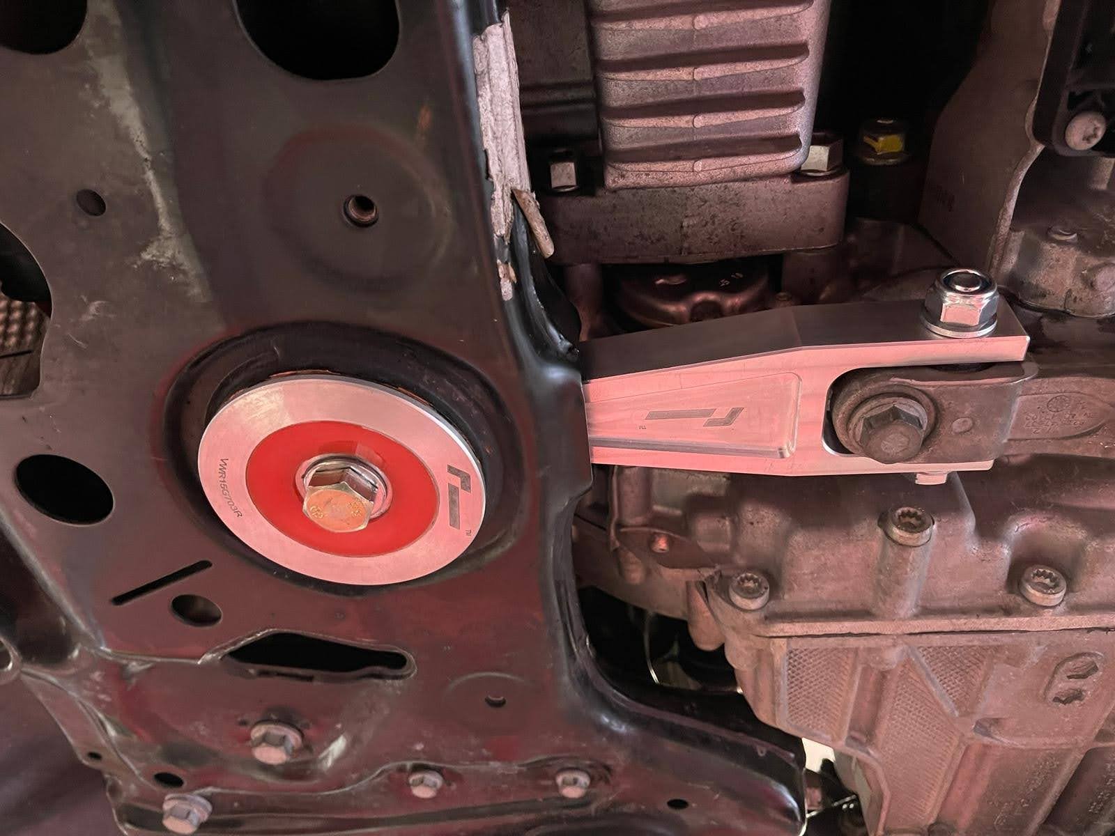

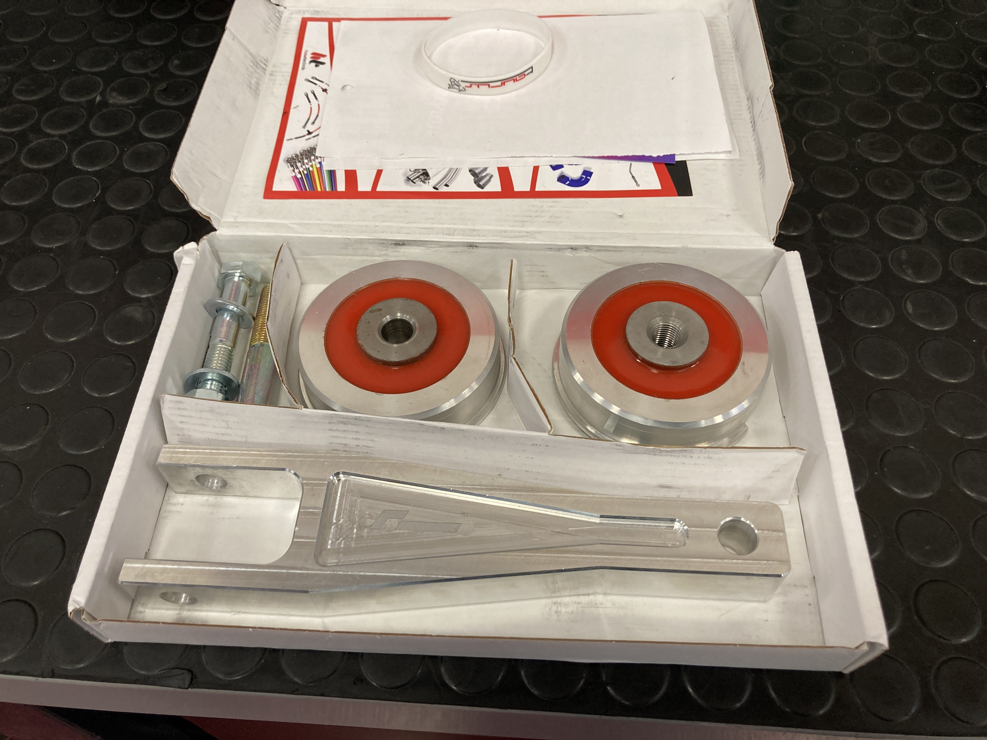

Now I have another problem to deal with, which started when the engine mounts started to no longer hold up under strong acceleration, especially when shifting between first and second gear. So I decided to replace them, choosing the Racingline central mount because it also has the connecting rod.
Since it became almost impossible to get goods from the UK, after several weeks of waiting the seller offered me to give me the same kit in a "race" version, with more rigid supports.
I accepted and installed them, with a noticeable improvement in gear shifting, much more direct. Before the car jolted when changing gear, now it is smooth and the acceleration is constant and linear.
However, I solved a problem but I created a bigger one: vibrations.
Now the car vibrates horribly, I would define it almost undriveable in D because under 2k rpm the car chassis resonates with a very annoying noise.
I stupidly purchased non-void engine and transmission mount and the vibration was horrendous under 2k rpm.  So reverted back to the standards one and I bought this arm for a fraction of the branded ones and added in a powerflex dogbone insert which does increase NVM slightly.
https://www.aliexpress.com/item/10000128124456.html?spm=a2g0o.productlist.0.0.7b084fb8eqsrfR&algo_pvid=355a47e7-6049-445d-83dc-f9e94adc5596&algo_exp_id=355a47e7-6049-445d-83dc-f9e94adc5596-0&pdp_ext_f={"sku_id"%3A"20000000124731992"}
I even increase the idling rpm that made a slight difference.  If you have ODB11 then its very simple to do.
I think the Revo engine and transmission mount are meant to be slightly harder the stock with a slight increase NVM however based on feedback the best ones are Superpro or BFI but they are stupidly expensive!
I may try the 034 Motorsport ones from Awesome for c £300.
Still not as fast as a Mini around corners. Ok? 🤣
When I looked at your photos, even before reading your issue I wondered, didn't this create more problems than it solved?
Unfortunately in the majority of upgraded engine mounts this is the case, despite some people saying "oh it's not that different", they probably have too much "because race-car" mentality and a higher tolerance than I do.
It's a long time since I was looking at engine mounts for the Clubsport (think they are the same for the Superb) and can't remember who was supposed to be the "mildest" one but even for that I had heard people say that it's not exactly as stock, which is to be expected, which is why I didn't proceed really.
I had a similar experience in a previous car of mine, an ordinary warm-hatch, and it was really taking away from the comfort and driveability, I can only imagine how out of place it must feel on a car like the Superb so I hope you find an alternative, or maybe the "normal" version of Racingline (is it the one with blue dampers? (instead of the reds in yours) is less harsh?

As for the engine mounts, i was advised to wait because they would soften over time. In fact I decided to keep them: above 2,000 rpm it does not vibrate at all, below 2,000 there is a very annoying drone. But that's not a problem for me, I only drive in S 😁.
