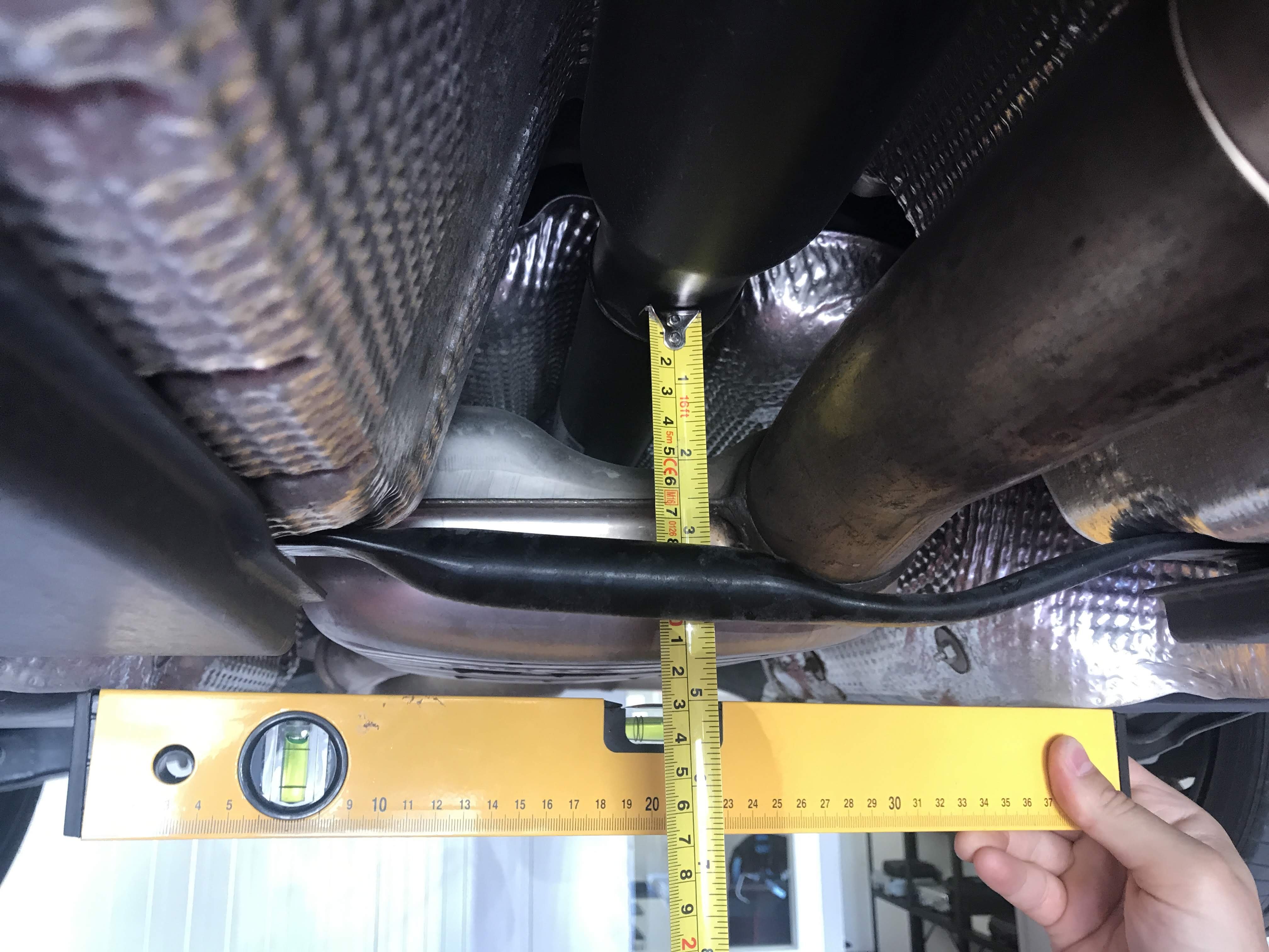

According to their description, that vibrant resonator is 5 inch deep. Considering the standard resonator has a concave in it to fit under the prop shaft, I think you're onto a loser Roscio - but I admire your ambition and determination to find a solution. 👍

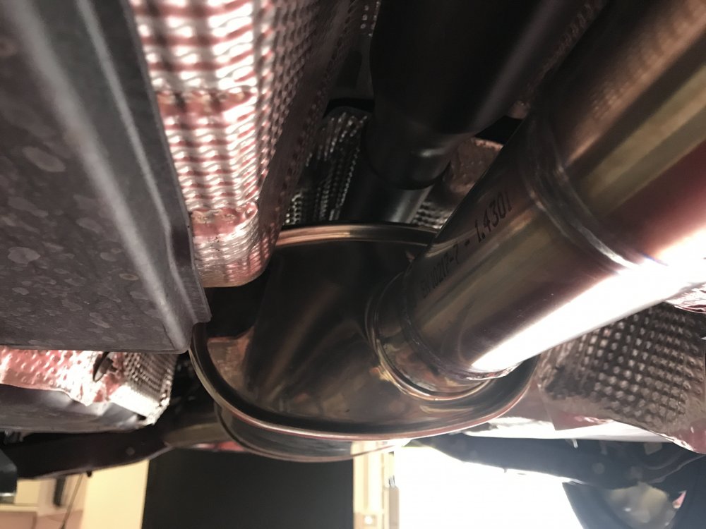

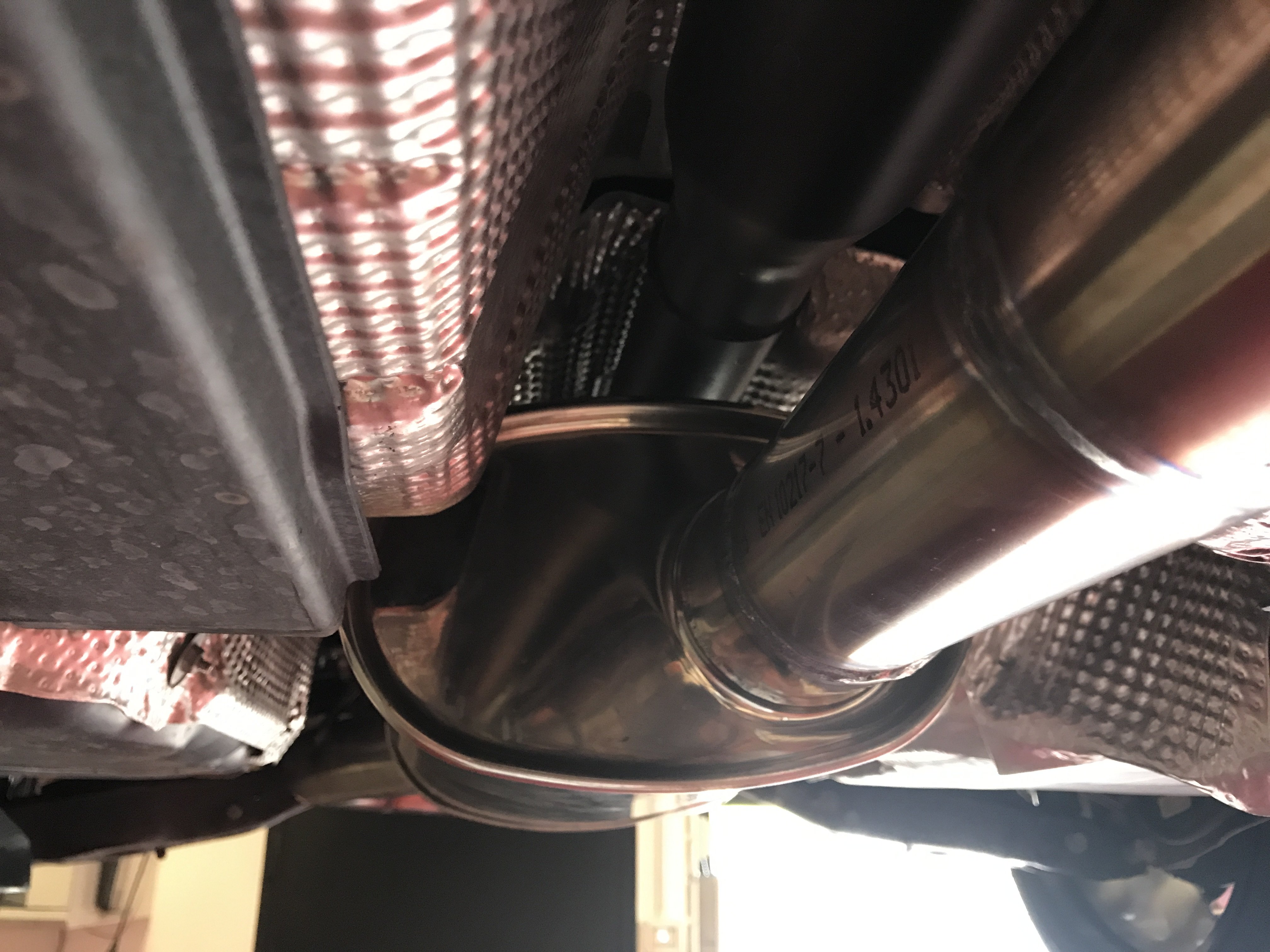

True, there is barely space for the Vibrant 5 inch deep muffler. This is the stock one:

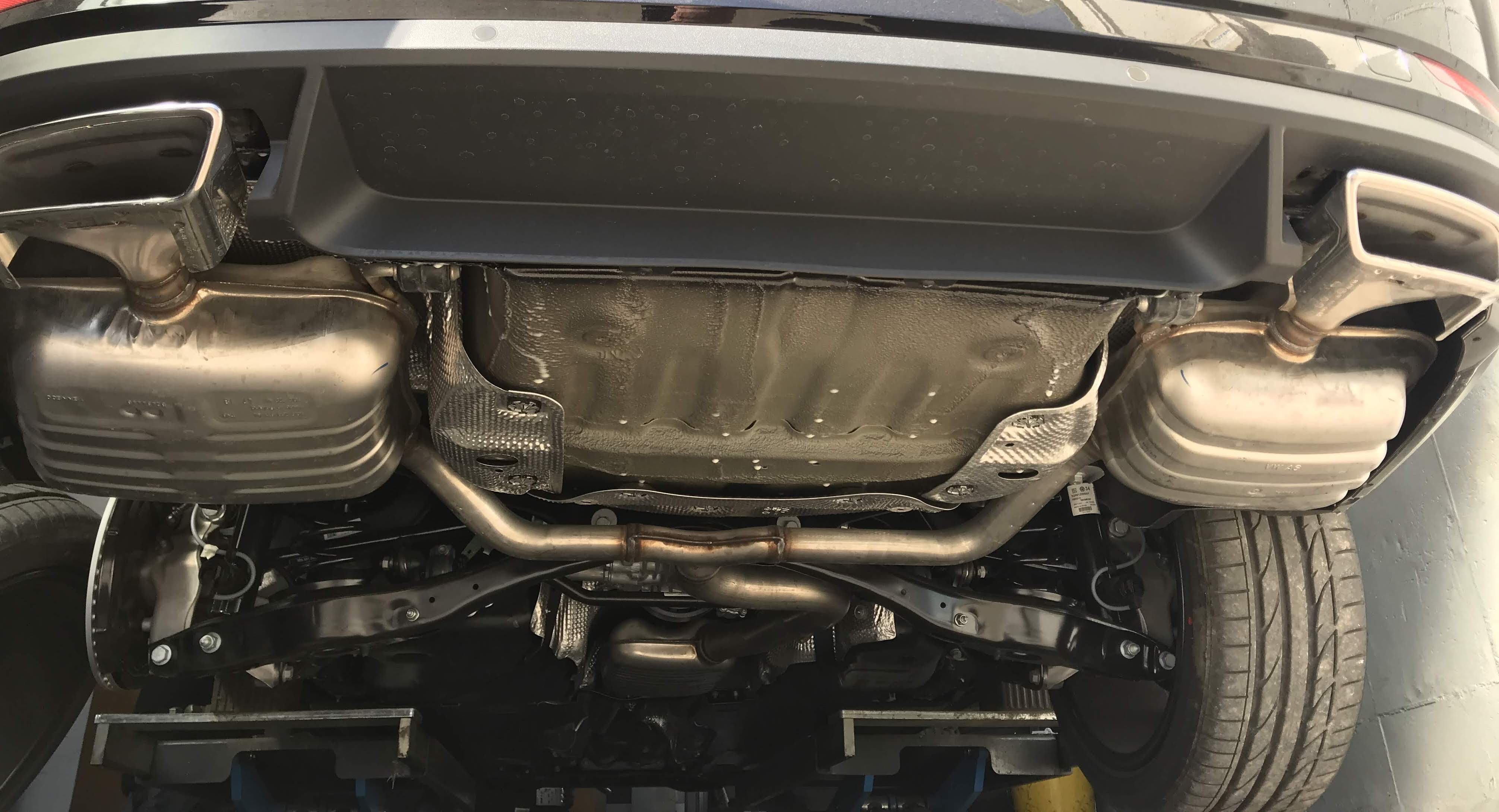

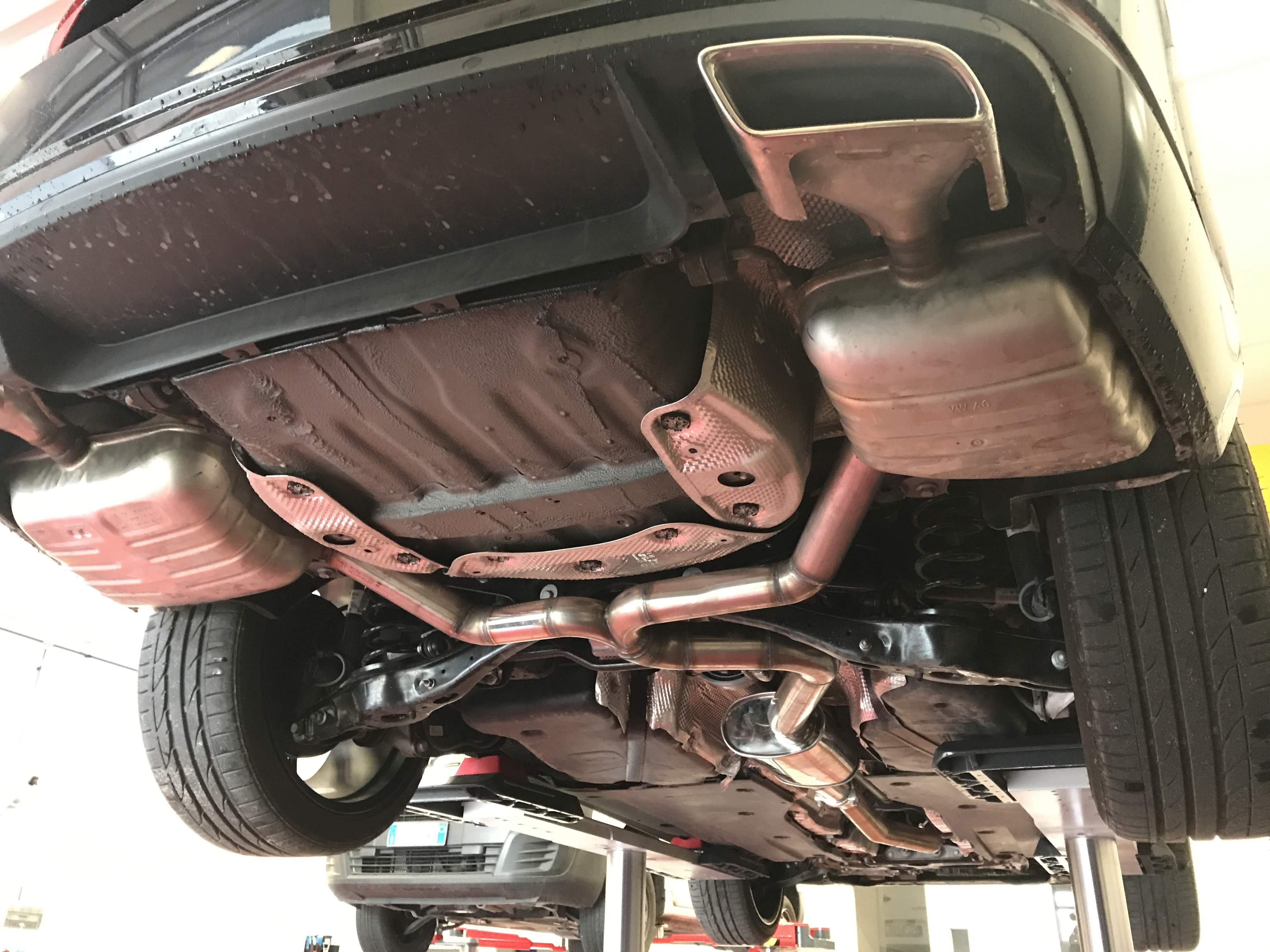

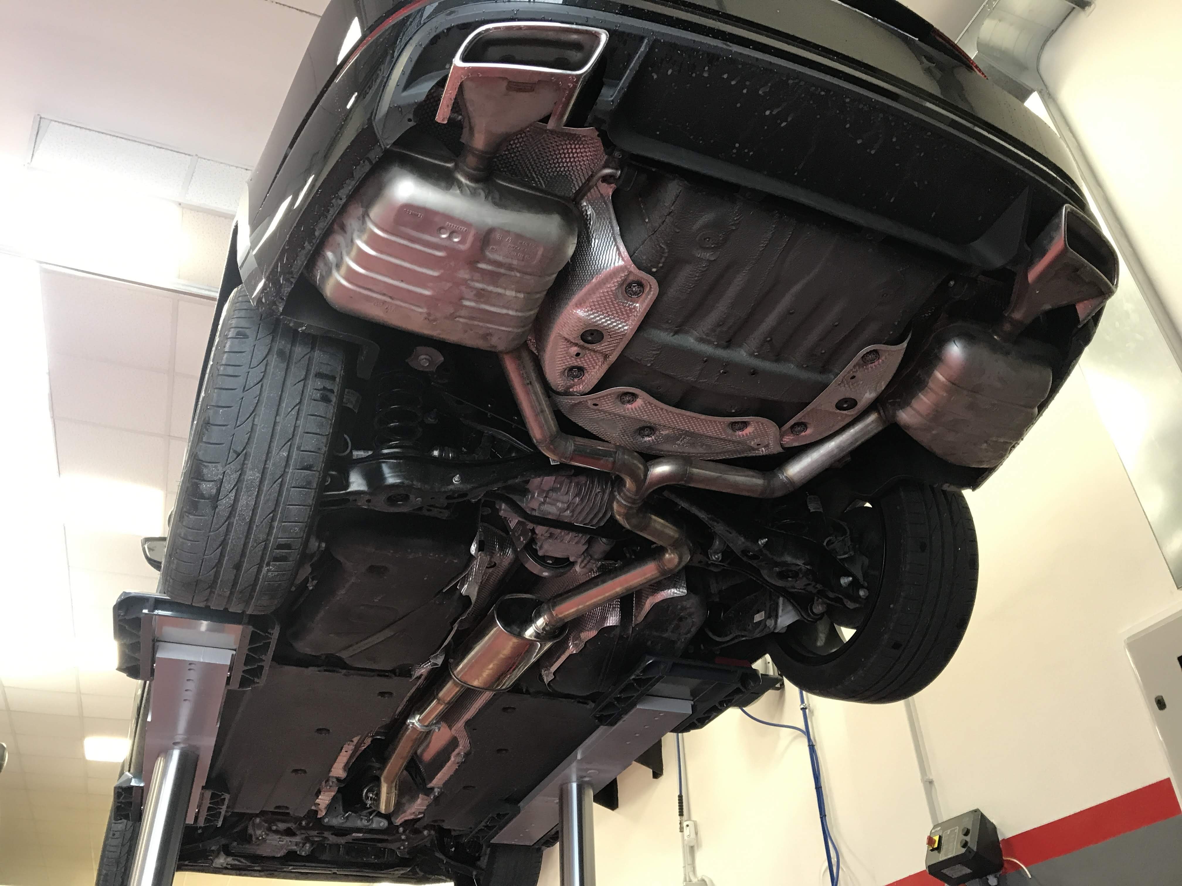

So in total you have a completely upgraded first half from Milltek with an upgraded downpipe and complete GPF delete (I assume that's the SSXVW513  model?), and then you join it to the Vibrant muffler (those are both 3" ?) and after that it's all stock still?
43 minutes ago, newbie69 said:
Just for me to get this clear, what you did was to remove the mid-resonator from the piping, and weld back a Vibrant muffler in its place?
Not exactly. The existing line had to be adapted to the new muffler i bought due to its dimensions. So I thought it would be better to change te entire 2.5'' OEM pipes with new 3'' for better flow.
The Milltek downpipe i bought, the SSXVW513, has been modified because it interfered with the transmission shaft. And beyond that, this one reduces at the end from 3 '' to 2.5 '' to connect to OEM catback, so I cut it before restriction to have a full 3'' exhaust.
After the central silencer, the 3'' pipe splits in two new 2.5'' up to the OEM rear mufflers.
Final configuration is:
- Milltek SSXV513 (modified), with HJS 200 cell cat
- GPF delete
- Vibrant Performance #1127 central muffler (it has 3'' inlet and outlet)
- upgraded 2,5'' to 3'' pipes
- stock rear mufflers
pave the way for the rest of us noise-sensitive family men!
On this aspect I can assure you that it is really quiet, it sounds completely stock (until you push accelerator hard).
My wife said it's quieter than before. I don't think so, it sounds deeper. But it doesn't attract attention, and this is the important thing!

The Milltek downpipe comes in two options either for pairing with the OEM cat-back (2.5") or the Milltek cat-back (3"), if you knew the resonator's  limitation in advance you would have gone for the second option that keeps a 3" diameter all along the pipe and spare yourself from some modding but you were hoping to keep the OEM res so it's understandable.
For the "muffler-back" bit, you decided to enlarge the OEM pipes from 2.5 to 3 instead of fitting a 3 to 2.5 reducer on the outlet of the Vibrant correct? At that point and after all those steps I guess it makes sense, you don't want to come across any other obstacles in the flow...
I like how you have kept both OEM mufflers though, that's probably why the noise has been kept at reasonable levels, very nice that you have achieved that despite having upgraded the entire exhaust system to a much better flowing one. Proves once again that mufflers are not a limiting factor even for such more powerful setups :thumbup:
You hit the spot!

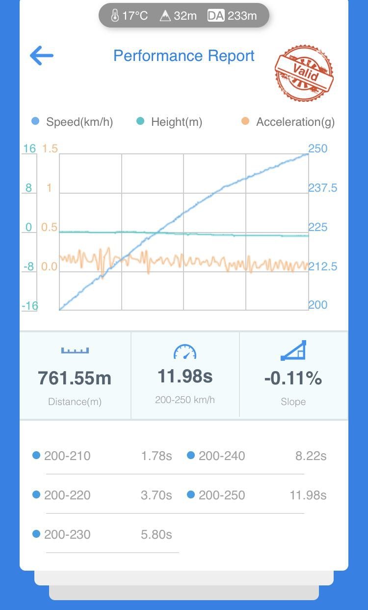

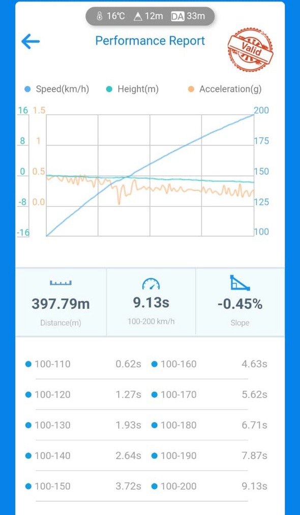

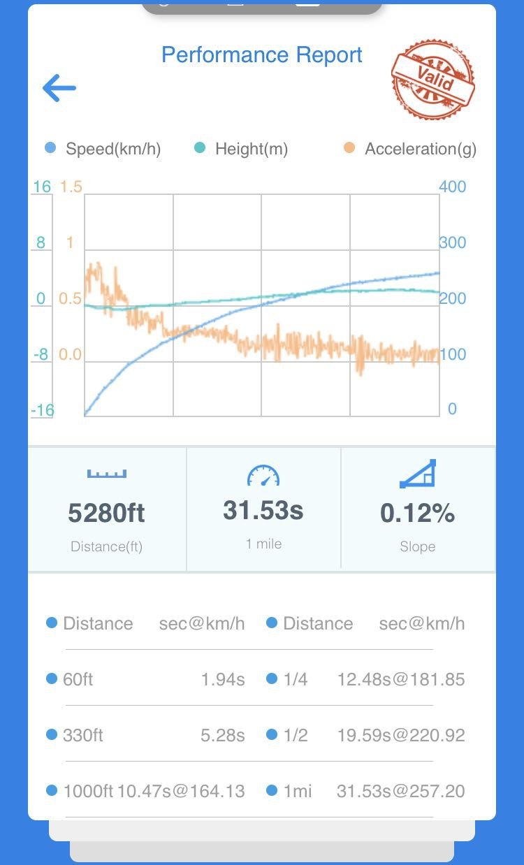

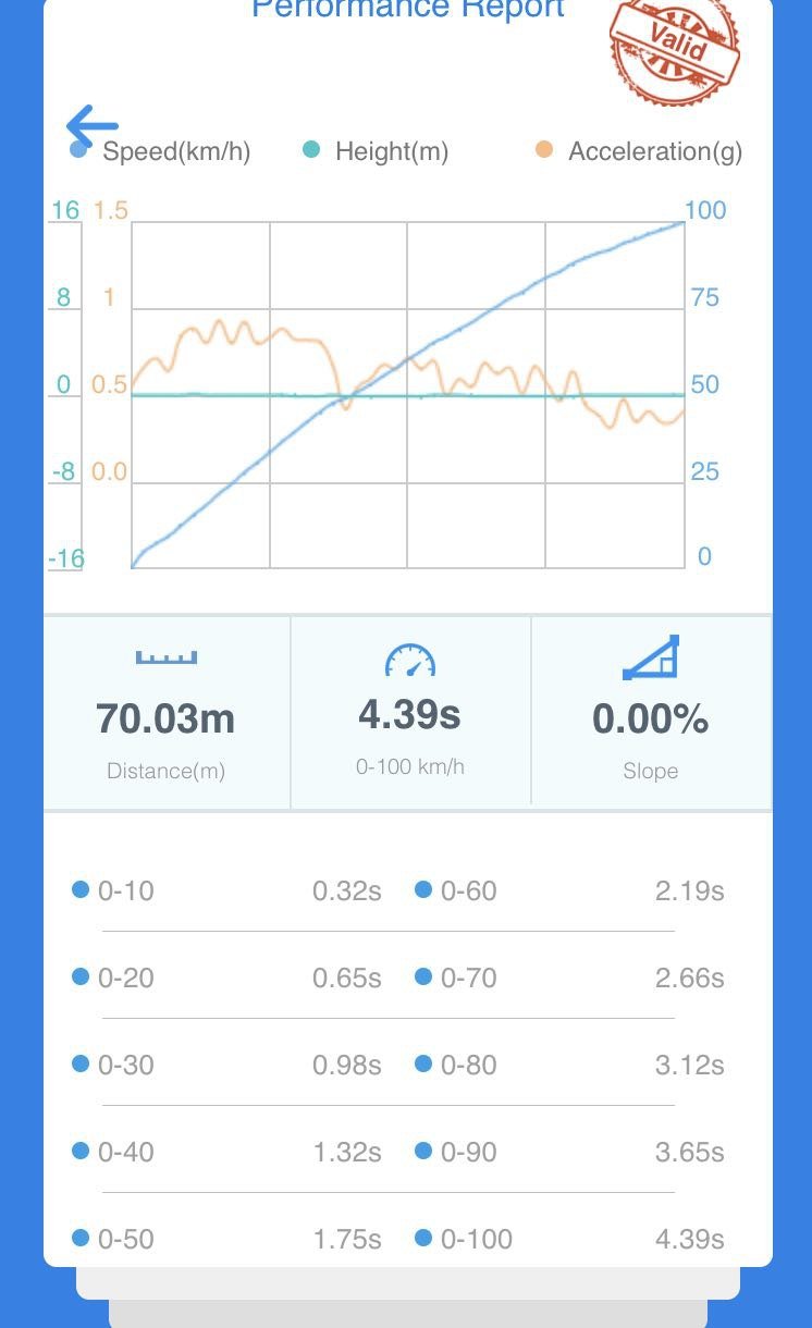

Time for some dragy numbers, I had the opportunity to do some tests. Long story short:
0-100 4,39 sec
100-200 9,13 sec
200-250 11,98 sec
¼ mile 12,34 sec @ 183,43 km/h
½ mile 19,59 sec @ 220,92 km/h
1 mile 31,53 sec @ 257,20 km/h
I’m not happy at all with these results, I expected high 3s on 0-100 and middle/high 8s on 100-200. But numbers don't lie.
Asked my tuner, he says that i could get better times if manually upshifting at 7200 rpm, because in S it upshifts at about 6900 rpm. BUT with this dsg there is no possibility to have auto upshift working in manual mode, for now. I’m not a professional driver and i’m not able to upshift manually at exact moment without hitting rpm limiter.
Maybe soon or later i'll get how to manually upshift at the exact moment, and maybe will get better numbers, but for now let's say that i'm fine with this.
After all I feel the car powerful and gets me a smile every time i drive it...
I would be on the same boat if I were you. Your 0-100 and 1/4" mile times show that the launch is not the best. It doesn't make sense for me to be hitting 0-100 in 4.1" and 1/4" mile in 12.2" with just 390bhp. How does the car feel when launching? Is it a smooth process or? At which RPM is the Launch Control set at?
I had said the best and most noticeable improvement on mine after the REVO + TVS combo was the gearbox behaviour, including launching. The DQ381 is a trickier gearbox than the DQ250 6-speed, that needs really good software to show its potential, otherwise especially with raised power it suffers from weird hiccups.
Can you upload a 0-100 log too? It would be clear then to see which part of the launch you have issues with.
The other reason is maybe the slightly later spool of the TTE535. On the 100-200 run with the launch out of the way of-course the situation improves and the car starts to show its real power, but still, with 480+ bhp peak I'd expect to see 8's I think. Would be interesting to weigh your car and know where you're at. You've already ditched the heavy stock wheels so you should be close to the 1625kg value I measured on mine with ligthweight 19's.  Maybe your tuner has gone for a milder approach that peaks later? Could it be related to the fueling worries on the 272?
