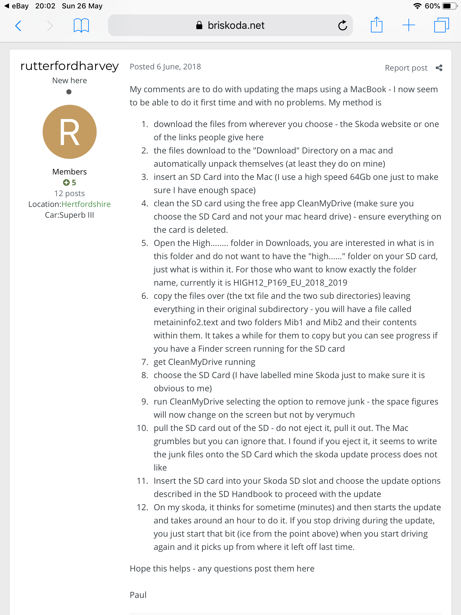

I follow the instructions here when using my Mac to update my maps without any issues
The "CleanMyDrive" app mentioned does a similar job to BlueHarvest that I mentioned - removes the 'extra' files that macOS adds to the SD card which confuse the Skoda sat nav.

I don't think they will - they mention using a 64GB SD card and doing an update of the sat nav from the SD card; neither of those are correct for an Amundsen as with an Amundsen you MUST use a Skoda SD card (any normal SD car will not work) and there is nothing to update after inserting the SD card as the Amundsen reads the maps directly from the SD card.
With an Amundsen you download the .zip or .7z file, uncompress it, then simply copy the files to the SD card and finally clean up the unwanted macOS files. BTW I always copy the original contents of the SD card onto the SSD/HDD of a NAS drive I have, so I have an archive of all the maps for my MIB1 Amundsen from 2016 to 2020.
