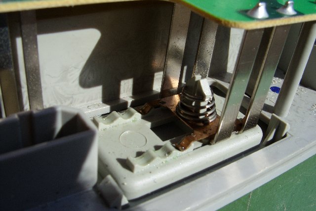

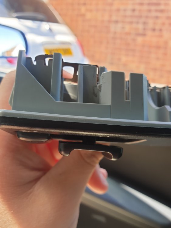

Hi has anyone taken apart an interior light on a mk1 fabia before? I've taken the grey cover off where the buttons are and a spring has come out from some where and now the middle button which slides across is now loose and doesnt work will I need to buy a new unit or can this be fixed?
The spring slides over the post that is attached to the sliding switch button. It locks into position by the tangs on the end.
Took my light out and took a pic for you. vRS light might be slightly different but same idea I think...
