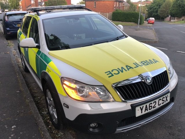

 need some help or pointers on where to find the BCM or CCM on my 2012 Octavia scout.
 Randomly the front driver indicator has come on and stayed on even with key out etc etc.

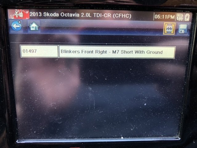

 I have got fault codes but depending on how I test or what I’ve unplugged and plugged back in the codes change slightly.
 Indicator doesn’t flash just stays on, the mirror and rear flash as normal but the front just says on constant even when I’m not indicating... headlight plus is fine no corrosion etc, tried resetting car with battery disconnect etc and tried clearing fault codes but as soon as I plug the headlight in it’s instantly on. Even swapped headlight over from my 2010 model incase it’s internal headlight wiring at fault but still the same.

Given that the other headlight does exactly the same then either a fried BCM or possibly chafed wiring where the indicator feed is in contact with a permanent 12v feed, possibly the high beam wiring as well, the fault codes would indicate that voltage is present on those circuits when it shouldn't be.
The indicator being lit is proof of that, perhaps its a high resistance feed to the main beams not enough to illuminate them.
